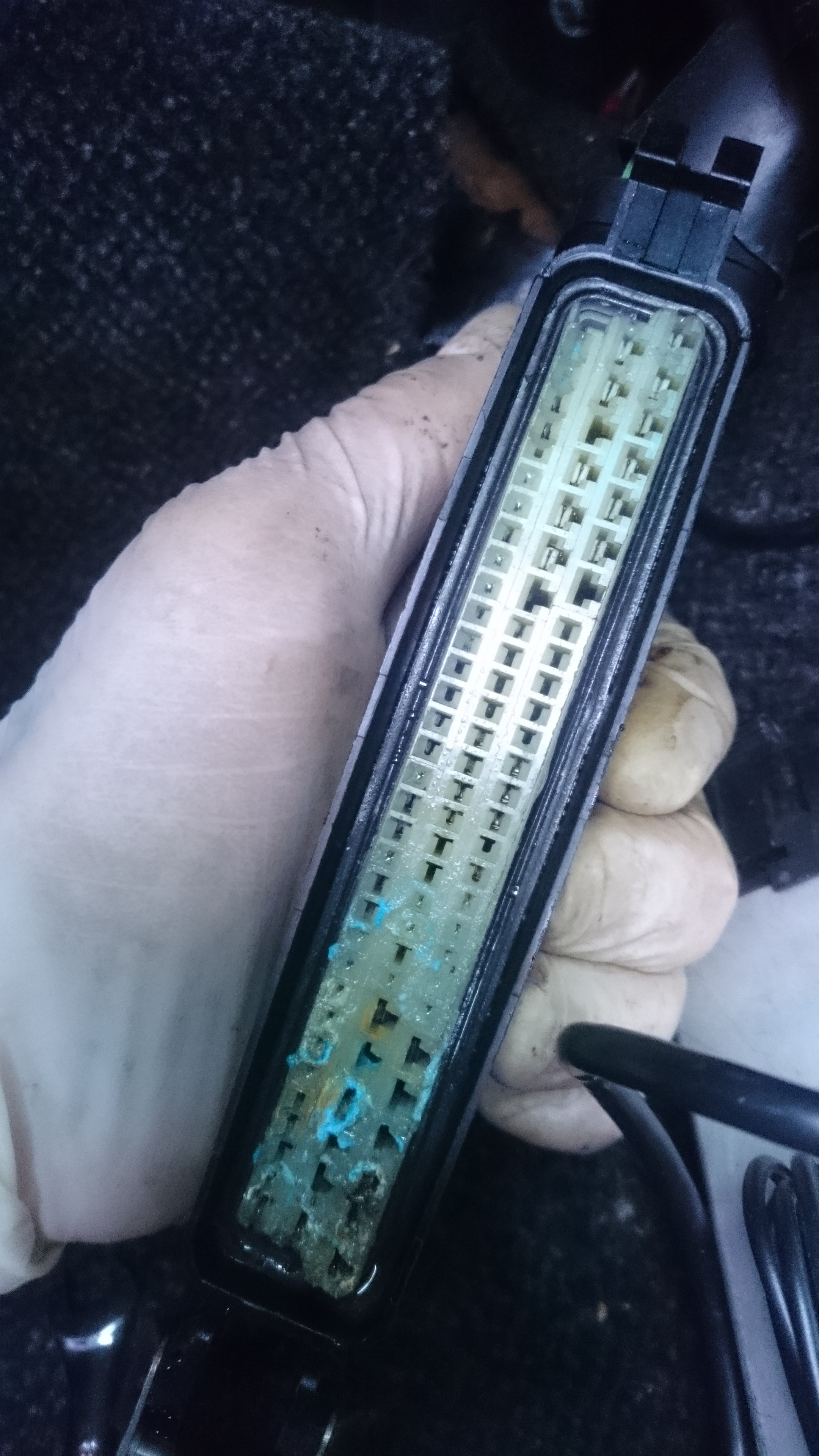

The diag socket is inches away from the engine ecu itself, located in the passenger side centre console, just behind the carpet trim panel, but upon inspection you wouldn't think anything was amiss, so i assumed it must be an internal error. I thought i'd better try to take a look anyway, in the vein hope it might be a simple thing, or something obvious that would at least confirm where my next money should be spent.
I didn't need to look very far!
The ecu is held against the tunnel with a formed steel bracket, with the multipin connection at the top, so easy enough to release it from its mounts, manouvre it freely into the footwell, and release the loom connector.
and i found the problem!
That's got to be 30 pins swimming in water, how on earth it managed to start and rev to 2500rpm is a small miracle in my opinion :shock:
it was easy enough to clean up, and the big relief was that there was no water ingress to the ecu internally. Even contact cleaner was not able to creep in through the pin seals, so water couldn't for sure.
contacts and connections purged and cleaned, reconnected, and voila!
Turn the key, instant life, and revs through cleanly, Thank God!
Ive done some more tidying and improving to enure its all futureproof, and more to do yet, but a good few miles more on the clock for test drive and she hasn't missed a beat yet.
I'm assuming that the water ingress began as the condensation i saw indie the windscreen only recently, as she's been laid up for some time, unused and parked outside, but a conversation with Tom (BLS) confirmed that this wasn't uncommon aback when 164's were current.
Apparently a £2.50 car wash could easily result in a £700 ecu job, so there must be some weakness through the bulkhead and firewall where water can run down the loom and into the upward connecting ecu connection.
Clever design that, thank you Luigi! :roll:
I'll be greasing, siliconing and sealing whatever i find, the car should float when i'm done! :lol:

got yerself a bit of furry corrosion there mate!
