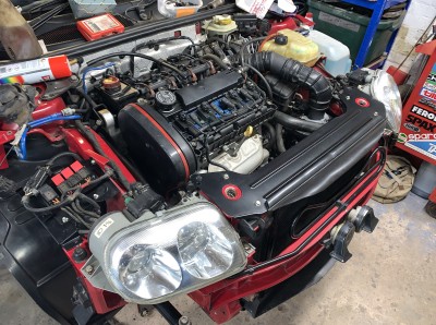

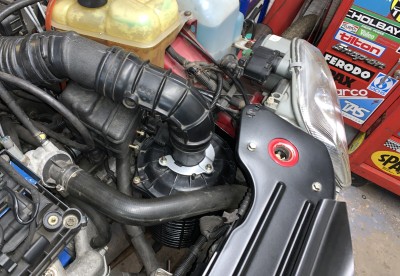

Some under bonnet shots showing how the refreshed bits and bobs are helping improve the engine bay. I need to put more effort in to get the plastics bits better. Im also replacing as many nuts and bolts as I can. I hate grotty nuts !!!

Re: My 916 Spider
superb 8-)

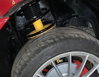

Quick update on the spider. So I got the front suspension refurb all finished and fitted the new Konis. Then the problem started. I fitted the wheels and the words “holy Sheize that’s close “ came to mind.
Now remember that I ran the car last year with the 18” wheels with no issues so I had to start looking at cause of the the problem. It turns out that the konis spring pan is a full inch lower than the std struts. This came as a surprise since they are supposed to be a straight swap for the std legs. Now with std 16” or even 17” wheels it wouldn’t be. Problem but with 18”s it most certainly is
Talking to Phil at Alfashop It also appears that Koni have now discontinued struts for the 916 series cars so For the time being I’ve refitted the Monroe struts with new springs until I can get some help from Koni. I may have to look at sending the struts to koni UK to see if they can strip them down and lift the spring pans an inch

Posts: 1425
Re: My 916 Spider
Do you have a set of standard wheels?
Or could the Koni inserts be fitted in the original struts?
Posts: 1756
Re: My 916 Spider
Yes I have the original 16” wheels but I don’t really want to refit them. I’m currently looking at various options which does include rebuilding and modifying this set of Konis
