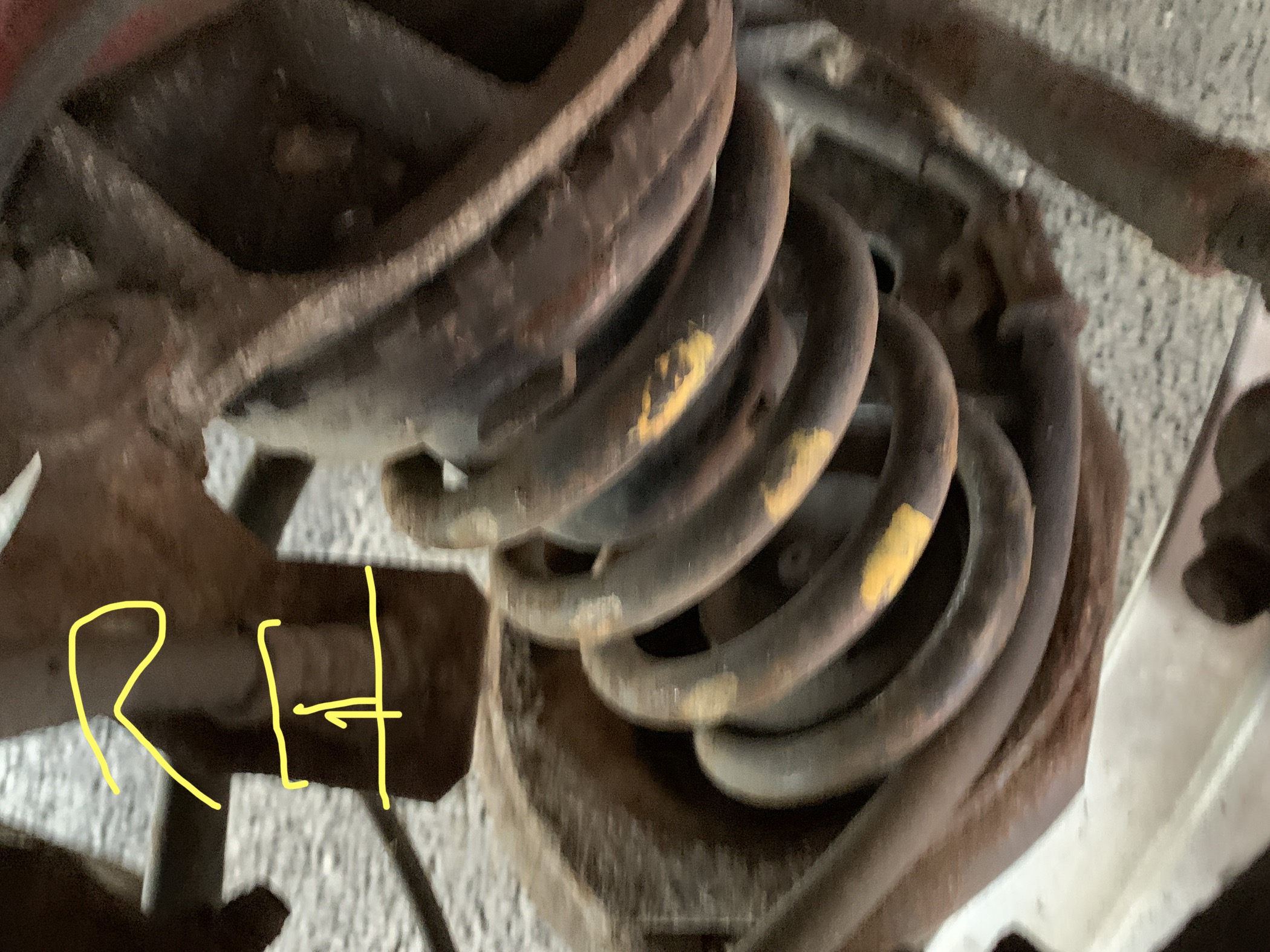

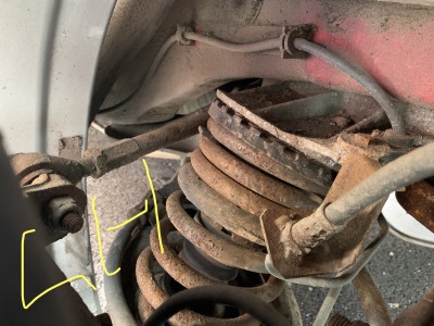

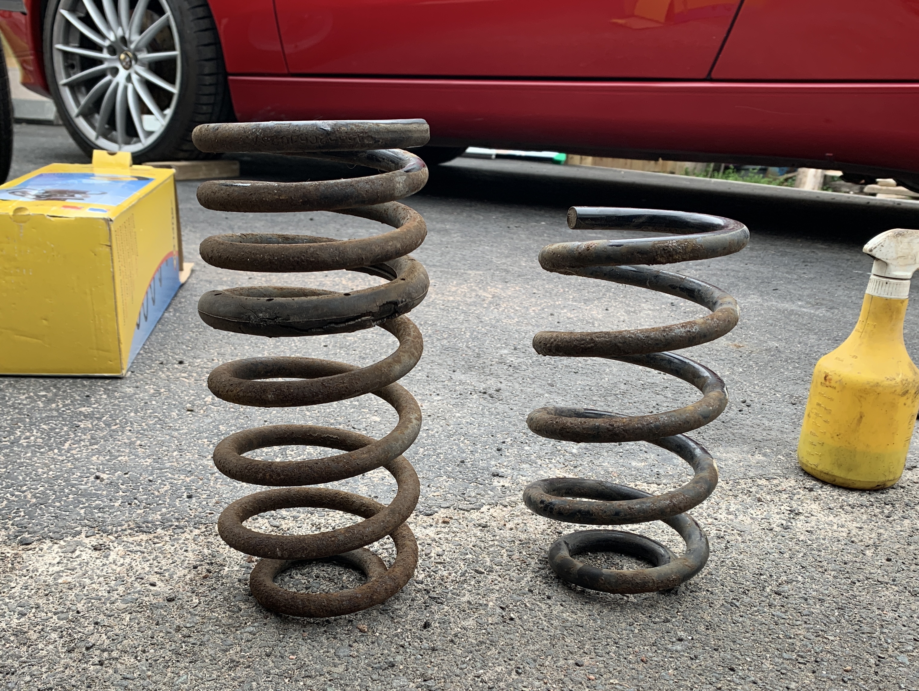

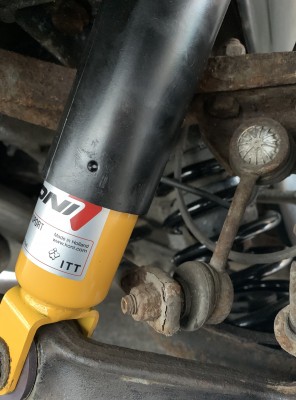

New rear springs and Konis fitted today
Why do people do this !!! The LH is a 3.0, RH is a std TS
Rear springs as removed Why do people do this !!! The LH is a 3.0, RH is a std TS
Re: My 916 Spider
Apart from sqeaking, did the car sit level with those 2 springs fitted?
- Posts: 1756
Re: My 916 Spider
Hi Dave. Yes it did actually sit ok but as you can see the bigger spring was coil bound for the first 4 coils
So its effectiveness was “Suboptimal”. The car felt quite firm at the rear.
Re: My 916 Spider
That is an amazingly stupid, as you say why ?
Re: My 916 Spider
These issues arise from people just doing the minimum to get the car through the test usually, we see it all the time.
You can explain to the customer that it's best practice to change in pairs but often it's turned down on cost grounds, not everyone sees things as we do !
Re: My 916 Spider
Best to fit a second hand spring.
Then it matches the other!

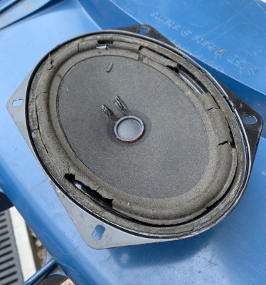

Stereo started to sound a bit ruff Can you spot the problem ??
I didn’t want to cut the plugs off the loom so I made made these to connect to the new speakers.
New Kenwood loveliness
Re: My 916 Spider
Knackered!
Nice upgrade and loom adapter to keep things neat
That has got to be an improvement over those split originals!

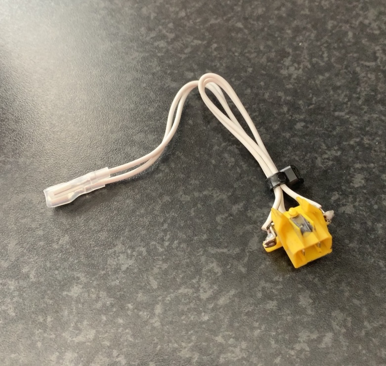

Finally looked at the Spiders A/C system today. The Compressor had never engaged since I got the car. I started by checking The compressor connector with a circuit tester and sure enough the wire wasn’t being energised when the A/C was selected. This was either empty system or a duff pressure switch I checked and sure enough the system was pretty much empty. Shoved some “ make it cold juice” in and still no compressor clutch action. Checked all the fuses and other connections and all seemed fine. I didn’t want to keep adding cool it juice with out the comp running so i ran a frig link for the comp to the main fuse and the comp clutch kicked in. Now with the engine and compressor running I was able to set the correct system pressure. (20-30psi for the low side) once I did that and removed the frig link and replaced the proper switch wire the compressor now responds normally and we have conditioned air. Maybe a bit unconventional method but I’m calling it a Result.
I’ll Now monitor the system for a few weeks to see if it holds up or if it looses pressure and how quickly. That way we can decide if we have any leaks. We’ve got no drips and there’s no “venting to atmosphere” type smoke so hopefully it’s all good.

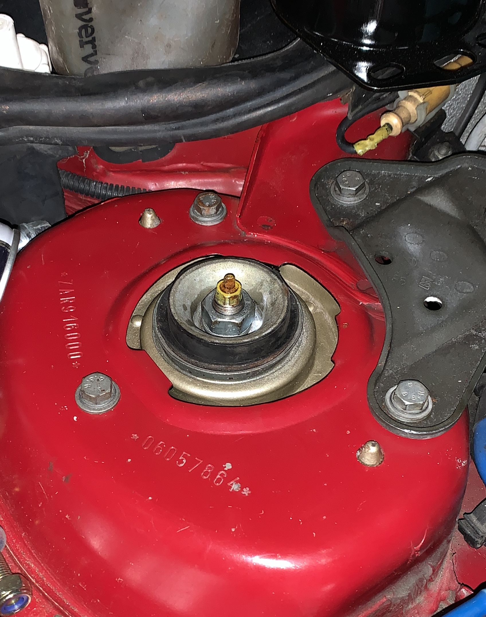

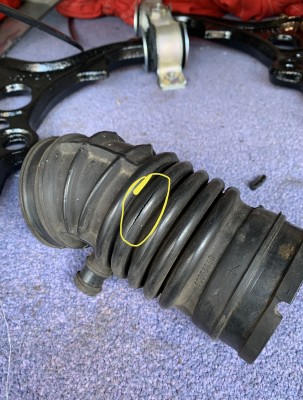

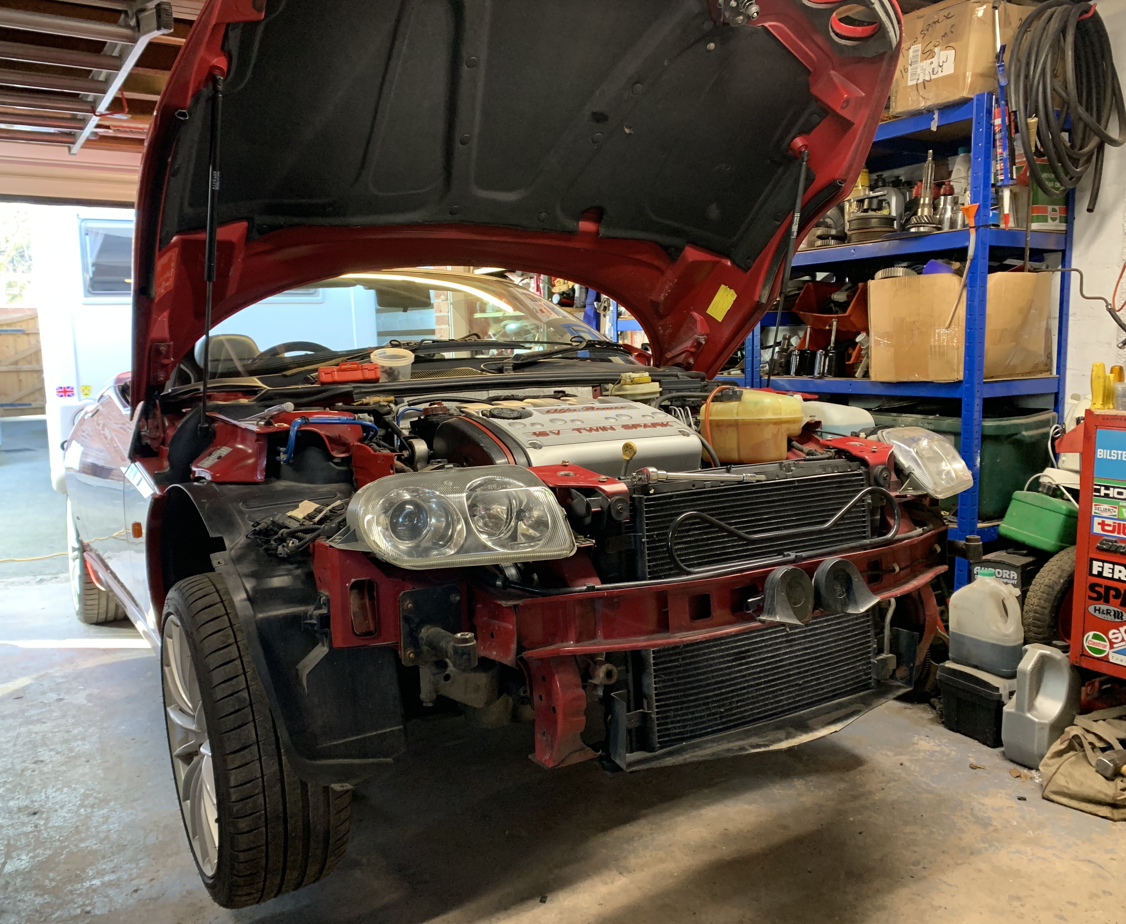

Bit later than planned but the spiders winter hibernation work begins. I’m doing pretty much the same stuff that Kevs doing to his GTV. (Without the engine rebuild) I’m fitting Koni struts up front with new springs, new lower wishbones , ARB drop links and track rod ends. I’m also taking a pile of sheet metal to get powder coated. The idea is to hopefully have trouble free summer motoring leaving me free to do the sud and midget
So that was suboptimal
I’ve also got the drivers door stripped down. It’s always rattled and I’m trying to get to the bottom of it. It’s obviously been apart at some time and the gorilla that didn’t put back together made a great job of not putting back together properly. Also found the air intake rubber had a split in it.So that was suboptimal

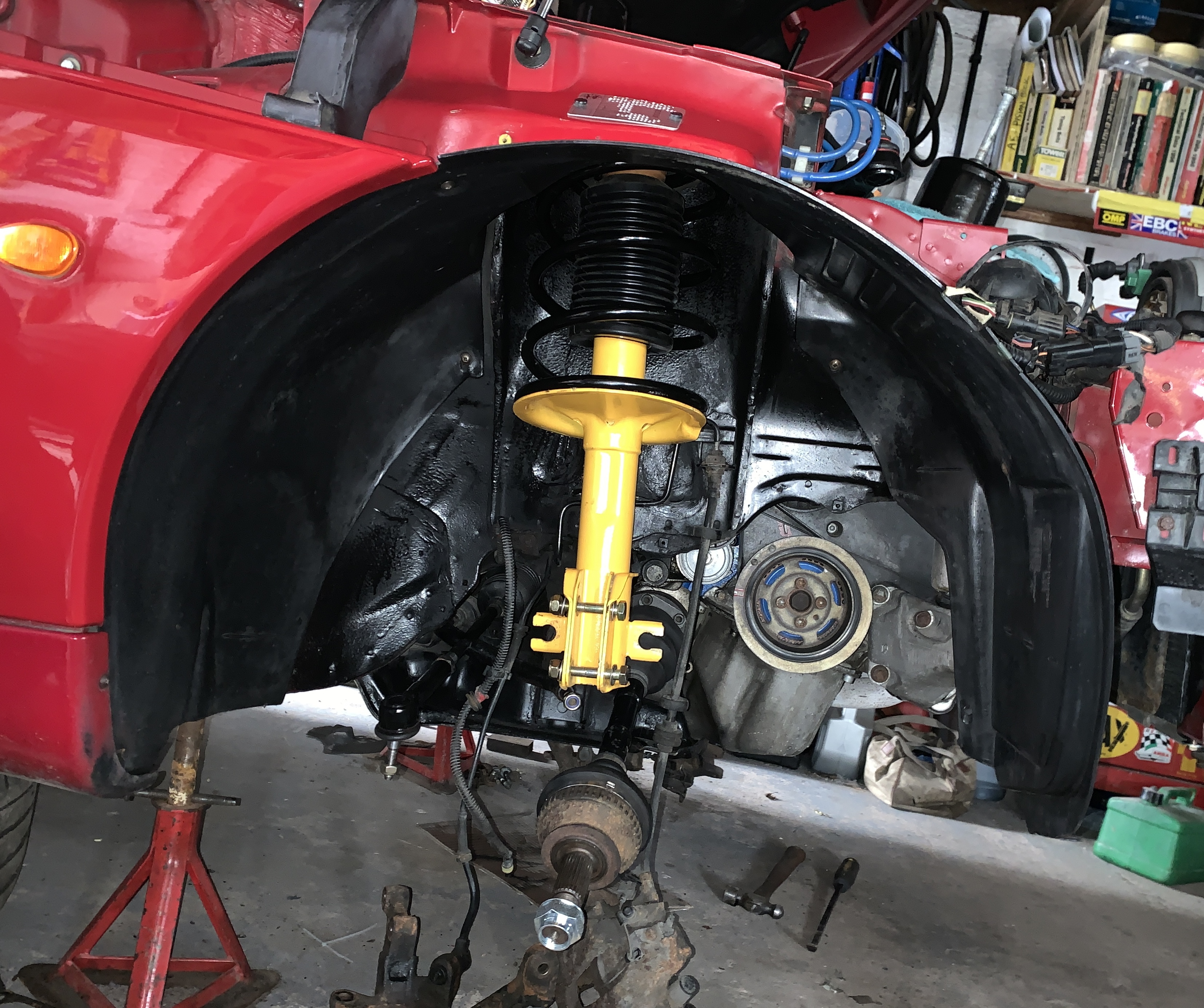

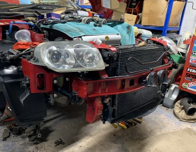

- Posts: 1756
Re: My 916 Spider

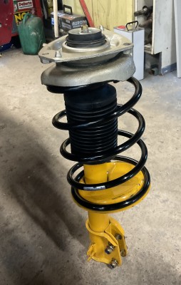

Quick update New Konis struts & springs. new gaiters have arrived from Alfashop. I Took the opportunity to repaint the front bumper irons and fitted nice new nuts. I’ve also given the front end a bit of a clean it’s all hidden when the bumpers on but that’s not the point
I’ve also dropped my spare subframe and a pile of other metal work to be Powder coated.
The usual stuff like the rad support member and the slam panel. Oh yeah and the air box bracket was crusty so that sorted aswell. That’s going to be a couple of weeks as they’re really busy. Times not an issue and I’ve still got lots to get on with.

Re: My 916 Spider
More progress. Both struts are rebuilt and now back on the car. I’ve taken the time to refresh the black paint on the inner wing(I’d prefer body coloured but as this area is black as std. I’ve just redone it). I’ve also repainted the top mountings so they don’t look quite as scruffy.
Still waiting for a call from the powder coaters to say all my bits are done hopefully by weekend. This is all taking a longer than expected due to me having a really bad attack of Sciatica down my right leg I’m struggling on but by god it’s painfulAlfasud Ti 1984
