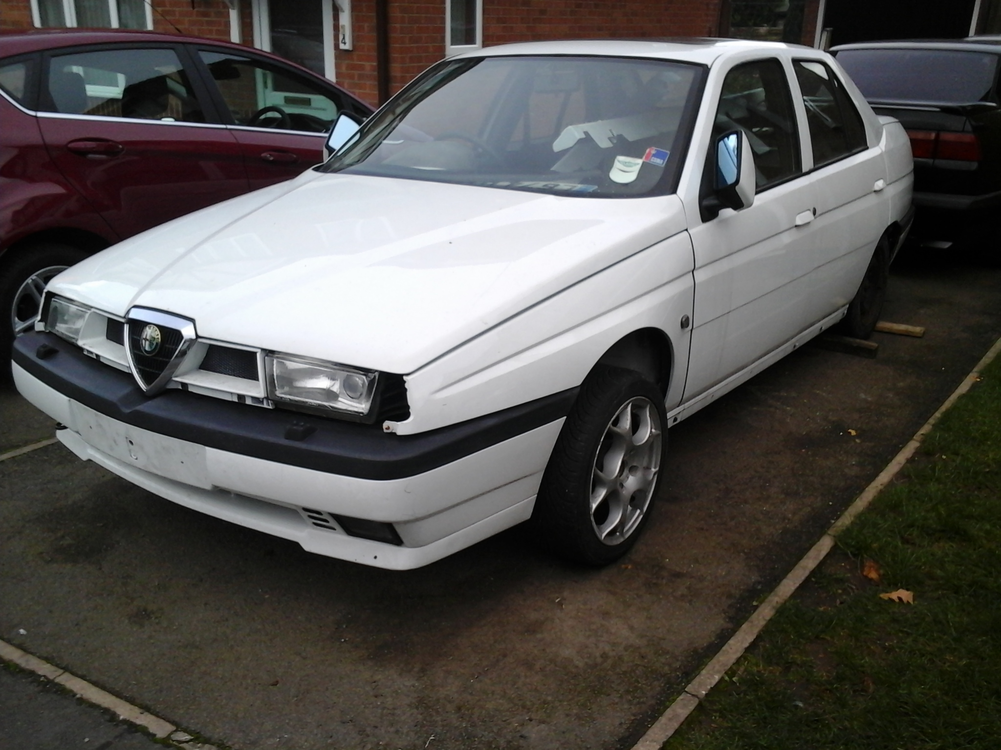

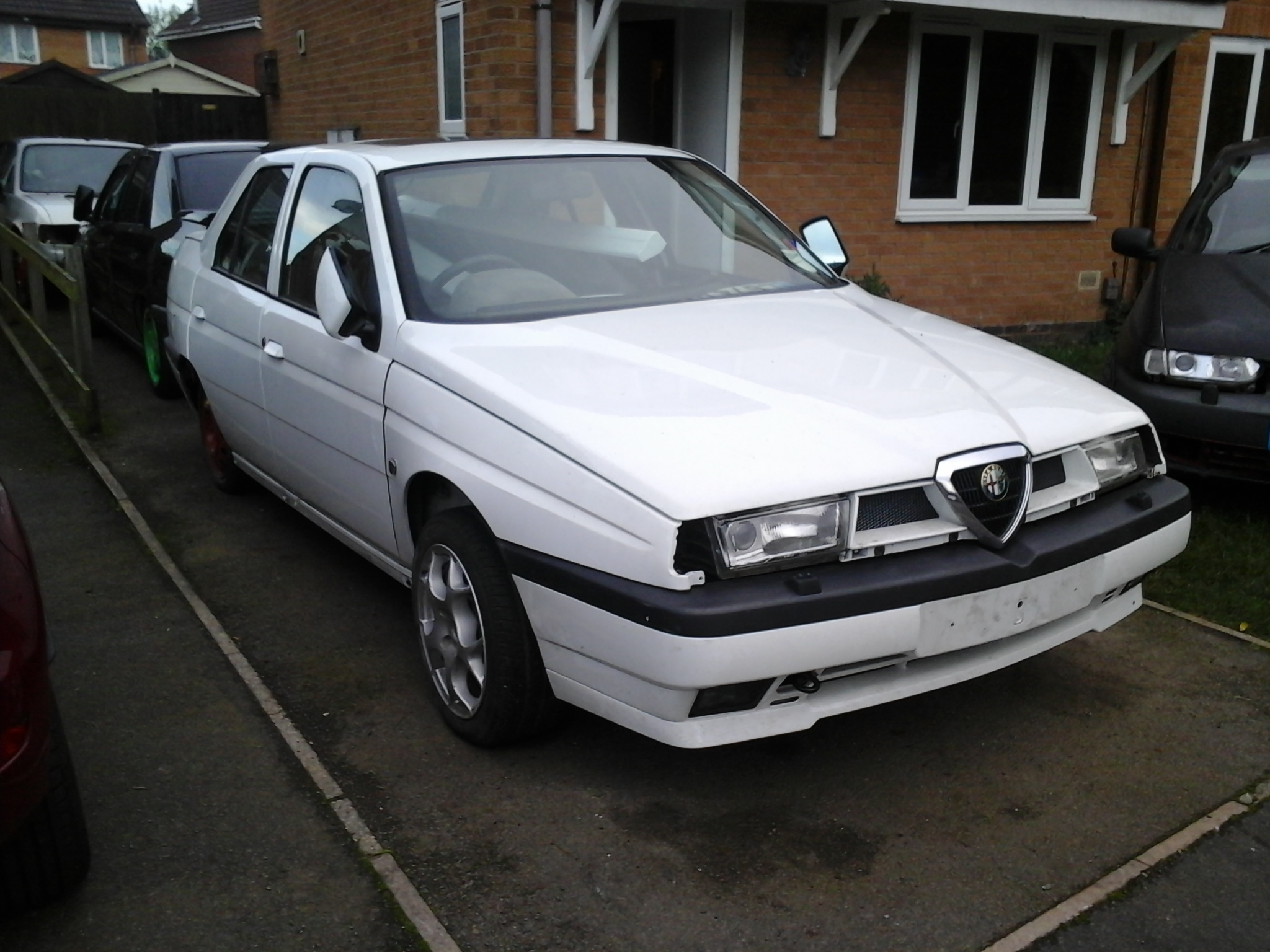

The white 155 will be getting the diesel engine from the lhd 155 diesel over the next few weeks
The shell has had all the welding done and a full respray

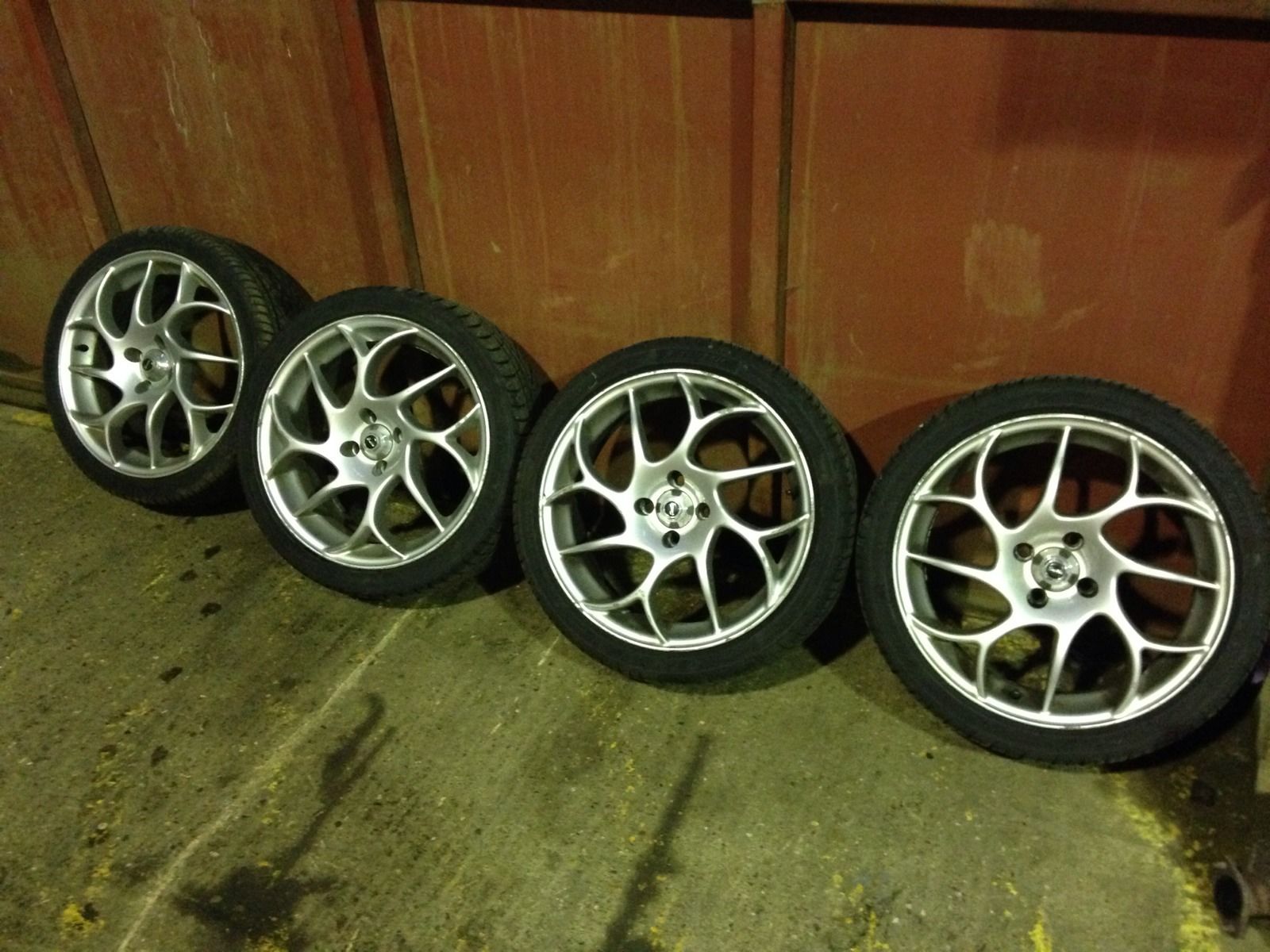

The vemons are for the girlfriend's mk1 golf cabby

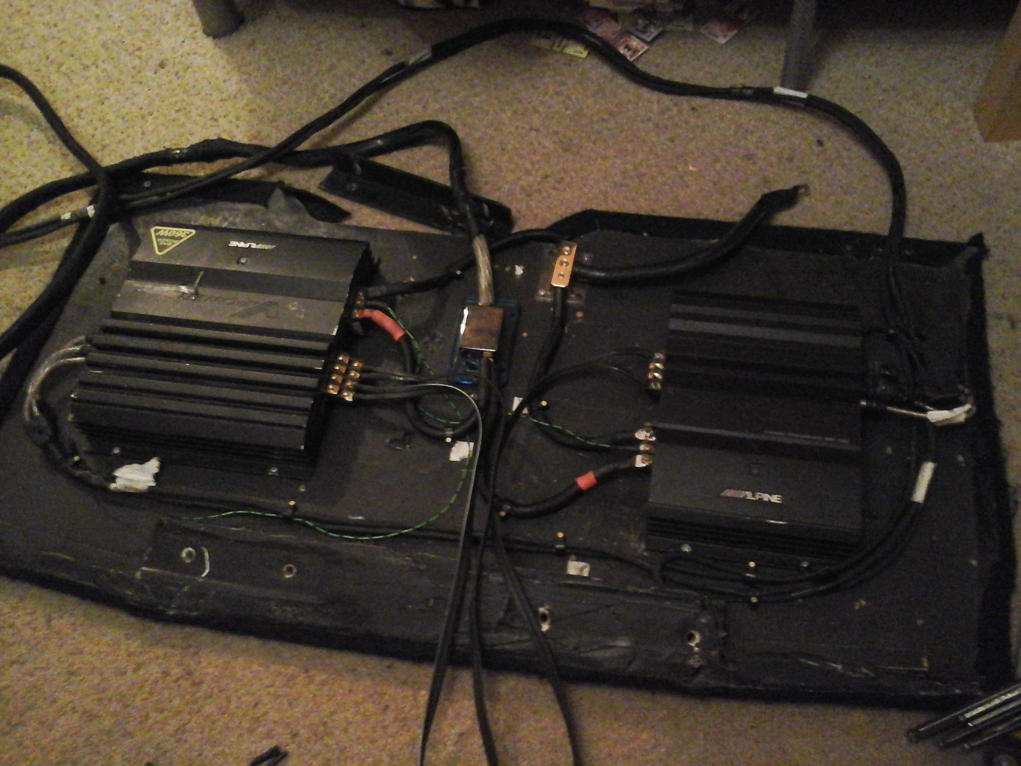

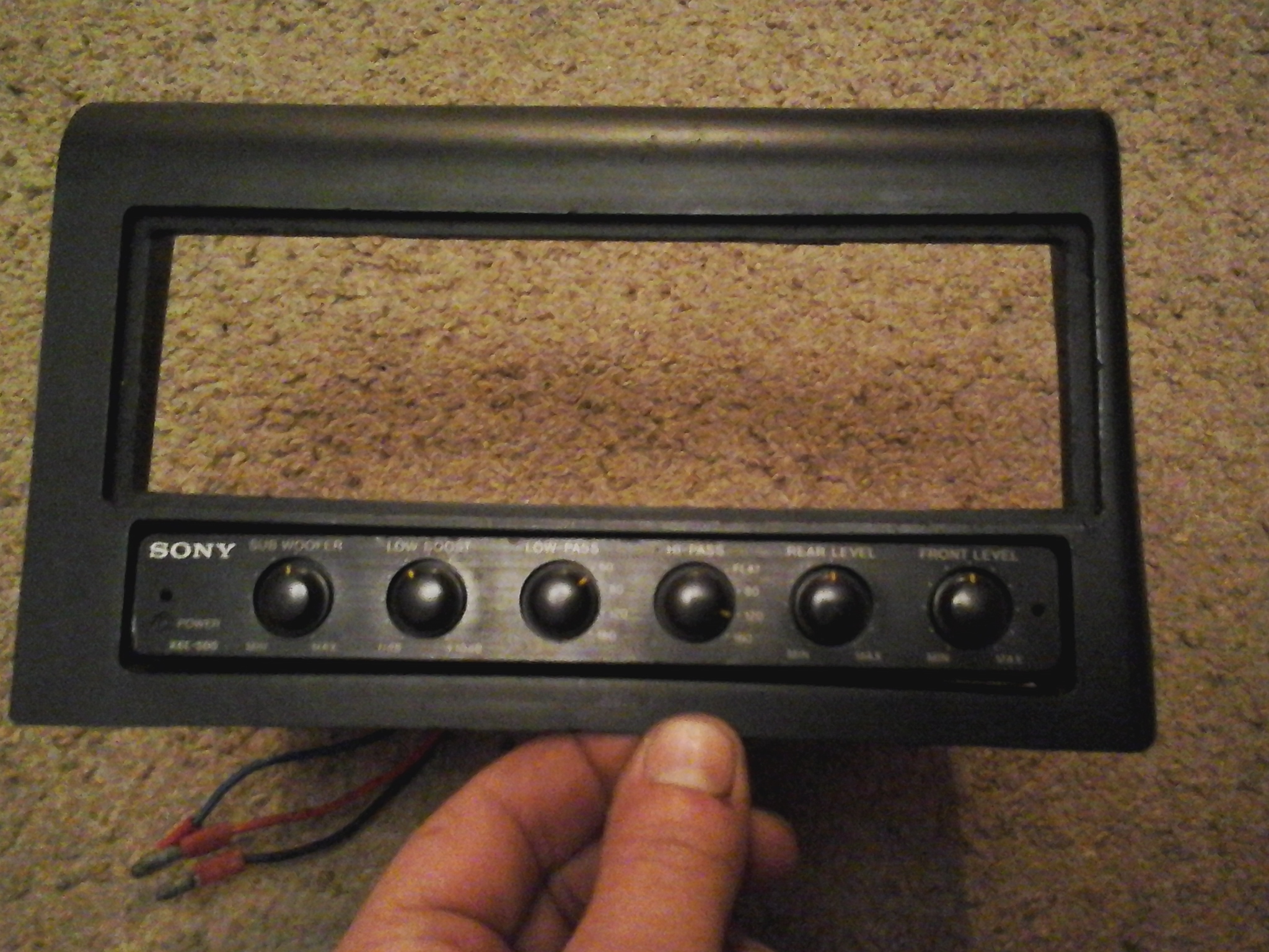

Fitted the boot lid wiring, boot carpet/sound deading, rear seat belts, inner c post trims, outer c post panel by rear screen, sony crossover into radio panel and 2 alpine amp's on a panel to go under rear shelf with wiring

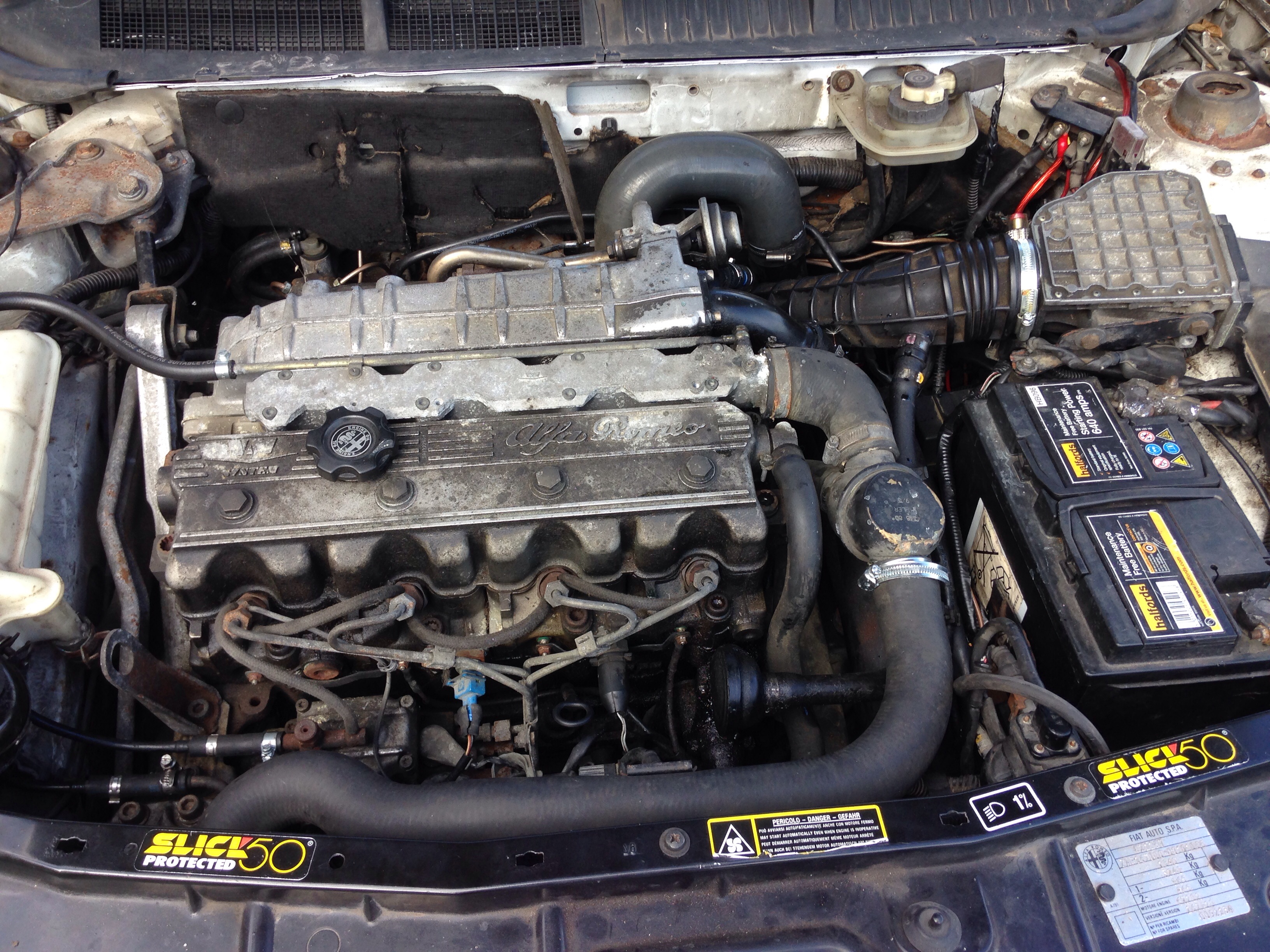

Removed the engine/gearbox from the black lhd diesel 155, fitted it into the white 155 with front shocks and brakes.
Also removed abs system as the diesel 155 didn't have it fitted

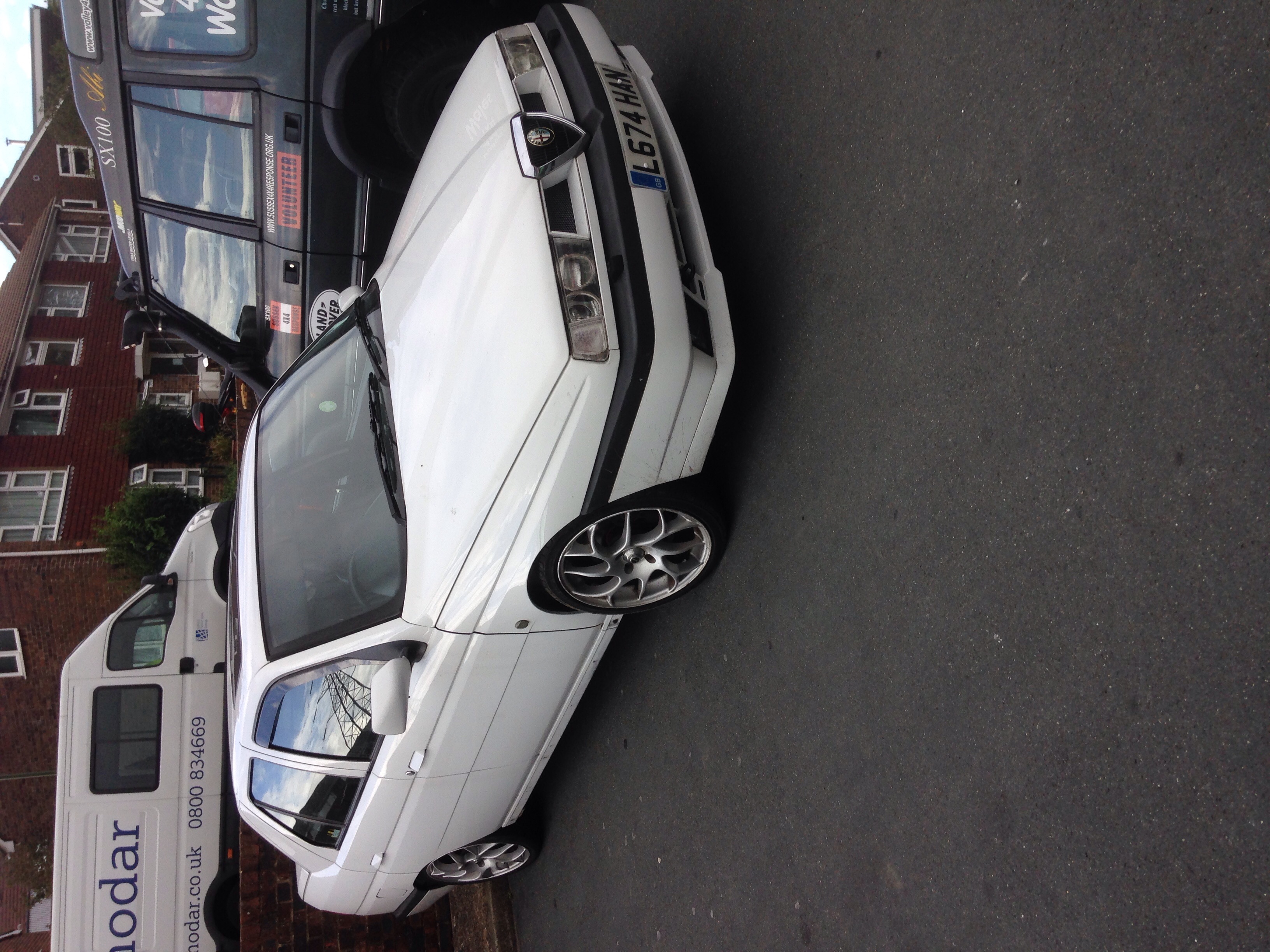

A few pics still need to fit the 145 QV side skirts
