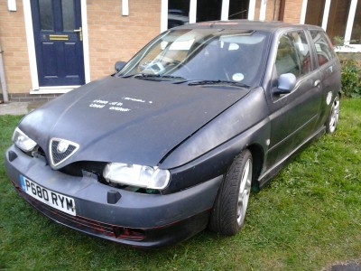

I started building this Alfa 145 with coupe 20v turbo in it for a friend as a track day car and usable on the road aswell.
We wanted a phase 1 car as their don't rust like 99/00 cars. The coupe was a non runner with gear change problems. It had no code light working on the dash which was just a fuse after replacing it the run sweet and the gear linkage was seized on the top of the gearbox.

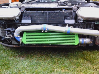

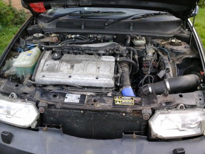

Coupe 20v turbo engine and box
K&N air filter
Fmic
Gtech 1 chip
Boost gauge
Bailey dump valve
Turbo timer

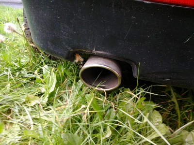

Finished the welding on the nearside this afternoon, put anti freeze in, adjust boot lock so now works on the button on the dash, fitted the nearside front inner arch and re under sealed nearside floor
Plus took some photos

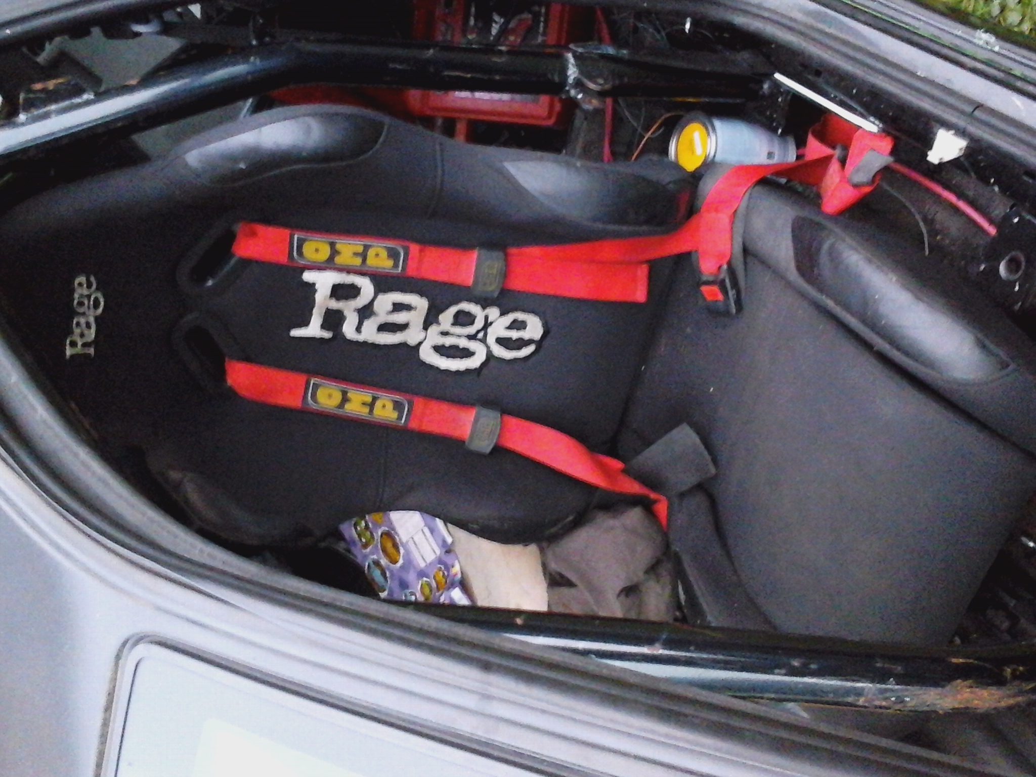

Did a few more bits today replaced the rear wiper motor, fitted nearside seat and harness

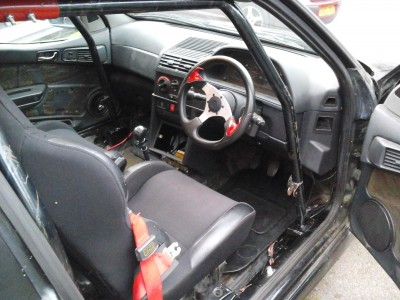

The offside floor is welded now, drivers seat is fitted, offside harness and seat belt are fitted.

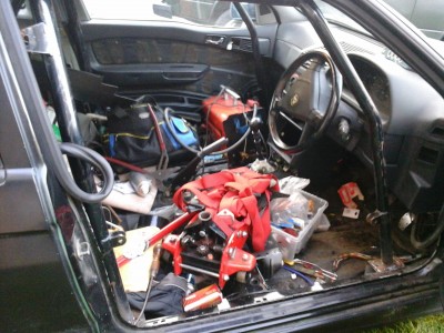

All emptied and hoovered levels checked....................mot booked for 2mor at 9.15

Fitted alfa 156 bonnet gas struts and smaller steering wheel

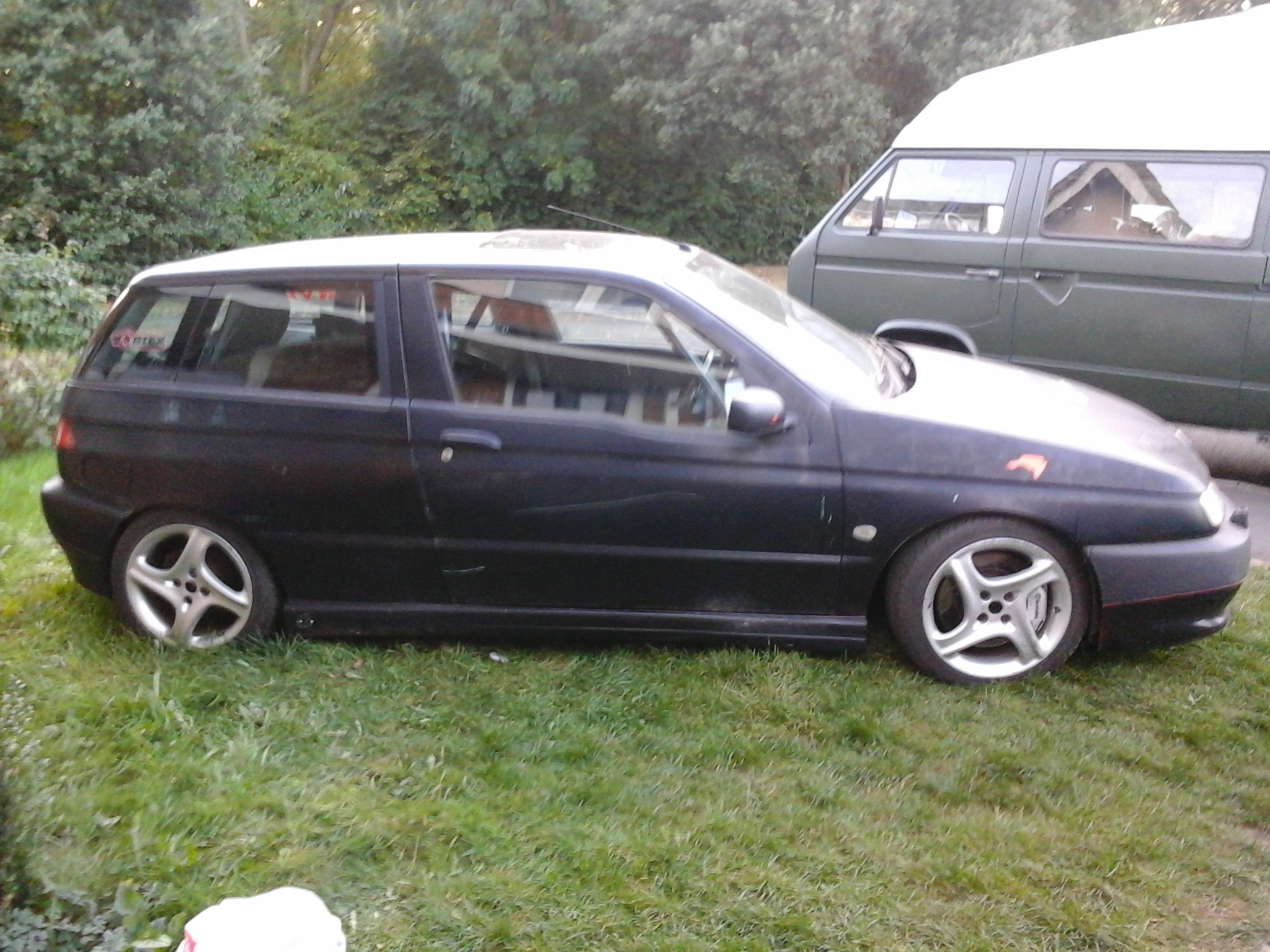

Fitted a set of wind deflectors and just keep driving it

Fitted tow bar, wired it up, got the 17" oz alloys out and put them inside the 145 ready for Monday when I go to get the tyres fitted
Re: Alfa 145 with coupe 20v turbo
Had tyres fitted and fitted them
