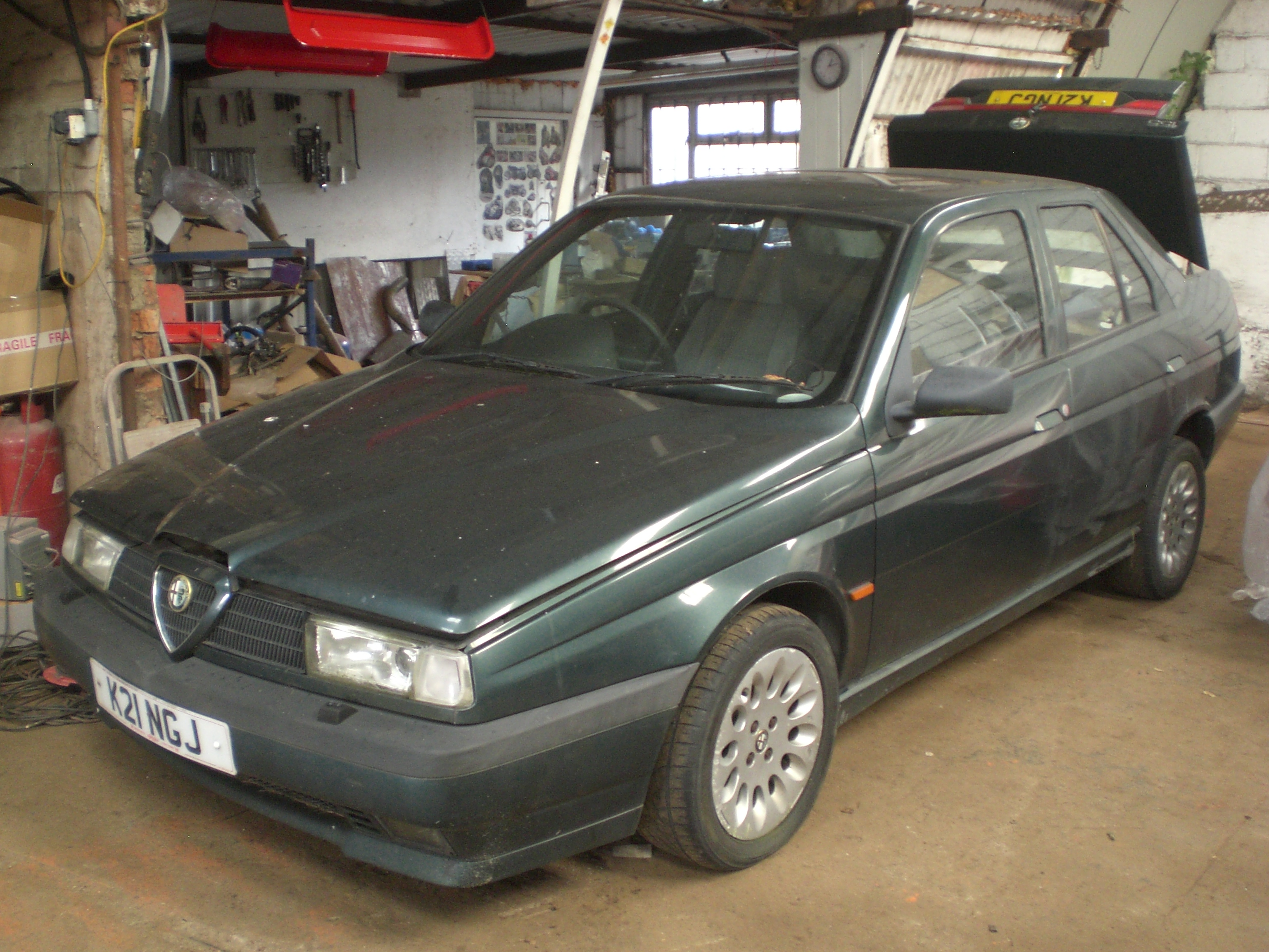

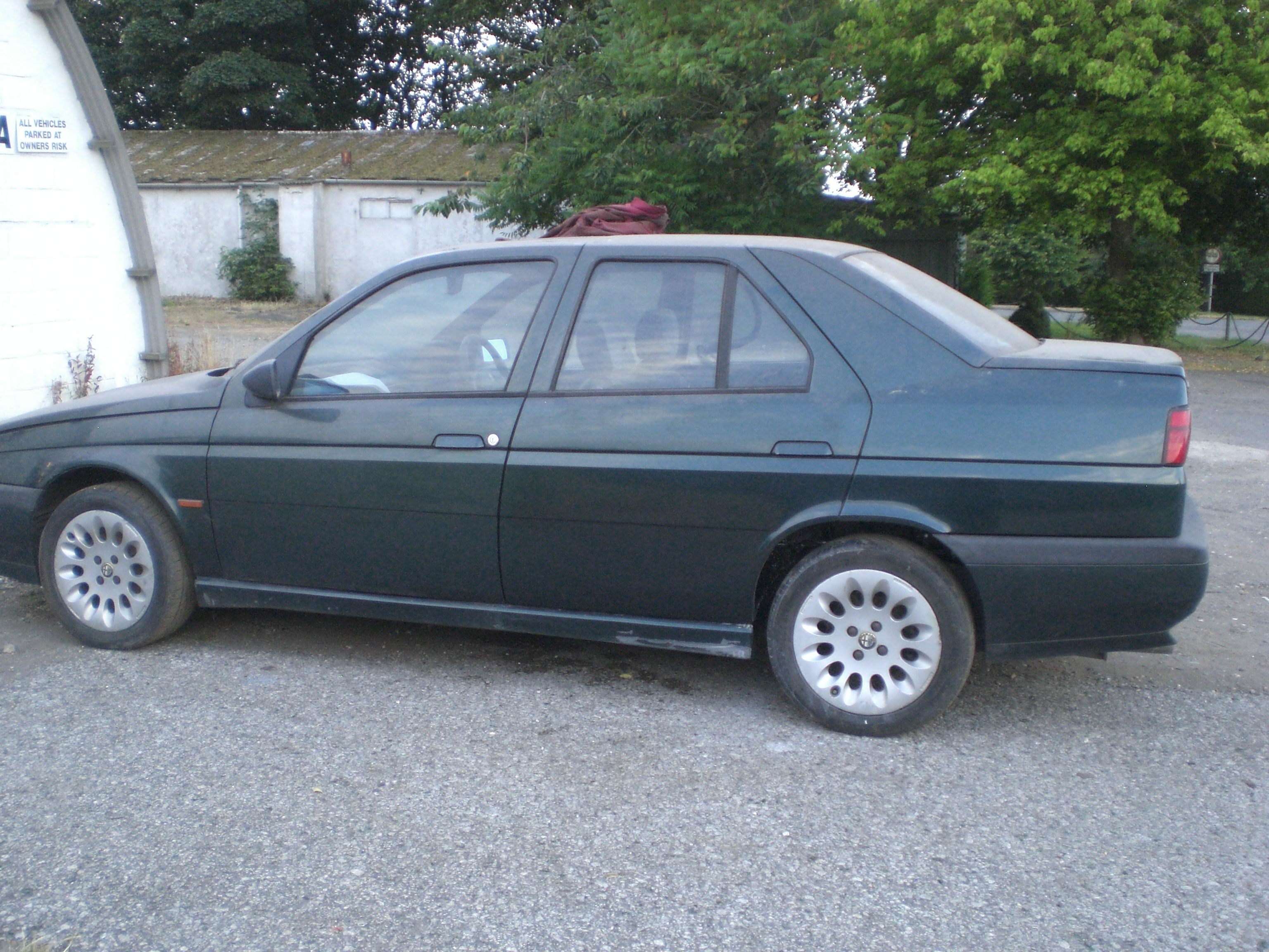

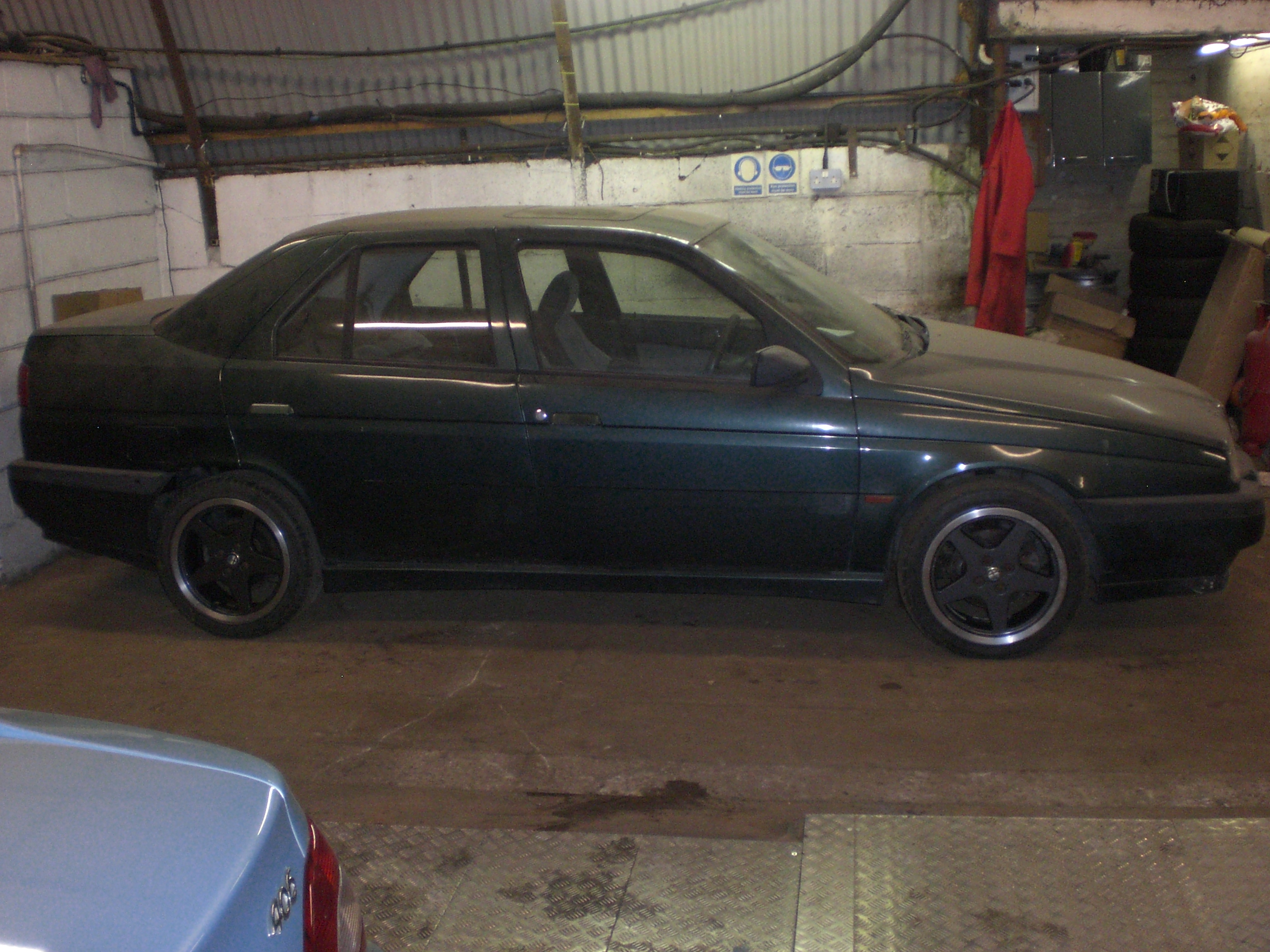

Hi all.
I got this car off Shrew a week or so back, some may recall it being offered on here a while back looking for a new owner, eventually it found me!
Deal was done as is so often the case, unseen in the flesh or even on picture so I didn't really expect too much.

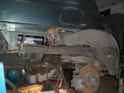

Said to be a non runner with a poorly fuel pump and some welding needed to the boot floor/inner arches.

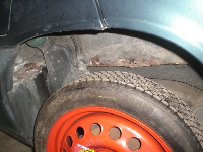

Non running is sortable so no drama, rust though I expected to see rear arches with severe bubbles if not bits missing, a lot of 155's suffer with rot in the rear arch which travels into the boot floor area. Indeed my old Lancia Dedra turbo that my friend Jim now owns had a few blisters come through that turned into a reconstruction of much of the rear end, the Dedra & 155 sharing the same arch etc, if not pretty much the whole car!
Glad to say though that on arrival on the trailer it wasn't half as bad as I imagined it would be.

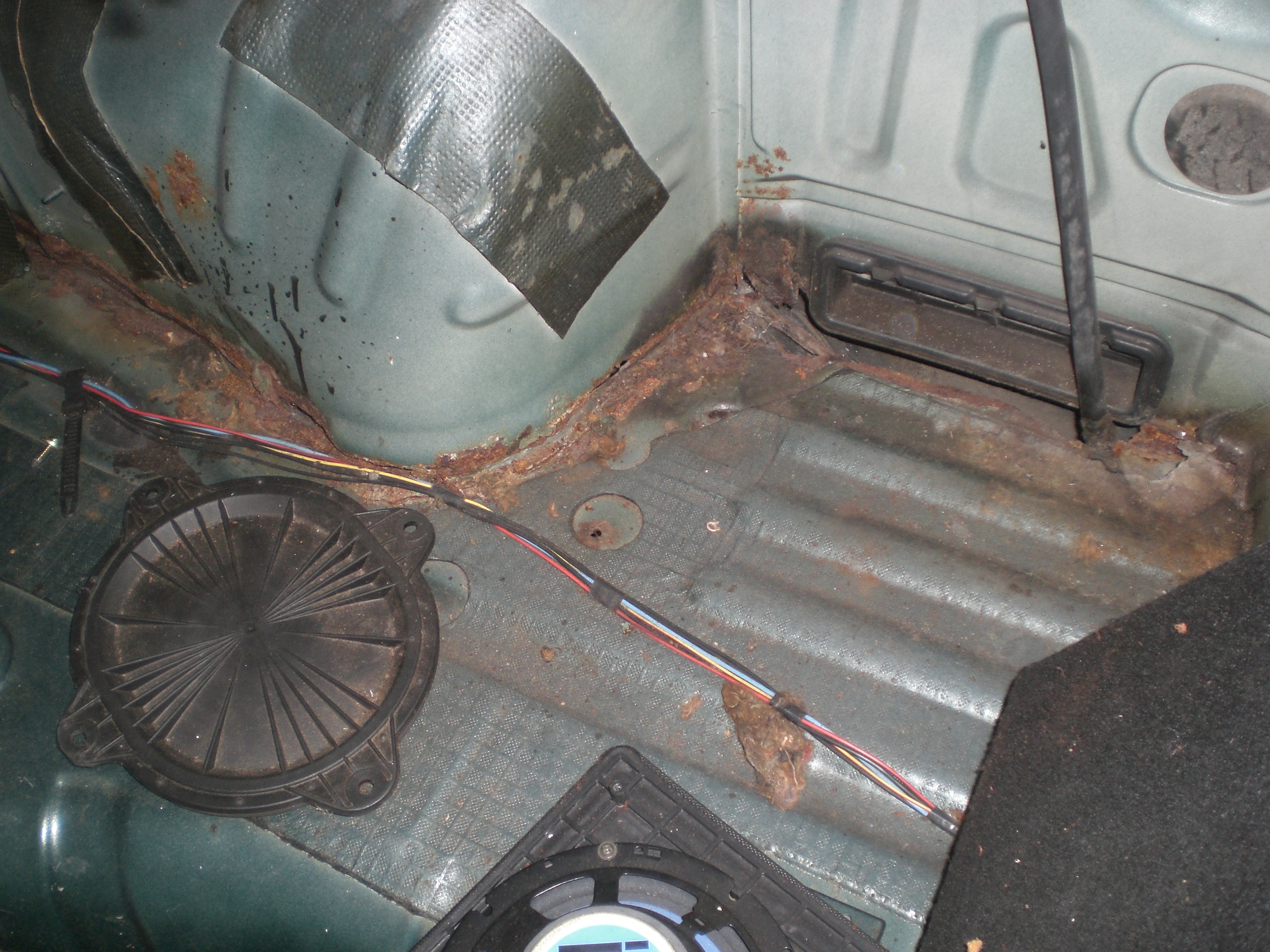

Pulling out all the bits from the boot which had already handily been removed revealed that it's not at all bad, shouldn't be too much of an issue....when I can find the time!

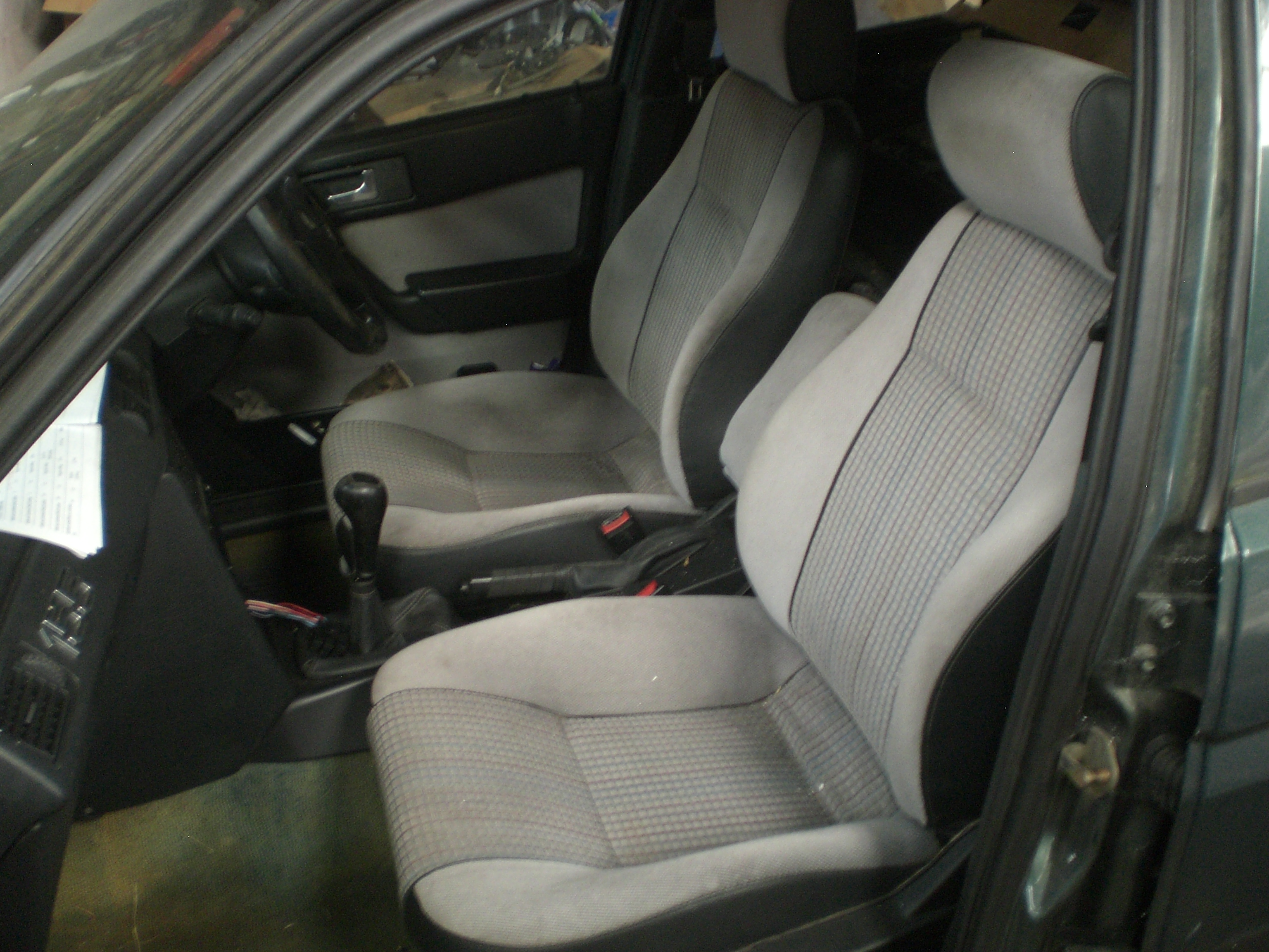

Interior in fine shape, should make a nice car.

Managed to find some time on Saturday evening to have a look at the pump issue. No electricity reaching it so a fiddle with the pump relay, fuses and ECU connections restored power. Happy to report that after a bit of spluutering it fired into life
Quickly followed by being turned off as a nice mist of fuel was making the back of the engine pretty damp from a leaky return pipe!
Inside the arch doesn't look too bad, most of that holed part will be chopped out when the time comes, just will be a while before it does come around to it!

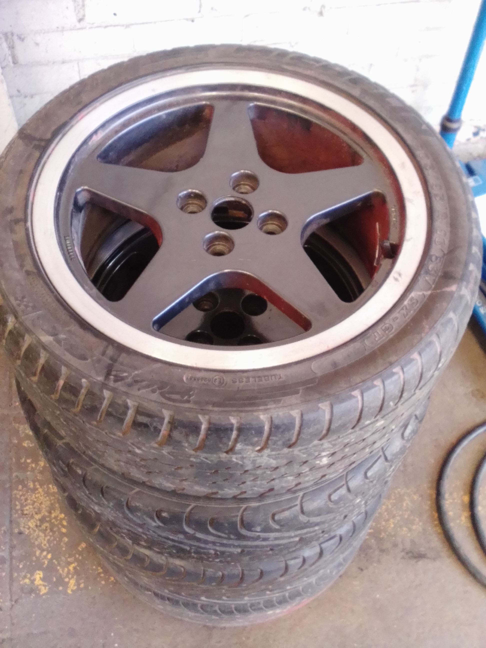

The wheels look rather retro with that tyre tread. Will make the steering sharp and reduce road noise !

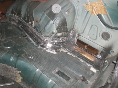

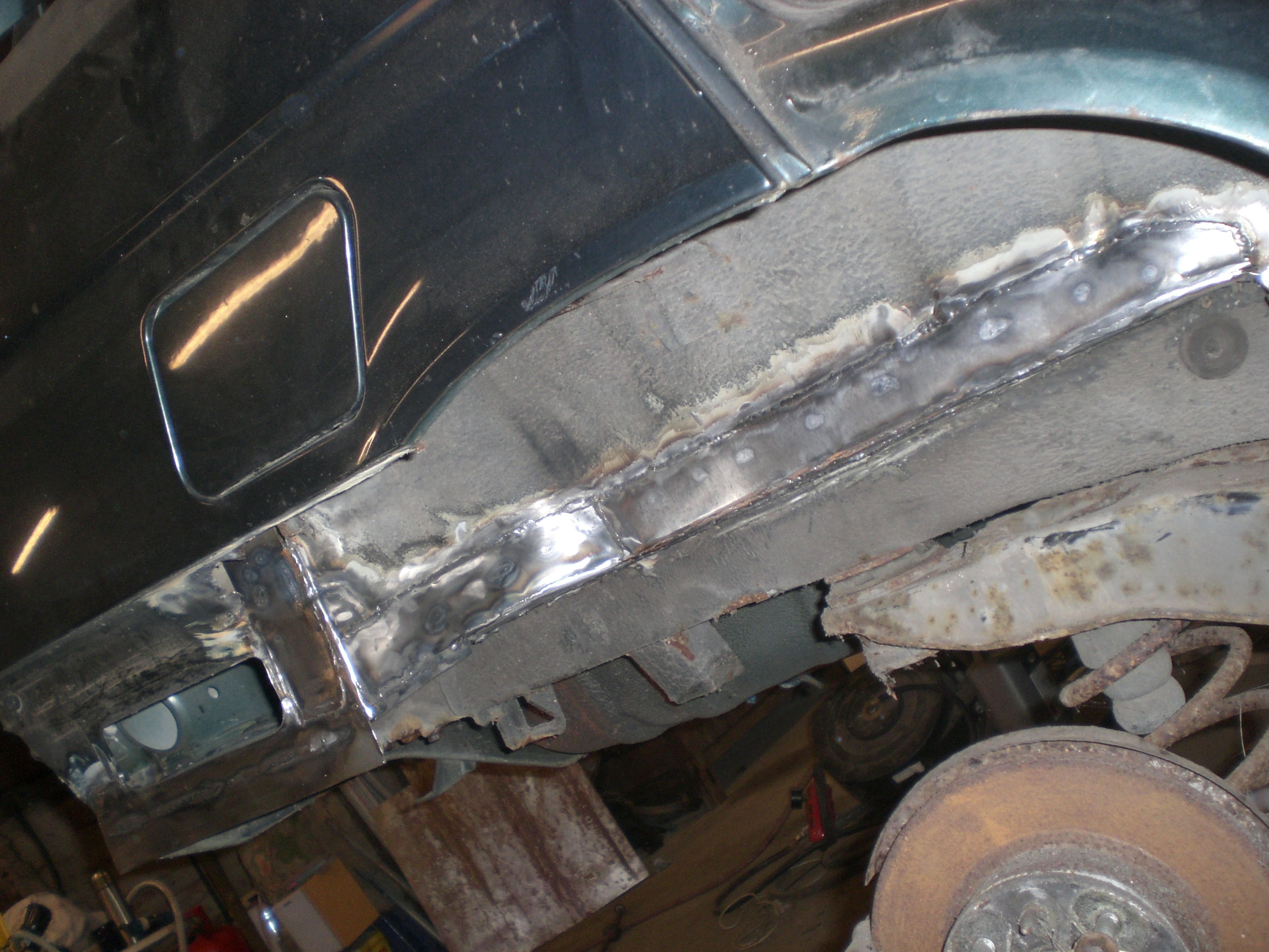

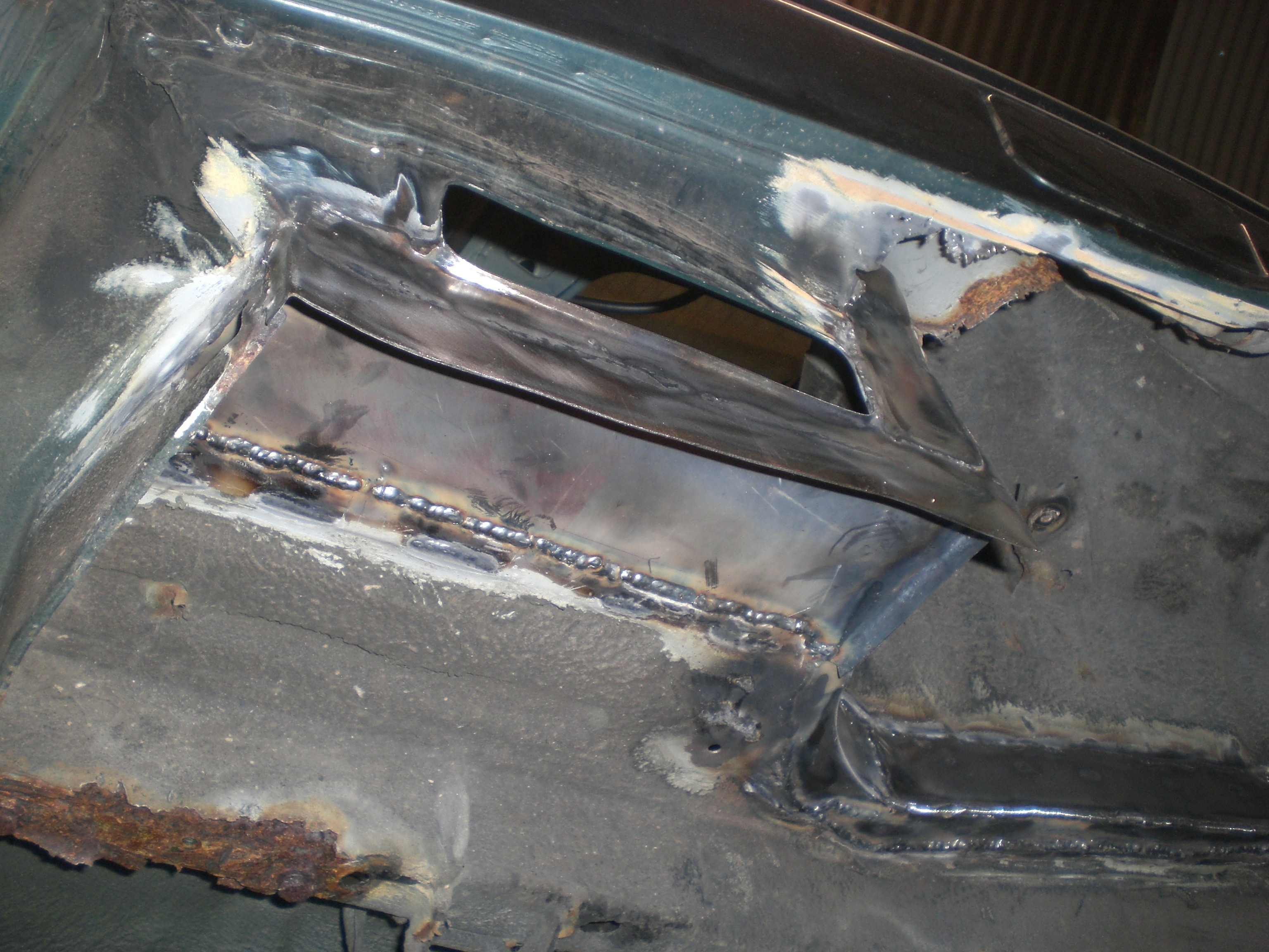

Been waiting for some time to tackle the rust on the 155, this afternoon I got chance to make a start.
Passenger side got the vote to be tackled first, rot wasn't evident all the way along to start with, until a bit of digging showed corroded seams all the way to the seat belt anchorage so the grinder soon made a nice wide channel to fresh steel.
Boot bit didn't go too far over towards the middle so quite a simple thing to repair.
Just got to make up some bumper mounts, not unlike the integrale ones funnily enough, plus box in the lower portion of the rear quarter, where all the water has been getting in and causing all the issues!
Aiming for this to be a quick repair, simple plates, primed/seam sealed then stoneguard and some paint. Nothing more drastic.

Passenger side about done now, solid mount made for the side bumper mount to slide into, very similar set up to the integrale so feels familiar!
Had to repair the inner arch up to the door shut, seams had come away leaving a nice gap where the water had got in, causing all the rot.

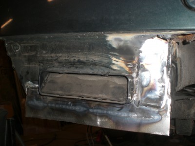

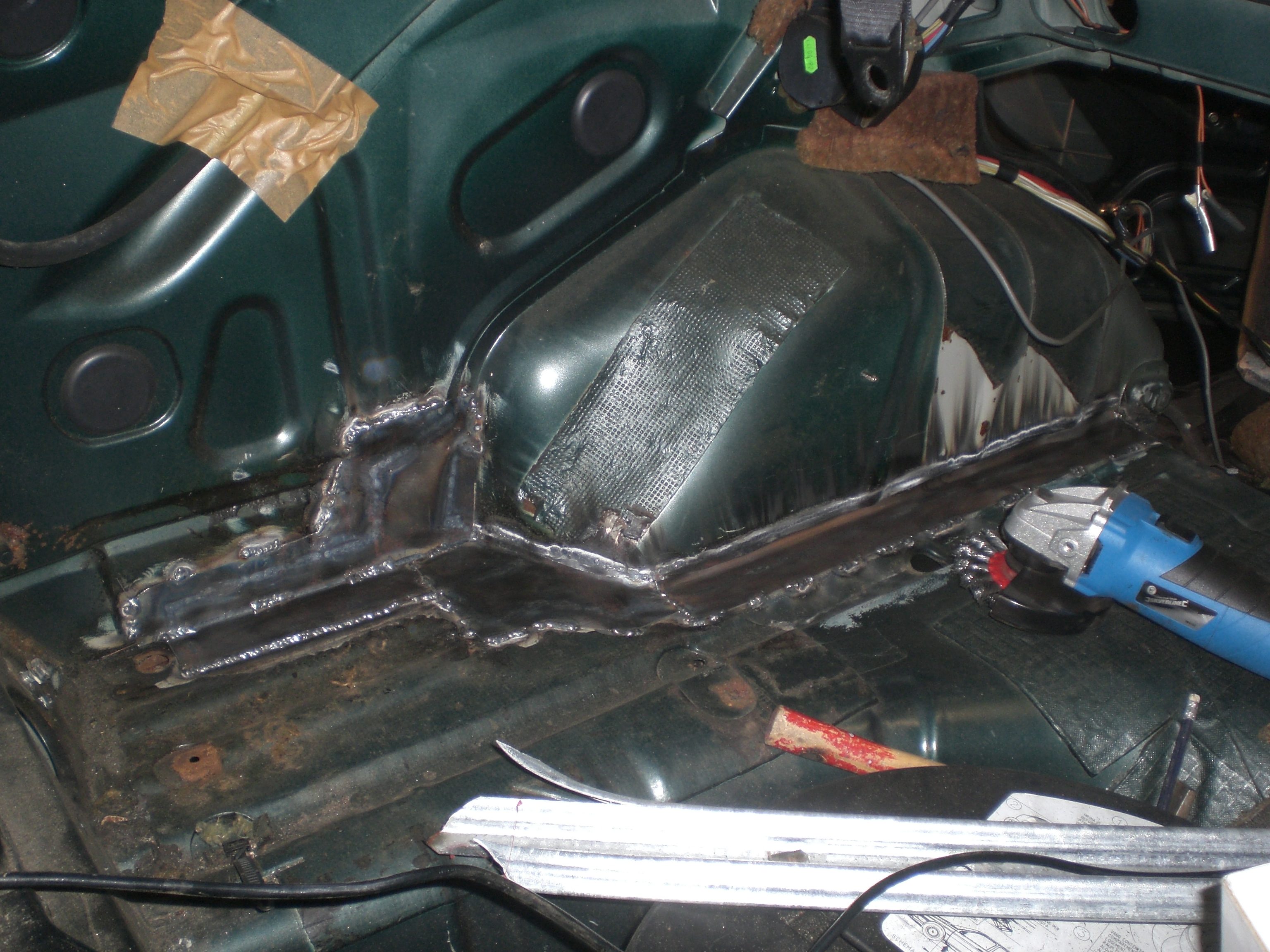

New years day so up to do some more welding
drivers side had more rot really than the passenger side, also complications of the filler neck and side vent to get around
rot didn't go too far back luckily enough, gladly it's soon solid metal so welding isn't like trying to stitch a wet paper bag!
first job was at the back end to make a plate for the boot floor
then the job to make the opening for the side vent complete with rolled flange so the clips get the correct purchase to hold the vent in place

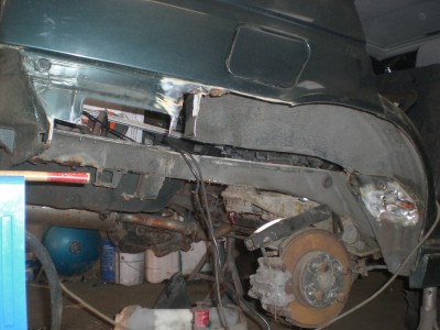

section to the inner arch was next, boot floor needed extending out too as the gap was too wide
section at the front near the seat belt mount needs chopping out then the outer arch will get boxed in along with the back of the filler neck hole. last job to make up a bumper mount.

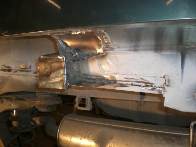

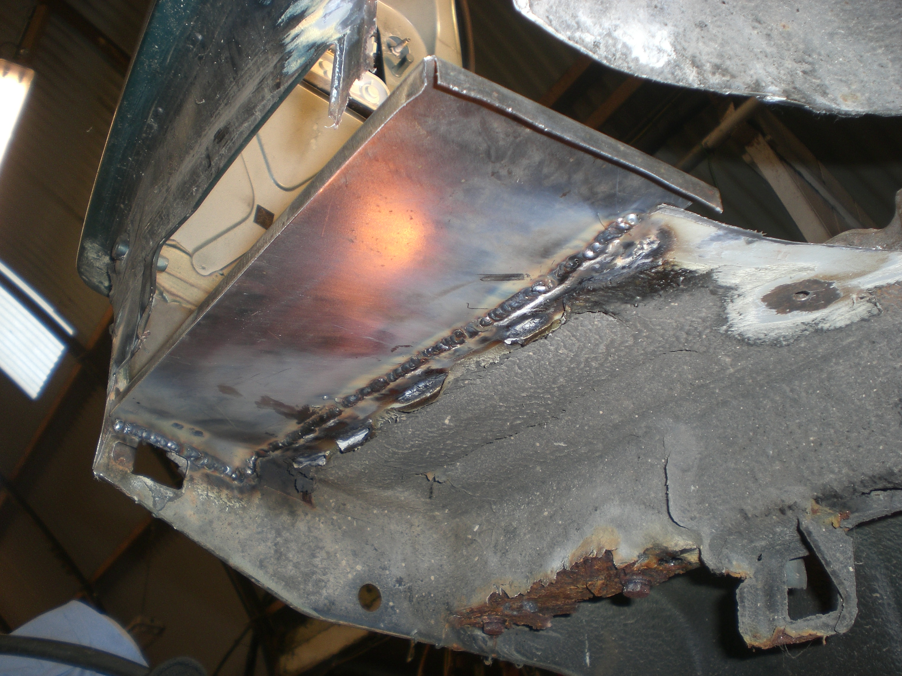

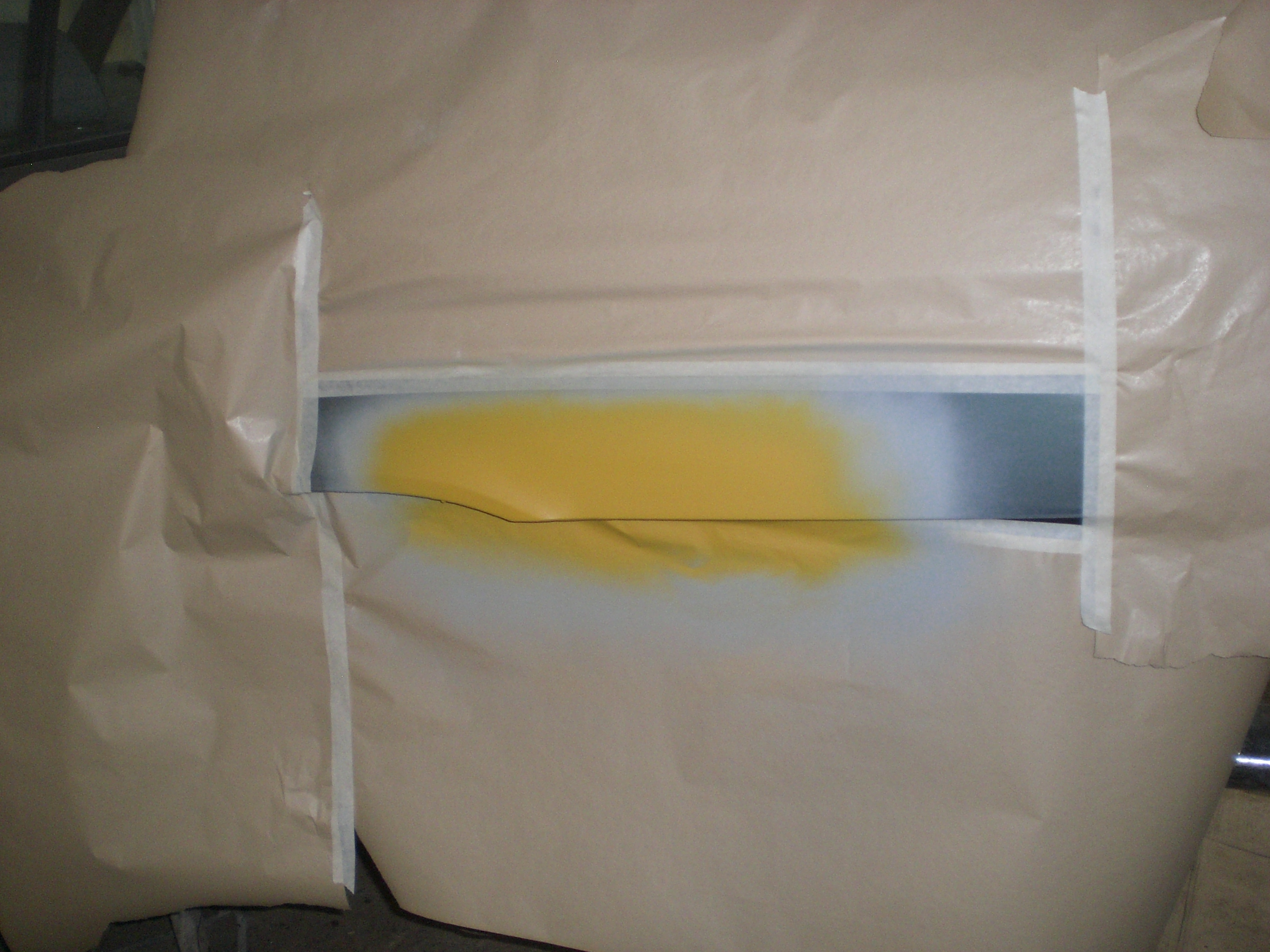

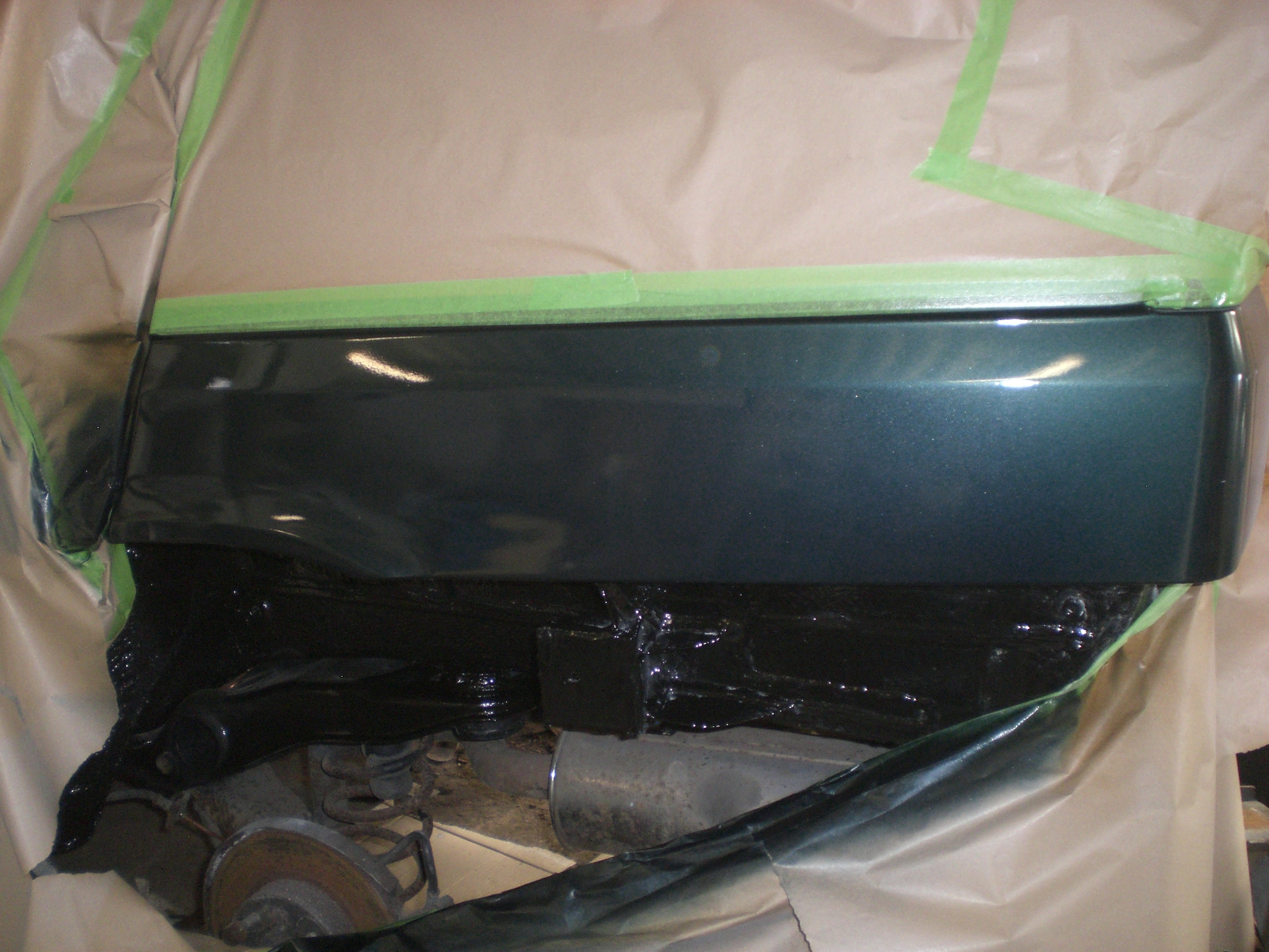

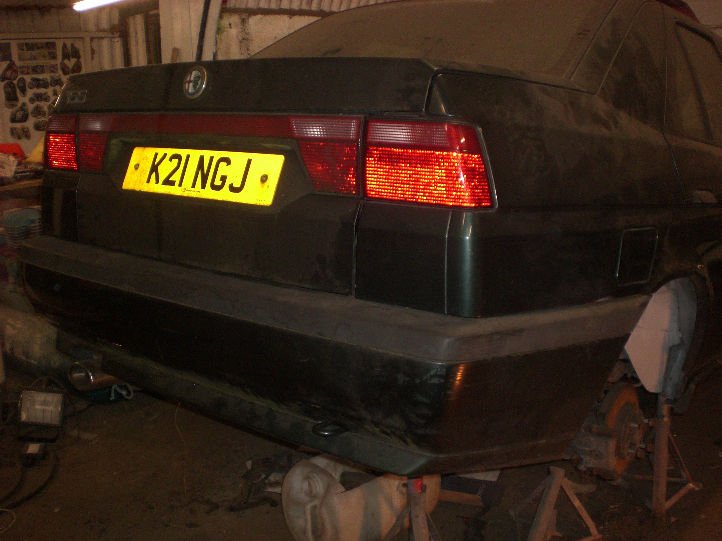

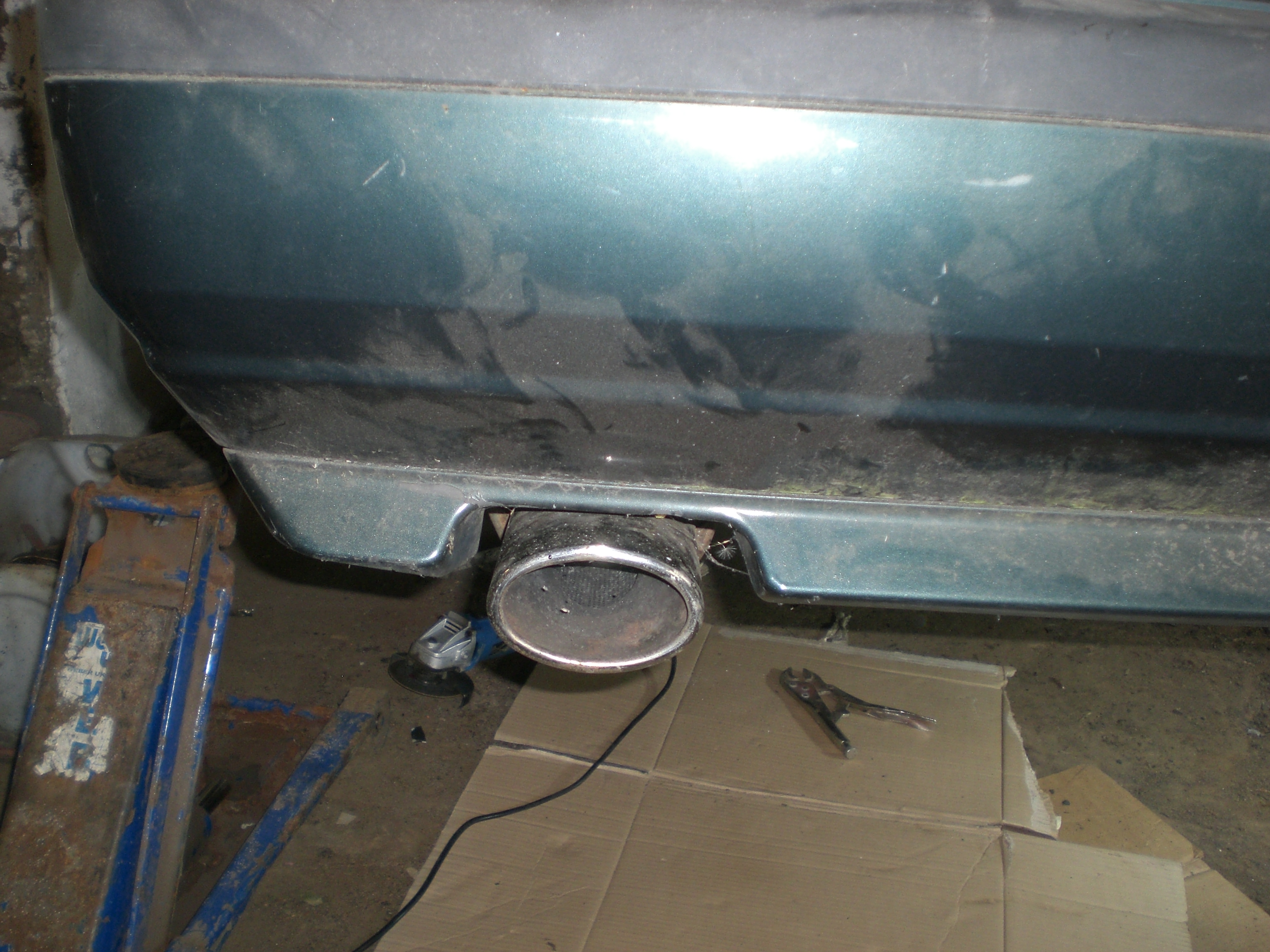

Finally got around to welding the tow bracket back to the chassis rail, after repairing the chassis rail!
All welding done on it now, at least the rear end, assuming nothing nearer the front!
Bumper fits well now, all holes sorted and adjusters work to find the sweet spot for aligning.

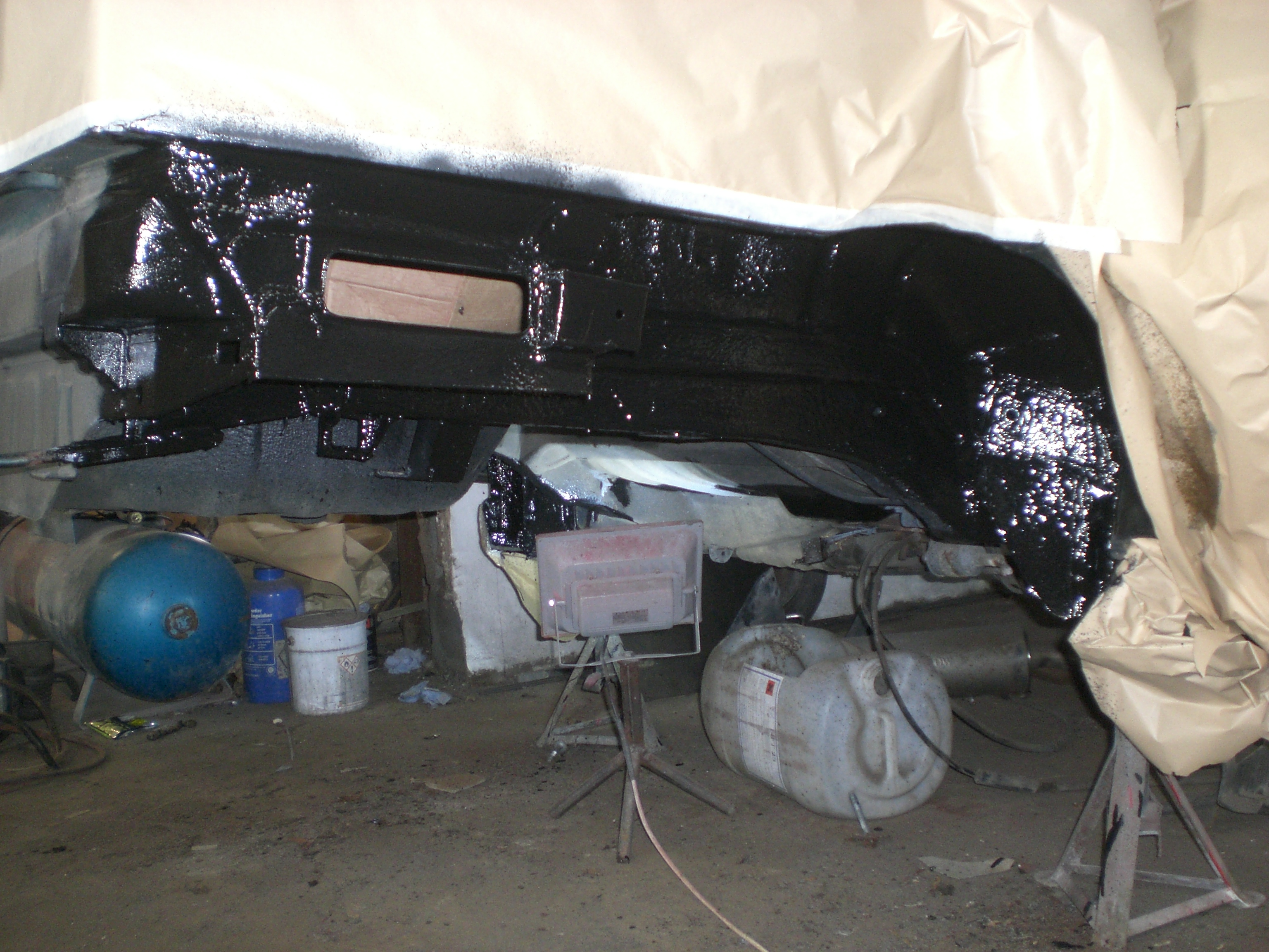

Seam sealed all the welds tonight so next week I'll get some stoneguard on it all then paint it the week after.
Can then refit the fuel tank and get it mobile again.

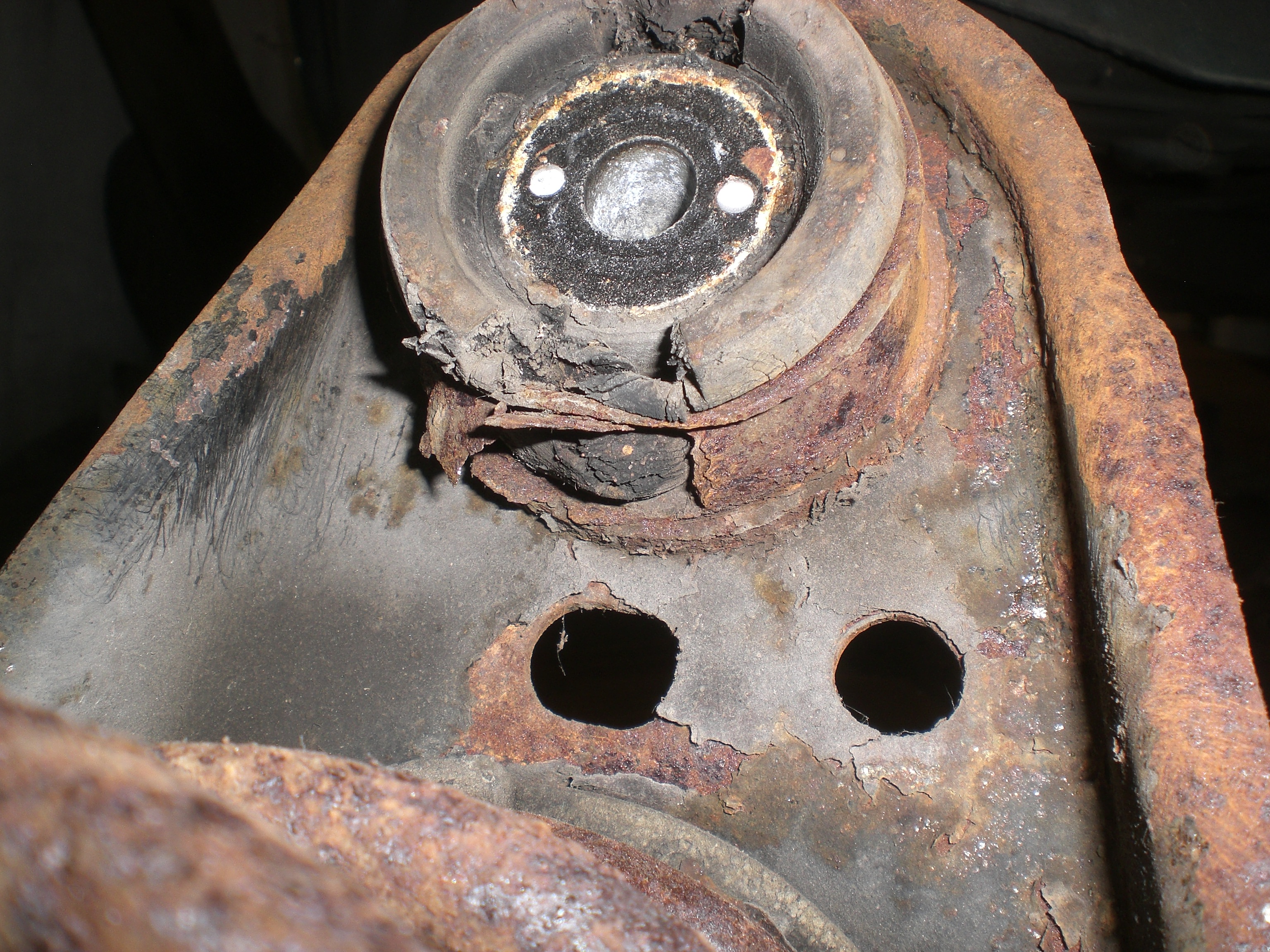

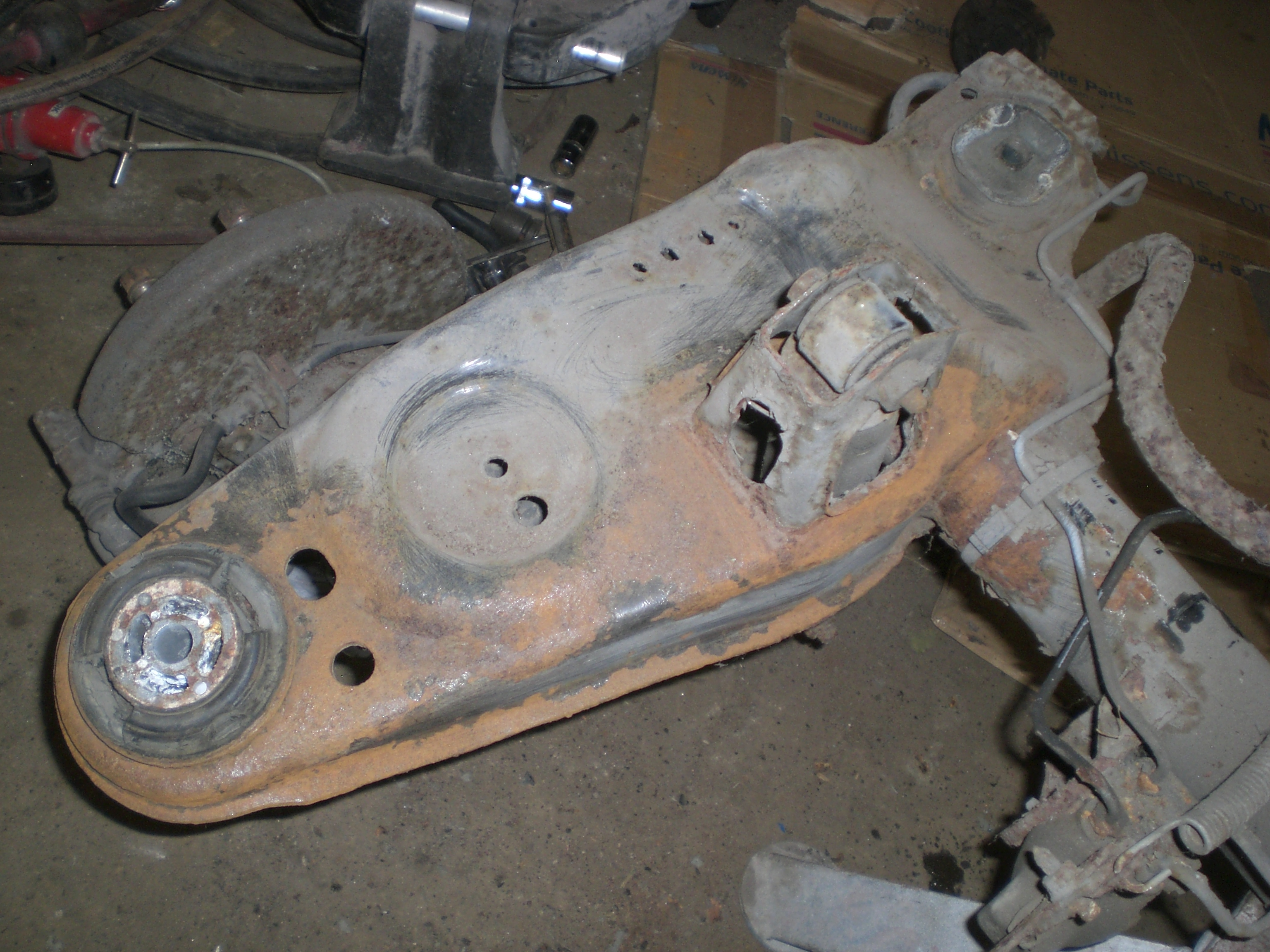

with everything going on I've neglected the 155 a bit, seems it was back in Feb that I last did anything....
so with a couple of hours spare tonight I set about making myself more work
there is a patch of rust on the rear subframe that needed welding, I could have done it in situ but I then spotted an other bit further around which wouldn't have been so easy.
as the tank is out it's only the hand-brake cables and pipes to disconnect then 4 bolts and the whole thing comes down, seems childish not to attend to it whilst access so easy
the rest of the frame just has surface rust so i'll clean it, treat it then soak it in waxoyl once I've replaced all the brake pipes
need to get the car mobile again, it's sat on stands for too long...

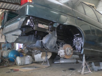

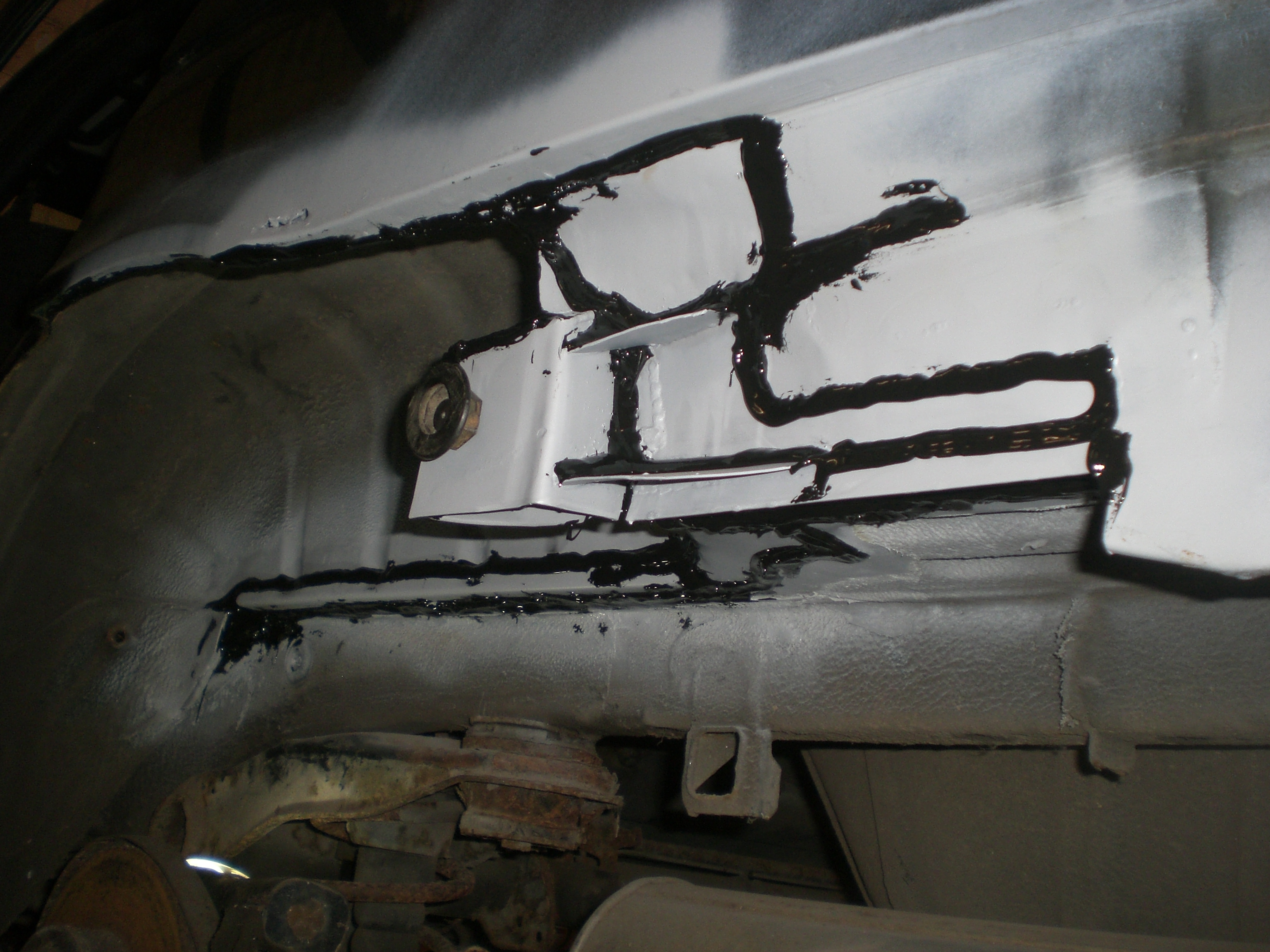

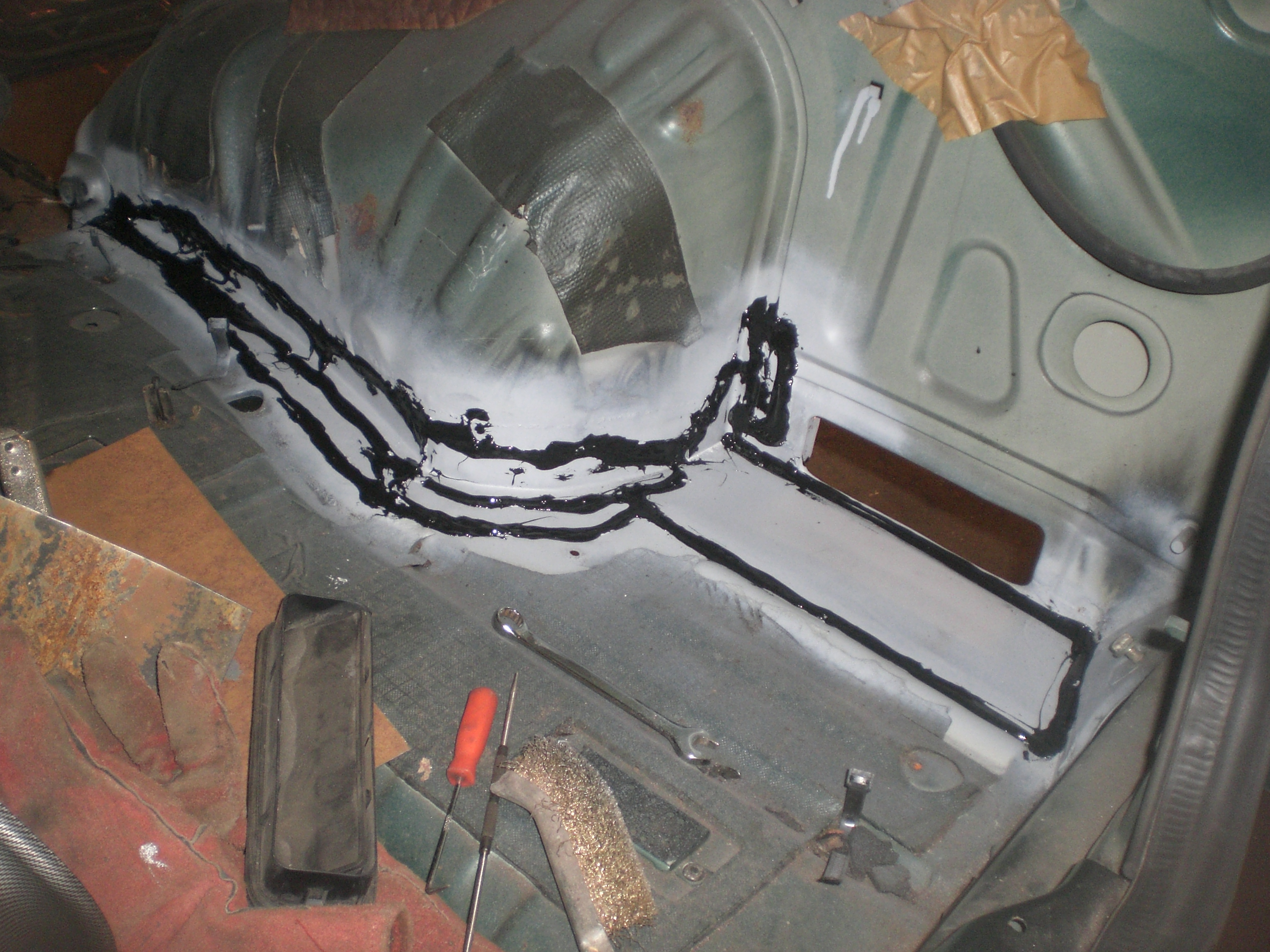

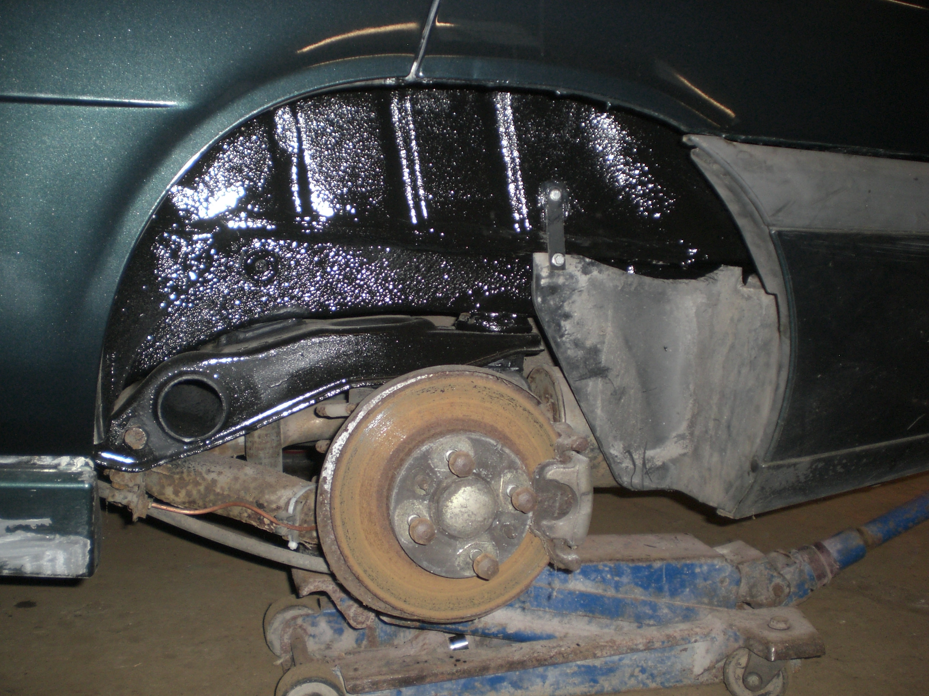

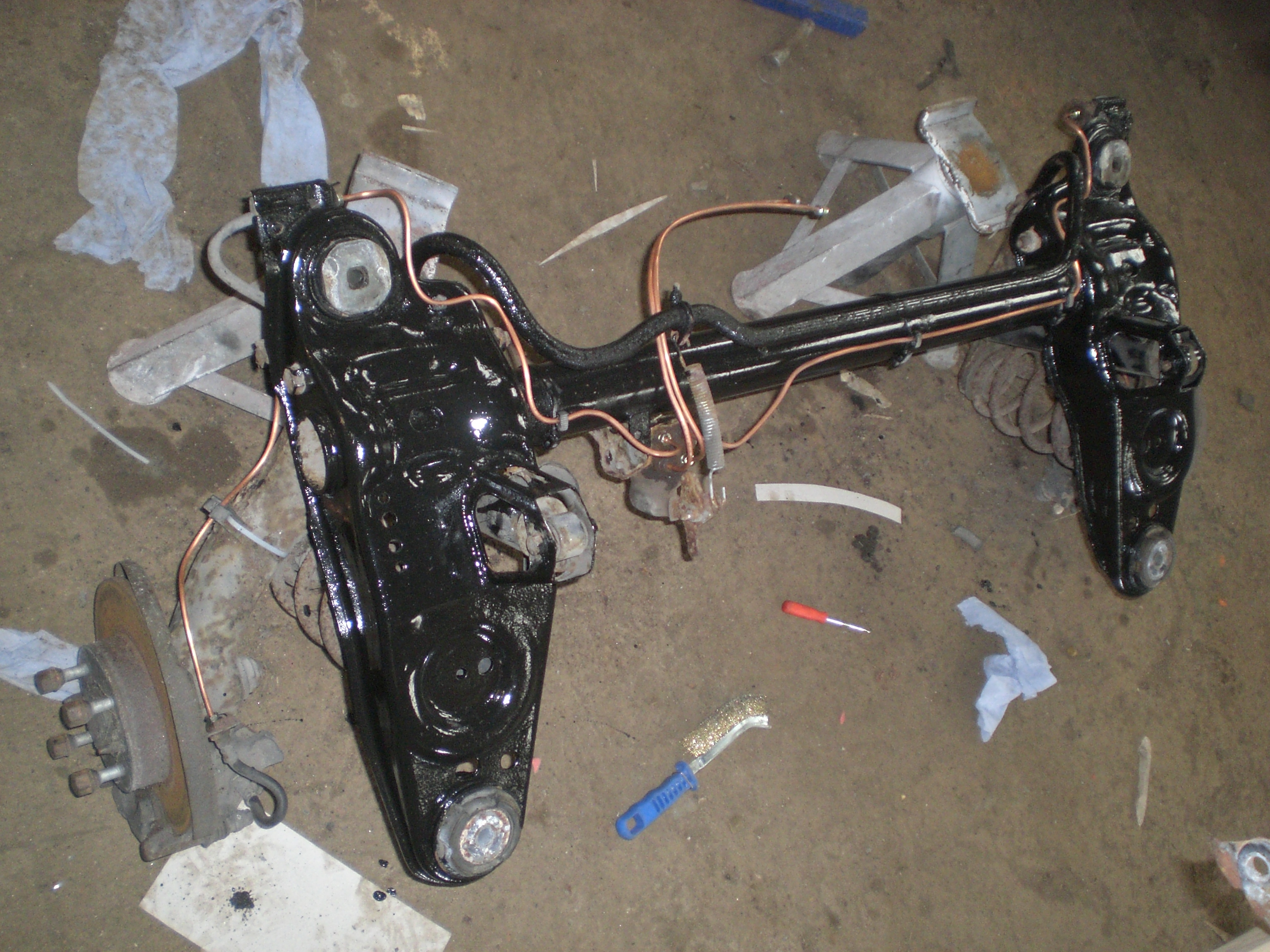

I welded up the rear subframe mount at the weekend then gave it a coat of paint.
Got all the new brake pipes fitted today..

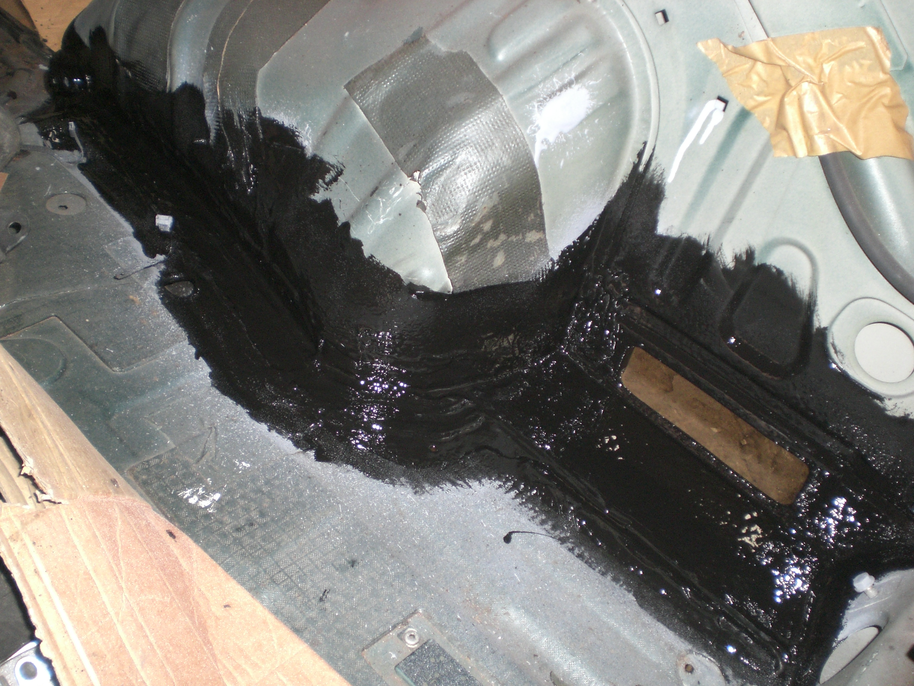

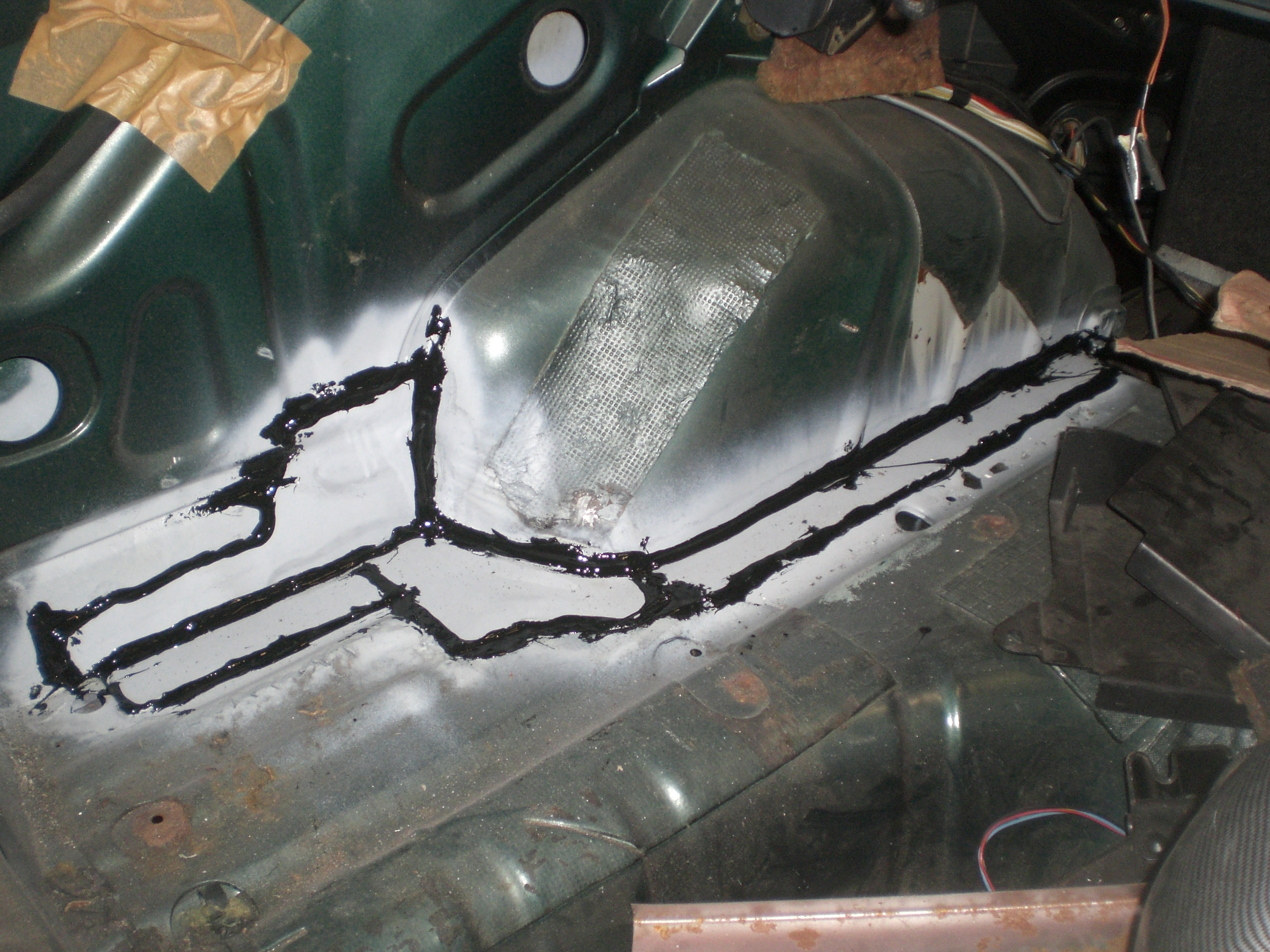

The rear inner arches I'd stoneguarded last week, now that has all dried off nicely and I've found time I brush painted all the arches and the parts I welded earlier in the year. This enamel paint is easy to slap on with a 50mm brush and allows a really good layer to go on, as well as over yourself!
As you can see I have also given the inner repairs a good dose of the black paint too, all the better for keeping moisture at bay.
One more step closer to another one being done...

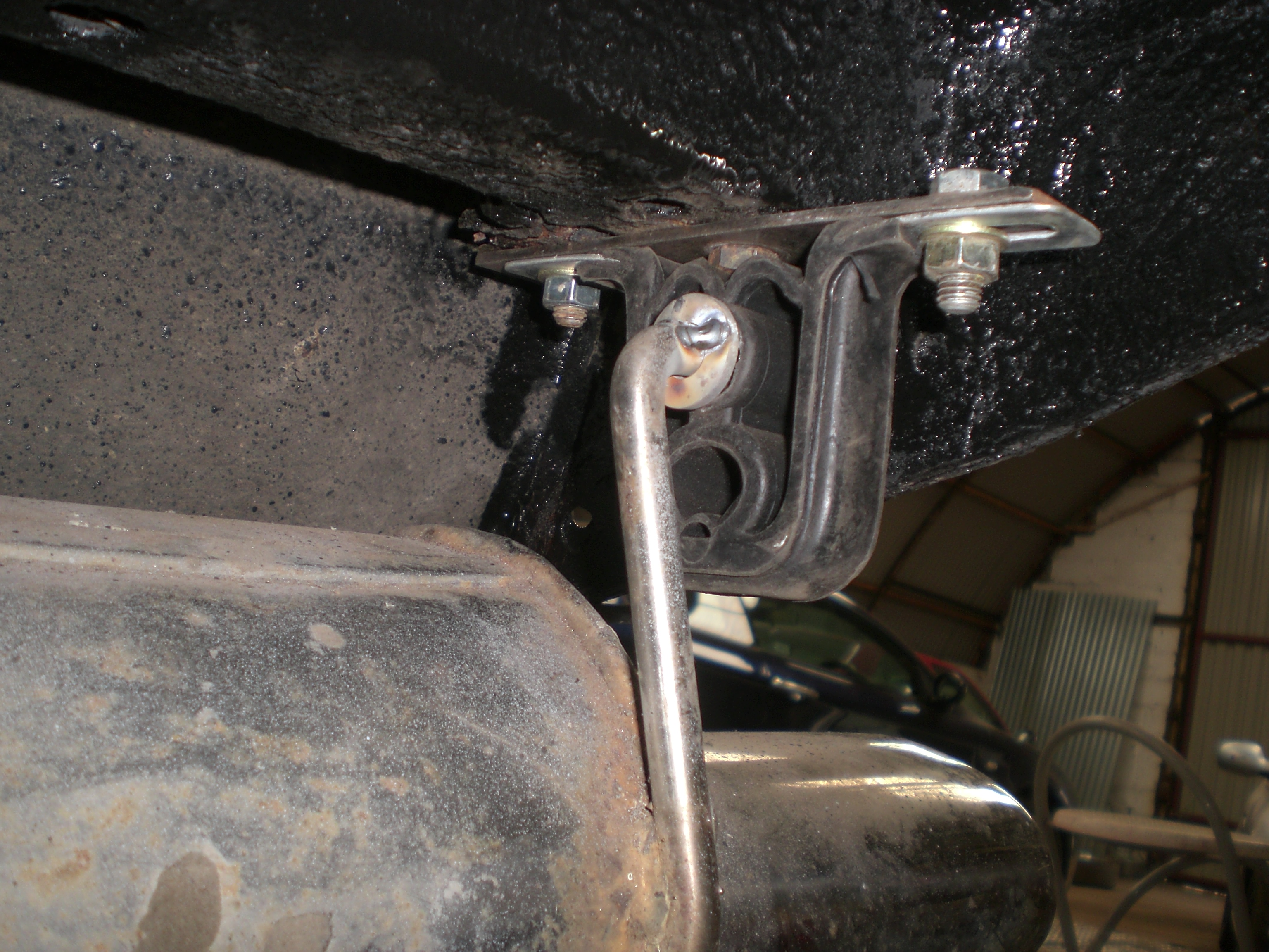

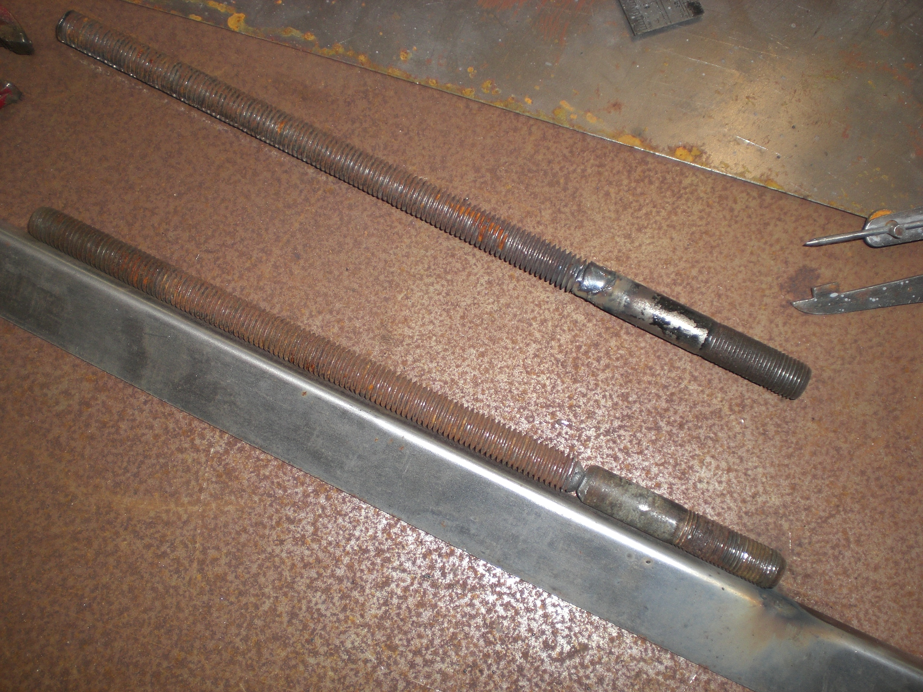

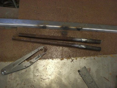

Got the rear axle fitted this afternoon. $ bolts hold it against the chassis rails. On my own so thought it'd be a bit wobbly on trolley jacks so came up with a solution...
2 old bolts had their heads chopped off and got welded to some threaded bar...these were then inserted into diagonal corners in the chassis which made great guides as the axle got jacked up, then insert the 2 normal bolts then take out the guide studs, simple!
Bit of angled section used to keep things in line as they are welded...
Fuel tank all back on now complete with refurbished straps so we're getting there....

The exhaust was previously held up with bits of rope, the original hangers having been discarded when the powerflow one went on I guess, the mounts they used were tiny and far too weak to hold it all up.
Much more secure now and should last for years to come.
Rear hanger had a tiny little half moon that looked like it'd struggle with a Morris Minor let alone a big rear box like this!
Can't recall where or what this one fits, tempted to say Renault Clio but it's not quite the one....anyway, it'll last years now.
It does fit the bumper cut-out nicely though.

Nearly didn't go up to the unit this afternoon, work this morning then home for dinner and sat watching TV with the dog....could have easily stayed there all day Managed to drag myself up there by half 4 so didn't hold much hope of getting a lot done..
Started off by sorting out the rear bumper and getting it fitted back on.
Rear undertray next which thankfully I'd managed to get all the mount points sorted so easy enough.
Rear arch covers that fill in the bumper end gap needed some fettling as that is the area where I'd done loads of reconstruction, a plastic support made up and fitted to save getting the welder out...
With all the back end back together the tyres got pumped up and wheels back on...

Decided it was about time the car saw the light of day again so outside in the late evening sunshine it went.
The rear 1/4 panel I'd sprayed wasn't quite a good match, new rattle can paint was a shade dark. As I'd still got plenty left I thought i'd attempt to blow the rear door in to blend the colours out. Plan was going well until I rubbed through nearer the front door so would have to spray the basecoat further along than I wanted to
Nice bit of alfresco basecoat spraying, the thick layer of dust and dirt will stop any potential overspray from the really low pressure the rattle cans give off so no need to sheet the whole car.
Note there is only lacquer overspray on the front portion, rear end I'd sprayed at the 1/4 panel so no edge to edge issues anticipated...
As predicted though blowing the basecoat so far forward didn't help me sits' not as smooth a transition as I'd hoped to do. I could carry on and do the front door and wing but it's good enough, tidied it up enough. If I keep the car I'll most likely do a proper full respray sometime.
Happy enough with my evenings progress, the 155 is another step closer to being back out there.

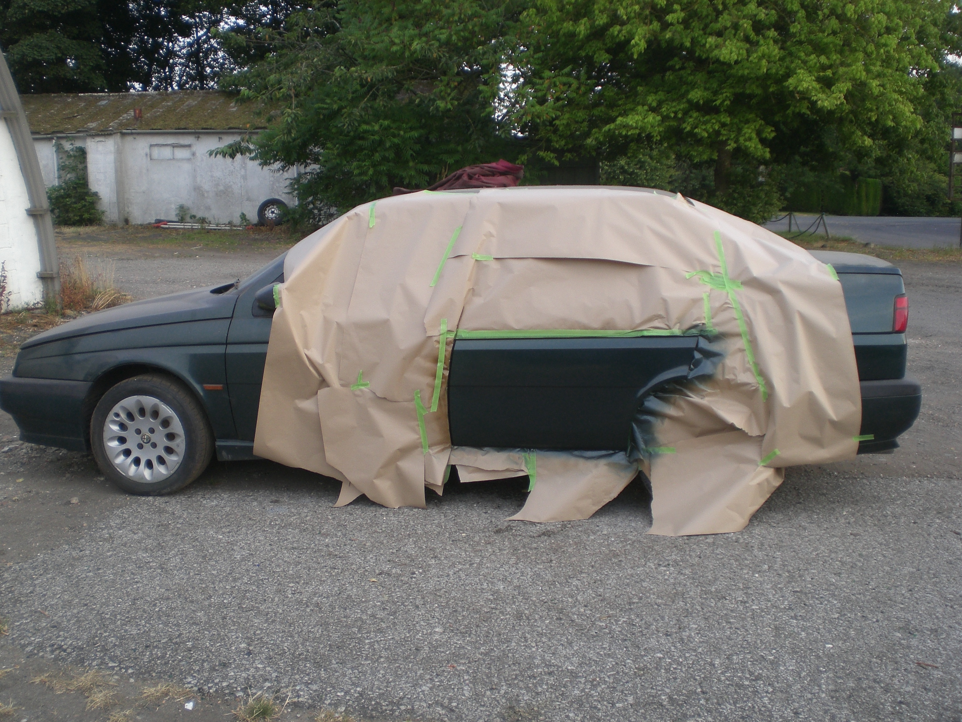

Had a great gift today thanks to my good mate Paul, the 33 owner.
Thanks again mate, I'm sure they will suit the car nicely

Started off going through the brakes, discs and pads removed for cleaning and inspection all round. Happy that all calipers are in good order, all bleed nipples came out very nicely, makes a change! Front pads need renewing, discs seem OK but I'll know for sure once I can drive it.
I'd changed a few brake pipes mostly around the rear end when the axle was off. A full length one needed changing so once all the discs etc were back on it went over the pit.
How come the brake pipes that always need changing go on for ever all around the back of the engine?
Bleeding though was another story. 3 corners went well but the n/s/r would not get any fluid through. Working back from the caliper to find the fluid I realised the brake compensator was at fault, inner mechanism for that side was jammed closed. Under the rubber cover it became obvious that this unit is beyond saving, thick with rust

As I couldn't yet get to drive the 155 I consoled myself with the new rims as donated by my mate Paul, I actually think they suit the car great, even more than on his 33!
