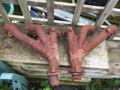

Hi Marc .
Sorry I haven’t got any pump bits. I Do have some exh manifolds which i think are 75 V6 . Have a look at the pic see if they’re any use to you.

Oh well, it was worth a try Think I've managed to source a replacement oil pump anyway from a 116 gtv, though I won't have any idea how worn it is 'til I get it and strip it down.LooLooSud33Spider wrote:Hi Marc .
I've already got some manifolds the same as that (which I'm hoping are 75 v6 items too) so I'm fine for them thanks. But in the unlikely event you've got the casting which bolts between the thermostat housing and the pump (basically the lower half of the thermostat housing by the looks of it) I'll definitely grab that off you - despite searching for months I still haven't found one yet.
