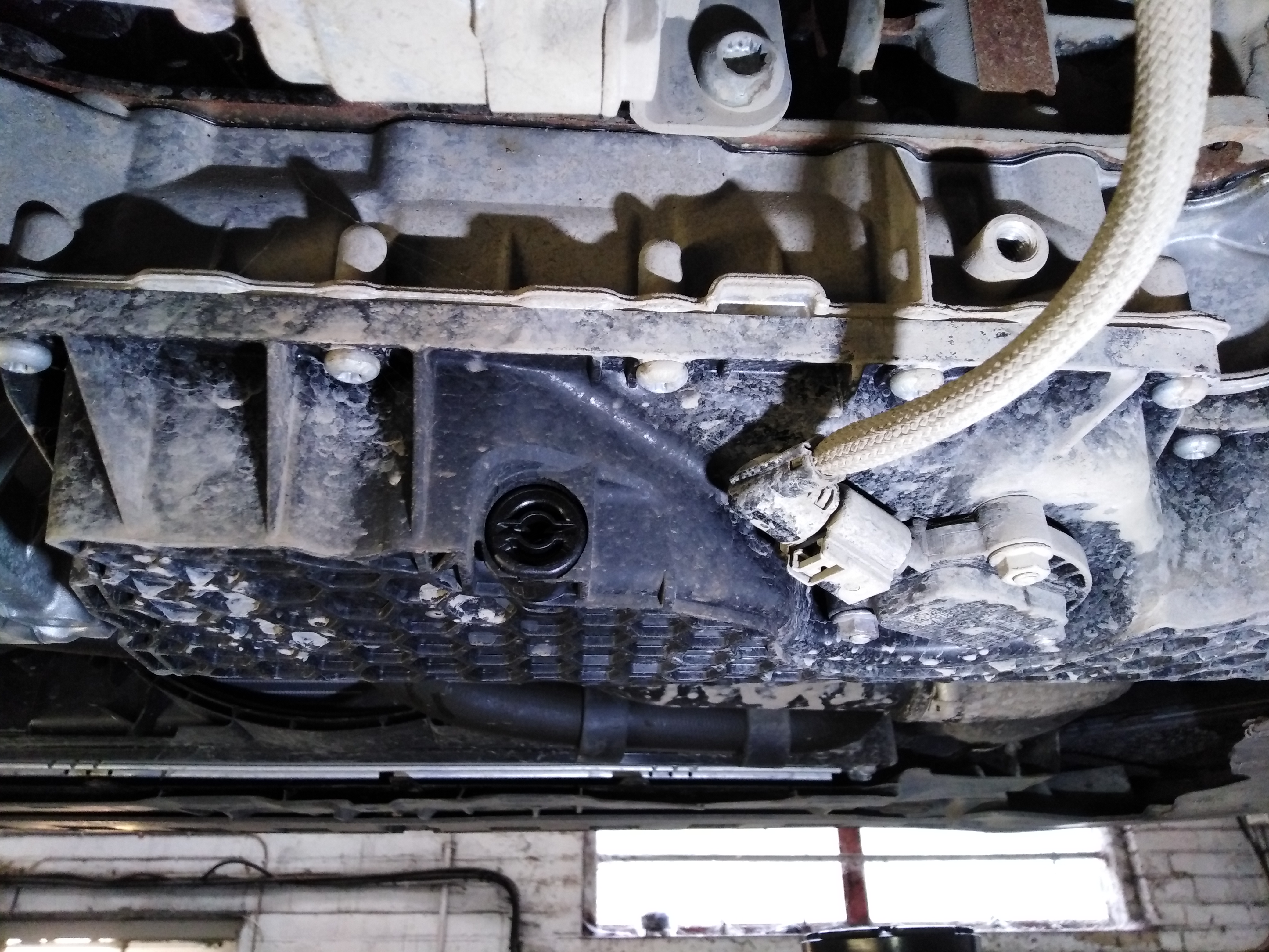

The latest stupidity addition came today, had an Audi something or other, dunno what model it was, quattro with a 2 litre tfsi engine or something. Only in for an oil change so thankfully I didn't have to drive it far, kept nearly nodding off when sat in it due to the impressive level of mediocrity displayed inside masquerading as an interior, God all Audi cars are dull. Should come on the NHS as a cure for insomnia.
Dropped the undertray off having first fought with threadlocked securing bolts :?:
Only to find, yep, a plastic sump!
Genious!
Worse though it had an even more stupid sump plug made of flimsy plastic that looked like it needed a quarter turn but felt like it would disintegrate if I tried any harder. A search online revealed you need a special tool to remove it!
Gave up then and just sucked the oil out the dispstick tube, which I don't like doing as that doesn't flush the crud out.

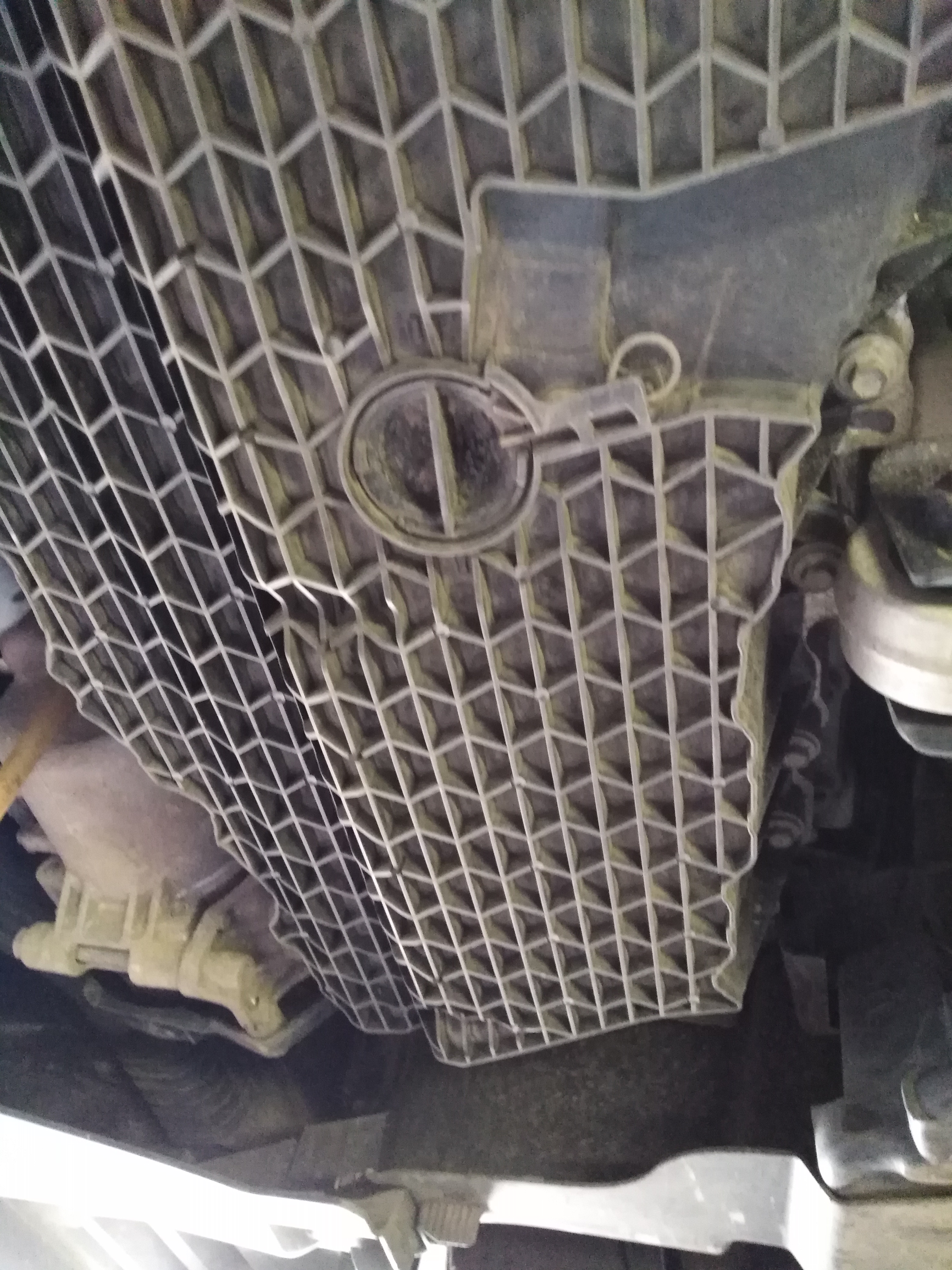

Had this in yesterday, Peugeot van with the Peugeot/Ford diesel engines. Just thought I'd show the plastic sump in case anyone ethought I was joking..... And yes, that "R" clip is vital to stop the plastic drain plug shaking itself loose! It does have a locking notch within the mechanism to lock it shut but it's hardly a tight fit, turns very easily by hand....
Genius? :shock:

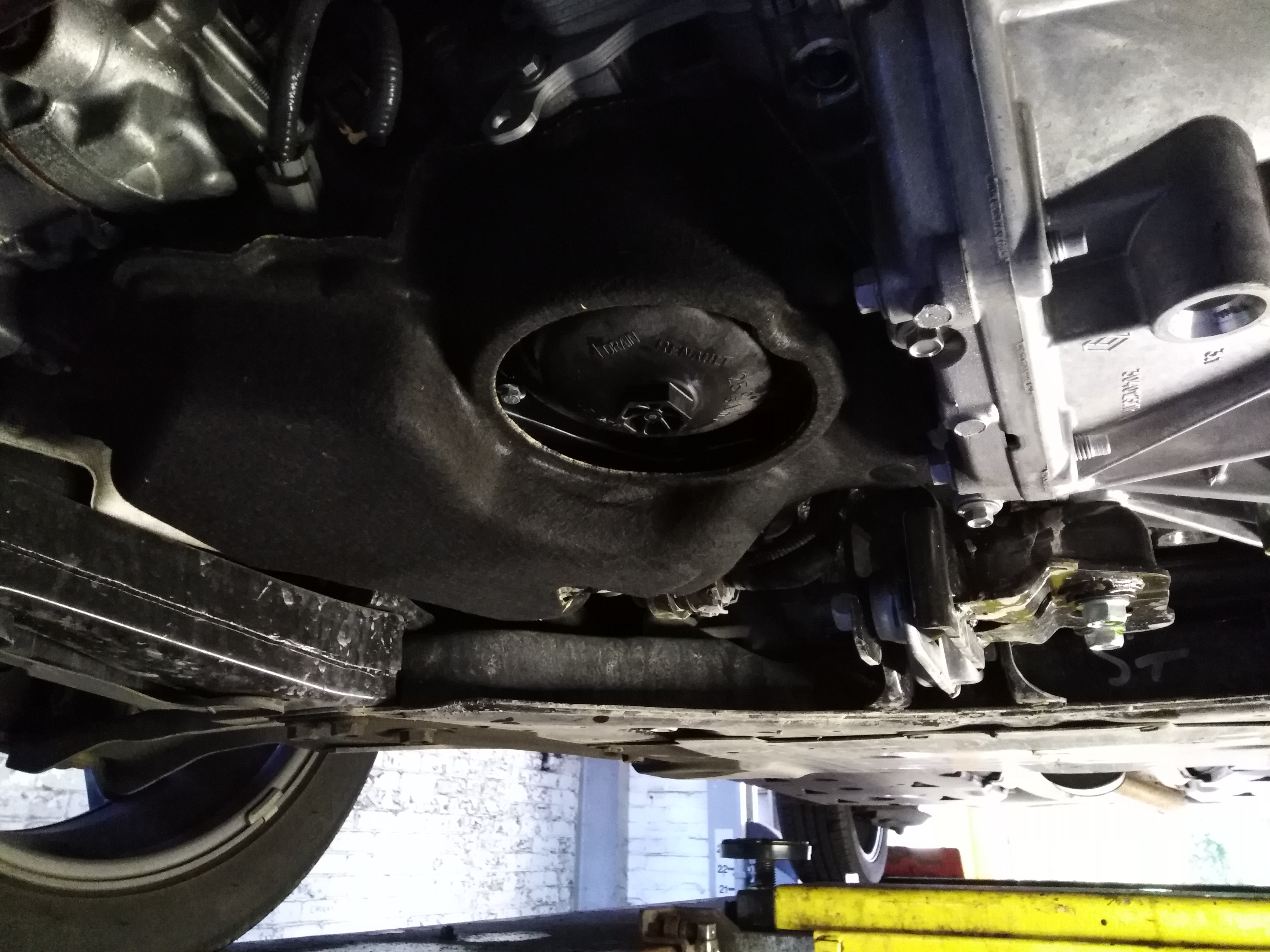

This one today, Nissan Qashqai despite the Renault lump....
Now I can't condemn this as much because for once the oil filter cartridge housing is very handily placed for easy oil changes, but although the sump is steel the housing is plastic and it sits down as low as the sump ready for a big stone, or low kerb to crack it...
Ought to really have a steel guard round it at least...

...Especially given the car's pretensions to be a "luxury soft-roader" :lol:

Yes, exactly that Lauren
They seem to think it's an semi off road vehicle despite fwd only!!
Picture is deceiving too, looks like the filter housing is only the removable cap exposed but that felt warming blanket hides the fact that the bottom of the housing is level with the sump and has probably 3" depth of plastic housing to aim at....
