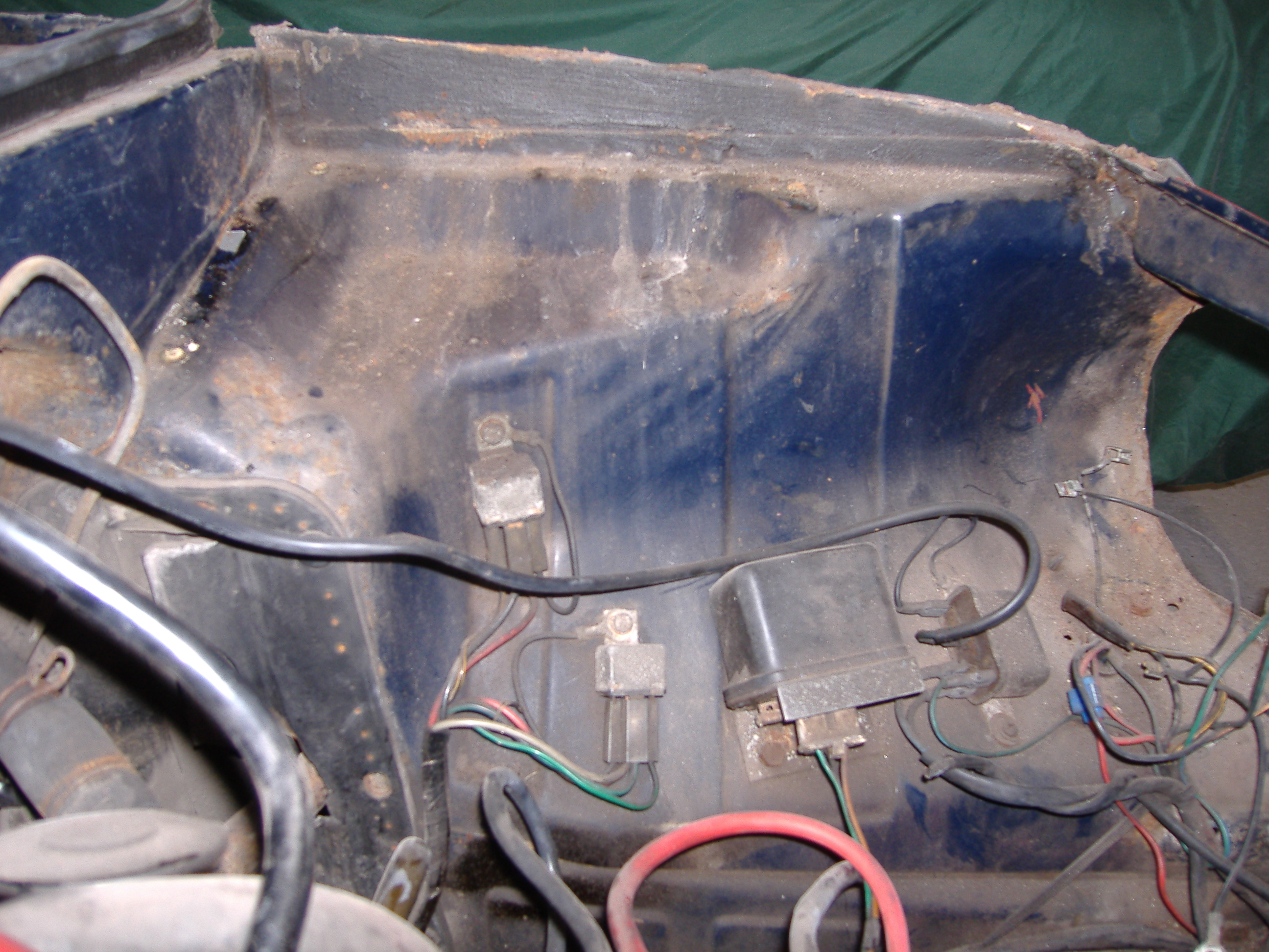

Anyone like to tell me where the ballast resistor is normally located as would like the Sud bits to be in about the right place. Thanks.
