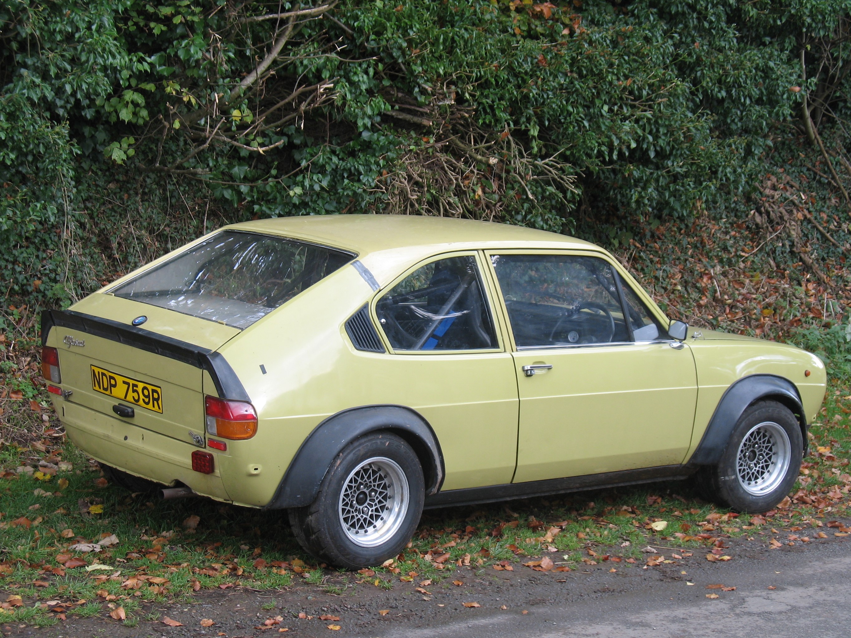

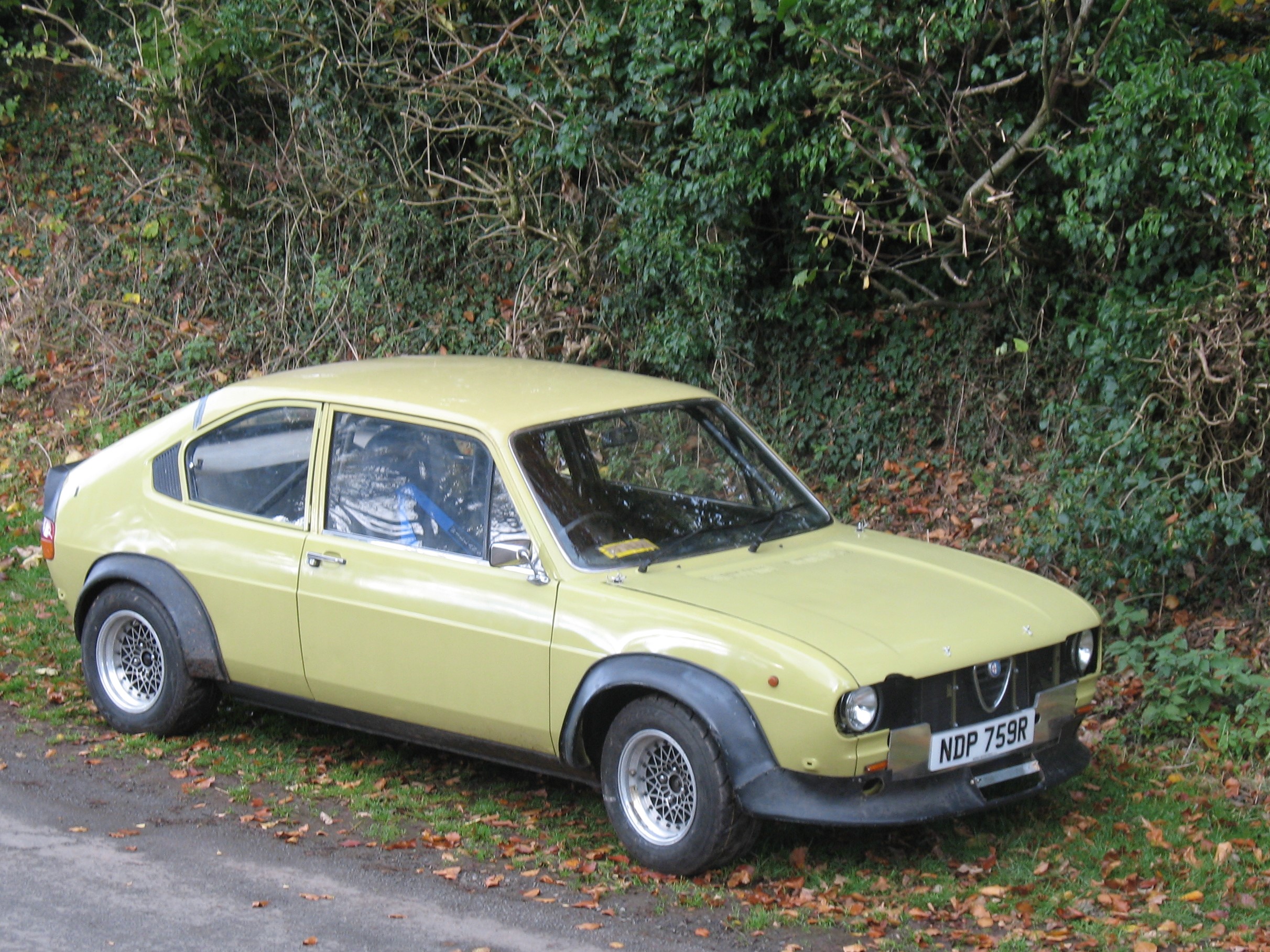

1500ti restoration. Ex racer
Off for MOT today.

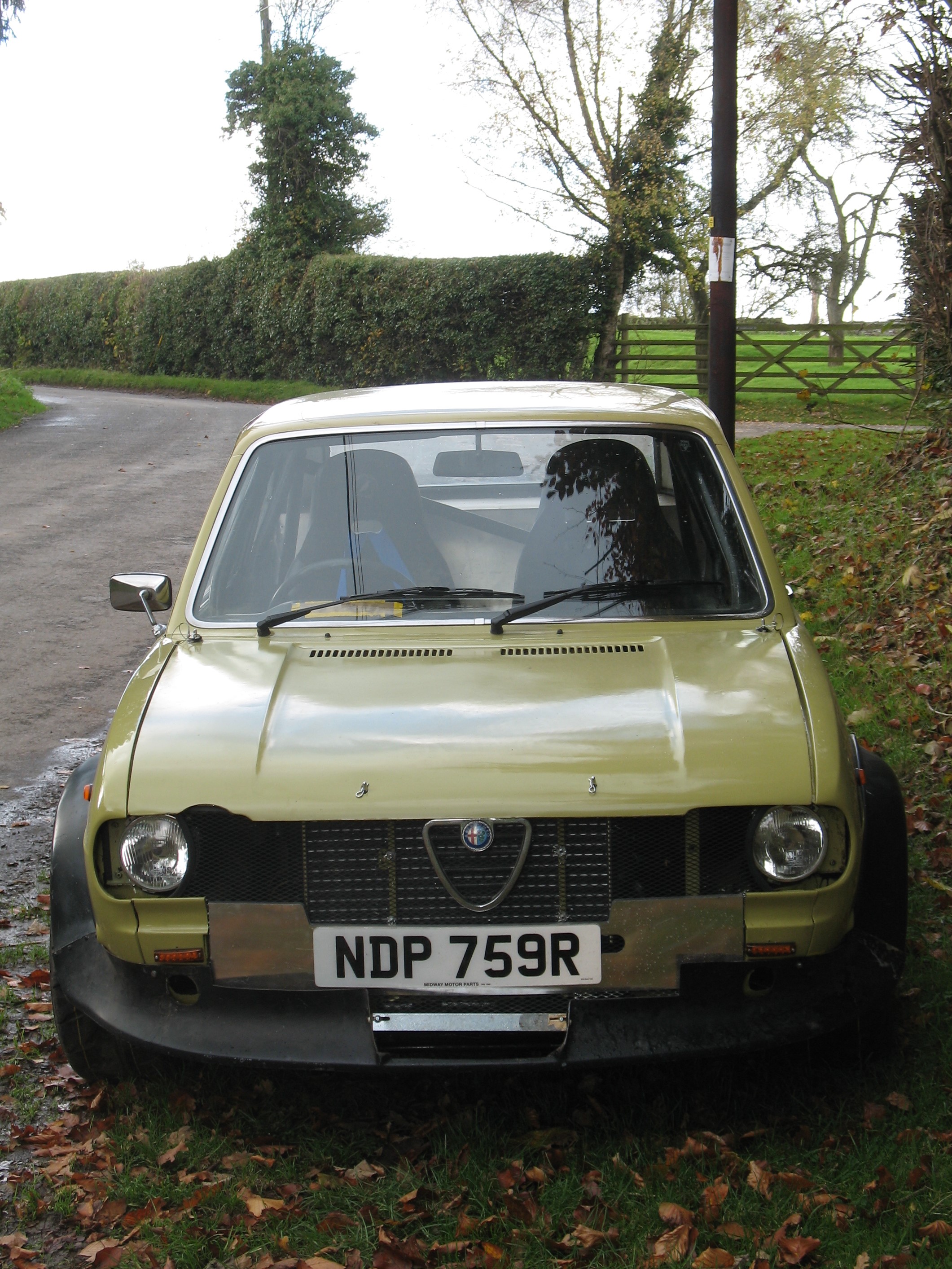

The front panel I noticed yesterday is all to cock !
How did I not notice. It was my mistake too, as I measured to get the most airflow to the rad and then the chap who made the panel put in the slots centrally.
Best of all is I fitted it, looked at it endlessly as I did it to get it right and then admired it. Never saw it till a week later.
The rally driving mechanic who is helping me get the last bits done took it for a drive on wed. He drives everything fast !
He said ` It really wants to go and keeps heading for the hedges!' So he reset the tracking. I redid the speedo cable again.
One of the old seats collapsed and found a chap to redo the base. Fab job done and 30 notes.
Left off working on a chair Cardinal Wolsley had once sat on to do it.
So did it pass James ???
It passed !
Bit of headlamp adjustment and a wire came off the stop light switch during the MOT of course
Drove it around with Eric who has really pushed me on this last stretch, cripes it goes and despite the mish mash of components the front end feels great.
Something wrong on the rear as too jerky and noisy. Certain it is the dampers, possibly just adjustment.
Eric drove it rally car style and I could not match it. It does go round corners well.
Pictures to follow.

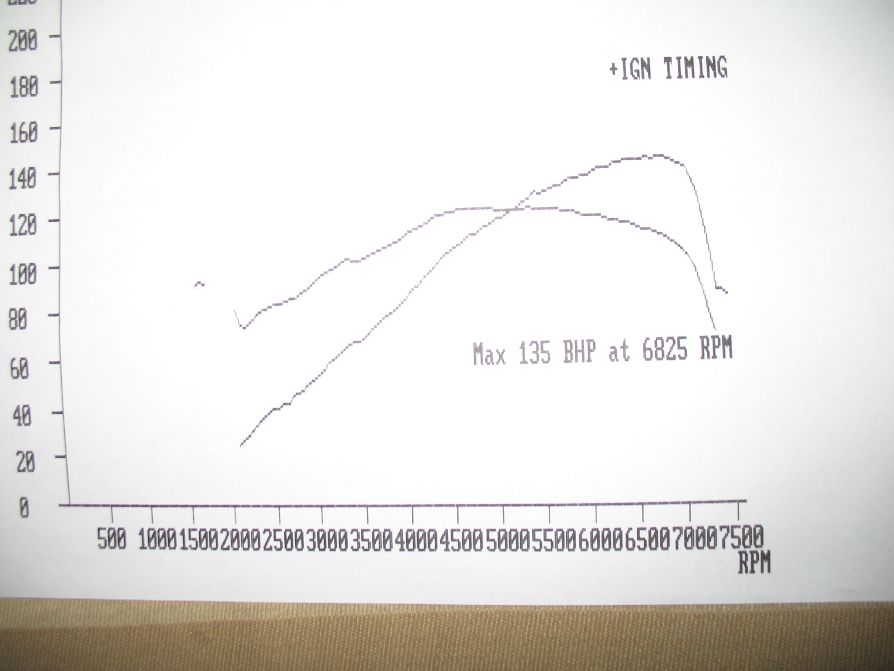

All went well. 135bhp at 6,800 rpm. Lots of small niggles took up a lot of time and so made it expensive,
but worthwhile and very pleased.
A quick run down the road was the proof of the pudding as it fairly whips along. Great fun.
Good result there James, a nice conclusion to all the challenges you took on.

Nice smooth curves with no flat spots, looks great and must sound awesome. Good numbers if at the flywheel, excellent if at the wheels
Many thanks for the positive comments gents. I passed on your regards Fruitbat and it made Dave smile.
I was amazed at how well he works on the detail, intensely and confidently despite the owner and a locally renown rally car mechanic watching, yet it does not faze him.
I surmise bhp was at the wheels as it was on the rollers, best thing is that the car feels just the same as the curve shows. A superb delivery of power. I also now understand why so may of you rate the 1.2 gear box. Its very well spaced gears.
A credit to Keith at K and L for building the engine and Dave for his setting up.
Yes it does sound fabulous, like a serious bit of kit.
Next over winter I shall sort out the rear suspension as it is too harsh and fighting the front, not sure why, so needs
careful investigating.
Then reposition the seats and sort out the hash I made of the front panel.
Still it did the job and got me through an MOT, so happy days.

It'll be power at the flywheel calculated from the dyno load - 135 is very respectful though
- Posts: 774
Dave is very detailed. I learned a lot from the first time he did my car. Helped me get things right afterwards and what to check and look for.
The good bit of news is Dave's rollers are pretty pessimistic as is Dave. If you have got 135horse power. Everyone is a pedigree. You,'ll have no lame donkeys in their.

Thanks for clarifying that BS25. Yes, Dave gave me advice on a couple of things which I will follow up on.
The main one was that the modern carb insulators that I fitted as they were meant to be good, (rather than the Bakelite
ones) are not working well so the fuel was hot and frothing away. Worth 3 BHP he reckons !
So shall get a pair of proper ones.
