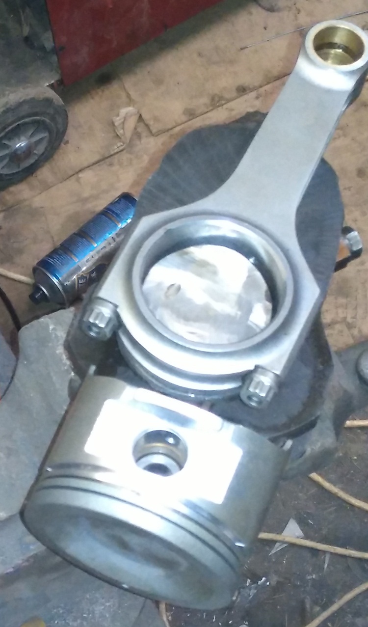

Re: 1800 8v with Nissan pistons.
bert308 wrote:I never realised the extra skirt on the Nissan pistons could be a problem, attached is a pic of the conflict. I guess the pistons should be modified to be like the Alfa pistons.
I also ordered a set of the Max Speeding Rods for the old Datsun Bluebird 1.8 as mentioned earlier, they were suddenly on their site for only $169 so I ordered but then they didn't want to sell for that price and had to pay $239. They will need narrowing on the big end side though. I will take the whole lot to the machine shop soon.
hi, how many mm of gap do you think you need? i mean measuring from the piston pin to the crank, having everything assembled ( like in this photo)
'cause i have found something interesting, but need to know if the piston "tails"are too wide or too near the crankshaft..
thanks for any help!
Gap is Gap i guess, but for a true clearance i'd probably want to see 2 or 3mm all round or more maybe?
can you you show us more specifically where you think your clearance is debatable?
Excellent post Bobkelso and nice find of the other Nissan pistons, I should have found them first time around. Haven't been here for a while and nice to see an update. Today I went to the shed and searched for the parts...I have the rods I mentioned earlier that are 1mm longer, and they are symmetrical. They have a 2mm wider big end than the Alfa rods, so for testfitting I cut a damaged crank in 2. It seems the Nissan aftermarket rods do clear the Nissan pistons on the Alfa crank. Here is a short movie:
http://www.youtube.com/watch?v=RjN1Z2uZDaw
But don't take my word for it, I guess it is time to put my money where my mouth is and take the stuff to the engine shop to have a block bored to 89mm, and have the big ends of the rods narrowed by 2mm. (I also will bring 2 nice flowed heads that I had fitted with new guides and valves, to have the valve seats recut and a light skim for cleanup) So the 1mm lower Nissan pistons with the 1mm longer Nissan rods should give a good shortblock and I will mount the flowed heads with C&B street cams I have for a nice 8v boxer with good power and manners...
Hi Bert, interesting, so that piston type and that piston rod (symmetrical) seams to mach,
from your video it seams there is enough space also considering 1,5mm more
when adding the nissan bearing, with nothing or at worst very little to file from the skirt..
What I don't know is if the machine shop can machine from 26,8 to 24mm,
together with the nissan rods, also the nissan bearings, because as hobbyist
I can't figure the best way to do it, but I hope it is possible and quite normal for "pro",
may be some particular/professional thick is necessary to hold them during process..
