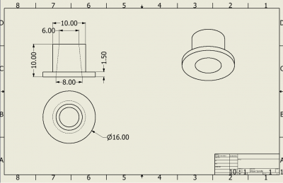

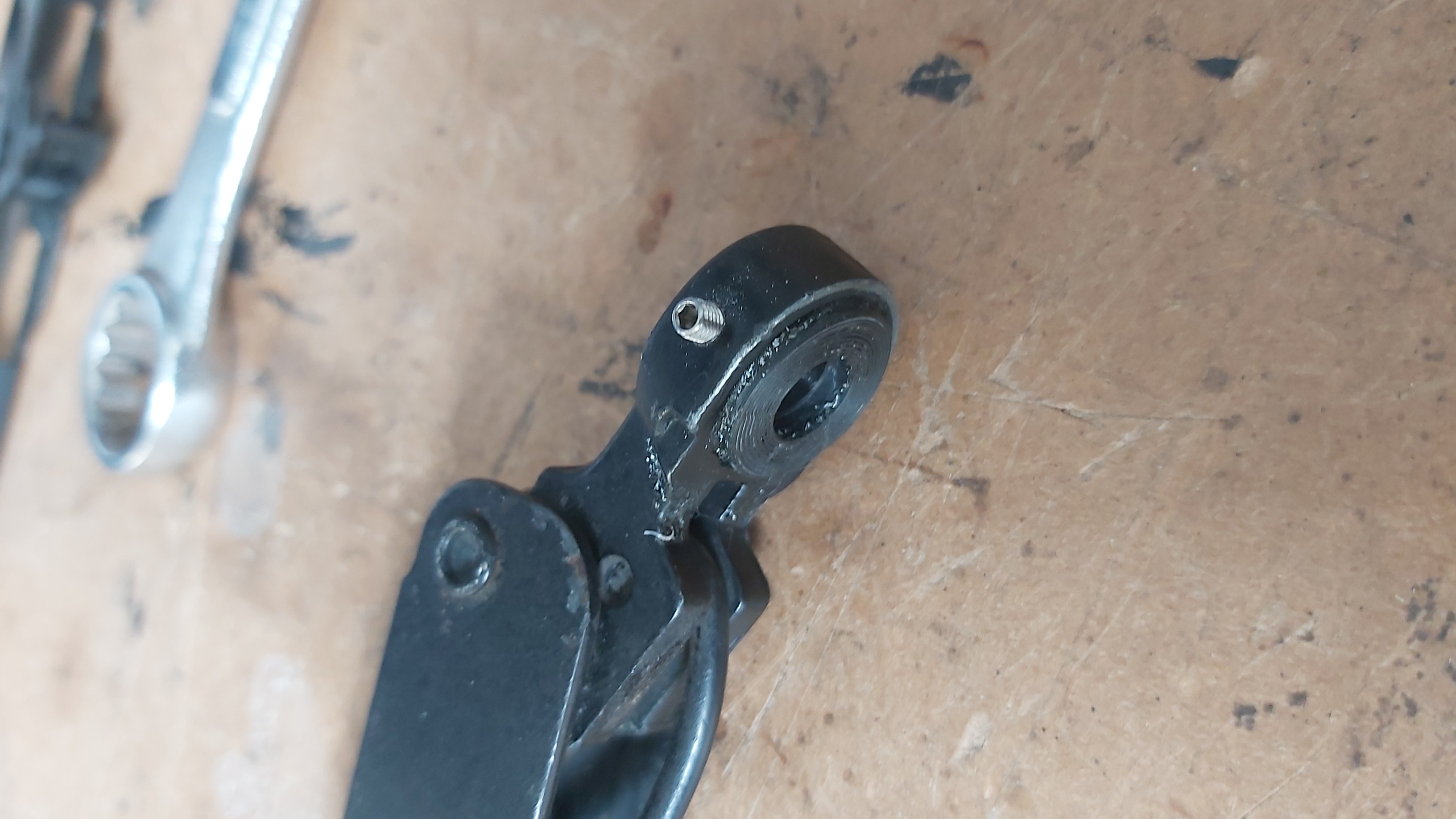

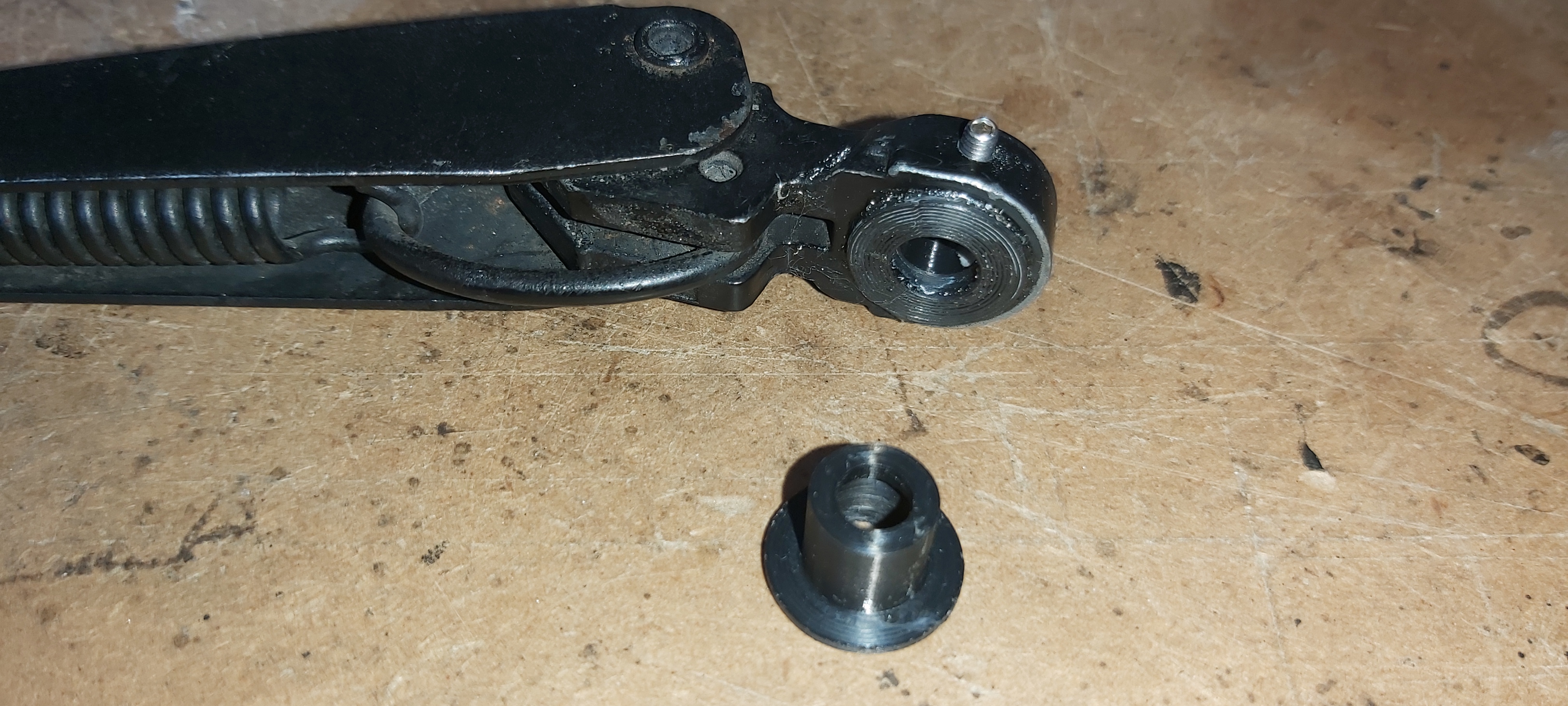

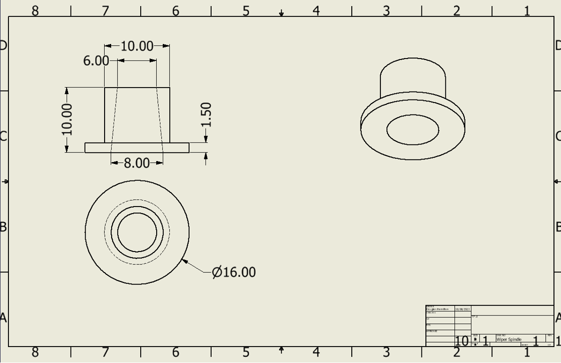

Got an insert for the arm 3D printed. The inner hole tapered to suit the spindle.
Outer diameter 10mm with a 16mm flange at the widest end of the taper.
Drill out the spindle hole on the arm to 10mm then bond in the insert.
Once bonding has set, drill and tap to 3mm and secure with grub screw.
