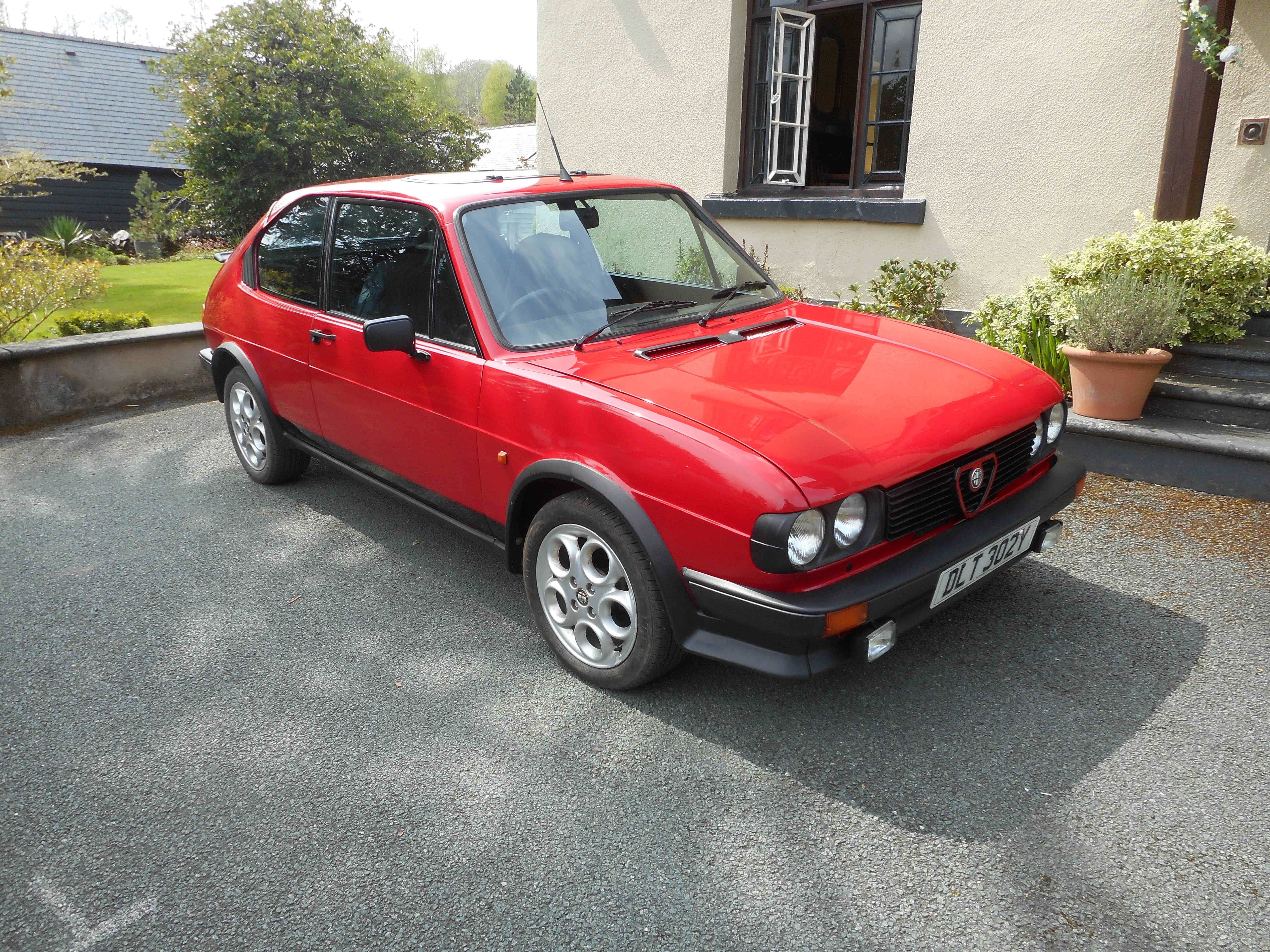

After putting the engine back in (1.5 Ti GC) and getting MOT/TAX/Insurance I now find I have a head gasket leak (done with a leak test kit). Picture attached.

Smart looking car. Same wheels I have on my Sprint too. You have to put specers on there too?

The wheels are from a 145.
I have the original pepper pots and tires, but you cant get replacements.
These wheels have 195 tires with 10mm spacers.
I think they are a bit wide. People recommend 185's, so i might downsize in the future.

Same as me - 195-50-15” but I used 15mm spacers.
Drove it for the first time yesterday and I too wonder if tyres are too wide. I like the look of the 15’s though
