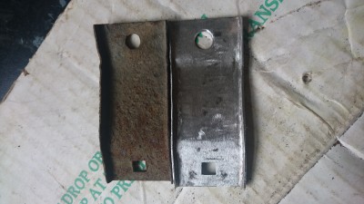

Has anyone got pictures and dimensions of the brackets that hold the front spoiler to the valance?
Posts: 2855
Re: Front spoiler support brackets
https://www.ebay.co.uk/itm/ALFA-ROMEO-A ... SwtpBeWr3I
Any use ? It will give you a physical reference to make any more.
Alfastrut
Posts: 510
Location: Derbyshire
Post by Alfastrut »
It helps. Thank you. Are they all the same size?
Posts: 2855
I think so. They look it in this photo.

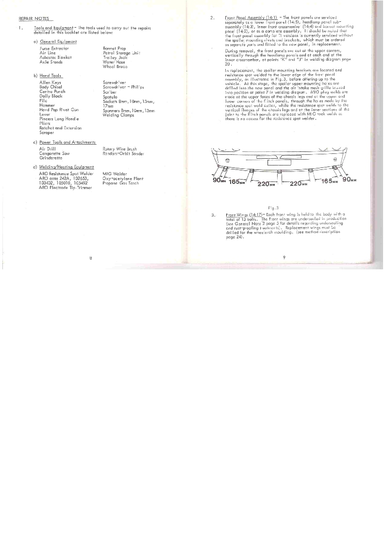

I've got a Thatcham body repair booklet on the Alfasud and I know it is in there. I'll dig it out tomorrow
This shows the dimensions of the spacing rather than the brackets themselves.
If anyone wants a full copy of the Thatcham Repair manual please let me have your email address.

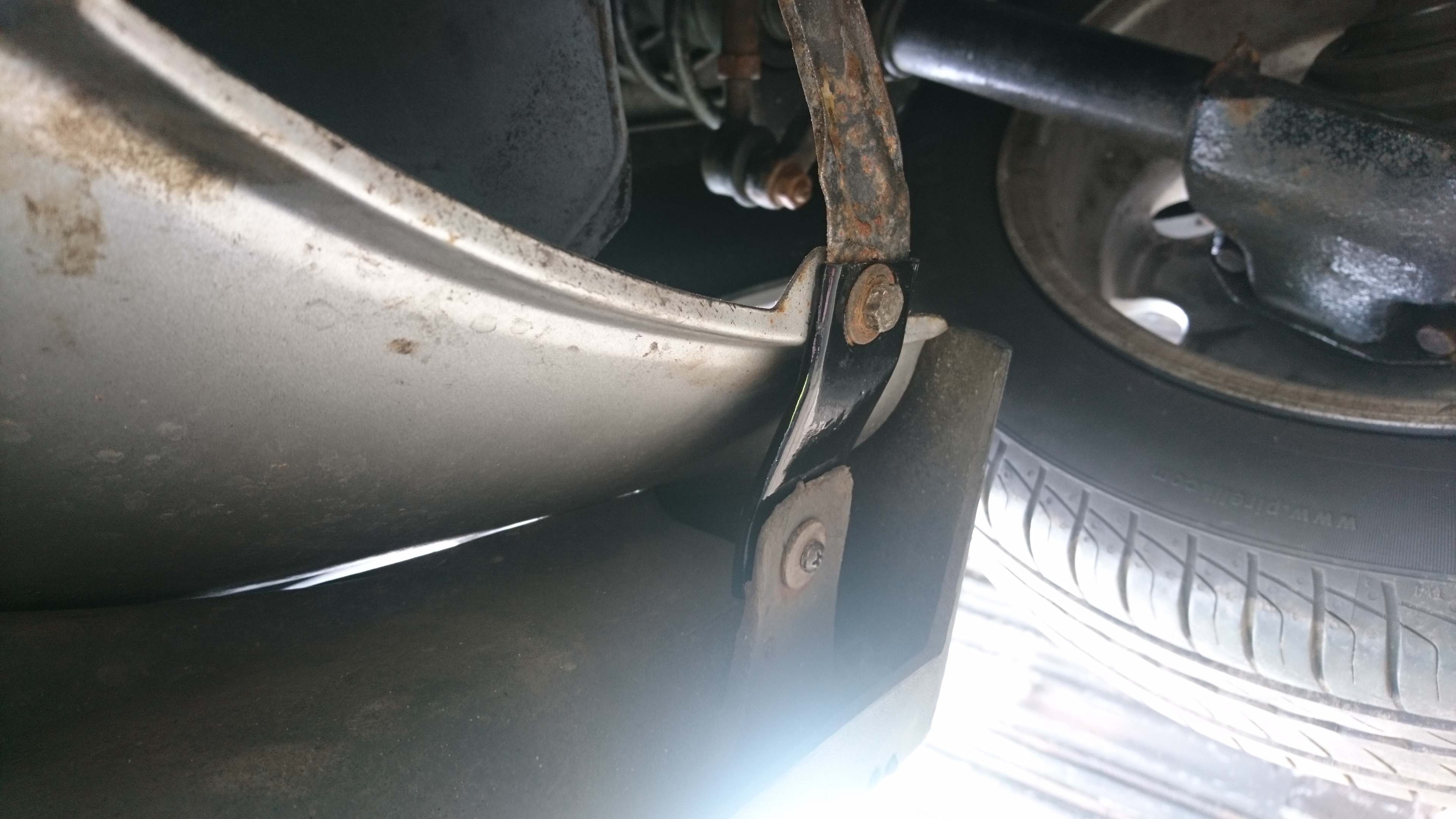

Is this how the wing to wheel arch bracket is supposed to fit?
Posts: 1425
Just get some 2.5mm galv builders straps on ebay, and bend to suit.
Much stronger that the original crap.
No body will know!

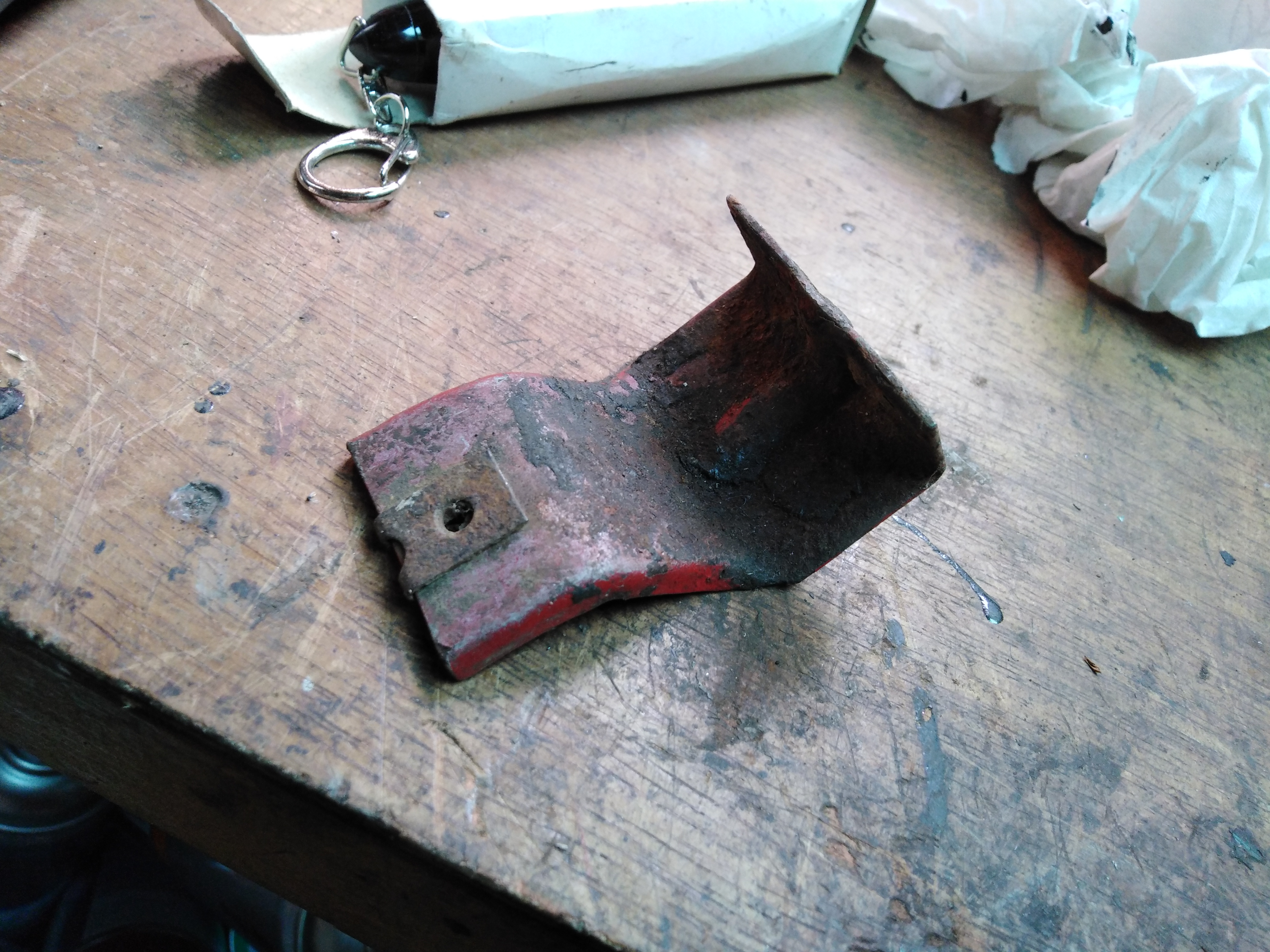

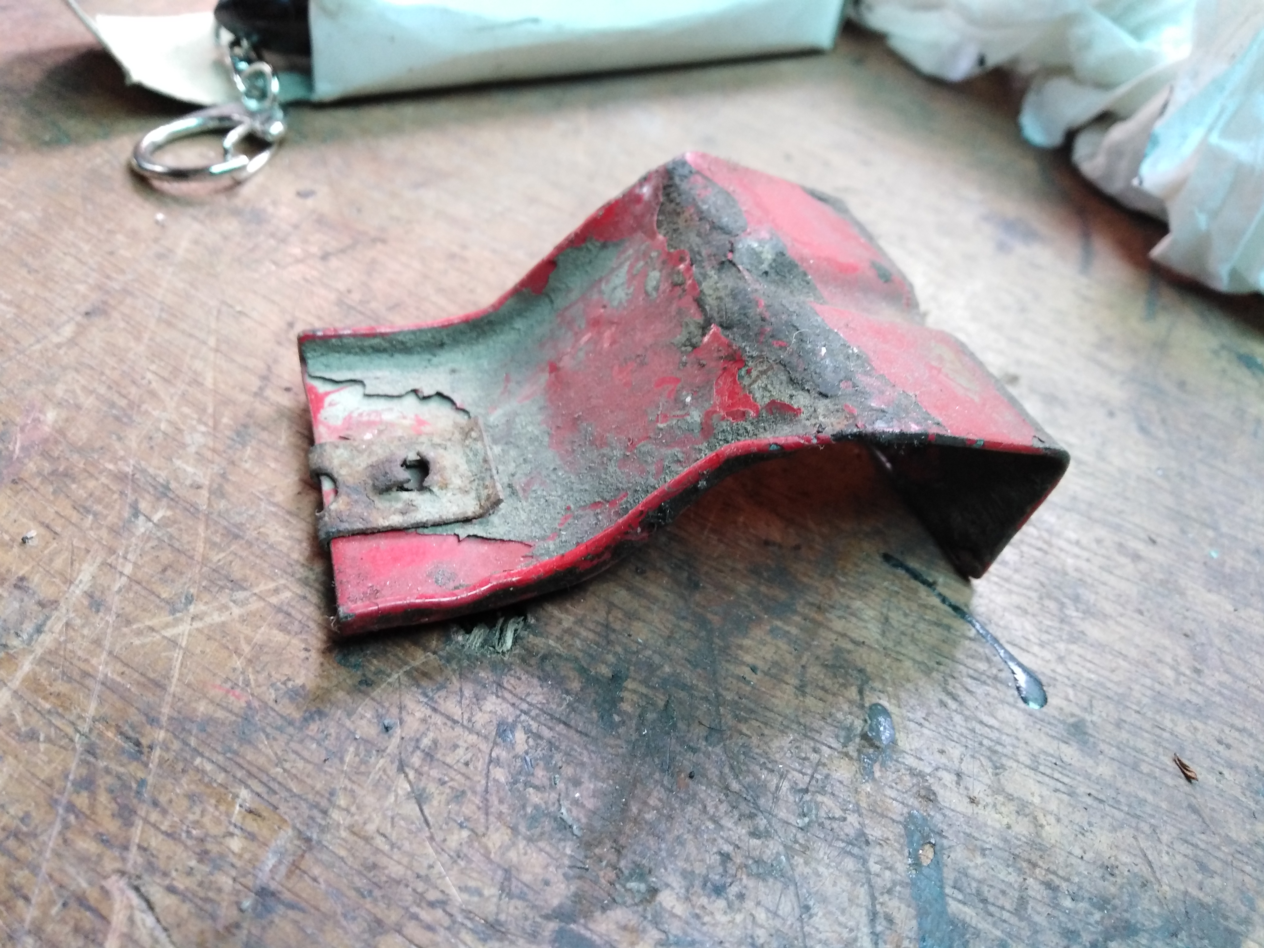

Just attempting to tidy up the shed a little, came across this, one only I'm afraid. Any use?

KevJTD wrote:
Sun Apr 19, 2020 3:12 pm
Thanks for the offer. I have managed to get 3 from John at just suds. I should be able to fabricate two more now I know what size they are. Let loo have it for a pattern since she is asking so nice.
Yours Lou 8-)
