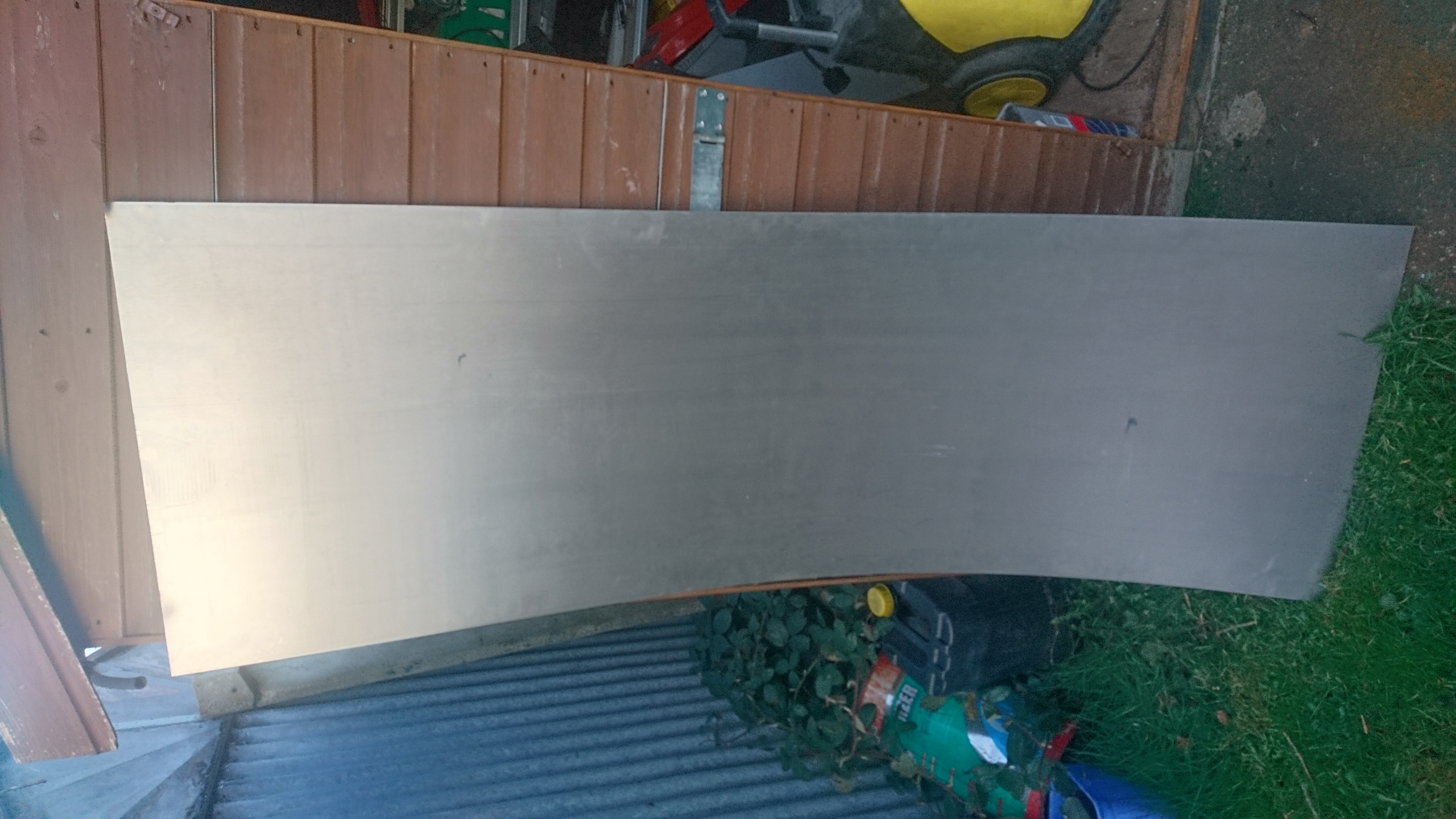

Got my 33 inner sill repair panel today
Re: 33 sills
Looks like someone will be busy.
Re: 33 sills
Funny. I’ve used the same panel to repair my floors, wings ,doors and everything in between 👍

Re: 33 sills
Post by Alfastrut »
It's amazing how versatile they are for the price. Only problem is they don't fit quite as well as the originals so take a little fettling.

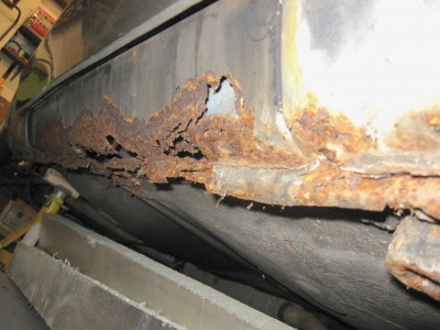

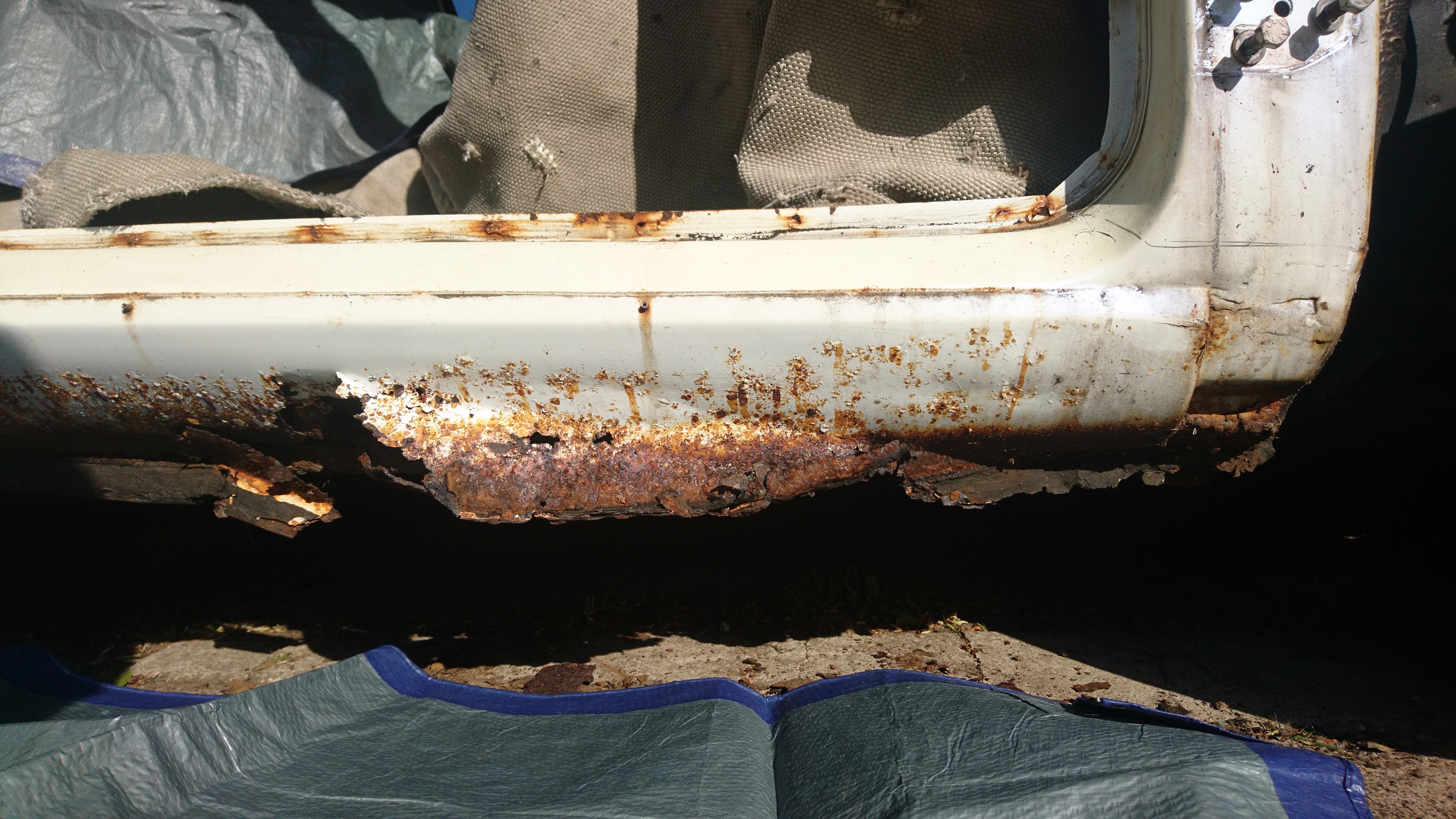

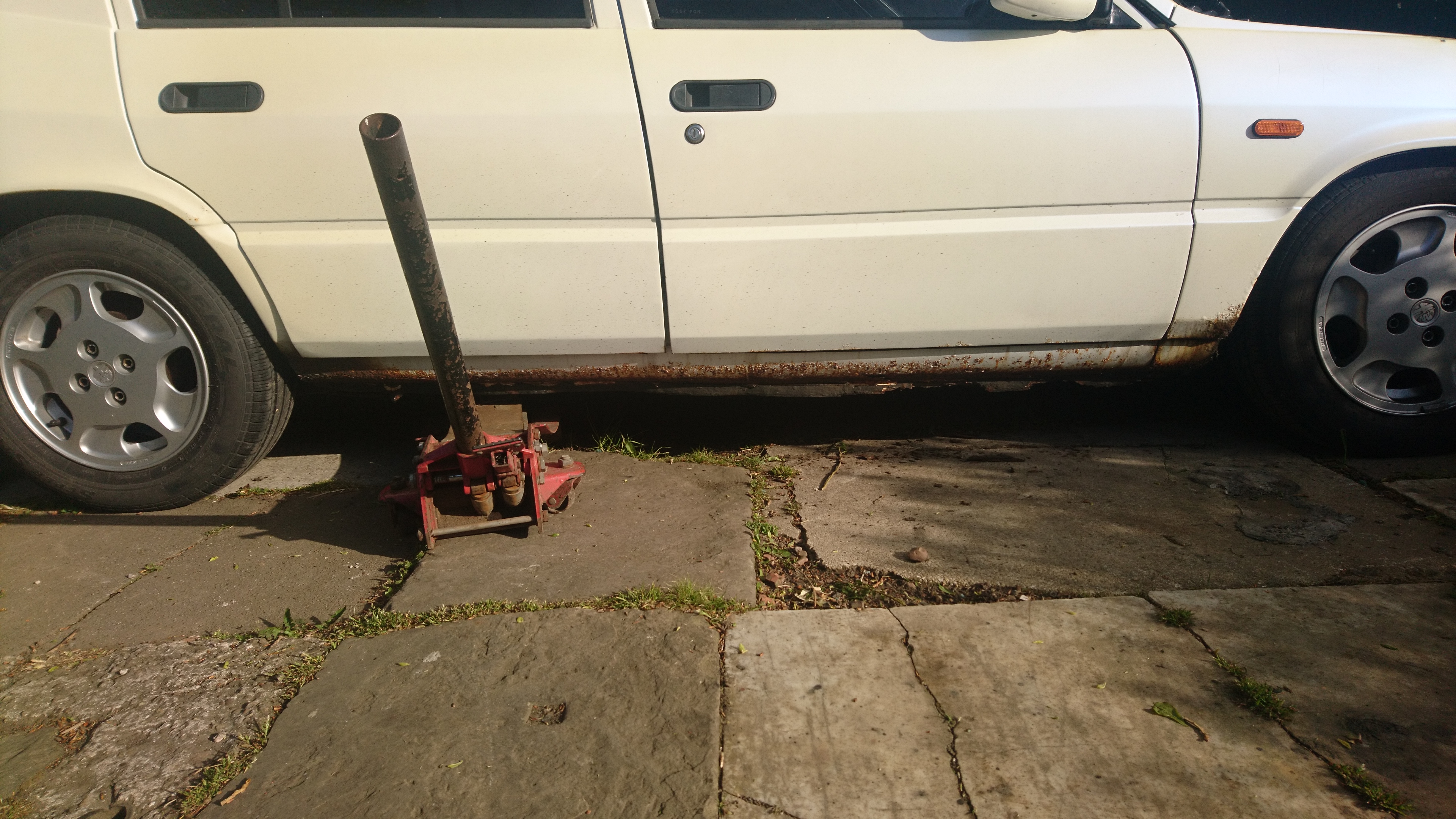

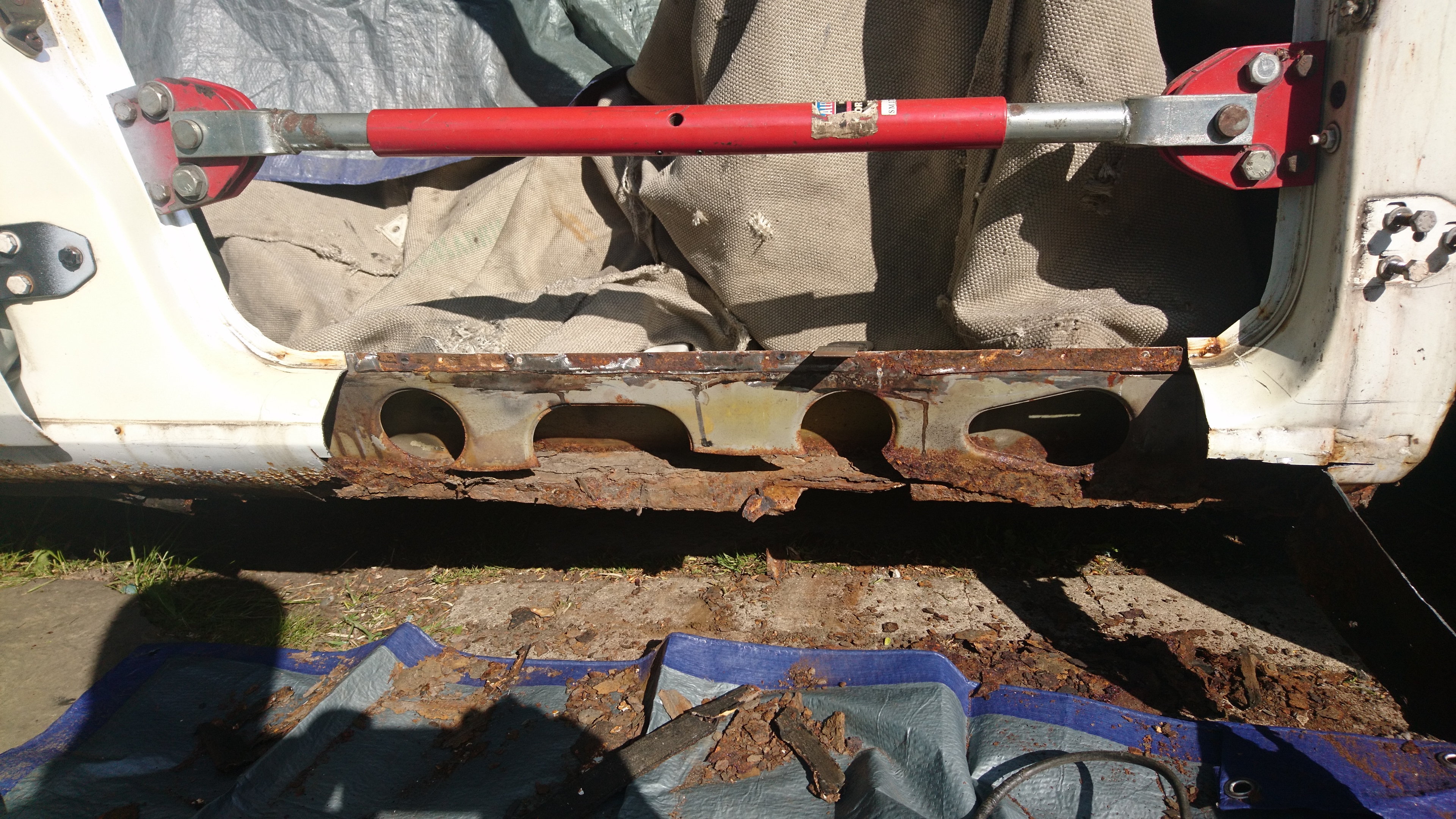

Well I've taken the sill covers off and it's not pretty
Re: 33 sills
I'd check your jacking points too . Been there done that 😉

It is rough
Posts: 1520
Re: 33 sills
Jack it up using the back axle, or the front cross member.
Otherwise the jack keeps going up, but the car doesn't!

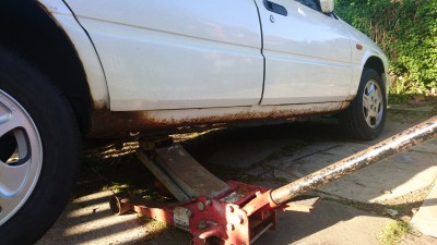

alfadave wrote: Wed Apr 22, 2020 7:43 pm Jack it up using the back axle, or the front cross member.
I'd never jack an alfa on its sills. On a sud or 33 I would never use the jacking points either. I learnt that lesson years ago 🙄
Posts: 1520
Re: 33 sills
Must have been that pic of the jack under the sills that confused me!
Alfastrut
Posts: 519
Location: Derbyshire
Re: 33 sills
Post by Alfastrut »
alfadave wrote: Wed Apr 22, 2020 9:21 pm Must have been that pic of the jack under the sills that confused me!
It's on the suspension connection point. If it was on the sill the jack would be in the car. 😉

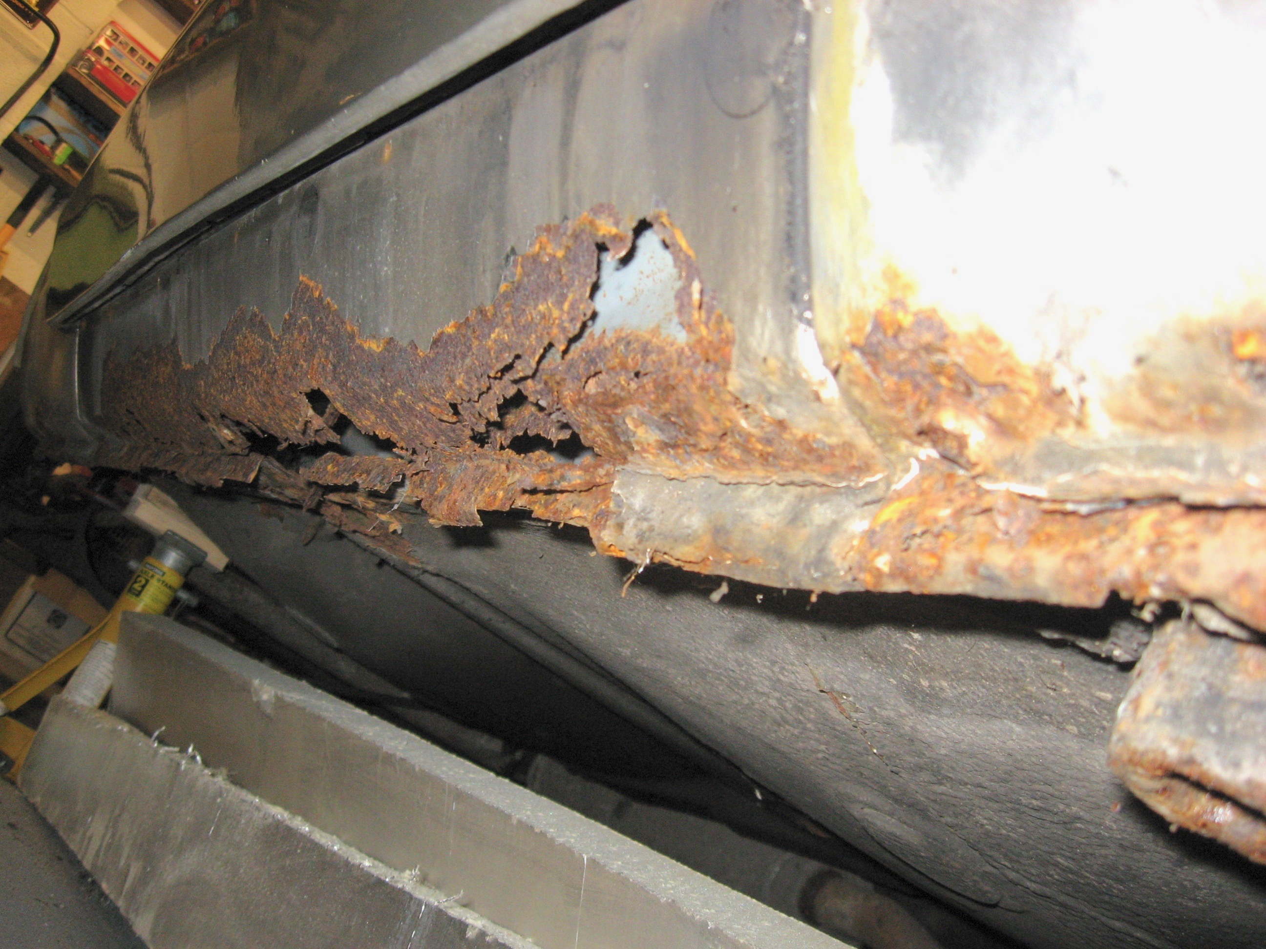

Post by Crank »
This is what I found when I took the Zender sill cover off my 'get it finished one day' Sprint Veloce. The space between the cover and sill was packed with a build up of damp road dirt.

Re: 33 sills
Lovely kits but they done kill our cars . When your finished . Wax oil the hell out of it on the inside.
Plus checkout upol gravtex and raptor . For undersealing . I used gravtex . But I'm going to use raptor aswell .looks brilliant stuff 👍

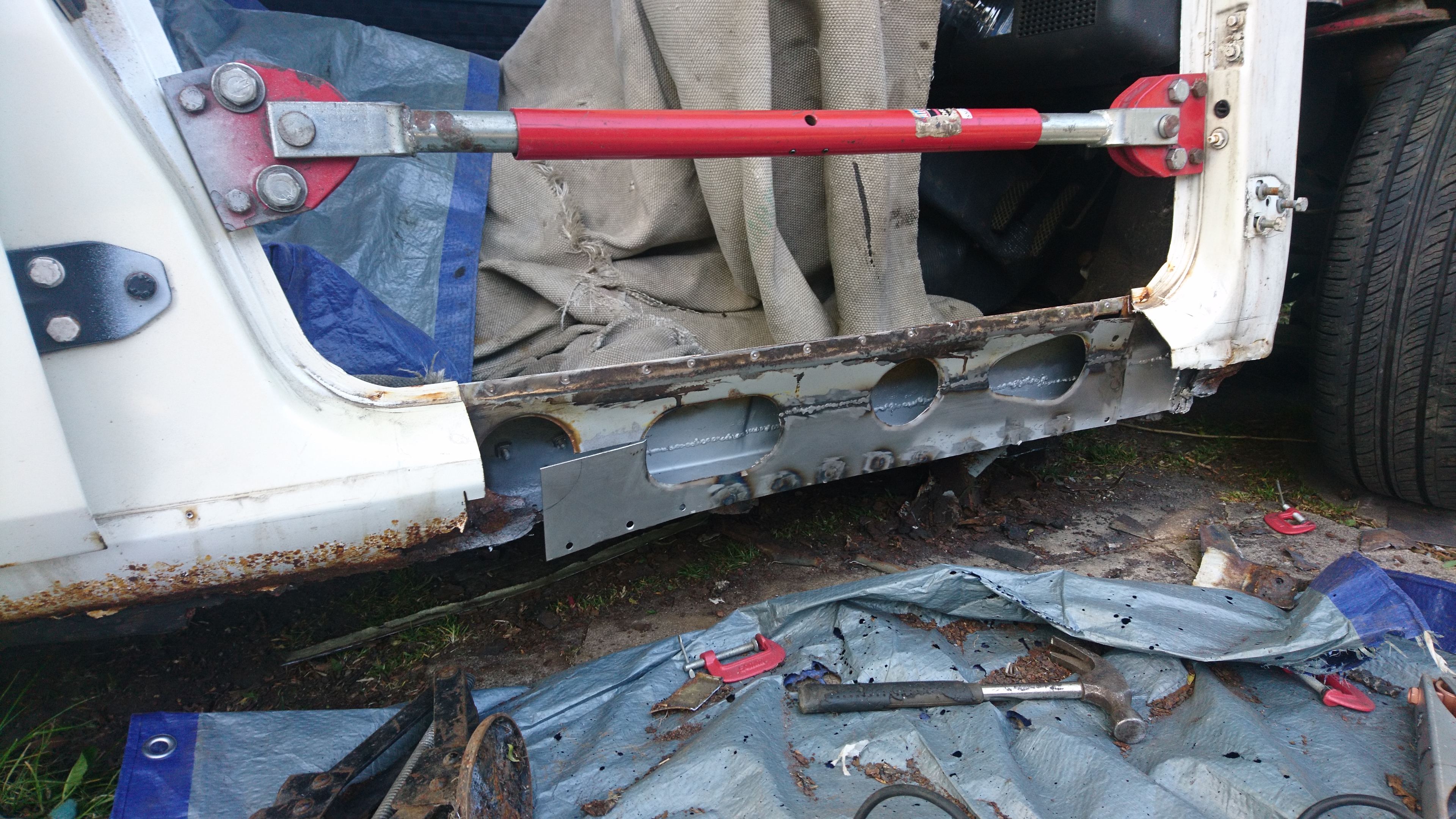

Today's progress

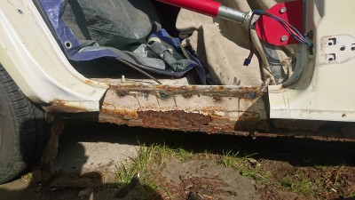

alfadave wrote: Thu Apr 23, 2020 10:07 am Hope your floors are more solid than your sills!
Are you going to be able to repair it?
The MoT guys can't really inspect that with cill covers on.
They used to state that on my old Sud ti with a body kit.
The floor will need replacing along the sill edges

Posts: 1520
Re: 33 sills
Bloody hell, thats great progress.
Mix old engine oil with some grease, warm it up when the Mrs is out, pour it in through a wiring hole or wherever, park it up away from your house to drip!

Re: 33 sills
Post by Andrew Fitton »
I’m liking the look of that door gap brace. I’ve got to do the offside sill on my MX5 NA which will be at least as bad as the 33 and it’s 10 years younger (mx5s have a terrible sill habit) - where do you get them from and are they dear. I was just going to weld some tube across but I don’t have any tube yet and that looks much neater.

Post by Alfastrut »
Andrew Fitton wrote: Thu Apr 23, 2020 5:14 pm I’m liking the look of that door gap brace. I’ve got to do the offside sill on my MX5 NA which will be at least as bad as the 33 and it’s 10 years younger (mx5s have a terrible sill habit) - where do you get them from and are they dear. I was just going to weld some tube across but I don’t have any tube yet and that looks much neater.
HI Andrew. They are sealey door braces. You can get them from machine mart but they are not cheap

Really neat central sill repair sections, for something that will never be seen that's a real effort making them so neat, fair play to you 8-)
Re: 33 sills
Lovely fabrication going on there mate.

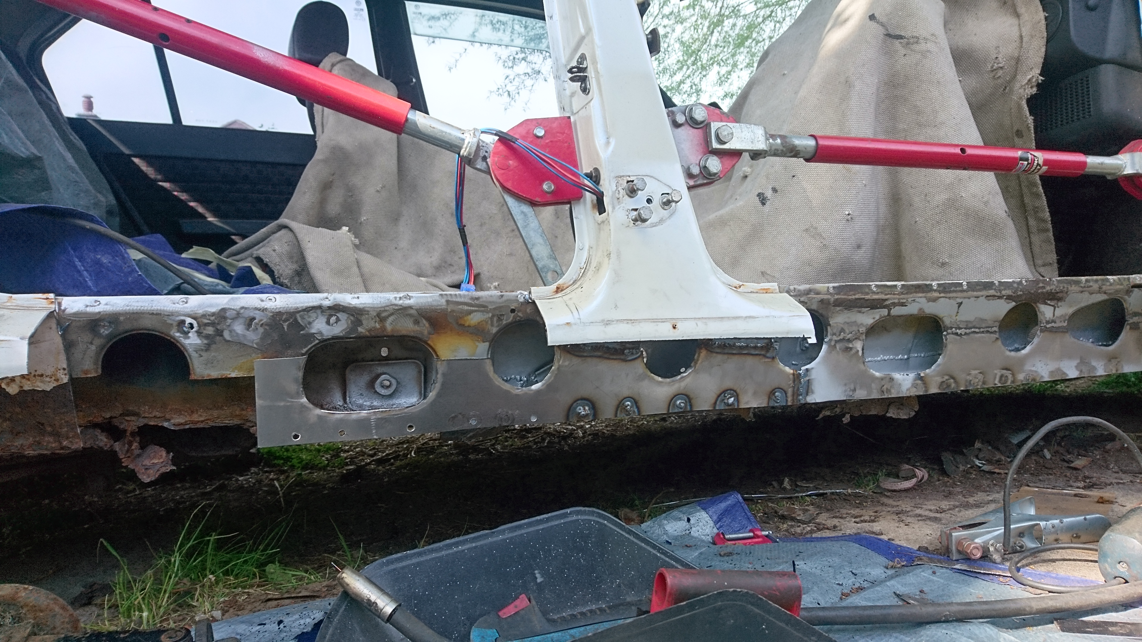

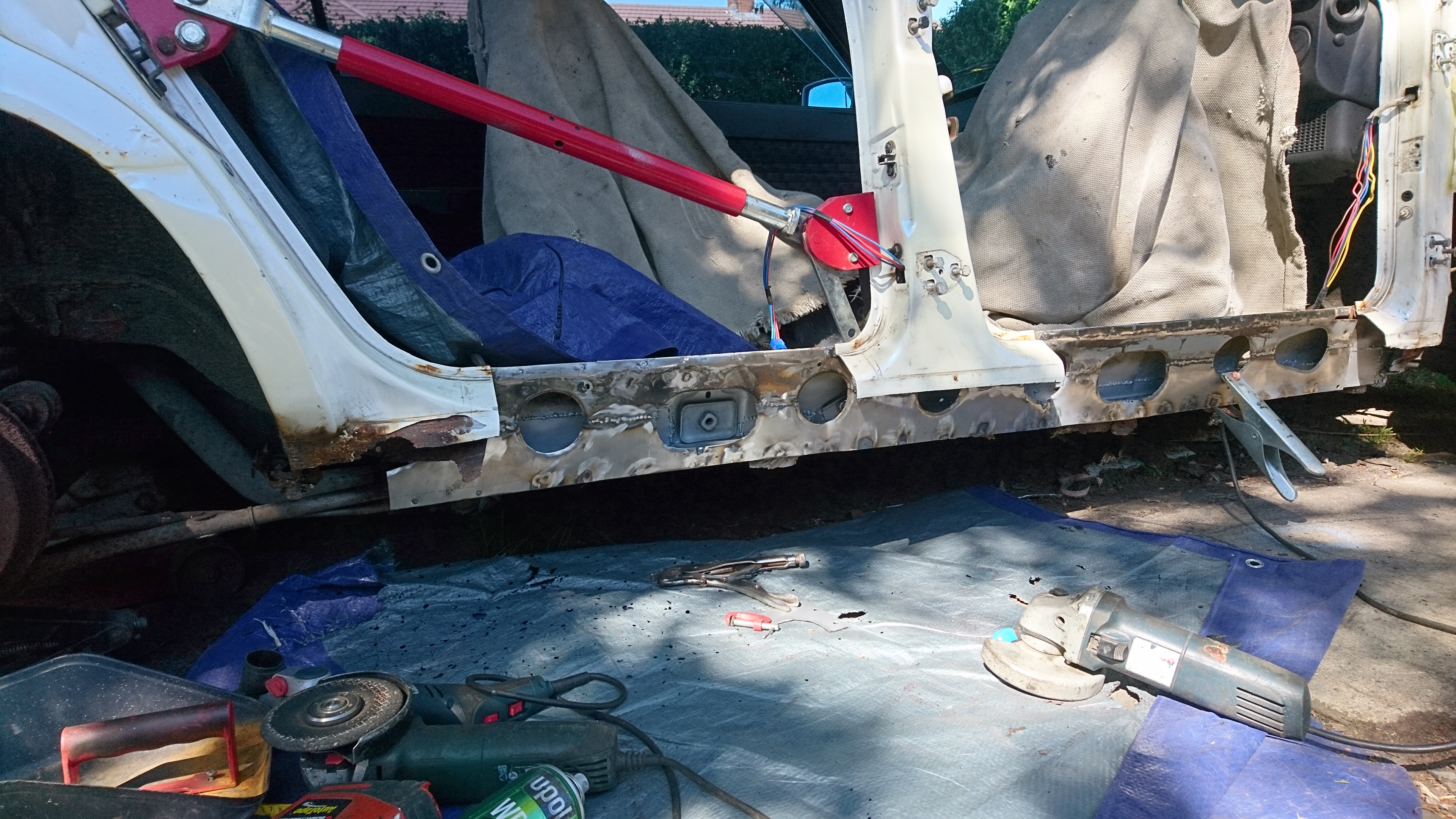

Todays progress

Posts: 1520
Re: 33 sills
Glad you've jacked it off the back axle! I'll sleep better now.
Whats the other side like?
