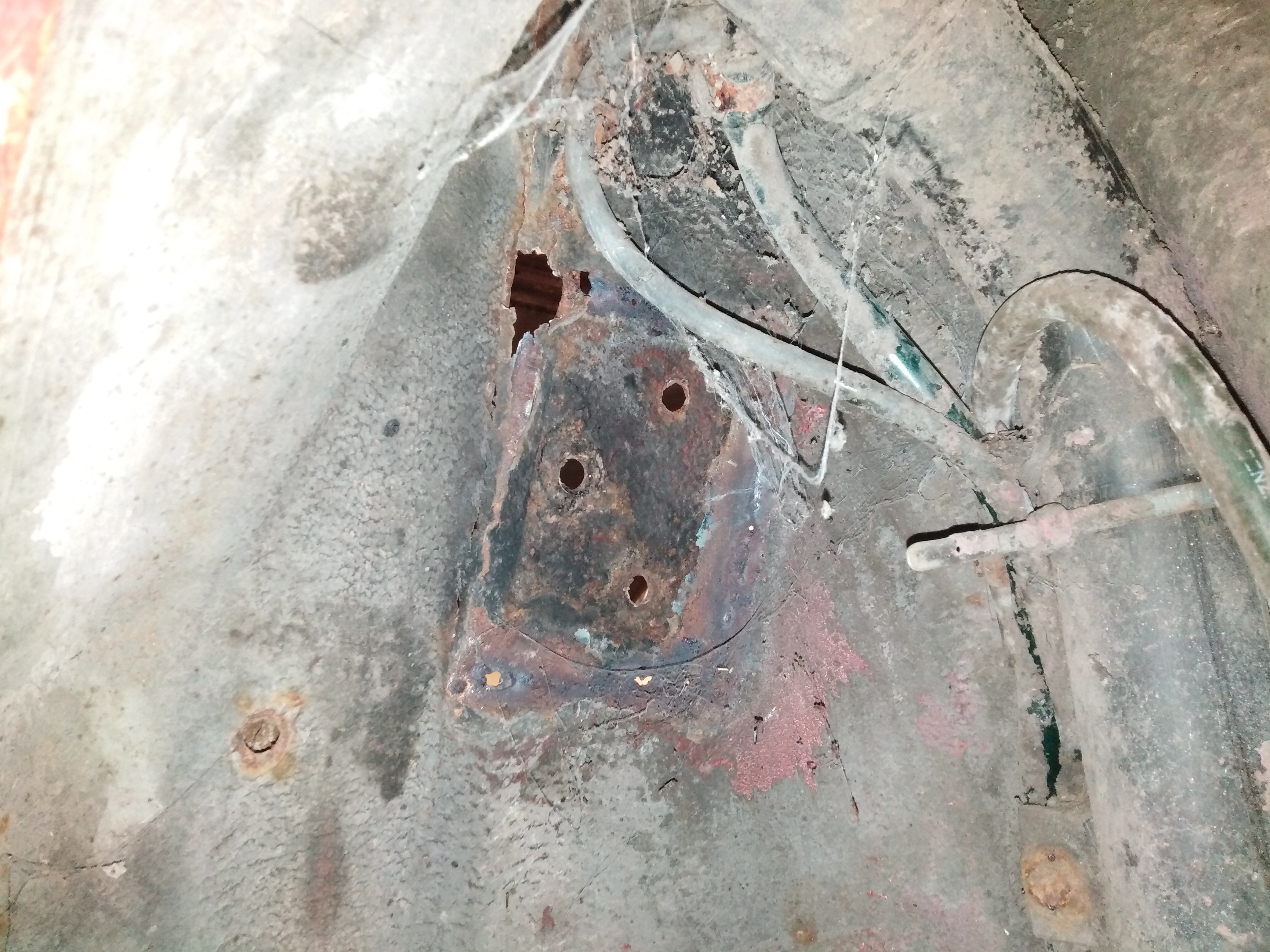

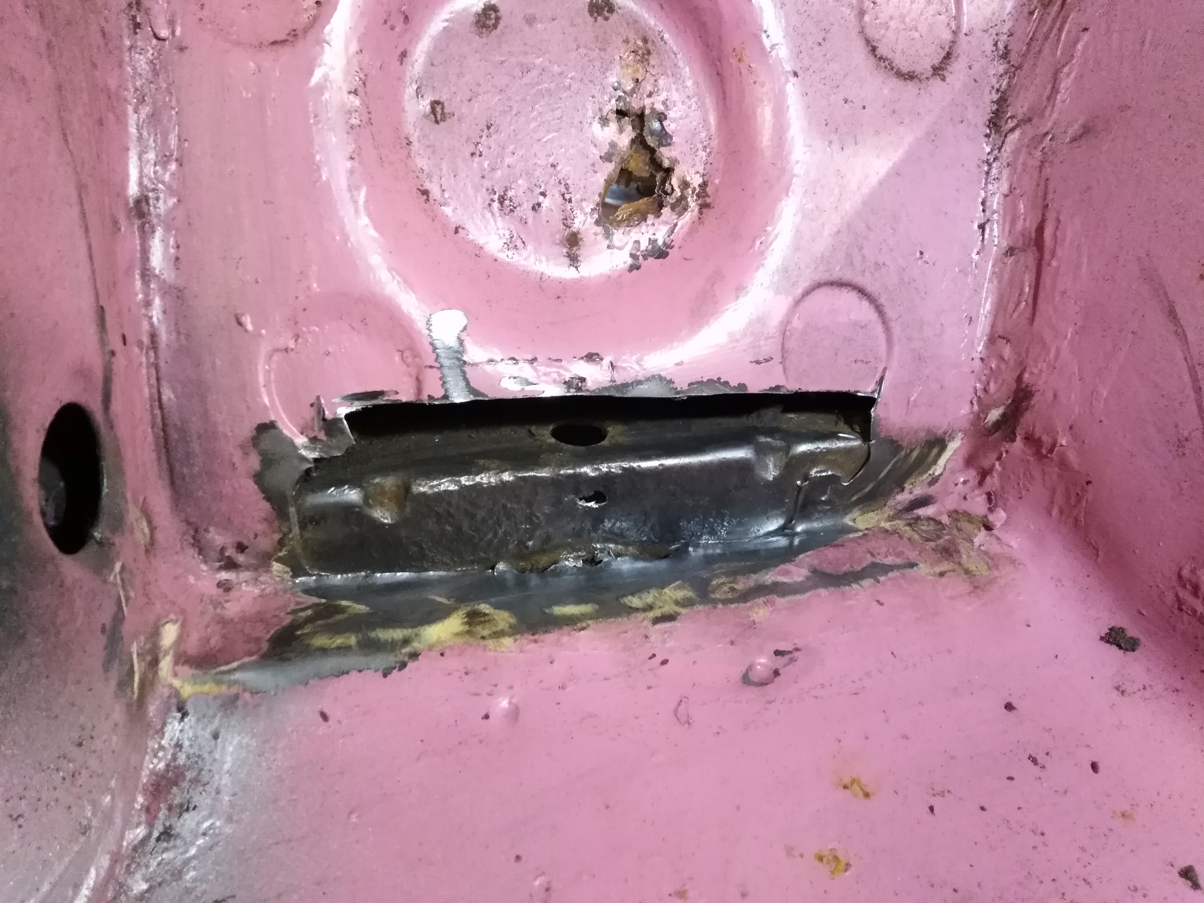

The drivers side cage mount behind the seat looked rough, a dig with the grinder soon found some holes
Re: Tims' Sud

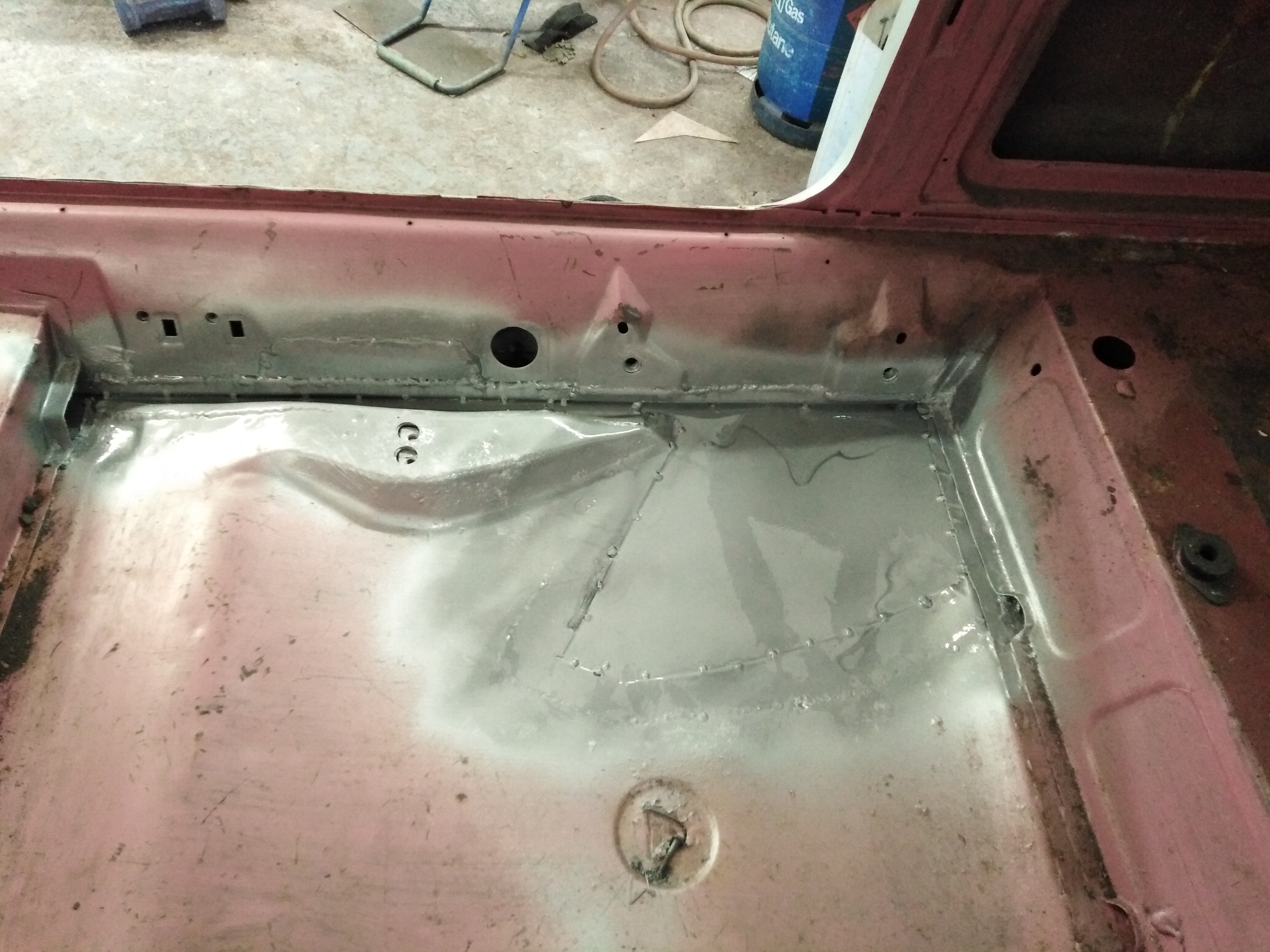

The repairs towards the rear were much the same, chop the rotten floor sections then the inner sill bits. Repair the sills then make floor pieces. But fiddly around the seat mount but all solid again.
Re: Tims' Sud
The floor section was made from slightly thicker steel again for a bit of added strength, it'll be getting a reinforcer section for the cage foot mount.

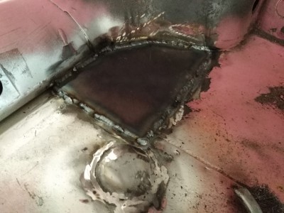

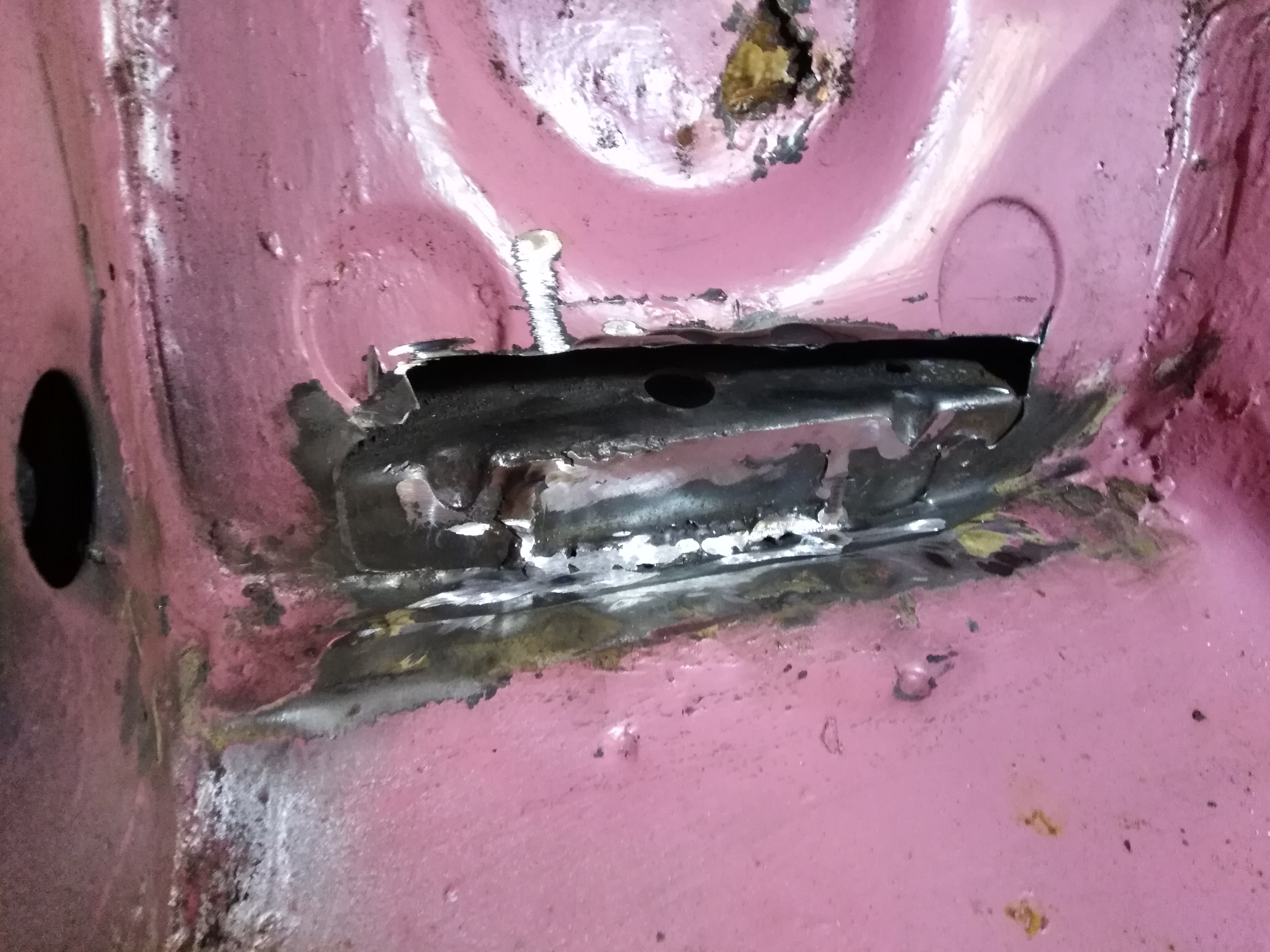

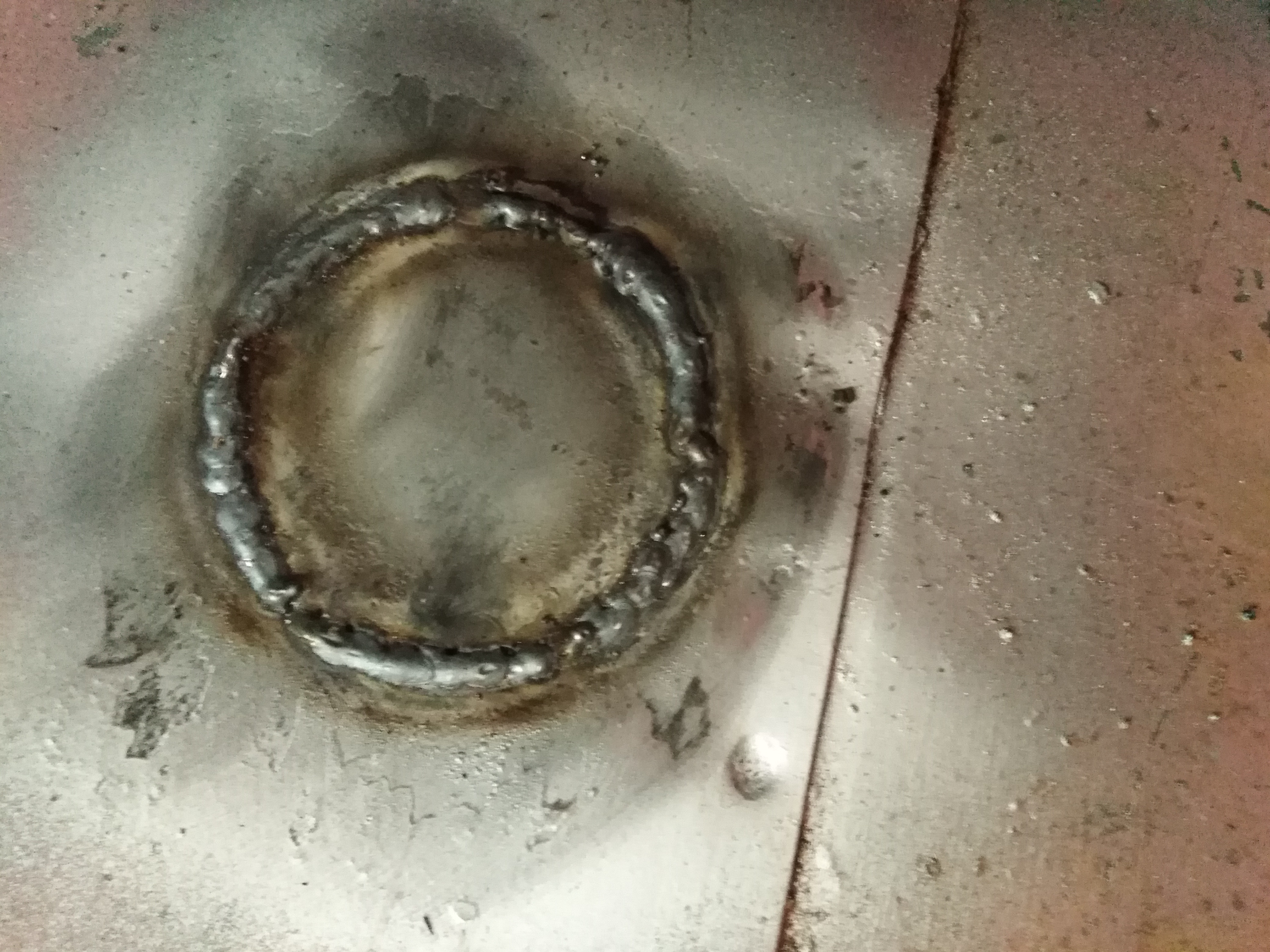

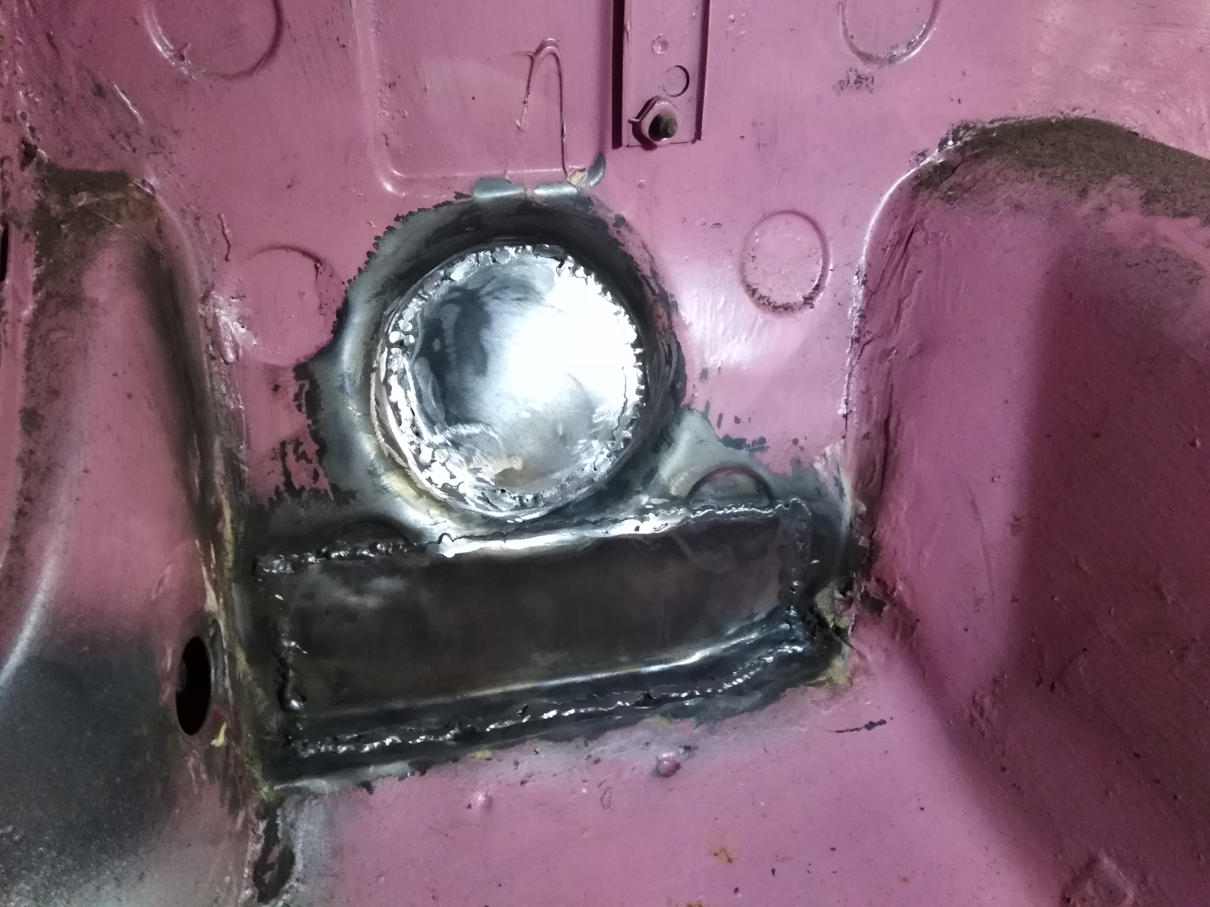

The passenger side was pretty much a repeat of the passenger side, just not quite as bad. Still needed the full length of the lower sill repairing but the front footwell was good enough to save.
The round hole got a plate cut out and seam welded in.

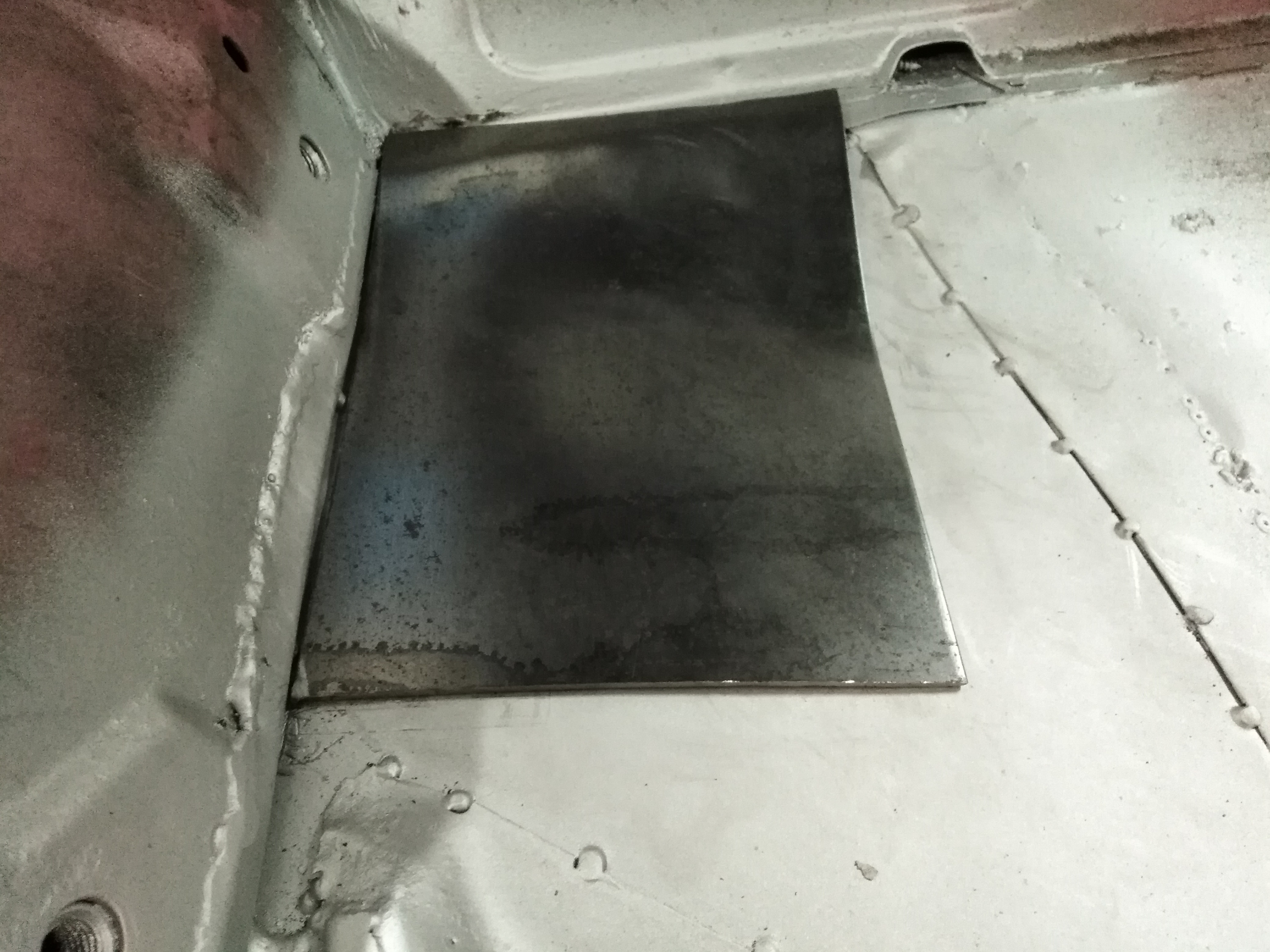

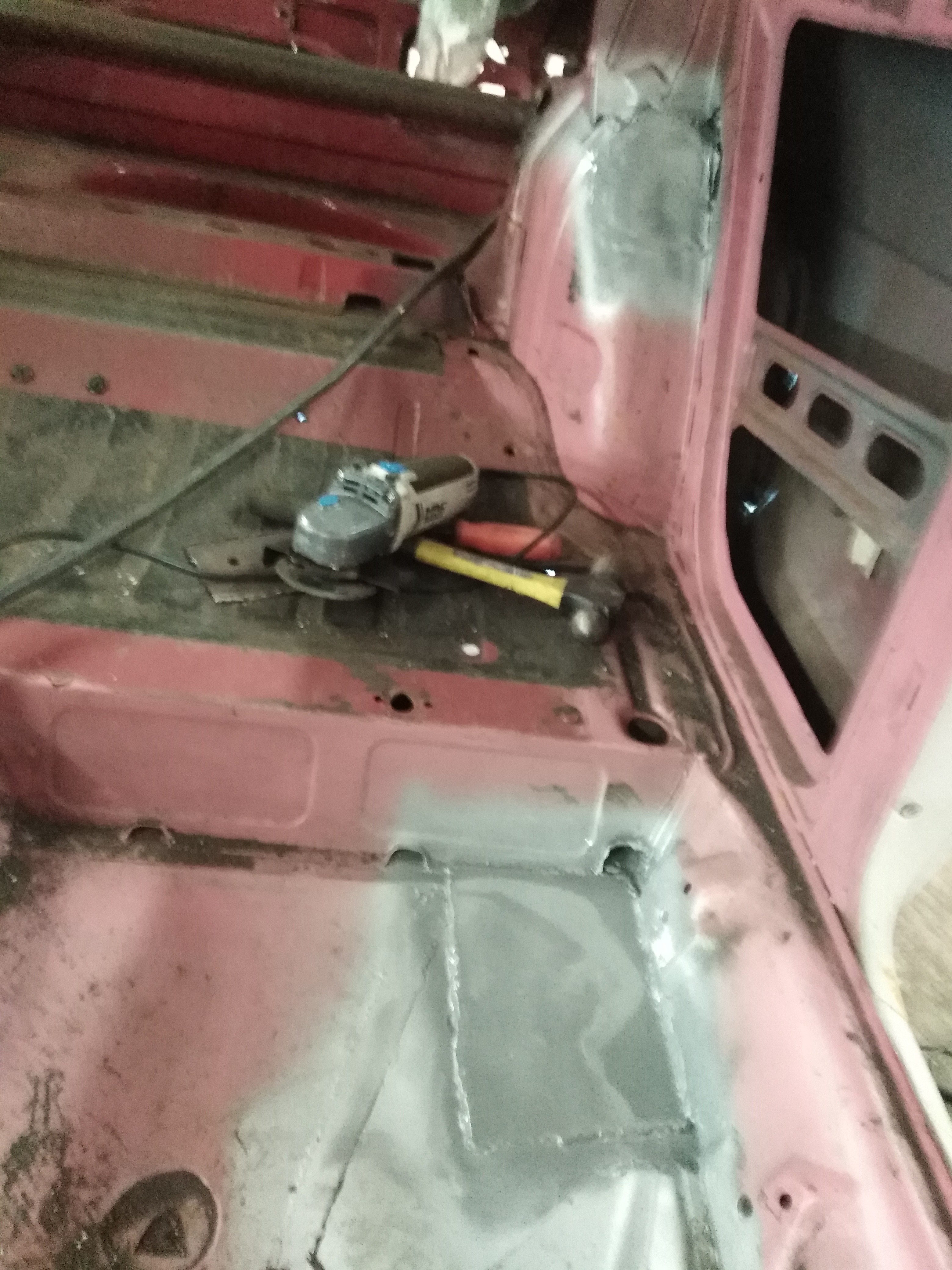

The roll cage reinforcing plates in 3mm got cut and shaped
Re: Tims' Sud
Drivers rear got its reinforcer in so the main 4 fixing points are done.
Re: Tims' Sud

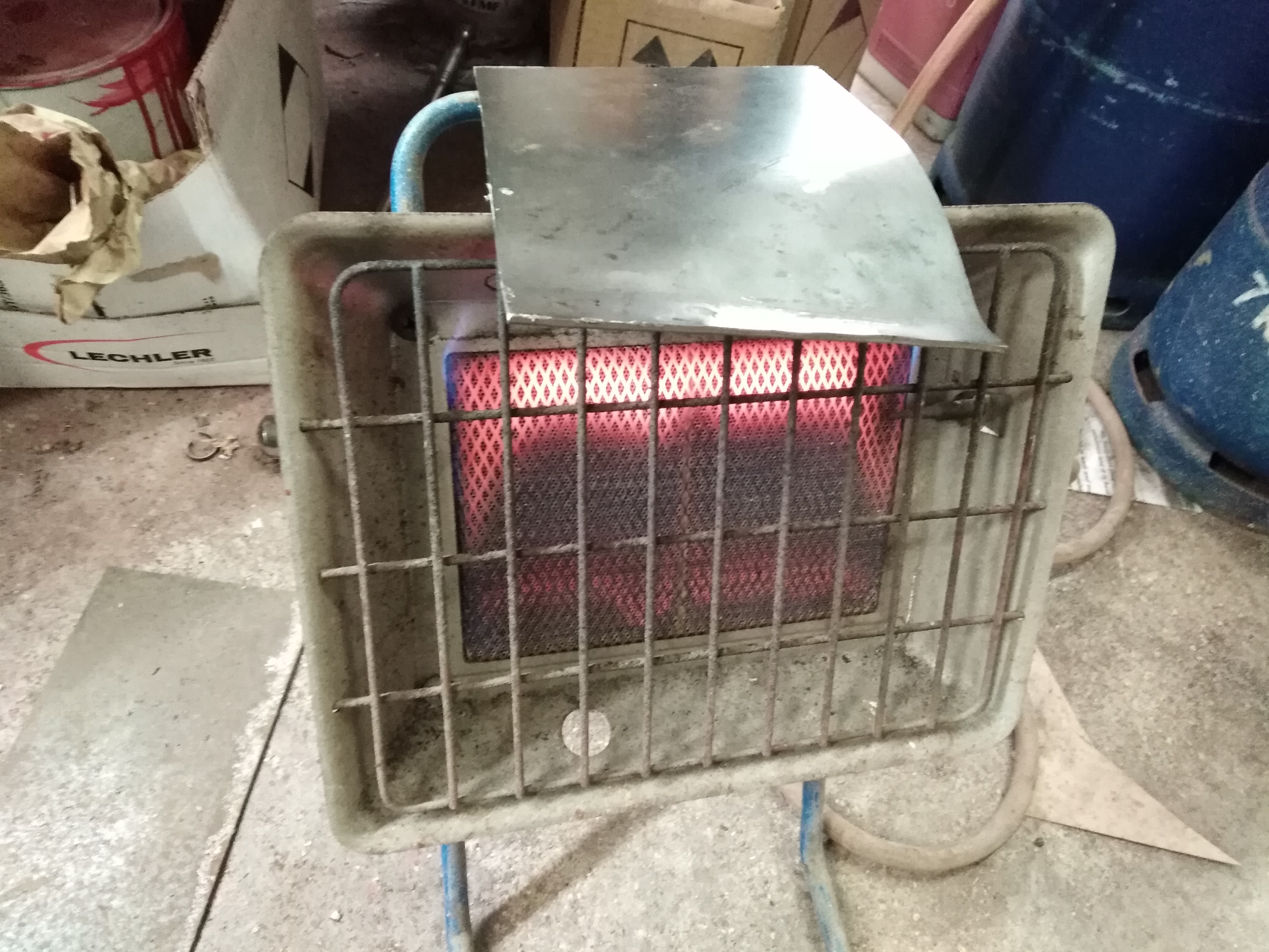

The rear bits needed to be shaped to follow the contours of the floor, manageable with the floor material but the 3mm stuff is tough to shape.
I came up with the plan to warm it up to ease things, my little gas fire was given the task. Not sure how much it helped but it made making the shapes possible. Had to be quick handling it though even with welding gauntlets!

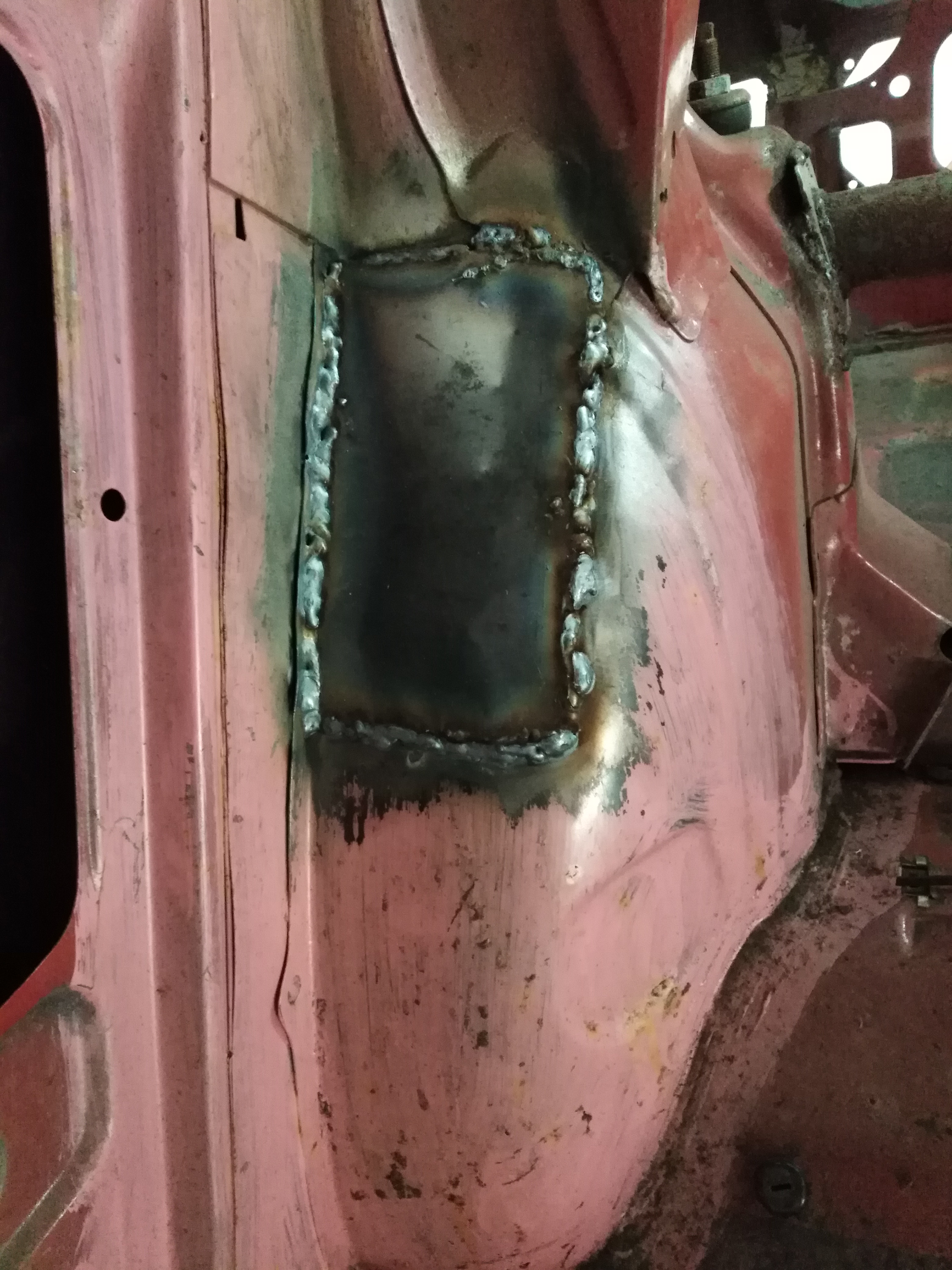

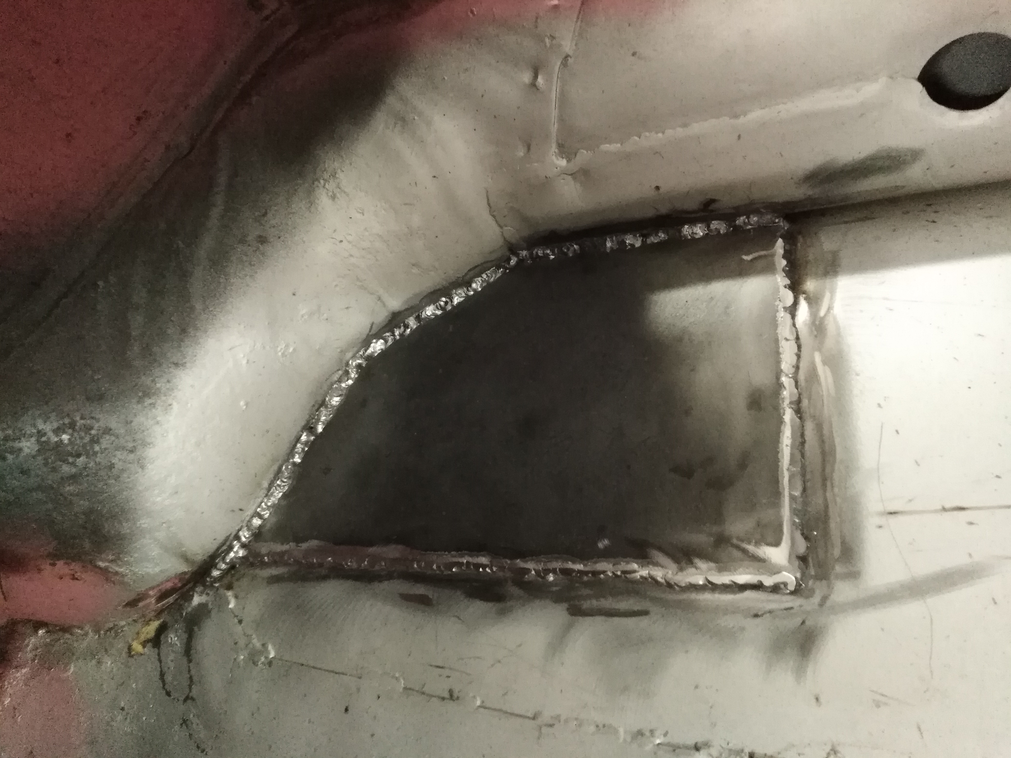

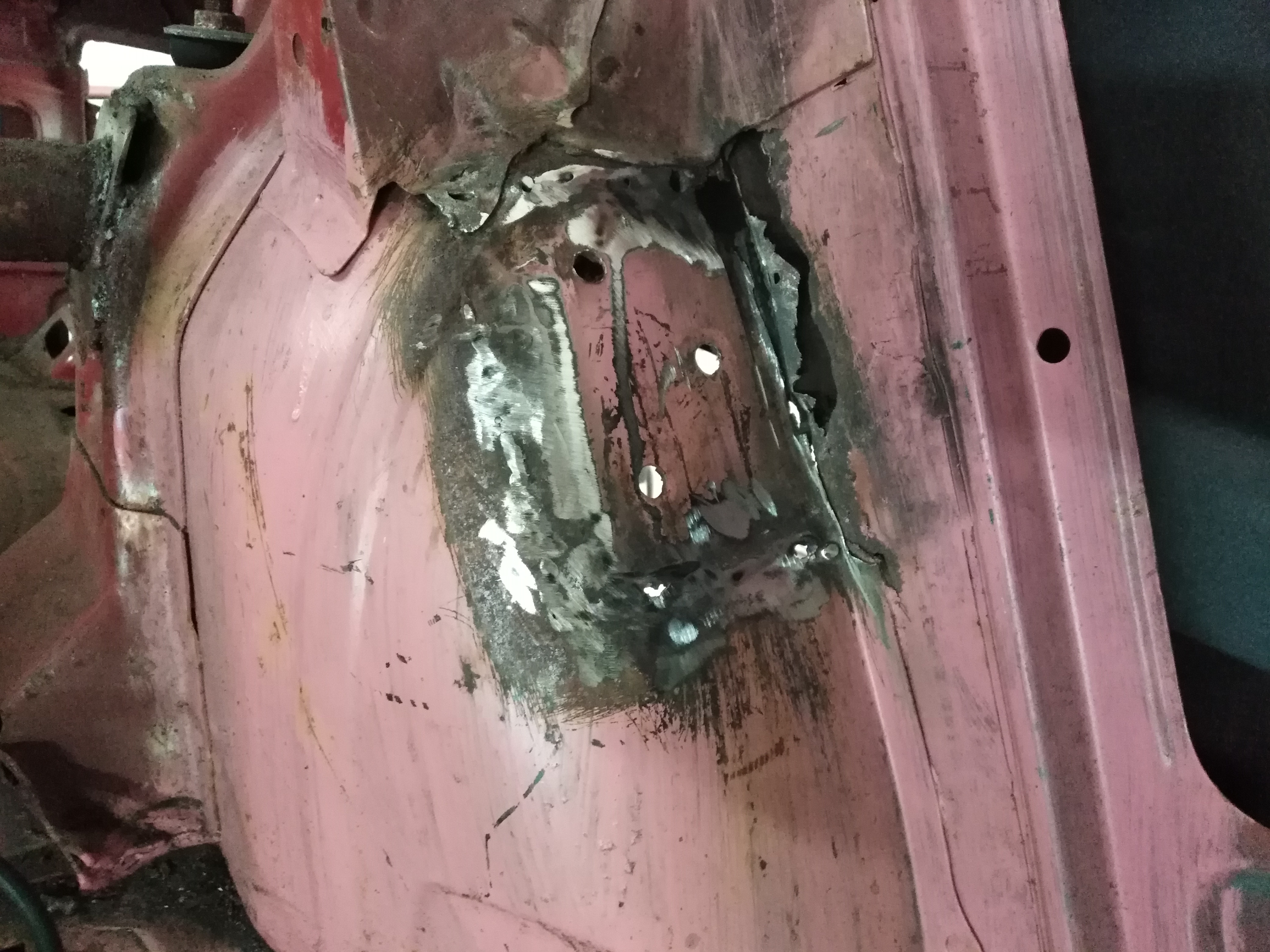

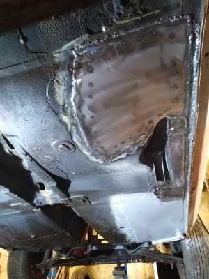

Where the cage meets the rear wheel arches looked a mess, plus the bolt holes don't match the cage that's to go in.
Although the arch itself wasn't too bad once the rusty reinforcing plate was cut off there was some rust to remove so worth chopping out even if the holes had been usable.
Arch got a new piece let in. Next visit I'll repair it where it meets the inner quarter panel then make a piece for the reinforcing plates.

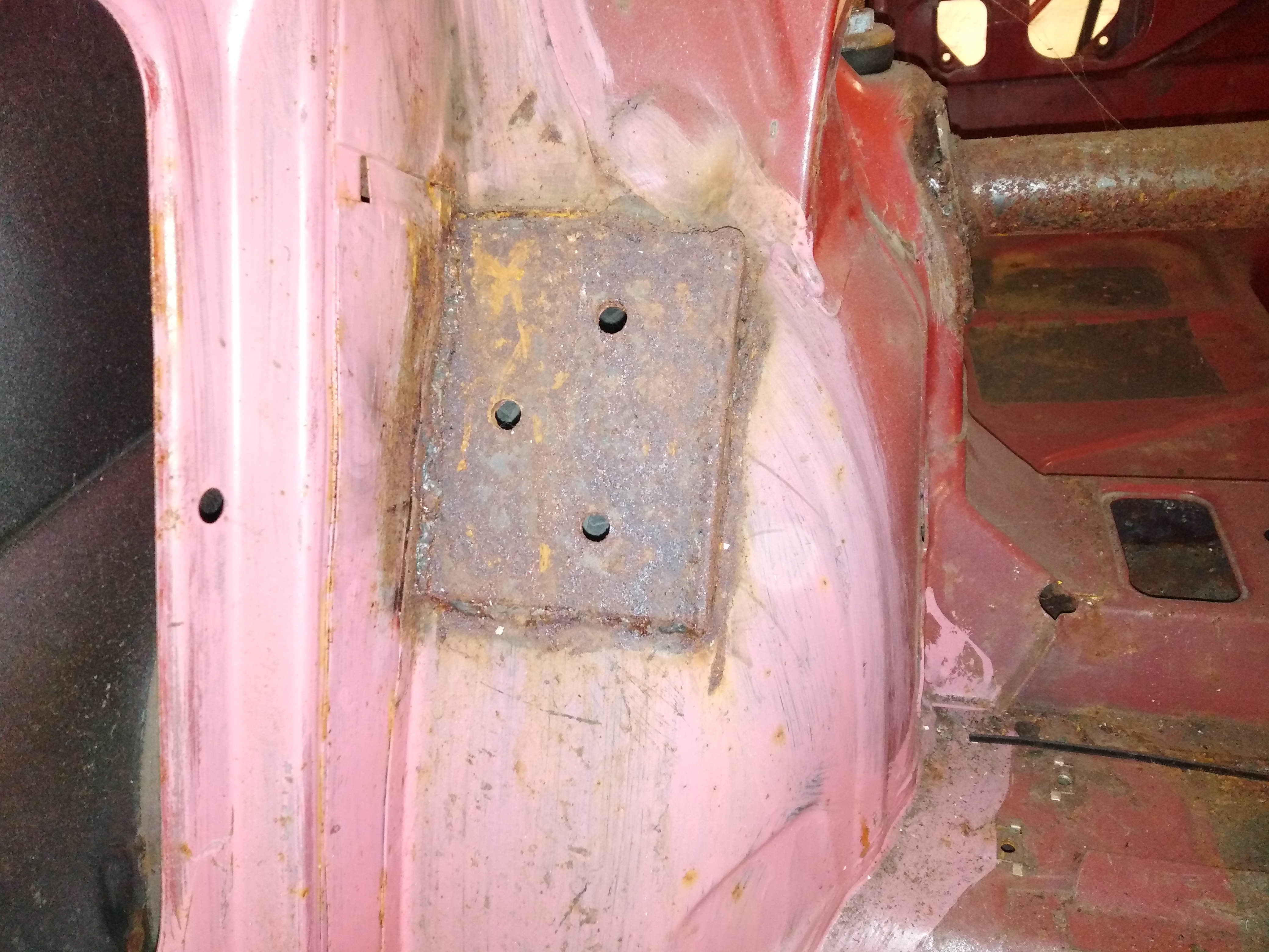

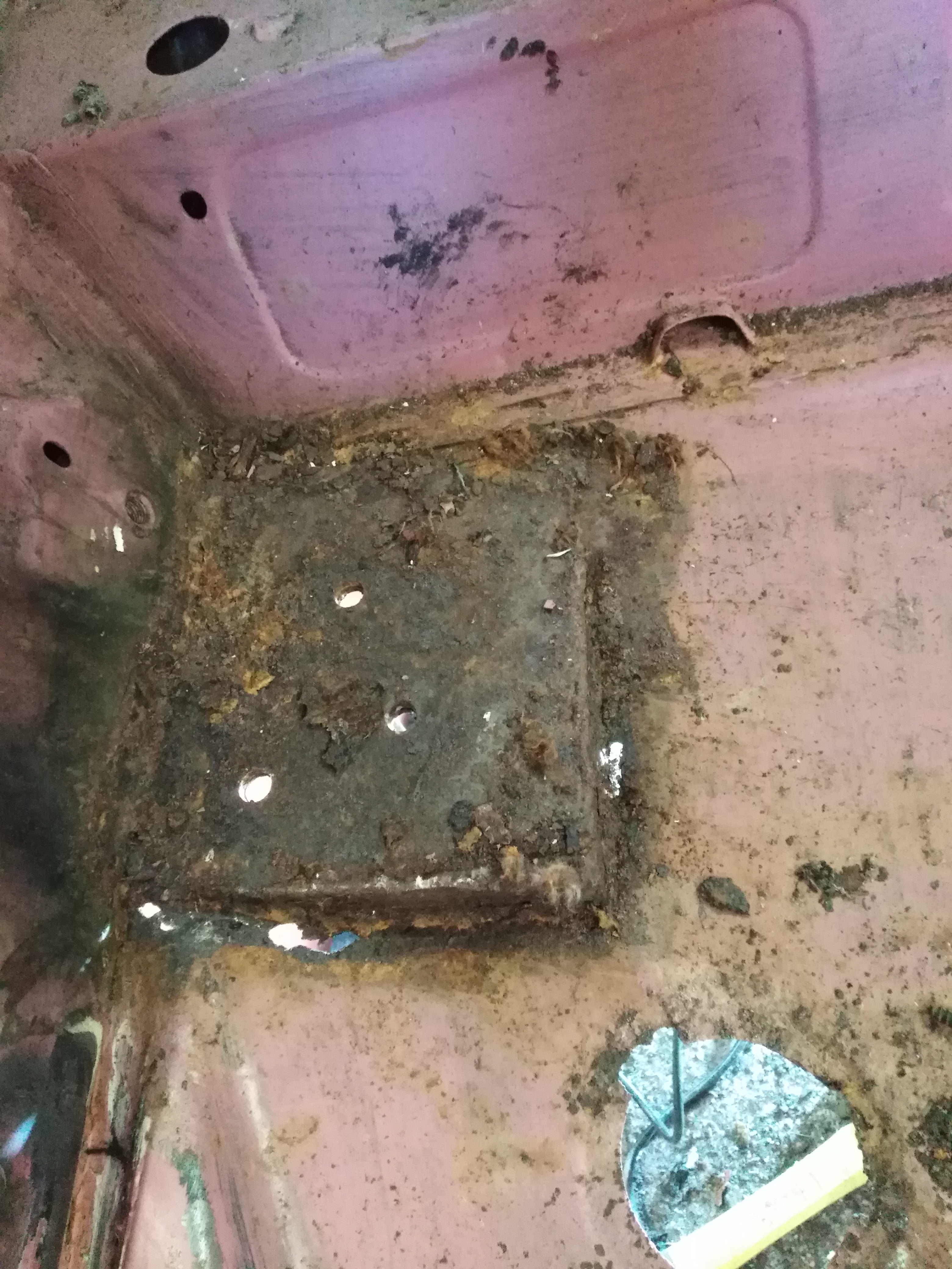

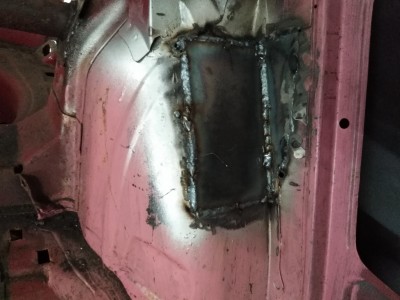

Passenger side got a little extra repair patch then the reinforcing plate welded in this afternoon.
Drivers side thankfully was in much better condition under the old plate, arch didn't need repairing.
Reinforcer plate all that was needed.
Made up some plates for the underside, next time I'll place the cage in and get all the holes drilled. Be pleased to move onto a different part to weld!

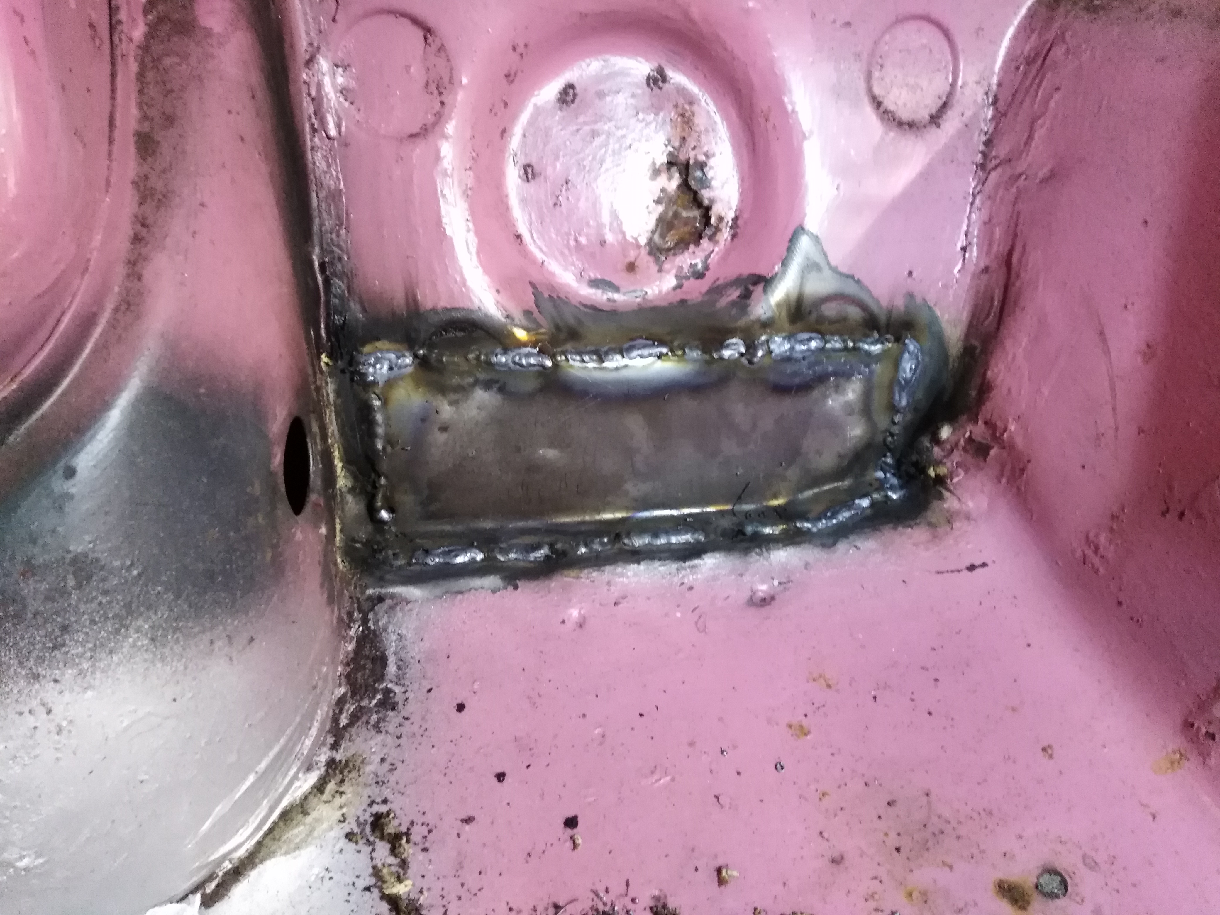

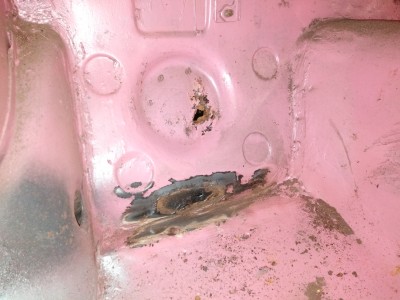

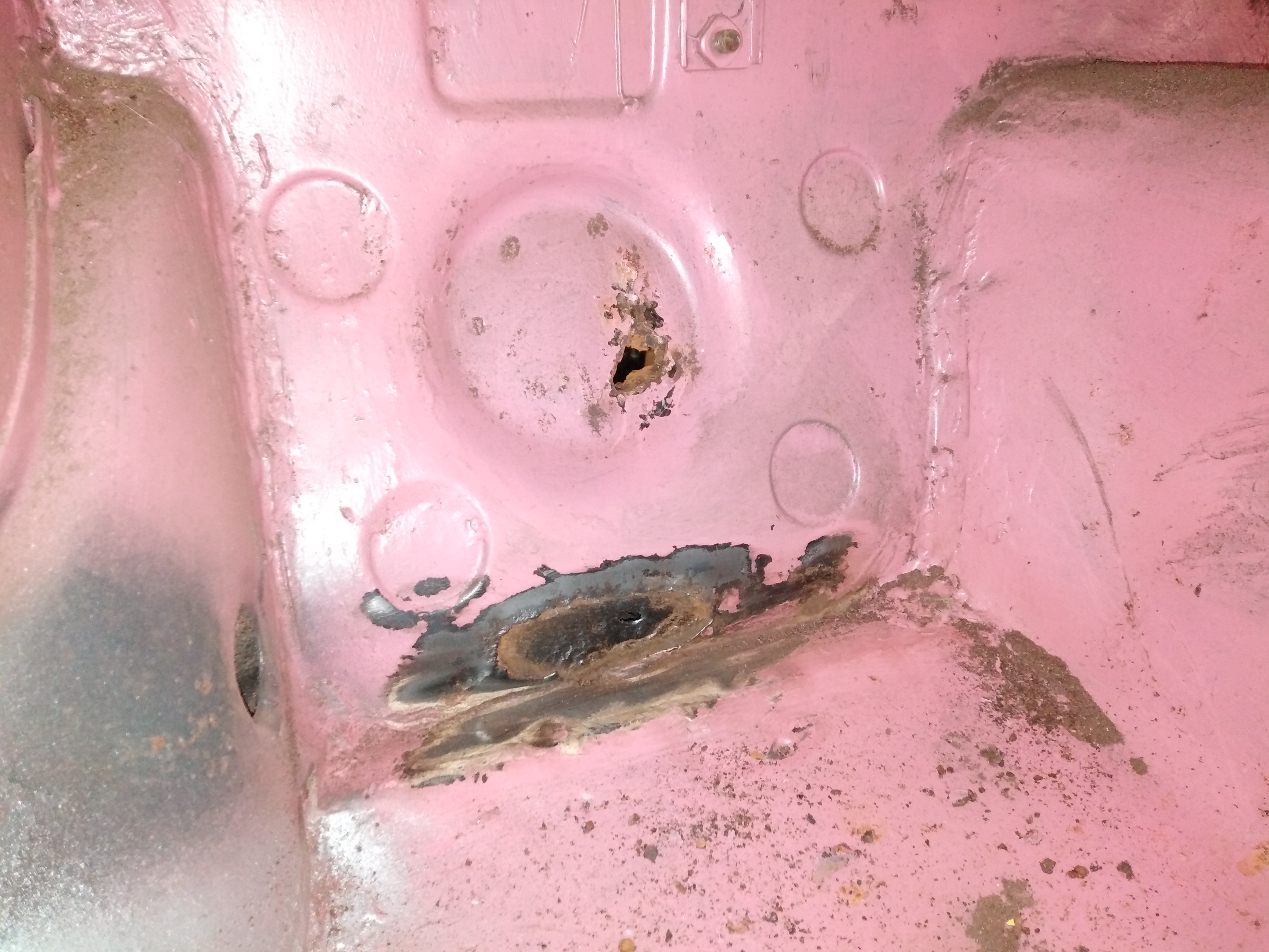

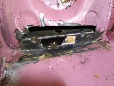

There was a suspect area in the passenger footwell, looked like trouble.
Decided I'd better get back to it this afternoon, year is nearly over already..
Re: Tims' Sud

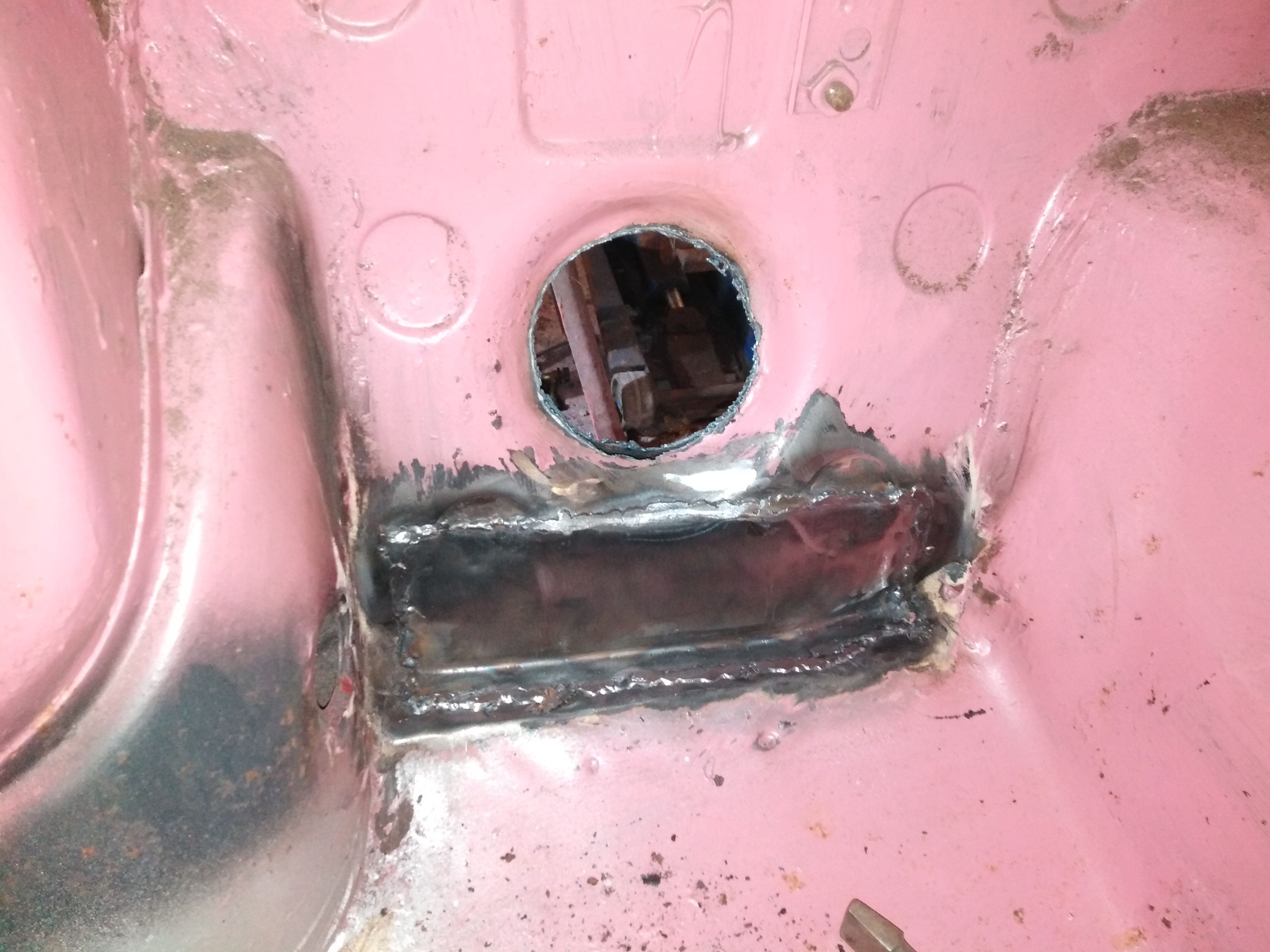

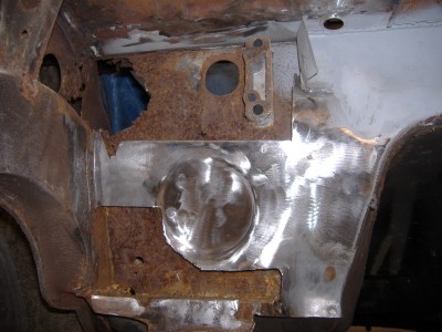

The inner skin got cut away to reveal the main source of the corrosion, this bit is actually the reinforcing section where the suspension arm mounts so needs to be free of rust..
Re: Tims' Sud

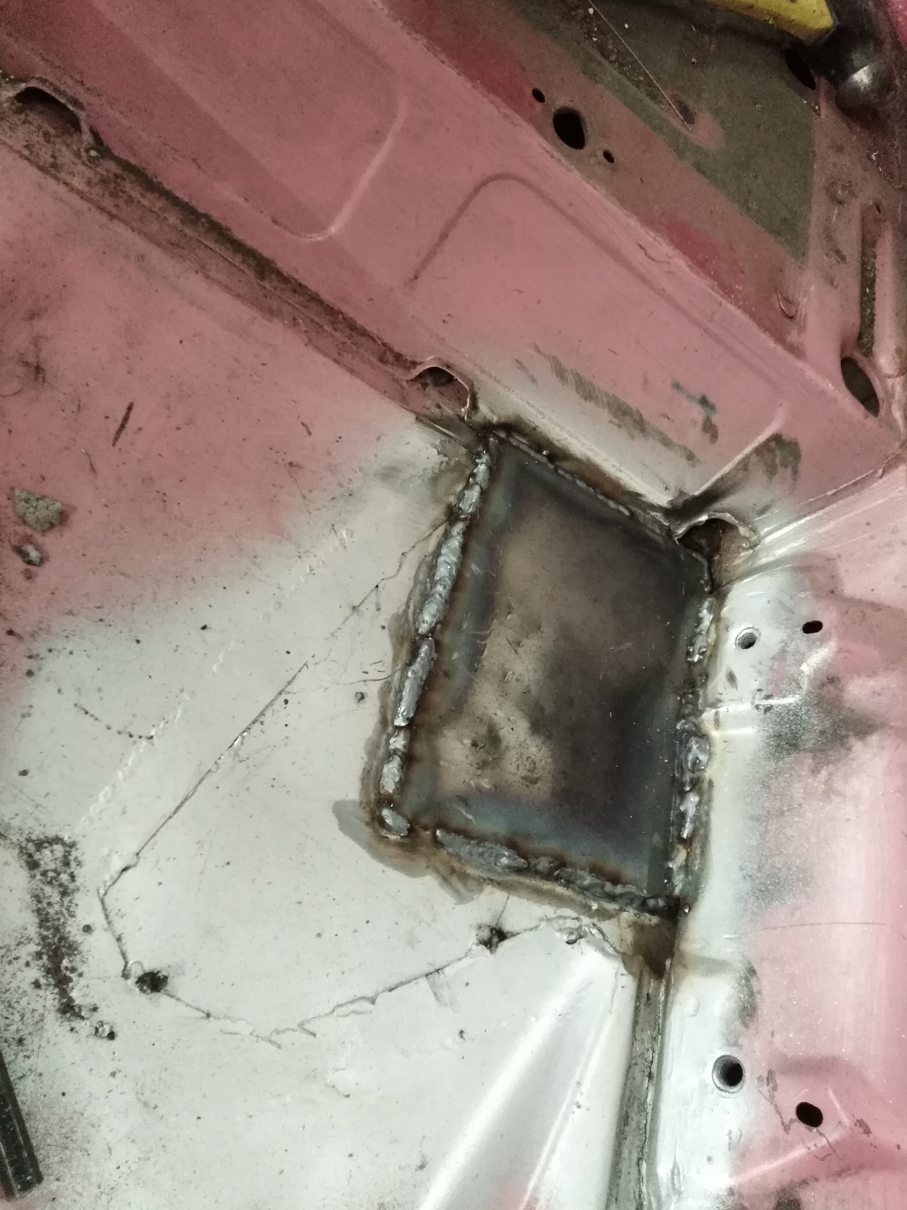

Some 2mm steel cut to fill the hole and welded in..
Re: Tims' Sud
Inner skin then welded back over..

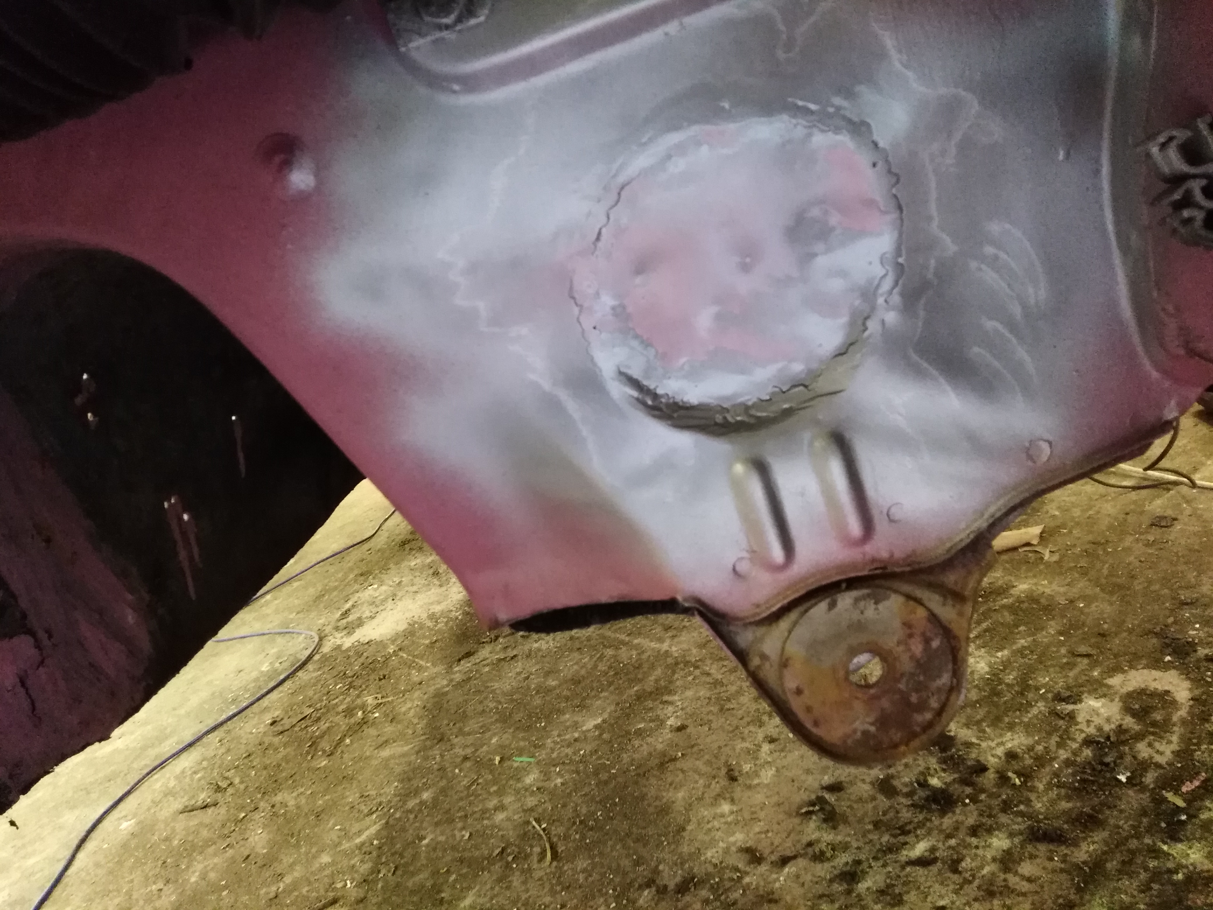

The round indentation above also had some corrosion, double skinned there too, both layers got the plasma cutter treatment..
Re: Tims' Sud
Circular plates cut out for inside the car and in the engine bay...

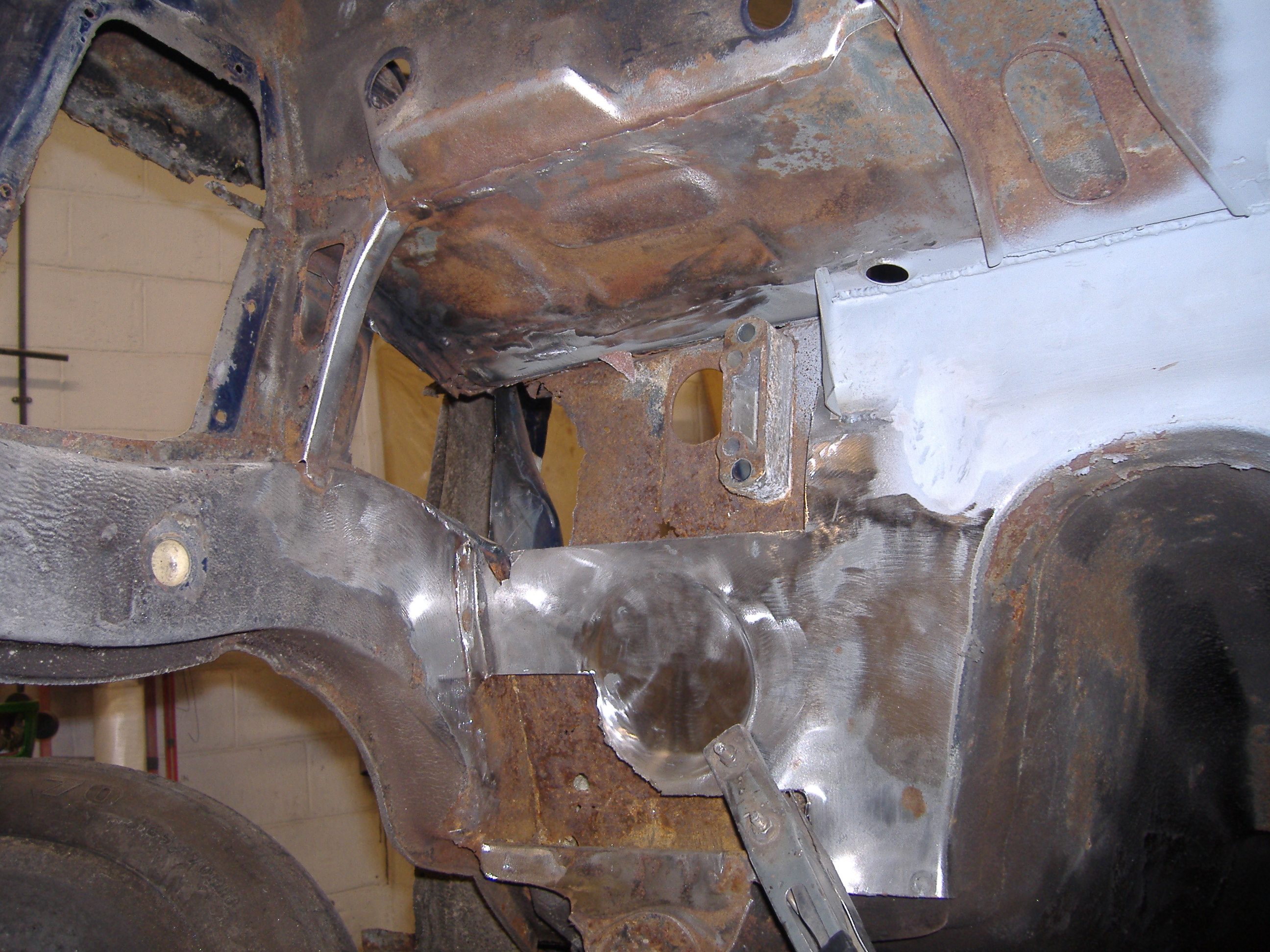

Nice job Kev,
Had to smile as mine was the other way around. I worked around the round bits.
