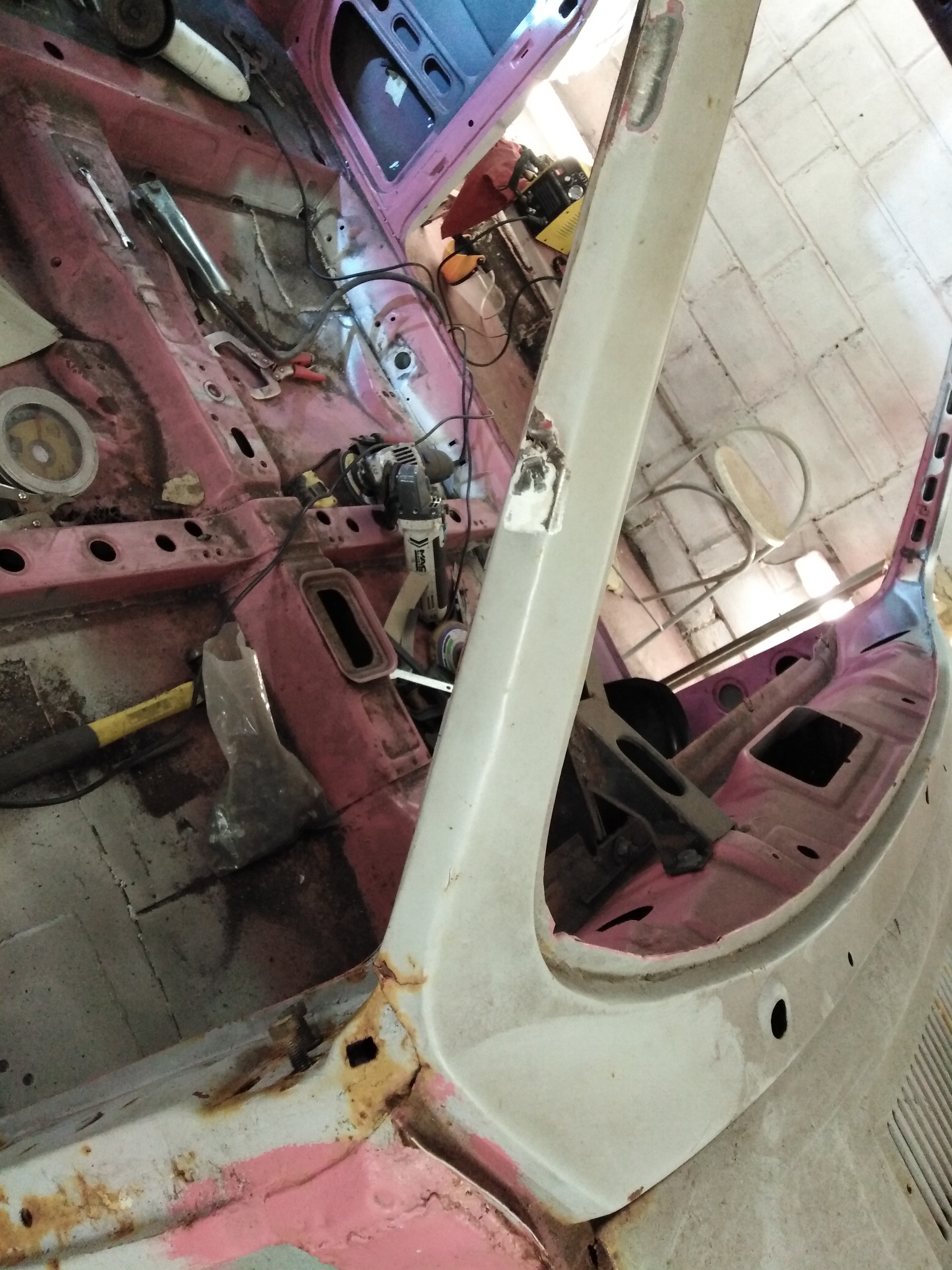

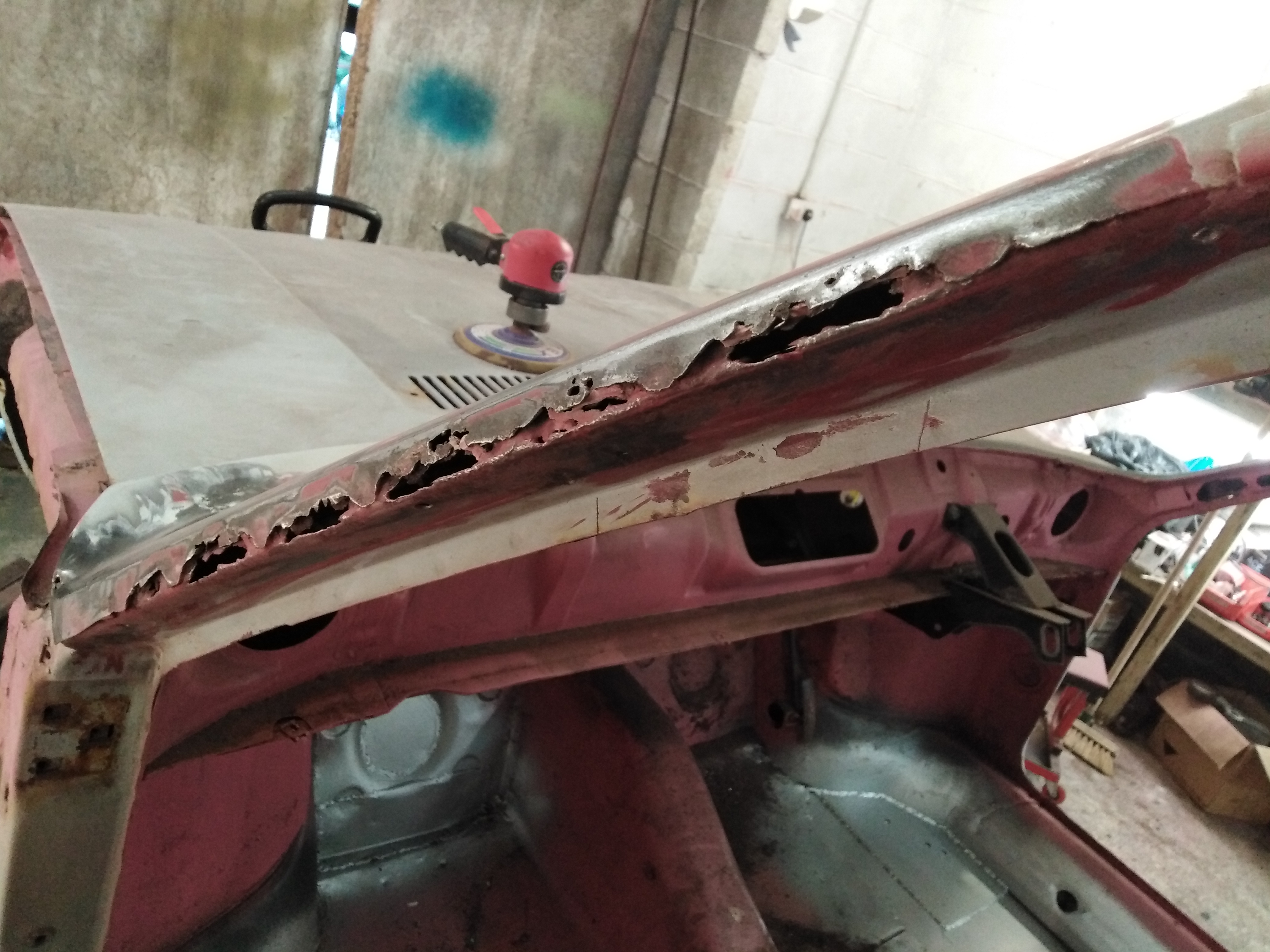

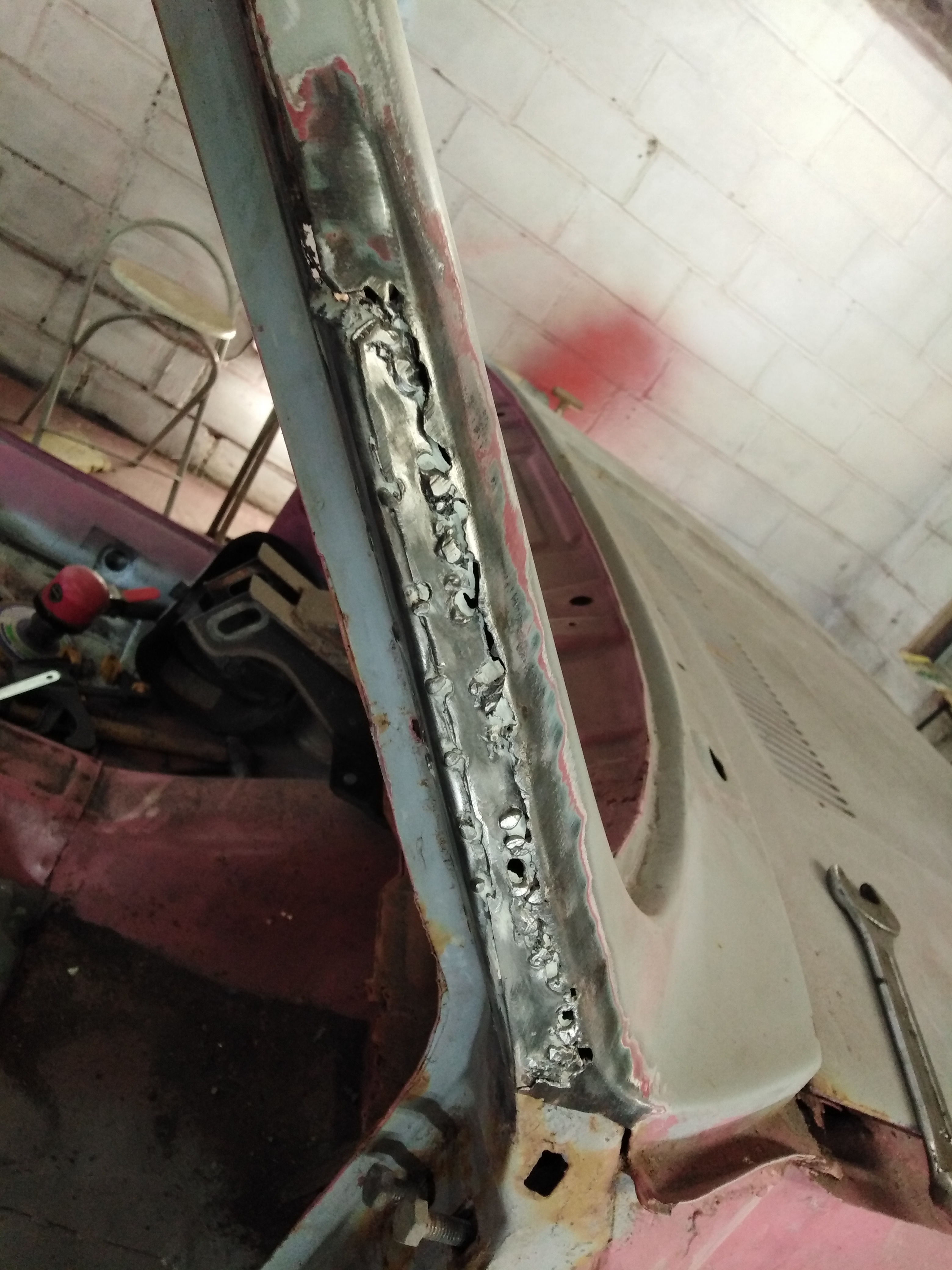

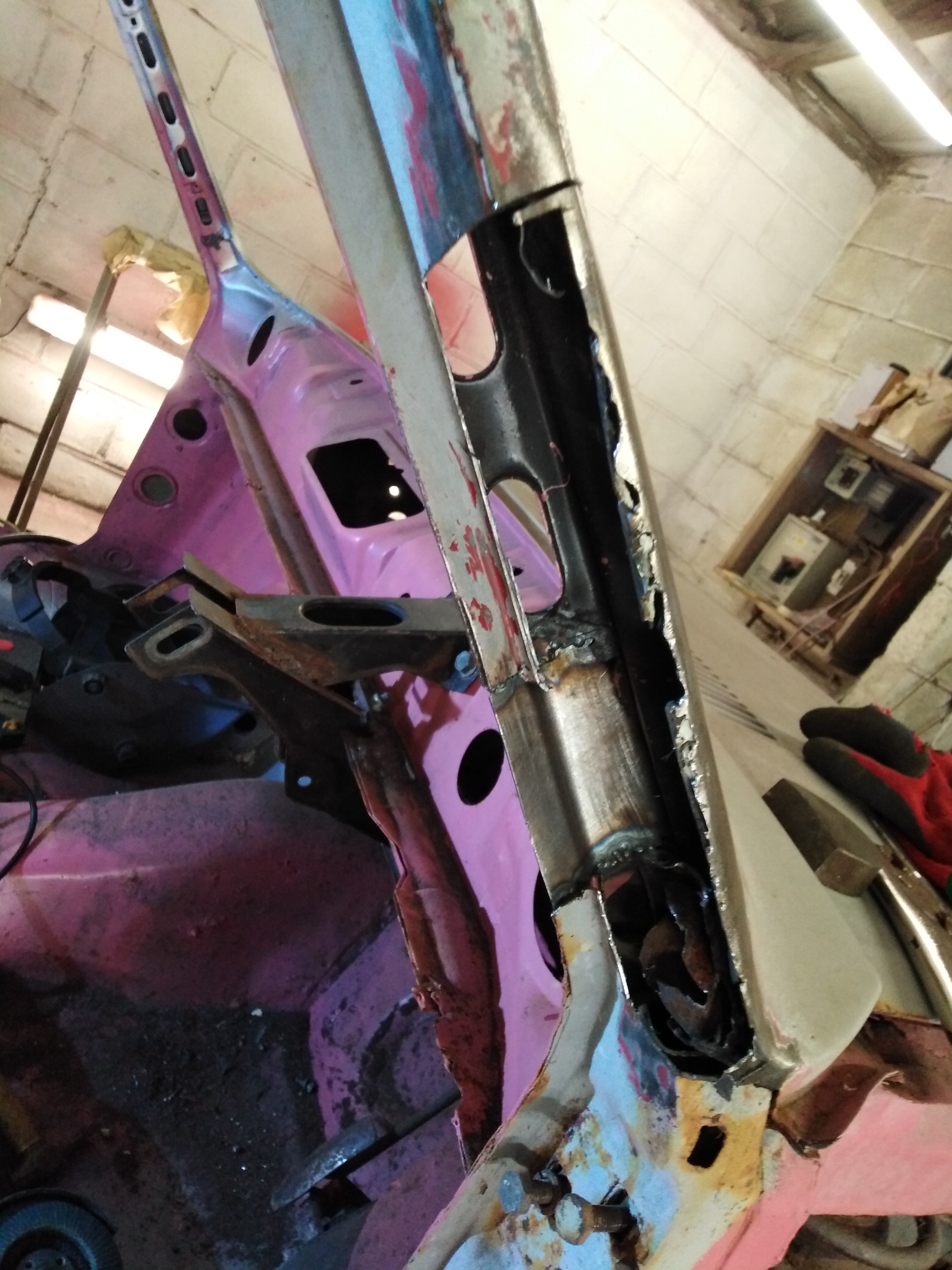

The passenger A pillar had some rust coming through, the knotted wheel soon dug out any weakness
Re: Tims' Sud

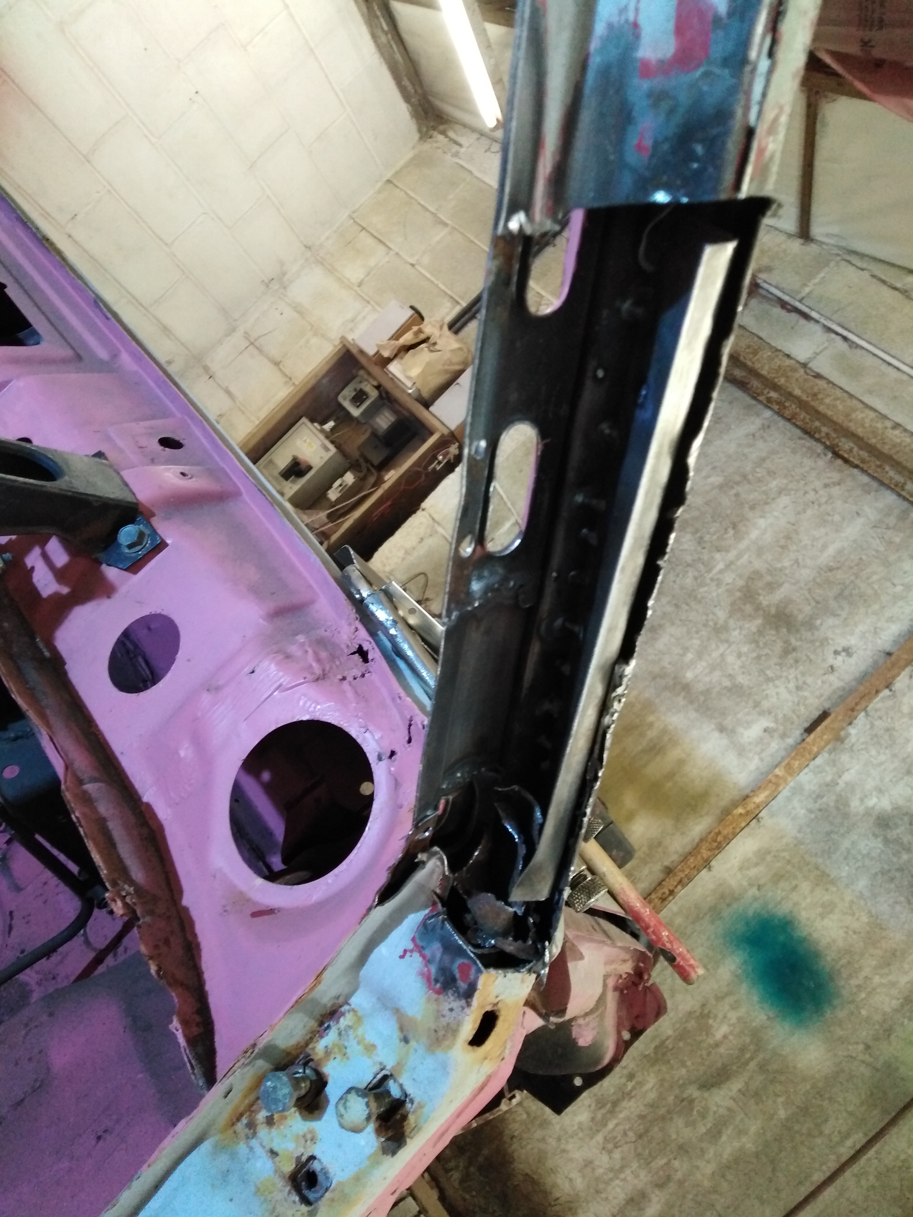

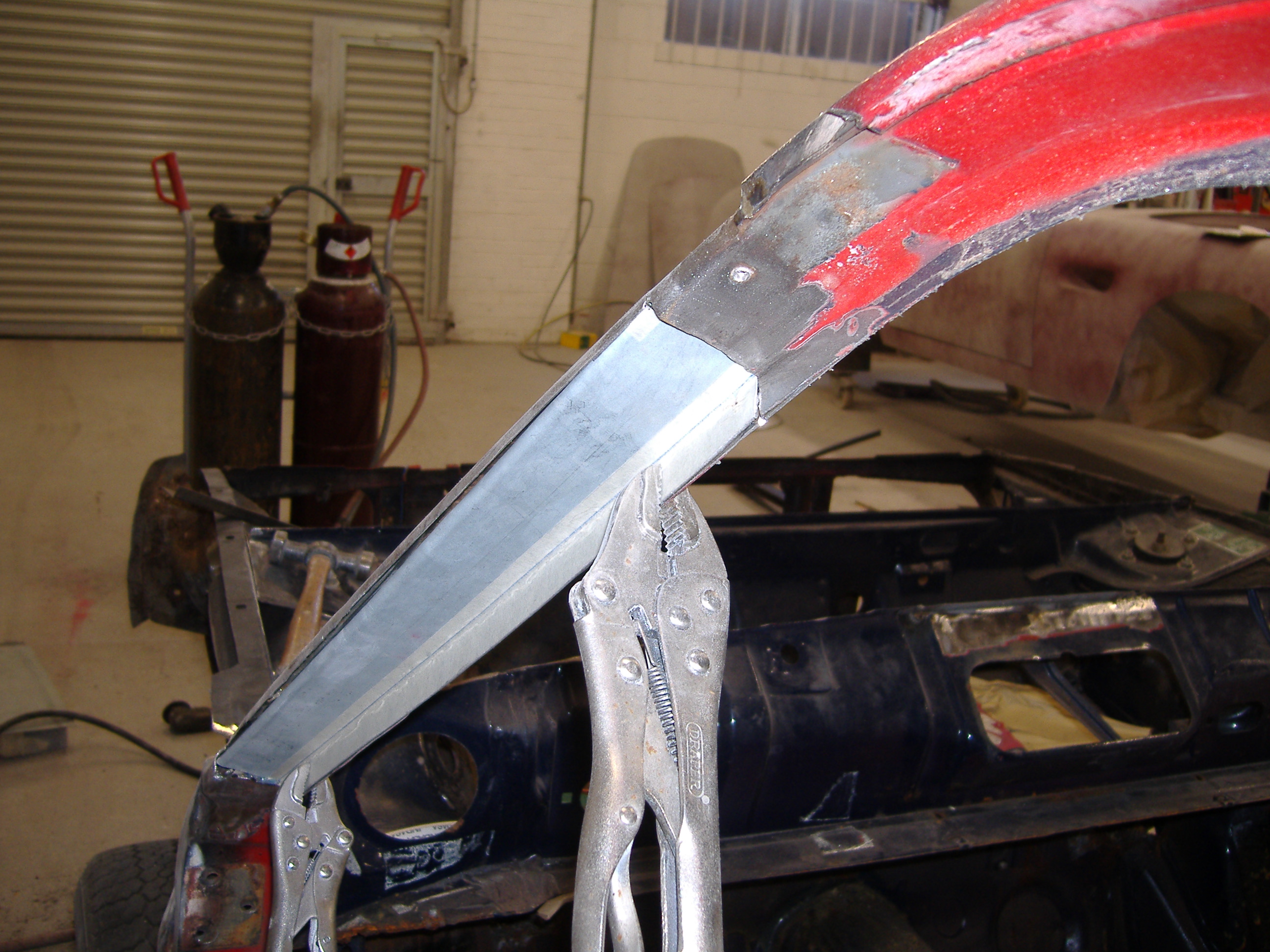

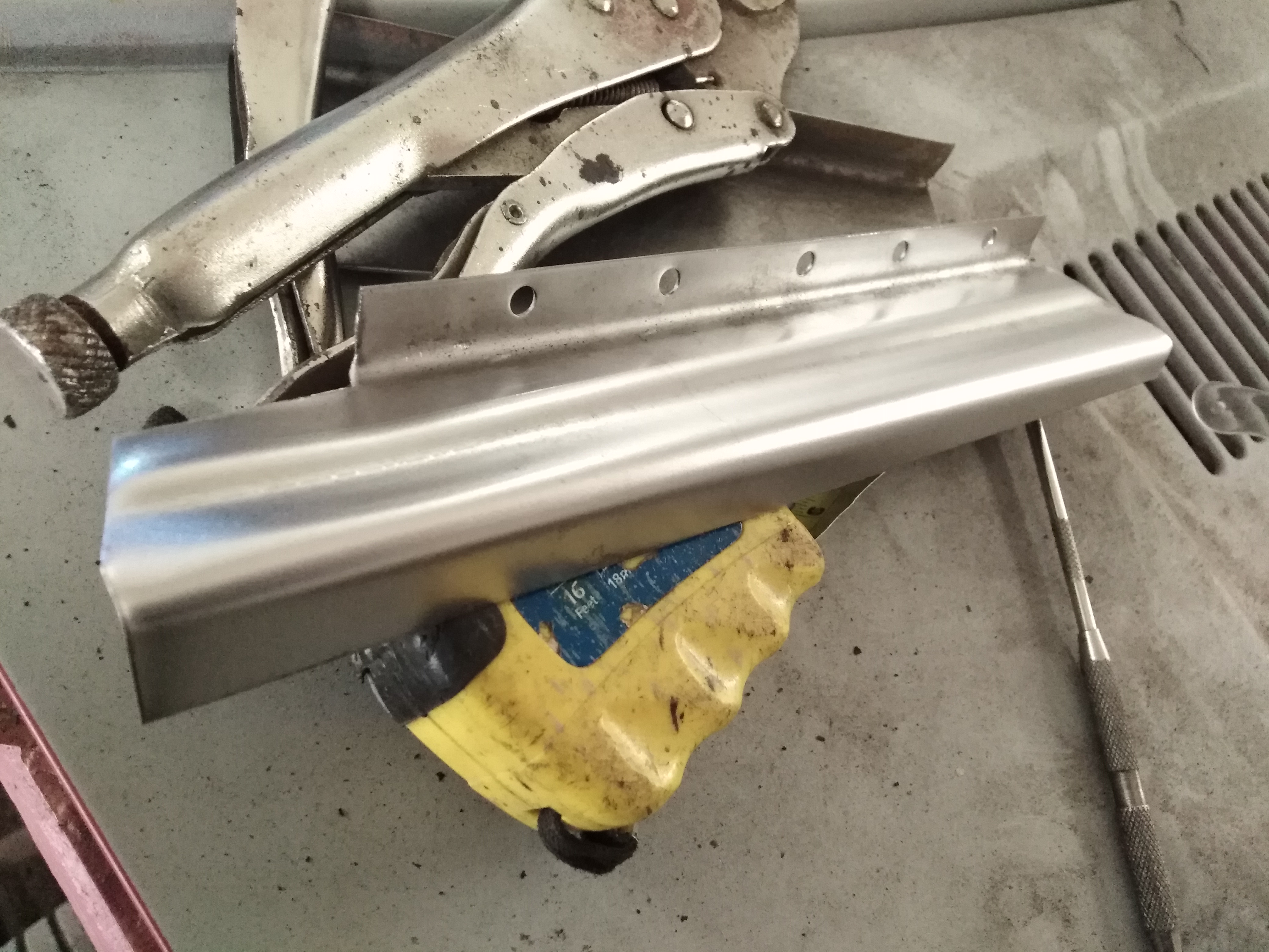

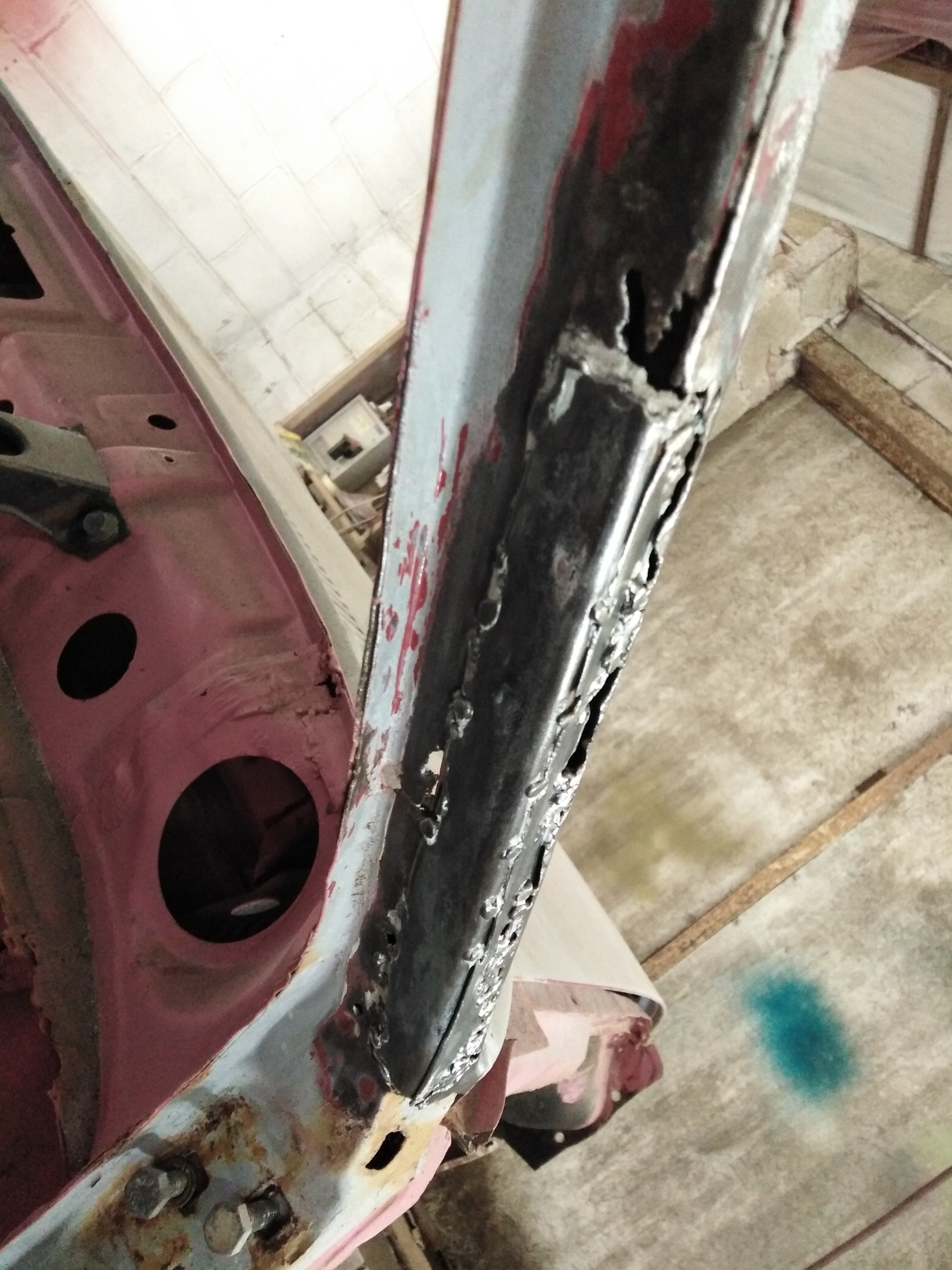

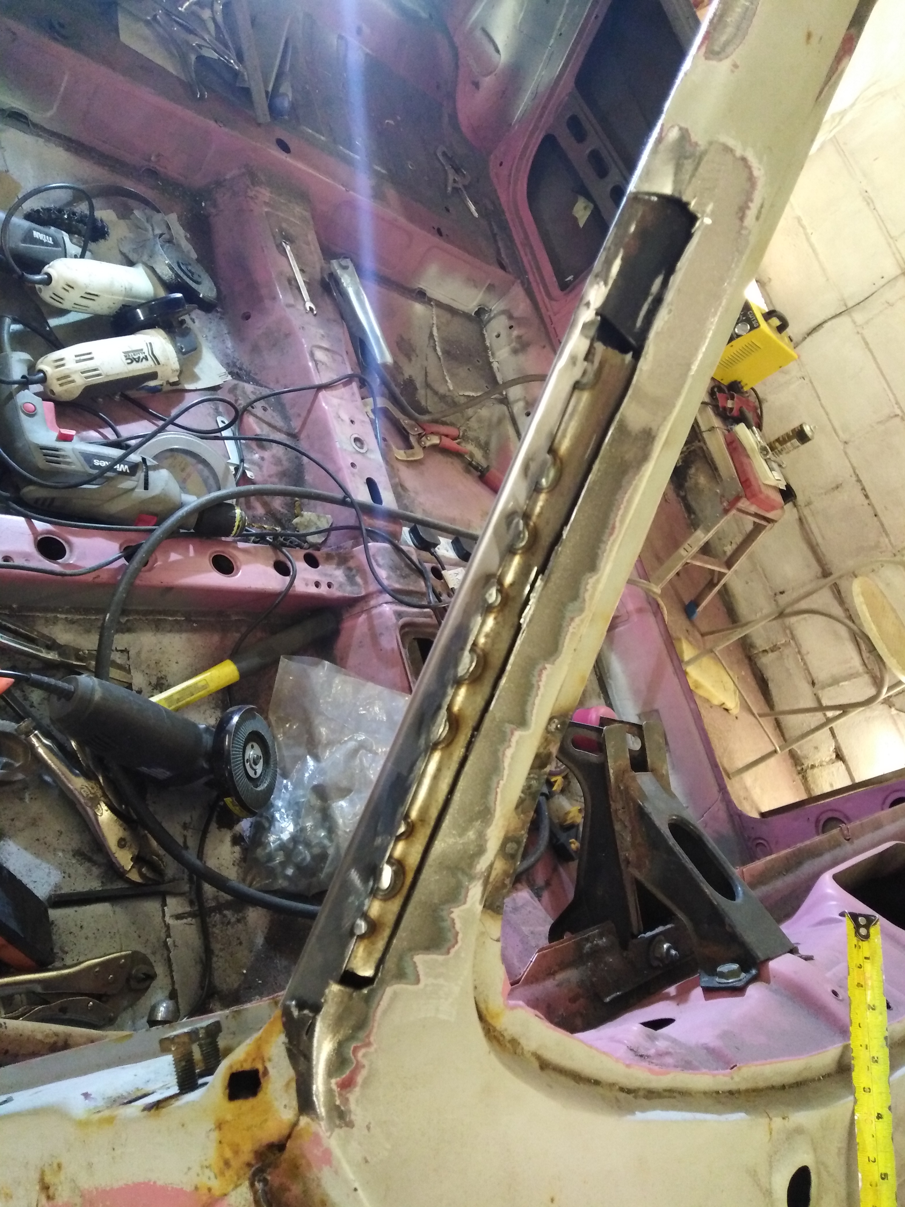

Once the outer section was cut away the inner piece was also rusted through, a new section made up and welded in.
Re: Tims' Sud

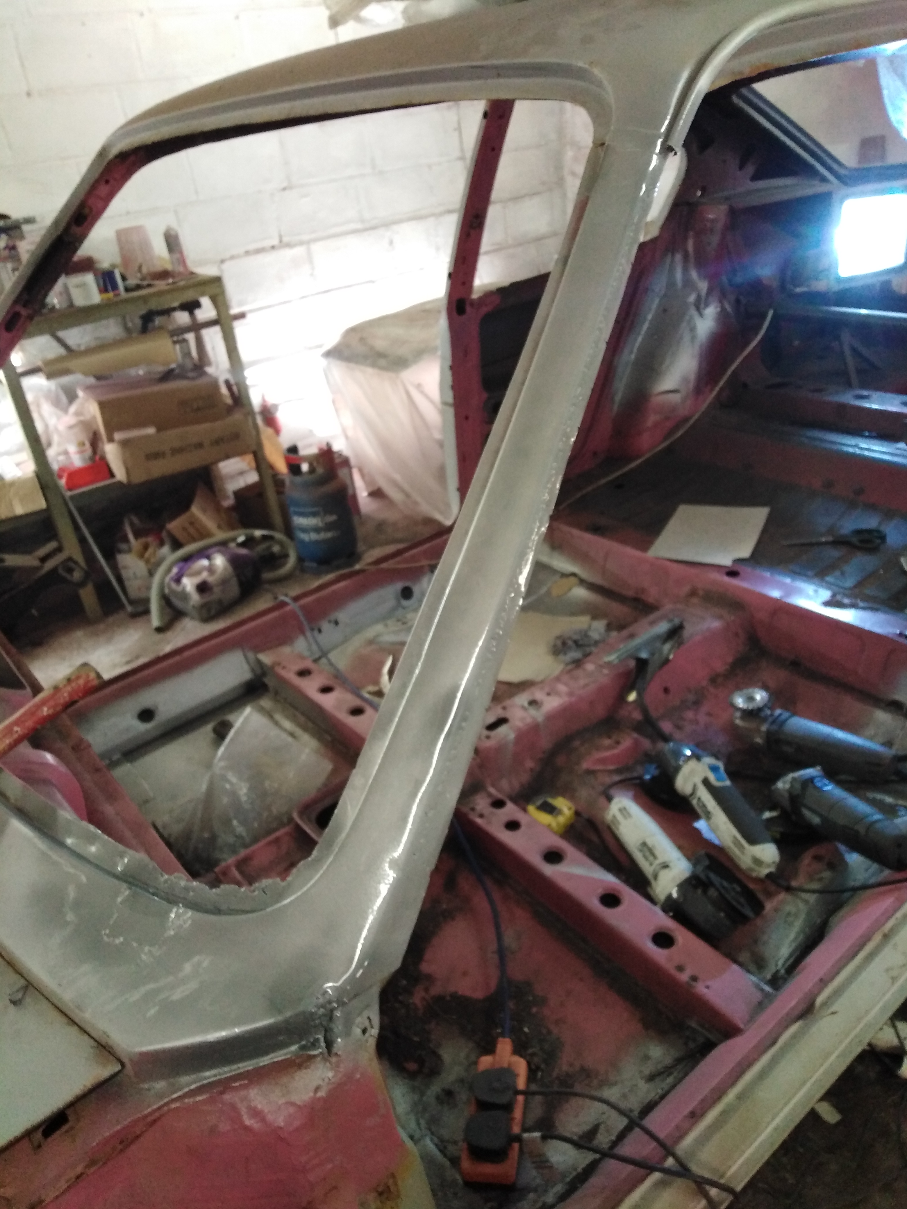

A new outer skin then made things rust free again..

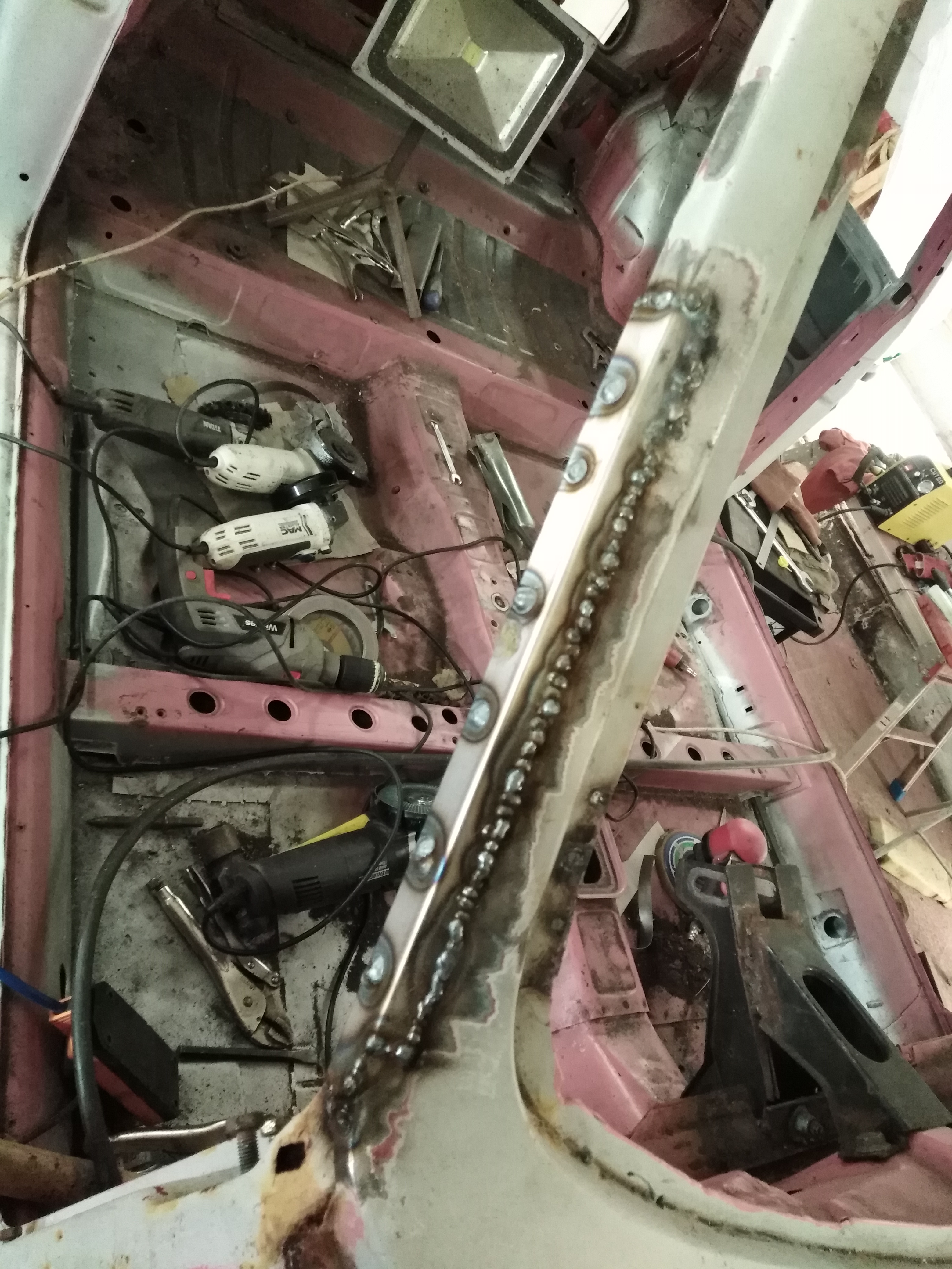

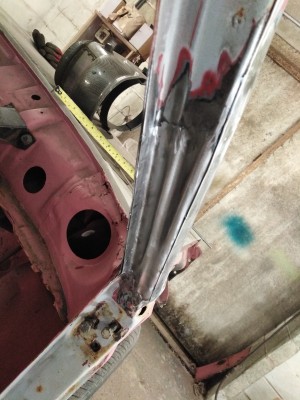

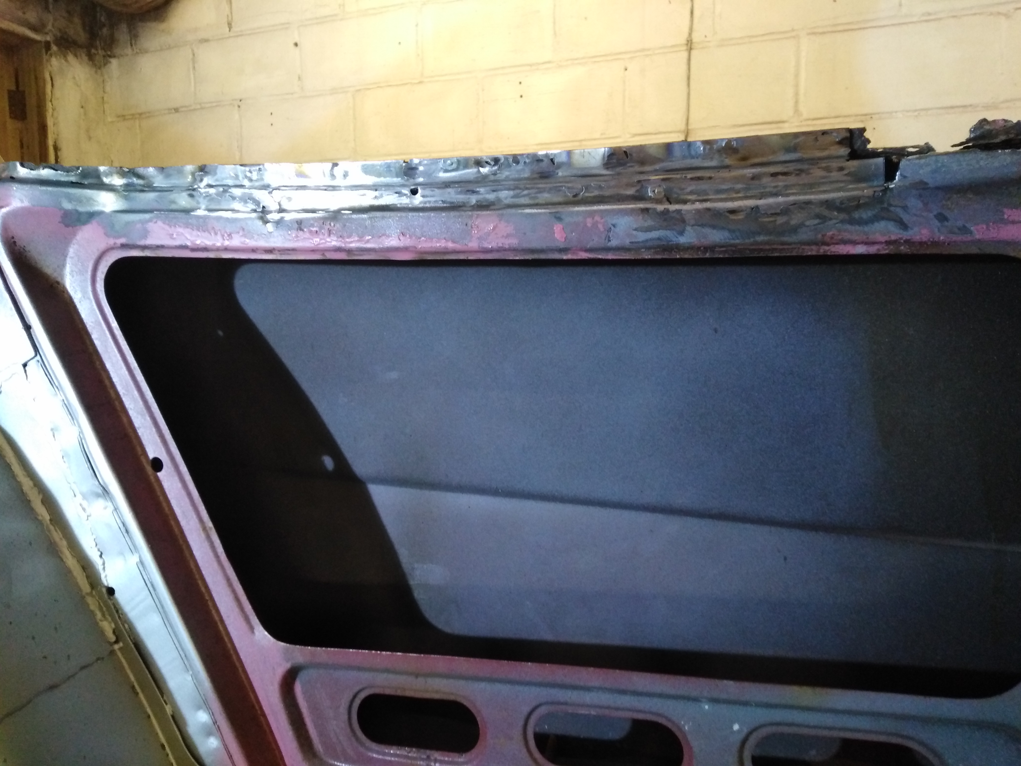

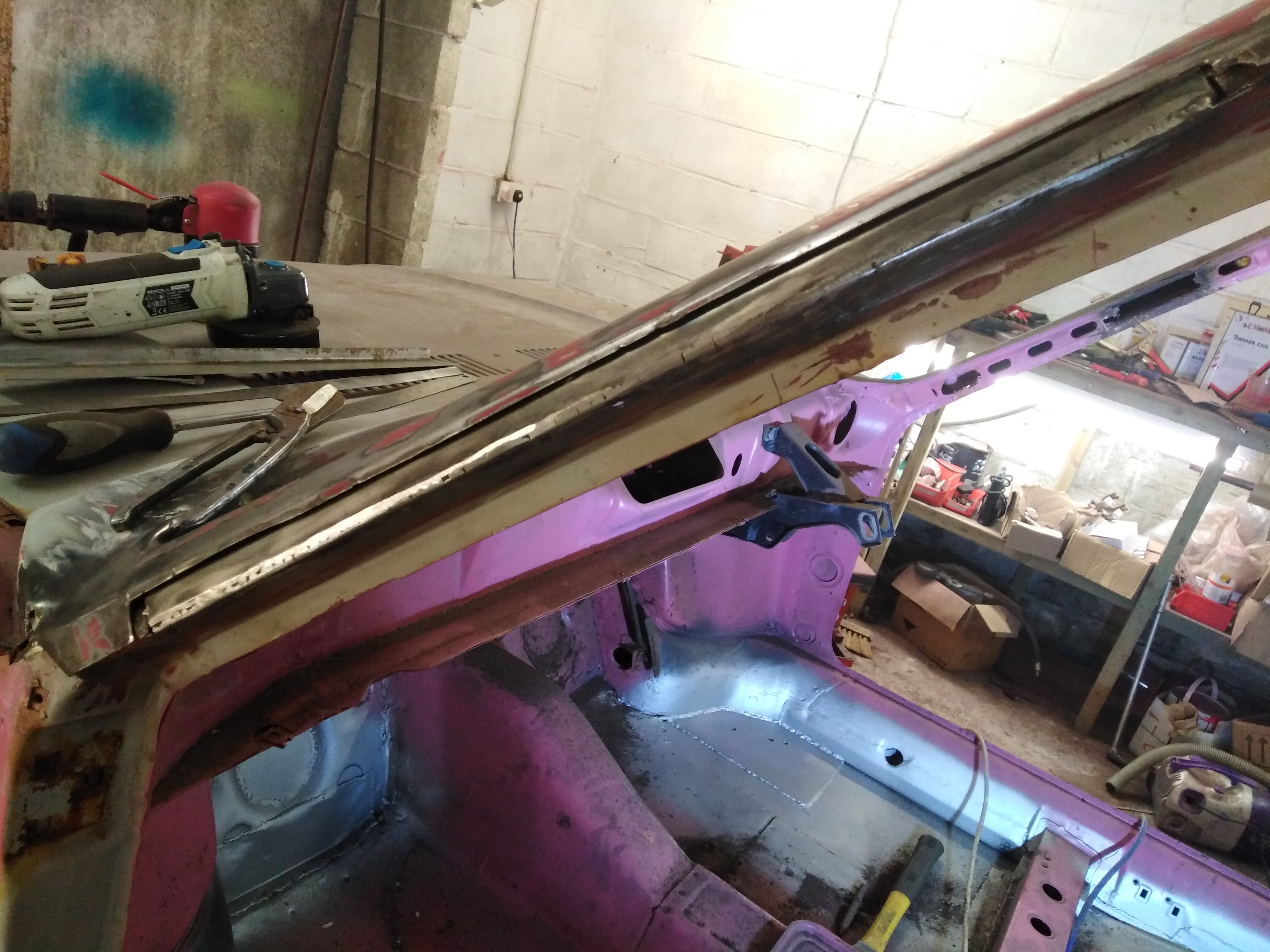

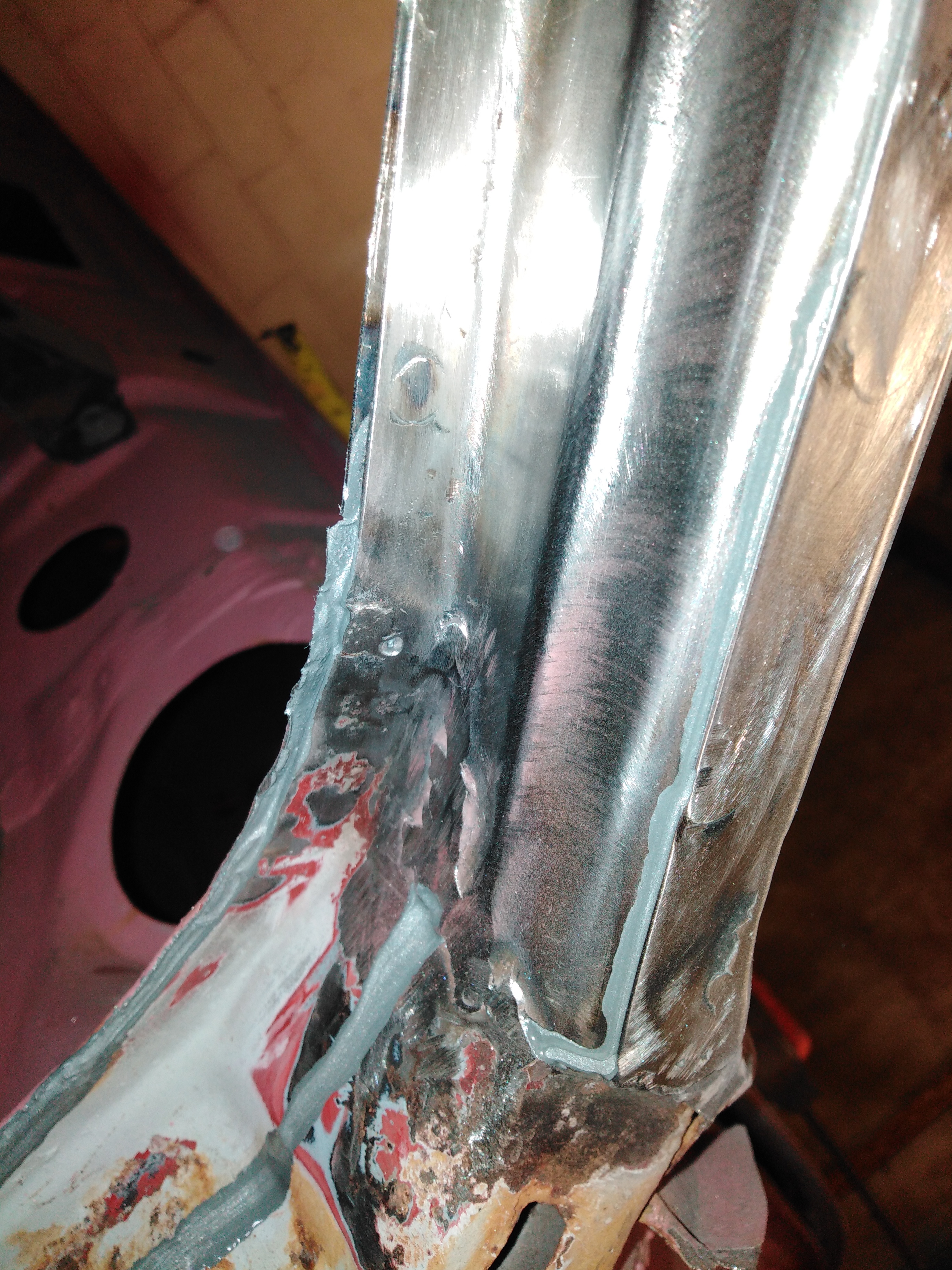

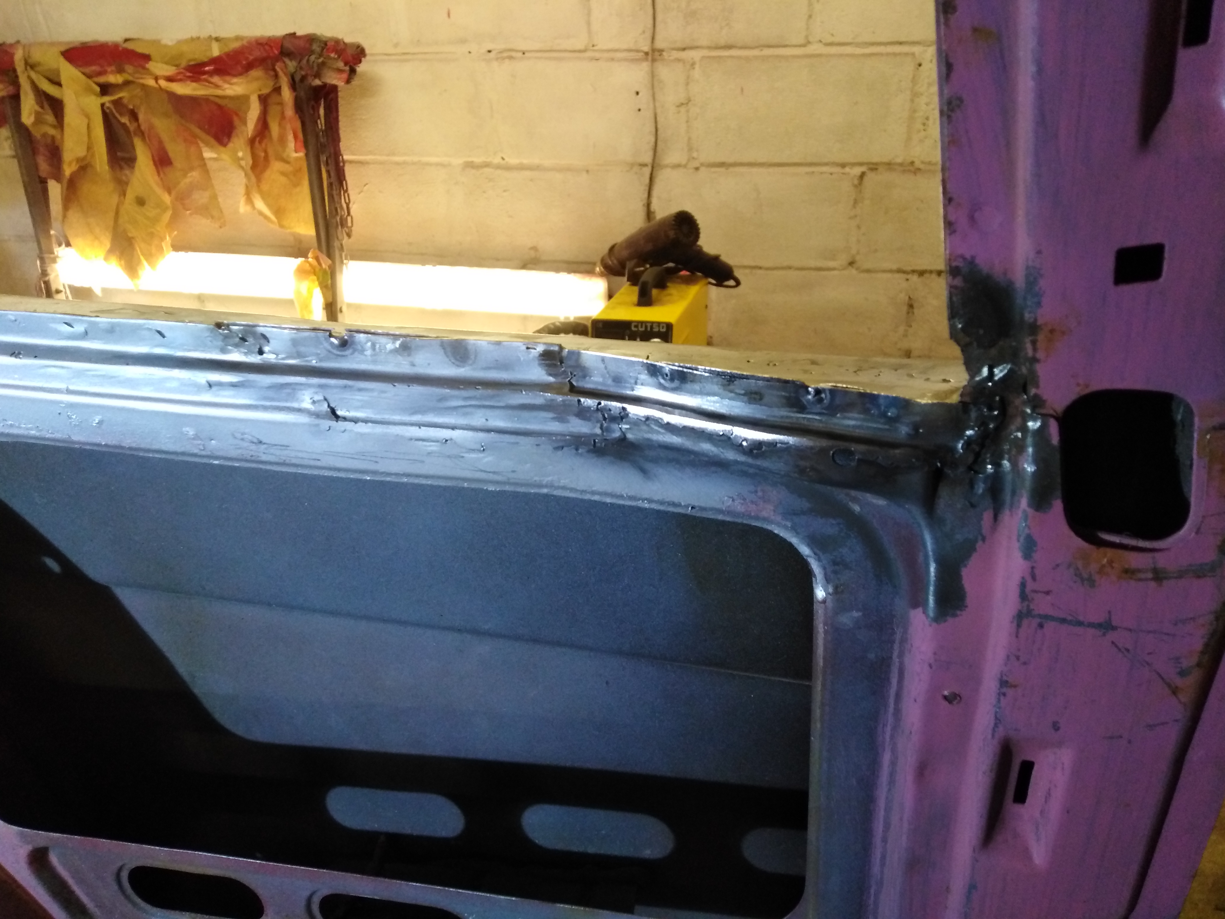

A previous repair on the screen corner got tidied up then the flange cut out to rid more rust in the seams.
Inner pillar where the roll cage had been welded before tidied up well enough so the pillar declared fit for purpose.

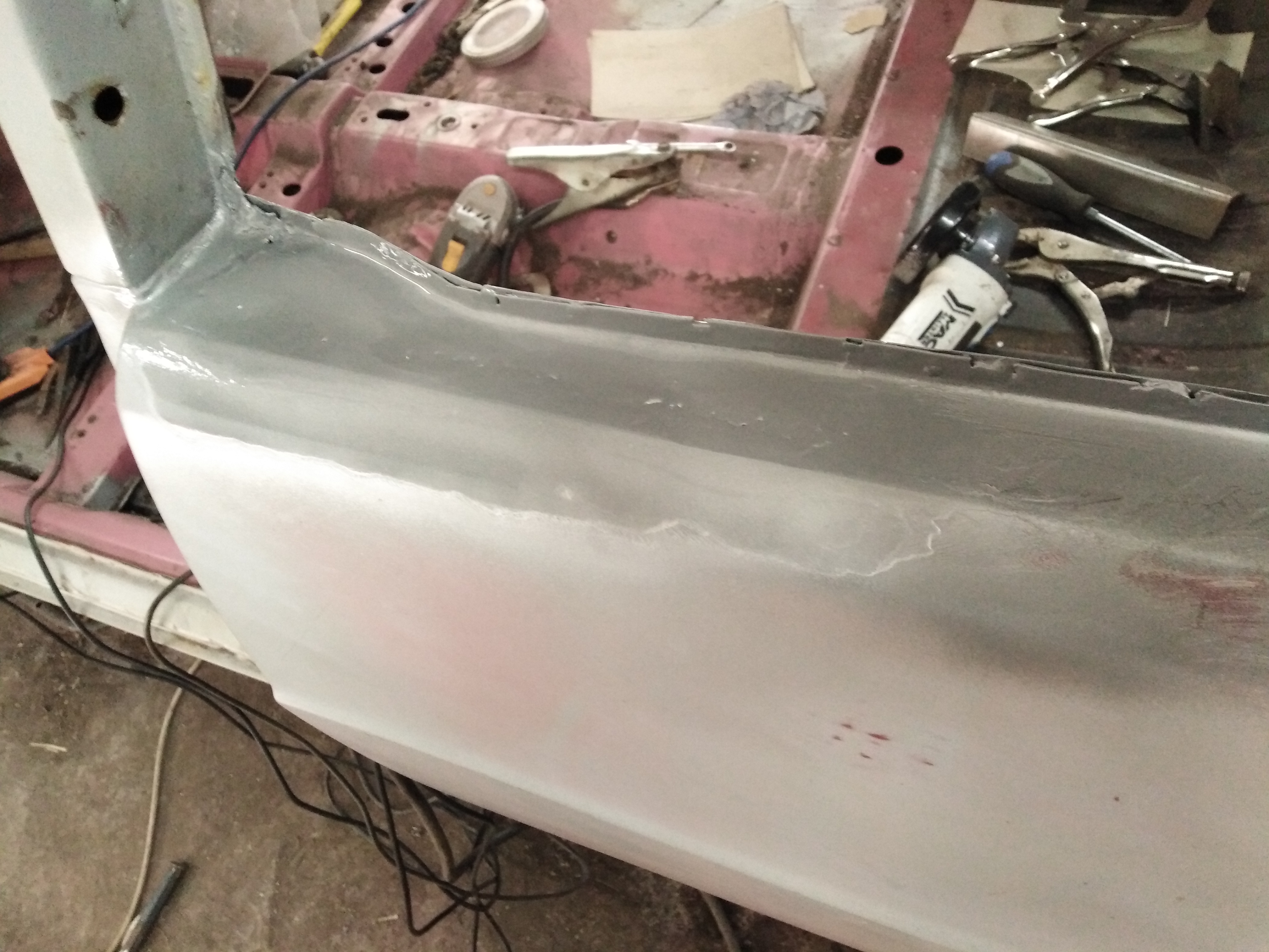

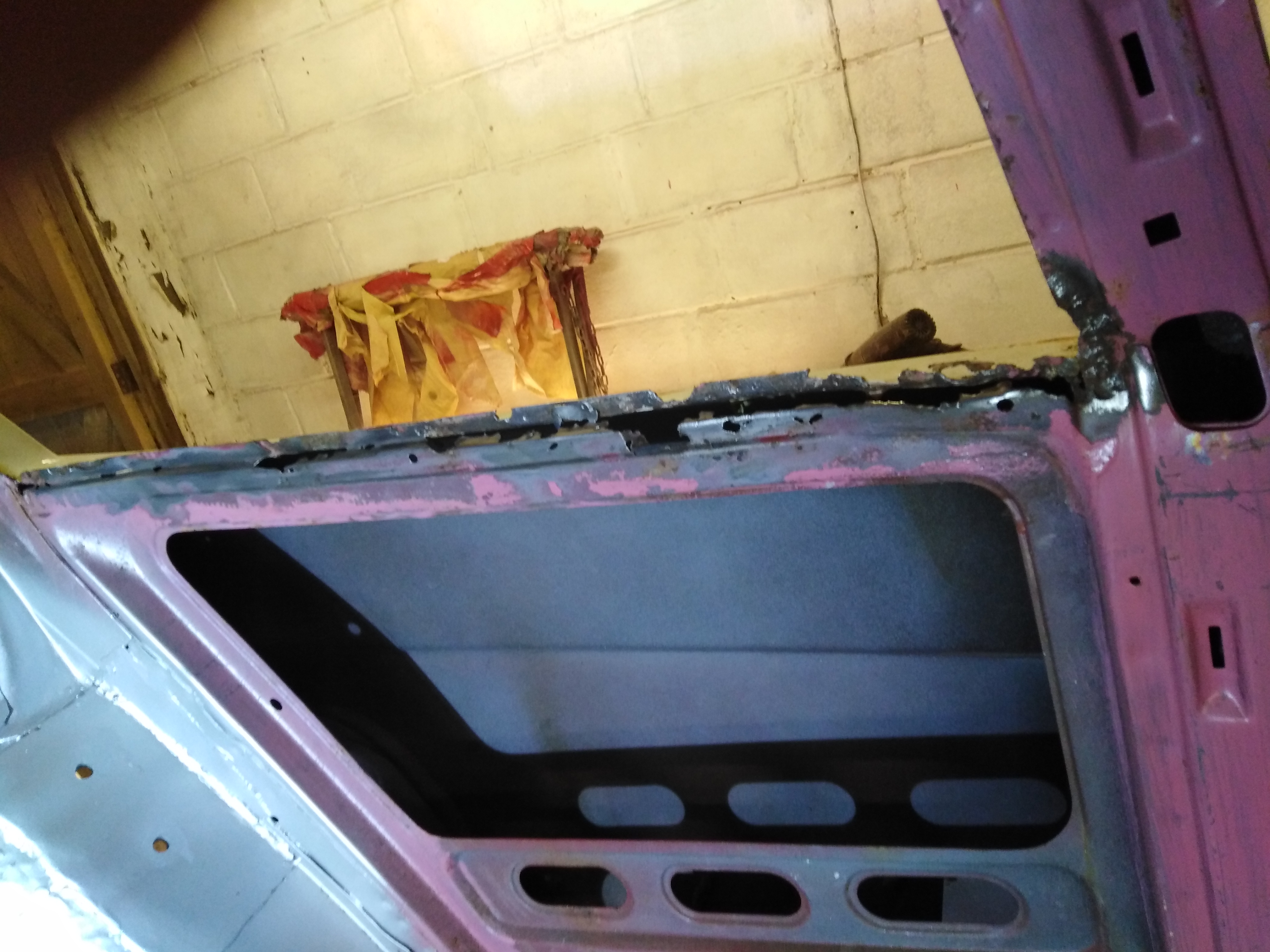

With that done a small repair in the rear seat area the onto the rera quarter panel where they rust under the window seal.
Grinder soon made a mess!

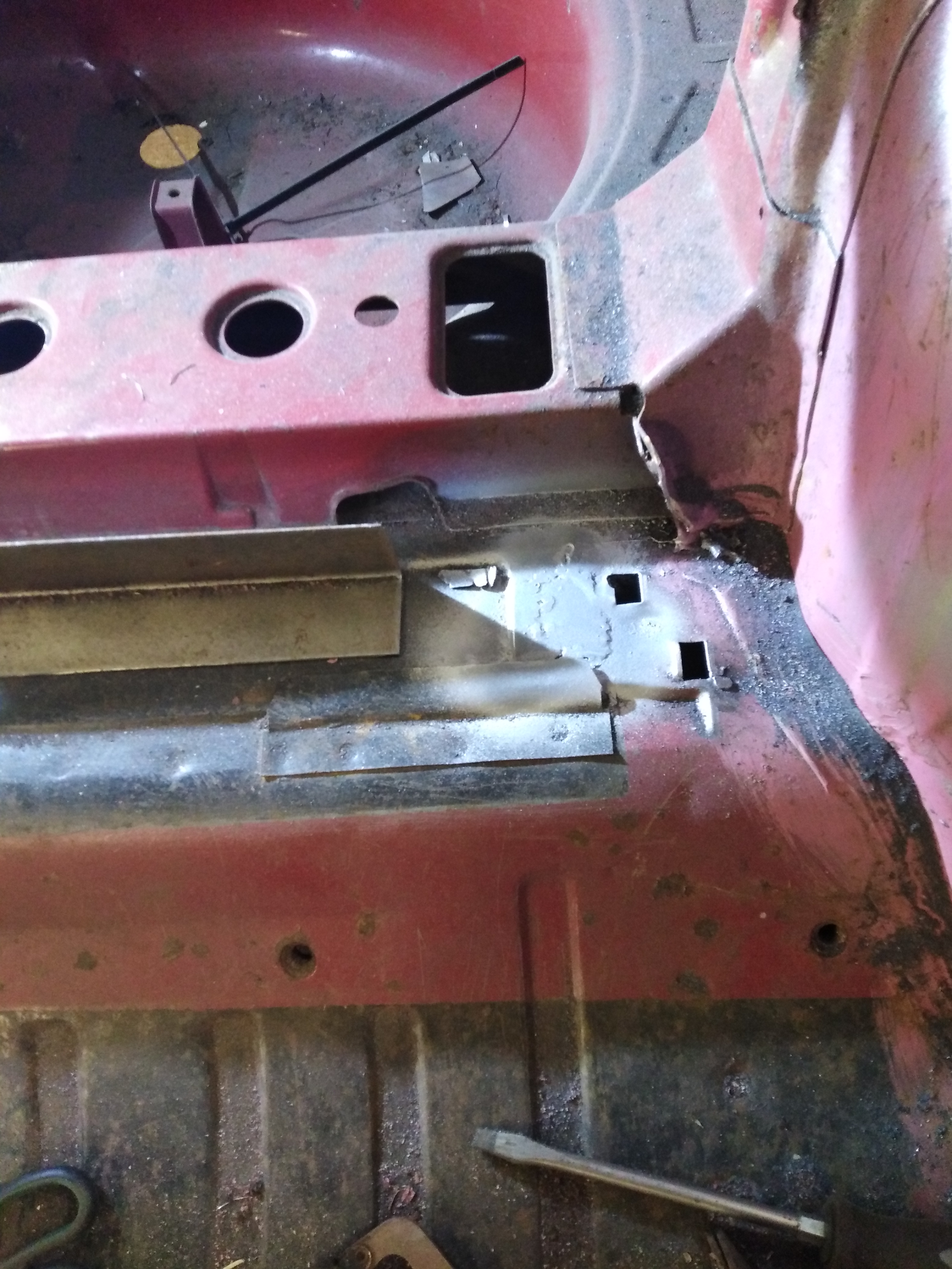

Inner section repaired mostly...

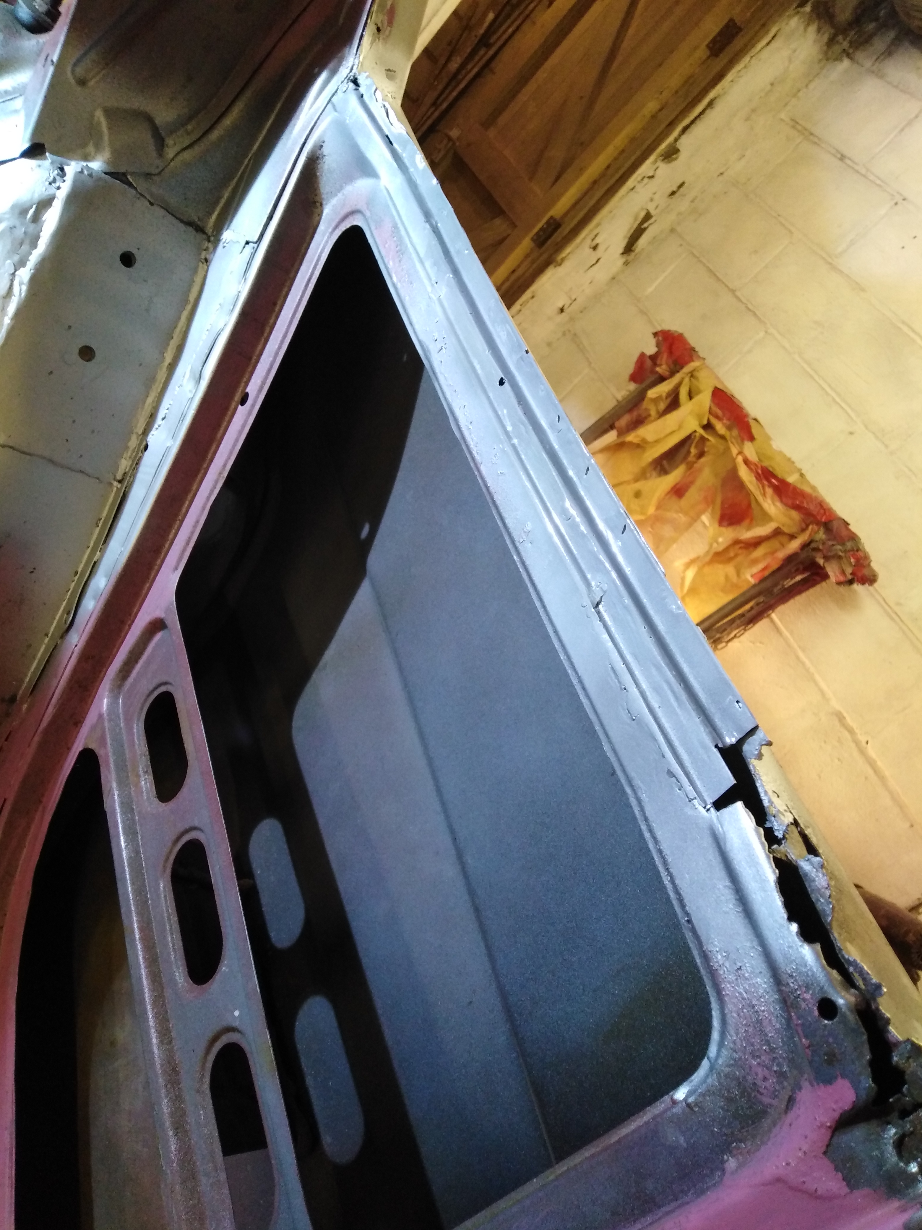

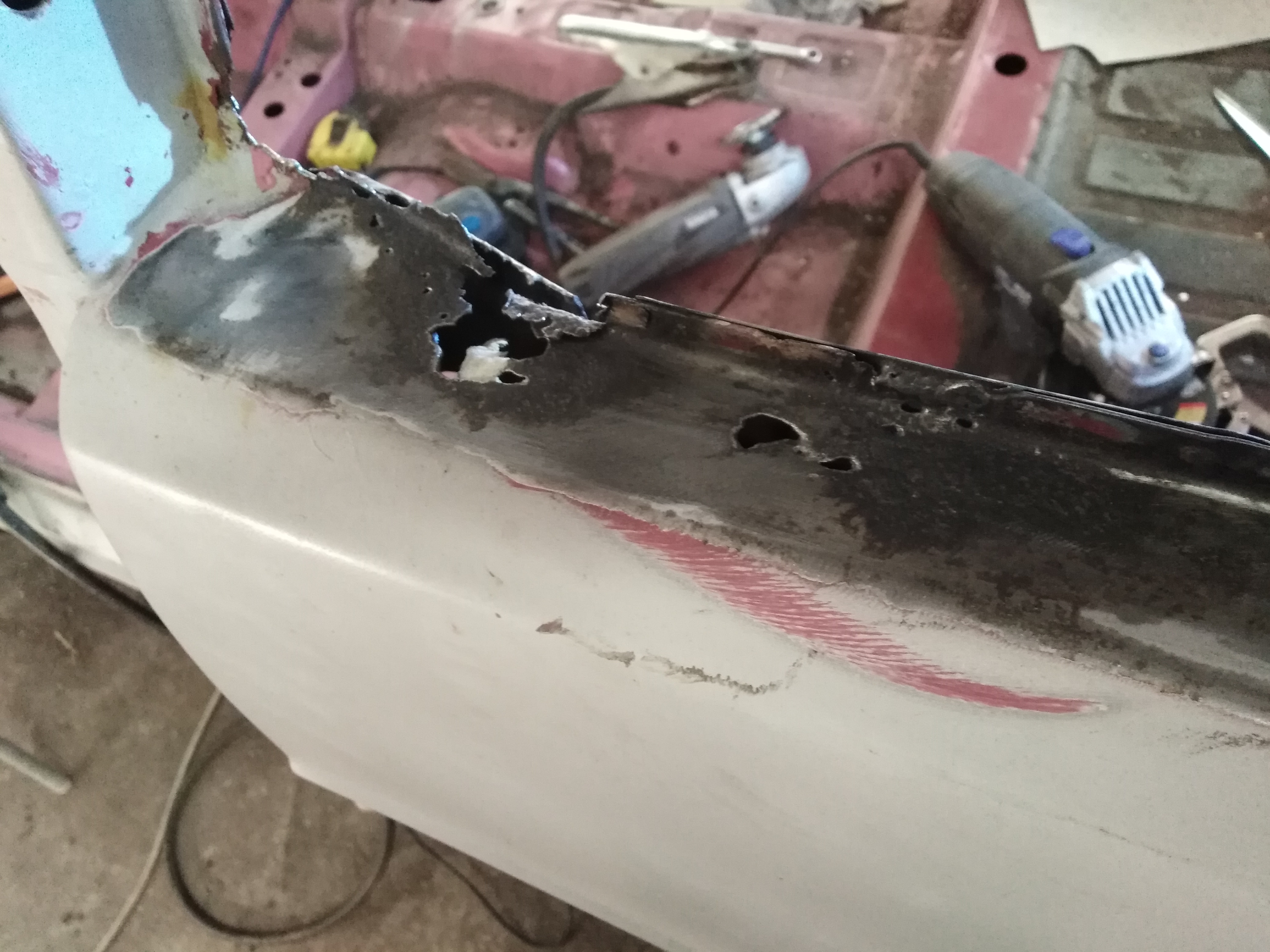

Outer section near the B pillar though had been filled over, looked OK but a bit of exploration revealed it had just been filled over rusty holes...

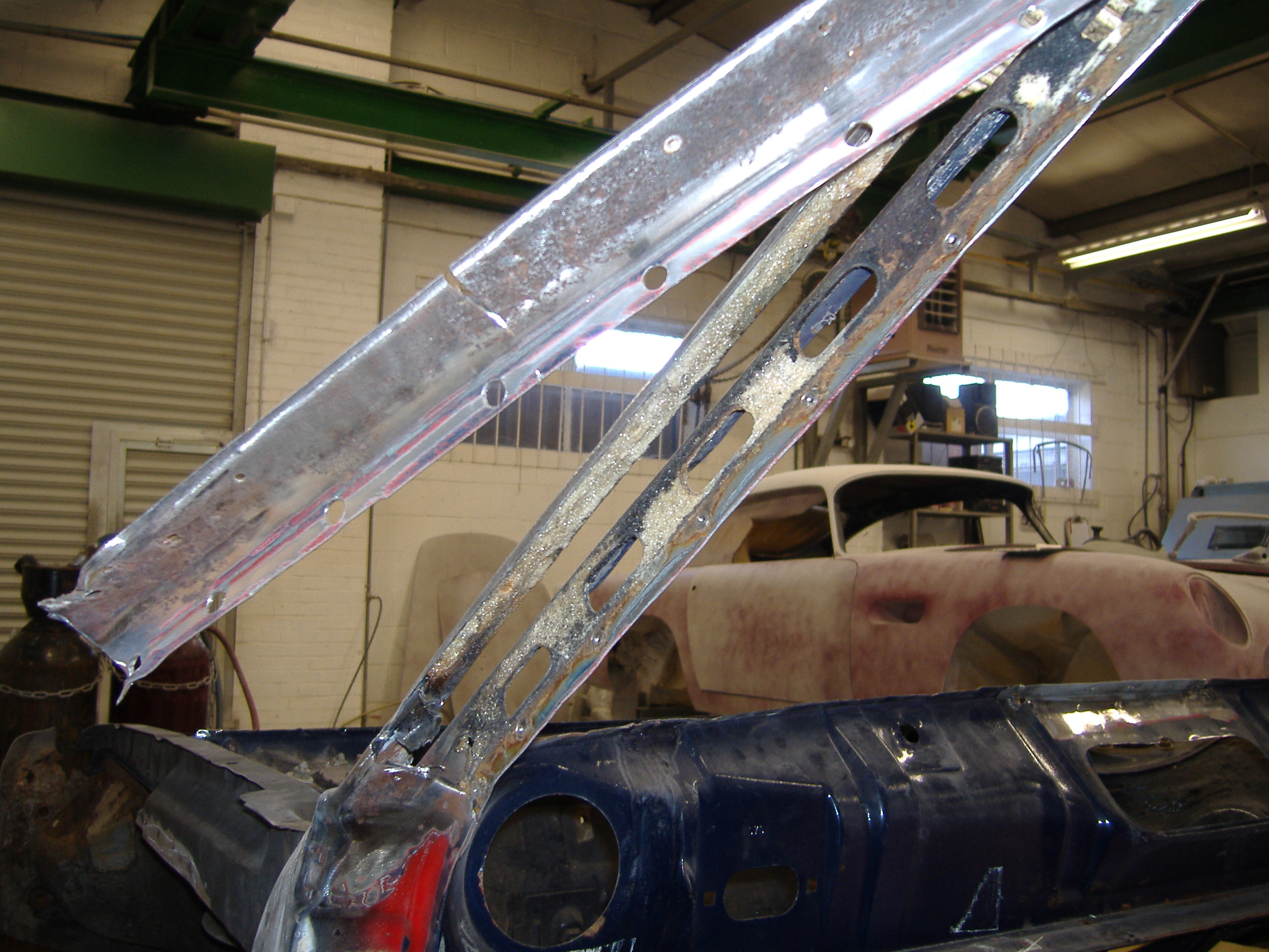

Still had some of the foam in it, bloody stuff. Put a square of it in a little splash of water and it soaked it up a treat! What on earth was the thinking there

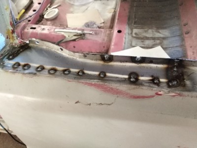

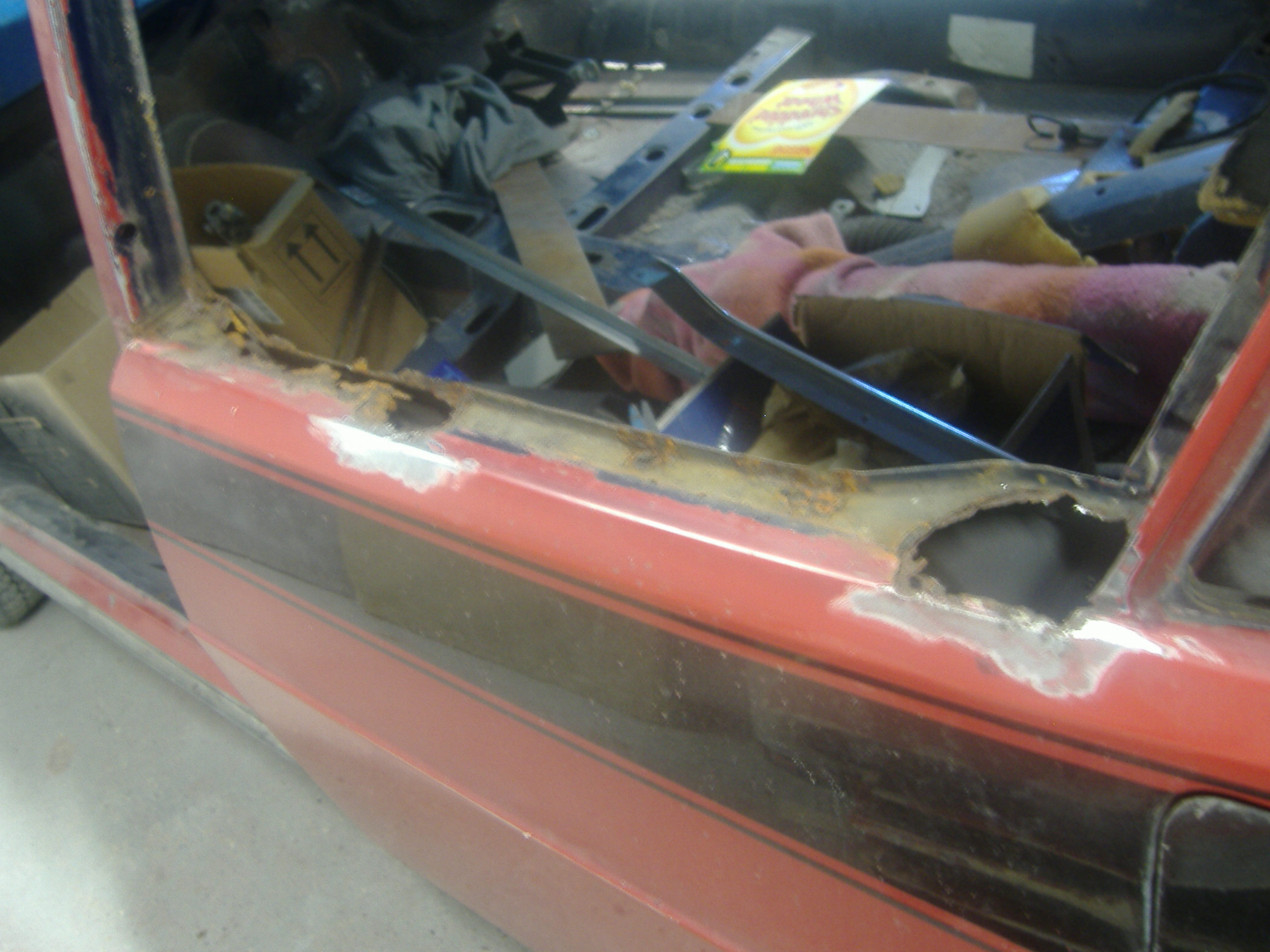

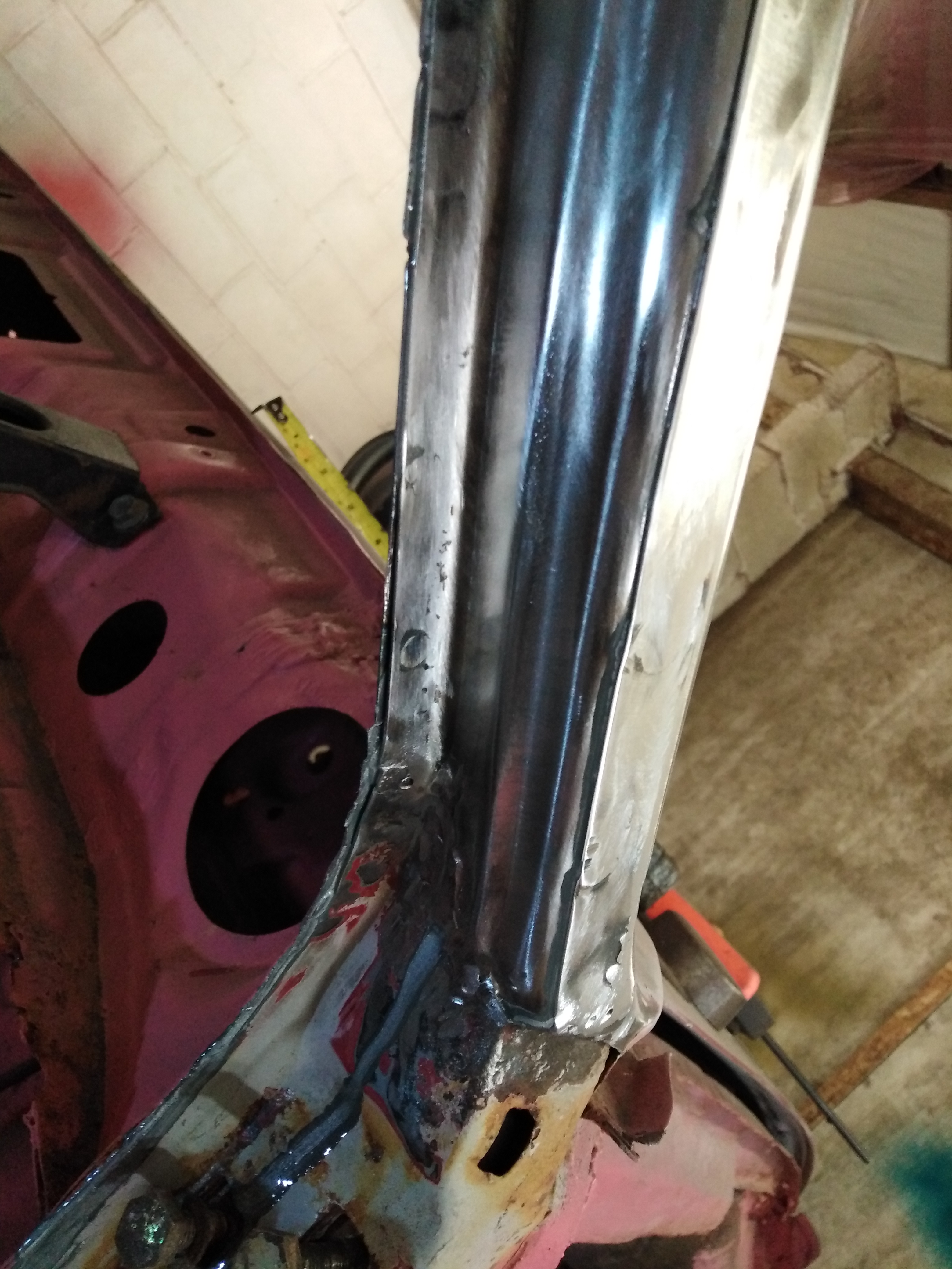

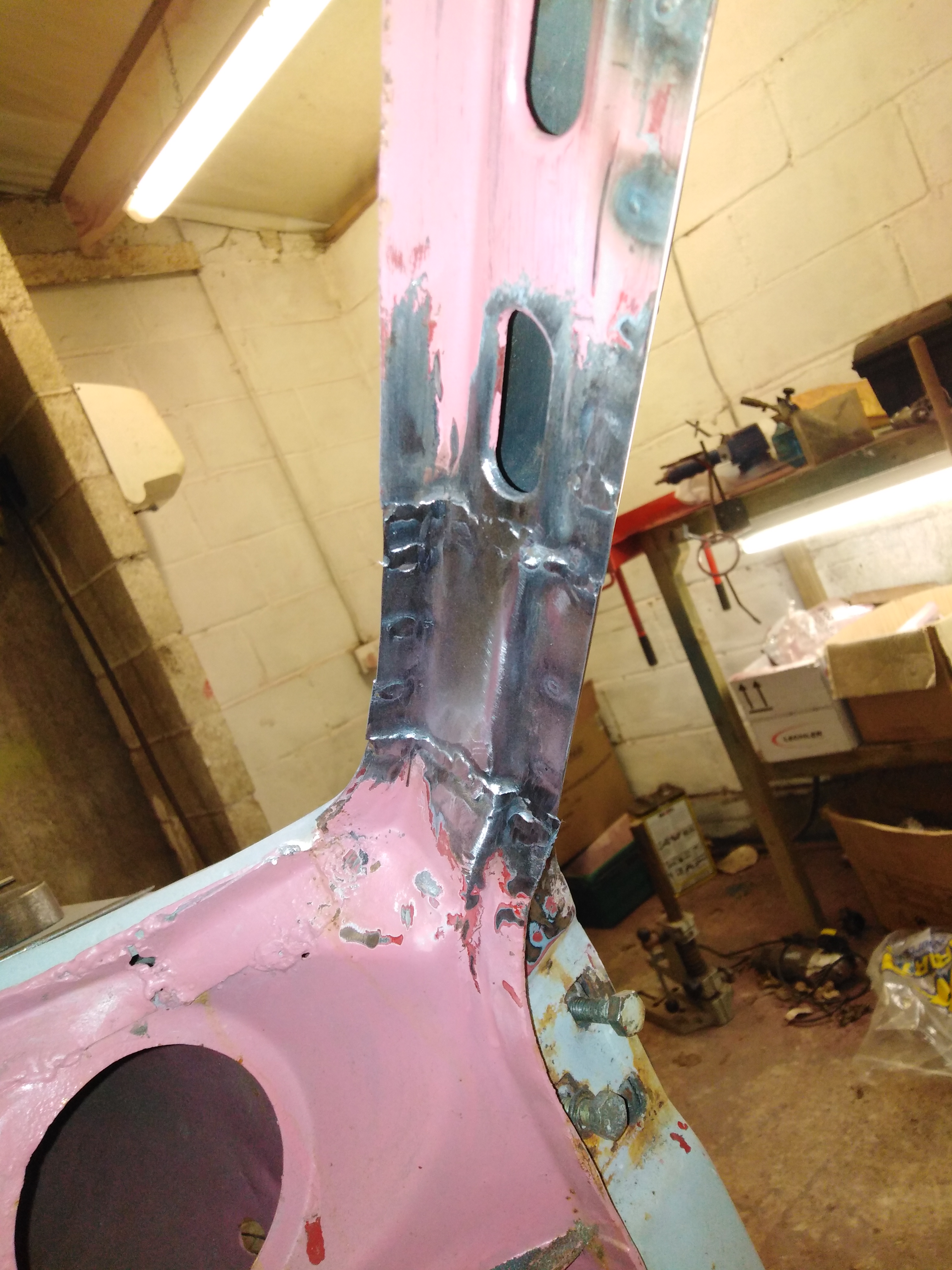

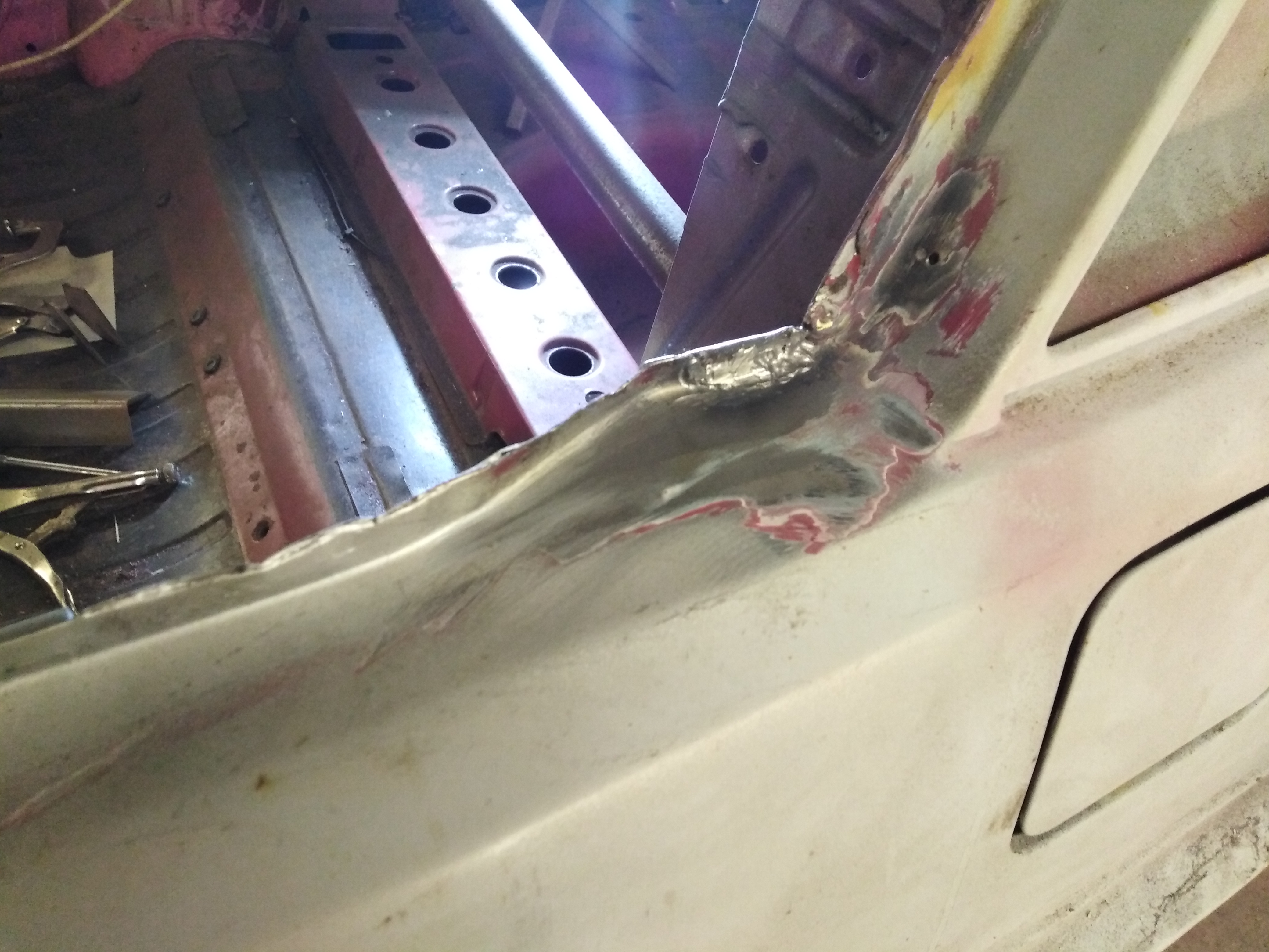

Got some more time on the car this afternoon so a plate was made up for the hole I made in the rear quarter top..
Re: Tims' Sud
Tacked in place then slowly welded all around to avoid distortion

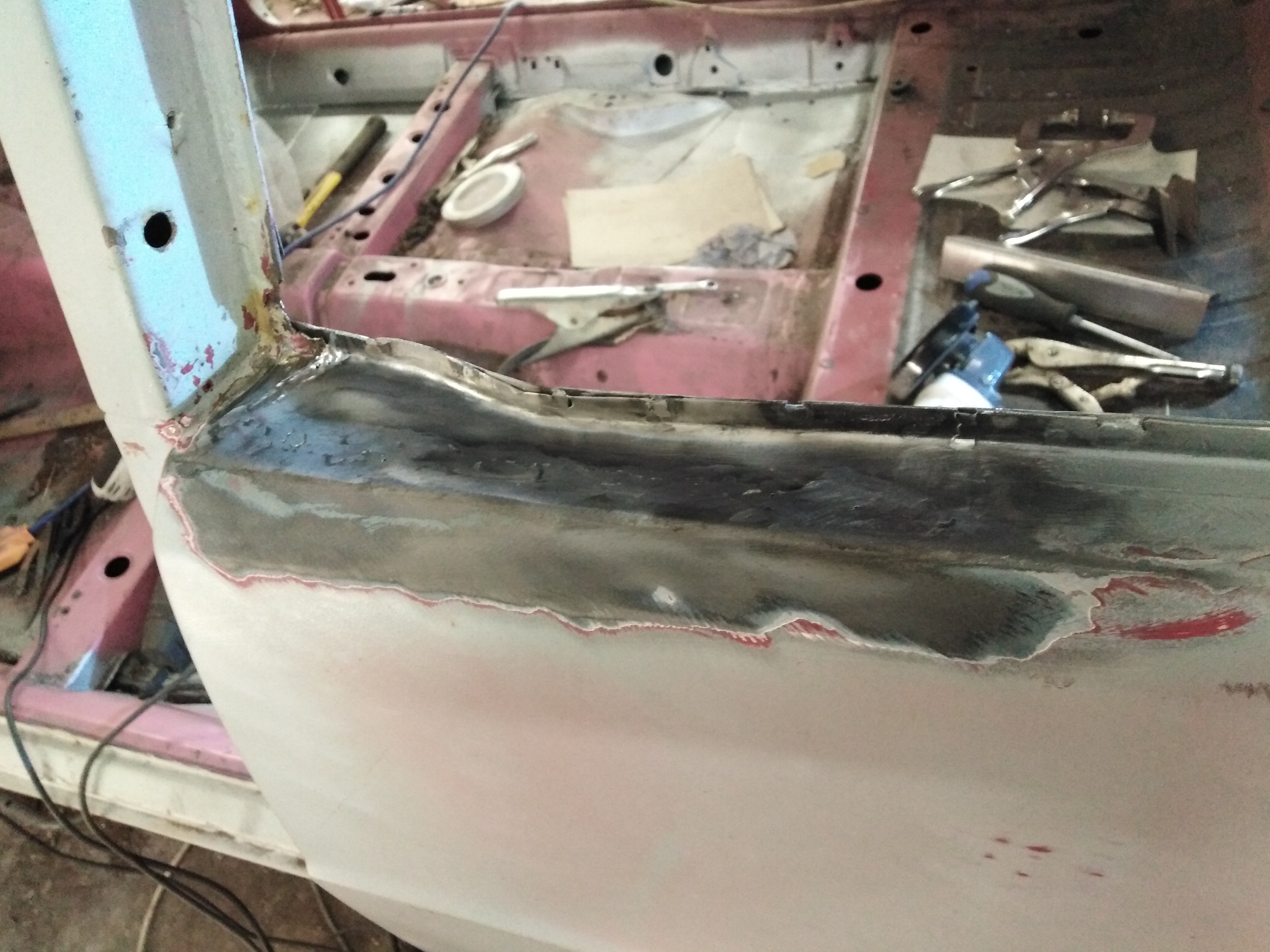

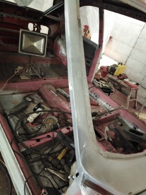

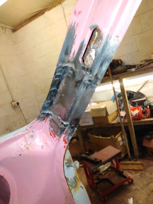

Inside tidied up and a bit at the back so this side is done

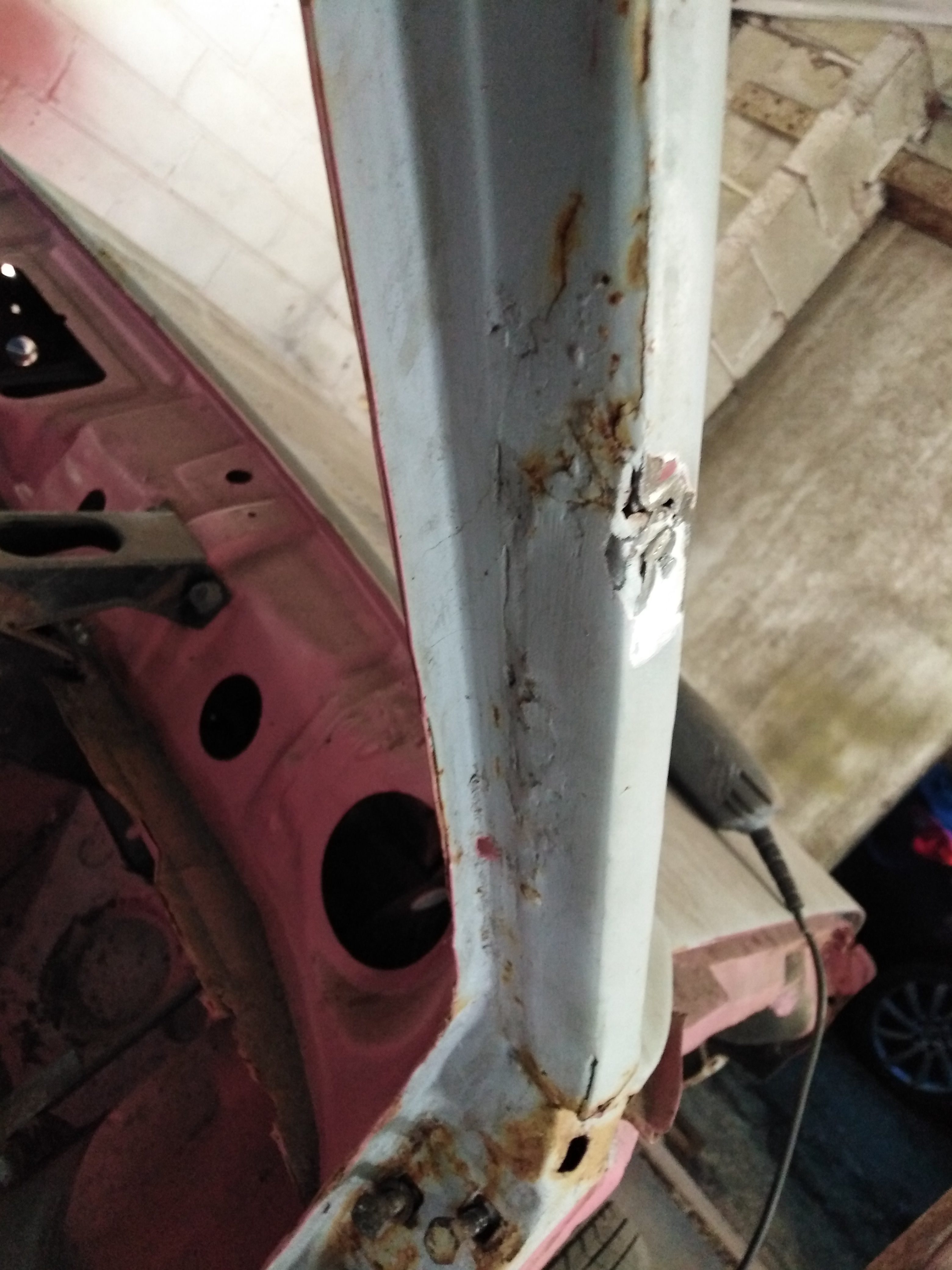

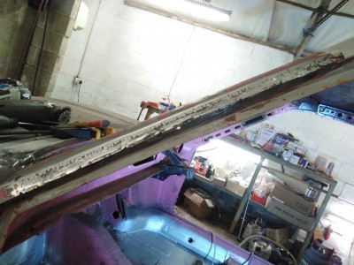

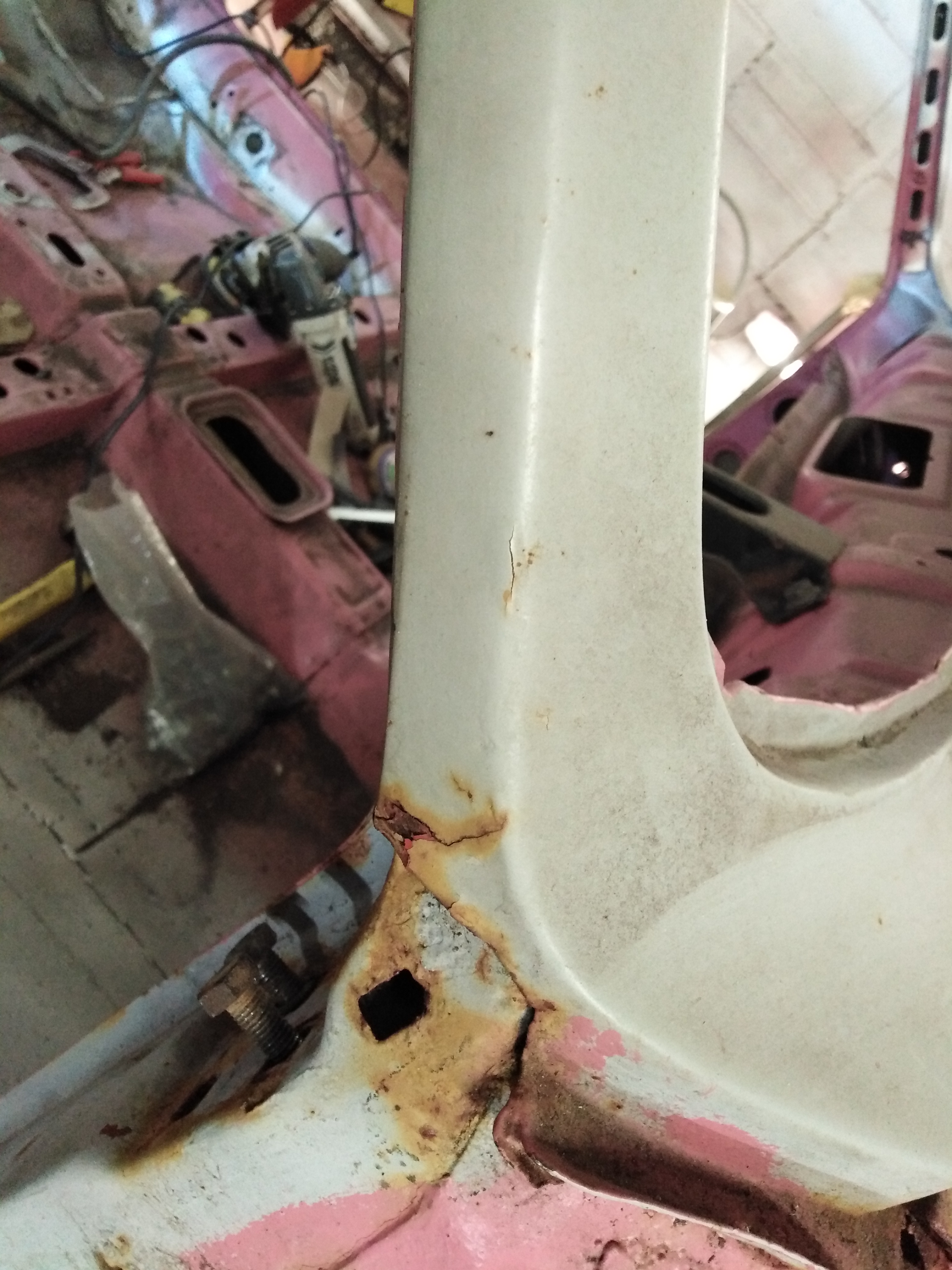

Drivers side A pillar seemed OK on the face of it although a rusty crack near the bottom was troubling me.
There was also a pretty ugly repair to the underside.
An investigation with the grinder started to reveal the filler....

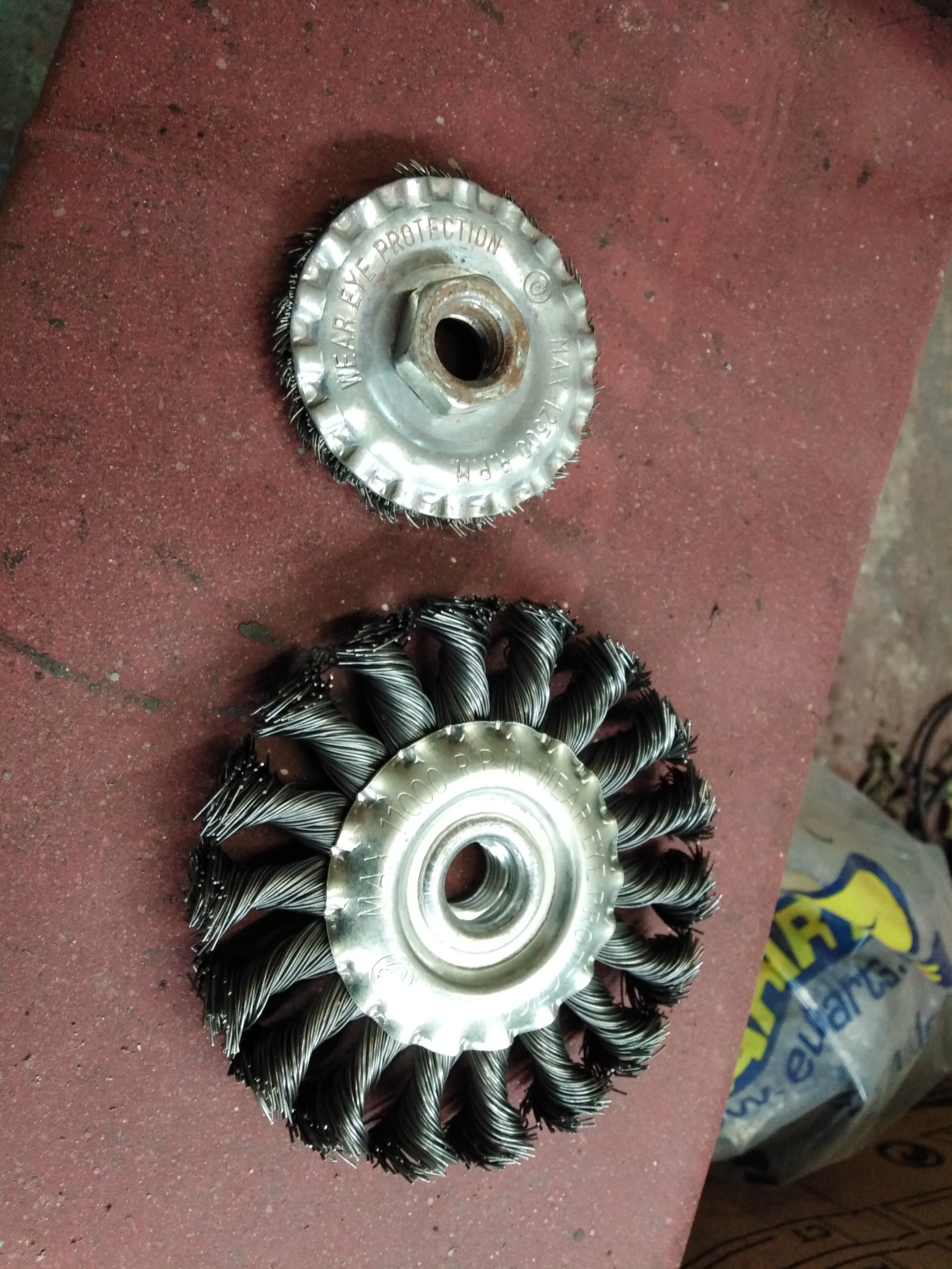

Talking of grinders, my weapon of choice is a knotted wheel on a 4" angle grinder.
They are nasty things, need great respect and both hands on the grinder as they grab, especially when new.
But they take the paint and filler out in no time plus if there's any weak rusted bits it digs them out to leave solid metal, may look drastic but at least what's left is useable!
Used and new, they eventually wear down plus the strands fly out, best off wearing a full face mask...

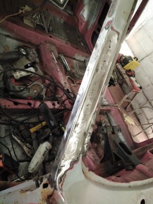

With the filler removed my fears were realised......what a mess!
Before starting to chop this lot out there was a section missing on the inner face, where a roll cage had been welded to previously. I did this piece first rather than the outer bits so at least some of the pillar was attached!

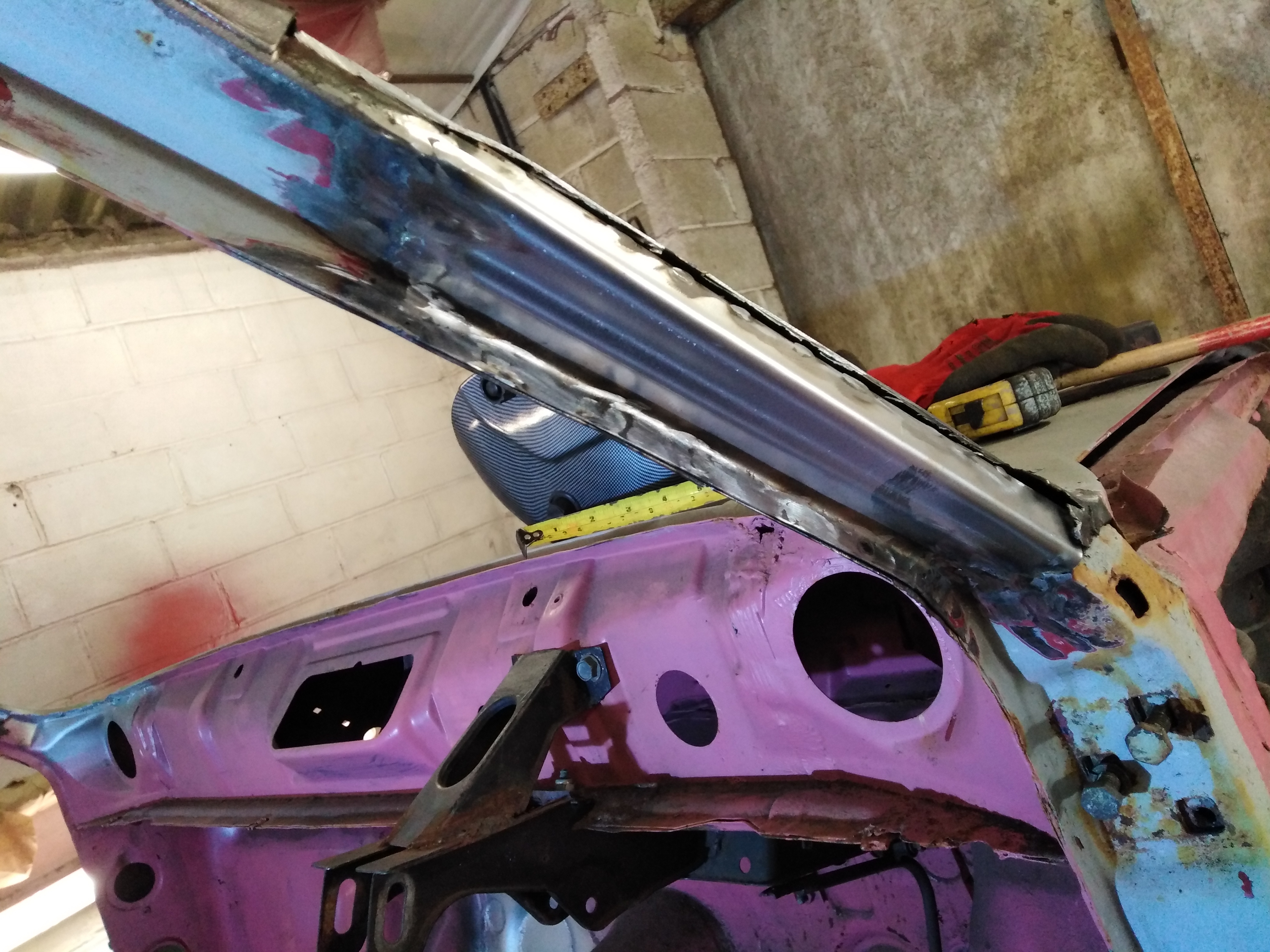

Underside then cut away where the previous repair was...
Opened out a bit more then a return flange piece welded to the inside to be picked up eventually by the new underside section...

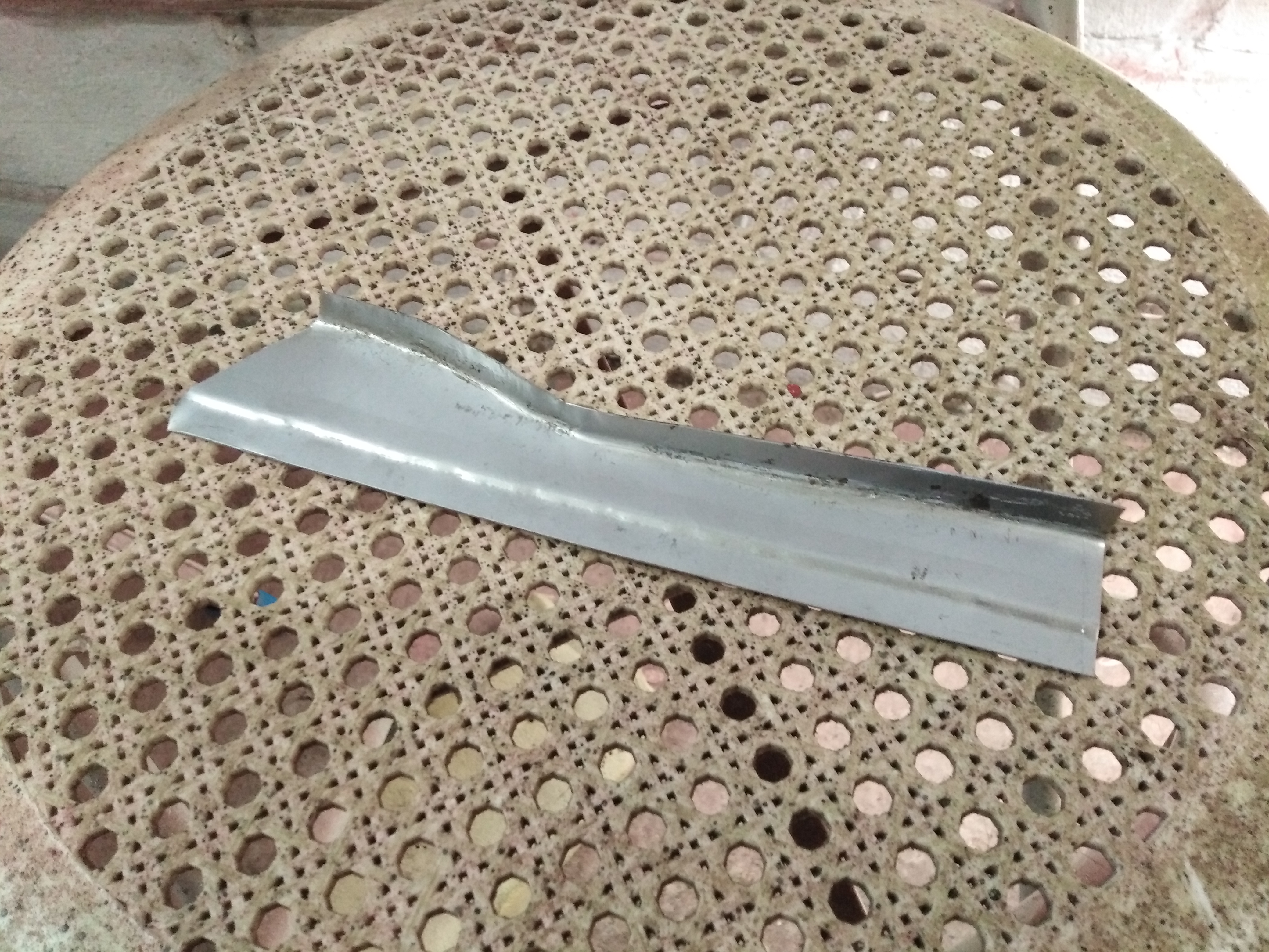

New underside section made up ready to fit...
A much neater repair, if I do say so myself
Re: Tims' Sud
Just left then to make a new outer skin and weld it in place
