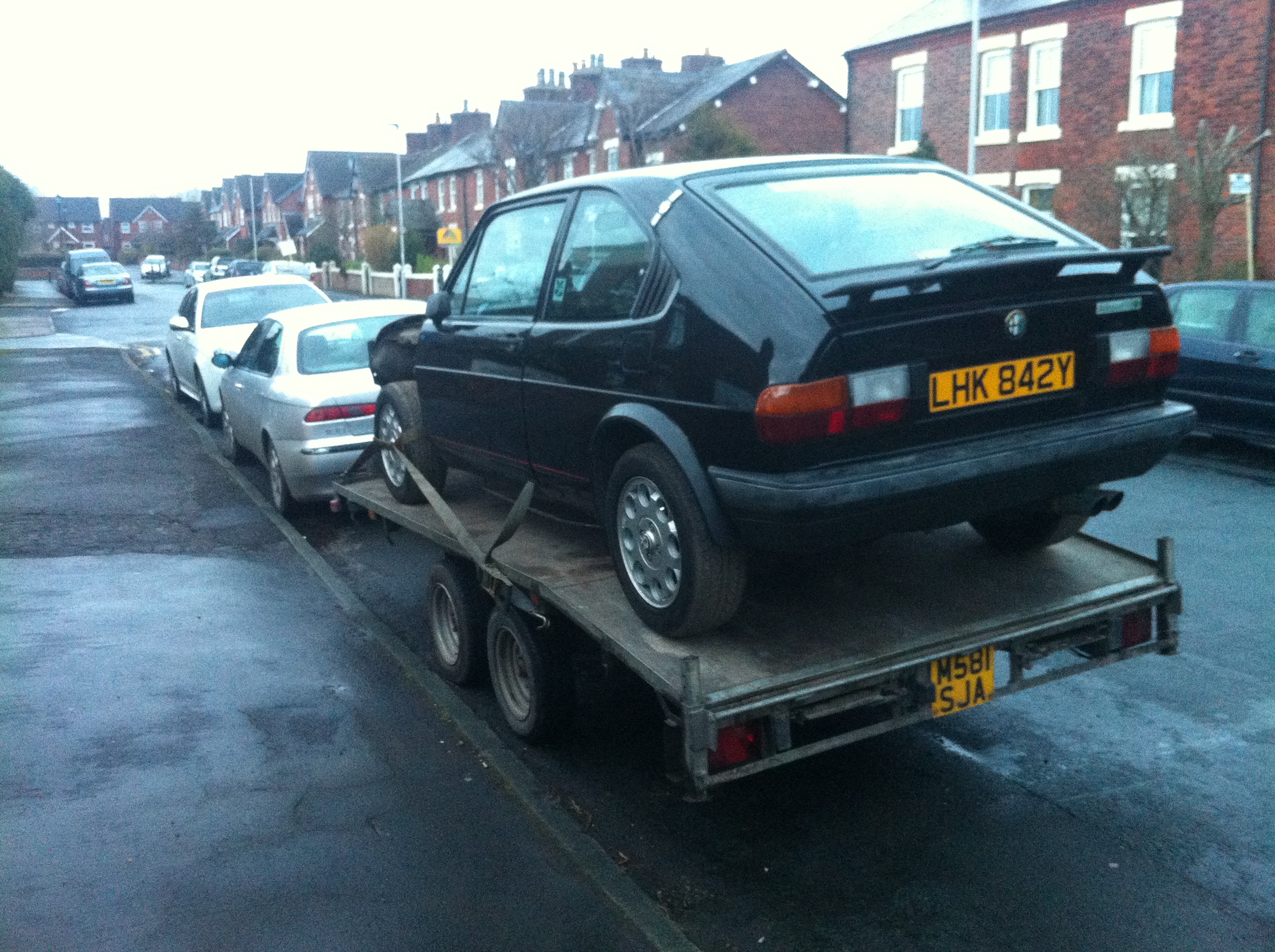

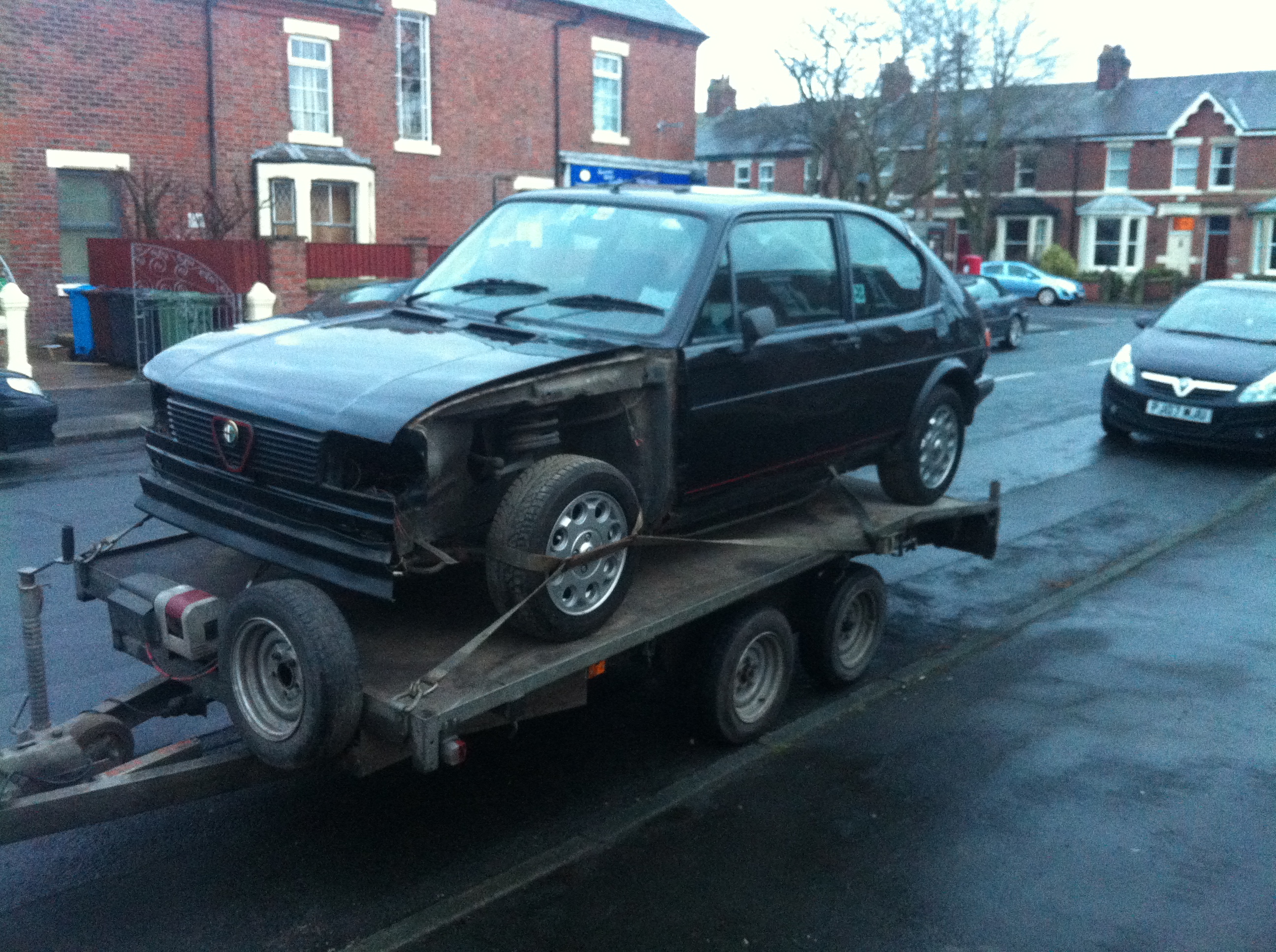

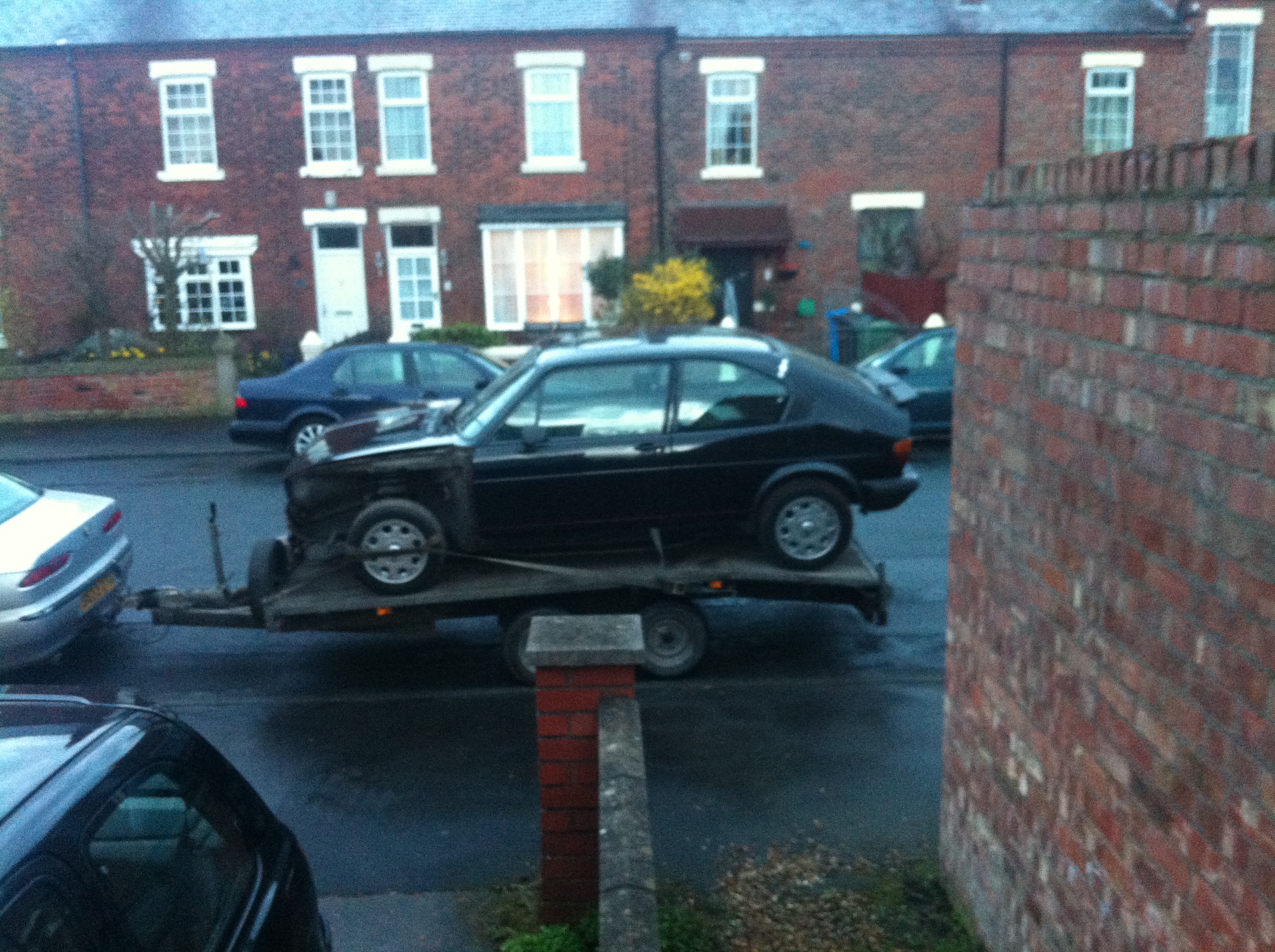

Started a new project today, an Alfasud Green Cloverleaf which has been stored since 2008. My first car once I passed my test was an Alfa 33 1.3s and it was great but I always wanted a Sud Green Cloverleaf so a few years later I tried to find one but it really was almost impossible. When I say impossible, there were some but they really were shot at. A few years later (ok many years later!) finding this one was a pleasant surprise... at first glance a frightening spectacle with the wings and lights off and fuel lines hanging down.

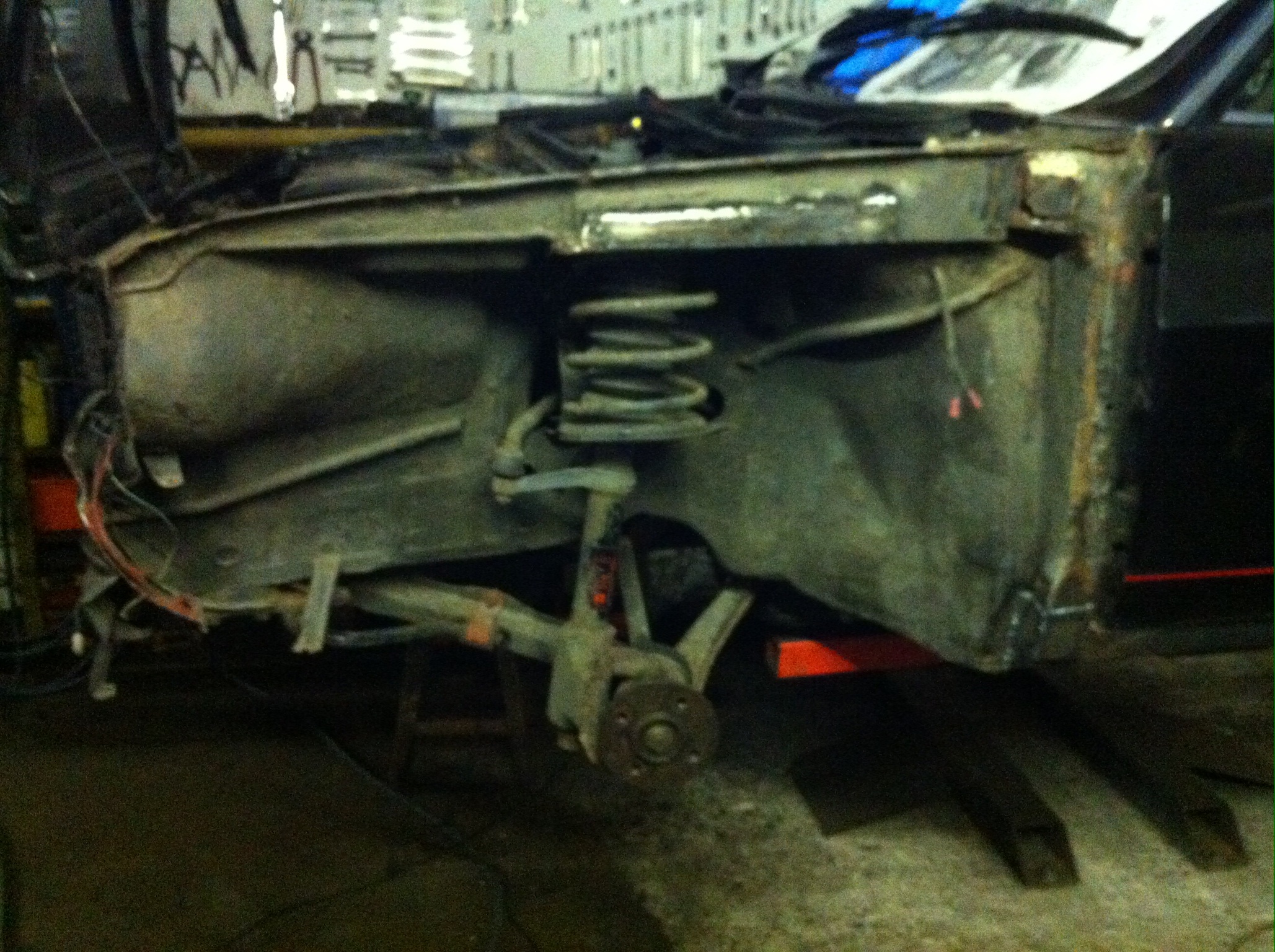

However, it's not so bad...a tiny amount of welding needed at the end of the sill where the front wing rests.. the first MOT issue. I've bought a new Bosch battery so tomorrow will be a case of checking fuel supply, ignition, oil supply (cranking the engine) and hopefully life from the engine!
Here's some pics...
Here's some pics...

Believe it or not I didn't get around to even fitting the battery as I decided to attack the grim job and do the welding. On the offside I had to take the strut out to get to the crusty bits! ...

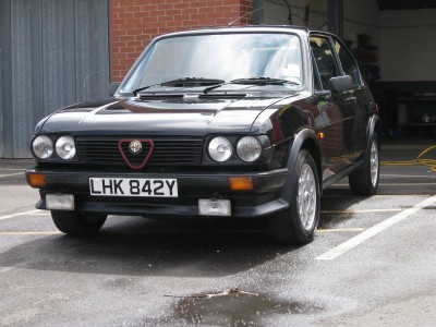

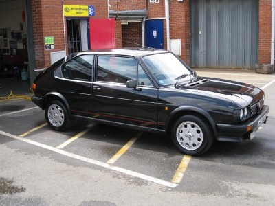

The car's a good one alright. Used to be mine. Glad it's gone to a good home.
Here's some pictures of her before I took the wings off for the welding to commence (and before I ran out of money!)
Hope they inspire you to carry on Richard....

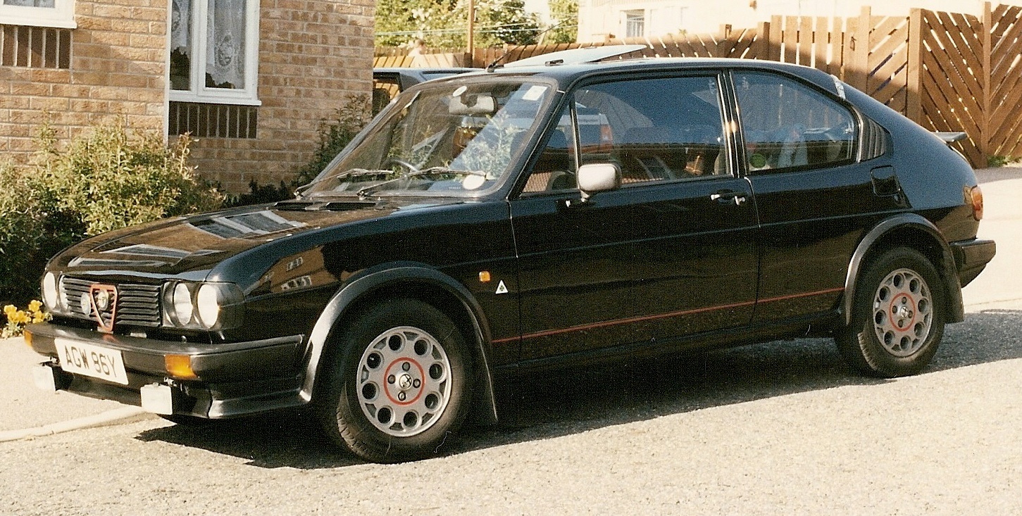

I'll let him know at our AROC meet on Tuesday, he'll be pleased to hear it's still in good nick, my old one AGW 86Y is still around somewhere I believe, last seen in the Colchester area, anyone seen it lately?
Cheers. Ian
Cheers. Ian
