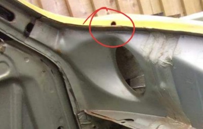

Hi chris. What series is your Sud ?? On S3 The pipes come from the lower corners of the screen. Theres a hole with a small plastic insert that goes in before the screen and the pipe pushes on to it. Hopefully it’ll just be the pipe that’s failed not the insert

Great picture. I now understand what they are for. Since I still have the windscreen in, it was not obvious where they went!

If the pipe is not in I wouldn’t worry too much but what happens when people have to repair that area they don’t reinstate the holes and water sits there
And causes the screen surround to rot
