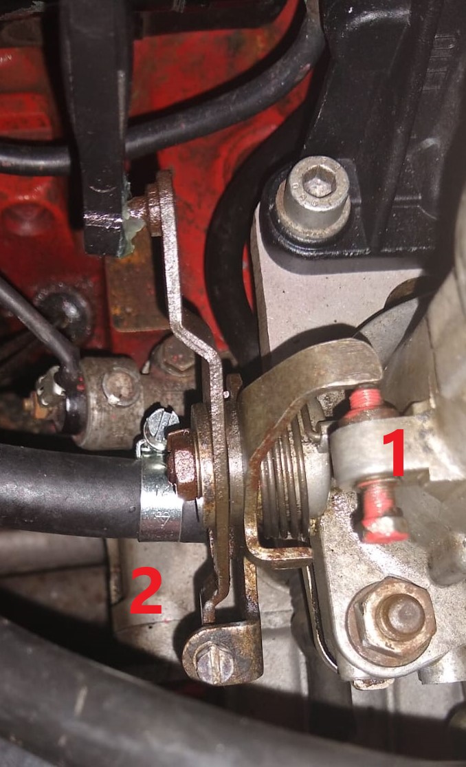

I will ask a wee question - and hopefully this will help others going forward. (Mods - a carburettor sticky thread might be a good idea as there are not many left out there with the skills to adjust these things I fear).
Going by all the guides (and from what I can see) Screw 1 should be the idle adjustment. When I picked the carbs up I was told not to touch that as it determines the closed position of the butterfly valve. I was told screw 2 is the idle adjustment - but the guides don't seem to refer to this one at all......... However I have followed the recommendations on screw 2 rrather than on screw 1. Therefore I have adjusted until it is JUST touching the lever - I had put a sheet of paper between lever and screw so that it was just held in place. I removed the sheet of paper, then tightened a quarter turn as the guides recommend. Have I done right?

Looking at my red Haynes manual p159/160
Your screw no2 should be adjusted to 1mm (40 thou) clearance.
Your screw no1 is to adjust idle speed

Hi, Alfadave is quite right. Here is the 'full' procedure I go through. Obviosuly I don't always start with checking the mechanical timing everytime, but if I'm working on a car which I don't know, then I start from the very start. I find it can save a lot of wasted time overall. Also, worth noting, I check the compression to make sure the valves are sealing correctly i.e., not burnt out etc. As this greatly affects the running of the carbs.
Carb Balance procedure:
• Check mechanical timing – cam & TDC positioning.
• Check cylinder compressions (min. 149 psi & max variation of 15 psi cylinder to cylinder).
• Check inlet vacuum system & lubricate vacuum advance mechanism – ensure working ok.
• Check throttle & choke cables are not acting on the carbs and there is a small amount of slack.
• Theory: 3 screws to set up:
o Relay lever screws (x2) affect synchronisation of the carbs through the linkage.
o Mixture screws (x2) affect richness of fuel (start rich and weaken until crimson blue flame at idle with Colour Tune)
o Throttle stop screws (x2) affect RPM and therefore airflow (check with carb balancer/airflow meter).
• Check linkage adjustment (refer to Haynes manual for 'A' and 'B' settings below):
o Linkage cross-shafts should be 61.2 - 62mm between ball centres (“A”). Can’t adjust plastic ones.
o With throttle pedal released – check gap between relay screw & relay lever (‘B’) is 1 mm (each carb).
o Check both throttle/butteflies open at same time on operation of the throttle pedal. With the air filter off, you can hear the suck start on one before the other. Also by eye, watch the relay levers act on the throttle spindles as you gently push down on the nearest black plastic cross shaft. Adjust both relay screws until you get them perfectly synched.
o With throttle pedal flat down (from in car) – check each relay lever should be within 1mm of its stop.
• Check/adjust idle speed to 850-900 rpm. Adjust via throttle stop (horizontal) screws – one per carburettor.
• Check/adjust ignition timing (8’ BTDC @ 850-900 rpm) – first ‘I’ before ‘T’ (for 1.7 8v 305.50 engine).
• Check/adjust mixture settings of each choke with colour tune (bright blue flame) and/or gas analyser (within required range). Should be around 2½ turns. Start rich (3½ turns) and turn clockwise, until bright blue colour.
• Check/adjust airflow – adjust throttle stop (horizontal) screws to balance airflow to be identical across both carbs (can’t adjust the individual chokes on the EU Alfa spec Dellortos).
• Re-check/adjust mixture settings to ensure still within range.
• Re-check/adjust idle speed to 850-900 rpm
• Re-check/adjust airflow to ensure identical airflow across both carbs.
• Re-check/adjust throttle synchronisation across both carburettors. See linkage adjustment section above.
• It might take a couple of runs through these steps to get it all right.
• Ensure butterflies fully open with full pedal depression (1-2mm gap to relay lever stop).
• Check operation of vacuum advance unit on higher revs (operates between 5-10 mm-Hg & holds vacuum).
• Re-check ignition timing, disconnect vacuum advance for higher revs.

And your 1 = throttle stop screw and 2 = relay lever screw
Re: Twin carbs
Thanks Dave - I have the Haynes manual but why can't I find any of this stuff.alfadave wrote:Looking at my red Haynes manual p159/160
Si puo diventare Alfista
Re: Twin carbs
2 ensures both carbs butterflies are opening at the same time, 1 is the idle speed adjustment set on both carbs. You need the balance flow meter to ensue both carbs are drawing the same flow when adjusting it. And the same flow meter to adjust the bypass screw so the individual chokes on each carb flow the same...
