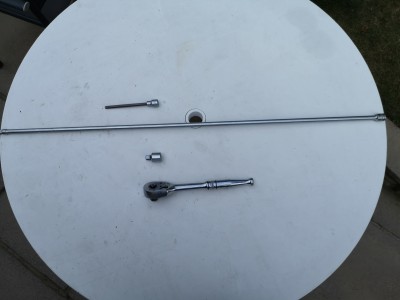

Here is a photo of the tools I use for removing the drive shaft bolts.
I use a long 6mm socket so that it can fit in next to the CV boot without damaging it and you can get into all 6 bolts without turning the drive shaft.
This allows you to leave the handbrake on so if you are not replacing the discs it keeps them in place making it much easier to re attach the driveshafts without having to hold the disc, spacer and driveshaft when aligning the bolts.
I use a 3 foot extension bar and this allows me to undo and tighten the bolts from the side of the car where the wheel would be.
You can always connect a few smaller extension bars together. ( I got this one cheap at the NEC and then had to walk round the show with it all afternoon).
By using this method it also allows you to torque the bolts to the correct torque.

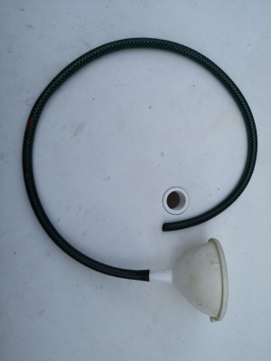

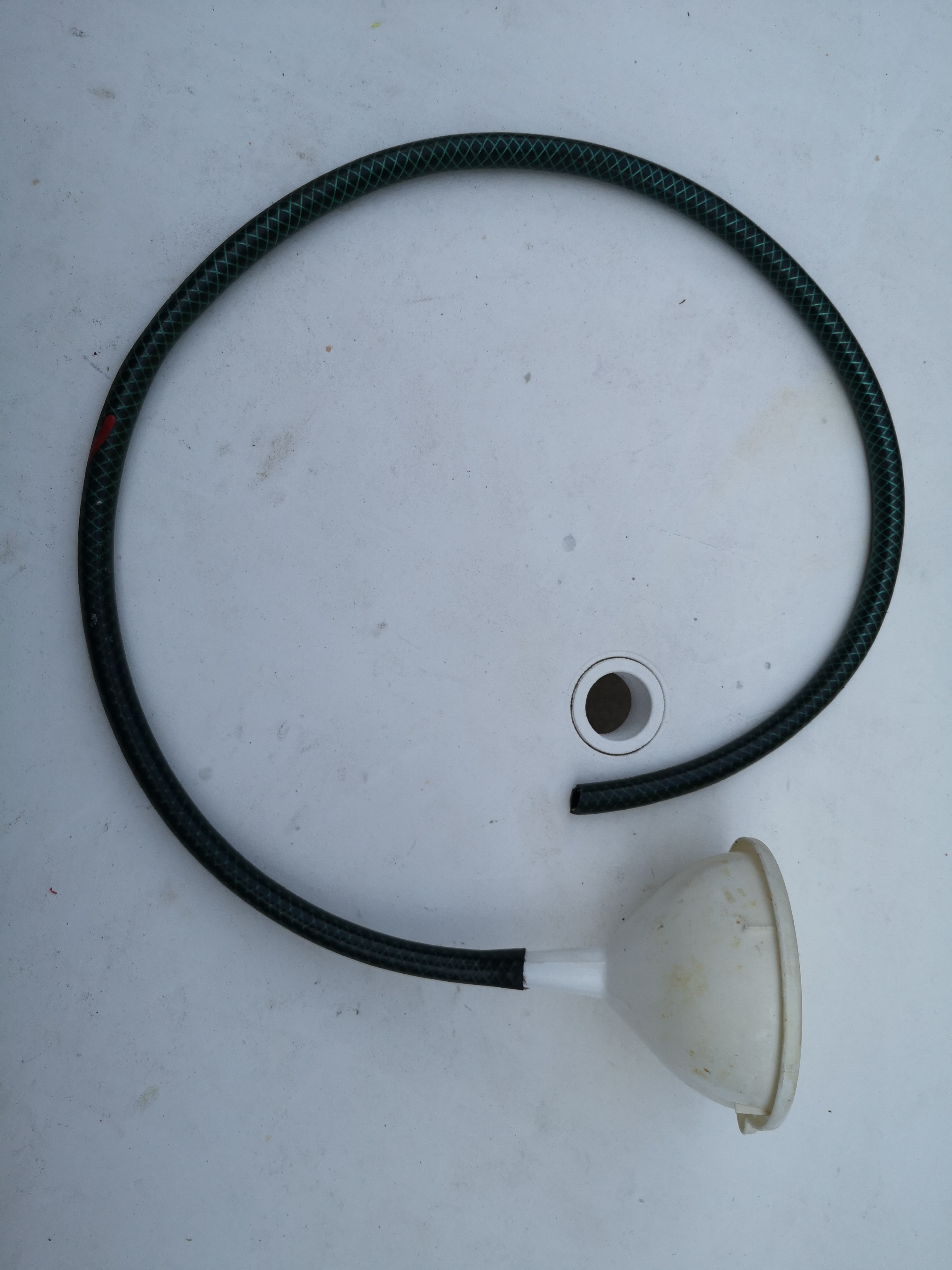

These are the very complicated tools that I have used since 1981 for filling the gearbox with oil.
A length of garden hose and a funnel!
Assuming that you have already drained the gearbox oil, jack and support the car on stands making sure that it is as high as you can get it on the drivers side (RH drive cars).
Remove the filler plug and get a willing helper to feed the length of hosepipe from the engine bay down the side of the gearbox.
From underneath the car push the hosepipe into the filler hole and hold it there.
Get the willing helper to attach the funnel to the hose and slowly pour the correct amount of oil down the funnel whilst you hold the hosepipe into the filler hole. (slightly more than the prescribed 3.4L)
Put a drip tray under the side of the gearbox.
When the oil has all been put in lower the car until it is level to allow any excess oil to drain out.
Jack the car back up, reinsert the filler plug and the jobs done.

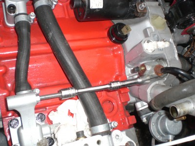

The clutch slave is a pig to get back in place, too much resistance whilst you fiddle with getting the circlip into place, not enough space or hands!
So I came up with this solution using a few sockets & extensions and a long bolt which goes into the alternator mount.
Once assembled in the manner pictured with the head of the bolt in the socket and the threads in the alt bracket then all you have to do is turn the nut next to the alternator mount which forces the bolt/extensions against the slave forcing it into place whilst being held firm so you can use both hands on the circlip insertion task....simple!

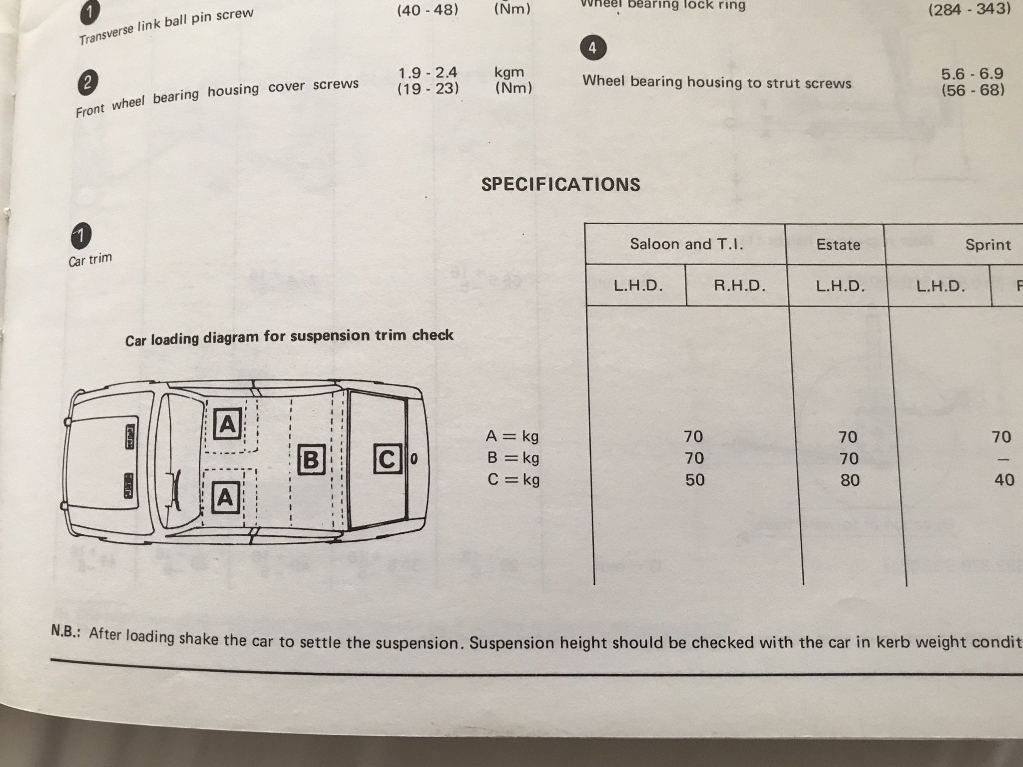

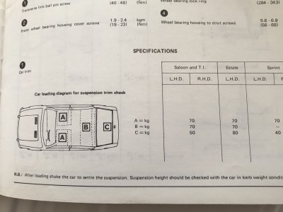

Always tighten suspension bolts with the suspension at its normal Running ride height . Simply make sure your axle stands are under the axle not the body so that the springs are taking the weight Of the car. This ensures the Bushes are correctly stressed when you put the car in the ground Failure to do this can Result in premature bush wear and eventual failure . This also applies if you fit lowering springs just slacken they bolts and retighten at the new lower height. Below is the preload weight /position table for suds and Sprints.
