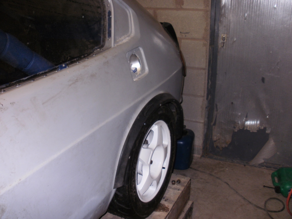

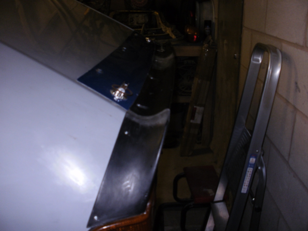

Hi All,
Lately i have been contacted by several people enquiry about converting the S1 boot spoilers to fit an S3,
here are my findings and some what painfull learning curve.
As some of you know i purchased an ex class A racer with full fibreglass panels, which i set about modifying
to replicate a trofeo racer without the wide arches to compete in the the tin tops and future classics.
I contacted Bob Wright to replicate rear wings from a pair of S3 original wings, kindly loaned by John from justsuds,
Bob took a set of templates from the original wings for future use and then went on to make a set of wings
somewere between the wide arch wings from the class A racer and the original S3 wings ensuring a perfect
fit back onto the racer.
Also delivered to Bob was a genuine S1 rear spoiler and front spoiler (also loaned from John)
Bob took a template of the front spolier in 2 pieces for future use and made 2 no full piece front spoilers for myself.
Bob also took templates of the original rear spoilers again for future use, i took measurements from a S3 tailgate and
instructed Bob to make a rear spolier to this dimension, 40mm less than the original, 2 no were produced.
Unbeknown to myself the rear wings on a S1 are 20mm wider over the rear lights than a S3 hence making the 2 no wing spoliers over sized,
also when fitting up the rear wings it became apparent that the fibre glass lower section of the tailgate was shorter than
a standard S3 spoiler, resulting in the replica fibreglass spoilers all requiring adjustment.
I then reduced the 2 no wing spoliers by 20mm by carefully cutting out a parallel section then bounding the 2 pieces back together with epoxy resin,
this was reinforced from behind with plastic splicing pieces, the joint was then over bonded with epoxy and sanded to a smooth finish. i carried out the
same procedure on the main boot spolier.

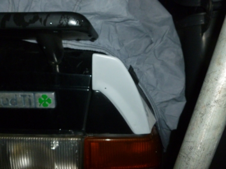

Hi Liam
well done mate, you've got that working a treat!
seeing as i'm one of those folk you've been talking to about it, i might aswell share my own good fortune in the same subject.
i was round at a lovely old fella house just last week, to see what sud spares he was selling. Amongst the stuff i knew about there were other boxes that he want to show/sell me as part of another larger package price.
one box was full of rear lights, and without diving too far in, i came across a pair of S1 tailights, Beauty!
we did a deal, i filled the van of anything he wanted to part with, biody panels, engines, gearboxes, lights and trim etc etc and off i went.
once home and routing through, at the bottom of that box was the two end pieces of the 3 piece spoiler that as you know Liam i've been gagging to do the very same conversion as yourself!
Yippeeee!
Plus, i've located a decent enough centre spolier too now, so once the postie has done his bit, i'll have a complete genuine S1 spolier.
However, i am truly torn about going with the spoiler as you have done Liam, because S1 spoliers along with the simplified rear lights and back end just floats my boat big time, and my sud will essentially look like this
or, do i use it as a basis to build what neither love nor money seems to be able to find, but simply, and absolutely, Rocks my World! Twice!! every time i see it!
i have tried to get one through Fabrica Italiana, the portuguese guys who replicate the original Trofeo kit, but i don't think they do this part, but i do think i will be able to come up with something of a fabrication and fibreglass that would be close enough for the look and effect for me.
Your Sud is going to look fabulous Liam, of that i'm sure.
I'm not so sure what sort of a job i will make of mine, but i'll be giving it a damn good go!

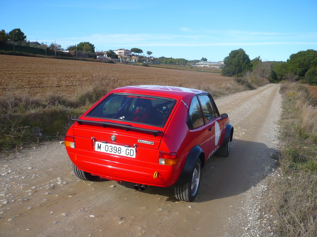

Re: S1 to S3 Boot Spoilers

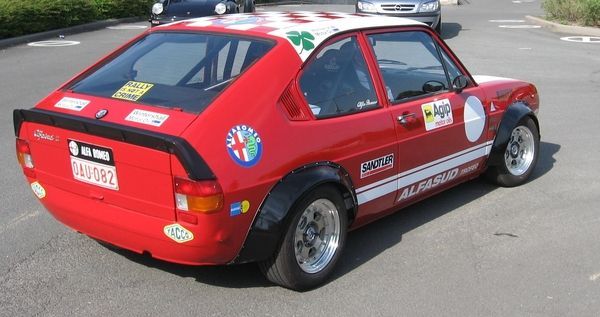

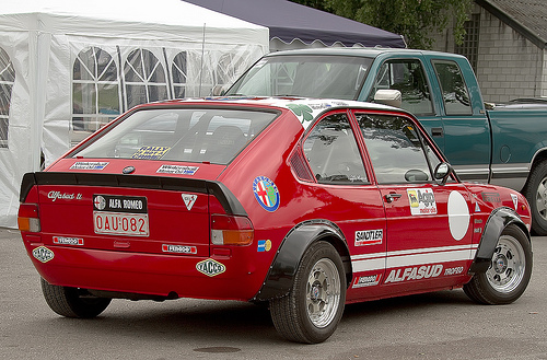

Spot the difference...

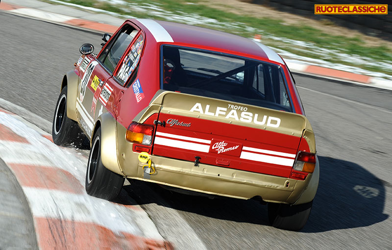

which also works! ha ha!
my personal issue, is that if i did that, my Sud would look like a grey plagurism of Teds, which would be gorgeous of course and i'd do it in a heartbeat, but then neither would be quite as unique, and thats as important to me as i'm sure it is to Ted too.
they all look great really, tough to find a bad'un!

Some more pics of how i aim to acheive a semi trofeo look by using a modified S3 spoiler kit.
And a little teaser for Shrew, i toyed with the full width trofeo kit and fited it up with the compomotive
to see how it fitted, hard work to fit up and the 60 series tyres on a 13inch rim don,t look the best.

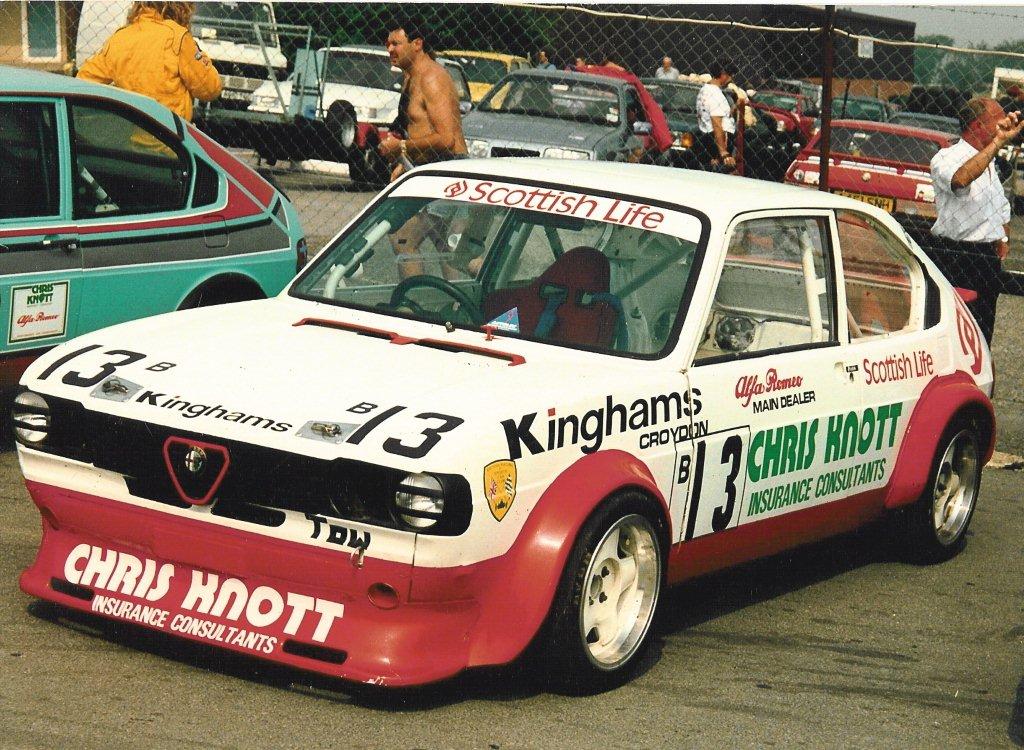

Hi Shrew,
A pic of your front splitter from 2003, the other photo is from the 80,s prior to it undergoing
the fibreglass treatment (blue), i prefer the splitter on the blue sud to the trofeo and white sud,

Yes i bought the car from Andy Steavenson, i beleive a guy called Paul Fasey owned it prior to Andy
and he bought it from Nick Humpries.

That second picture is of the car in 1989 when run by Paul Fasey. He bought it from Nick Humphrey at the end of 1988.88liam wrote:Hi Shrew,
Liam
The man in the background holding on to the fence is my Dad who, unfortunately died in 2003. So, thank you for posting the picture - it's made me very happy and sad in equal measure!
Ted.
