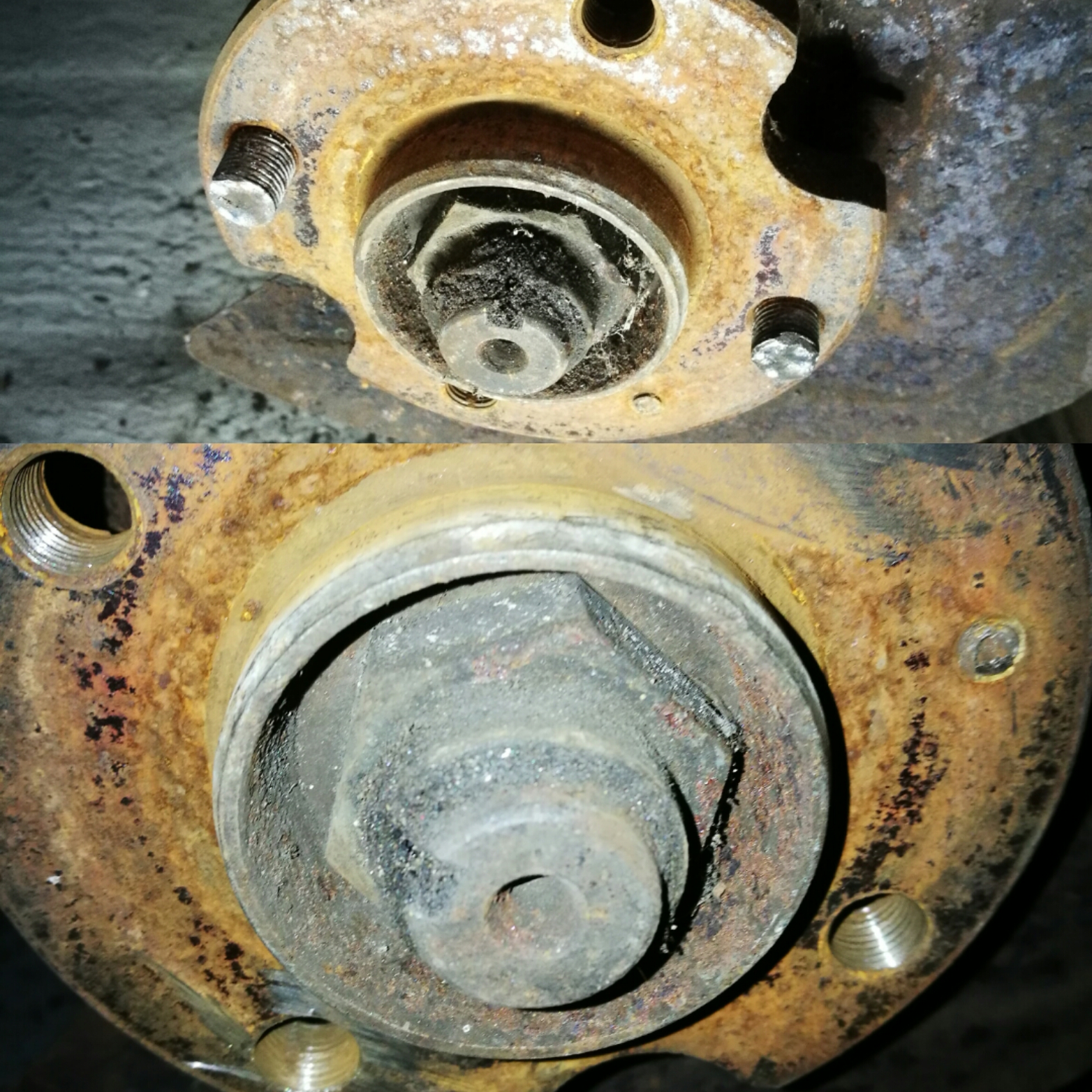

First job was to cut flush and then drill out two snapped wheel bolts .Then I lightly filed them ,till I could see the threads .Then tapped them. Next I had a little play with one of Carlos fandango alloys I got off a certain person we all know

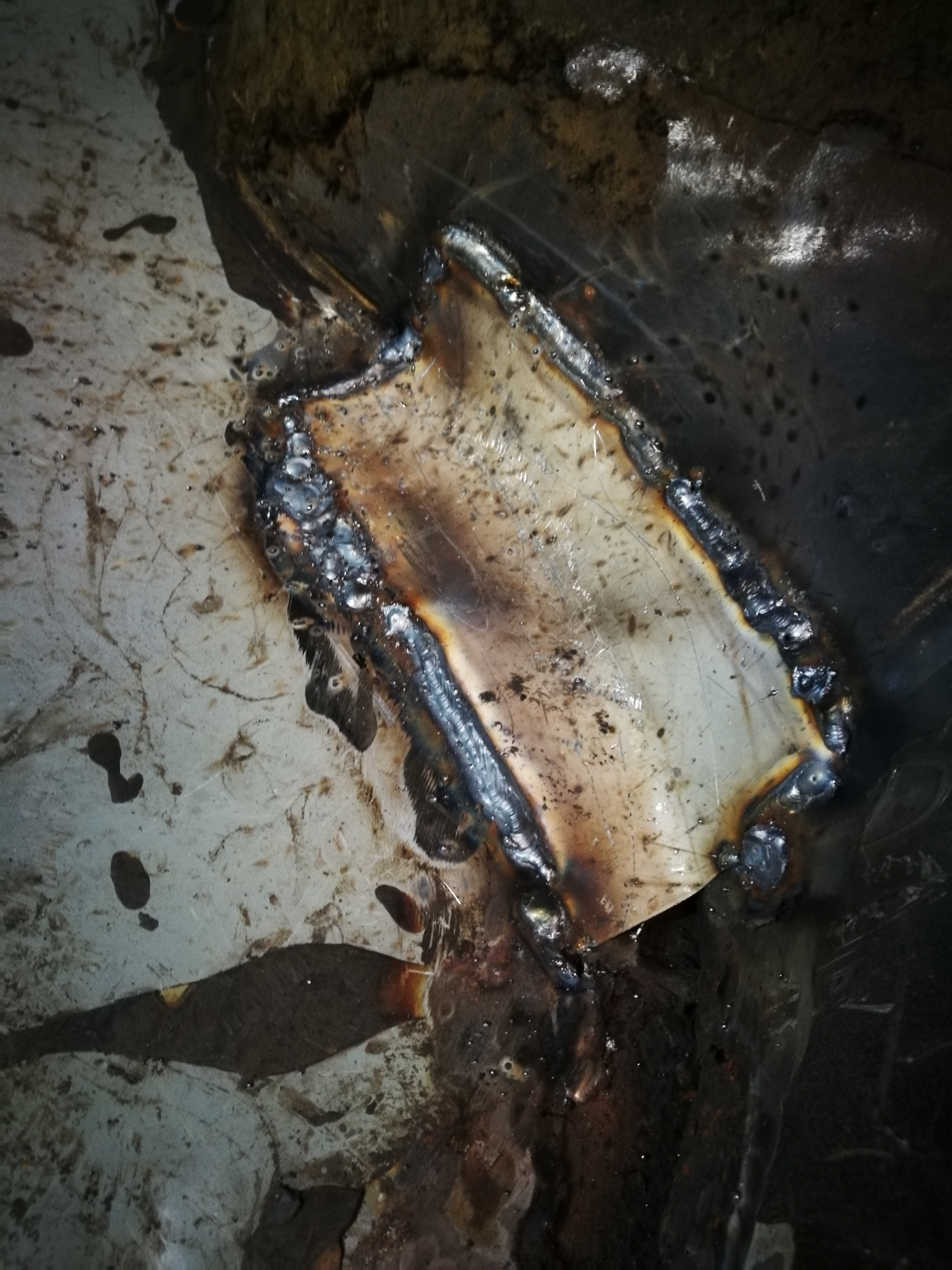

Well I finally started welding today . Most of the cabin is done now bar about foot of plating. Had a nice little fire on the passenger side where the fuel and brake lines are . To the point I was thinking.time for the fire extinguisher I'm plating along the floor to the inner sill. This will be finished tomorrow afternoon .

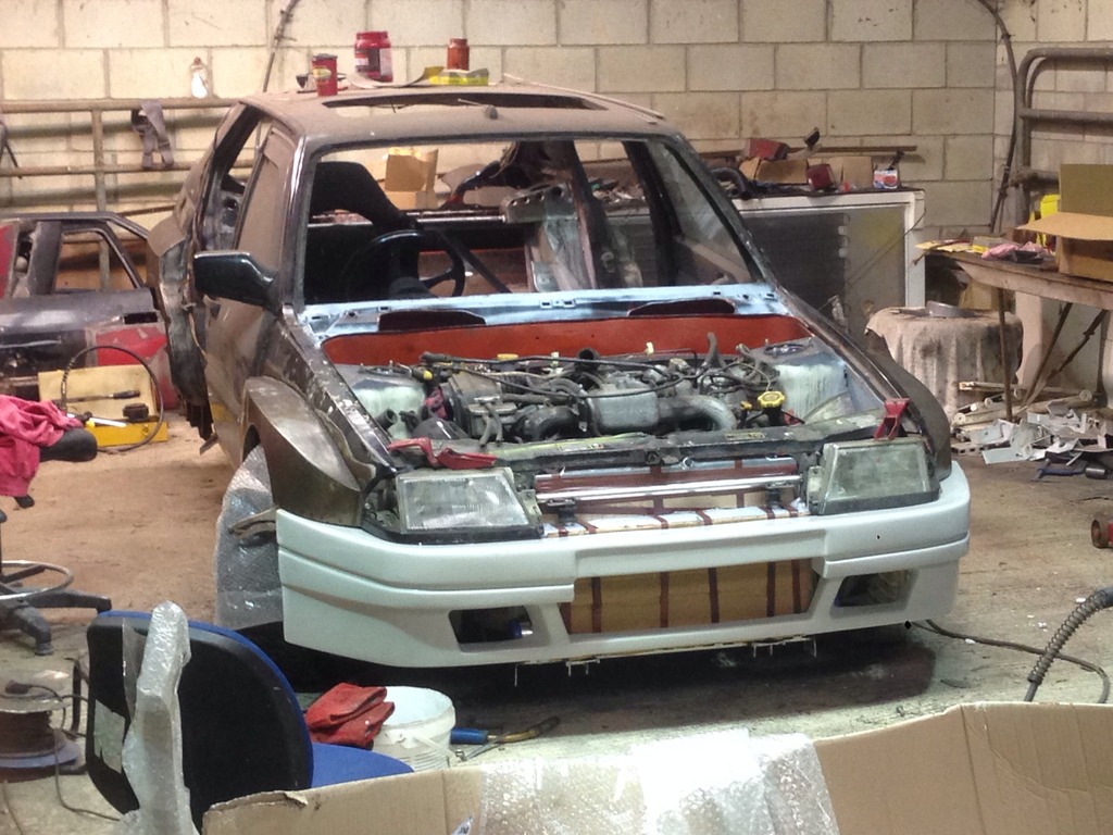

JB, have you ever seen this guys project ? All steel.
Re: Alfa 33 s2 16v Resurrection
Evening Keith
Interesting why to get underseal off
Yes it's based on Subaru platform. Was on the forum of Nazi moderators
Hmmmmm nice arches

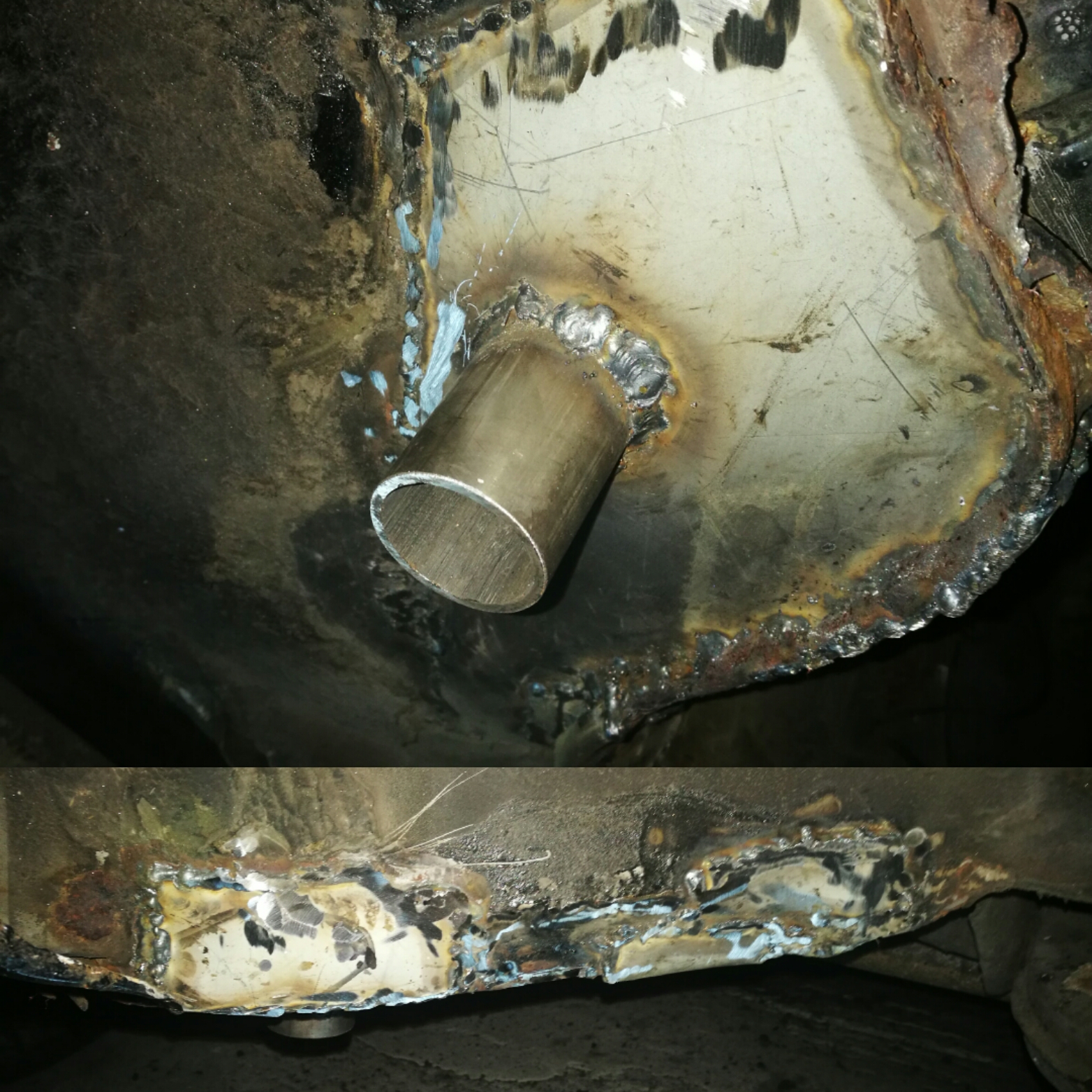

Bit of progress this afternoon. Front inner arch and front jacking point rebuild. Still waiting on the lower sills . But I'm happy if I can do little bits to keep moving forward. Won't win any welding awards. But it's strong

strong welds are always the aim mate, anything else can be covered in seam sealer looks fine to me
at least you'll be able to jack it out without looking for the dimple in the carpet!

True . Need to get some seam sealer . happy with the jacking point. Refitted the side skirt to see the if the length of the tube was to long . But it's spot on . 50mm .You can just see . Which will help when jacking.

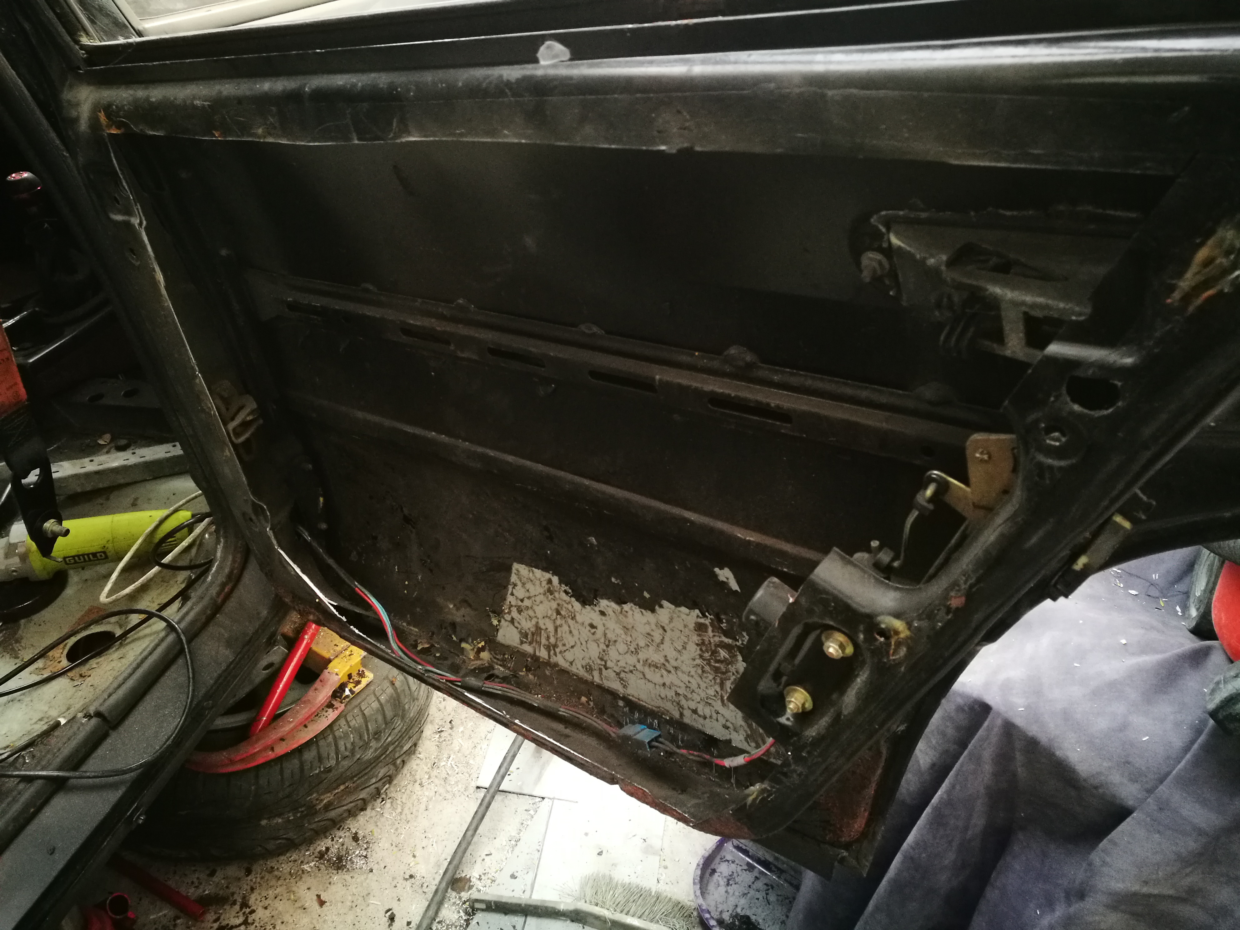

Fun day working on the 33 today. No gas as the shops closed today. So thought a spot of weight reduction is in order. So started on the rear drivers side door. Off came the door card . then i noticed part of the sound deadning was missing and a bulge panel was straight. Warning filler alert . So a bit of hammer time As you can see .The whole section was filler . Now they have done a great job in the mid 90's im guessing .As I've owned from 99. BUT they had shortz the inside of the door . So why didn't just knock the damage out so about half an hour of chizerling . All the filler was removed . Which I weighed to see .And it came out at 663 grams now as they had the door card off .Just hammer it out . Like I did . Probably took the bloke a morning to fill it So back to the weight reduction. I've cut out most of the inner door .But I've kept the central locking mechanism. The front doors I'm going to keep the power windows too . But I'm going to cut as much as I can from the inner panel. All windows are now out . I've weighed parts to keep a track of most of the reduction. Then I can add when I put in the poly Windows. I'll be covering the hole with an aluminium sheet .More for looks than anything as this is going to be a bit of a show car to promote my business. But that will be more the bodywork and wheels
