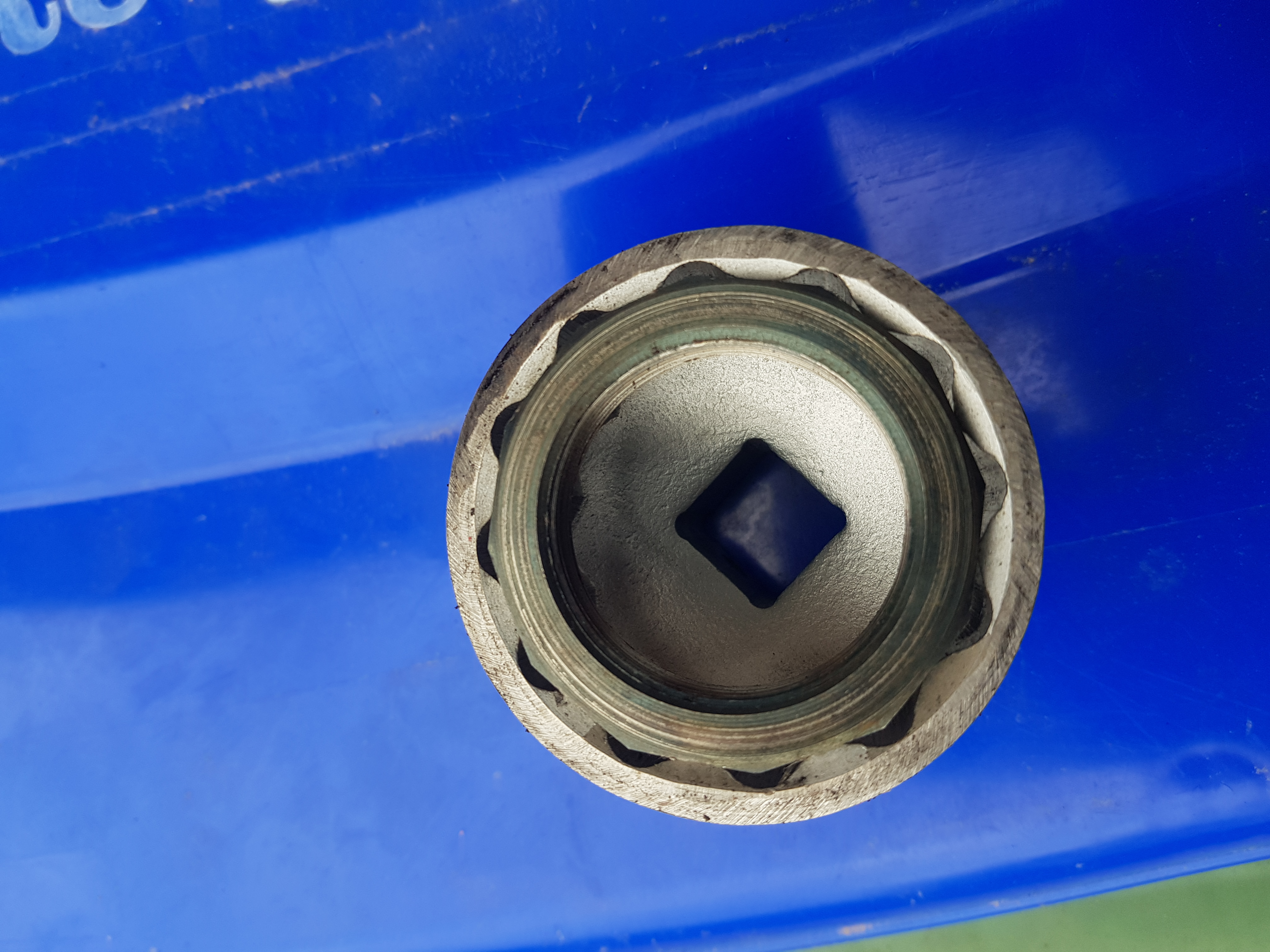

Thanks very much to Kev for this guide.
I part disassembled my Sprint's front hubs so I could repack the bearings with new grease, replace the seals & fix low preload on one bearing. By removing the nut you can take out the outer ball bearings for clean up, but the inners are captive inside the hub so you have to clean them out in situ unless you press the outer race out of the hub.
In the absence of the special Alfa tool to undo the big internal nut I used a 52mm bi-hex socket with the outside ground down so that the socket could fit inside the hub (after the grease seal had been removed). I couldn't find a 52mm thin wall socket for sale at a sensible price. Note the nut measures approx 55mm across flats but this is misleading, a 55mm socket won't do the job. As you can see the 52mm socket is a very snug fit on the nut, very much flank drive, in fact I needed to give it a few light taps with a hammer to make it fit. I also ground some material off the front face of the socket so that the full depth of the nut was engaged in the socket. Rounding off the nut would be a catastrophe.
The new nuts I obtained from a respected vendor are slightly smaller than the originals & as you can see they fall to the bottom of the socket & the drive is more towards the tip of each flat. A 51mm socket might fit, (if you can find one) but as large sockets are pricey I decided to swap the original nuts over & reuse them rather than risk rounding out the new nuts. You are after all pulling around 300Nm of torque when you tighten them.
