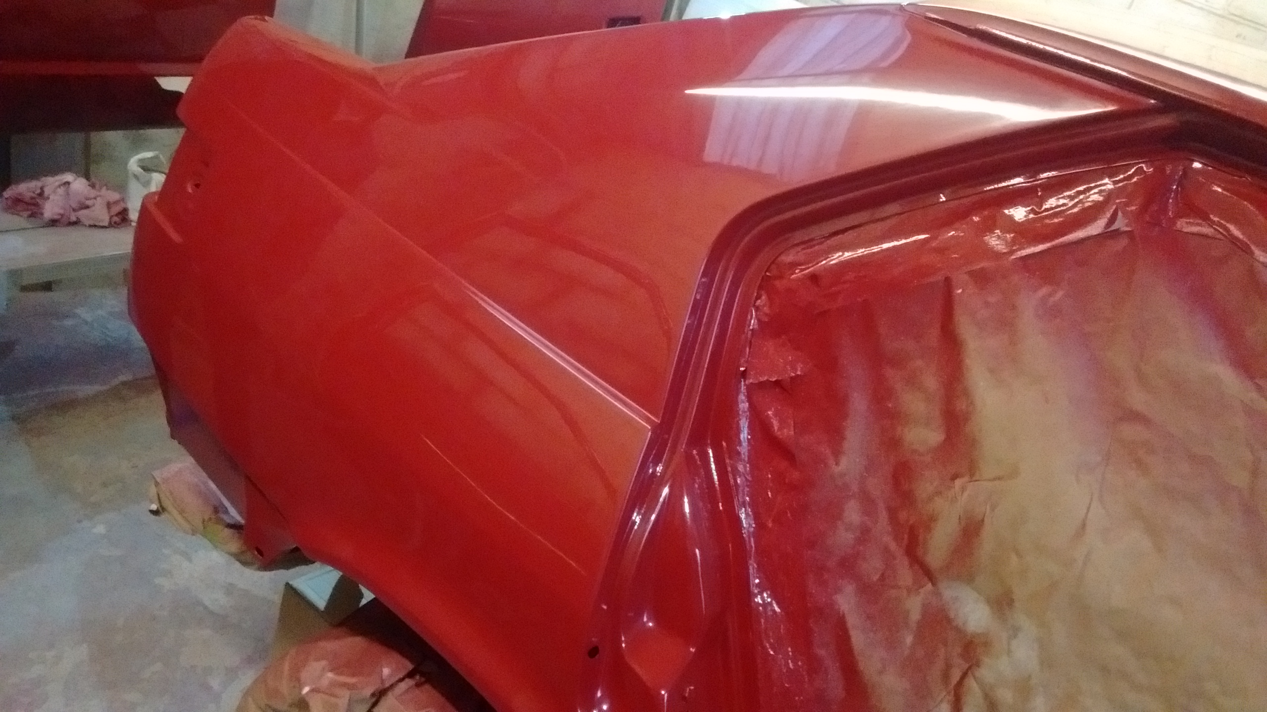

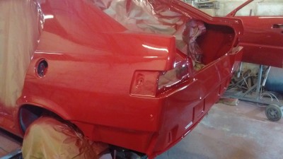

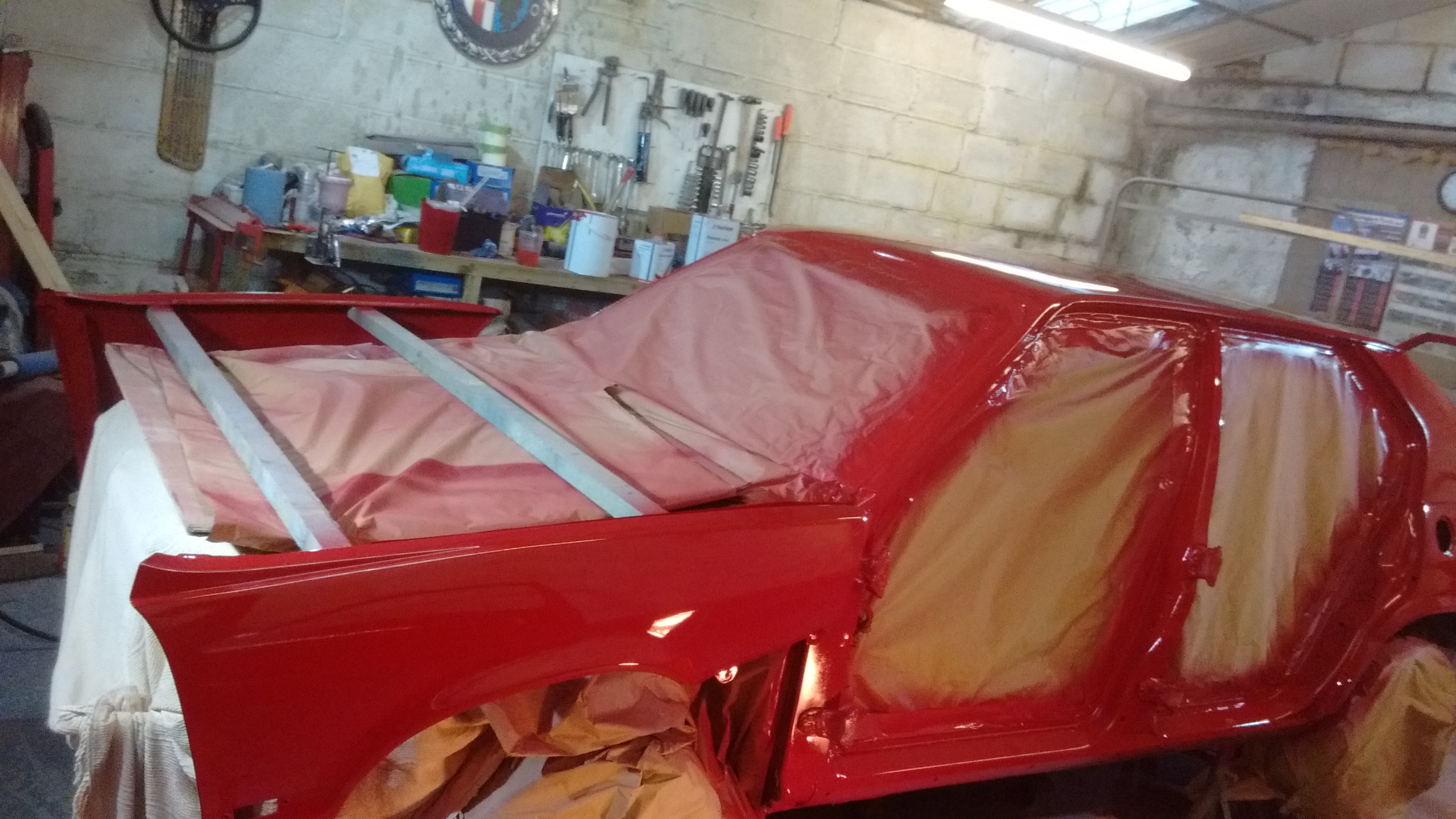

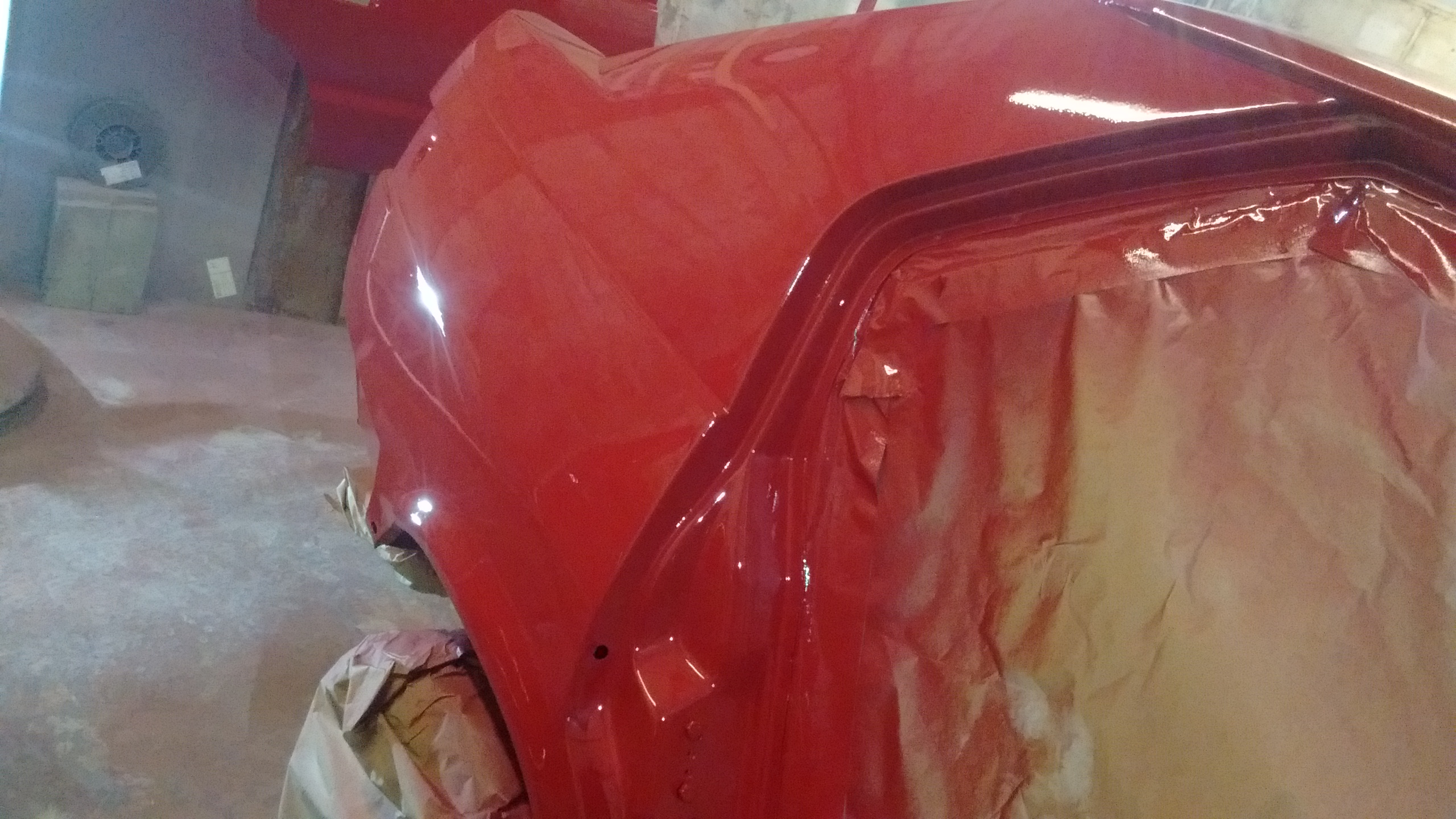

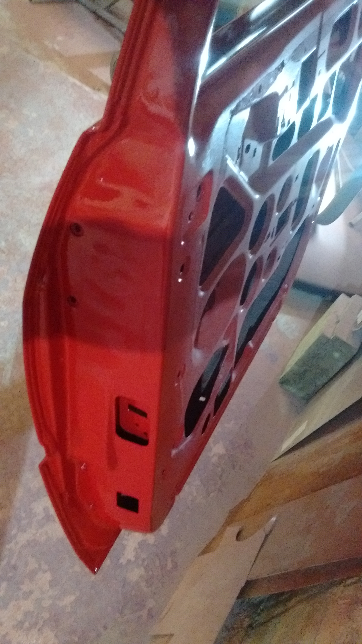

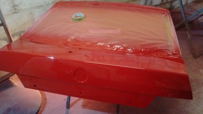

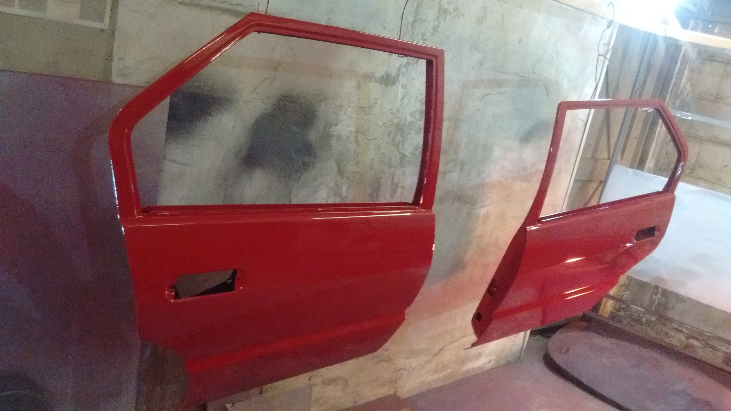

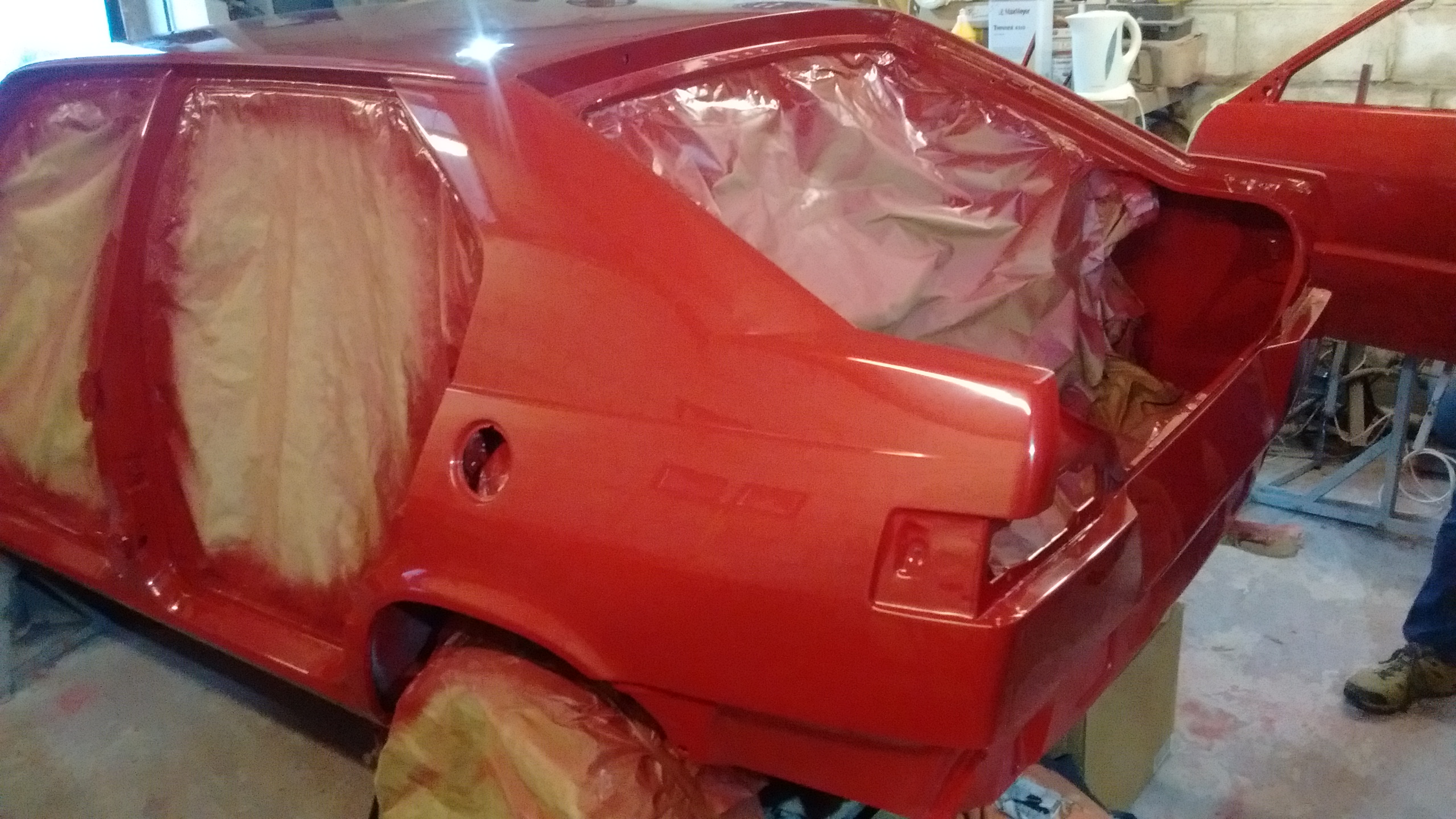

another long day but well worth it.
started off early doors and sanded off the rest of repaired roof section plus a few bits like the door shuts, Pauls' help was a great bonus.
then we had some tidying to do! what a mess
car re-masked, de-greased and wiped down then everything repositioned just so, hardly an inch to spare in the unit
rear hatch was a bit tricky as the underside has far more bare metal on show than I'd thought so with the inner window frame painted we flipped it over so I could paint the outside, couldn't have done that on my own, an extra pair of hands today made all the difference
anyway, this is the finished result....

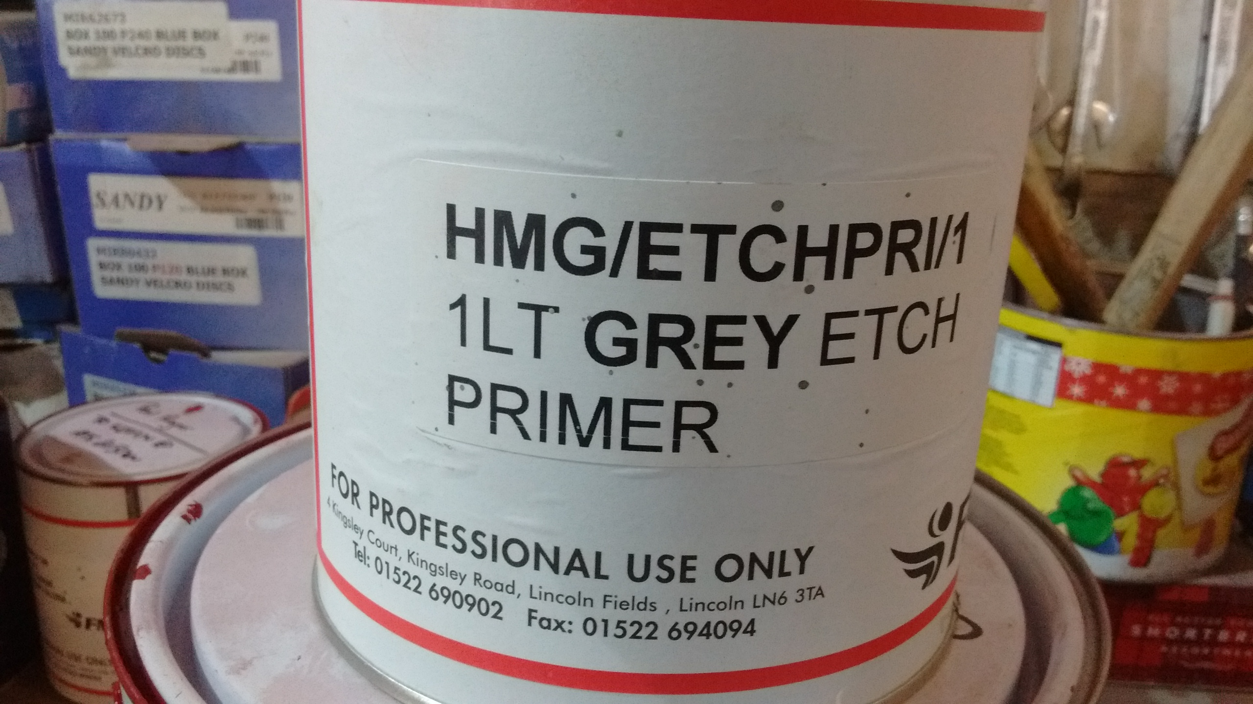

Must be a rebranded etch ?
The car looks great . Nice finish chap what gun is your weapon of choice. I'm a devilbiss man, gti and Sri pro for small jobs . The 33 is going to look great when it's finished

yes, it's a devilbiss one but couldn't tell you what model....can do when I have a look though
used to use a £20 ebay one which I still use for priming, but this one just seems so much better.

Bloody 'ell Kev, do you ever go home to sleep ??
The car looks great mate. How do you extract the over spray as it looks clean .
Top job.

has been 3 12 hour days or thereabouts mate, i'm knckered! we're off to donington tomorrow for some BSB action so a day off at last!
the unit was previously used by a shot blast guy who installed a ruddy great extractor fan and handily left it there in my little unit it sucks the air out pretty well, do have to plan where & when I make the order to spray though but clears the air within a few mins

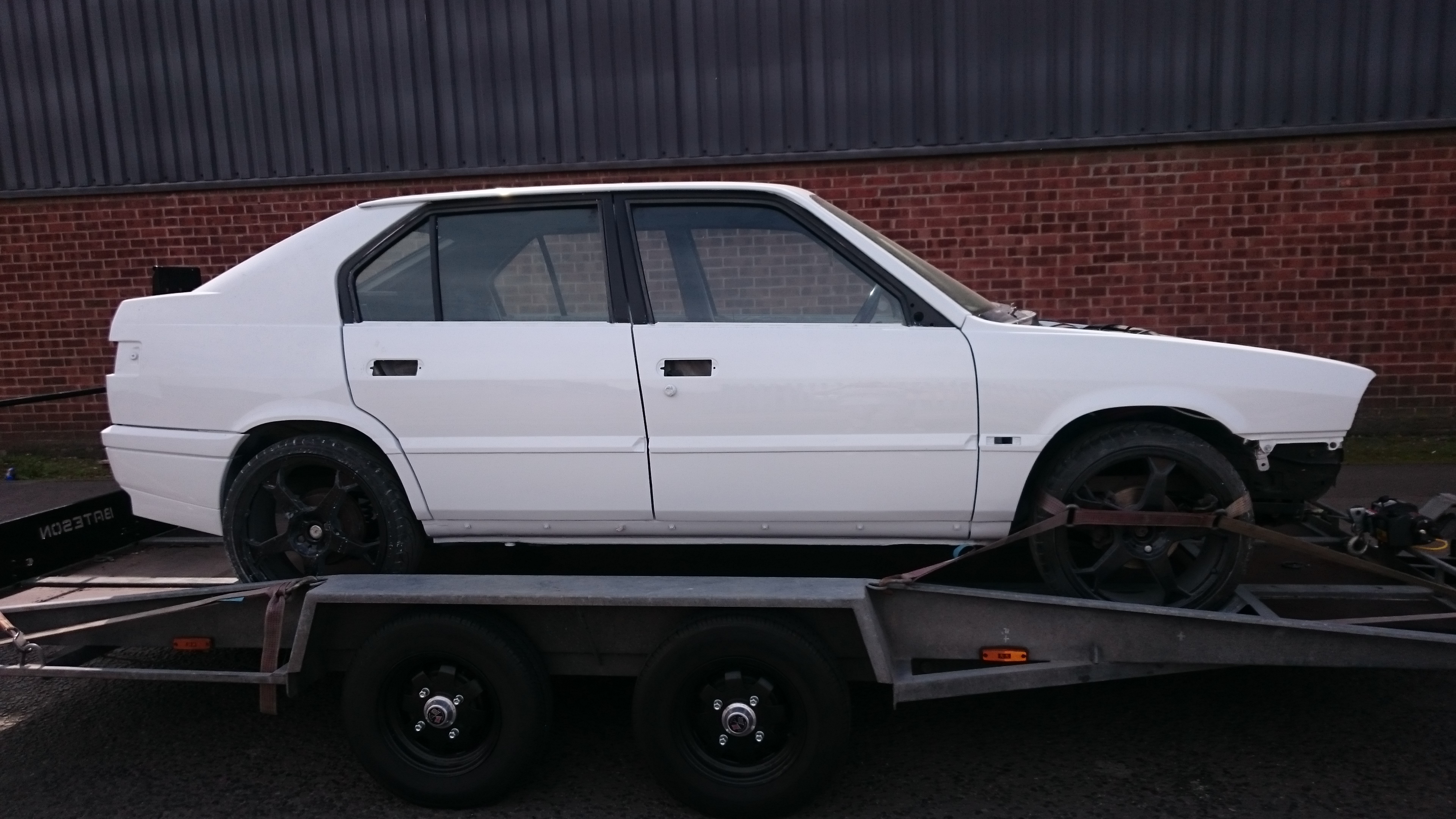

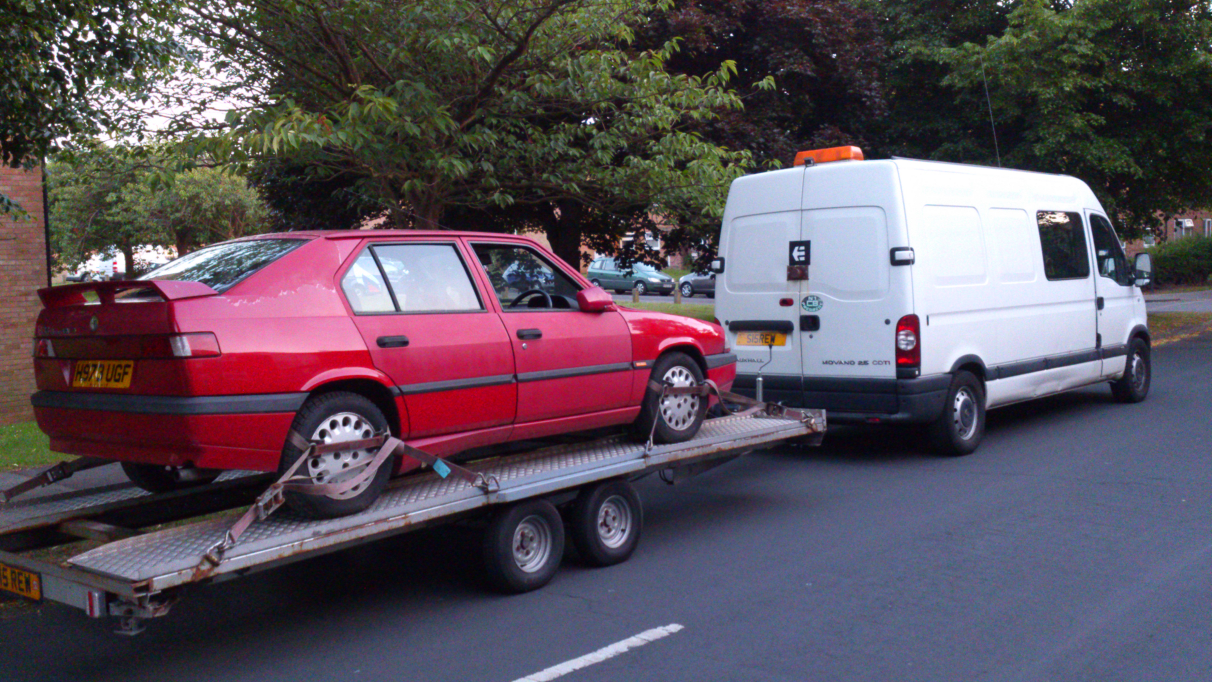

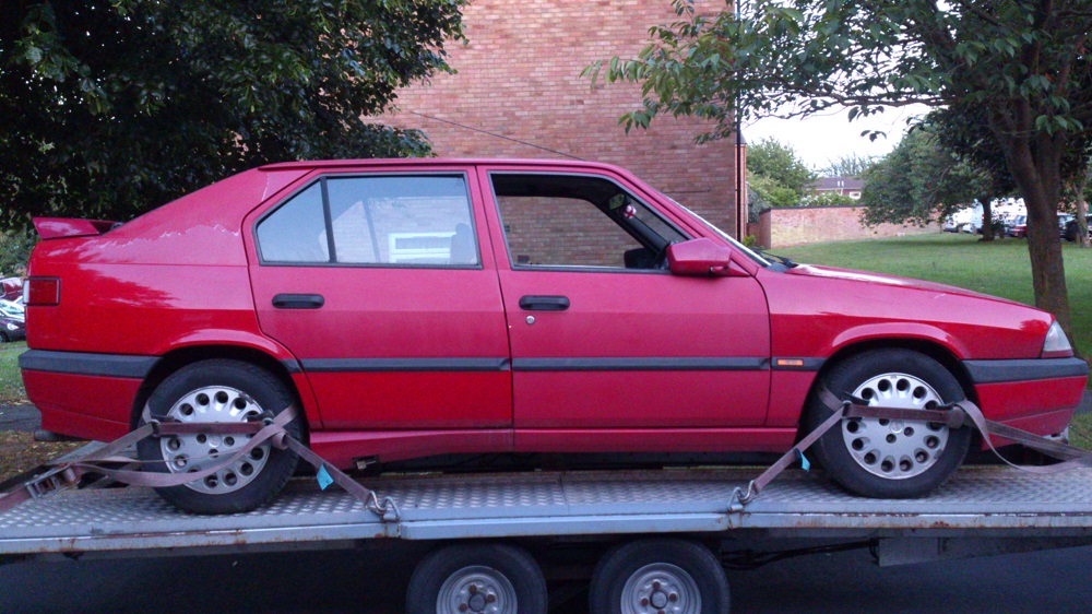

and now would look a great time to reflect on its humble beginnings too,
its come a long way Paul since i unearthed your car from a lengthy garage sleep!

it is the same as VJM was
amazing difference between now and then mate, poor old girl has had some work since that picture, but she's well worth it. a more solid 33 would be hard to find

Good to see it how it was, so once Kev has done his magic with the paint (I will be helping flatting and polishing later today with him) it will look a million dollars.petrolhead wrote:and now would look a great time to reflect on its humble beginnings too,
Then comes the rebuild, so I will keep the pics as a driver to get it done, hopefully ready for the Italy trip in Sept.

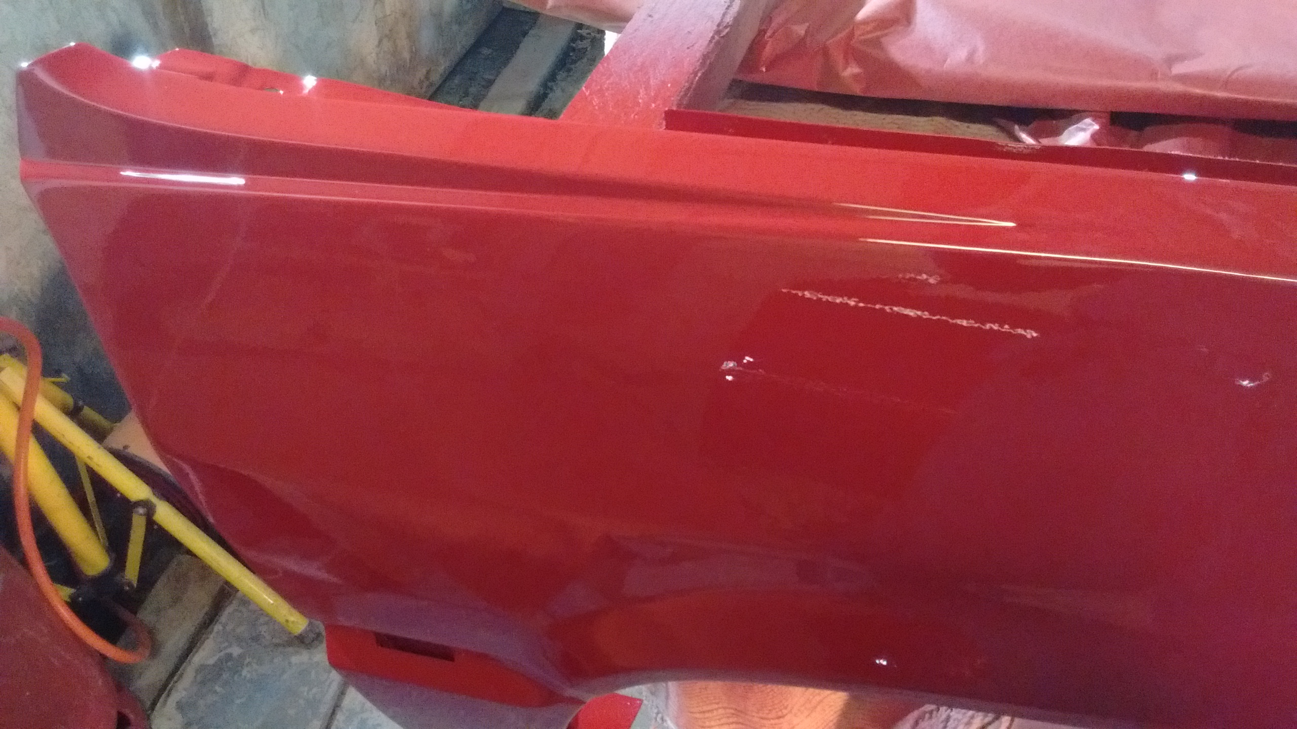

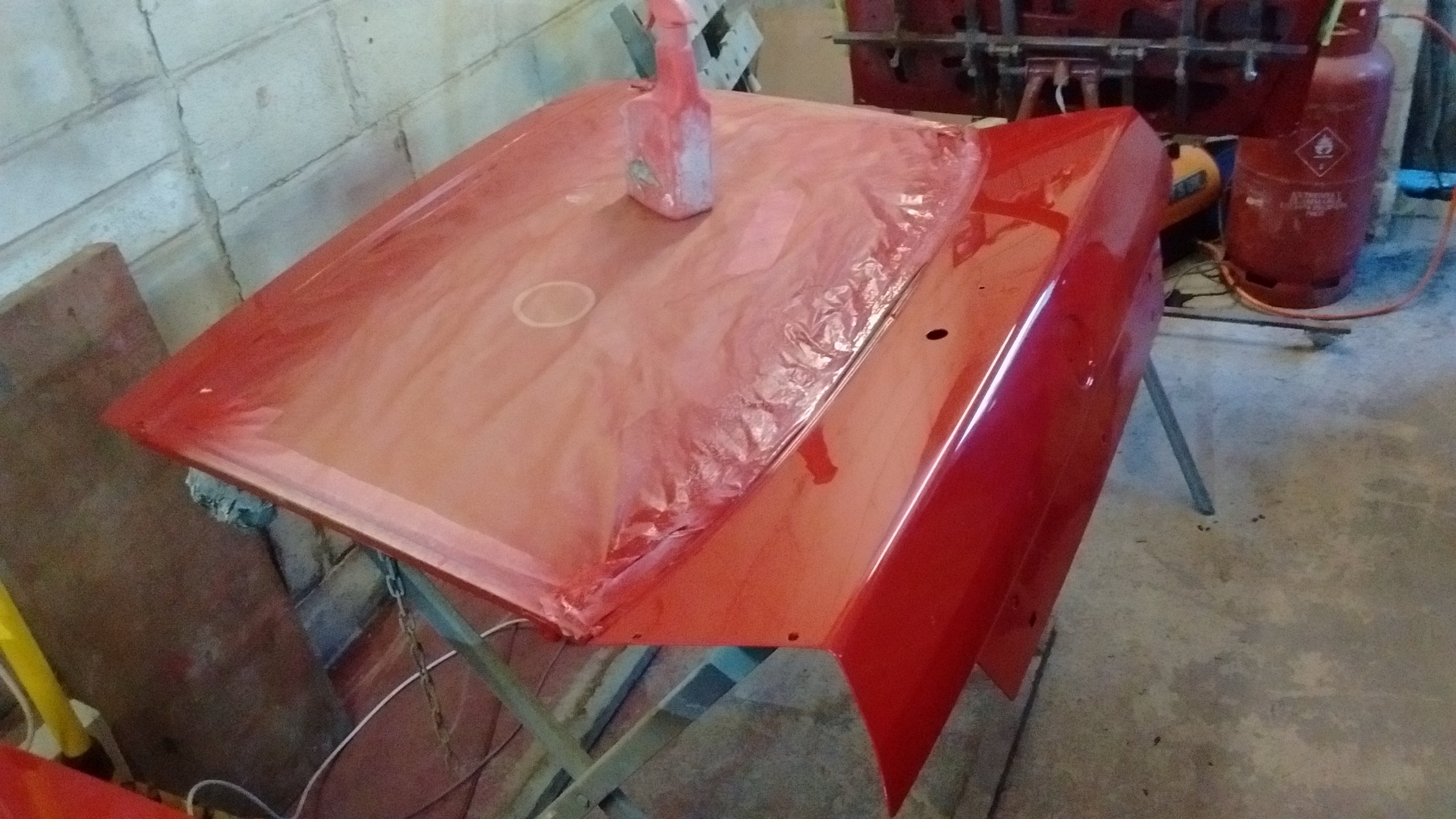

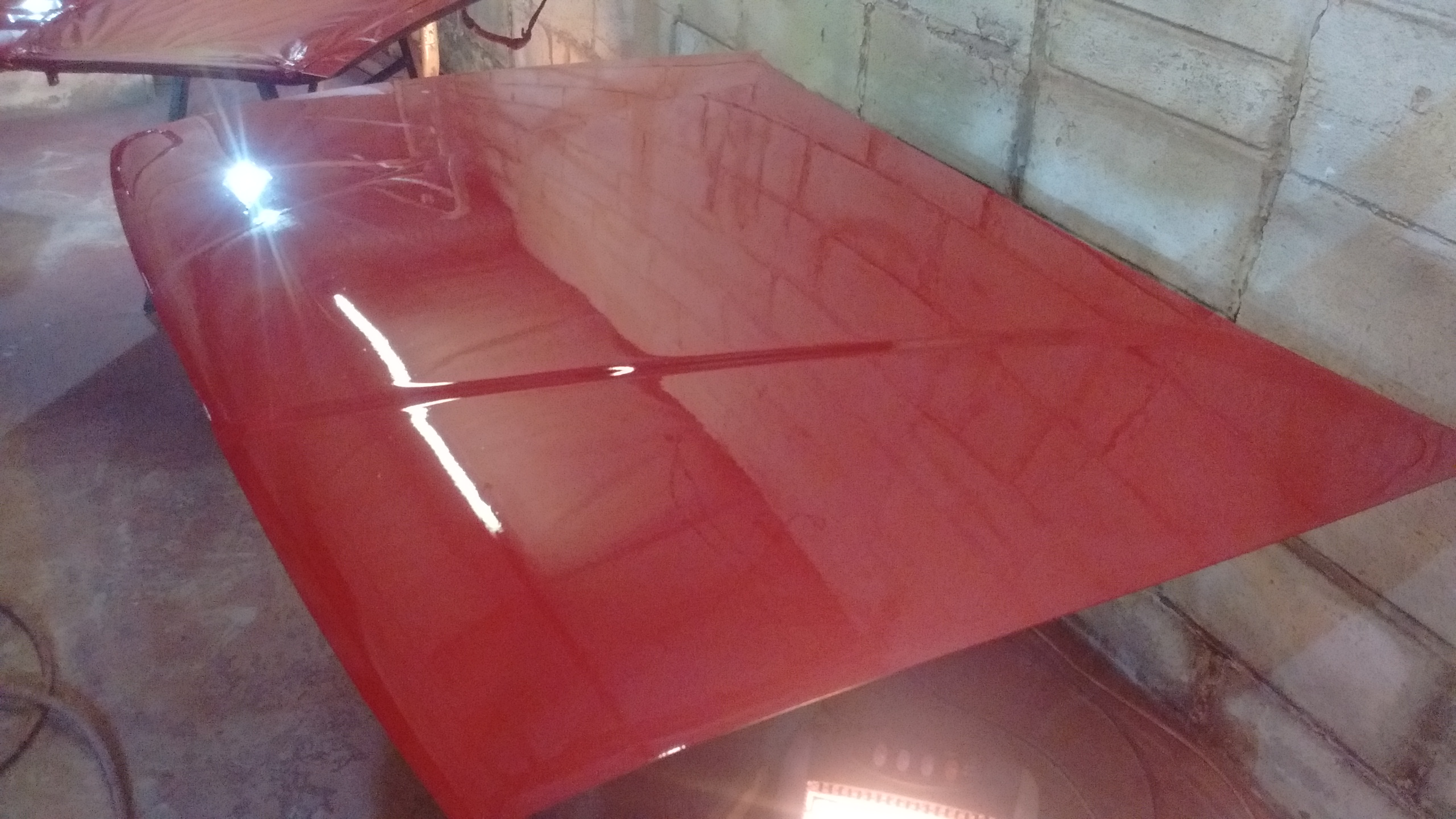

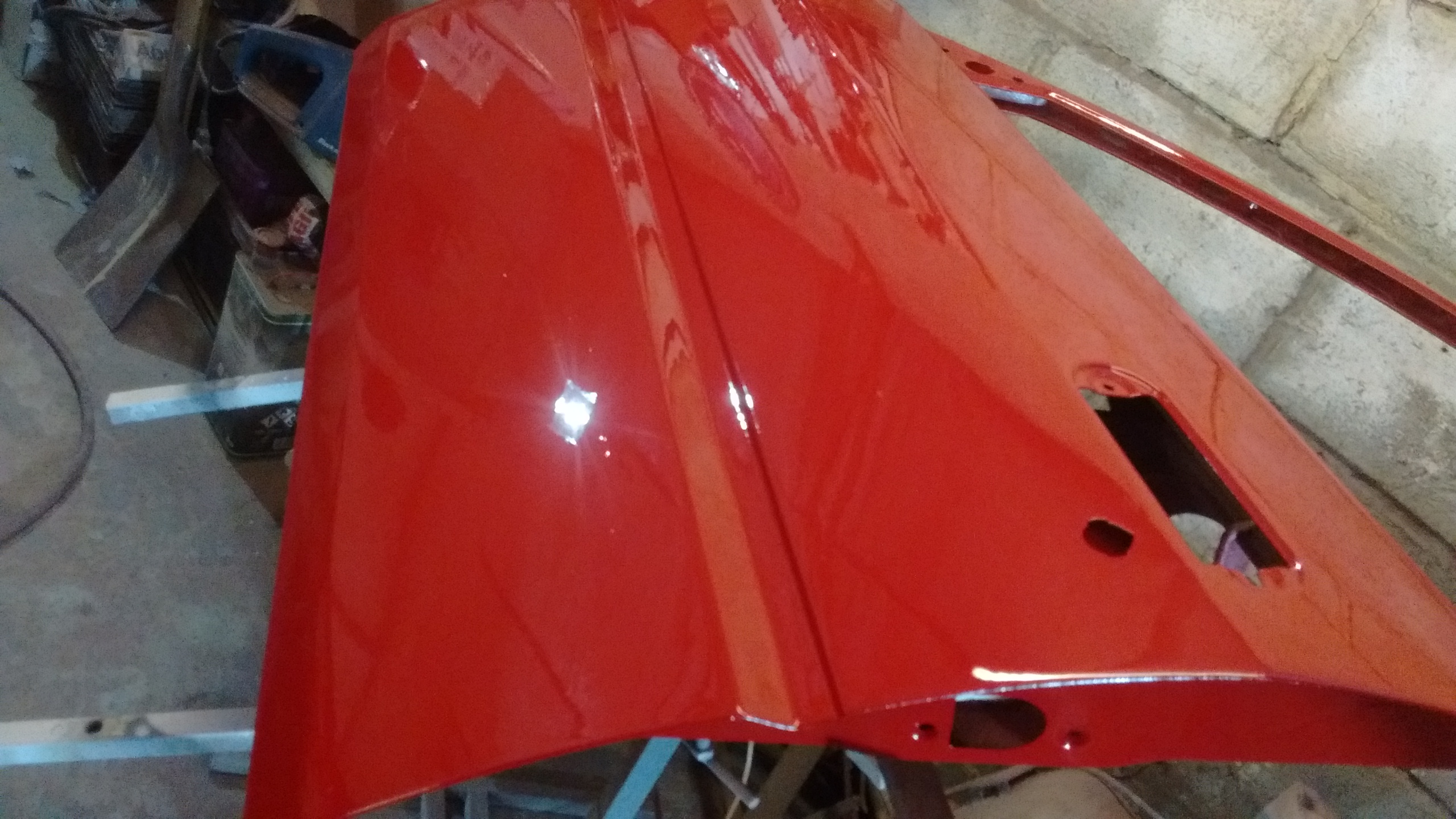

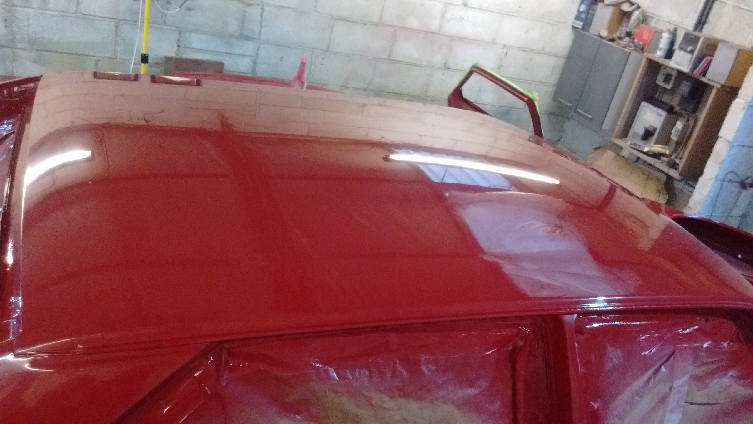

fairly productive day, makes life so much easier with an extra pair of hands so more done than I'd usually hope to get finished.
managed to get the roof, bonnet, front doors and rest of shell flatted and polished up, at least most of the stages of polishing. still a couple of stages of finishing to go but the surface is now nice and flat with the shine coming back
paul did have a fright though, gave him the task of using a DA sander with the 3000 grit trizact discs on to go over all the freshly flatted paintwork, quite a nervy thing on the freshly painted surface. when he shouted out that he'd burnt through the paint on the bonnet we both feared a bonnet repaint was in order, until we spotted it was a sunlight reflection causing a very convincing line right at the swage line! panic over, but was a nervy time for him

we all have those moments every now and then!

So had a great day with Kev and has he said had a scare with the bonnet, phew damn sun and blue skys!!!!! playing trick on me.
Looking forward to getting the polishing finished and the masking off doors back on etc.
