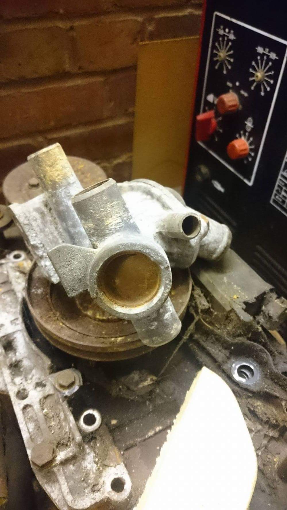

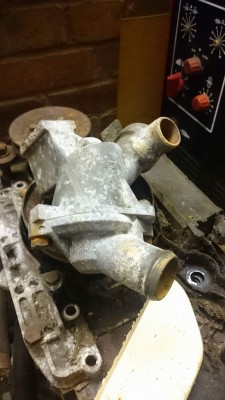

Is that the housing with replaceable thermostat Colin?
- Alfamet
- Posts: 418
- Contact:
Re: It begins...
Looks like this Tony....

Another view of it.

Re: It begins...
That's exactly what I'm after.junior wrote:Looking good to me. You should have much peace of mind after this is done.

Thermostat housing now sorted. Thanks for helping me out Tony!Alfamet wrote: Another view of it.

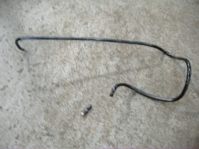

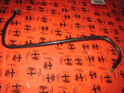

Re: It begins...
Is that clutch pipe the right one Colin ? It looks a simpler shape than your original, - perhaps a 33 one ? they come through the bulkhead in a different place, hence the slightly different shape.

I'll know next week John!justsuds wrote:Is that clutch pipe the right one Colin ? It looks a simpler shape than your original, - perhaps a 33 one ? they come through the bulkhead in a different place, hence the slightly different shape.
John.
Re: It begins...
If its the wrong one Colin give me a shout, sure I have one in the box o bits.. Rich.

Well, after a bit of a delay Alfie lives again!
Finding a usable replacement clutch union pipe proved to be difficult so, to save time, Euan at CP Garage had one made up in stainless steel braided pipe by his local Pirtek branch. A further delay here was caused by the fact that the pipe made and marketed by Goodridge as being suitable for the Alfasud and Sprint turned out to be way too short (see photo) so be wary of this if you decide on the Goodridge item.
