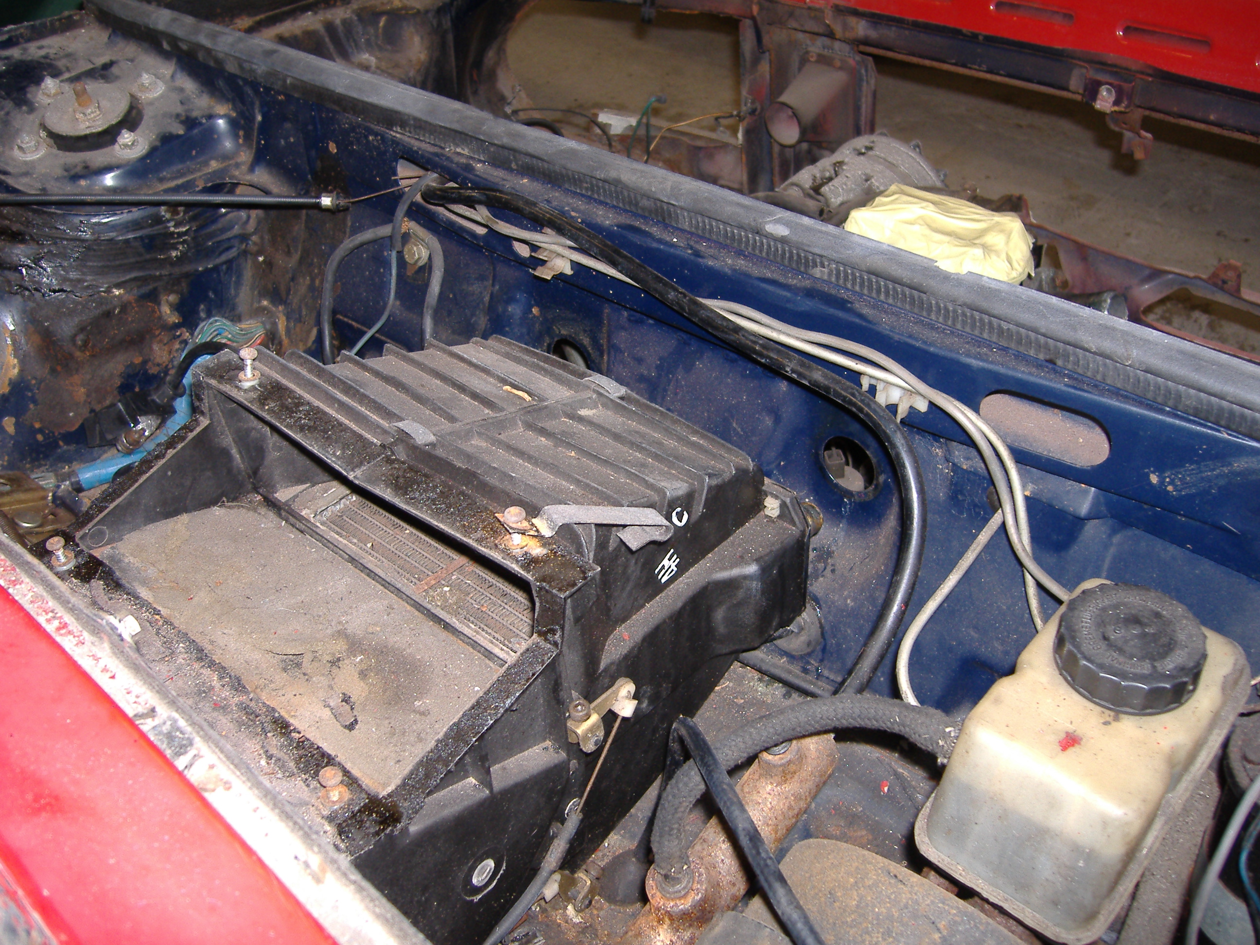

Now trying to get the heater in. Its the right one from John at justsuds and so is the plastic piece that ducts the air to the screen but I just cannot get it in to place.
Heater goes in fine without it, but when the piece is in place above it I cannot get it in. Any thoughts please ?
The duct is hard up against the dash and locked in correctly on to the heater. The angle changes a bit depending which way you put the duct in but neither allow it much better than can be seen above. Hope that makes sense.
Had the dash out to ensure its not catching that end and the wipers linkage has been taken out as well.

that trunking piece between the heater box and dash does indeed sit inside the car, slots in before the dash goes in
the heater box is tight enough without the extra 1" in movement you're losing by having it in the bulkhead space ..

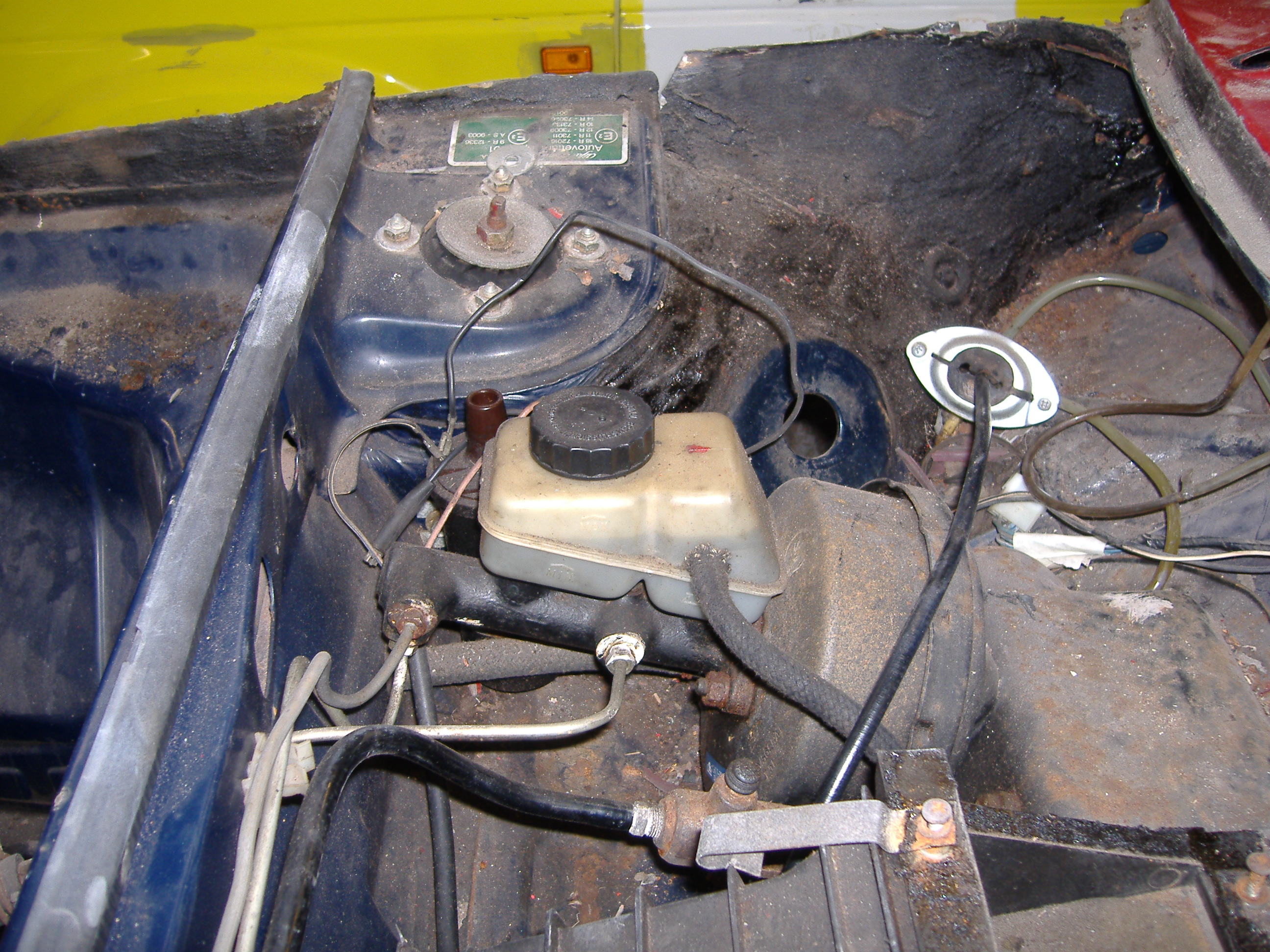

Pictures are a bit rough. If they are no good I will try and get better ones for you of the finished car. :D This was when I was stripping it out.
Just clicked on what to do and why. Will post a photo later to explain it.
Very handy photo's as mine was not that complete. Thanks.
I was going to replicate how the car was originally, but following your photo's it got me thinking and I realised the reason the brake fluid reservoir was against the bulkhead was because of the heat from the exhaust and so a fire hazard.
As the exhaust no longer follows that route there is not reason to go to that effort. I had not realised that was the reason I thought there was some other cause or advantage, such as it being more secure in the event of an accident.
If anyone feels my logic if flawed please feel free to speculate as well.

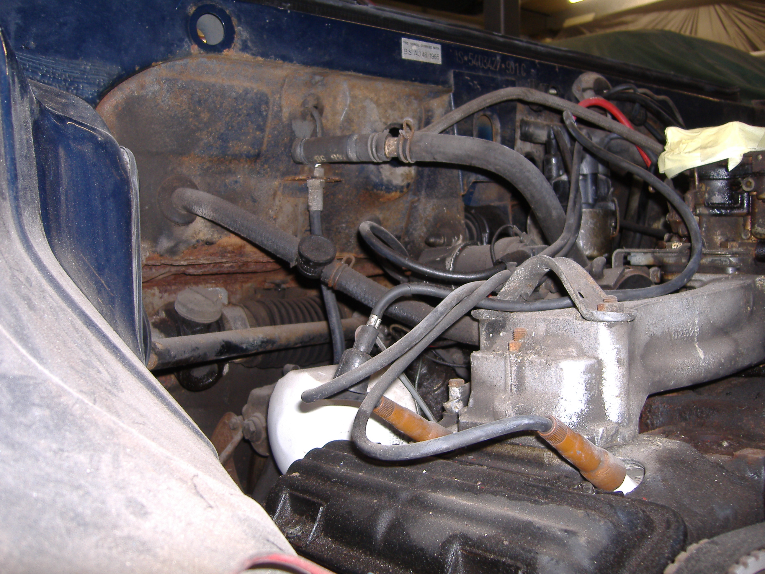

This pipe on the servo goes to the carb manifold I believe, but exactly where ? Thanks for your comments as ever. :D
These show where it comes through the bulkhead, but obviously this is a single carb. Twins must have a similar set up on one of the manifolds.
Hope that is a start. ;)

servo pipe goes onto drivers side manifold ;)
Ah ha, I see now and your pictures are excellent, thank you. A dead straight run then unlike every other pipe on the car ! :lol:

Sorry but I can not help with the plastic thing, I just fitted it. I think it may be some sort of one way valve :idea:
:D
Ah, I wonder how much it is needed then, or if it just makes for better feel on the brakes.
A one way valve does make sense. in my anyhow ! :lol:
one way valve is vital for keeping vacuum in the servo ;)
so make sure you get it on the right way around! think it says "to carb" on the outer rim or an arrow pointing to carb, something like that

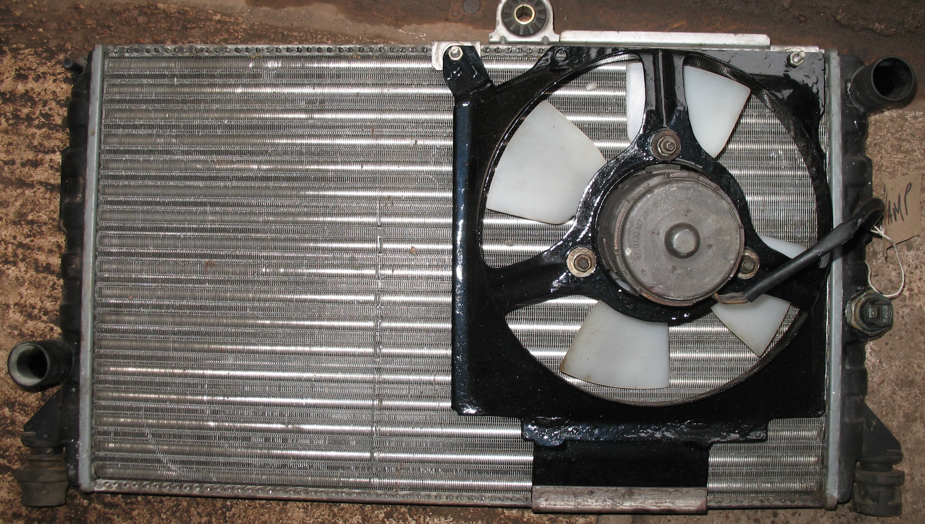

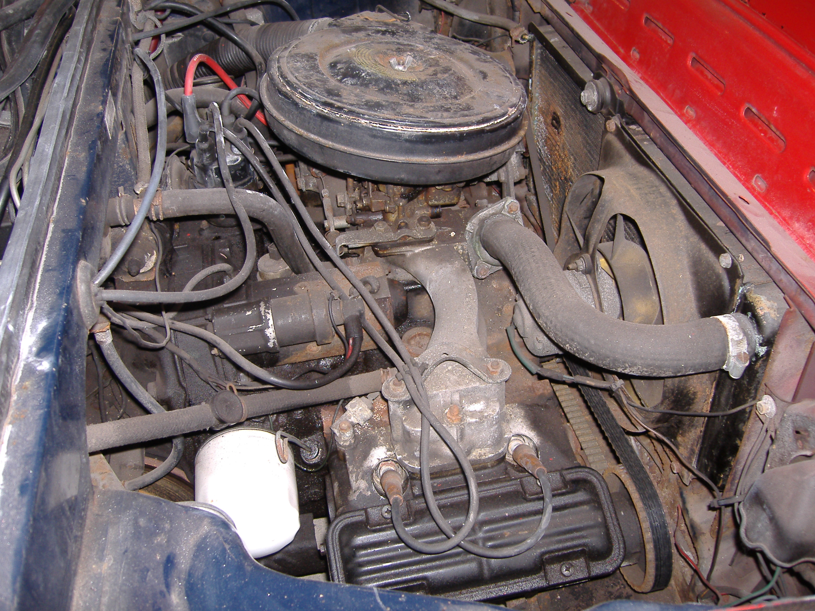

Struggling to get hoses to fit on the radiator as so close to the belts, are they normally this close or is my radiator sitting lower. :?:
Top end to the thermostat is fine. It is a much later rad than is correct for this car.
Got the fan set up well, but then this dictates where the rad is held at the top and so the position of this lower hose.
As you can see its an earlier an on a later radiator. This was changed from the WV one as I think they had used it with out a fan and fitting one to it would have been very awkward.
Also it was a good opportunity to make it more Alfa 8-)

Alfa 33 radiator....sits on two studs underneath
I bought one for my S2 sud, and it fits ok, and the hoses don't foul.

Just been looking back at your thread James, and you have a lot of bodywork chopped out.
As alfadave says, the rad usually sits on two lugs underneath. Yours looks quite different to the one I have. But I do recall that I had to use a spare top hose on the bottom as the hose shaped like a question mark came in at the wrong angle with the new radiator.
Sorry I can not add any more to solving the problem.
Posts: 1520
Could juniors rad be from a late 33?
My sud rad is 250mm high
Looking on ebay the late 33 rad is taller, and has different bottom fixings
