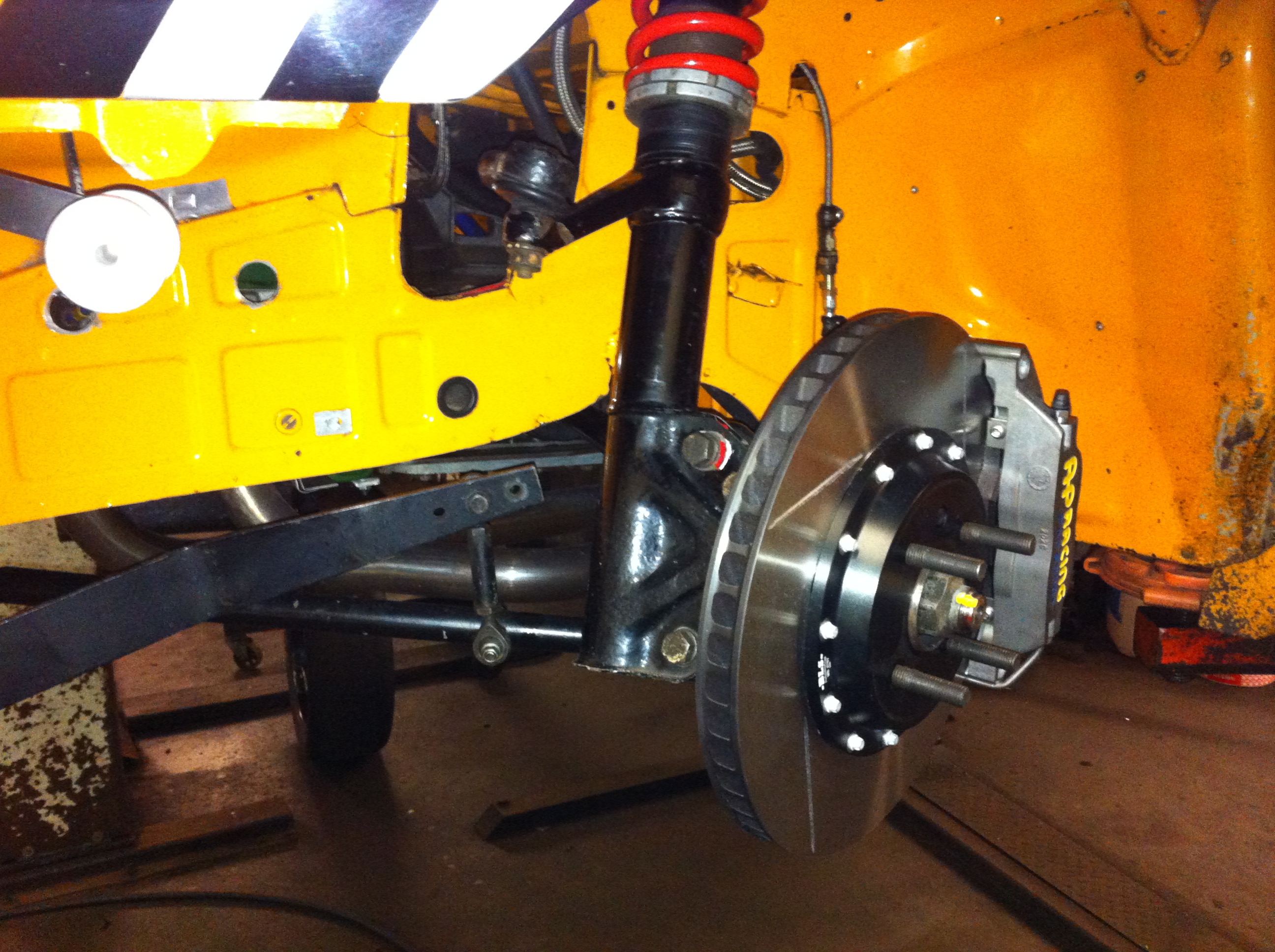

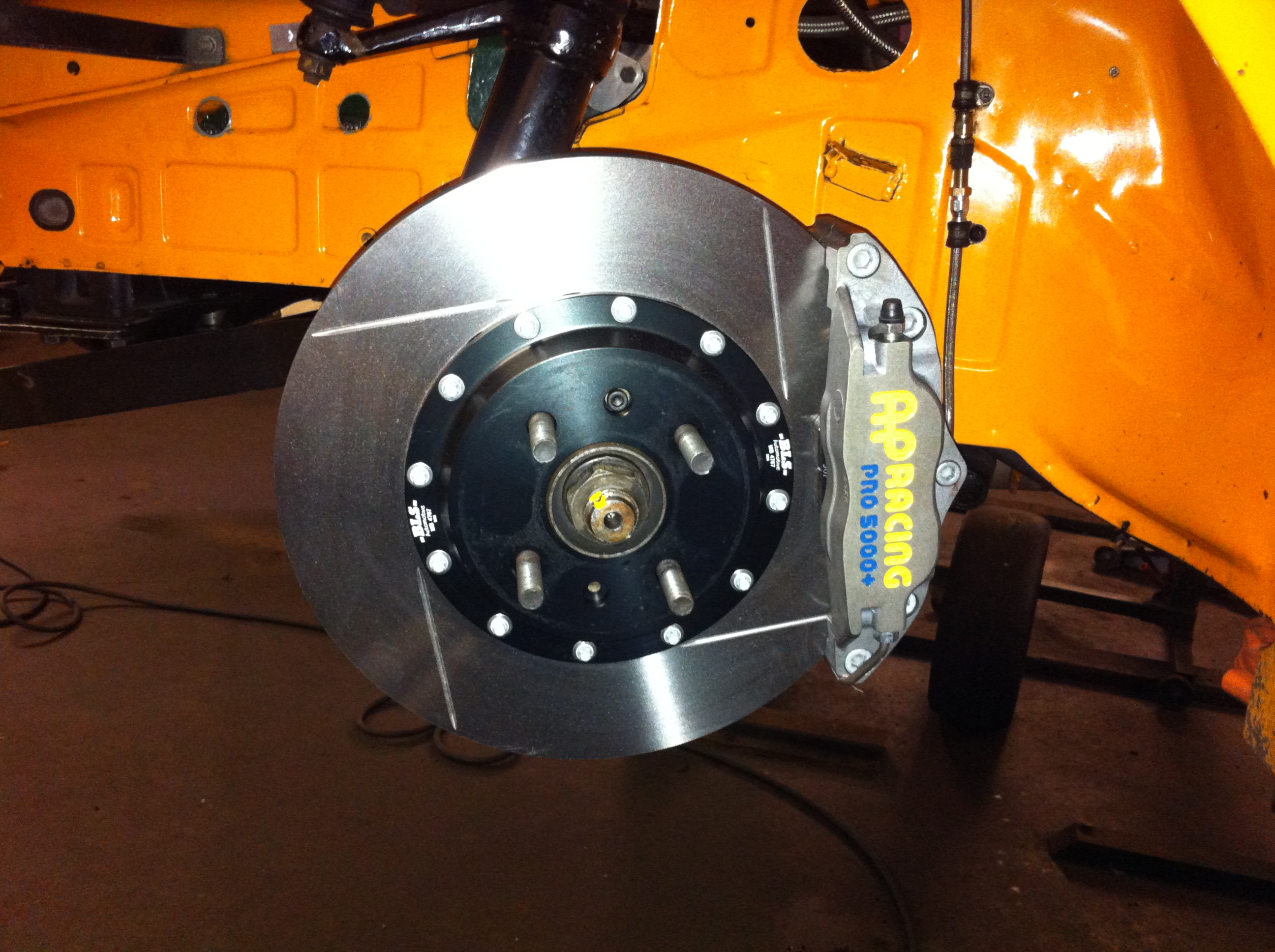

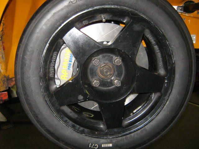

When I did posted the 2014 season summary I mentioned that at some circuits (mainly at the end of some straights!) the front brakes on our 33 were a bit marginal. The previous set up used 164 Twin-Spark discs with Alcon 4-pot racing calipers - this served has served us well but with a lot more power from the 16v engine it was time for an upgrade. We run 15" wheels so the new brakes had to fit within but we have managed to maximize the space available to us!
Our old set up have found their way into good hands so I'm glad that they will continue to see life on an Alfasud! Here's a few photos of the new brakes:-

Thanks for sharing details of your brake setup Bryan.
Would you use any cooling? You may not need it.
We bought some little plastic scoops from minimania that tywrap to the lower wishbone on each side and a short run of orange silicone duct hose. My brother has history of cooking the brakes and he didnt manage to cook these.
We are also impressed with AP Racing R4 brake fluid with a boiling point of 340deg!

As per usual, the photos tell most of the tale, but not all.
Having seen, even examined, the new set up in the flesh, the thing you can't see is Toms usual approach to the project.
Everything is exacting, simplified and straight forward to the best possible degree, and executed beautifully!

Hi Simon,
They probably won't need any specific ducting - there is plenty of airflow and the wheels are open compared to most so they should be okay. If required we can duct from the front bumper, as it's non-standard we have airflow holes each side that we can duct from.
We've used AP Racing fluid for a long time but have switched our allegiance to another of the Joe Gibbs products.
Shrew - they will be excellent on your Sud - more than plenty!
