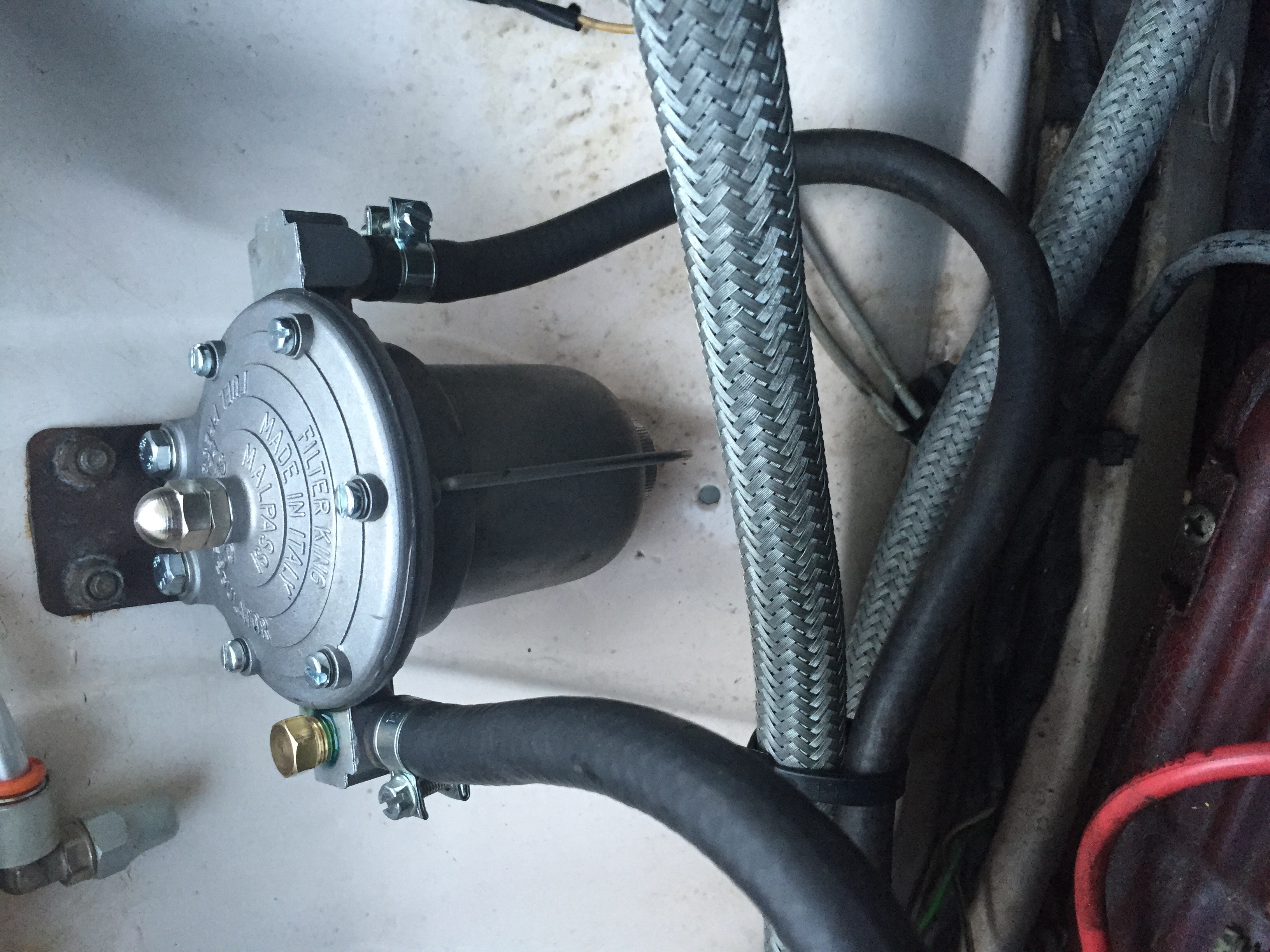

- Posts: 976

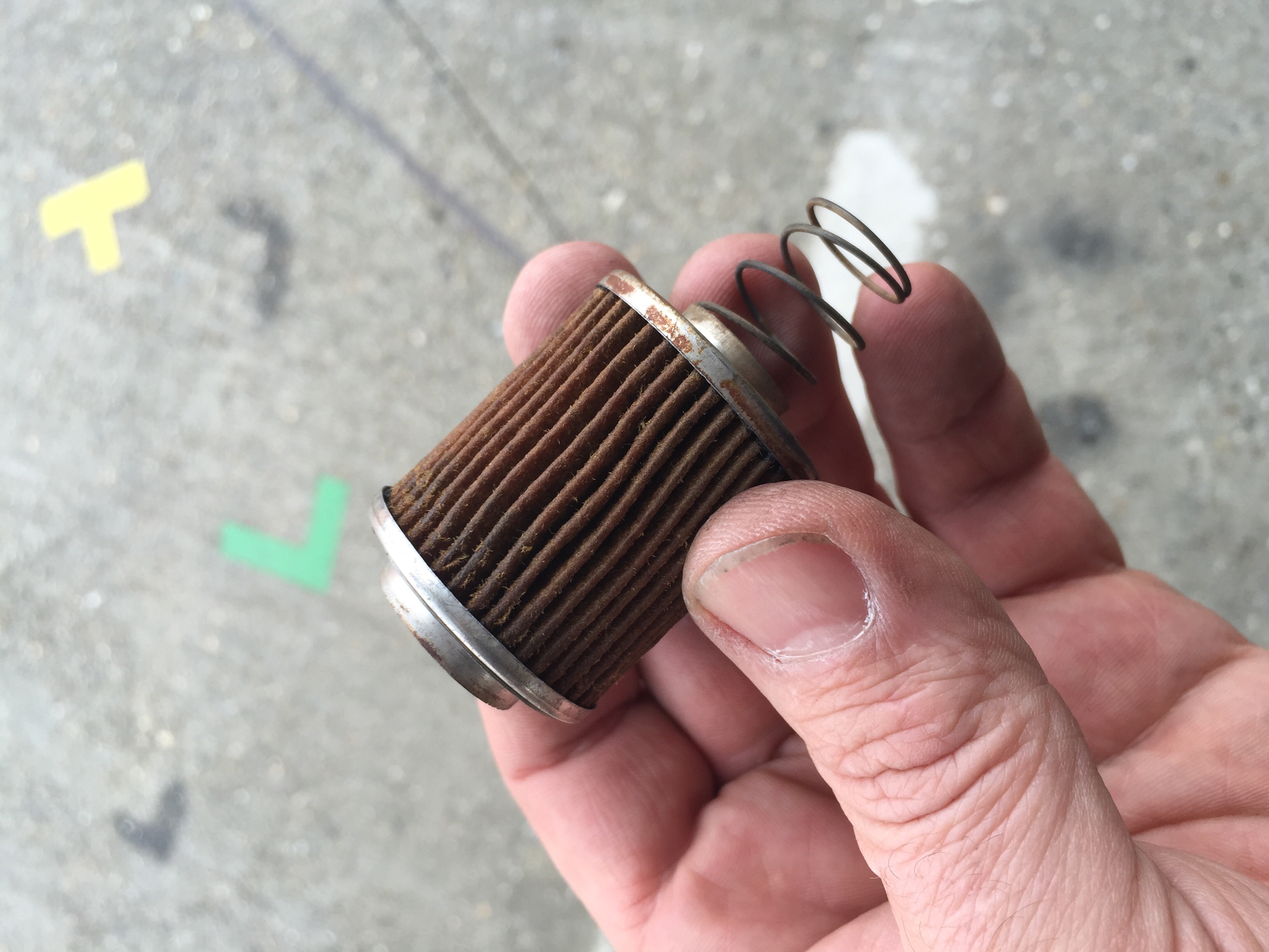

Re: 1974 Alfasud Trofeo
Hi Guys,
It was all a bit one step forward, two steps back today. The good news is the shakedown today means I will be ready for Saturday.
The car was popping and banging as I approached 6000rpm. Typical. I put in a foam filled tank and it makes things worse. I called Tom and got some great advice.
I checked the in-line filter which is a filter king pressure regulator. The filter looked a little grey so I removed it and the car ran much better but was not cured. On that run I got black flagged for noise. I was 2db over the 92db drive by limit. The on-site shop had four different sizes of decibel devil but not the 2in one I needed. I spoke to the noise tester and as long as I set the rev limiter to a lower figure they would let me out again but another black flag and my day would be over.
I went out again and got black flagged after four laps.
I have ordered a 2in decibel devil to pick up on Saturday for track days. I won't need it for racing as the limit at Brands on a race day is 102db.
Should receive my new Filter King with new filter and pressure gauge on Thursday. Its a 5 min job to fit it and Tom has given me the correct pressure setting to use. I have looked up Filter King information online. They specifically mention fuel starvation problems at full throttle settings if the pressure is too low. Pretty sure the starvation problems will be cured with the new correctly set Filter King.
- Posts: 976
Pics:
Filter King Internal Filter Carbs and Carb jets got a jolly good clean Posing in a charity scarf. It's for a very good cause.

- Posts: 976
Good advice thanks RSFruitbat.
I checked the carb fine mesh filters and they were completely clean.
New in-line filter / pressure regulator fitted. It is high flow so the paper filter is twice the size of the previous one. Set the pressure to 3.5psi and then blanked off the tapping. The car idling is noticeably better. Brgds

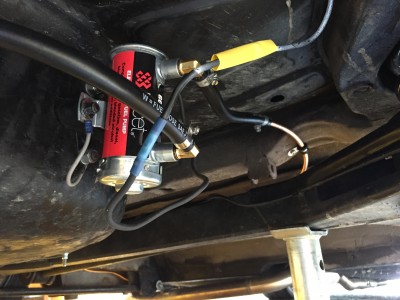

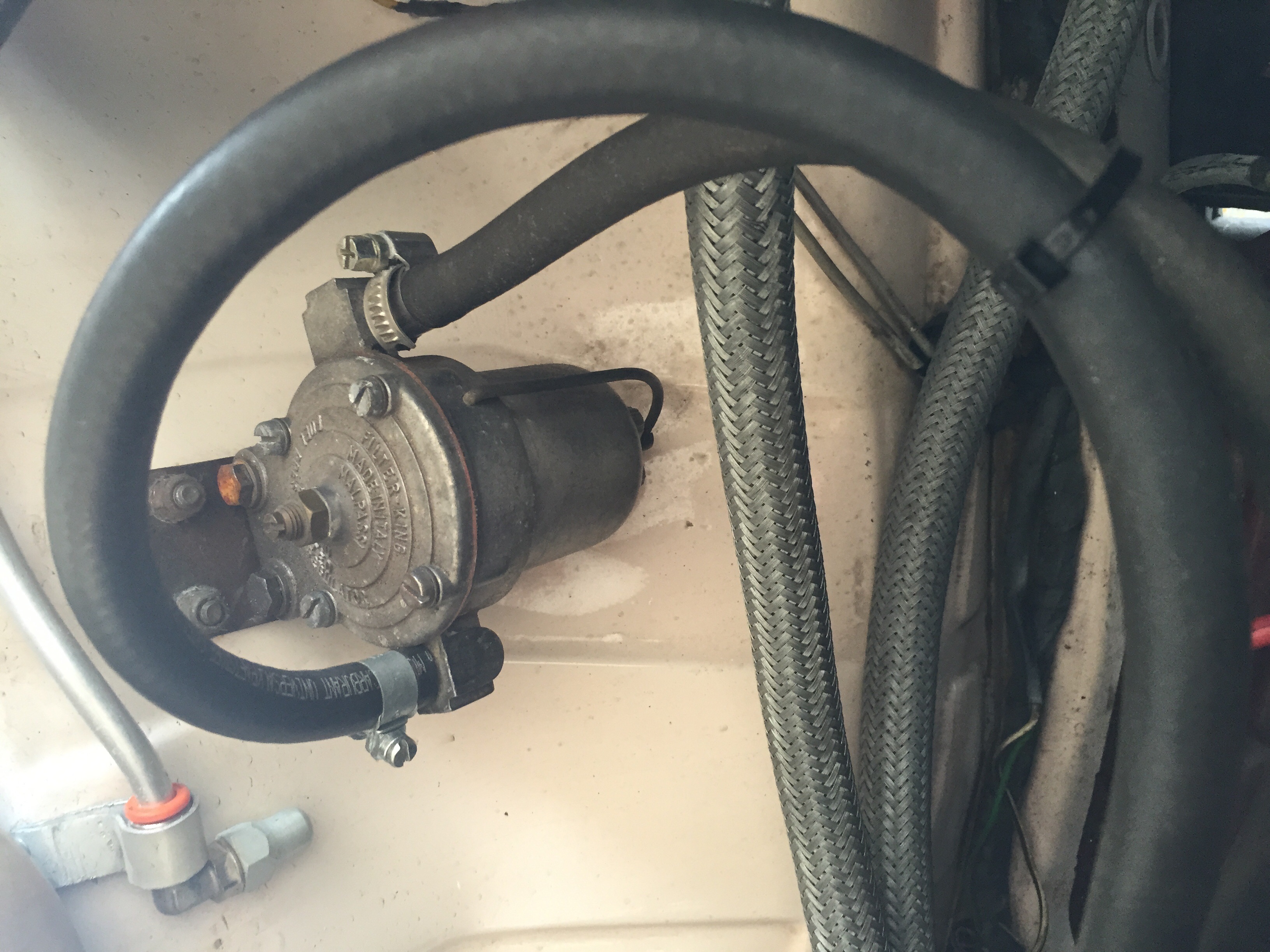

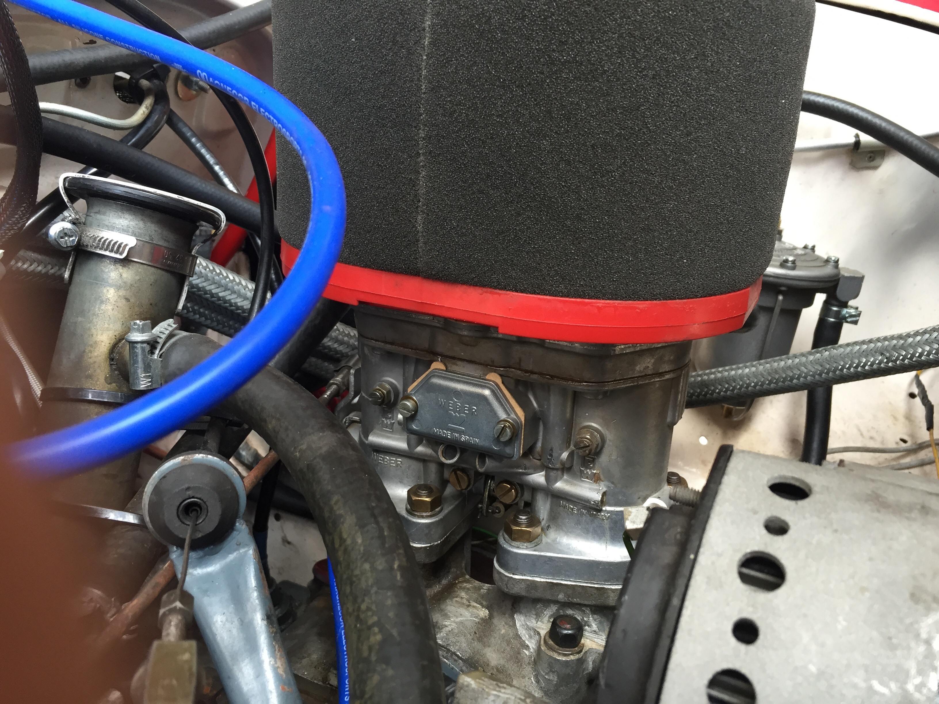

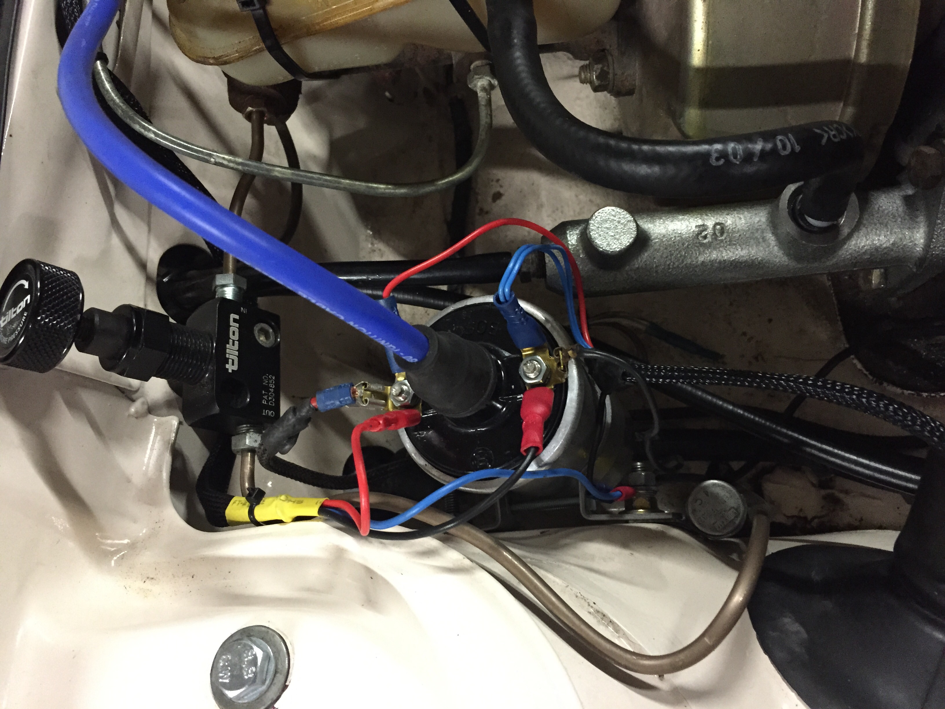

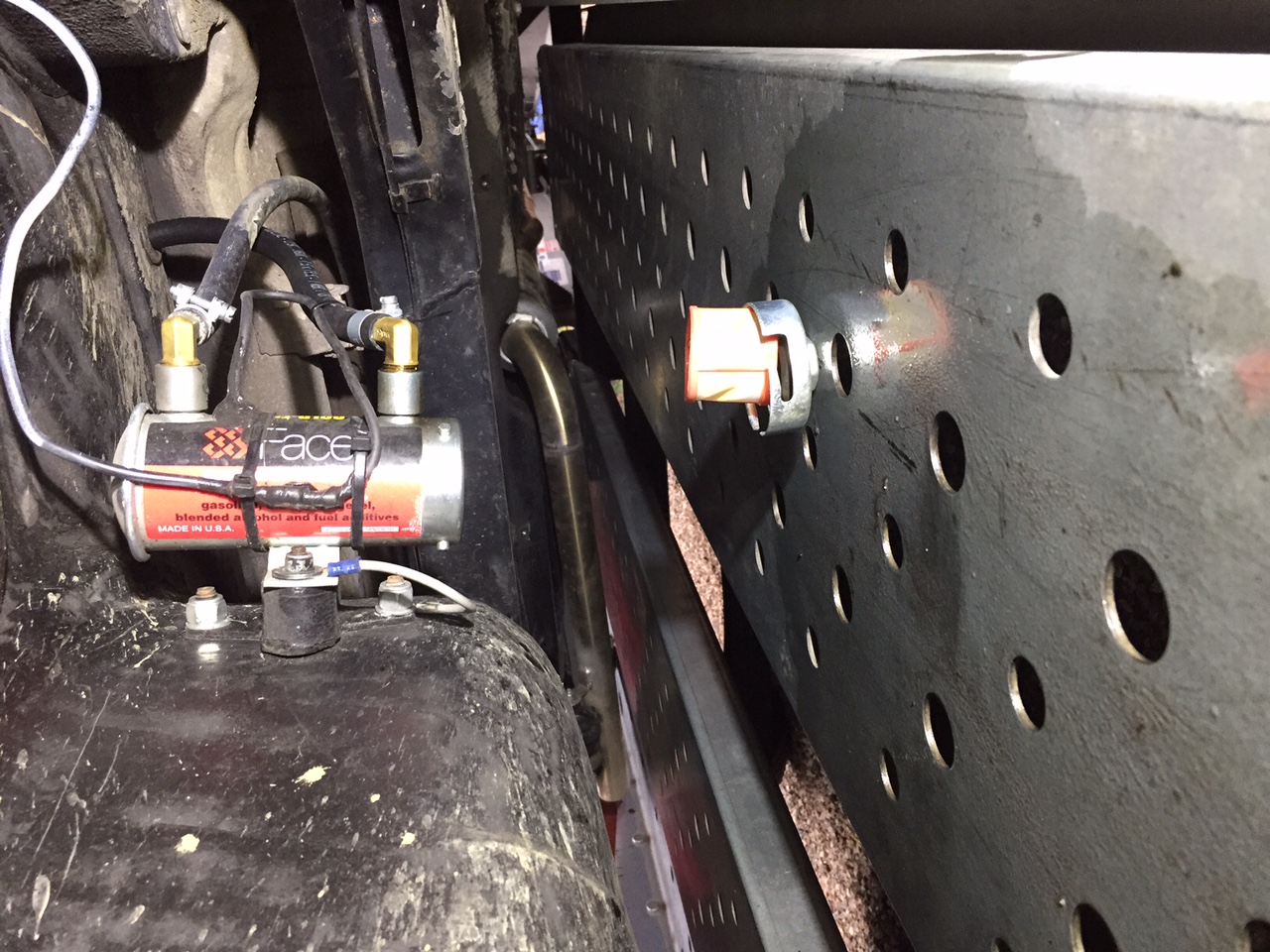

- Posts: 976
Hi Guys,
The fuel system was done last week:
The fuel tank feed pipe in the boot is now routed through the lower side of the wheel well right next to the pump.
New Facet fuel pump.
Fuel pump switch and power supply checked.
New 8mm copper pipe from the pump to the engine bay.
New fuel hose throughout.
Carbs stripped and cleaned and all jets blown through with an airline.
Float levels sets up accurately.
Overhaul kit fitted to each carb. New filter, gaskets, accelerator pump diaphragm and needle valve.
Carb cold start mechanisms removed and gasket and blanking plate fitted.
Tank emptied.
Flow rate at the farthest point is now 1 litre in 28 secs down from 35 secs before.
The car ran smoothly but completely cut out and stopped if rpm decayed to 1000 rpm.
Tank emptied.

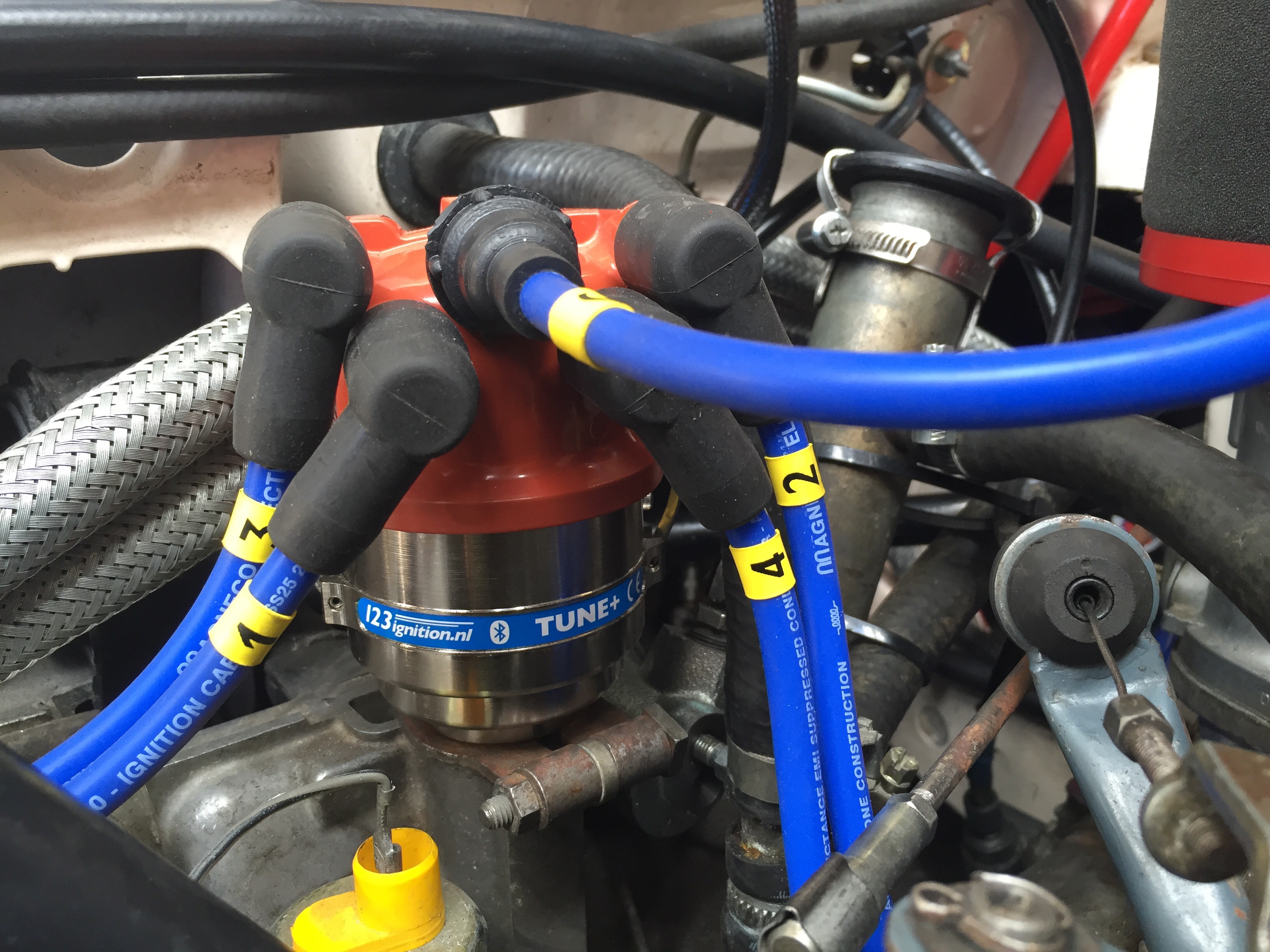

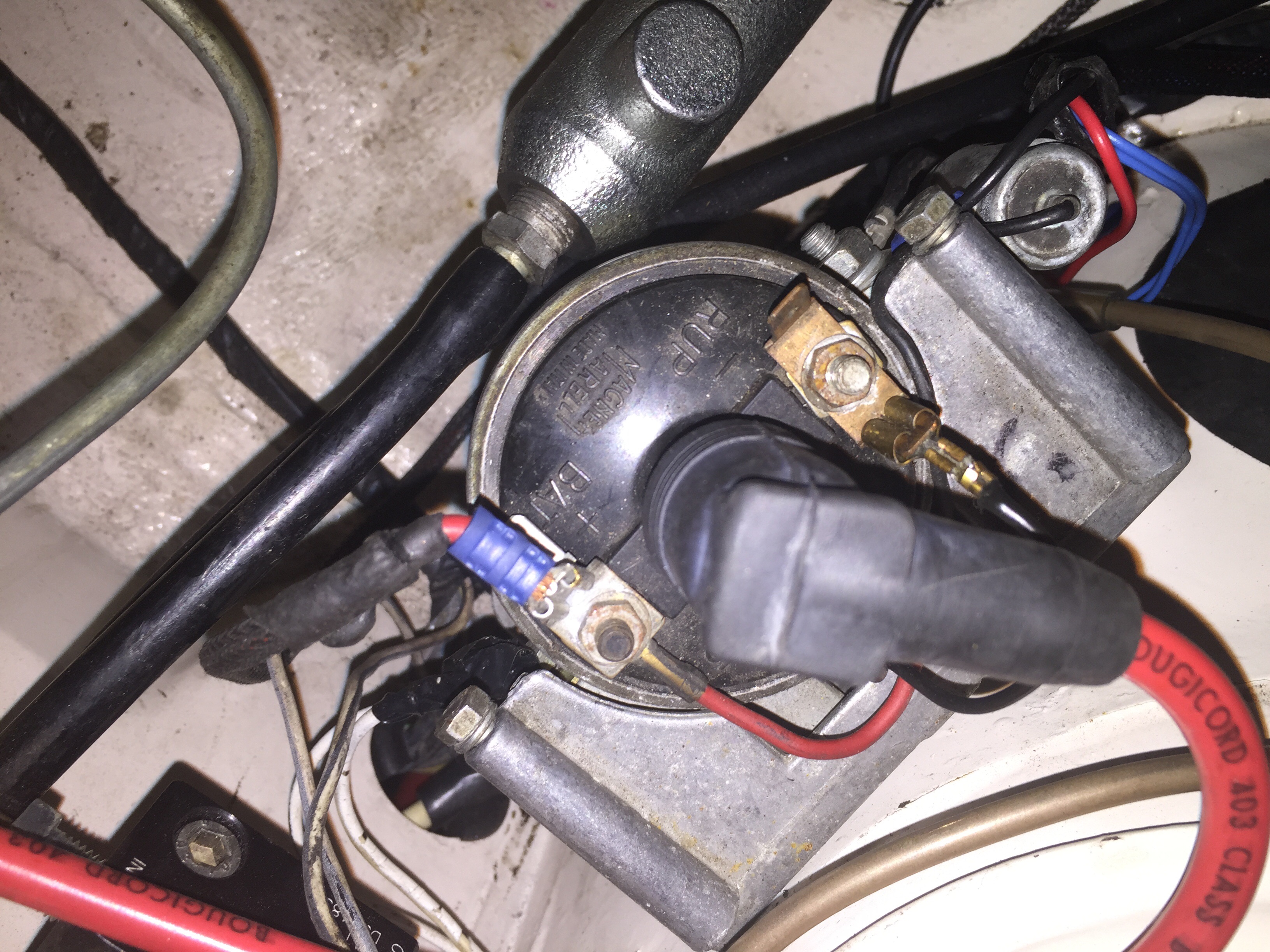

- Posts: 976
Hi Guys,
Phase 2 today - Ignition.
New spark plugs.
New Magnecor HT Leads.
This is the good bit - New 123Tune distributor that can be programmed from your iPhone. The one you need for your Alfasud is the 123/TUNE+ 4-A-V-V (bluetooth). It says this model replaces Bosch Distributors for VW & Volvo but I measured all the key dimensions of my the distributor drive and its the same.
Very easy to setup and ready for the rolling road guys to properly map.
New Bosch un-ballasted coil.
The existing Marelli distributor, coil and ignition system were all removed. Replacement coil The car started immediately. It sounds very different. Picks up nicely and will run happily at 1000rpm!
Rolling road tune-up next.
New spark plugs.

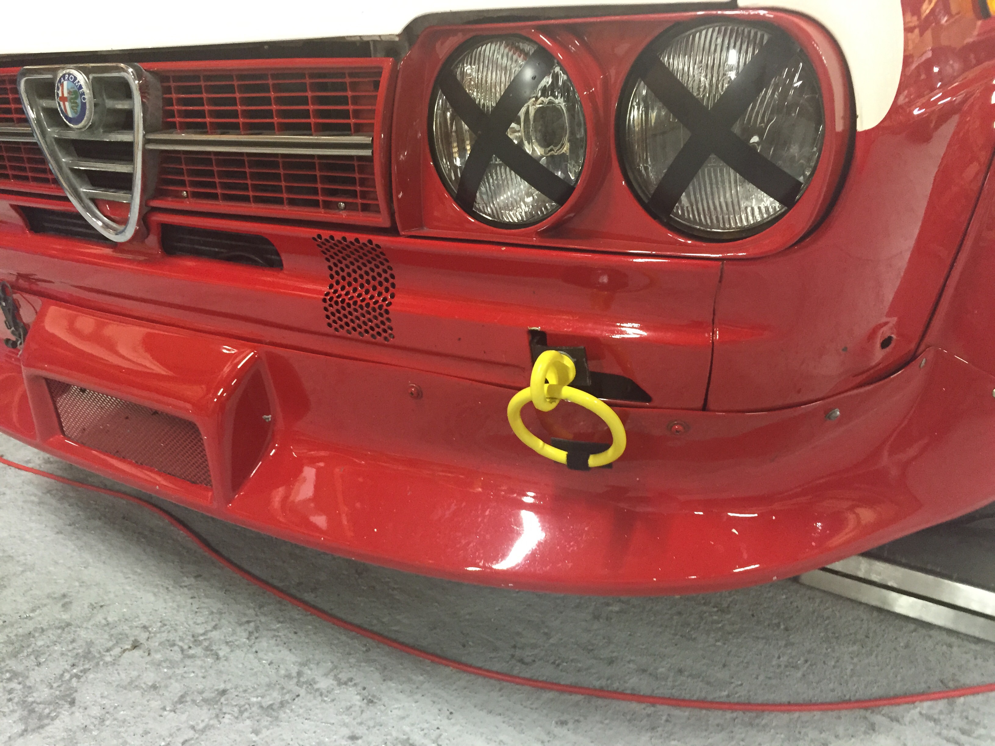

- Posts: 976
Hi guys,
Some pics for you: It's the new configuration for fuel delivery but I wanted to show the crimp. I saw them In marine use. When you heat it with a hot air gun it glues itself to the wires either end sealing the joint. My carbs are Italian and the cold start blanking plates are Spanish! Shrew won't like that. 123 ignition in place. New fan. Only 0.5kg lighter but much more efficient.
New High torque starter. Again only 0.5kg lighter than the original.
I am quite attached to my towing rings so they got a refurb.
Overall, the car has lost another 9kg.
