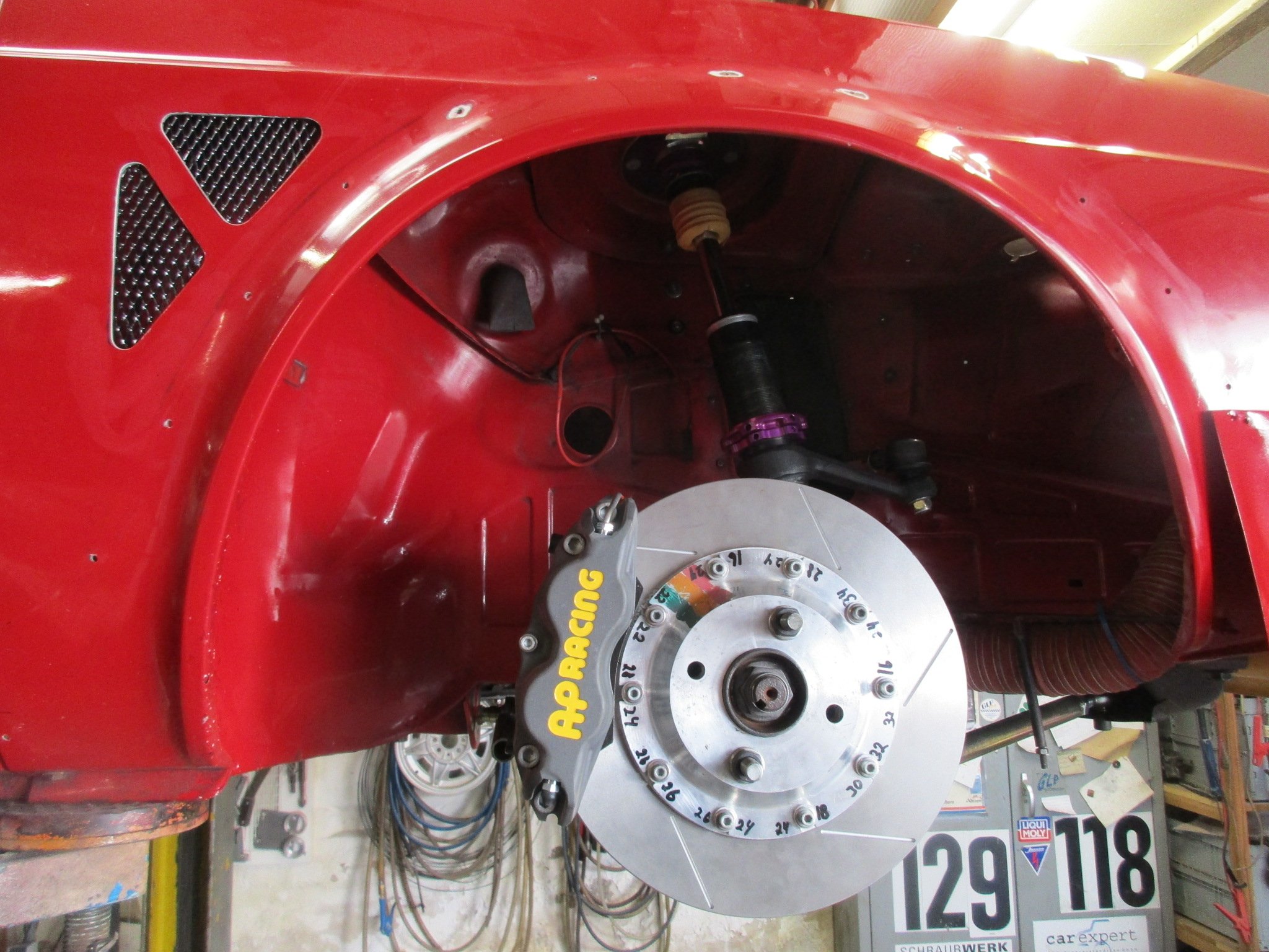

Re: Alfa 33 1400 16V Rallycar
Post by 902a »
I went with inboard brakes so many years to keep the unsprung weight as low as possible.
But as the engine was getting stronger, the car faster and the brakinge distances longer, I decided for the conversion to outboard brakes on my sprint as well..
I hope, i can test it this year someday, somewhere..
Ali

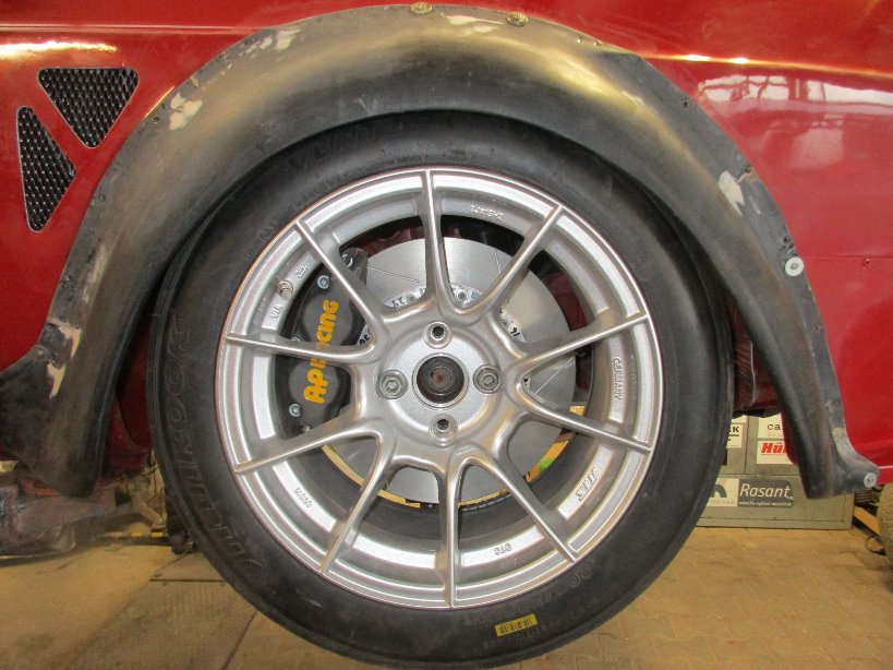

Posts: 1705
What size are the wheels on your sprint, 14inch ?

That looks like a nice conversion. What size discs did you go for?
902a
Posts: 85
Joined: Wed Feb 05, 2014 12:35 pm
Location: Germany
Post by 902a »
Disc size is 304 x 25,4 mm. Rim size ist 8x15. Choice of good race tyres and traction is much better with 15"

rsfruitbat wrote:
Tue May 19, 2020 8:51 pm
Did you go with 16v hubs or the earlier type?
What are all the numbers on the disc bell?
Hubs and drive shafts are from Alfa 33 S1 (905).
Numbers on the bells are measurements for the floating mount of rotor and bell with special bobbins

No particular reason. There were several drive shafts and hubs in my shelf. It was no prpblem to get new wheel bearings.
What do you mean with how much lower?
Torque of the brakes? Depends on disc size and brake pads you use. I went for Tarox rotors, as they never disappointed me before. And the AP Racing calipers should do the job as well. Not cheap, but good value
