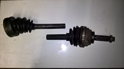

yesterday we had a drivesft snap under breaking and i'm gonna start a seperate thread for this topic

had it been rubbing on the chassis rail mate?

Yes, just where it's broken it looks to have a chamfered edge where it's been rubbing on something....

unfortunately no it wasnt rubbing on the chassis rail. any chamfering is down to the flailing when it let go at about 50mph.
Good point though i will check the other shaft just in case.
Re: Alfa 33 1400 16V Rallycar
Whoa! There must have been some torque going through there. Makes you wonder if you can get carbon fibre driveshafts (or maybe tubular shafts of larger diameter) for the 'Sud. The standard shafts weigh quite a bit!
Having the braking disc at the end of a long shaft connected to the wheel is always a worry, I suppose it is the one area where outboard brakes have an advantage...
yes, the shaft is very much the weak link on inboard brakes. Far more torque force through braking than ever in acceleration. especially with improved brakes and sticky tyres

thats when this shaft snapped, under braking.
Ill take some pictures of the broken ends but it looks just like when a bolt shears off. Theres that twisting effect.
I was wondering whetehr it was worth getting the shafts crack tested?
I was wondering about that as well. It might show up some latent defect. There again, just about any nick or scratch can act as a stress raiser.
I assume these parts are forgings of some sort?

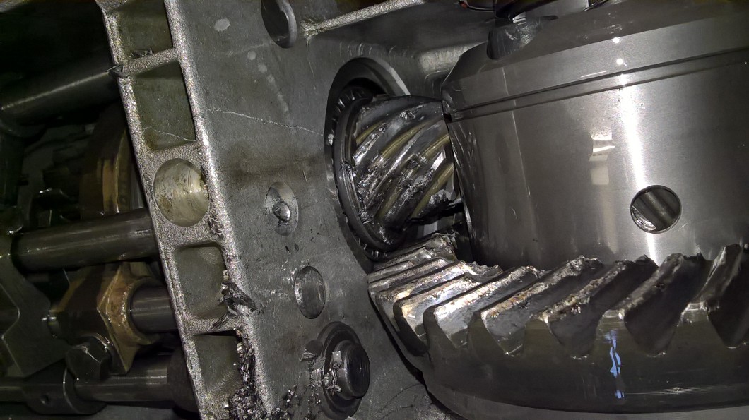

Bad weekend i,m afraid. Managed just a mile of the first stage before we had to pull up with gearbox problems.
Came home today and dropped the engine and gearbox out.
Looks like a tooth has come off either the crown wheel of pinion. It's gone round and got caught up in other teeth. This has pushed the n\s output shaft out of the box by 6mms breaking all its mountings. Diff has then wandered round in the box finishing off the crown wheel and pinion. It's also cracked the casing above where the pinion gear comes through.

Thanks Kev. i'll bare that in mind. Diff is going off to Quaiffe today to see if its ok. If it aint it'll be a call to AHM and gripper to see what they can do.

Just for everyones info AHM have sold out of Quaife diffs and wont be getting another batch made in the near future.
My diff is at Quaife so just waiting for the phone call.
Gripper diff in a box to go off for adjustment / rebuild which is about half the price of a new one!

Just phoned quaife and they are missing the end plate so they would have to be made in batches of 10.

Good news is when they get to look at my diff (end of next week ) they have all the parts to rebuild if needed apart from the end plate.

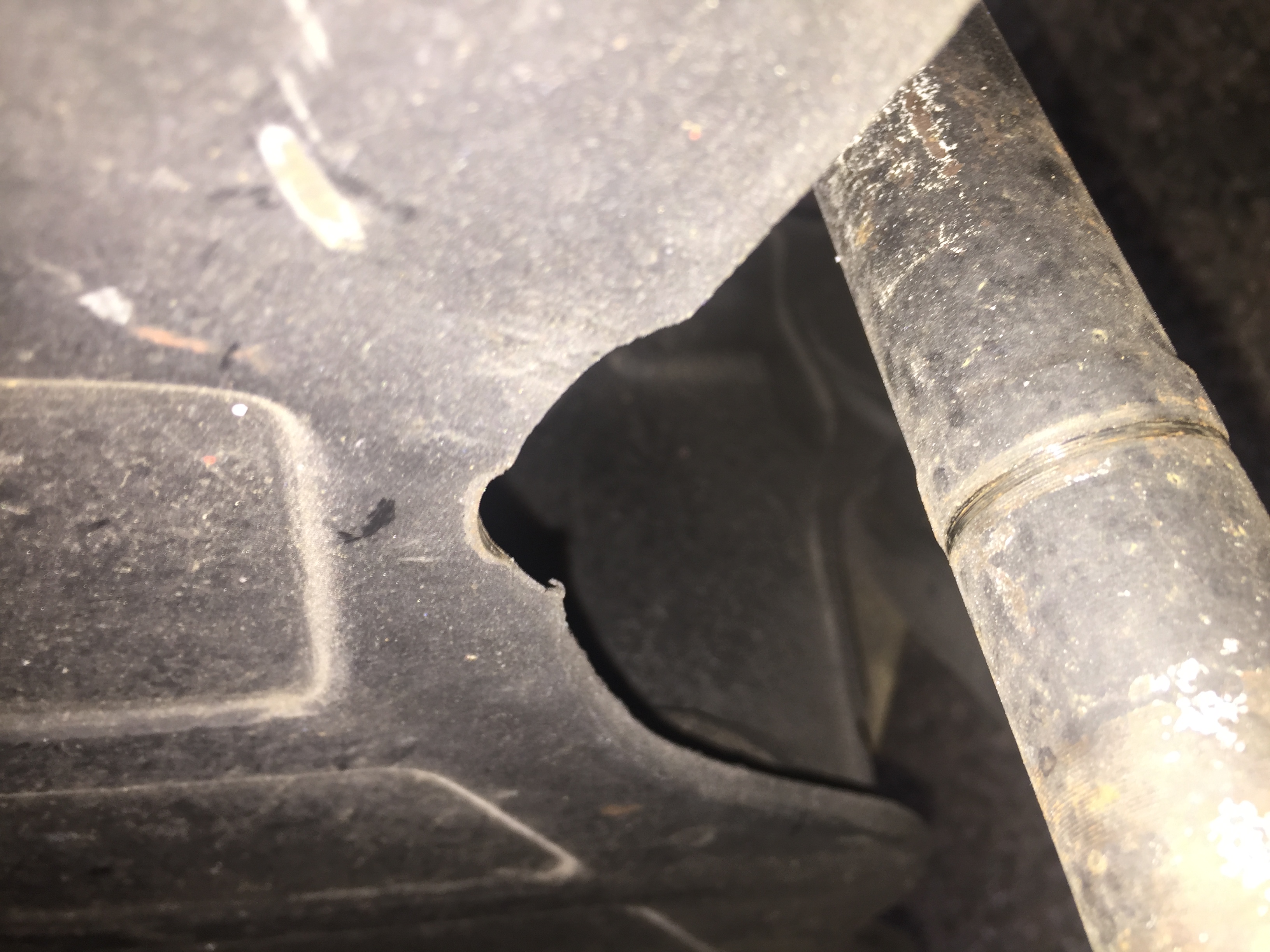

Sorry for the delay fella's, but Ade asked me to add this to the thread for him
Ouch !!

Quaife has said they can rebuild my diff so thats the good news. Not going to be that cheap though but better than loosing it all together.
Had my Gripper diff rebuilt as well and found their service much better, sent it, rebuilt and sent back, all in less than a week.
Hopefullly get the Quaife back Monday so just need to do some begging with my local gearbox man to fit and set it up.
With a following wind get the box back for the weekend, fit and test it ready for Rallyday the following Saturday???
