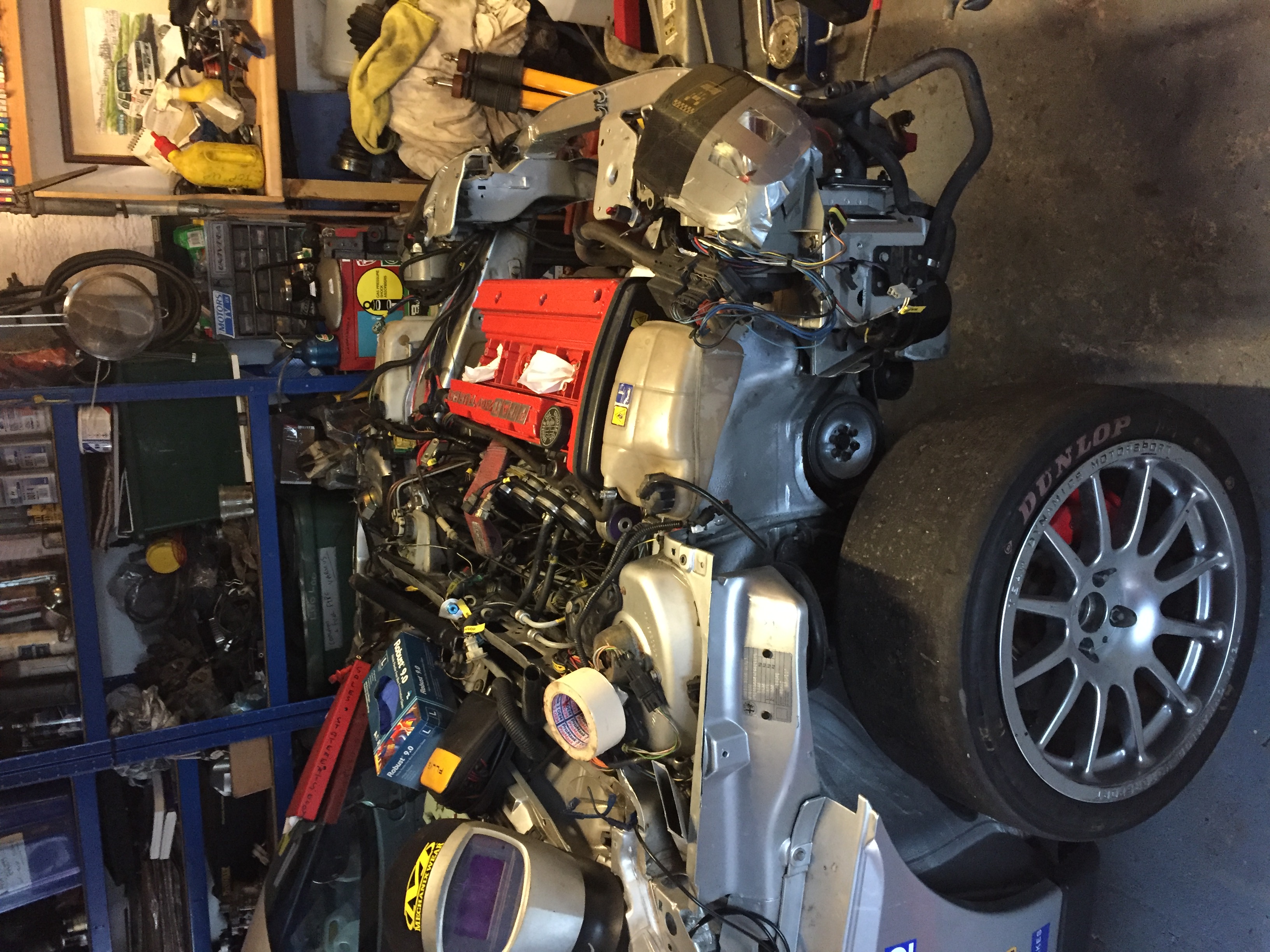

Almost finished stripping the coupe. I’m hoping to have a mega sesh over Christmas. To get all the major suspension components swapped over
I’m going to strip the engine aswell as I’ll be giving a it full rebuild.
Posts: 1756
Re: Race Spider getting new heart
Got the engine out of the Fiat on Christmas eve and removed the head . It’s lost a big end on #3 I’ll know how serious it is when I get the sump off later. it’ll probably need a grind and worst case a rod aswell . Depending how abused it was after it started to sound “bottom endy”
Apart from a. Dodgy looking exh cam Head all looks good with no bent valves or other issues so that’ll get fully stripped, cleaned and decoked then rebuilt with all new lifters and springs .
I have to say The guys on the Fiat coupe forum have been super helpful
And I’m giving them a chance to come and take any parts I don’t need off the car FOC.
Hoping to be shut of the shell in the next fortnight .
Posts: 1756
Looks like this things been run low on oil. Crank need a grind on both mains and big ends. #3 was the rattley one. thankfully I think it’s std. so a 1st undersize should be fine. Even for racing. I’ll be getting the crank nitrided after its been ground.
And we’ll be fitting ARP big end bolts aswell
Clutch Is toast so I’ll replace with Helix paddle clutch (6 pad)
The exh cam is also knackered
So far it’s been a good Christmas got lots done.

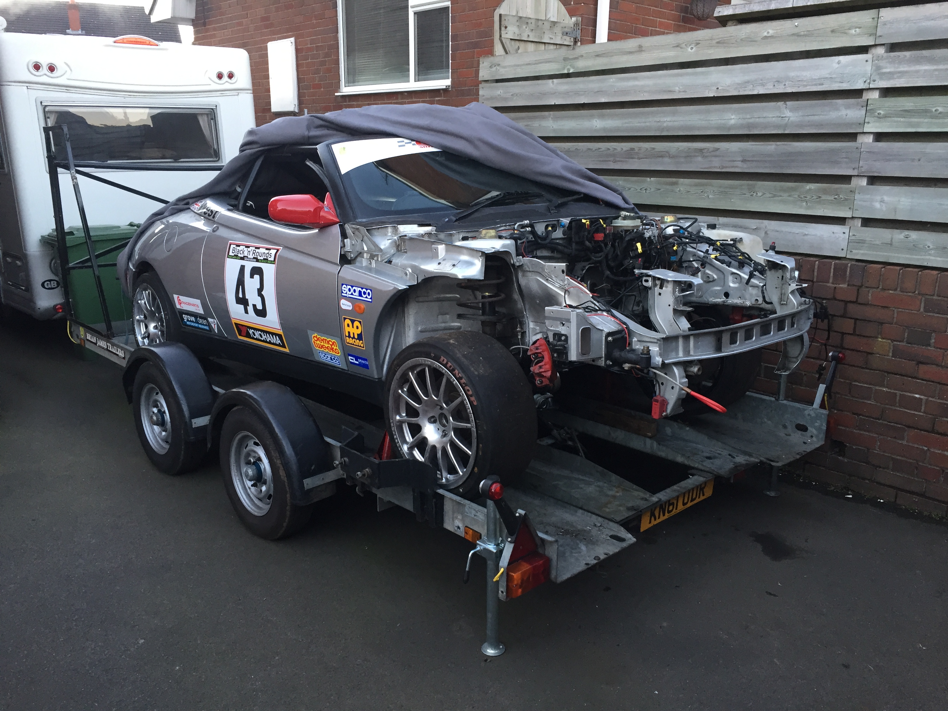

Posts: 1756
Re: Race Spider project.
Big push on the Coupider today . All the front suspension swapped over. Using the std Fiat struts at the moment as my Konis won’t fit the Fiat uprights . Next big job is to remove the entire spider engine Wiring loom. And then fit the Coupe loom. (I’m not scared... Honest)

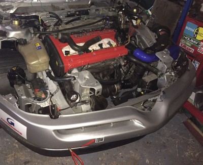

Had a Goid push on the spider today and made huge progress . Engine and Box now in after a lot of Eff**n and Je**in . It does fit but by god it’s a snug fit . Still got a lot to do including a bucket load of wiring and electrics to work out. hoping to have it running in the 4-5 weeks .
It is a tight fit Lou isn't it! 145 has the added advantage of the inner wing more pronounced too! That was fun too :D
Looks like it was always meant to be there though 8-)

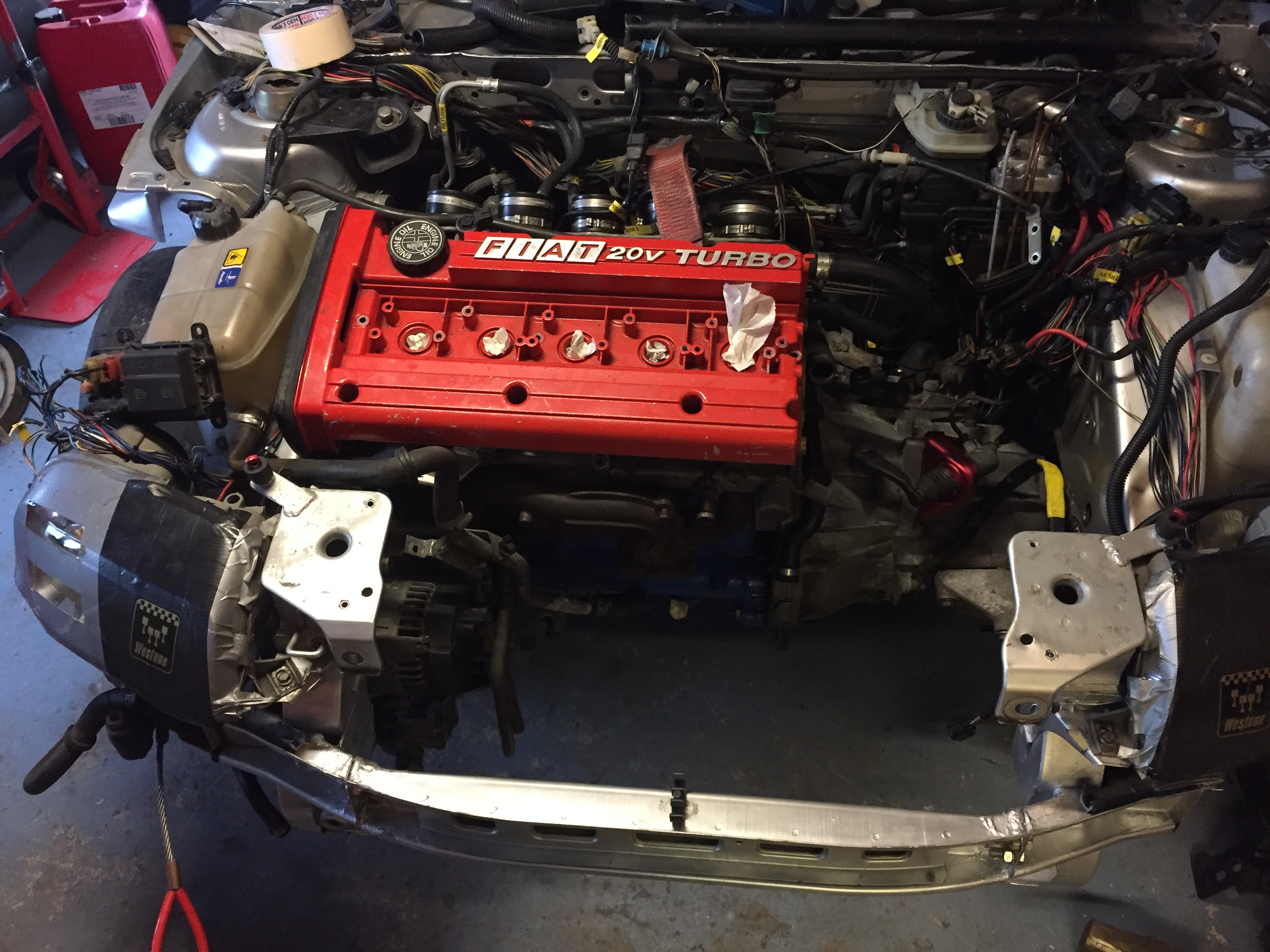

Posts: 1756

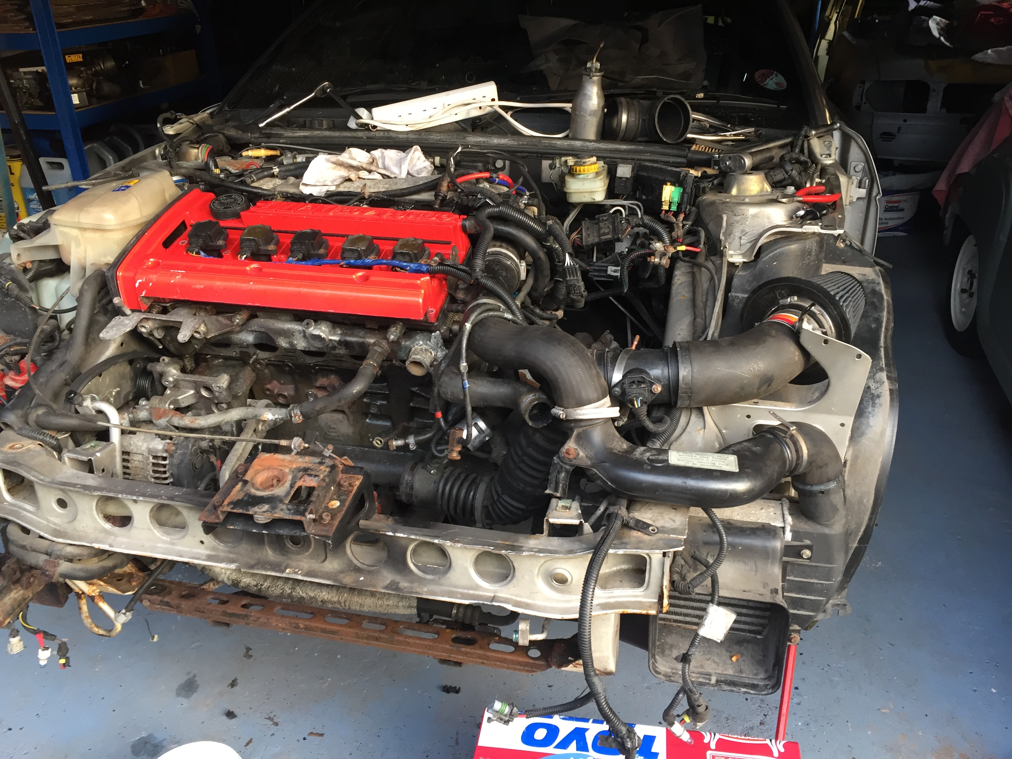

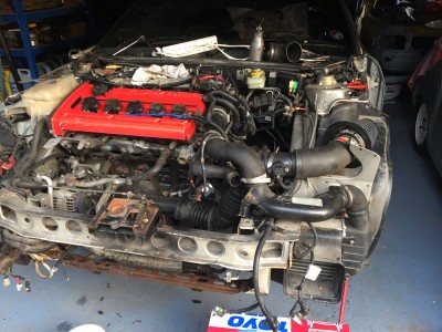

Lots of progress on the Coupider recently. Front Konis and race springs fitted (I’ve fitted inserts on this occasion as I got them cheap and they’re Brand new) intercooler mounted and most of the plumbing is now complete on both the Cooling system and induction system. we’ve got clutch and brake system bled but best of all we’ve got it turning over and we’ve built up oil pressure. Next move is to deal with the wiring . This is a bit more involved than we’d originally thought but we’ll get it sorted . All being well were aiming to have it running over the weekend .
Getting it cranking and good oil pressure is a great hurdle reached Lou, hope the wiring isn't too taxing 8-)
