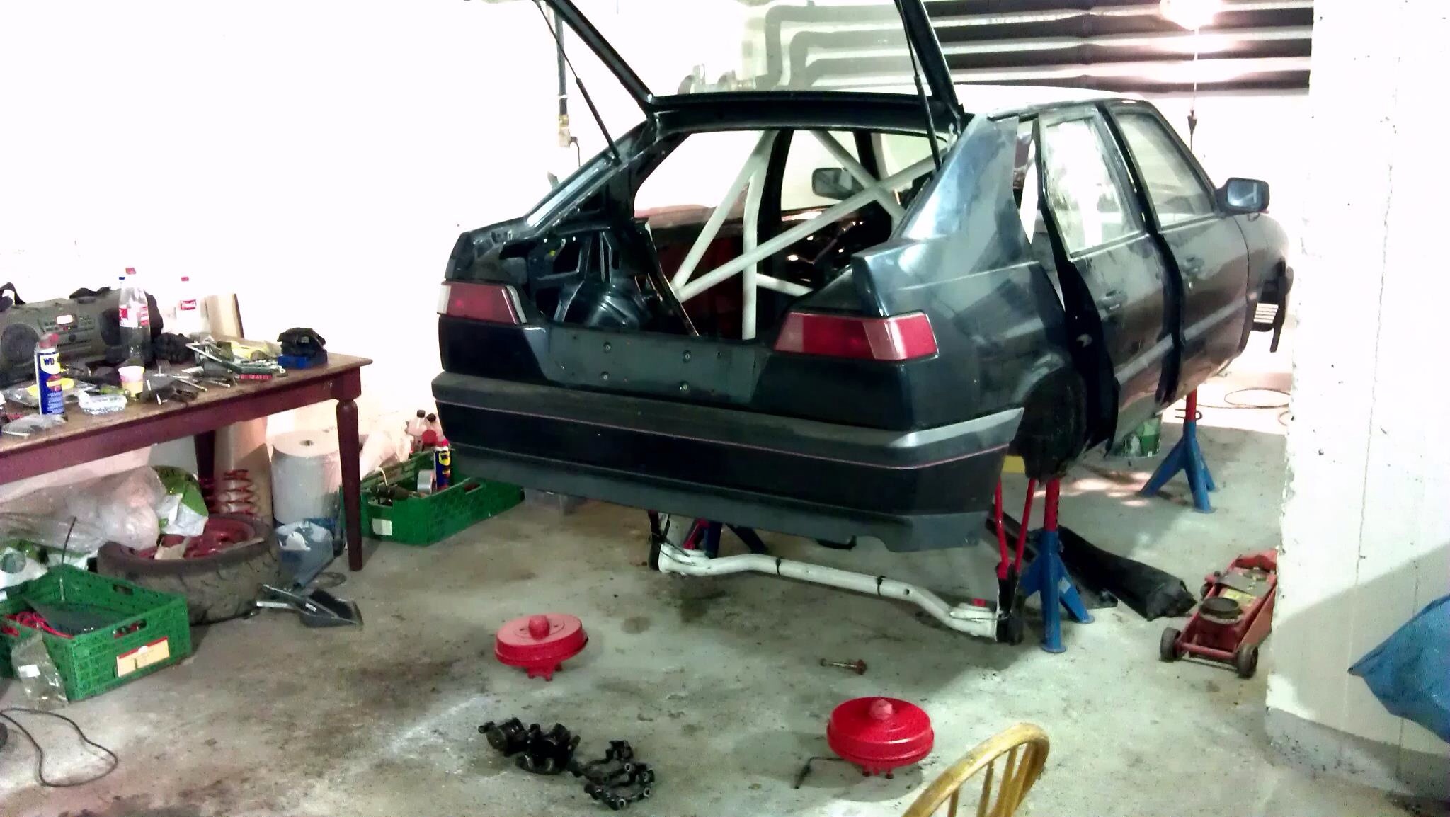

As you know, I have Intrax suspention with 40 clicks adjustment on damping from Full Open to Block. In front I differ due to the conditions on raceday (20 clicks on a normal day, 25-30 clicks on warm/sticky day), but in rear i use 39 clicks. I can change to stiffer springs, but what else can I do (except front anti roll bar)?
With the cage inside stiffening in the rear, is there an idea to weld a bar crossover on the damper tower? This is not needed in front I would guess, due to the construction of the enginge bay? Or....??
Pål

Have not found a 3-bolt front strut brace anywhere, only 4-bolt, so might have to make one...
After the flip last year smashing the right side, and the crash on the left this year, I think an 4 wheel allignment is in order also.
Anyone have any ideas on neg camber in the rear? I have fixed axel and drum breaks back there...

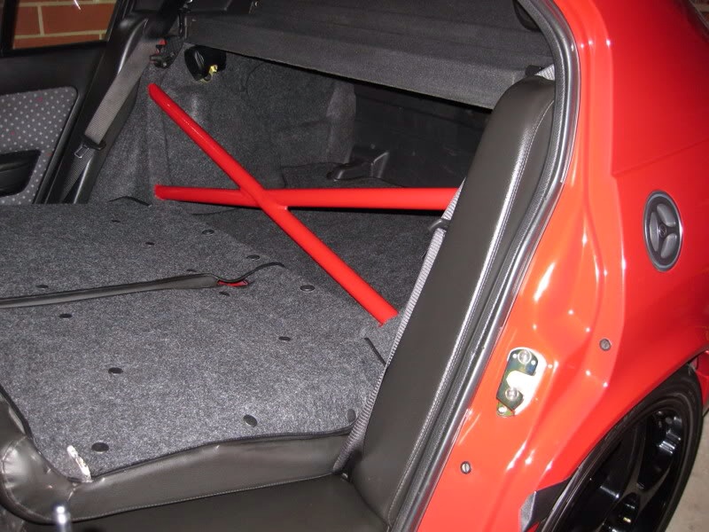

Here one way you can brace the rear

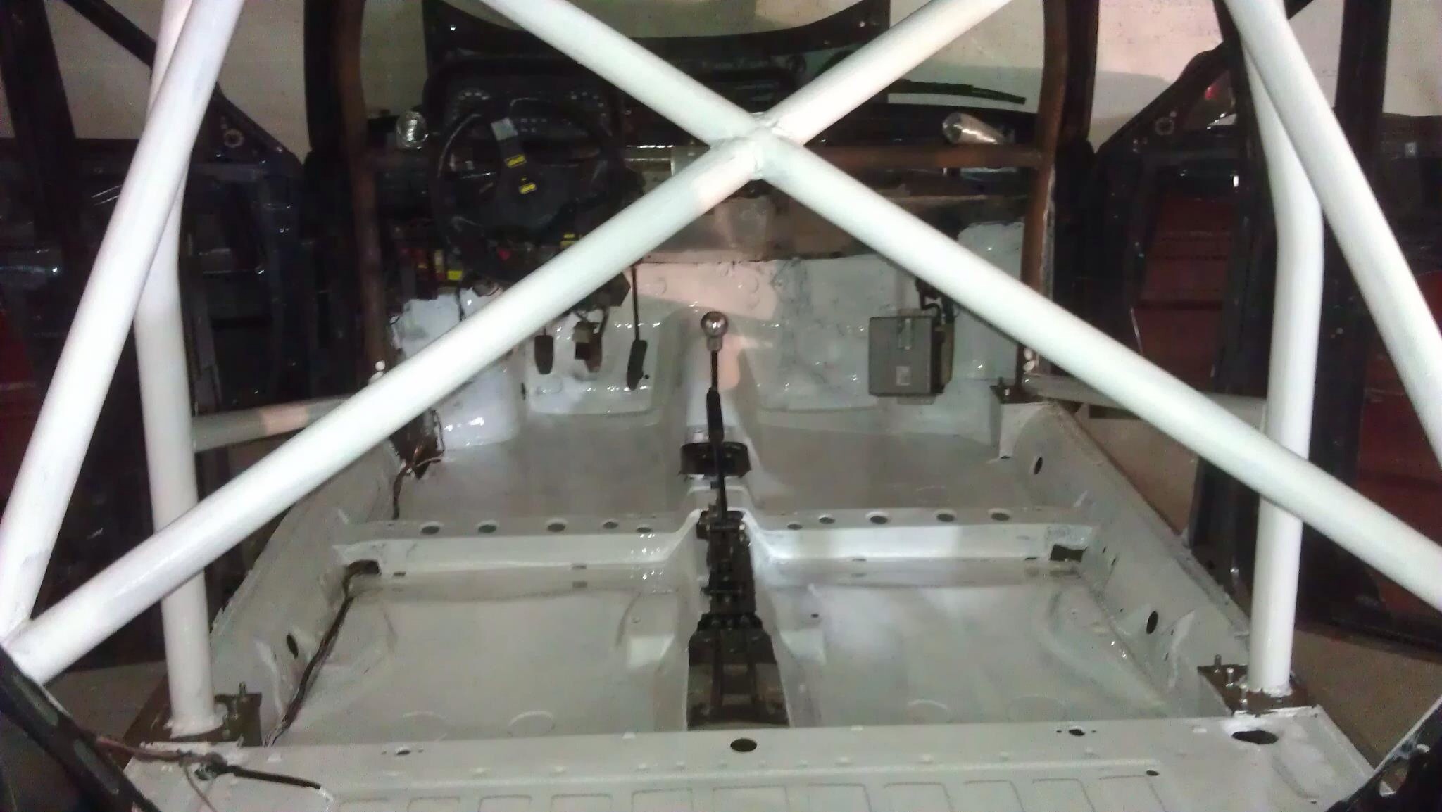

Remember I have a full cage, so not sure if I need more support in the back? Here is some old pics showing the cage
