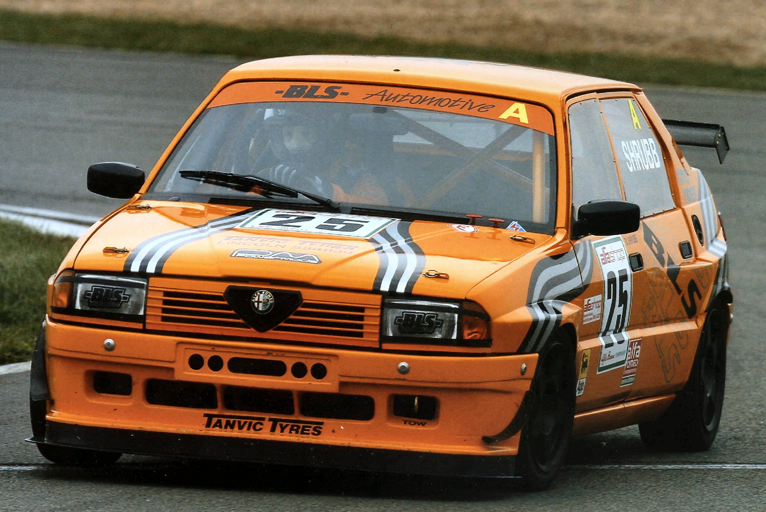

Hi All,
I'm really glad to see this forum prospering (well done to Kev and Shrew!) so thought I'd add a little contribution to it with some words and pictures of my 33 race car. I've got loads of photos - most of the action are purchased from the race day snappers so are 10" x 8" but as the car was originally built before the digital camera age I'll have to get busy with the scanner for some of the early build shots! So, build photos to follow at some stage!
My father (Tom at BLS) and I built the car in the winter of 1997 to replace our successful Sud Ti that we ran in Class C of what was then the Alfa Romeo Owners Club Championship. We were able to transfer pretty much all of the running gear at the time - especially as we were already running a 33 rear beam on our Sud (converted to run 2 1/4" coil overs and lightweight discs). The main challenge therefore was the body - getting as much weight out as was allowed and sensible, packaging the main components with weight distribution in mind, accommodating a wider front and rear track (wider arches required). The donor car was a Mk3 car of 1990 vintage - its main fall from grace was to have turned from Alfa red to Salmon Pink in colour. This essentially rendered it a £400 bargain at 7 years old bought from Cubleys of Ainsdale (a previous well established Alfa dealer)!
I'll post up a few pics of the car as it has been in the last few years, then if there is sufficient interest in hearing specification stories I'll talk in more detail about each area of the car in subsequent posts - covering engine, transmission, suspension, bodyshell/bodywork, etc.

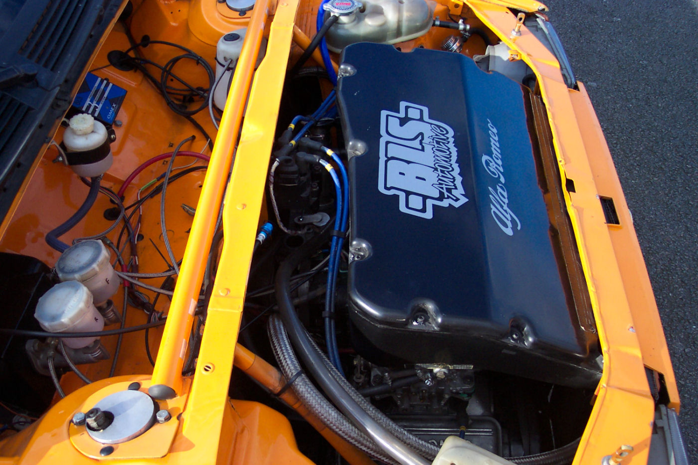

Hi all
not wanting to steal any thunder, i was just a little excited by recent work and developments at BLS with the 33 race car.
a winter build has seen a change from the ever faithful dellorto carbs and Omex 100 ignition control, to Jenvey throttle bodies, fuel injection, and upgrade to the Omex 600 ecu full management system.
everything else with the car is as before i believe, so all that remained to complete the changeover was a session on the rolling road with Northampton Motorsport to map the new system and bring all the hardware and hard work together.
the results, were as planned, better driveability over the carb set up, the precise fuel control being able to fill out the holes or gaps of the carbs delivery, so smoother faster transition through the revs, without dips, grumbles or rough patches.
the car as we already know, performs fantastically, so chasing more power etc wasn't ever the game, but you never turn down a free handful here and there! lol!
to try and show how it fuels now, in the rev range used 90% of the time on a hot lap, you have the viewing pleasure of the last dyno runs and checks done yesterday.

Thanks for the comments - thanks also to Shrew for the transportation service - fantastic as usual!
As per Shrews post, the session at the rolling road went well and gave the desired results in terms of the driveability gains - with a couple of extra bhp at the top end too! The runs in don't use all the revs as they were for the purpose of misfire detection - I glanced across whilst also filming and no more than 7000 rpm was used during these clips. Maximum power is at 8300 rpm.
As I have some time over the weekend I'll get back on it and write some words about the car as promised!

Re: BLS Alfa 33 race car
Great stuff Bryan, be a great read.
Incidentally, I meant to ask before,
Are you modifying the airbox to fit the jenveys and trumpets, or will you no longer run it and move to socks or gauzes or something?
The mods are already done to retain the airbox (also where the air intake temp sensor will be located). The throttle bodies are 18mm shorter than the equivalent carbs so we had some spacers and studs made up to lift the throttle bodies up to the same height of the carbs to preserve the packaging space for the airbox.

Here's an overview of the car's specification as it ran until the beginning of the 2012 season - where we converted to 16v (I'll cover that later). I had lots of success with the car - winning Class B overall (now A2) on several occasions and lots of class wins. On the right day (right circuit, right conditions - but not always in the wet) I've won overall but whilst 8v that got more and more difficult against 16v engined cars - not to mention the super/turbocharged, Supertourers and large capacity V6 engined cars.
With regards to power, we've always used known conservative rolling roads so whilst others have claimed more from 8v engines its not shown on the track where it matters. A friend of ours worked at Cosworth F1 when we were upgrading the 8v engine in 2001 and he 'designed' the head modifications - these included offsetting the exhaust valve to allow for 44.5mm diameter intakes plus larger than standard exhaust valves. The cams were also analysed (profiles based on a Judd profile) and deemed well suited to the valve sizes. He also specified the exhaust diameters and lengths using Cosworth software. It all worked rather well together and only really the march of time (and opposition) meant that 16 valves became required - way earlier than I went 16v but that was due to depth of pockets!
Anyway, here's the specification:-
Chassis
Converted from Mk.3 road car (Mk.2 lights, grille and front bumper)
Sparco welded in cage. Extra tubes through to suspension turrets
Kevlar composite bonnet and tailgate
Fibreglass composite front bumper, front wings, door skins, wheelarch extensions and rear bumper
Perspex windows (side and tailgate) – slider unit in driver’s window
Carbon rear wing (ex-Honda Super Tourer), front splitter and rear diffuser
Engine
1793cc 8 valve – 175 bhp at 8000 rpm
1700 crank – not steel but cross drilled
89mm forged pistons
Steel rods (H-pattern)
FD4 profile camshafts
Ultra big valve heads
Lightweight steel flywheel
Large capacity baffled sump
Twin Dellorto 44 DRLA carburettors
Full width air intake box (custom made)
Omex control unit (controlling spark) with distributorless coil
Custom made 4-2-1 stainless steel manifold with repackable rear silencer
Custom made aluminium radiator
Transmission
5 speed close ratio straight cut gears
Gripper LSD
Strengthened 16v casing with billet aluminium flat plate base plate
Pinion shaft supported with rear bearing and additional rear plate brace
Helix 7.25” single plate racing clutch
AP Racing concentric slave cylinder
Lightened shift remote
Front Suspension and Steering
Modified 16v front crossmember
Tubular wishbones (fabricated) with rod ends
Koni double adjustable McPherson strut inserts
Eccentric top mounts
Tubular adjustable front anti roll bar
BLS quick rack and Momo steering wheel
Rear Suspension
Modified 33 rear beam
Re-located panhard rod with nylon bush/rod end location
Watts linkages with nylon bushes
Bilstein coil over dampers
Adjustable rear anti-roll bar
Brakes
Front – Ventilated discs with lightweight Alcon 4-pot racing calipers
Rear – Solid lightened discs with lightweight Alcon 2-pot racing calipers
Fabricated pedal box with bias bar
Twin master cylinders and remote reservoirs (no servo)
Fuel System
Fabricated alloy tank – 30 litre capacity
Twin electric pumps
Pressure regulator and filter in engine bay
Aeroquip lines throughout
Wheels and Tyres
7”x15” 5 spoke alloys – front and rear
Dunlop slicks and Dunlop wets
Interior and Safety
Plumbed in extinguisher system
Schroth 4 point belts
Cobra Evolution seat
Battery located inside cockpit
