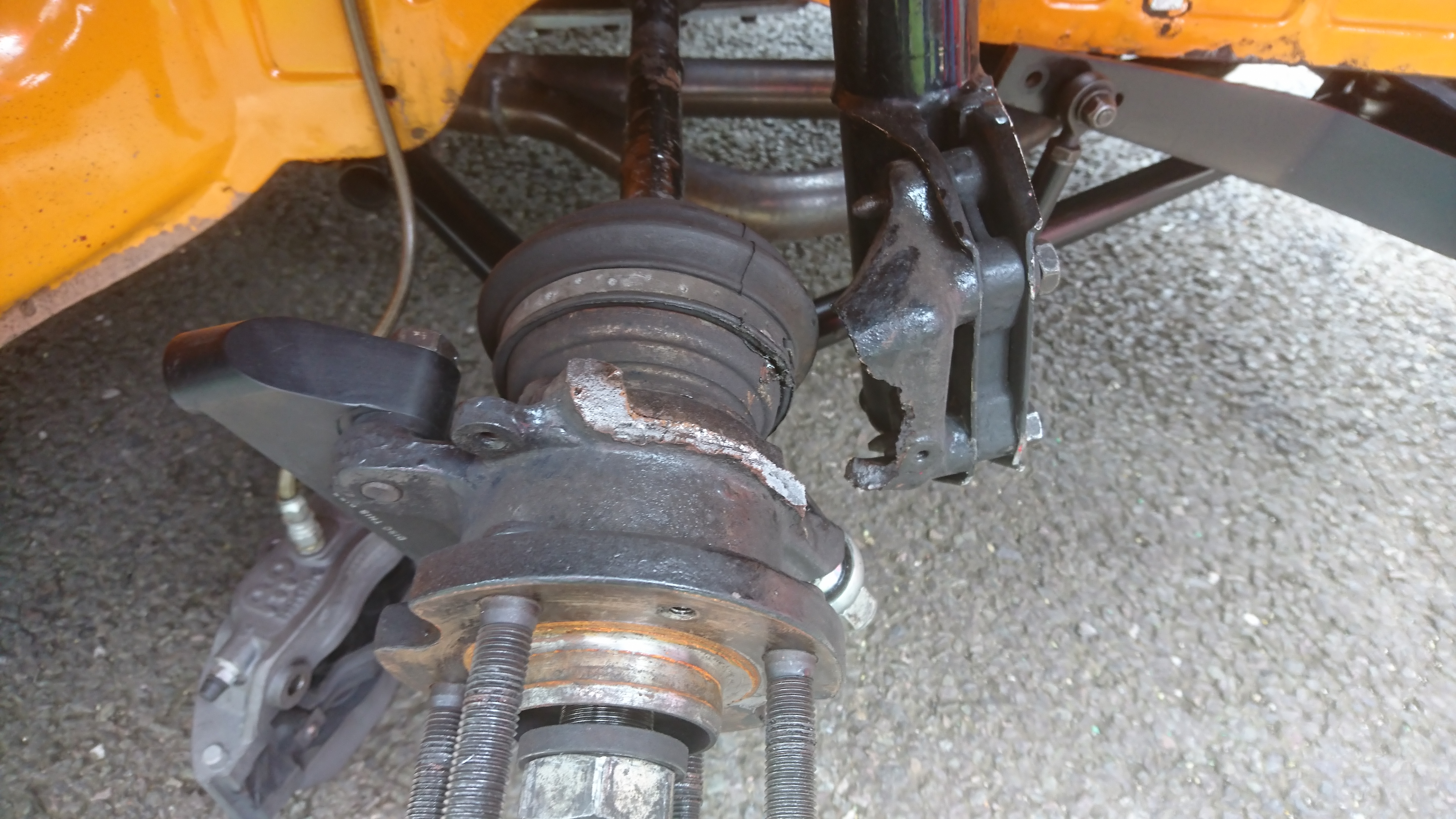

Front hub sheared going into the Mountain whilst leading on the first lap - thankfully I stayed on the grey stuff and parked up. Lots of effort from the team will see us start at the back tomorrow having changed the hub. Shrew has some photos of the now two piece hub - I'll see if he can post them up tomorrow.

As Bryan says, a frustrating weekend, but thankfully a real rarity for anything BLS prepared to have issues such as this. but even the mighty 33 has to have a bad day every now and then, and possibly show her age once in a while. It was afterall the hub that failed in the first race, 99% an unmodified and standard part, but sadly 30 years old, unknown original mileage, and the stress's of stiffer suspension and masses more grip than a road car could ever create, its actually a really good record that it hasn't happened previously, and we were incredibly lucky that the final separation of the hub parts occured the moment the car came to a compete standstill

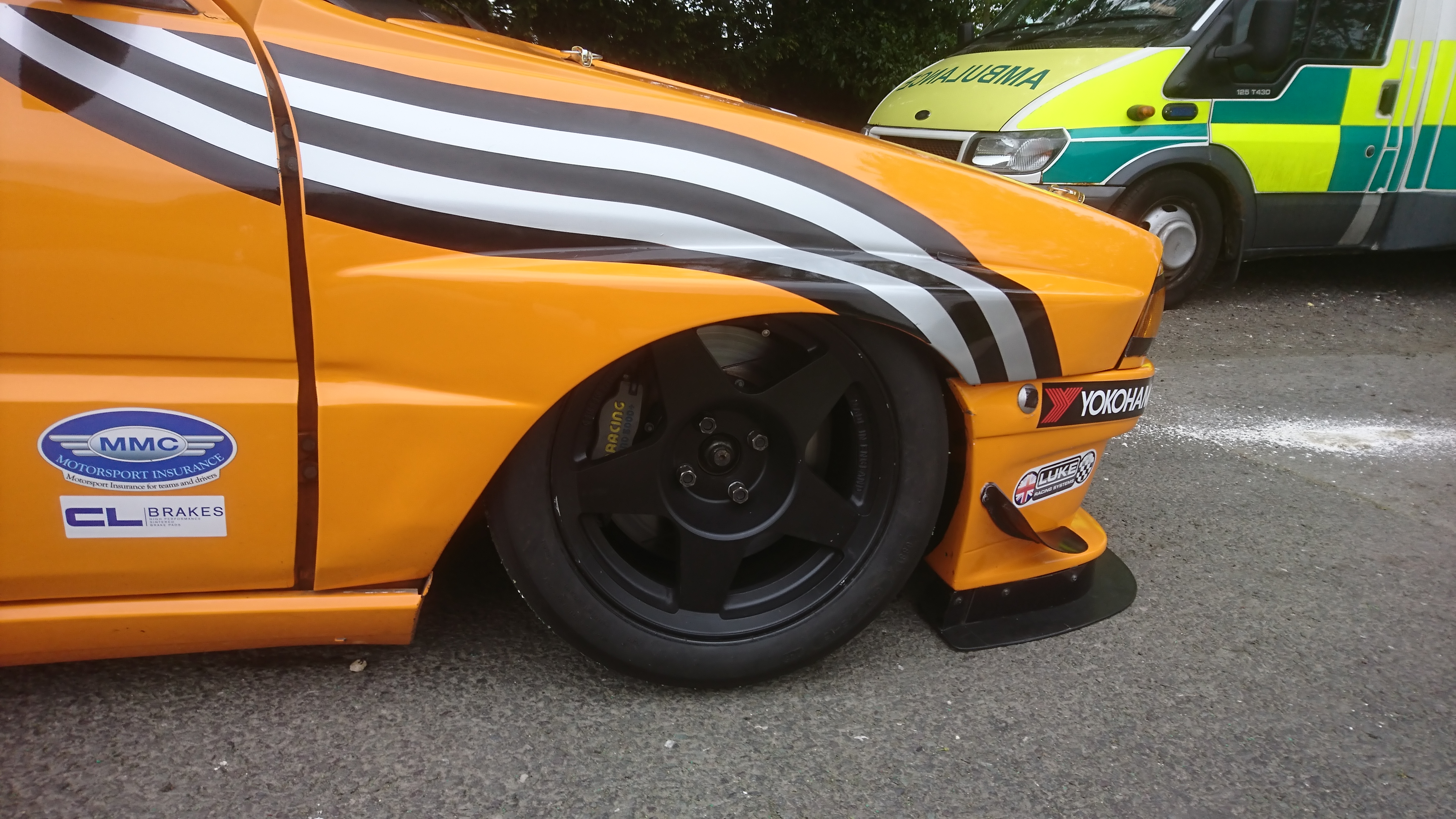

Thanks for posting the photos Shrew - just to clarify that the gap between the door and wing in the second photo is much greater than usual as the wheel/tyre pushed it out! Having said that, TVR would have been happy with that as a gap!

Thanks for sharing that guys. Thank heavens it finally failed at low speed. Poor little hub under intense pressure finally gave up its life but not until it had brought the car home safely - it was only 30!

Wow !! now that is a break.

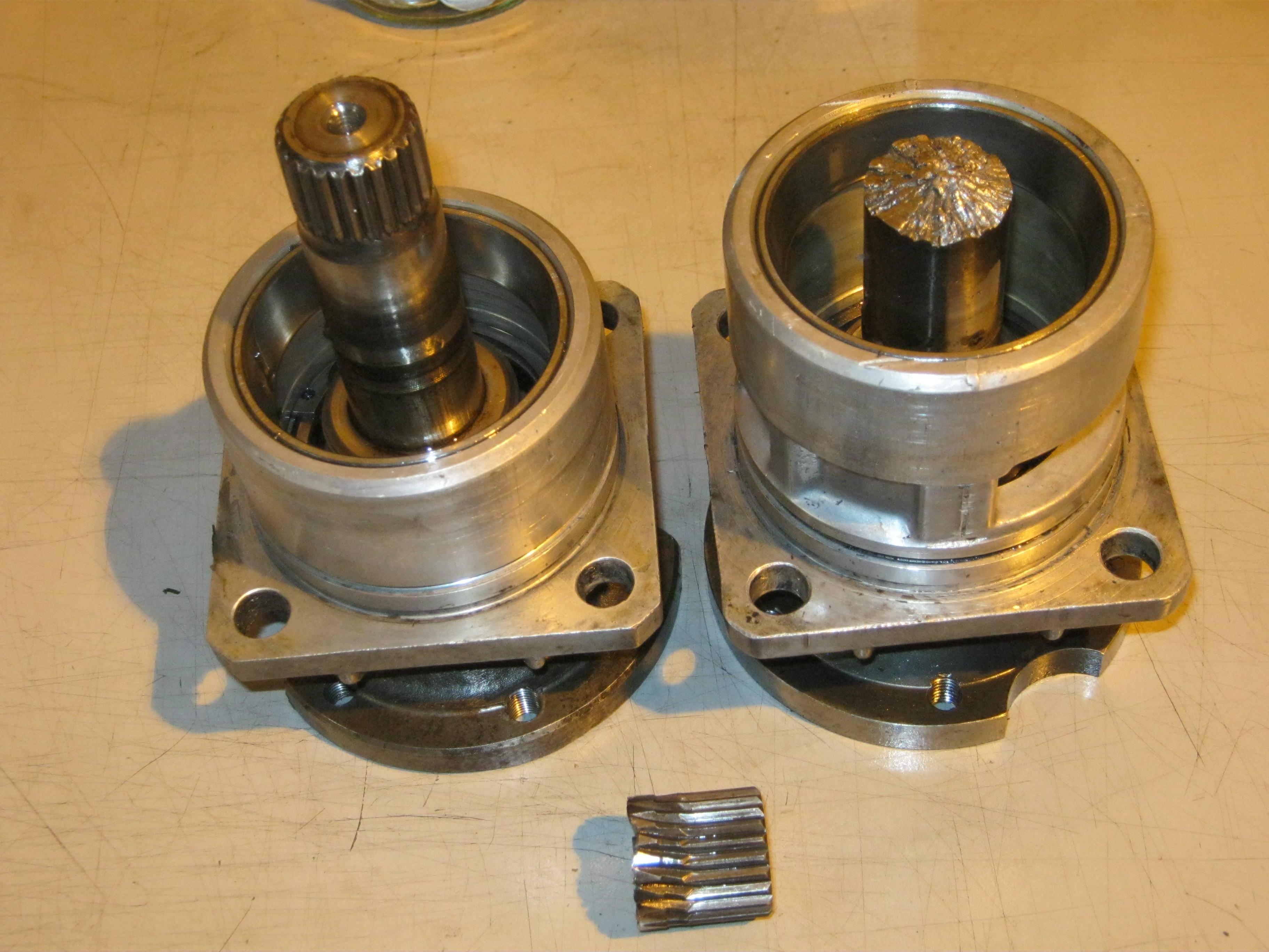

Turned out to be a weekend of major failures, offside output shaft twisted and broken. It was a specially made one though most likely failed as a result of the hub failure on the same side a day earlier. Everything else is intact. Here's the obligatory broken parts photo:-

Looks like the splines just holding out shifted the torque down to the break, not what i expected but i'm pleased nothing else has broken along with it.
Anymore custom ones around Bryan
Re: Alfa Championship - Cadwell May 6th/7th
Sadly not, quite a long lead time so will revert to standard shafts for the meantime. The LSD looked ok but we will send that off for a service/rebuild.
