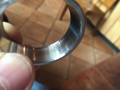

Hi guys,
The Trofeo offside front hub was changed tonight. On full lock round the car park the car sounded much better. Little bit of a tick from the offside rear so I will change those bearings too.
It will be interesting to see what the front hub bearing looks like when removed from the hub.

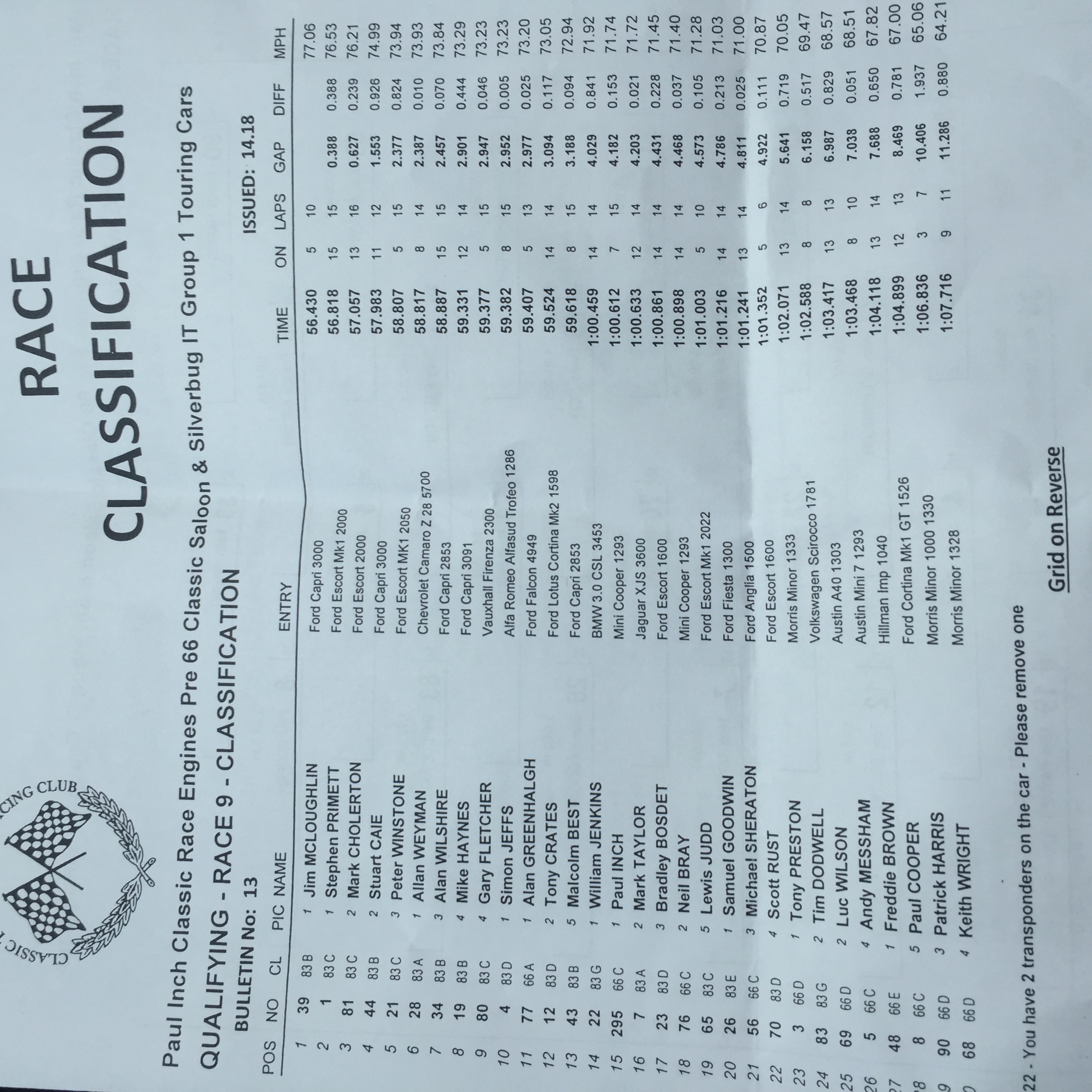

Good qualifying. In the pre83's I make it:
Jag 3.6
Escort 2.0
Dolomite 2.0
Escort 2.0
Dolomite 2.0
Capri 3.0
Alfasud 1.6
Good luck to all the Alfa drivers and Chris in the Golf Gti Mk1.

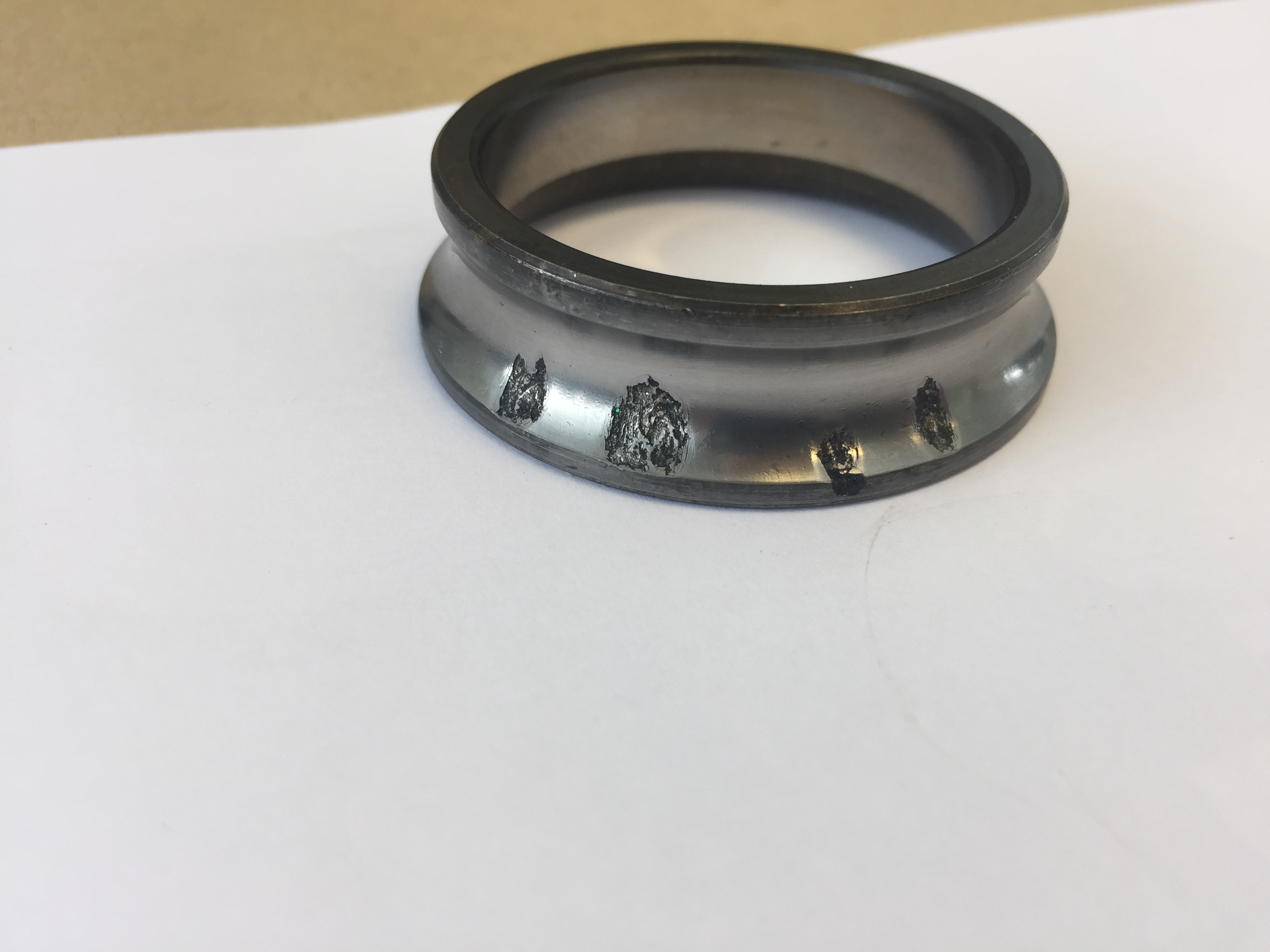

Hi Guys,

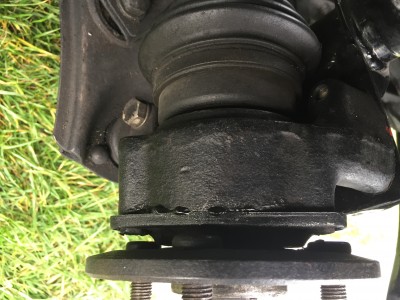

Tom has kindly replaced the bearing in my front offside hub.
The noise was thought to be the driveshaft rubbing or rubber nuts being picked up by the tyres.
The wheel turned smoothly.
The clue was the seeping grease.
Look what Tom found:
Re: CTCRC Pre 83 2017
Ouch !!
That looks like it has had some stick .
the way the pitting is spaced it looks like classic wear where the ball bearings are sitting in the same place and corrode away where they touch, glad it's sorted
- Posts: 976
I think you are right Kev. Just in those four places. Nowhere else.
You would only need microscopic corrosion for the inner race surface to start picking up.
Then as Keith says, the car soaks up a lot of abuse in the corners and you end up with craters. Now I know what that horrible noise was around Rockingham and the reason I didn't take it to Cadwell.
The new bearing is packed with a lovely high temp racing grease. I think I will get the nearside front replaced and then all four wheel bearings are new.

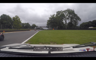

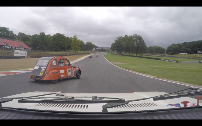

Hi Guys,

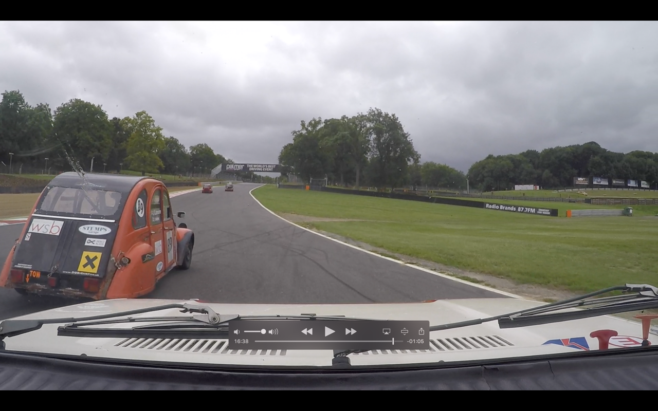

Just taken a couple of screen shots from my video of my grass tracking.
Evasive action need eh !
Nice one.
