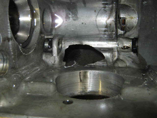

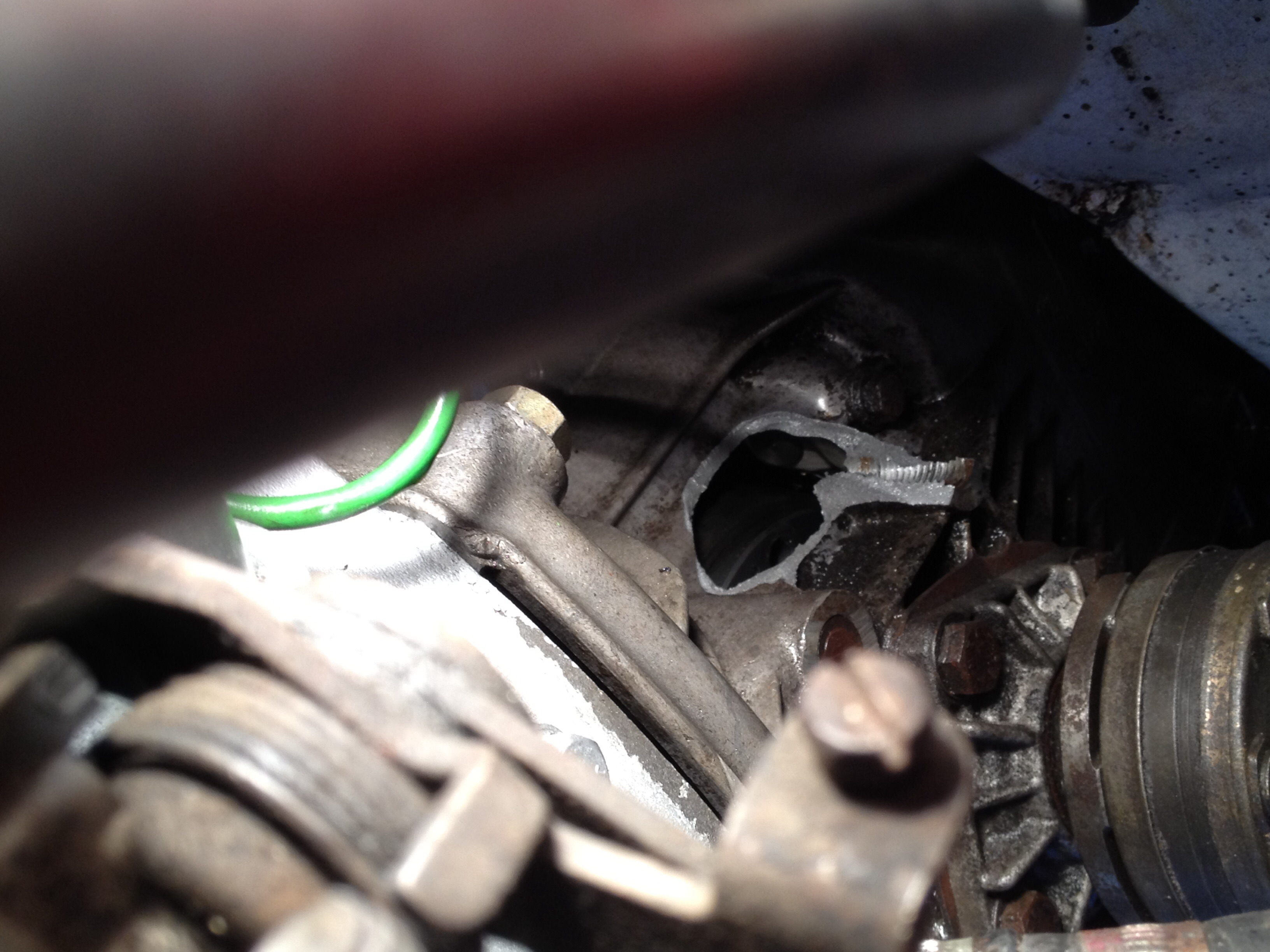

Re: Sprint racer
Oops !
I don't think there was meant to be an inspection hole here......
Re: Sprint racer
whoops!
no wonder it got a bit smokey

Re: Sprint racer
Oohh, that looks nasty..
Would be interested to know what it was that was that was so desperate to get out that it decided to punch it's way out.
When will you open up the gearbox Tim?
Good luck in swapping it out / getting it repaired.
Malcolm
Malcolm

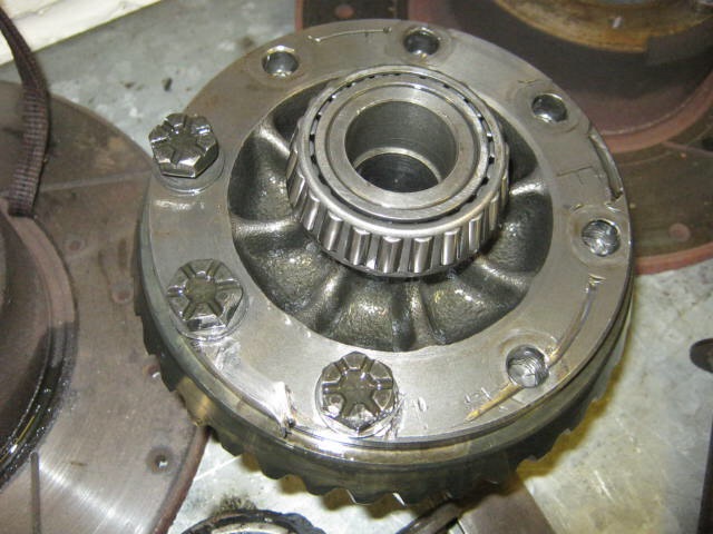

Re: Sprint racer
The culprit was a diff bolt, possibly multiple...photo to follow.
New gearbox done and fitted, old gear set put into another box and diff.

Re: Sprint racer
Couple of gearbox pics....5 missing bolts on the diff, one escaped, 4 fell in the bottom.
Re: Sprint racer
Thread lock next time !!!

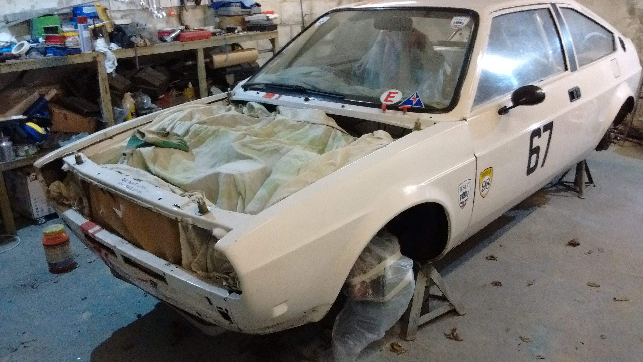

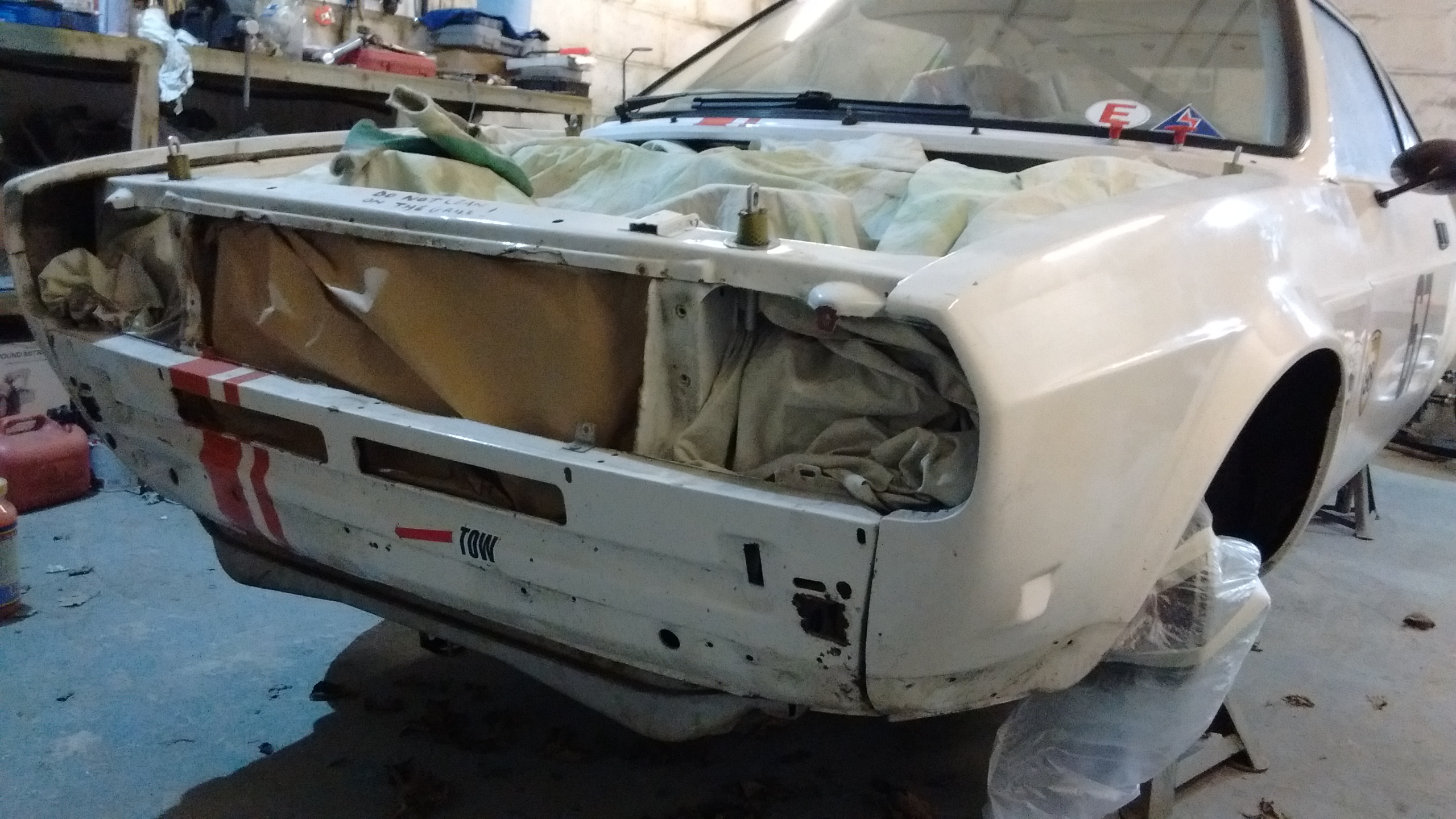

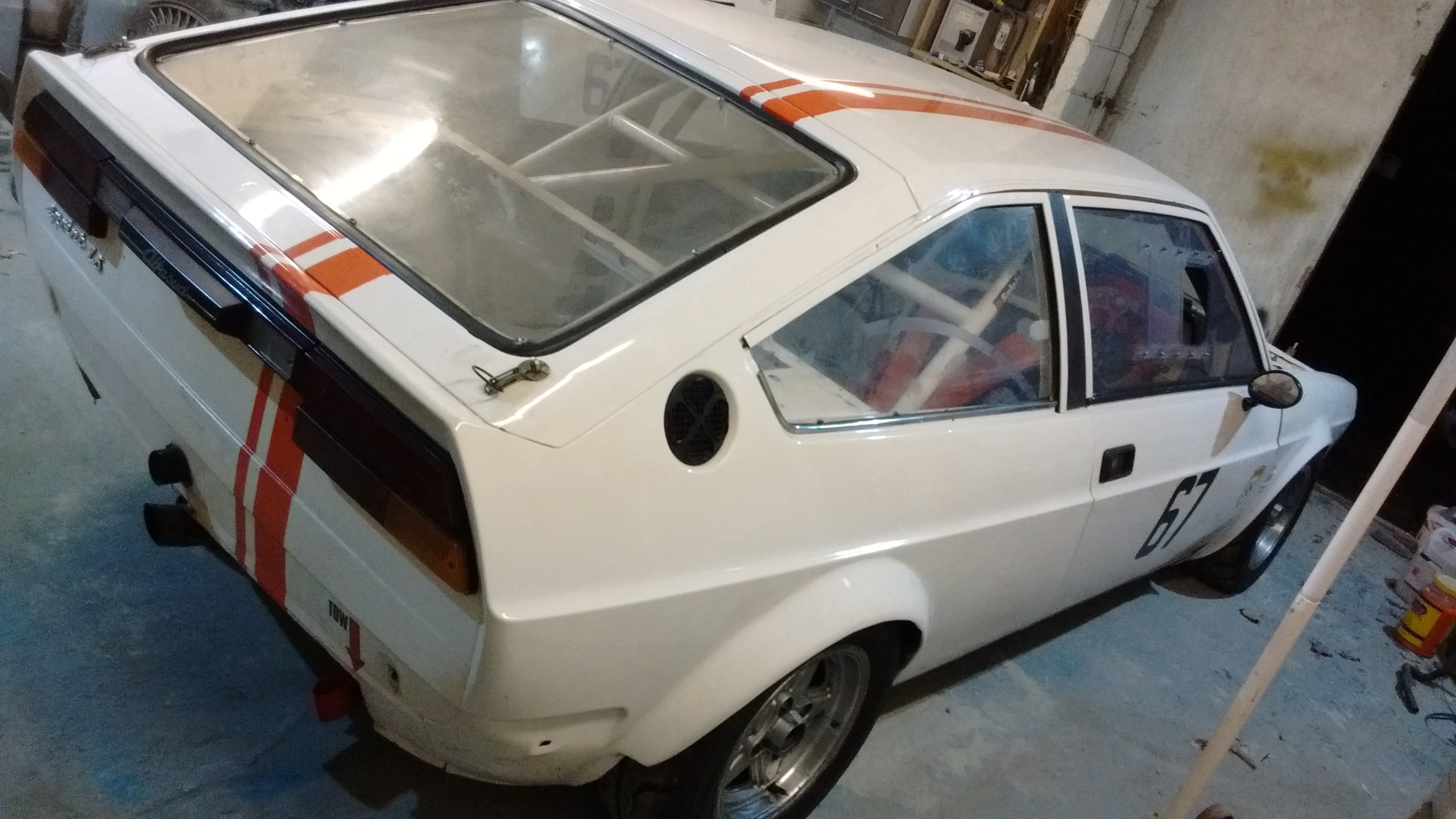

With all the running around this afternoon, getting the Fulvia tucked away nearer to home and all that I hadn't had chance to do anything to the Sprint.
After getting something to eat back home it was a choice, Saturday Evening TV or pop up to the workshop to get the car up on the stands and asses things a bit more, plus unload a few tools I'd taken from the integrale working area......
First off was to cover the inside areas that need to be kept clean, dashboard and seat etc. plus the running gear, sanding cars off makes a huge mess, even grinding causes issues as the sparks stick to anything then start to rust!
Front lower spoiler will be painted body colour, easier to do it off the car and ensure decent paint coverage behind it so that was removed. Front grille and indicators off, wheels off. About it really so far.
Should have some regular updates this coming week.....

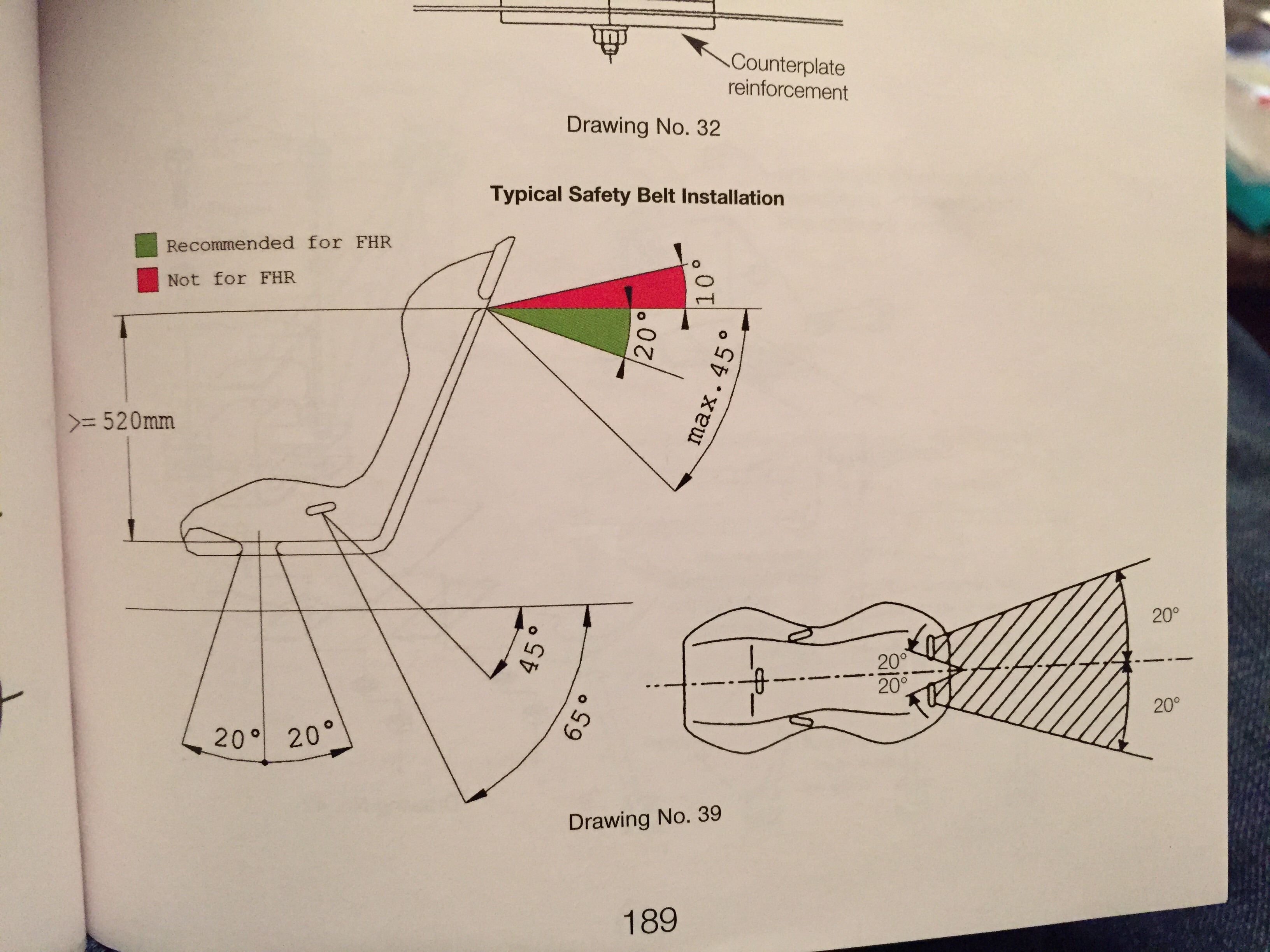

Shrew made me think about my harnesses and fhr/hans ......I might need to fit a harness bar after all...

Hi Tim,
Good luck with the work. I am sure the guys will do a great job.
Malcolm gave me a heads-up if you excuse the expression on seat belts complying with FHR requirements. 0-20deg recommended but your belts can descend at 45deg behind the seat. Here is the blue book extract:
