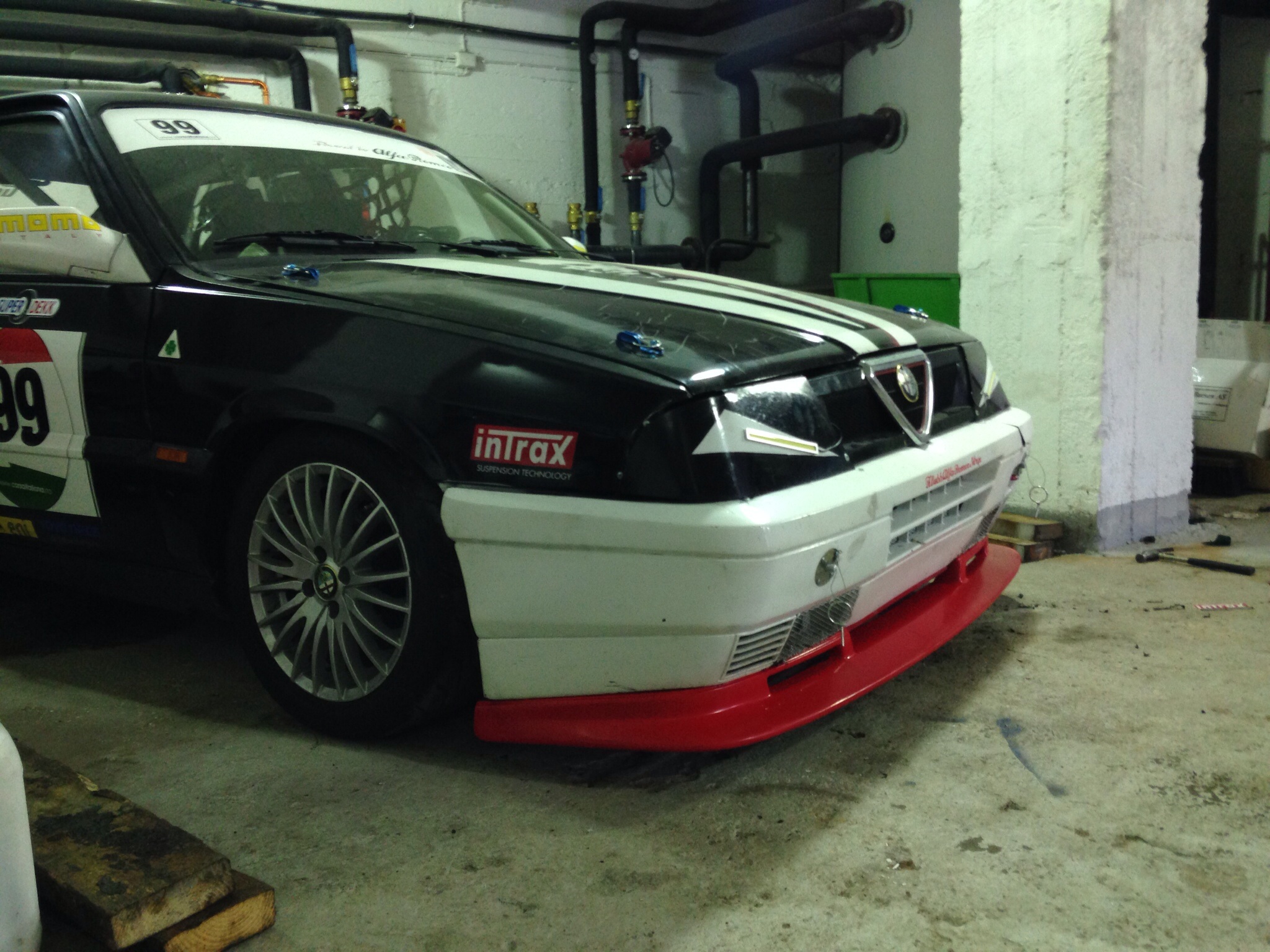

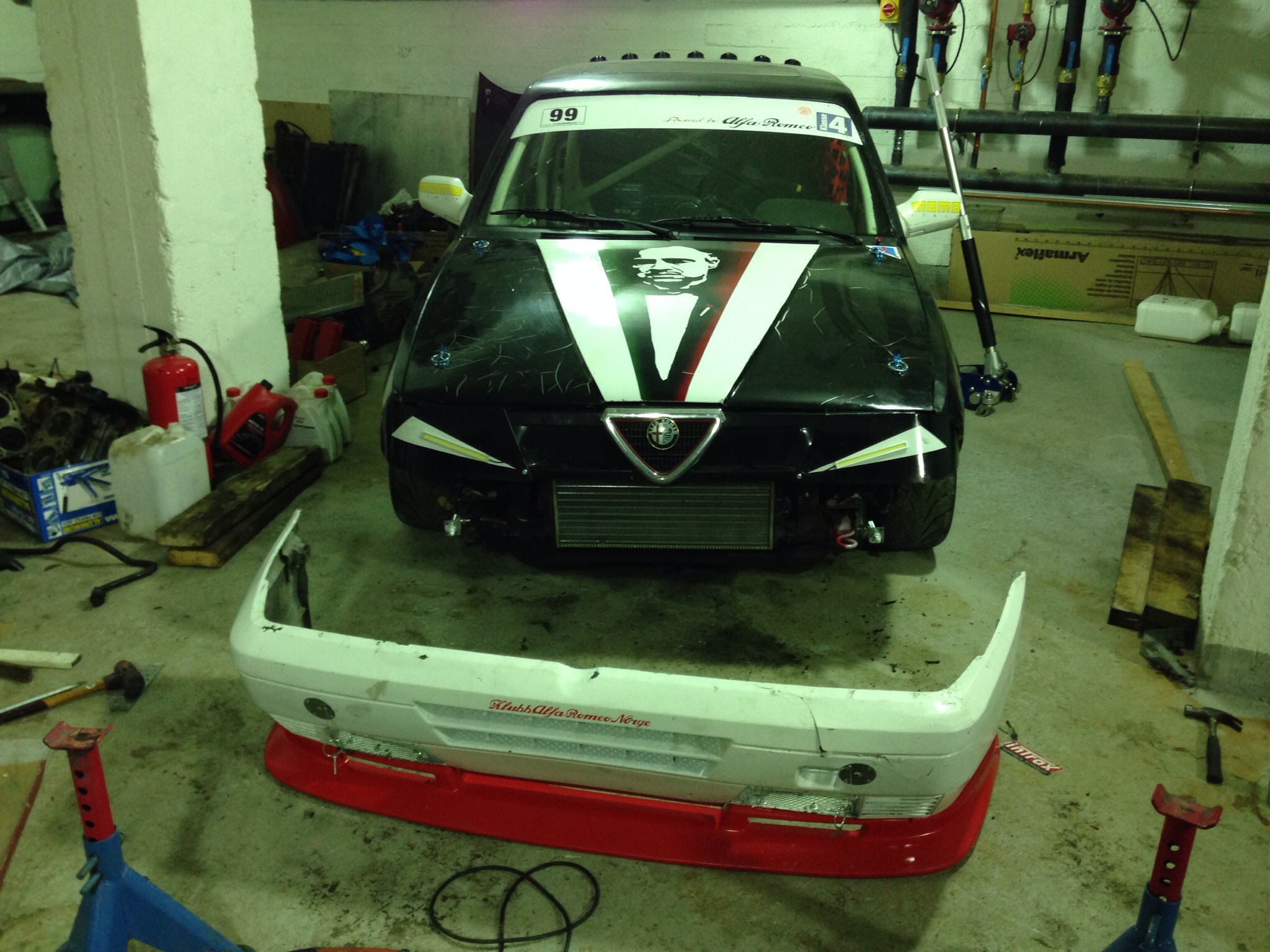

New frontlip installed
Some cutting and handeling to get it to fit, but now it's in place and with "snap on" mounts.

Nice splitter!
whats happened to the bonnet though?
Looks like Corleone hasn't aged well!
Re: From Road car to Race car - Alfa 33
The paint is cracking - or aging Don C. - depending how you look at it. It might be that I did not sandpaper it enough (was polished) before painting. I also did the black just with a spray can down in the basement, so myst blame myself ;-(petrolhead wrote:Nice splitter!
Not sure if I should sand the black down again and give it a new go??
Slitter looks good
As for the painting yeah just sand it back and redo , but make sure there no wax on the bonnet

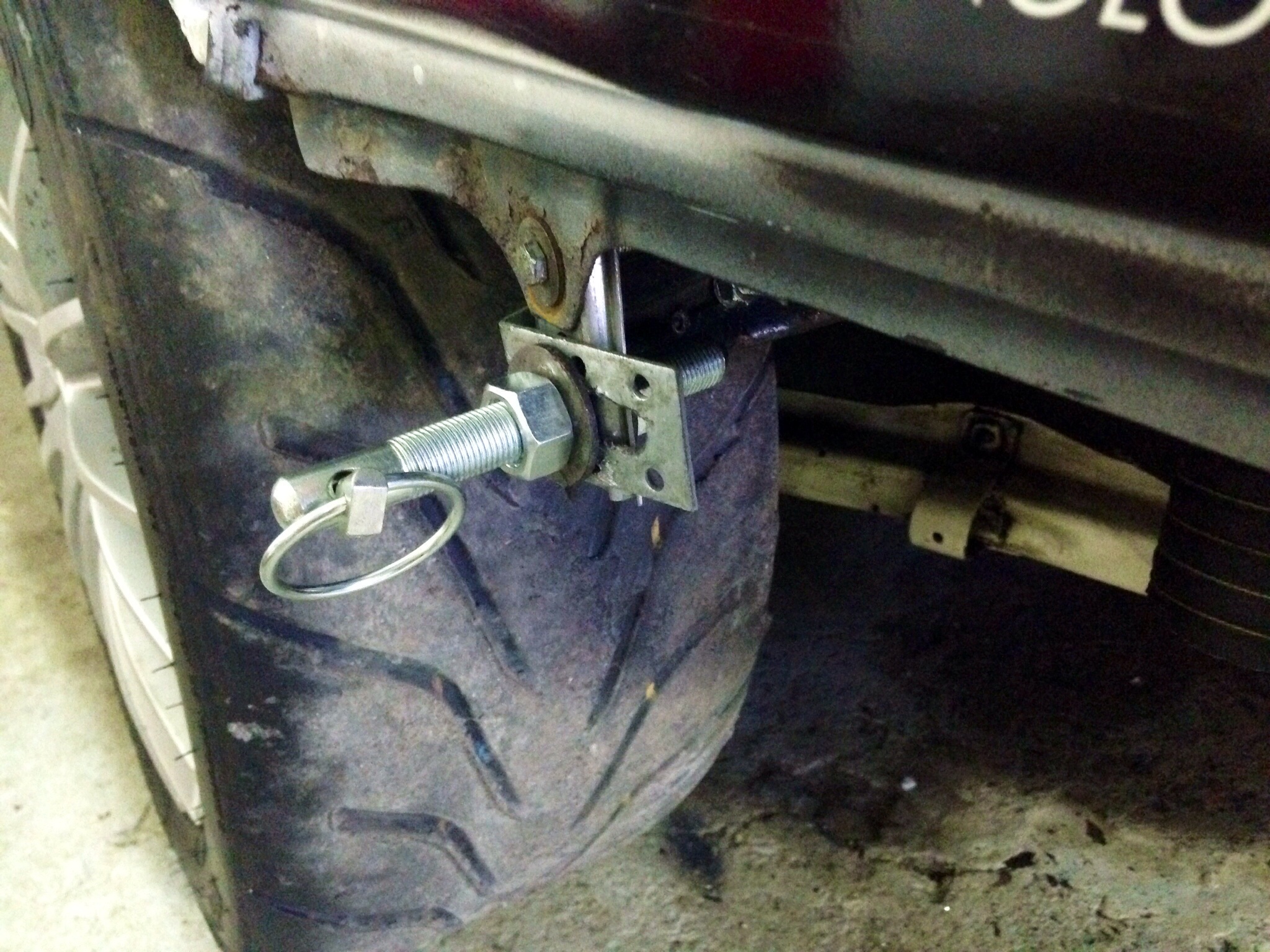

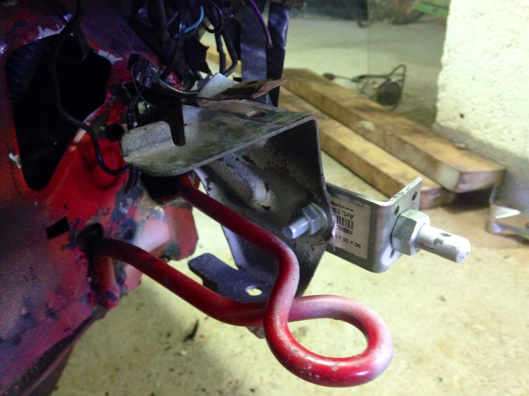

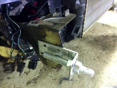

Here some pics of the bumper mounting. Have left the original bumper brackets on the car si it's easy to slide the bumper in place, rest is just hood lock's and angle brackets

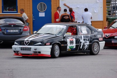

The upgrades worked great, and two more trophies for Don C
Pole Position after qualification, stayde in front in first race, so class and heat victory. Race two I was second on the grid (no. two had better lap time then me in race one), but late breaking in turn 1 gave me the lead that I kept until the checkered flag, and I secured me third strait win
Only challange was the sun and heat on saturday. I think I warped mye break disks, so now it's a bit shakey when I break hard. Should be possible to machine down, or......???
Nice weather, nice friends, nice racing, so all in all a really nice weekend

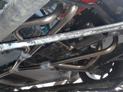

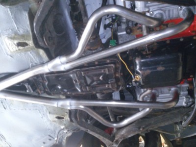

Actually, not sure mine is a crossover, it's equal lengths tho I think. I will take a photo next time I'm underneath the car.
here's my old 16V (now shrews) that he built the exhaust for, sure i've some pics somewhere of the build....
this one was on my trailer
- Posts: 3046
nice video's, and well done mate.
exhausts Tim, as a general rule, short headers are biased towards top end power motors, such as drag engines
secondaries are added to create a broader spread of torque, and to aid scavenge in paired cylinders, and can be tailored to place peaks of torque according to the cars use.
lose rules, and all rules can be played with of course, but equal lengths and a good healthy practice of high quality construction is a must, even if you don't have the sums quite spot on.
If your exhaust is from Dave's build, it could well be a crossover, as he is one of the few fans of them.
Most folk find them too compromising on ground clearance unless using a shallow dry sump set up, and tricky to get the routing right to work well and with equal lengths, or in other words
more expensive!
more expensive!

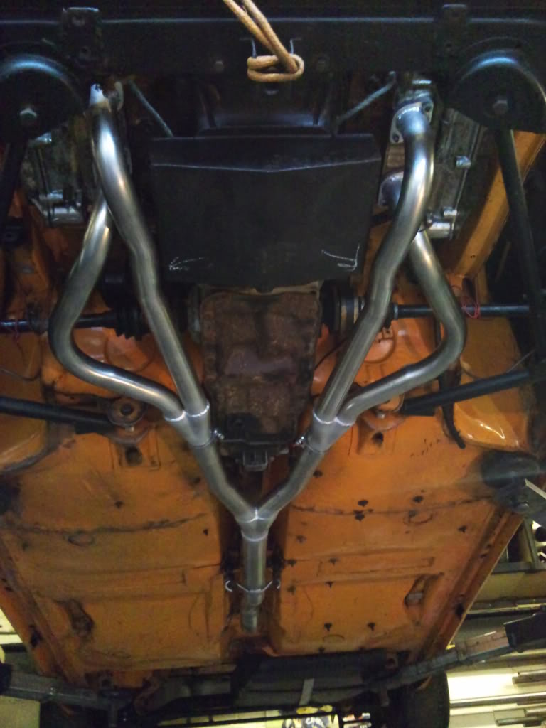

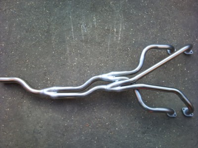

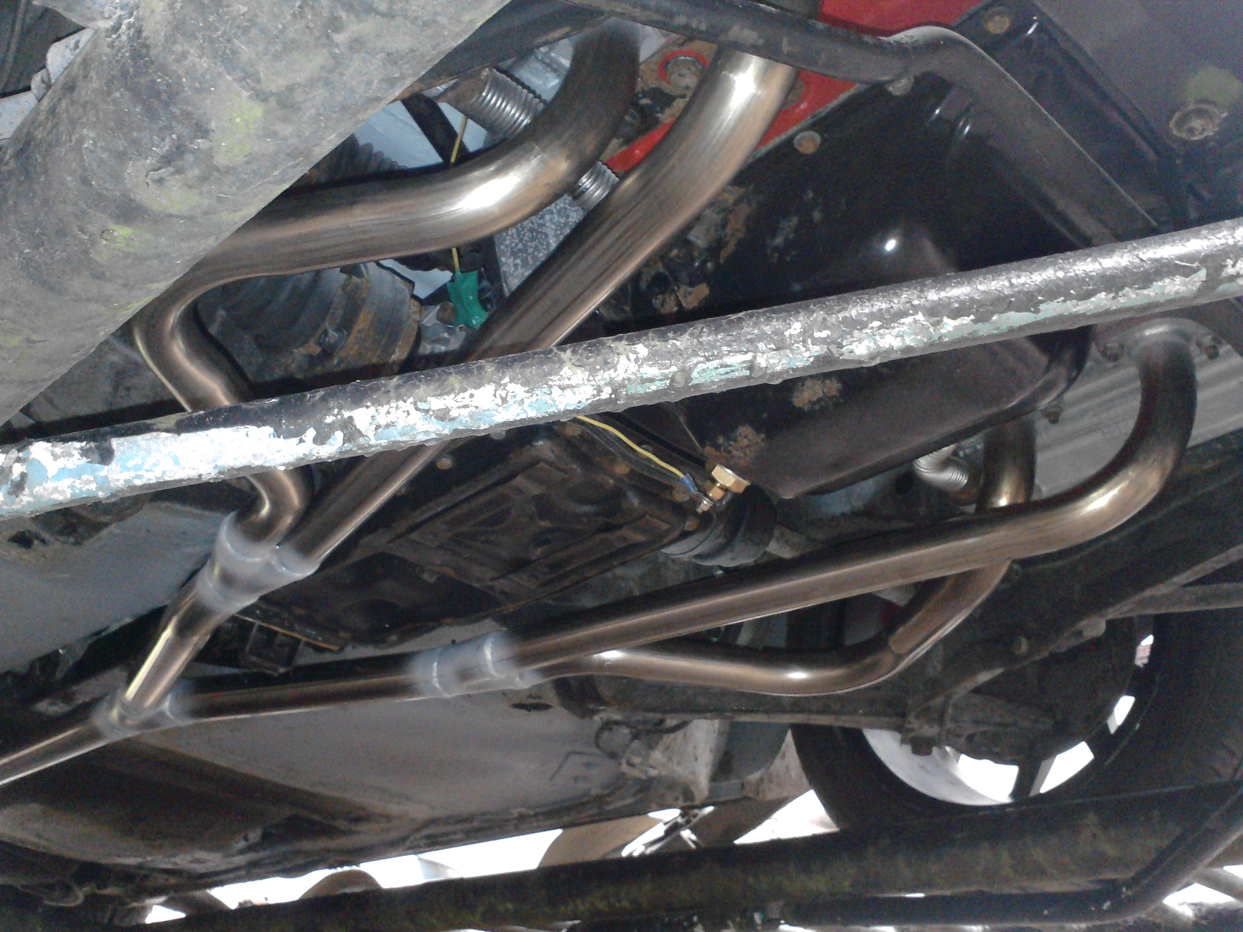

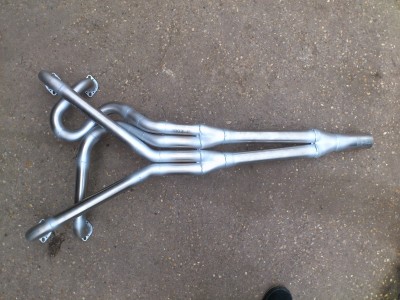

Heres a few pictures for future reference
a race manifold on a wet sump 16v sud (kev/my own)
the race manifold on the BLS race 33, with dry sump
a crossover for 16v 33 road car, onto a cat, wet sump motor
a crossover from mandrel bends, on a dry sump 8v race sprint
Good pics - though mine is a wet sump using the much copied BLS 'big wings' wet sump design
- Posts: 3046
Of course it is Bryan,
I was just testing you
