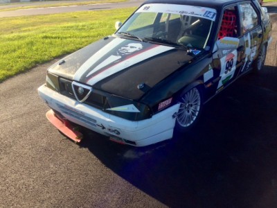

Question:
- after mounting the front lip, the breakes over heated (wobbeling when breaking after some laps), any suggestions on ventilation?
One idea is to cut out a part in the front side panel behind the weel to let the warm air out and to put a tube from the front fender hole and guide it back to the breaks to let cold air in.
Any other suggestions??

Run ducting from the lower air intakes on the bumper - you need to get air in as it's much more effective than extraction only.
Re: From Road car to Race car - Alfa 33
Will try something in that nature, but feel the need for both ari in and out.
