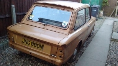

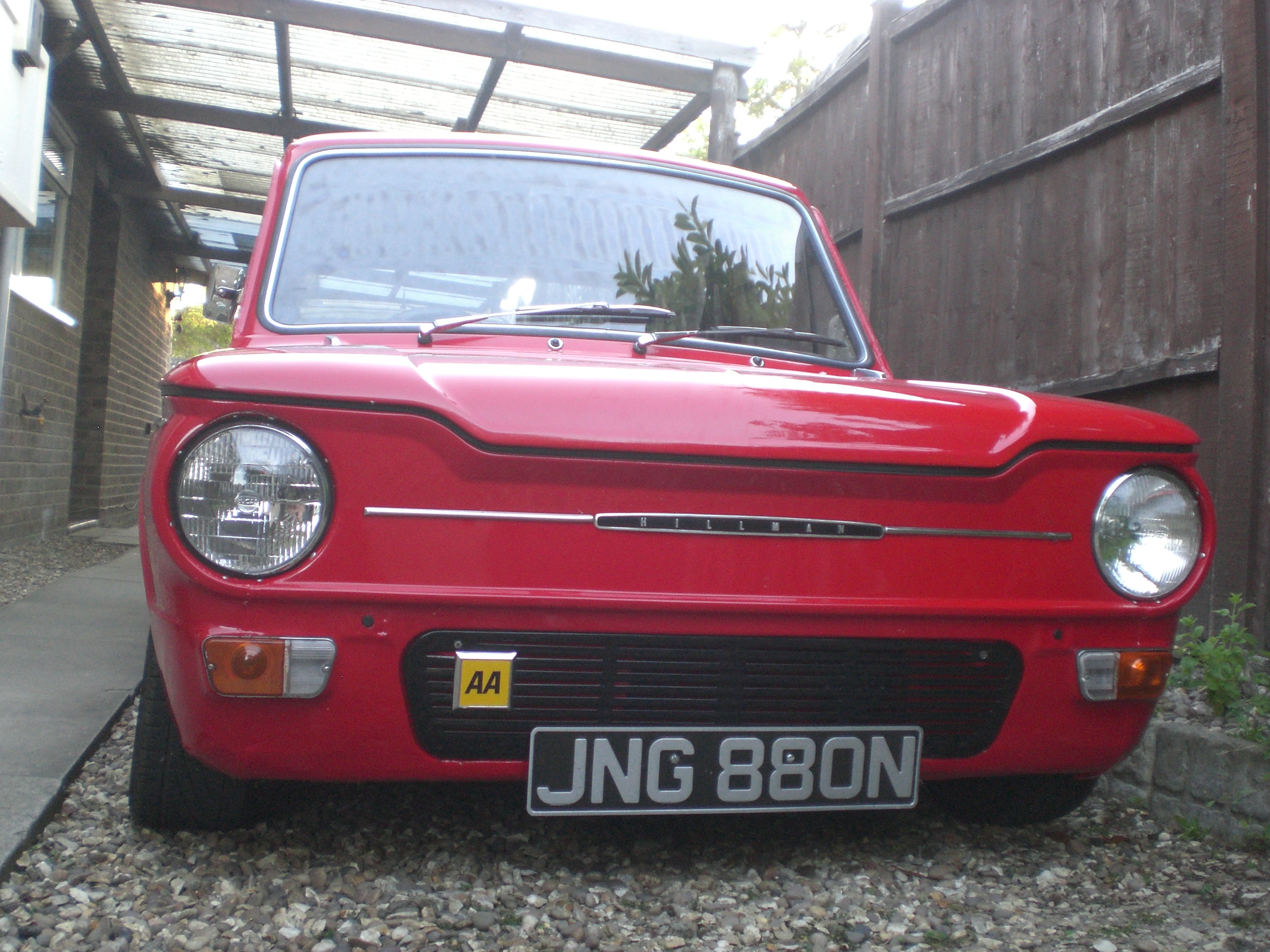

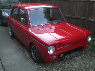

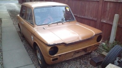

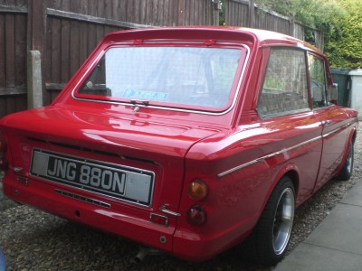

Finally the day has come, the Imp has made it back home!
Over 2 years ago it was sat here feeling like one step from the knackers yard, more like one foot in the knackers yard really! :roll:
The new radiator performed brilliantly. To avoid any town driving we went the long way home from the unit, via Cadwell and all over the shop, probably a good 45 to 50 miles so the car had a good workout in the high 20's heat of a Saturday afternoon.
His little Sis had to have a ride out in it once home, she reckons it's noisy!
Last time She sat in it it was more of a flintstones car...
Rob seems happy with it, I'm just glad it's finally off my "to do" list!
Re: Kev's workshop projects
Same place, mostly the same car.....almost 2 1/2 years apart....

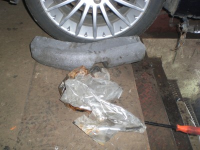

The GT is due an MoT at the month end, I knew the "sills" were a bit crusty...…
Seems Alfa still have work to do on rust prevention....rear end no better.....
Remember all the hassle with foam inside box sections? Seems like Alfa didn't get the memo......this foam is about 15" long, £2 x 4" diameter and stuffed inside the sill end, wrapped in a plastic bag just to ensure the moisture is trapped for as long as possible!!!!!
Hard to argue for how good the cars are when stupidity like this is being built in at the factory...

Those sill look a mess mate.
Do you recon it was prematurely started by damaged sills on a two post ramp in an earlier life?
Yes mate, they've either been trolley jacked or 2 post lifted on the wrong part. The wide section is purely cosmetic, the sill lip itself is the bit that should be used. All dented upwards and peeling sealant.

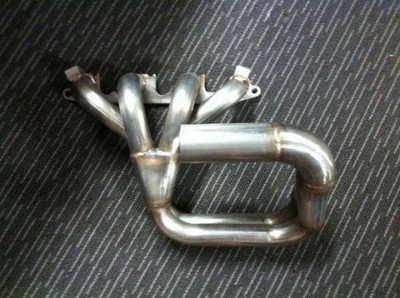

He's also been busy buying a few upgrades..
Shrew will be pleased to see this rather than the restrictive cast iron standard item, he's also got a sports back box to go with it, all in stainless.

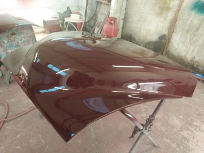

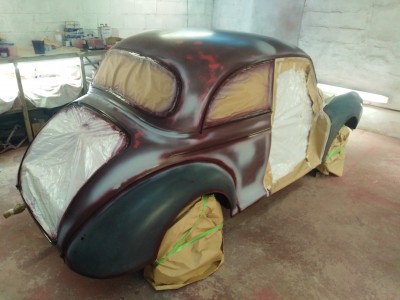

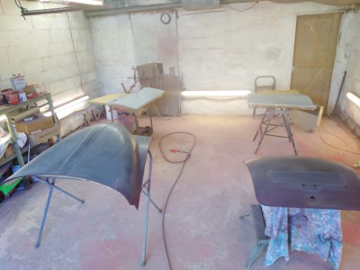

Different job to do this week, had a couple of days off work to use up and Terry who has the unit next to mine asked me some time ago if I'd paint his Moggy for him. He's been busy prepping it all Summer, stripped it right back and painted it inside and out. Trouble is for him he's now in his 70's and doesn't like doing a lot of spraying now having had Lung surgery a few years back...how can you say no!?

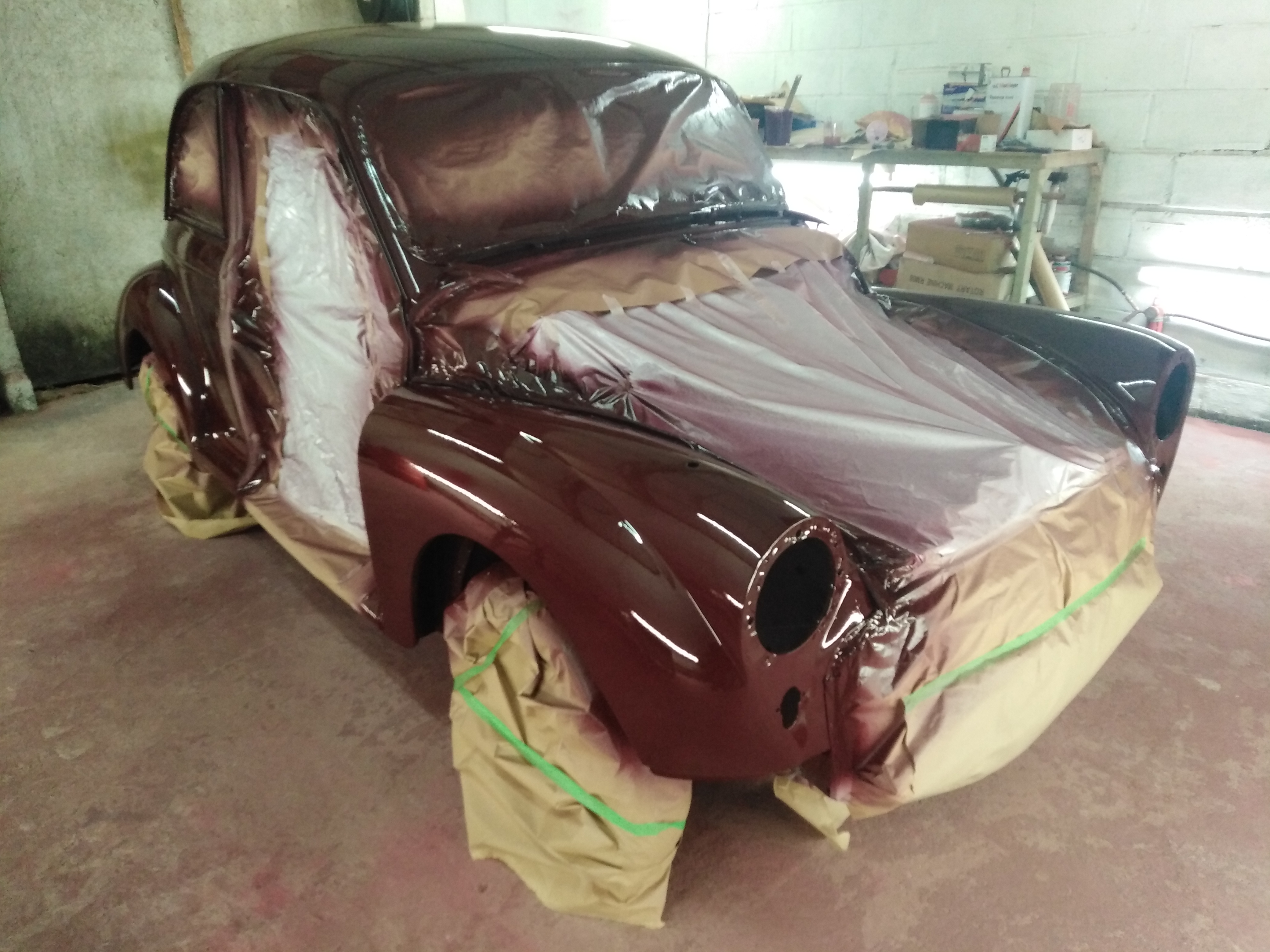

So Monday I had the doors, bonnet and boot in the little unit which he'd prepped and primed, even masked up for me. That's the kind of spray job I like :)
Terry has been doing cars for years, had his own restoration and sales for decades up at the unit. He'd warned me that these old cars with their curves were more tricky to paint, he wasn't wrong! The doors with the bulging wheel arch flares against the flat face creates a recipe for runs, managed to get away with it but so easy to overlap and build up too much paint.
Bonnet equally so, hard to get a decent finish all over, tried my best!

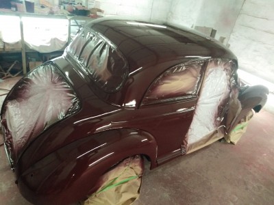

Bootlid went ok apart from when a big lump of fluff landed on it :evil: No option but to pick it out and load up the area..
This afternoon the panels went back into Terrys' unit for him to flat and polish them, again that's the type of paint job I like :)

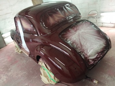

Bodyshell got pushed into the unit then we cleaned and finished the masking. He'd already painted the panel gaps before fitting the wings back on. Door shuts too, so he decided where things got masked off, suited me just fine ;)
Shell went pretty well, one fly in the middle of the roof as usual, a little run on a front wing but overall with all the shapes to cover I'm happy with the results.
