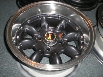

Been confined to home today with the bad weather, so Rob set about polishing the Imps' wheels.

I still can't believe you did them with cans.
I think they look fantastic.

I've had plenty of practice over the years with cans mate, so guess that helps!
They do look pretty good though, we can't wait to get them on the car as the red should reflect nicely in the polished dishes

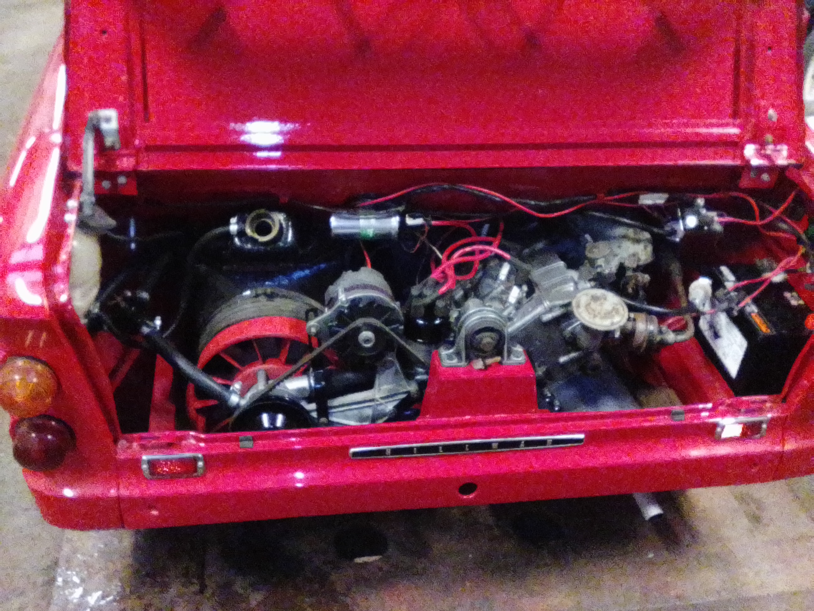

Well at long last we have the Imp running.
New electronic ignition kit fitted which was a great kit really, get a complete new distributor with the kit already in plus wiring loom for it, new coil and even cap and leads. All for less than £100 Rob says!
Much better than messing with points..
We've also fitted an alternator in place of the dynamo and separate voltage regulator which I seem to have wired up ok!!
Sounds pretty sweet with no nasty noises or rumbles, clear exhaust, no leaks and no side effects of being stood and the broken spark plug saga!
Next week we'll get the brakes and clutch bled so Rob can at long last drive it around the yard for the first time

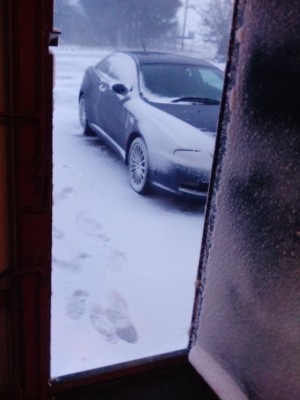

We did keep hearing the snow on the unit roof but thought it wouldn't be too bad, a bit came in on the 155 as the wind was blowing it a funny angle under a sheet..
Outside the snow did seem to be drifting more than we thought!
Nothing like as bad as a week or two back and unbelievable that 3 days ago we were in the teens temp wise!?

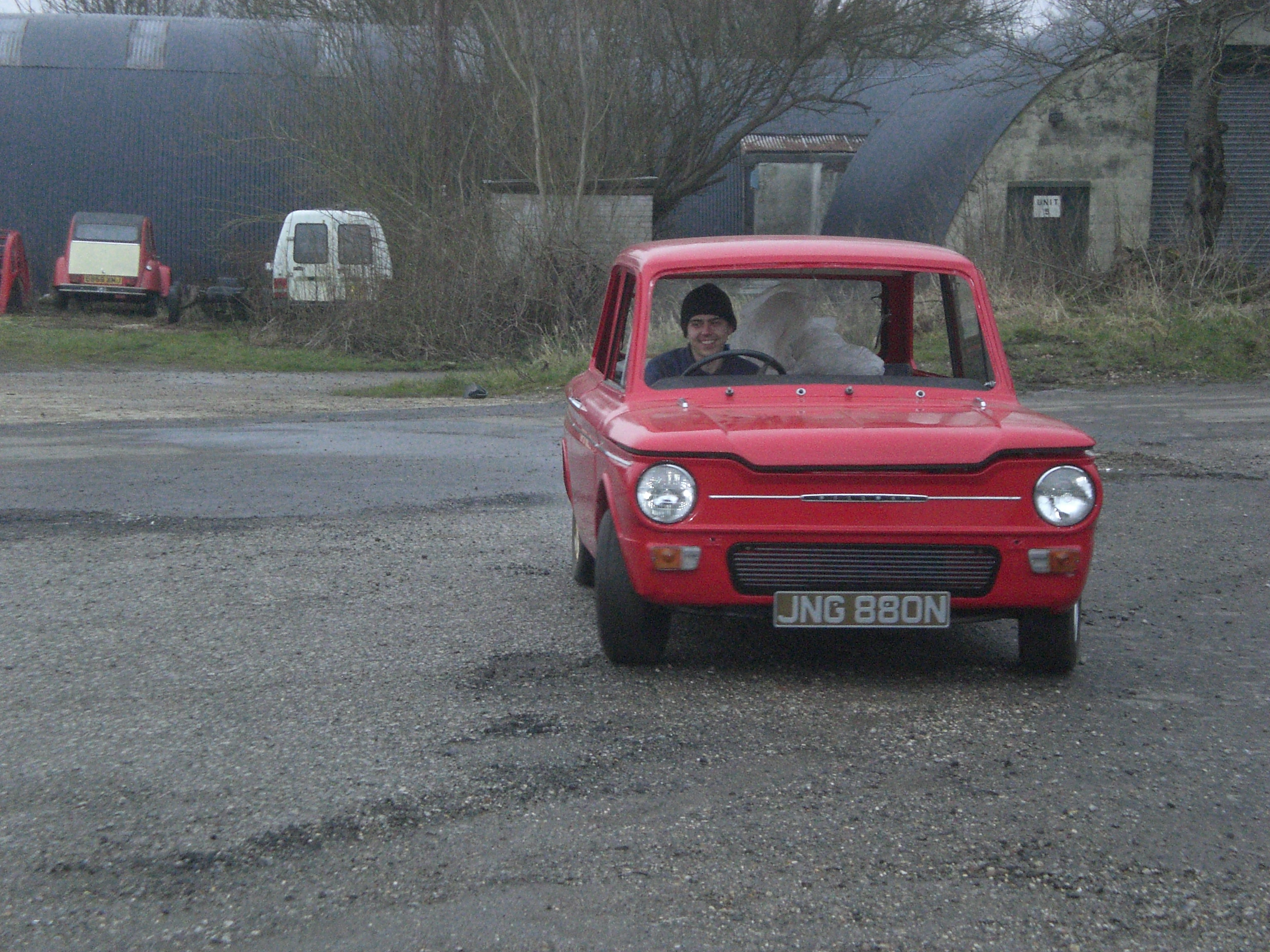

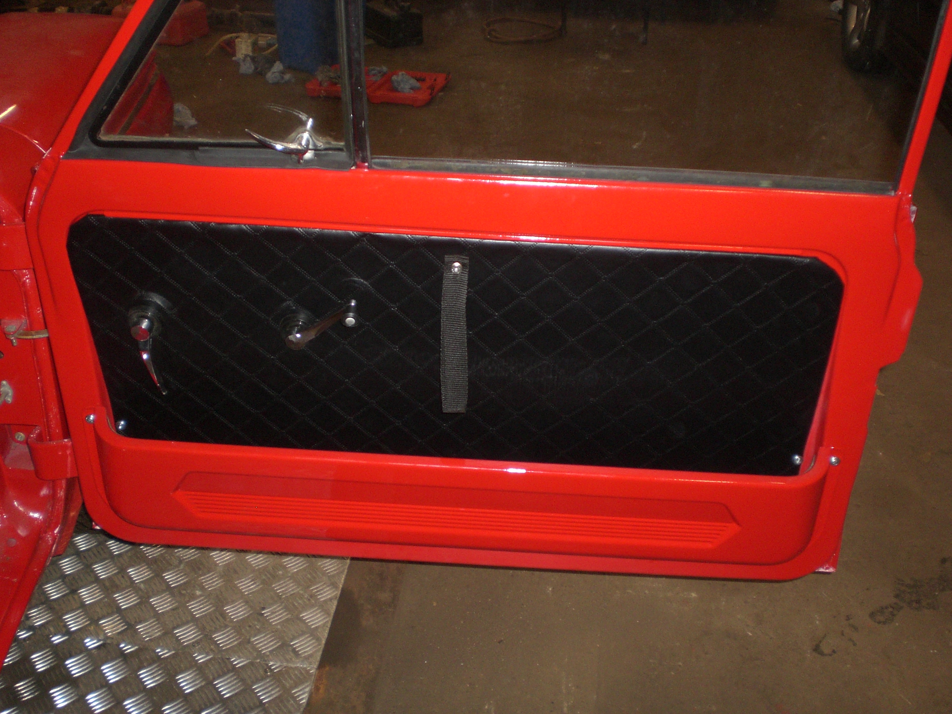

Rob has been busy getting the Imp nearer to completion, he made up some door cards as the old ones were rippled and ripped. 3mm hardboard and some vinyl of suitable pattern plus the added pull strap that they don't have (no idea what you are supposed to use to close the door?) and I don't think it's a bad effort at all from him

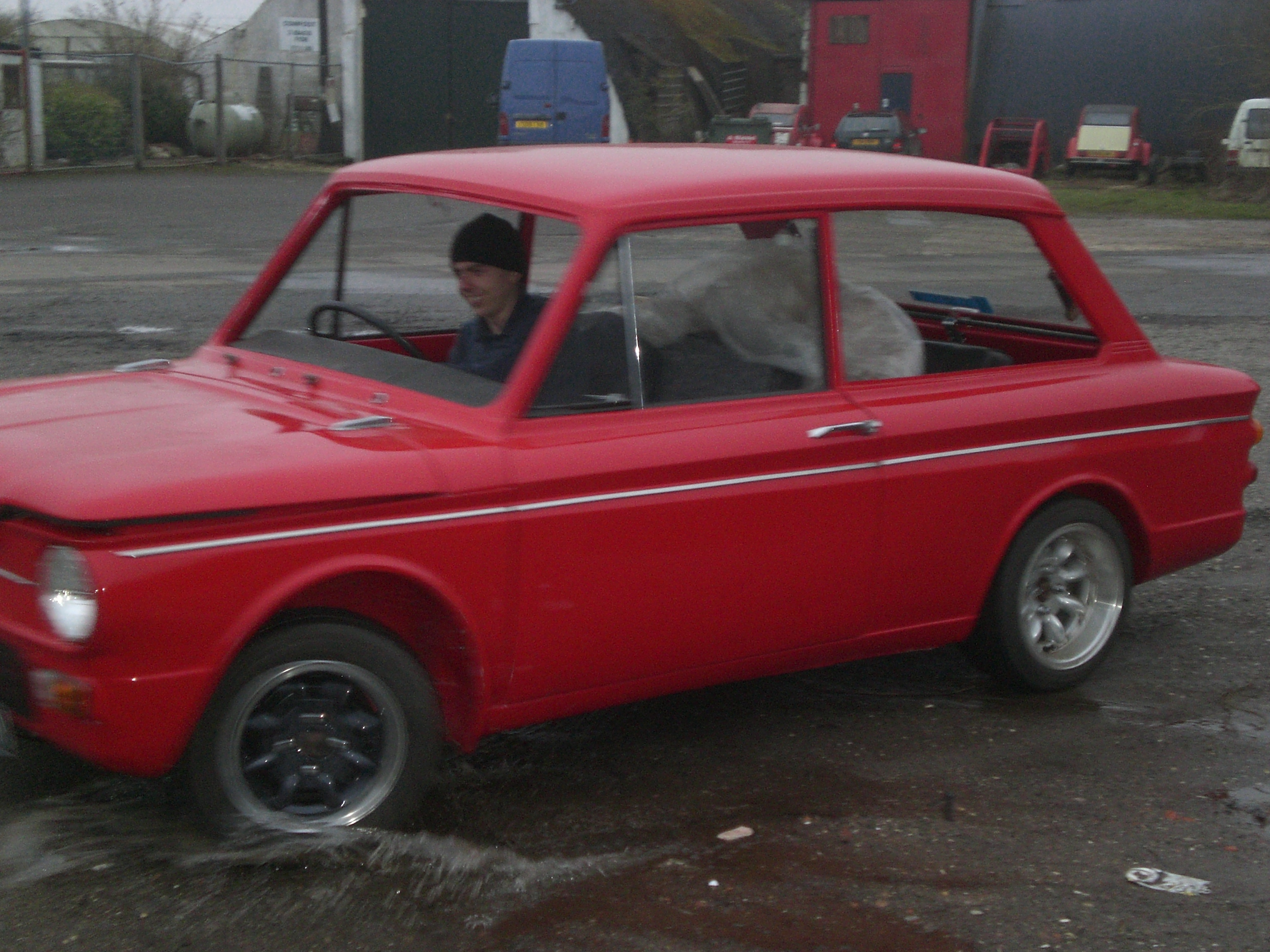

We managed to get the brakes bled at last as the new master cylinder arrived this morning, after some fettling to the new manual shoe adjusters.
Clutch still not quite sorted, had a leak at the flexi which was a pain as it's buried at the back above the engine. Still a little more bleeding to do before it's 100%
Rob was itching to try it though and time was marching on.....
He's waited for a long time for this day so hard to refuse him the joy of a little ride around the yard
A bit more fettling to a few bits before it's fully completed mechanically but nothing too much now. The interior is still in need of a few more days work though, not to mention some glass still to go in!

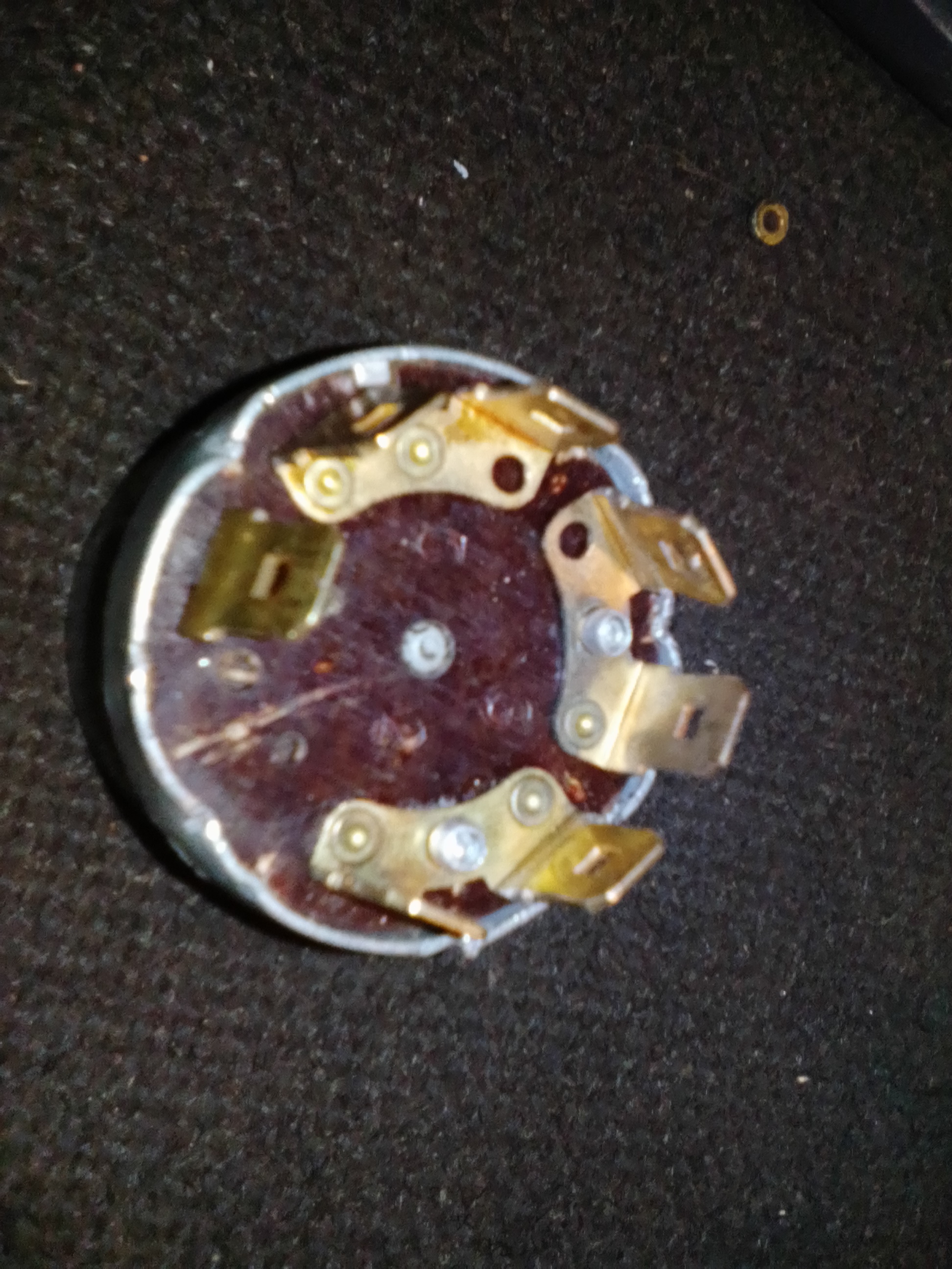

The ignition switch has revealed itself to be faulty now though, intermittent on supplying ignition apart from when cranking!
Hung back tonight and took it apart, lovely old stuff you can actually take apart and repair!
There were two broken contacts inside it which I replaced with pop rivets, similar to what was already in there. Works just fine now. Might do a few hours tomorrow rather than veg out in front of the TV

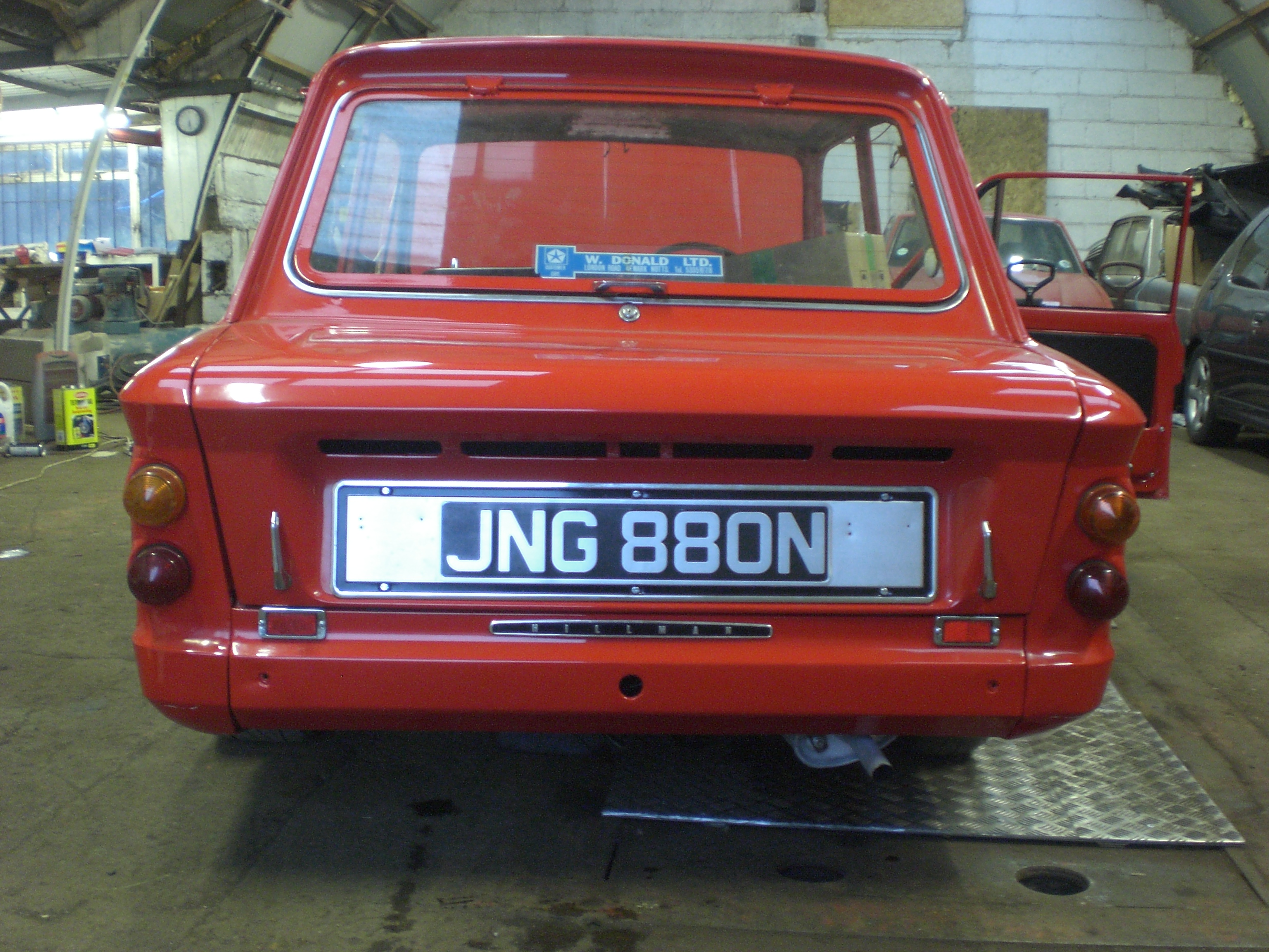

A few more little bits gone on, rear number plate and surround. I quite like it as it breaks up all the red as it doesn't look like stainless bumpers are going back on..
The little side bins in the rear quarters in the rear seats are usually left bare metal, talked Rob into cutting some more fabric like he's done over the wheel arches and rear shelf and glue-ing it to the inner sides, I think it's given it a bit more luxury The panel covering the arch lips over the top edge to pin it back neatly.

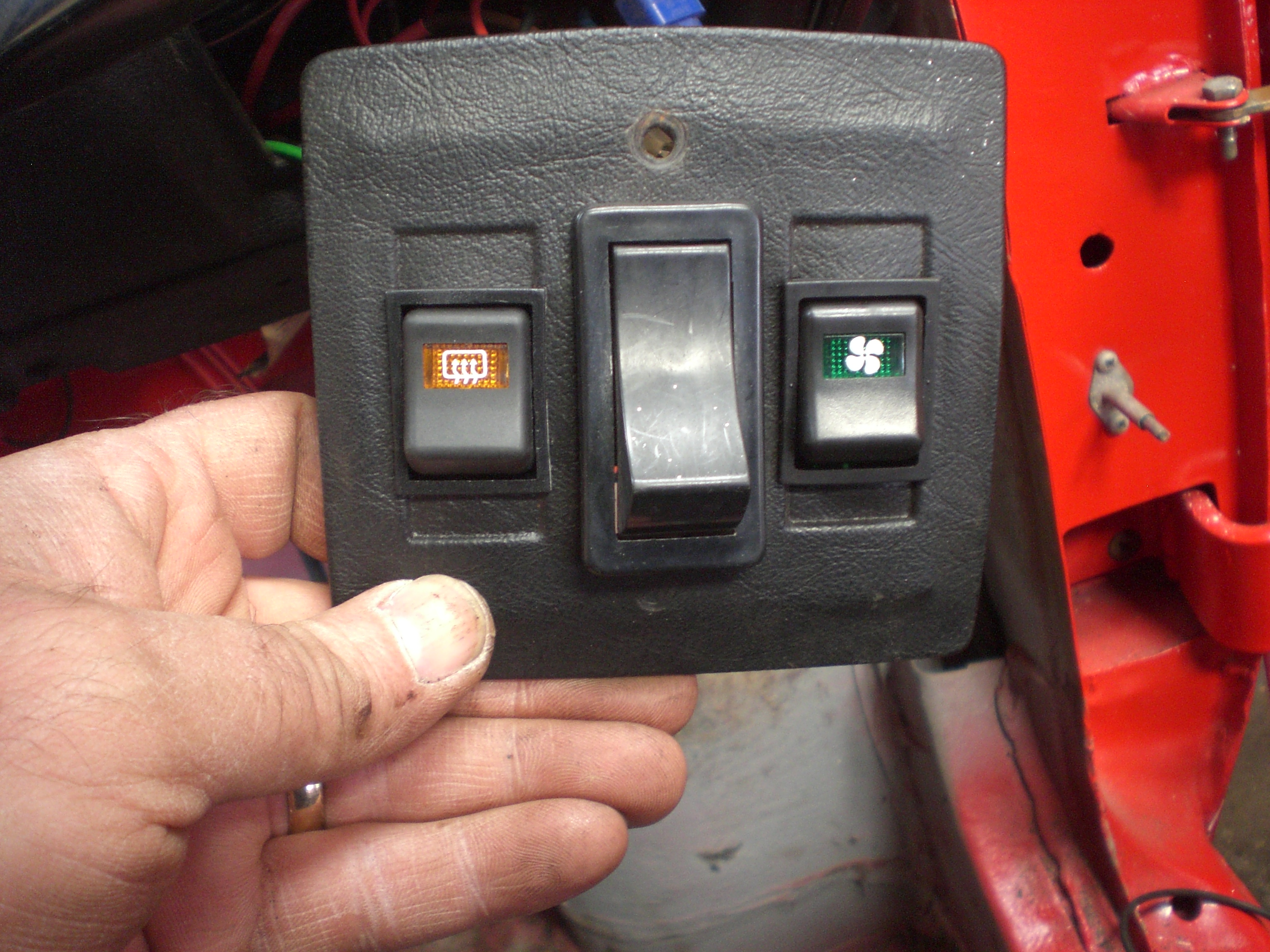

A bit of wiring done, not my favourite task! The car actually left the factory with not a single fuse anywhere, as they all did it seems...We aren't taking any chances so I'm putting in relays and fuses to protect the higher load circuits.

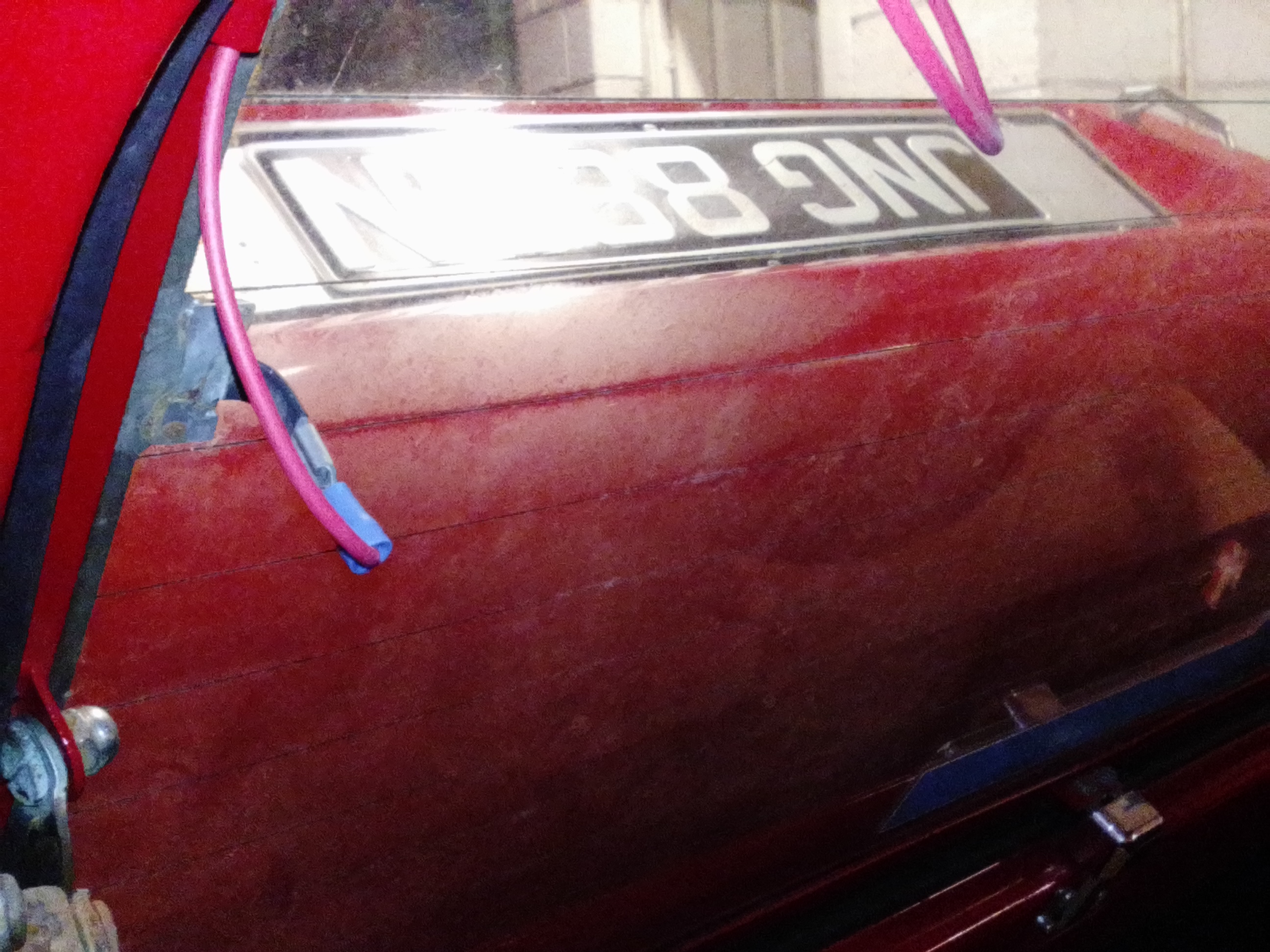

Heated rear window is something the car didn't have....even has a light up switch now Other switch will be for the electric rad fan that we've added as a precaution to supplement the engine driven one.
Elements seem to be working....not that it'll get out in many damp days I hope!

Poor gear lever was trying to rotate with nothing to lean against, poor thing. No wonder it was like stirring porridge!
Pair of fresh bolts fitted and everything back on the car and sweet as a nut
Still a few tasks to do, well loads of tasks really! But he's still hoping to be done in the next month or so....Cadwell for the Wolds Trophy is the aim now in mid May...

Didn't do a great deal this afternoon at the unit, just finished off the wiring alterations that we have done.
I've mentioned before I'm sure that the Imps' are devoid from any fuses at all, not a one!
So the decision was made to add some fuses and utilise a few relays where deemed necessary.
Some tidying to the wiring to do and maybe still a few more bits to add but we are getting there. Most systems are now fuse protected and heavy load stuff have a relay. Hopefully this will prevent any electrical fires!
This plate has two new switches for systems the car has never had, a heated rear window and an electric rad fan.

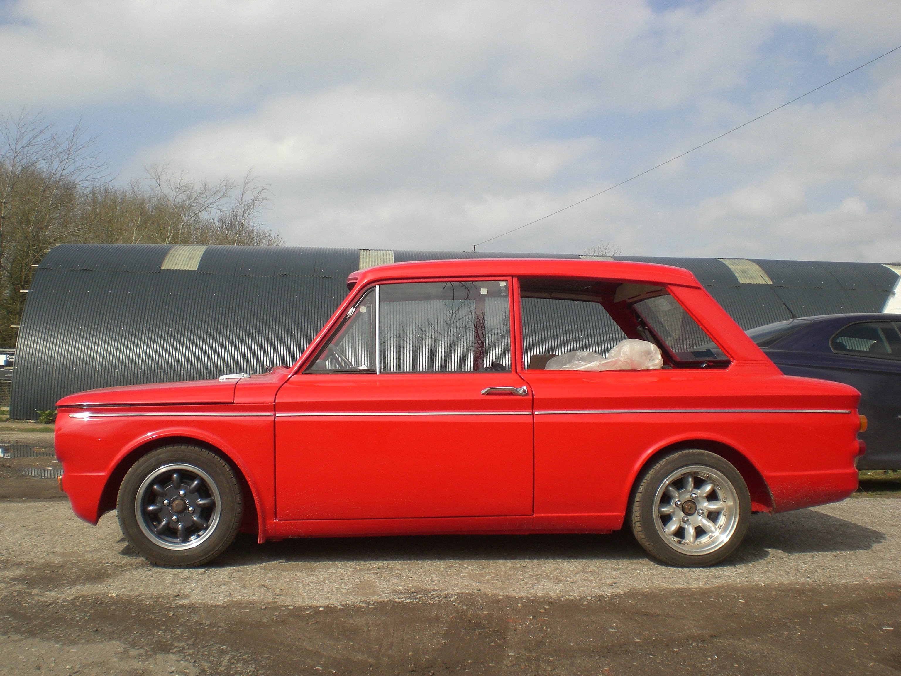

Rob though had been busy in the morning.

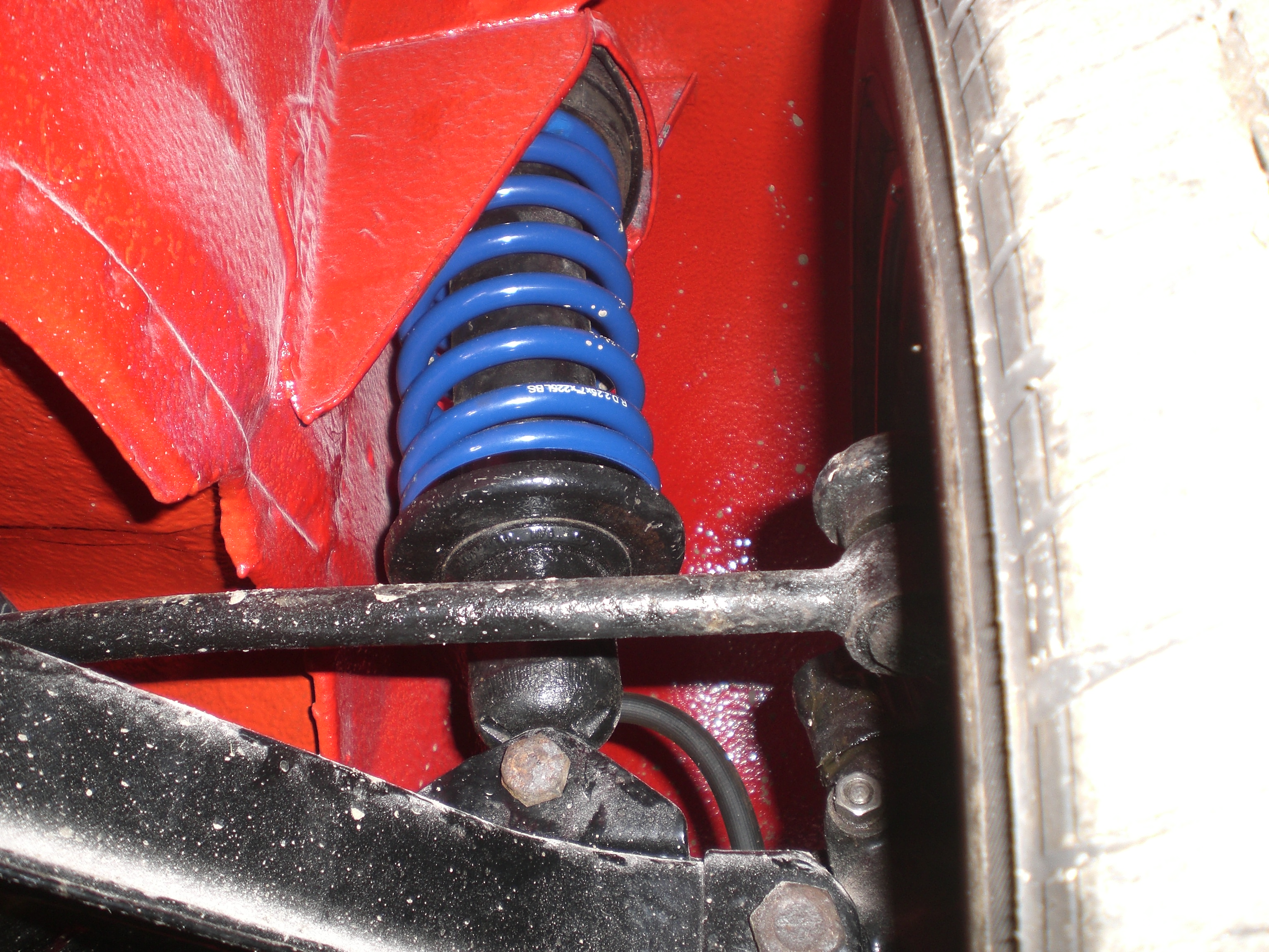

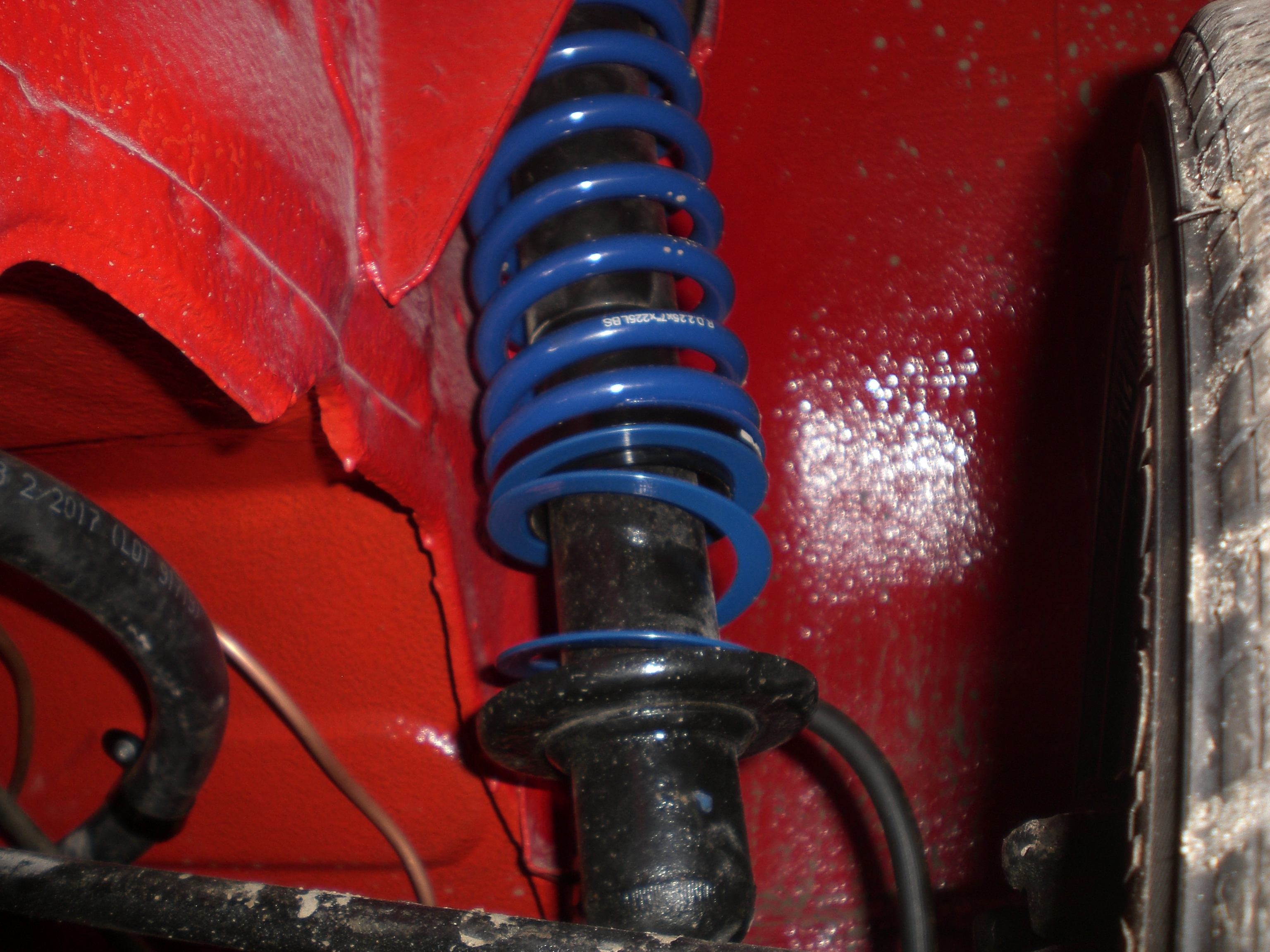

We had previously put some Imp "Monte Carlo" springs on that were said to be uprated and slightly lower, the result though was a very hard spring sat up in the air! Which also fell loose when jacked up!
After much calculations and finding of spring rates we settled on what I hoped would be about right..
The standard springs are 195lb rated (remember, rear engine and the whole car is only about 800kgs so no weight to the front) and the uprated ones were reputedly 250lbs. They were also around 9 1/4" tall, about an inch shorter than standard which allowed them to "fall out" with minimal rebound bump.
My solution (I hoped!) was to buy some 225lb springs 7" long springs so they would settle at the desired ride height. We also got a pair of 4" spring helpers which being just 5lb rate are purely just to keep things located on droop, together with the adapter ring to go between the springs that amounted to approx. 7.5" relaxed length (with helper compressed) and about 11.5" with everything relaxed so things would remain in place.
The results we are both very happy with, perfect stance without being too low and does at least have some compressible movement now!
The front springs in situ on full droop..
And settled on the floor...
Things are getting sorted now, we really aren't that far away from being done now

Imp sits really nice now Kev, great result.
