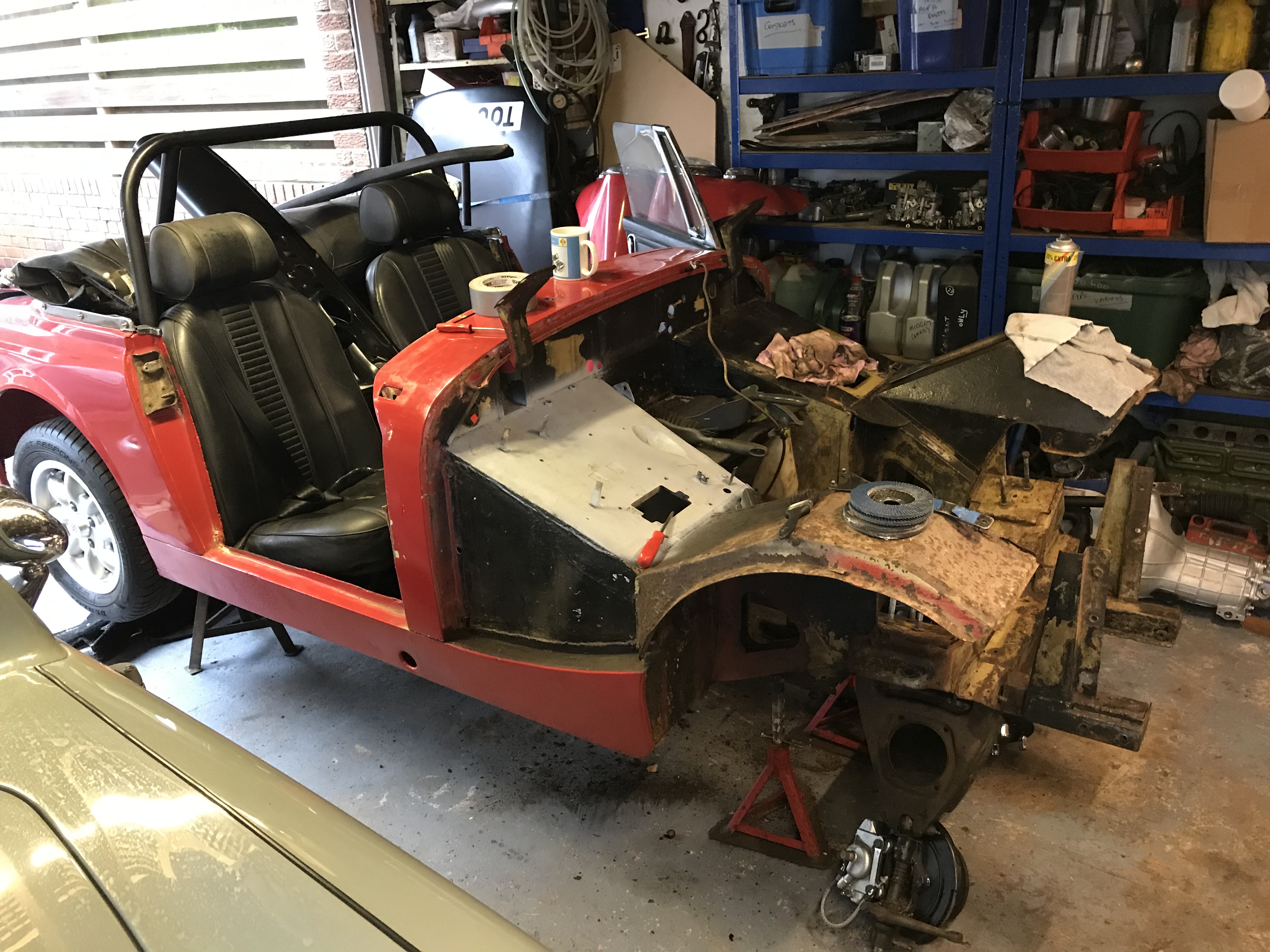

The Project has evolved as they do it’s having complete new floors, inner and outer sills, both foot boxes rebuilt And inner wings. And a pair of New doors
This work isn’t being done because the car was rotten but mainly because the car had been so badly Repaired in the past with seriously bodged repairs welded over rust. I just couldn’t live with that so it’s become a much bigger job but should be really nice when finished . It may even end up being a classic rally car

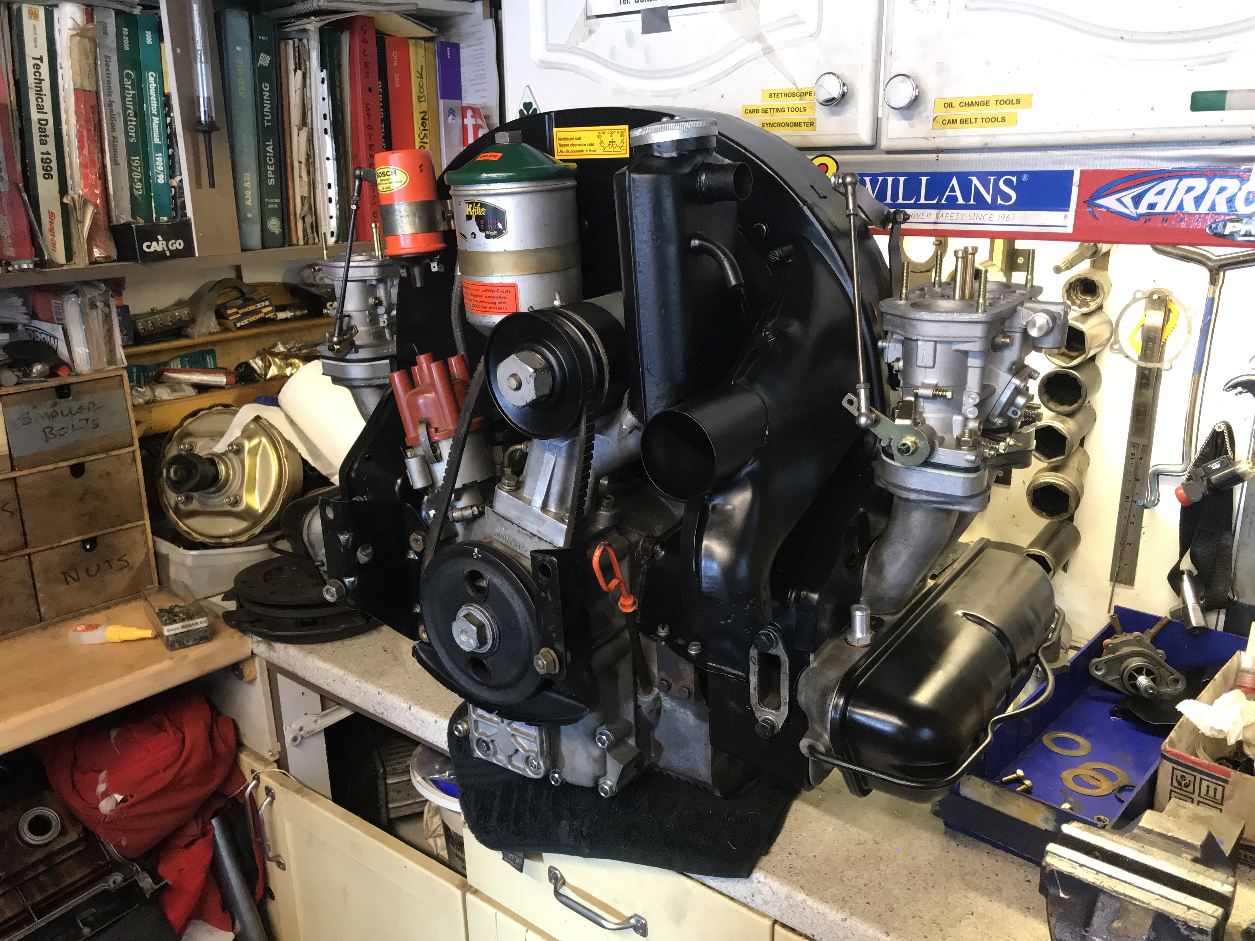

Another project I’m on with is an engine rebuild for a Porsche 912. For those that don’t know a 912 is an early 911 with the 4cyl Beetle derived 356 Engine this car was imported from the states by my friend sight unseen and I have to say it was probably the rustiest Porsche I’ve ever seen. It was far too much for me to tackle at the time so Bob has had the bodywork done by a shop that Specialises in Porsche coachwork. And I’m just doing the engine. I’m hoping to have that finished as soon as this lockdown is over as I need To get all the tinware powder coated. I’ll post pictures later .

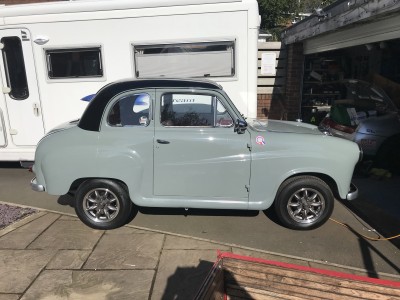

A30.
This is our little A30. It’s been a long haul this but it’s finally getting there. I recently fitted some new rear springs as the old ones had gone very soft.
We got a pair from an A30/35 specialist but they’re crap ! The car now sits much to high and is way to hard for such a light car they’ve got 11 leaves 3 more than the old ones ?? Spoke to them about it and they just don’t want to know. So I’ve decided I’m going to pull a couple of leaves out to get the ride height down a bit. After that I’ve got to rebuild the dynamo as it’s got a noisy bearing in the front cover
We’re hoping to use This a bit more this year.

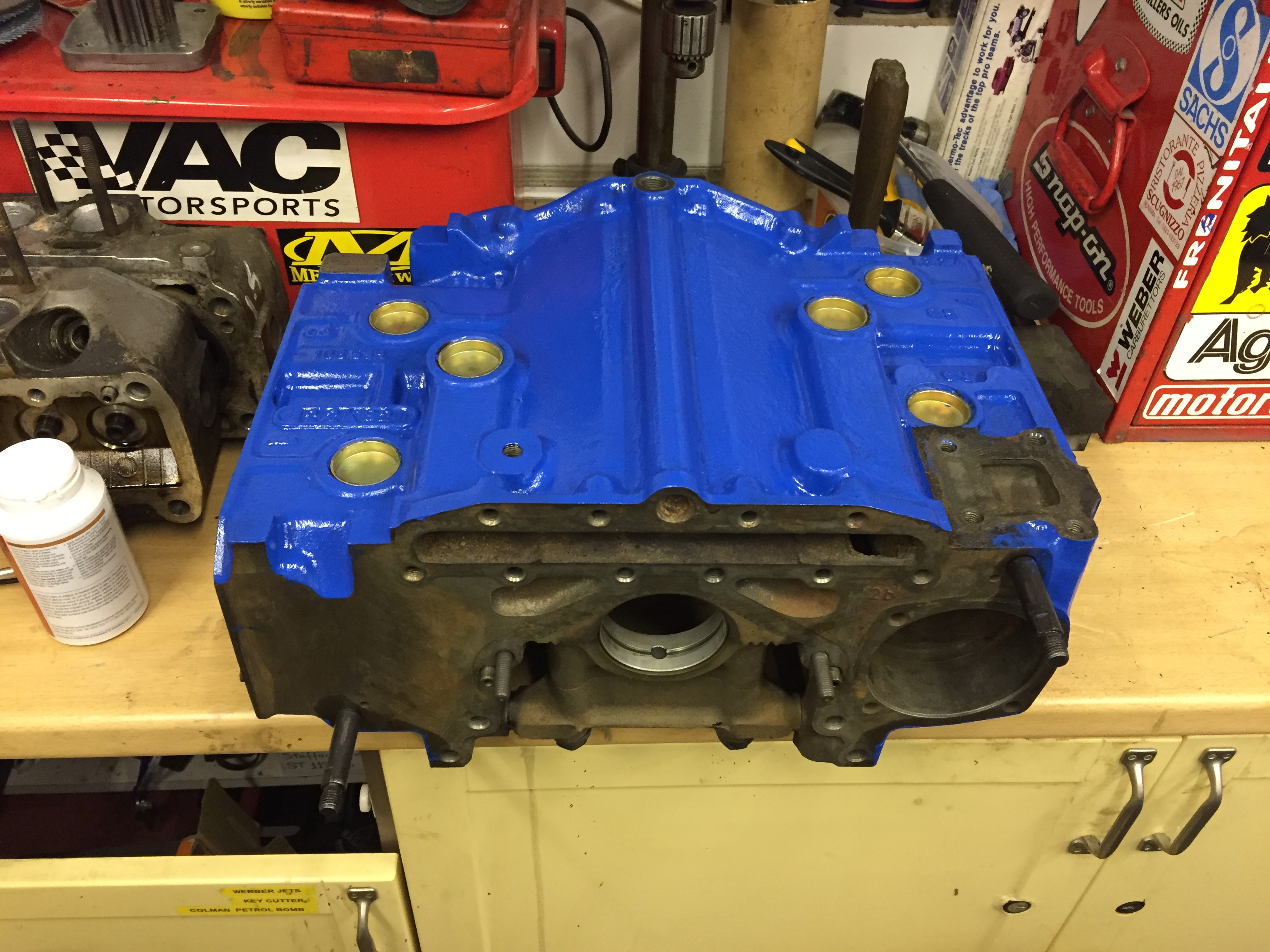

Oh yeah I’m also building a Supercharged 1.5 engine for the Sud .
This is the block This is the blower fitted to a dummy lump to check it’s all there (it is)

No going back now ! Done some work on the Midget . Drivers side floor removed along with the inner and outer sills . The hardest parts so far has been the amount of work it’s taken to remove all the badly done patchwork of previous repairs that Some of which appear to have been Braized on eeek!. You can see in the top photo the outer sill wasn’t even attached in the middle Properly. Also the sills had Been fitted about an inch too low and the Panel gaps made up with Bog !!! For those wondering yes I have braced the shell Across the door apertures prior to sill removal.
This jobs just getting bigger Which is good as I may jump on the sud as it needs a lot less work To get it to the paint stage

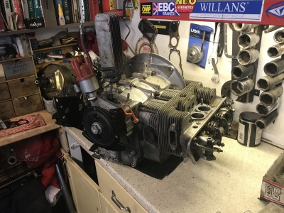

Re: LooLoos projects.
Porsche engine nearly done . Just waiting for all the tins to come back from powder coat

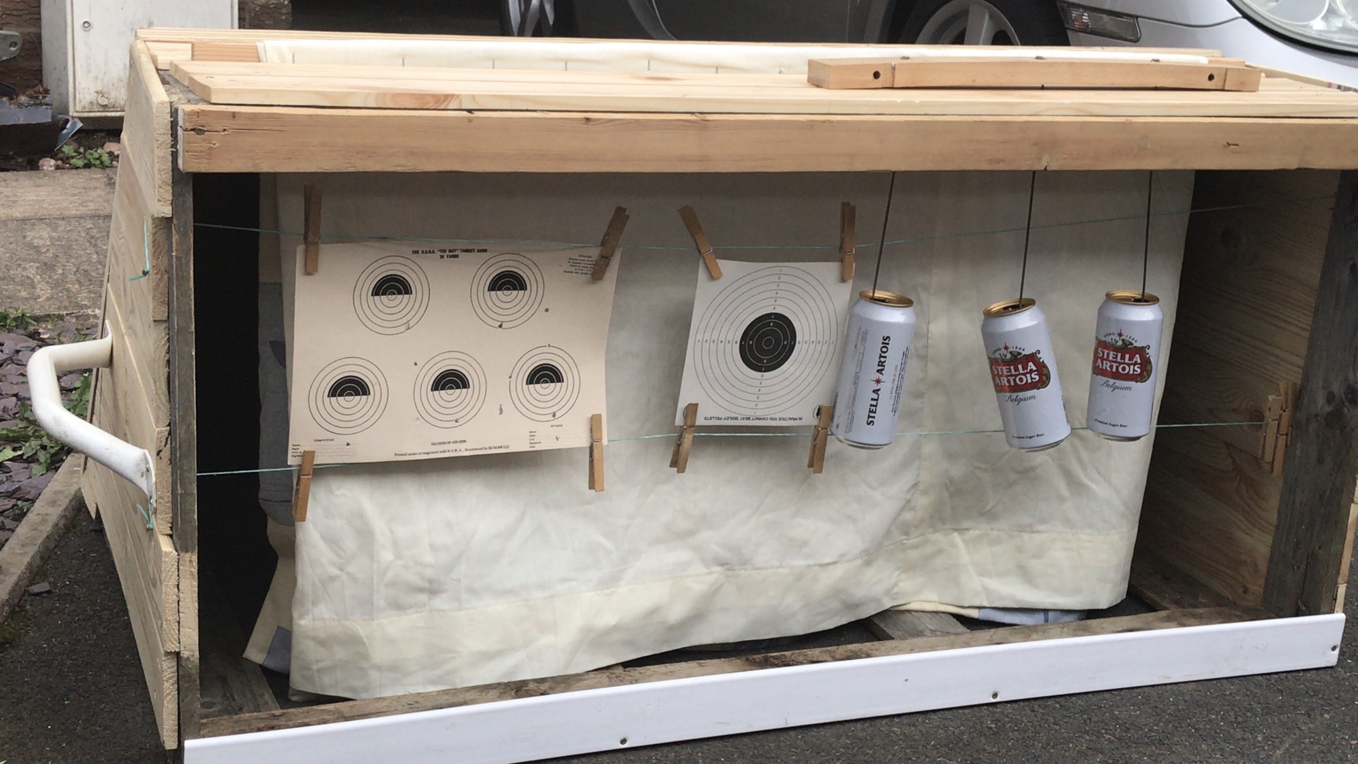

Another Small Lockdown Project.
Homemade Tin Can alley for Air pistol Target practice, Chippendale I ain’t but not bad as it’s All made from spare scraps of wood and an old Pallet

- Posts: 1755
It certainly is Dave. This is a Porsche 912 engine I’ve been rebuilding for a guy in Essex. It’s basically a 356 engine which was Loosely based on the VW beetle unit slotted In an early 911 shell
He bought The car in from the states last year. The engine was in a right state as I stripped it down I was finding all sorts of dead American insects and Foliage debris
It had basically been thrown together to resemble an engine so it looked complete but it was a real mess. And certainly wouldn’t have run if he’d tried to start it .
- Posts: 1755
Just finished rebuilding a Fresh engine for the Coupider aswell .
