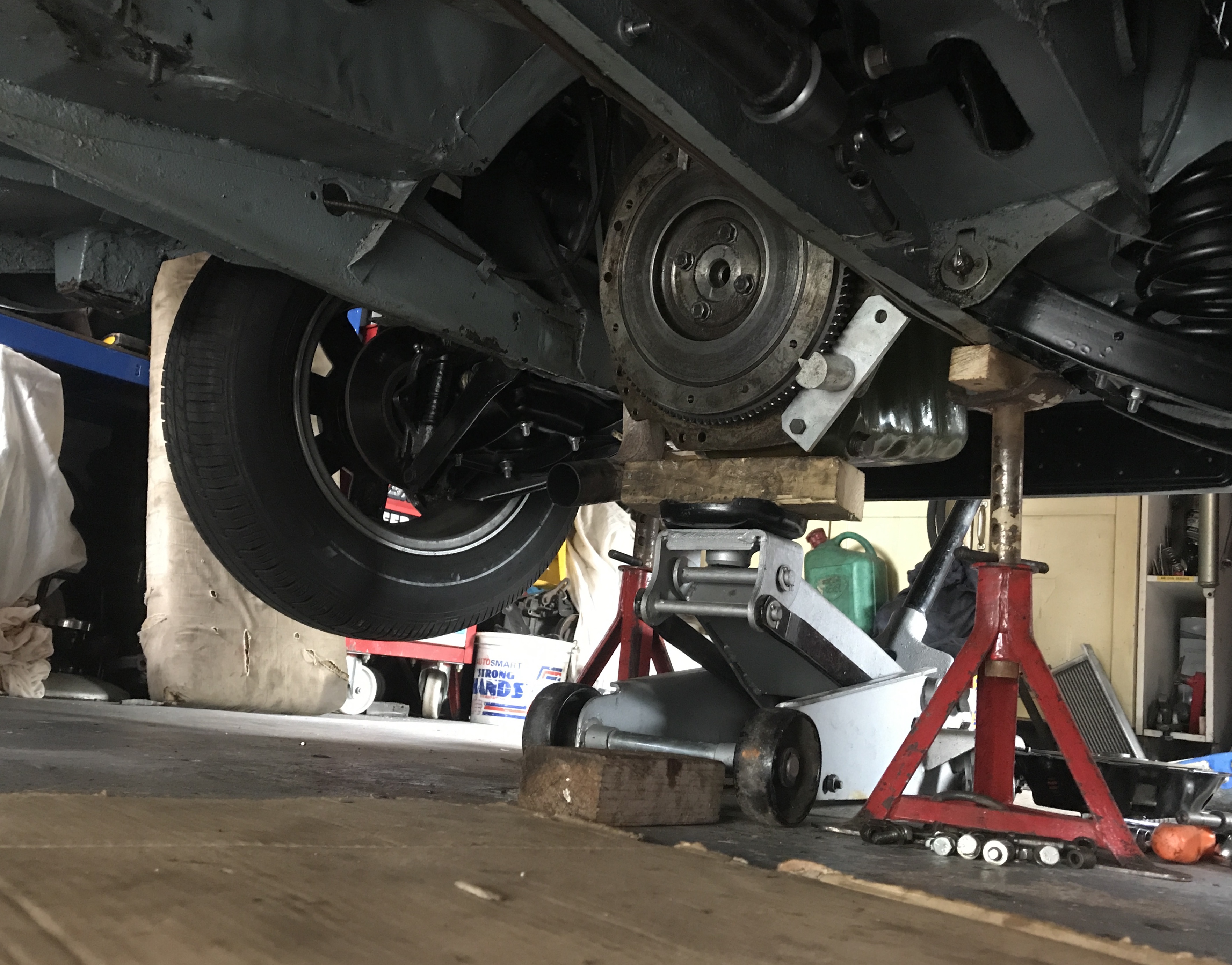

So After another generally successful run of 50+ miles the Austin Finally gets A new gearbox and (Spigot bearing)
The old box had always been a bit noisy and the sychnromesh were Very tired. We’d got hold of a gold seal unit for the midget But as the A30 now uses the same 1275 midget box we’re putting it in Jumbo instead. (Well the Midge won’t need it for 2 yrs) whilst it’s out I’m replacing the spigot bush in the crank as it felt a little worn

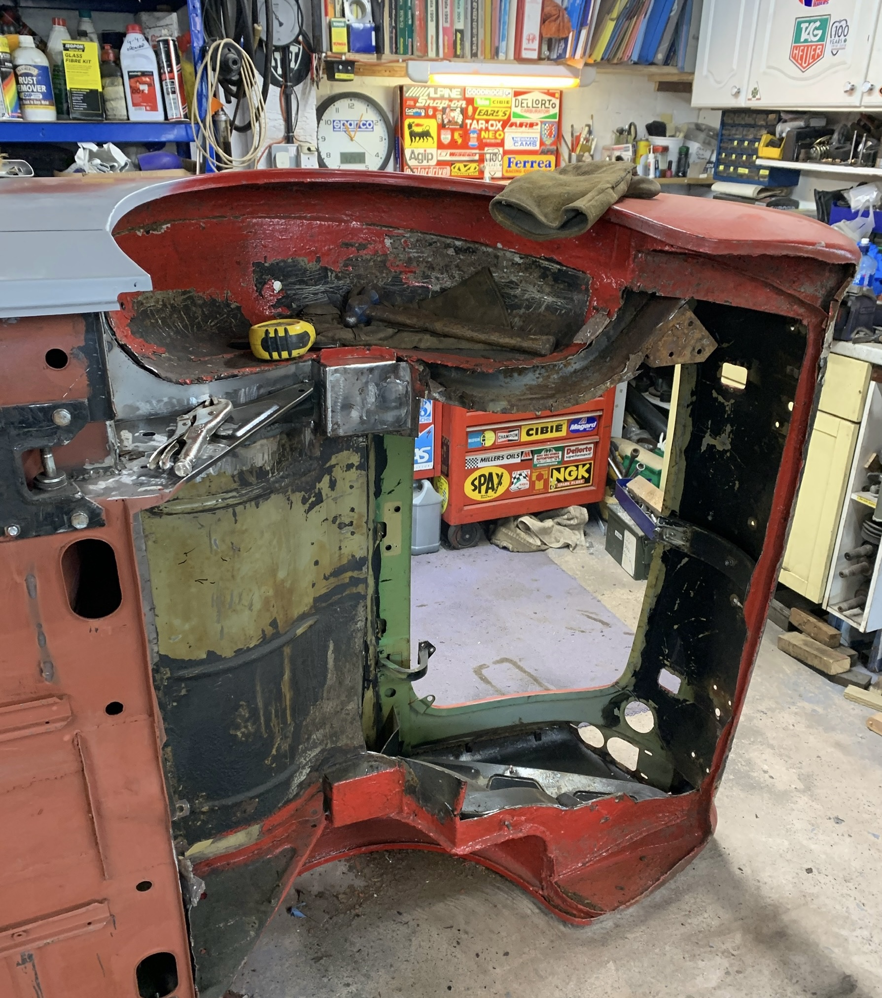

Remember me saying about the “oh no worries it’s a good one !!” gold seal box we bought for the Midget. Well it was just as bad as the one we took out !!! So as I’ve got 3 1275 boxes and a 1098 minor box I decided to take care. Of it myself and I’ve just finished rebuilding a 1275 box . I needed to fit a new 1st motion shaft and replace all bearings and seals along with an upgraded front cover with a lip seal to hopefully stop the drip. I’ve now refitted that box today and just waiting for some bits for the Carbs. Then hopefully the Austin will be good for a bit of summer use.
Ive also been doing a bit in the midget with new panels now being welded in so it looks less crappy
(But it’s still a midget)

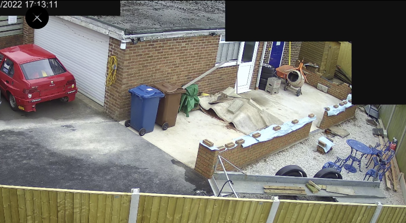

I know it’s not a car but it’s a car related project !! Big extension to the “Empire of Dirt” underway .
Hopefully the extra room will help create more actual room to work .Alfasud Ti 1984

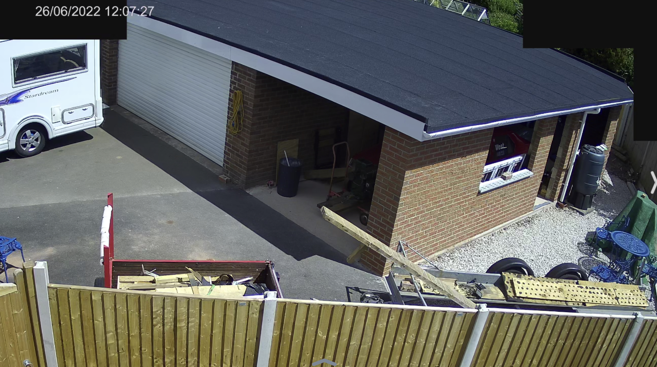

New roof finished. Next job is the side Windows and pedestrian door. Currently waiting for prices for a new electric roller on the new bit. Once it s all secure the old wall (now an internal) can come down to create one big open plan space.

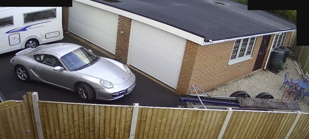

Garage extension is all done now. With new door fitted. I’ve taken the wall down between the old and new areas so I’ve just got one big area. I need to have a big move round this week so I can see just how many I can get in I’m hoping for 7 but the Porsche and spiders are quite big cars so may only manage 6. The main aim is to get the road spider inside over winter. Next job is to have the whole place rewired. It’s a nightmare !!!

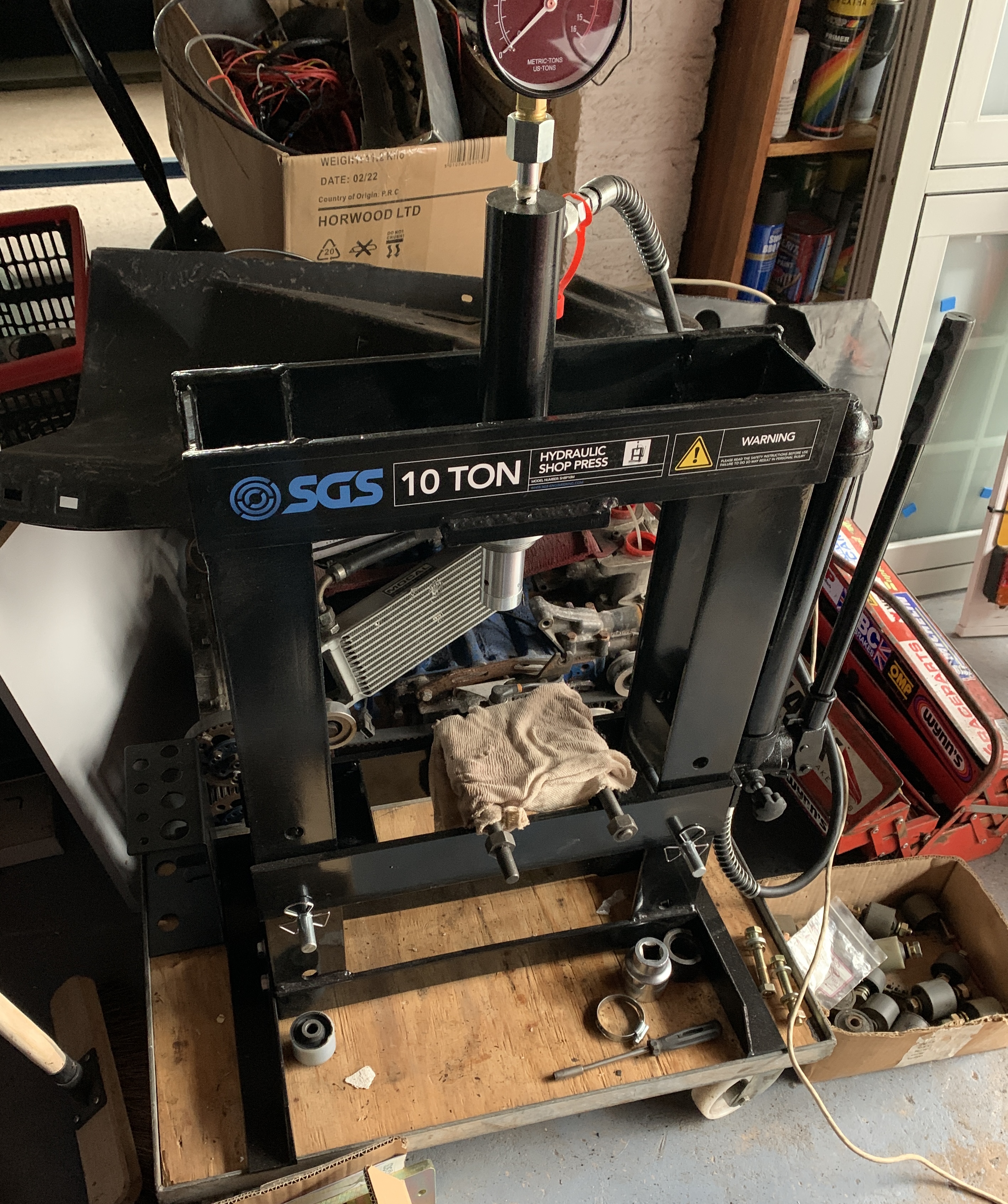

It’s just a little ten tonner for things like bushes and bearingsAlfasud Ti 1984
Re: LooLoos projects.
Neat press there, easy enough to stash out of the way rather than a bulky free standing one, handy thing to have
- Posts: 1737
Hi Kev. Yeah it’s listed as a bench top press. It makes bush installation a doddle. Some bushes can still be a little fiddly it all depends how much oversized the bushes are. Sometimes it helps to turn a small lead on the bush to get it started. I have the proper press tool for the sud top engine mount bush so that went in a piece of cake. I’m looking to make a press tool for the suds front suspension arm bushes.
Buying this kit may look extravagant but logic is that if I keep it in decent condition i can sell it all in a couple of years
