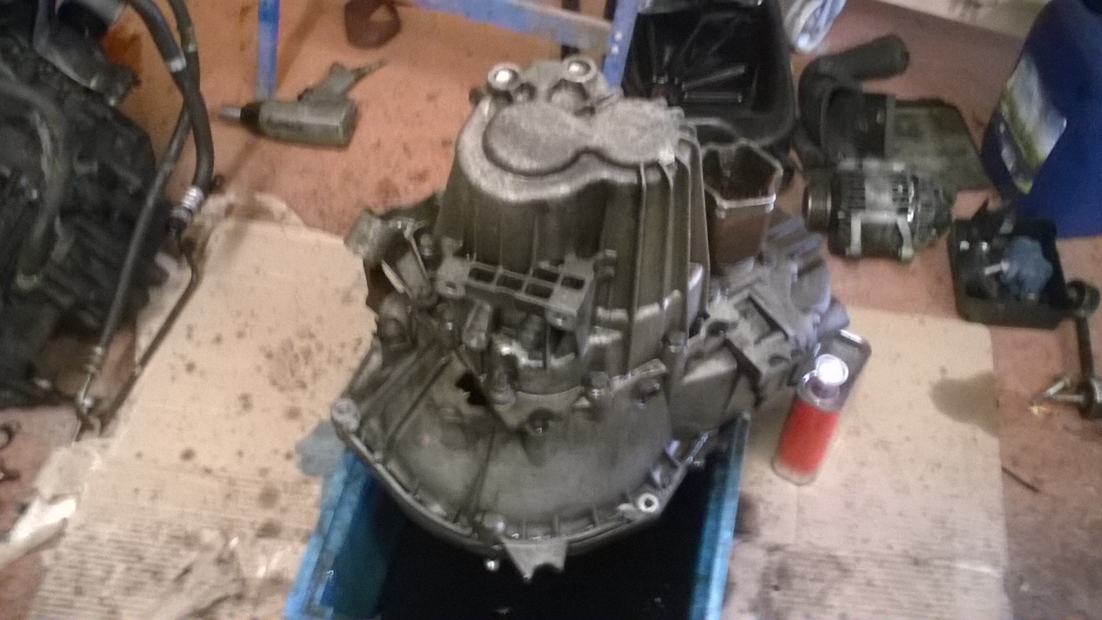

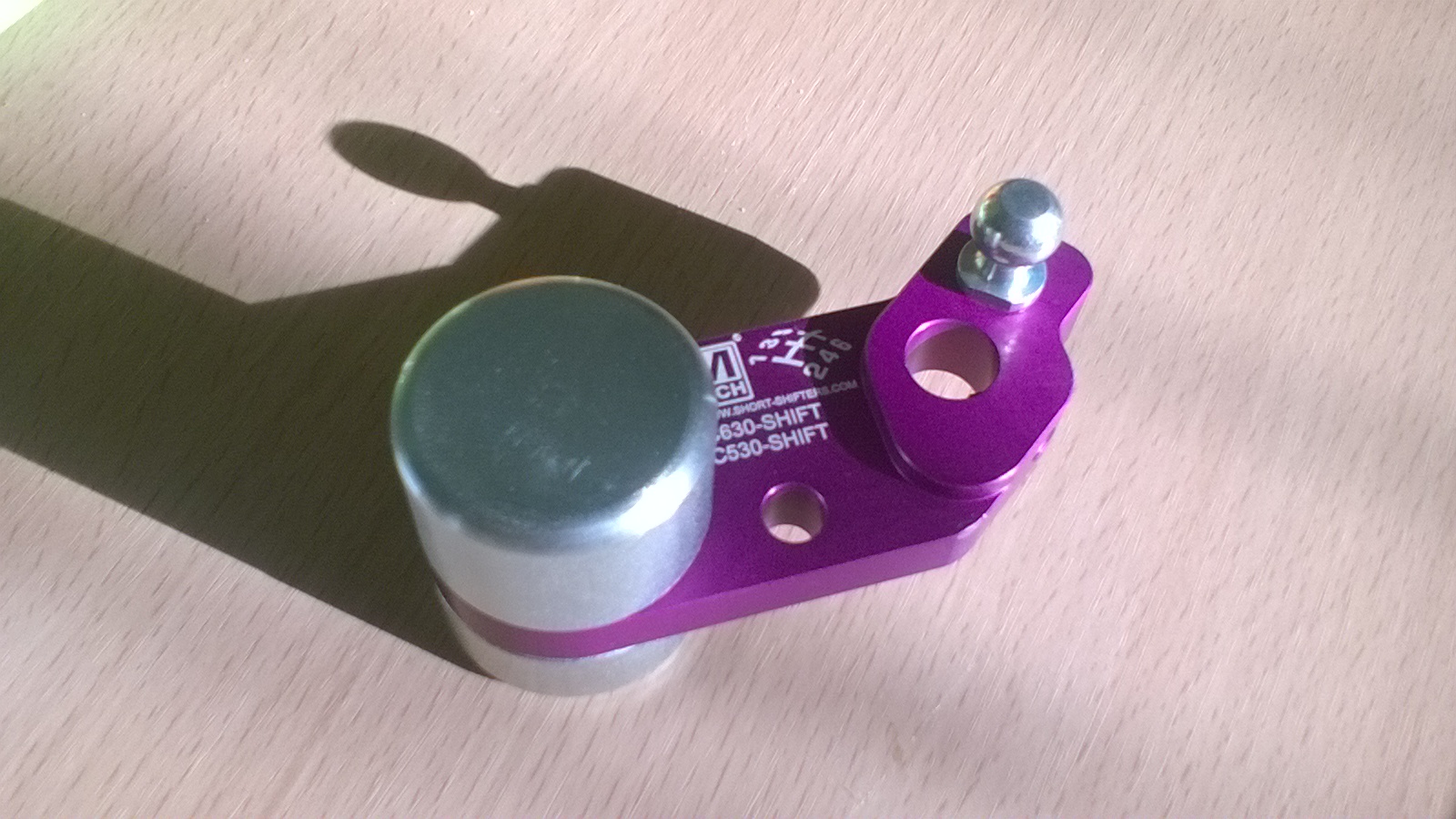

The snapped glow plugs and the mtech quickshift that I got in the post Tuesday
Plus the cleaned gearbox

Fitted the mtech quickshift
