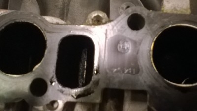

My eldests, Josh, 159 2.4 20v JTD has had some issues, all of them down to the emission control devices, and his inlet manifold was disgusting, largely down to the EGR of course :x
it might not look too bad, and i've seen worse, but just what i scraped out came up to 500ml in a measuring jug i collected it in, and then i used mr muscle oven cleaner to remove 90% of the rest.

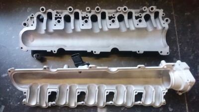

finally, i media blasted the rest off and smooth sanded the internal surfaces, and its now better than new.
i was tempted to weld up the swirl flap and egr holes and eliminate them altoghter, but the jurys still out on that direction for the time being as the car is soon for sale.

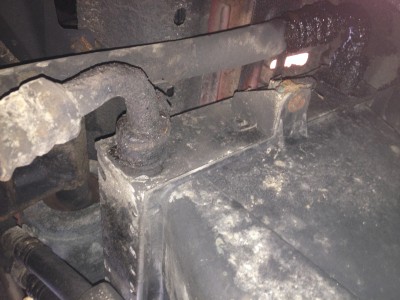

I wish getting the GT inlet off was as easy as the Freeloader, then I would love to get it looking at good as that manifold Shrew. I have cleaned the GT EGR and the sensor mounted on the inlet which was pretty clagged, just cleaning that improved fuel consumption a few mpg.
However, my next job on the GT is replacing the Oil cooler as I spotted some drips and looking underneath showed what looks like a corrosion induced hole somewhere. I have ordered the AutoLusso replacement kit - at £280, about half the price of genuine parts - so that will be my job for Easter weekend!

these cars are now at an age where the steel oil cooler components are old enough to corrode through, the prospect of a major leak would be disastrous!
