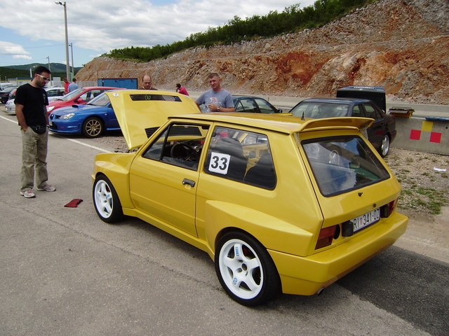

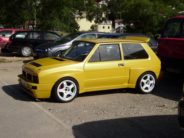

Here Kev, what do you think of this?
Looks a cracking job.
Apparently it is running the full 'Grale running gear
Re: Kev's workshop projects
That looks fantastic!
Proportions are really nice, if indeed it has the 'grale running gear then it'd be monstrous fun
Much, much better than that new rendition "futurista" that's being banded about for about £270k build cost, plus your donor 16V integrale to create a 3 door car....which looks really poorly thought out.
A 3 door car needs the door to be longer than the remaining rear quarter to look even remotely in proportion, this doesn't. Apparently they lengthened the wheelbase by 20mm....guess that's just moving the hubs back and shaping the arches, nothing to do with mounting points. Like it needs to look longer in the rear quarters!
They do some bespoke suspension upgrades and engine mods, but I'd rather do those upgrades to a standard shell and leave the doors available to use thank you very much, and save about £1/4M into the bargain!

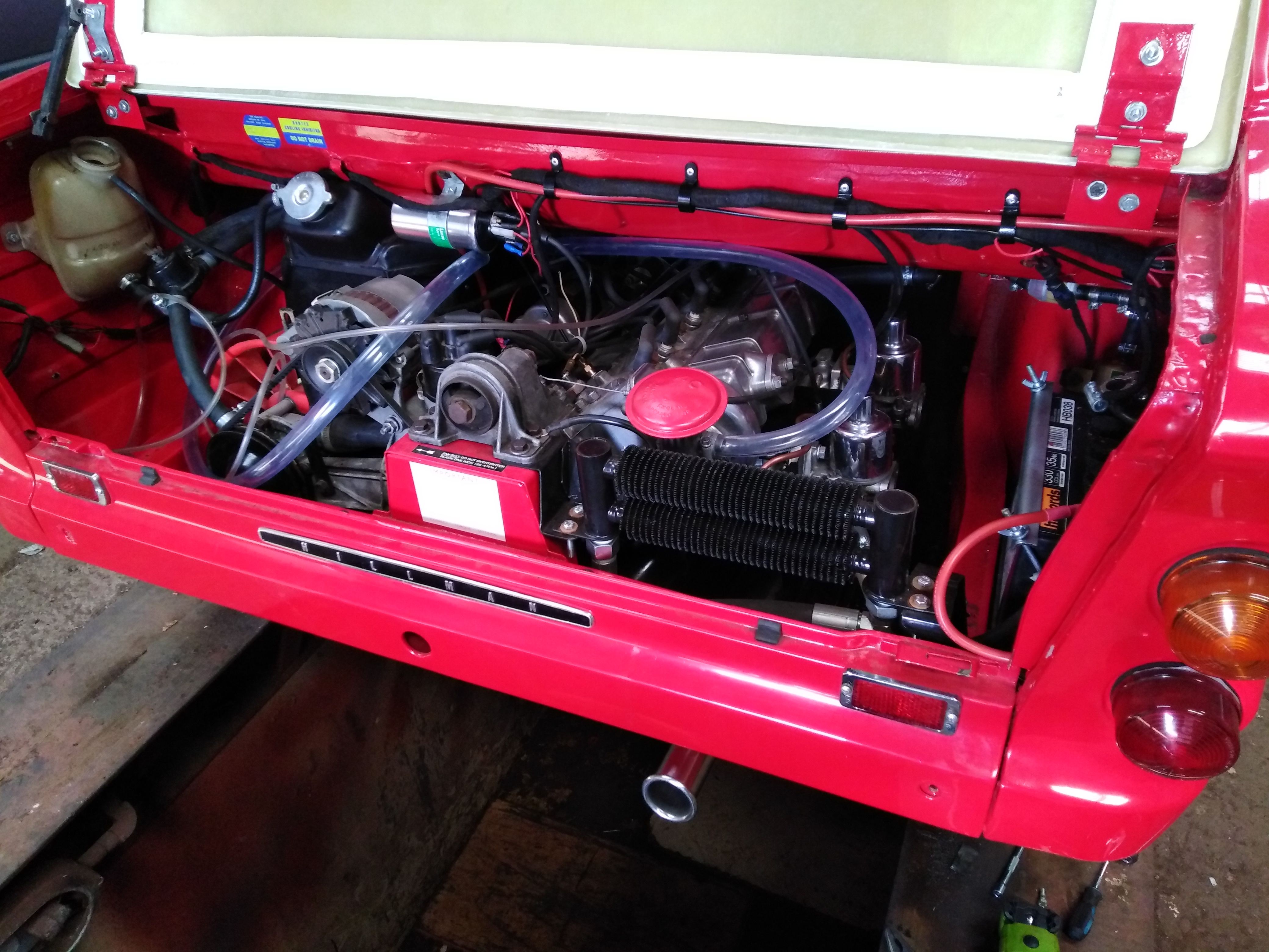

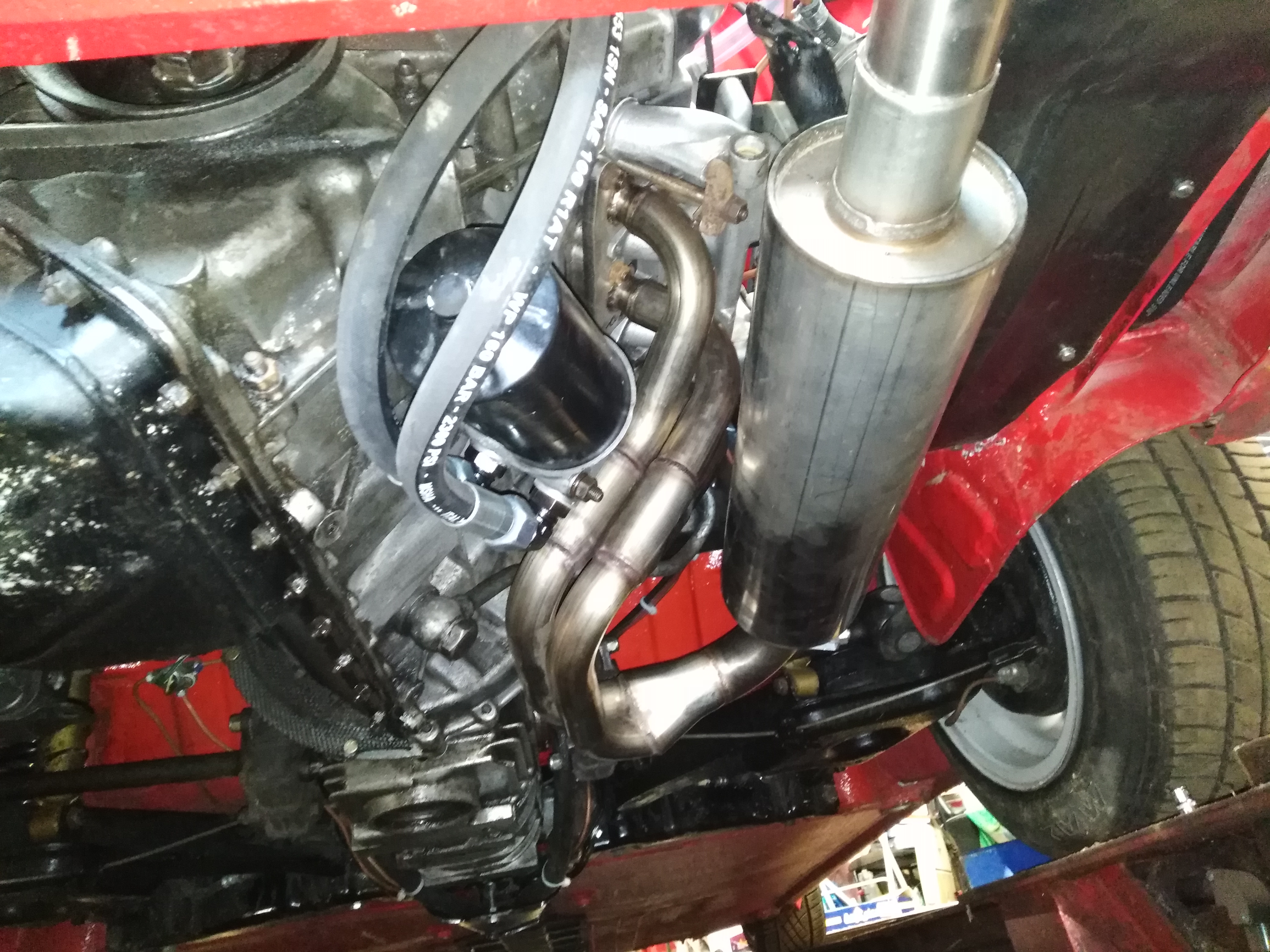

Rob has been pressing on with the Imp, he's adapted an inlet manifold that was for Stromberg carbs to use twin SU's.
He's made up all the linkages and heat shields as he went along, made a decent job of it. Still got the K&N filters to go on.
He's now got the stainless tubular exhaust on with a nice rolled tip.
Oil cooler on now so with the polished bits and wiring tidied up over the Winter it's looking a lot better in the engine bay.

Pass on my credit Kev, that is looking lovely.
Nice pipework and oil cooler looks fab. Nice touch with the manifold and polished SU's.
Is that also another boot lid?
Yes, he's been on at me all Winter to cut some louvres in the boot lid mate, not something I've attempted before so wasn't that keen.
So he ordered a fibre glass one with all the cooling slots in it!
Just needs a bit of fettling for latches etc then of course painting...

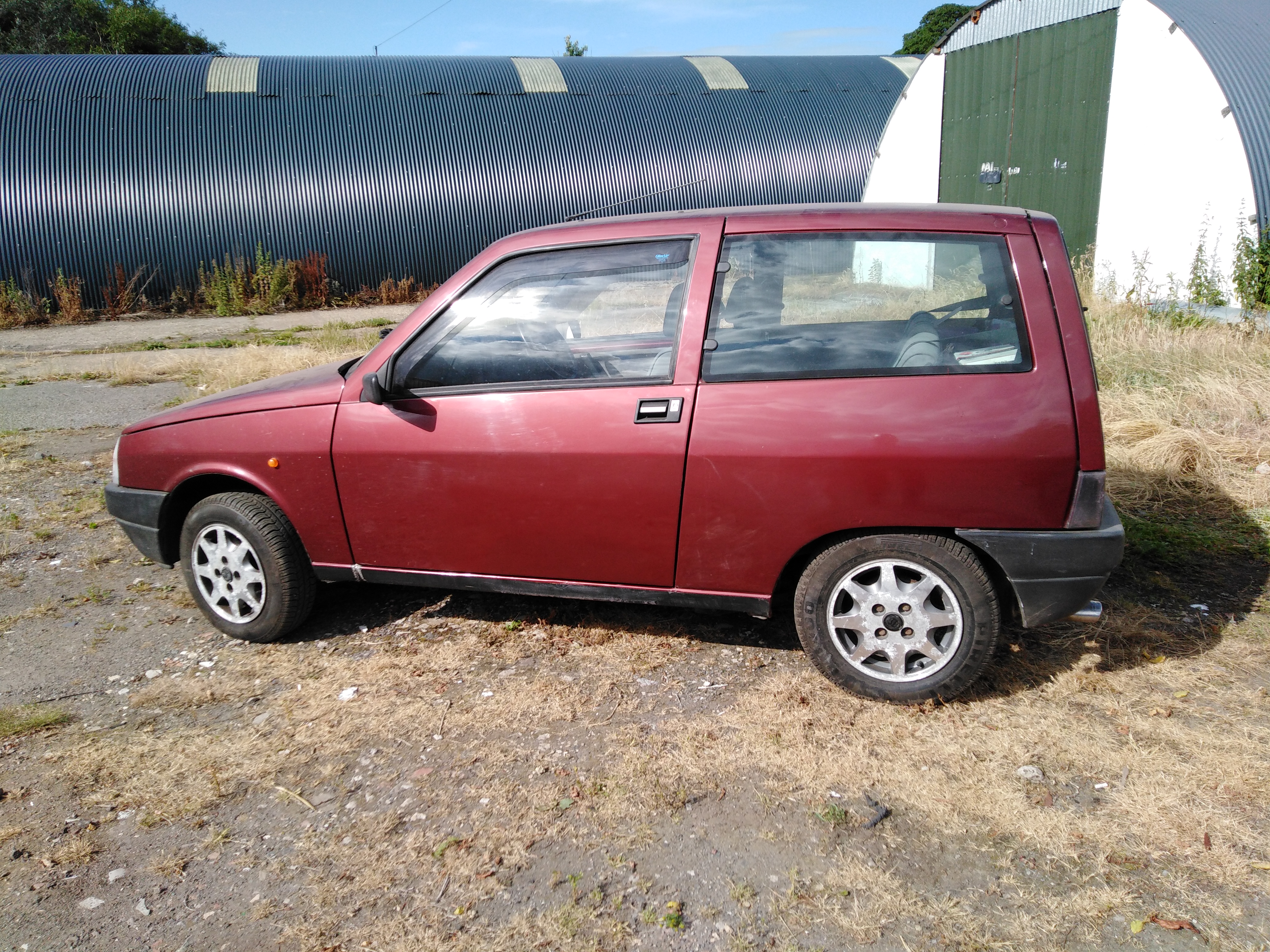

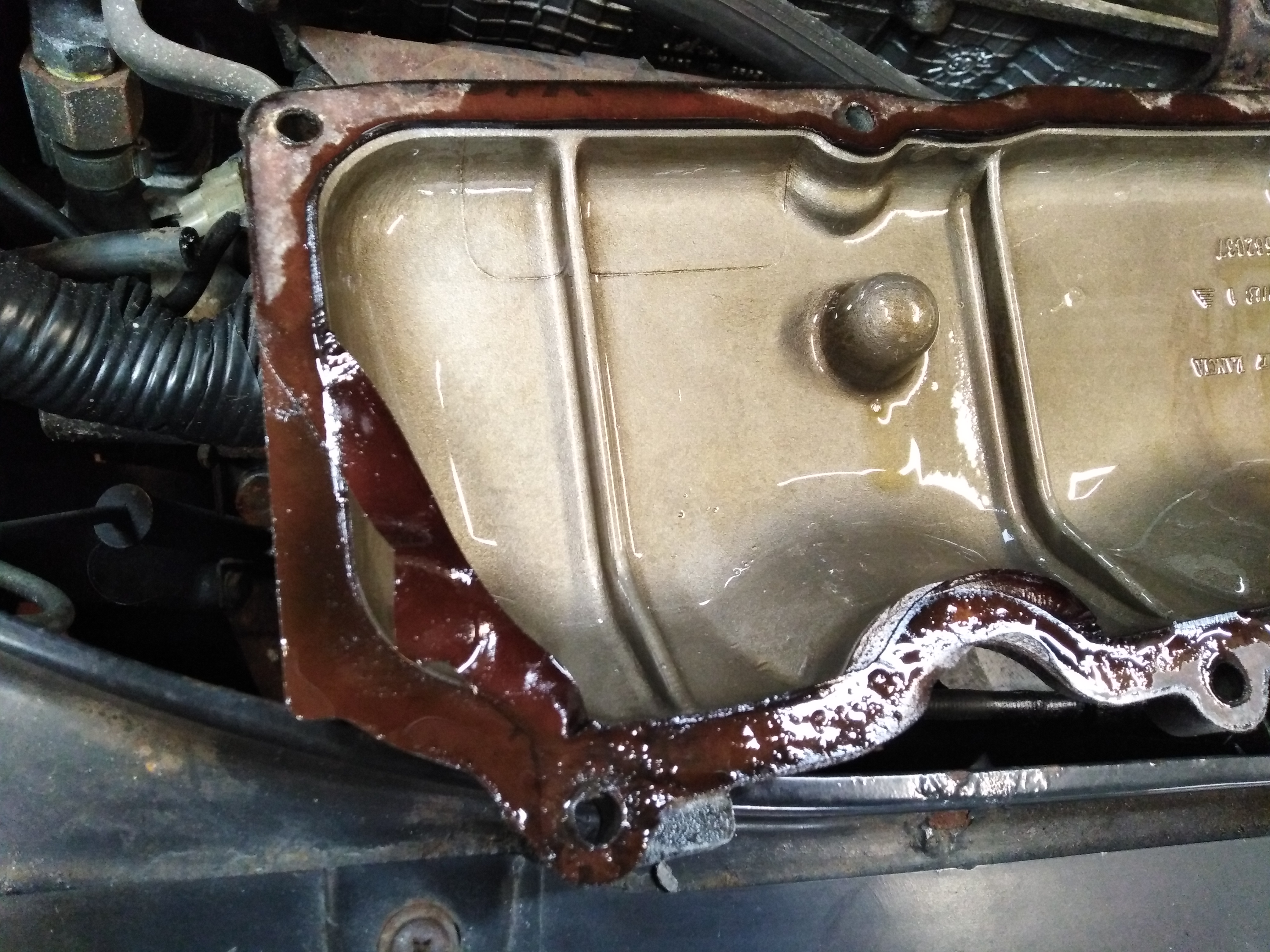

Actually managed to have a look at the Y10 this afternoon.
It's had a fair old oil leak since I got it but I've not used it so no big deal, after a couple of minutes running the oil burns on the exhaust.
Was clearly coming from high up on the engine as the head and block were being washed clean, had my fingers crossed it wasn't the camshaft seal and just the cam cover gasket.
Also hoped it wasn't the steel sump as these can get rotten given the age, although being soaked in oil has helped!
On taking the cambelt cover off though the seal looked OK, no oil on the inside of the pulley.
Camshaft cover gasket removed and the culprit was obvious!
Gasket looked like it was a multi layer one with one layer being well out of line, no idea how long it'd been like that but I'd guess a while.
Just need to pressure wash it all down now and hope that it was a simple fix..
Got a cambelt to change on it, plus a very small bit of welding on the floor to sill then it will too be ready for an MoT...soon have a choice of Lancia to use
