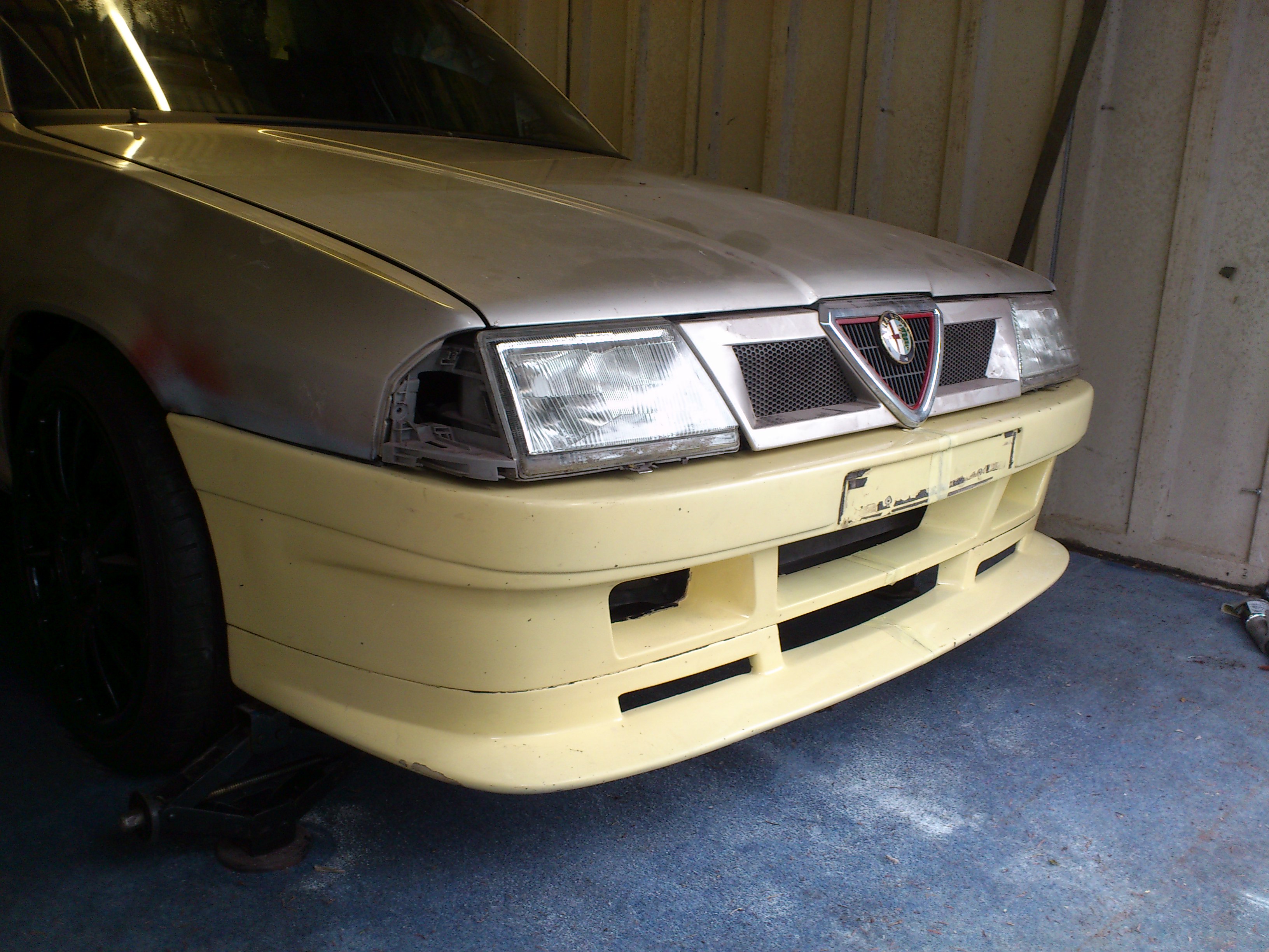

Supercharged16v wrote:I need that front spliter for my 33 !!
that is a stock s3 bumper, with the very bottom of a 75 veloce bumper attached.
nice idea, very nice!
he's copied my plan for the air intake placement so i may plagurise his splitter! ha ha! :mrgreen:

Agree the bumper does look great, this car was built two years ago I think it said in the thread. So it's about the time you where talking about the bumper mod . But I'm not giving you the intake as I've had mine there over ten years :lol:

JB, i didn't realise your intake was through the inner wing into the wheel well void?
i'm not the first afterall! doh!
as for the bumper Chris, it would be wasted on you mate, you'd mount it on the roof of a land rover, or back to front on a sideways 3 wheel drive inside out sprint! ;)

As for the intake , yes through the inner wing to the bottom left behind the grill ;) photos are on the laptop.I used two 90 degree waist pipes :shock: .
