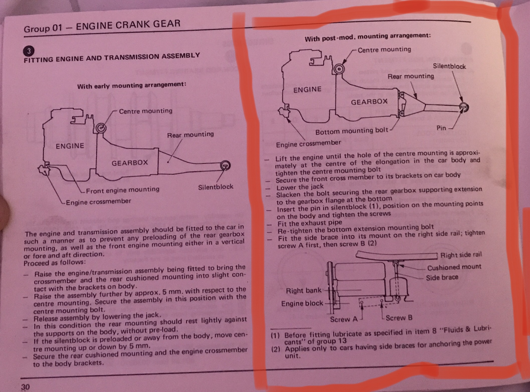

Then the other week the clutch started slipping, didn’t feel like a normal slip, if you floored it the revs would rise 500rpm then it would grip and be fine. Past experience has shown that when they start to slip the revs will keep rising until you lift off and allow it to grip.
Bit the bullet and decided to stick a new clutch in over the long bank holiday weekend.
Never a fun job, and it’s a surprisingly heavy lump given the modest power it has to cope with especially with callipers attached.
Of course it would be rude not to do a bit of ‘while you’re there’ stuff so I replaced the main bush which hangs the gearbox from the front bulkhead as a spare came with the car. Was a sod to get in so used the hose clip to squeeze it while pushing it in trick.
This tail shaft mounts to the back of the gearbox and holds the gear shift linkage, I knew the bush was completely knackered and you could feel the gear lever bouncing up and down as you came on and off throttle.
I modified a poly bush we use at work which usually end up in the bin, made it a cotton reel shape to sit snug inside the remains of the old rubber bush. Also cleaned up and painted the tail shaft to tidy it up a bit.
All in and working nicely, gear change vastly improved.

Interesting mod on the tail shaft bush. Never thought it would improve the gear shift
Mine is in a similar poor state.
The original ones seem to be obsolete now, so I may try your mod........

The tail shaft bush was never a tight fit on the bar even when new.
When I worked for a dealer back in the day the way to set it was to adjust the height of the engine/gearbox on the top gearbox mount until the top of the bush sits on the bar
Also very important to the gear change quality is the bush with the metal sleeve where the lever pivots - make sure the metal sleeve is not seized and give it a good grease up
Posts: 1756
Re: An introduction and my 1980 1.5 super
Gary is quite correct. The tail housing bush should be a loose fit on the cross mtg bar. When the engine and gearbox are set at the correct height that rear bush should be under little to no load. You should be able to wiggle the tail housing side to side quite freely
If it’s hard pressed against the body or mtg then you can get a vibration and the car will possibly torque steer as it means the engine and trans height is incorrect
The attached photo should help explainify it .
Any further questions just ask

Thank you, very useful. I wasn’t really sure how to set it up so just did it so it looked and felt right. I’d assumed by the size of the hanger bolt that the main hanger bush took the majority of the load. The old one was in a poor state with the weight on it but looked fine when removed.
The rear bush is still very soft even with the insert, I’ve not noticed any increase in vibration but definitely get a lot less movement in the gearstick.
I don’t have anything else to compare it to, I’ve not been in another sud since I was about 7, almost 35 years ago!
