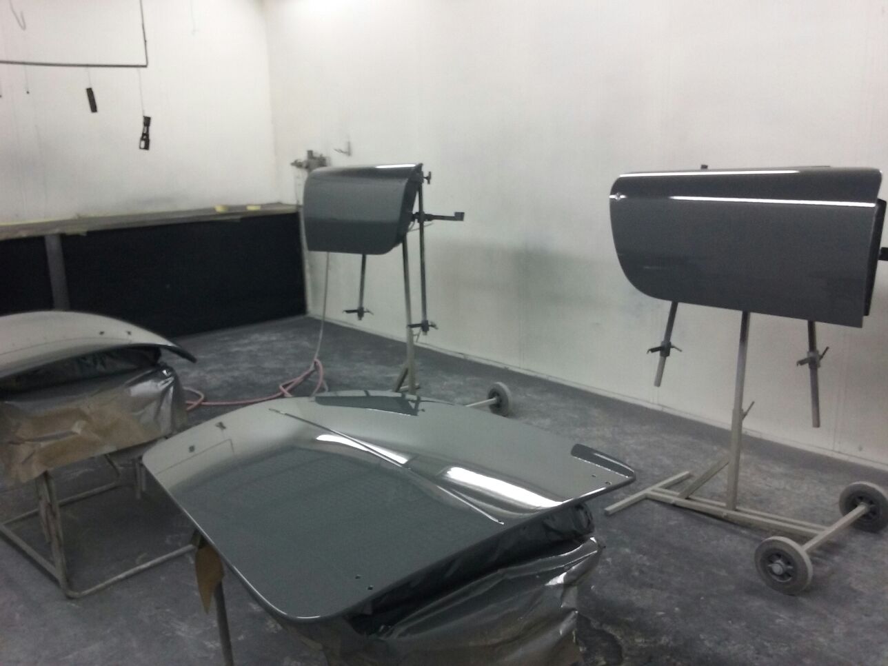

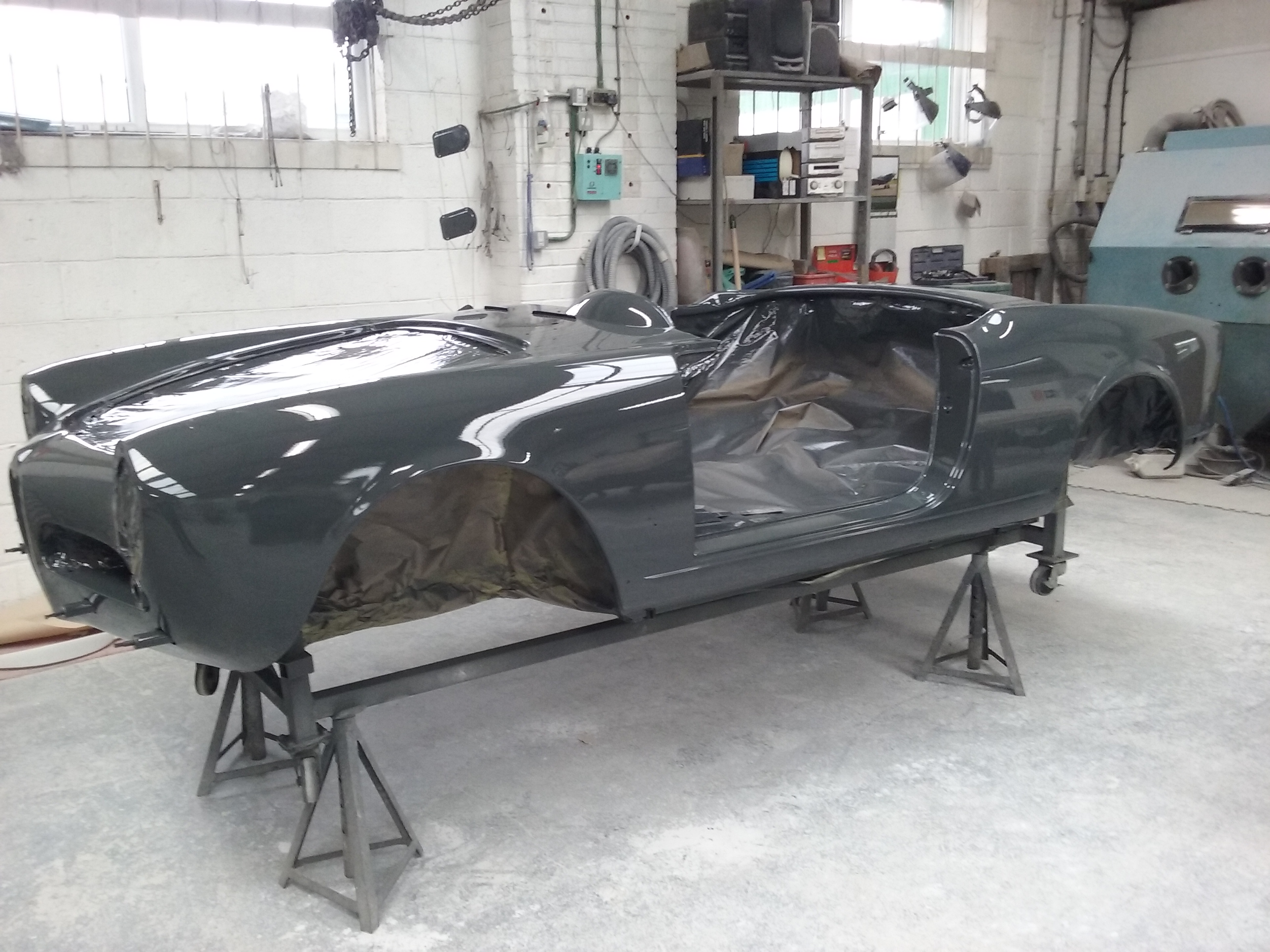

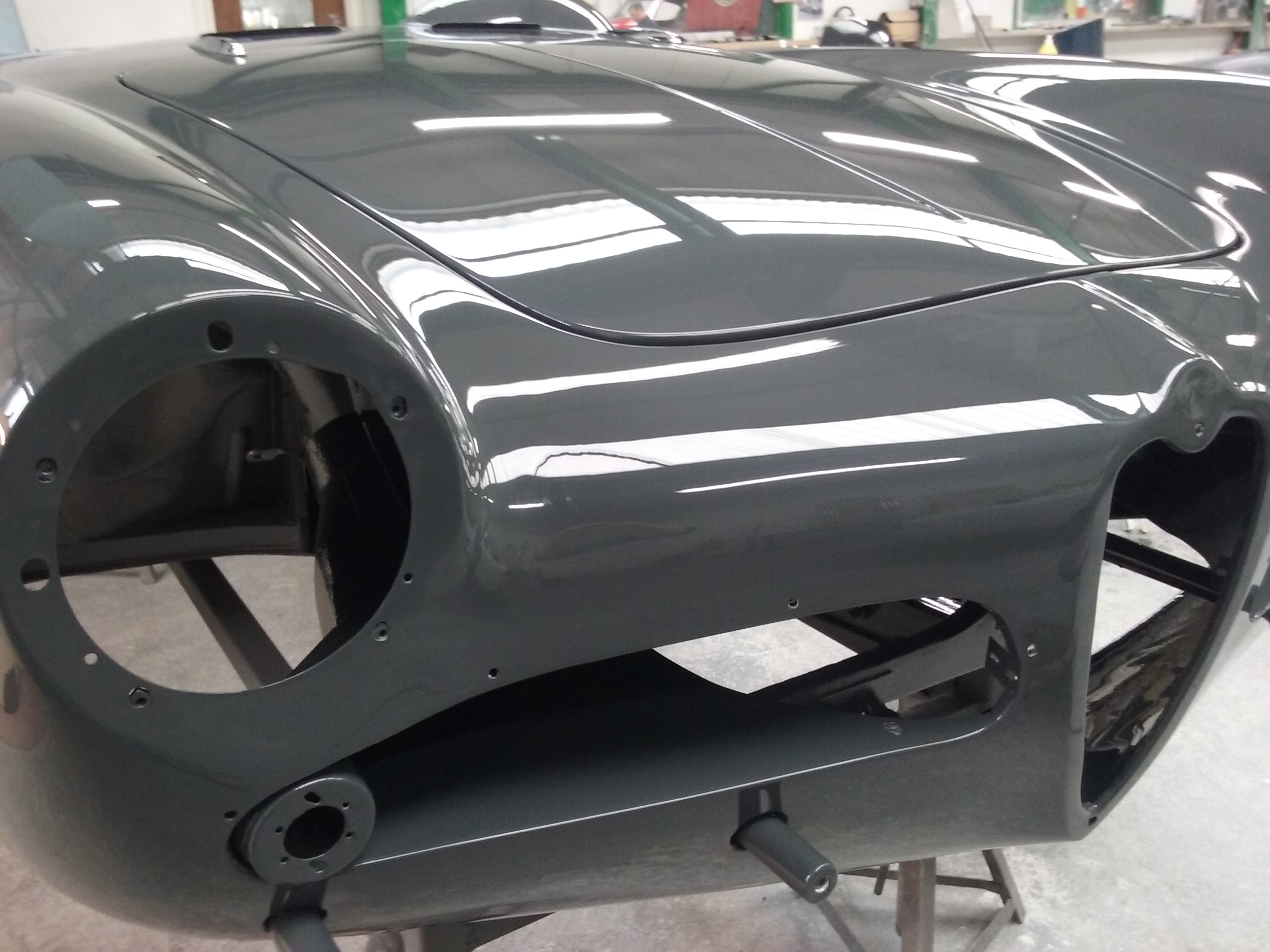

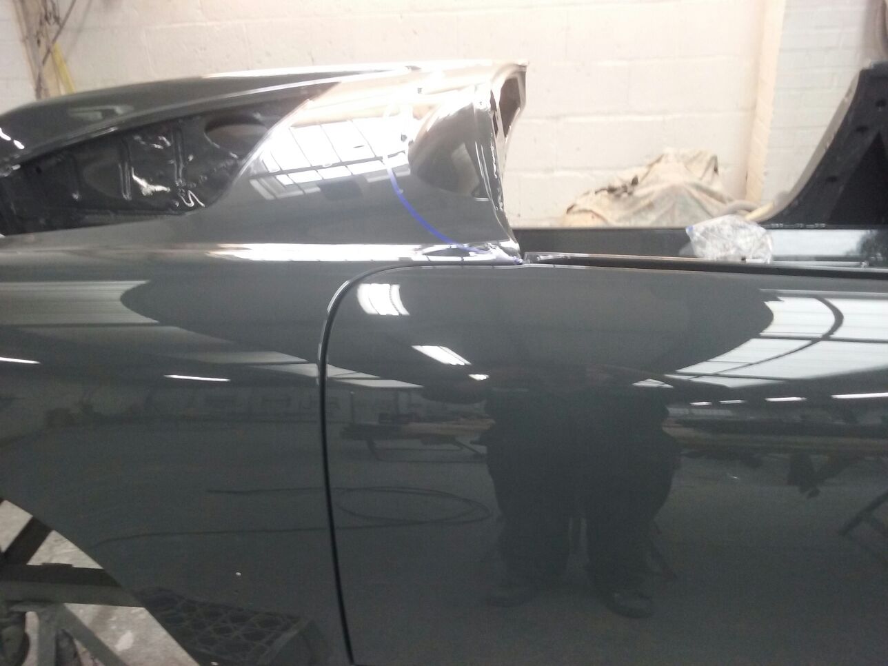

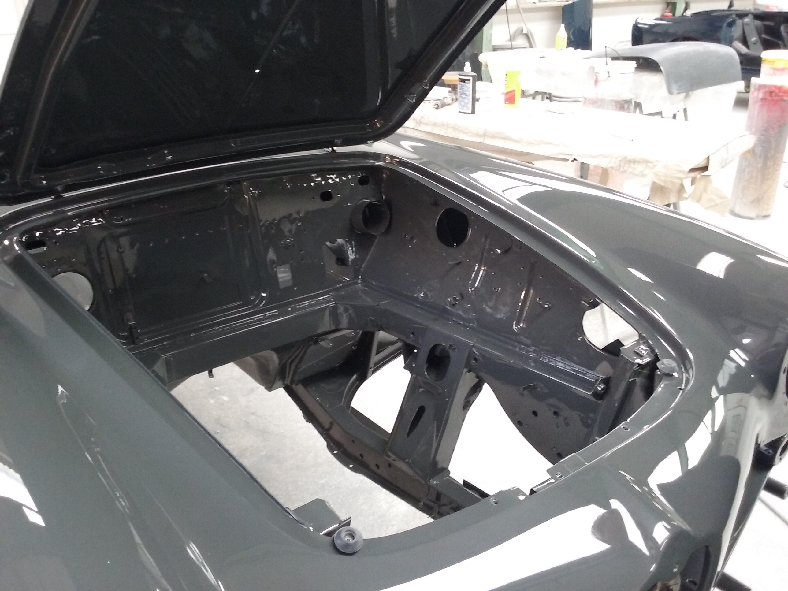

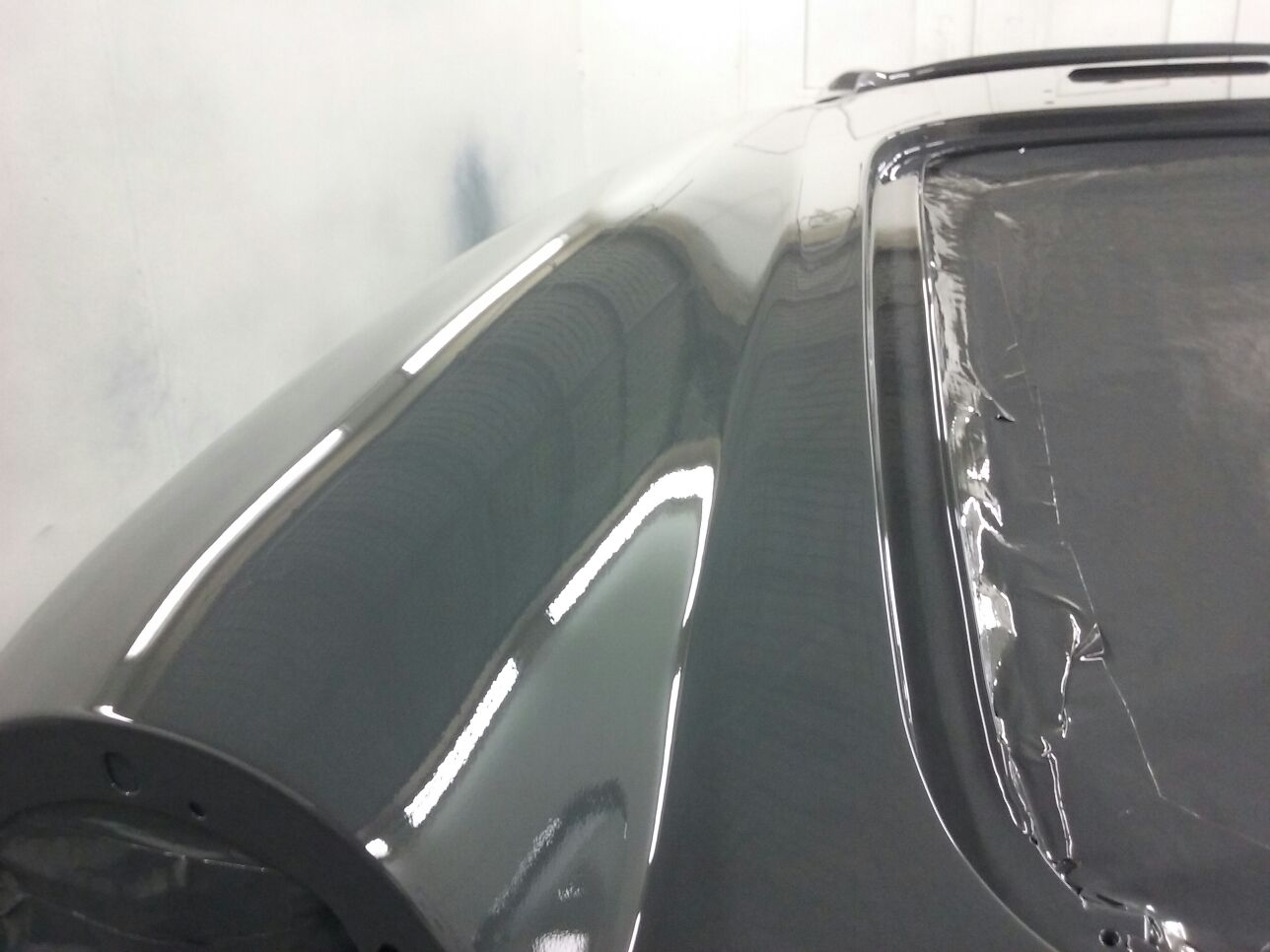

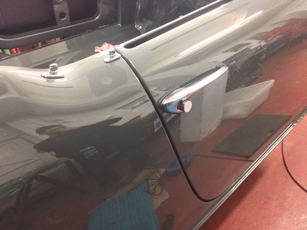

The car is now all in colour and I have started to wet flat and polish it.
First it is all flatted using 1200 grade wet and dry, then 2000 grade before machine polishing up.

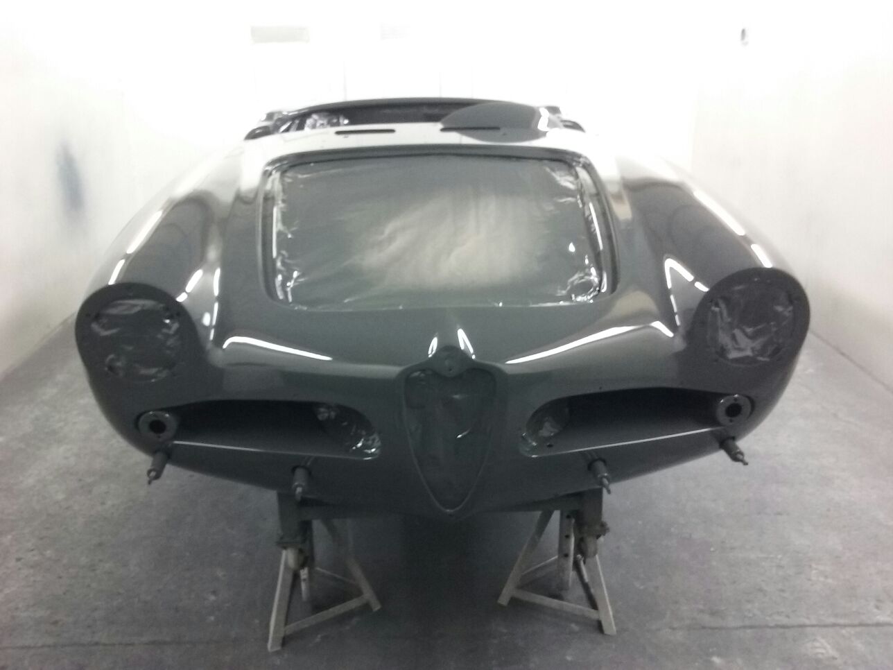

Here is the "out of the gun" painted car.

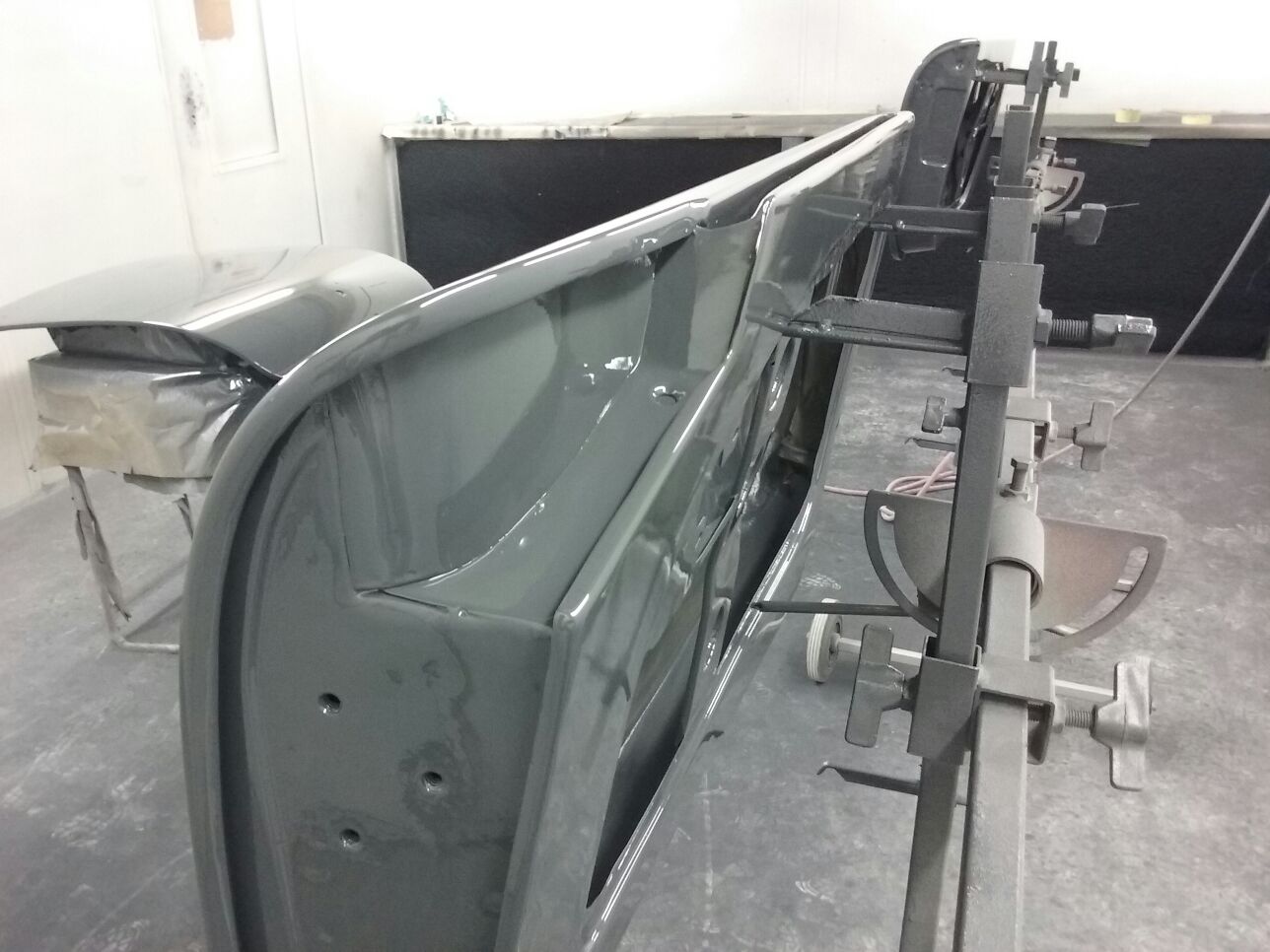

I have door hanging frames like that, what do you do for mounting them? Doesn't look like you've hooked the bottom one on? I'm terrified that they will fall off without being fastened top and bottom!
Posts: 2853
Re: Giulietta spider
Livin' on the edge mate :D
If you look close , there is a bit of rod pushing the bottom of the door out. I couldn't get the hooks in the bottom so the doors are just hanging from the top and pushed away at the bottom so I could paint all around the inside as you see it all.
The car has a small door trim card but no break line , so I couldn't paint in two goes (inside then mask off and spray just the outside). It was actually tricky to not hit the frame with the spray gun and get a nice even coat of paint.
Noticed the little pin, looks to be sitting on the edge of where the card will fit? living on the edge indeed! I'd be scared of it bouncing off and putting an outward dent in the door skin!
Often thought about getting a flat piece of wood, maybe 3" x 6", and making a small indent that would fit to the end of the bottom pole then resting it against the inside of the door skin. Not a small enough area to create any issues, particularly as the weight is all on the top attachments.
Had the same issue with the Fulvia doors, needing to paint the whole of the under/sides/top of the doors in one hit. Saves a lot of masking faff too don't you think?

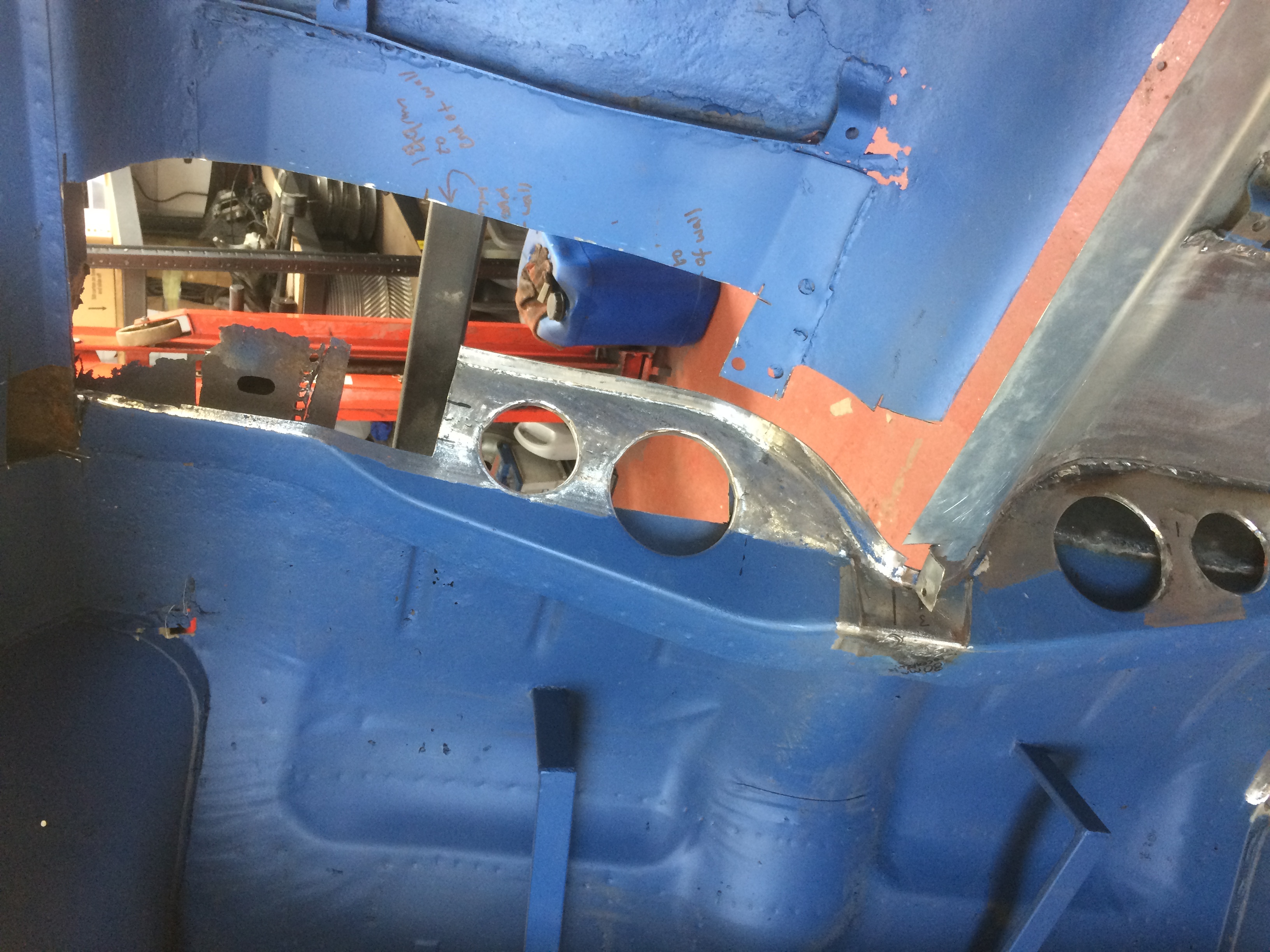

Restoring the lower half of the rear inner heelboard/crossmember

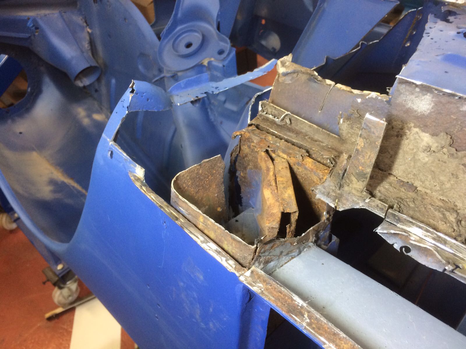

Excavation of rot from bottom of A-post. Good metal was only found at the lower hinge box

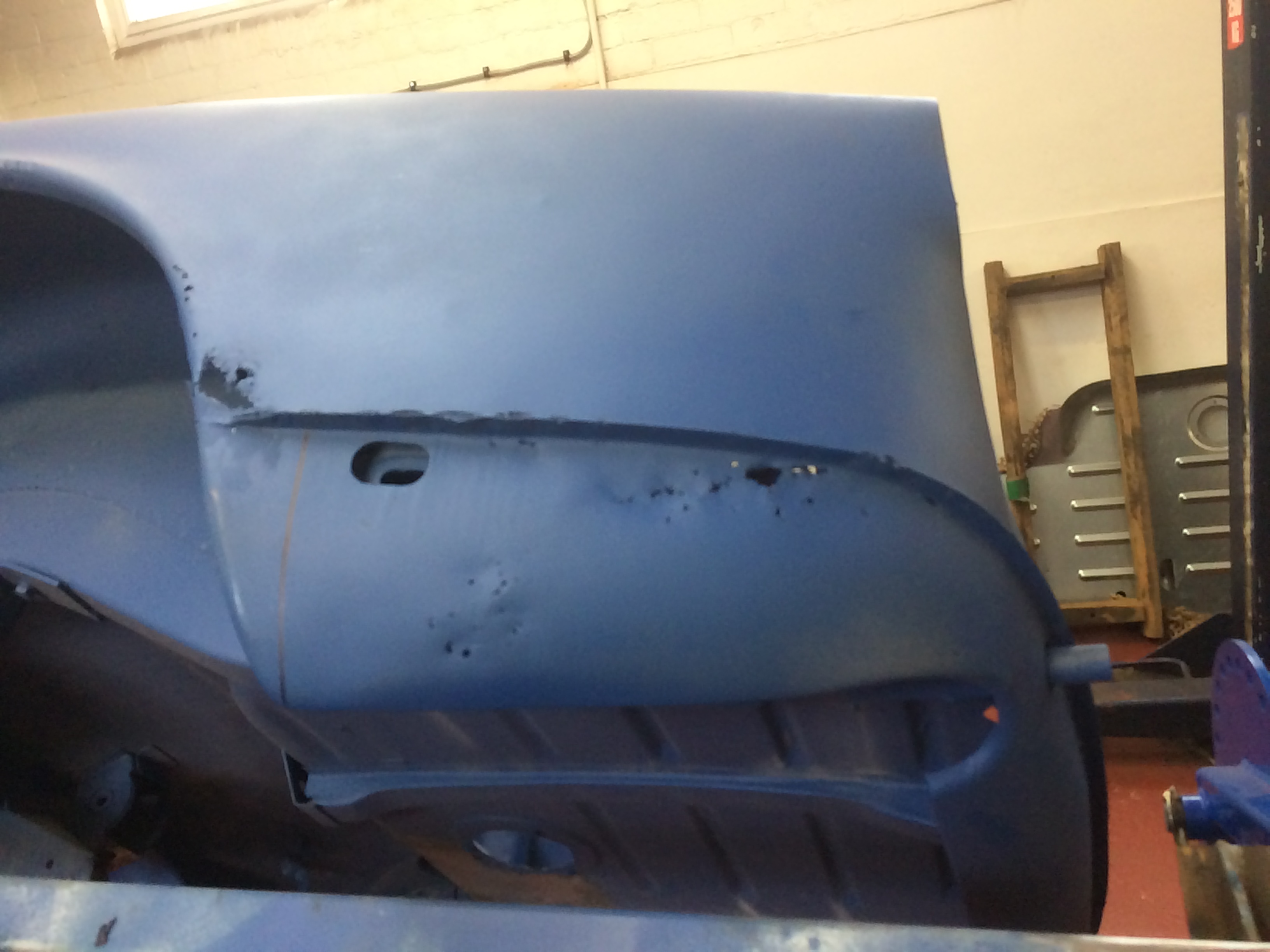

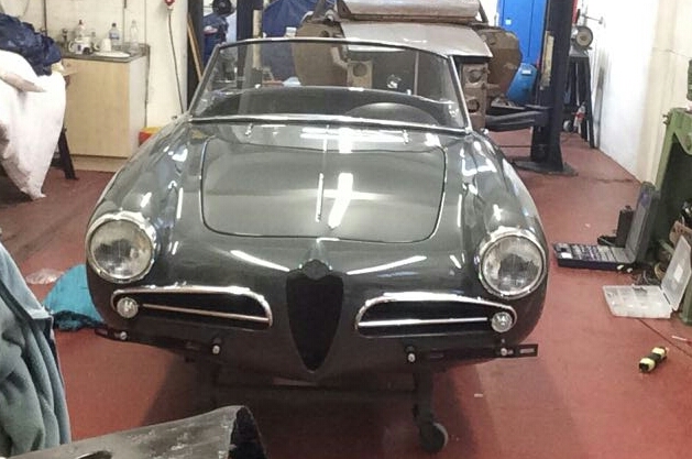

As found condition of lower valance / /rear quarter.

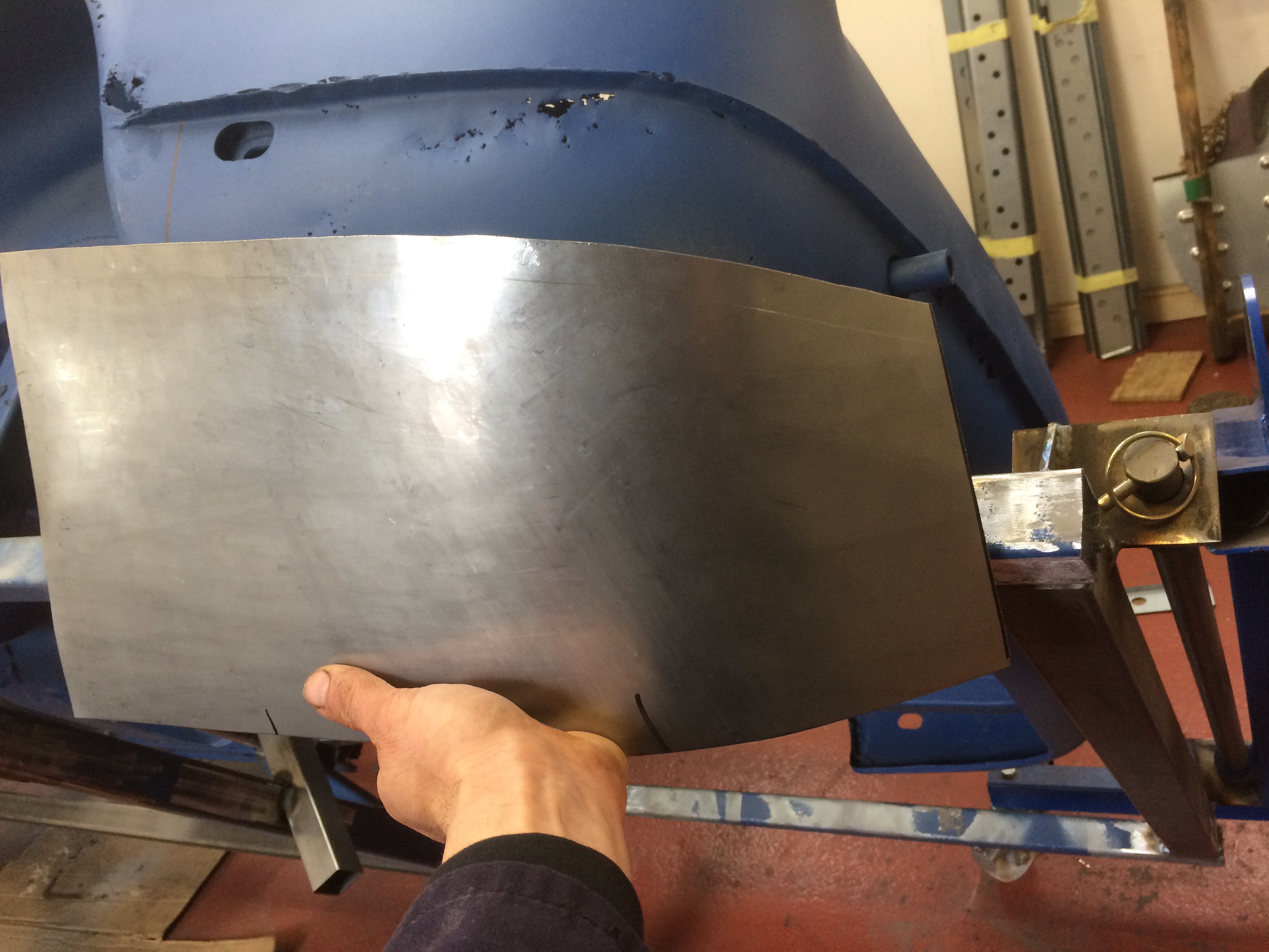

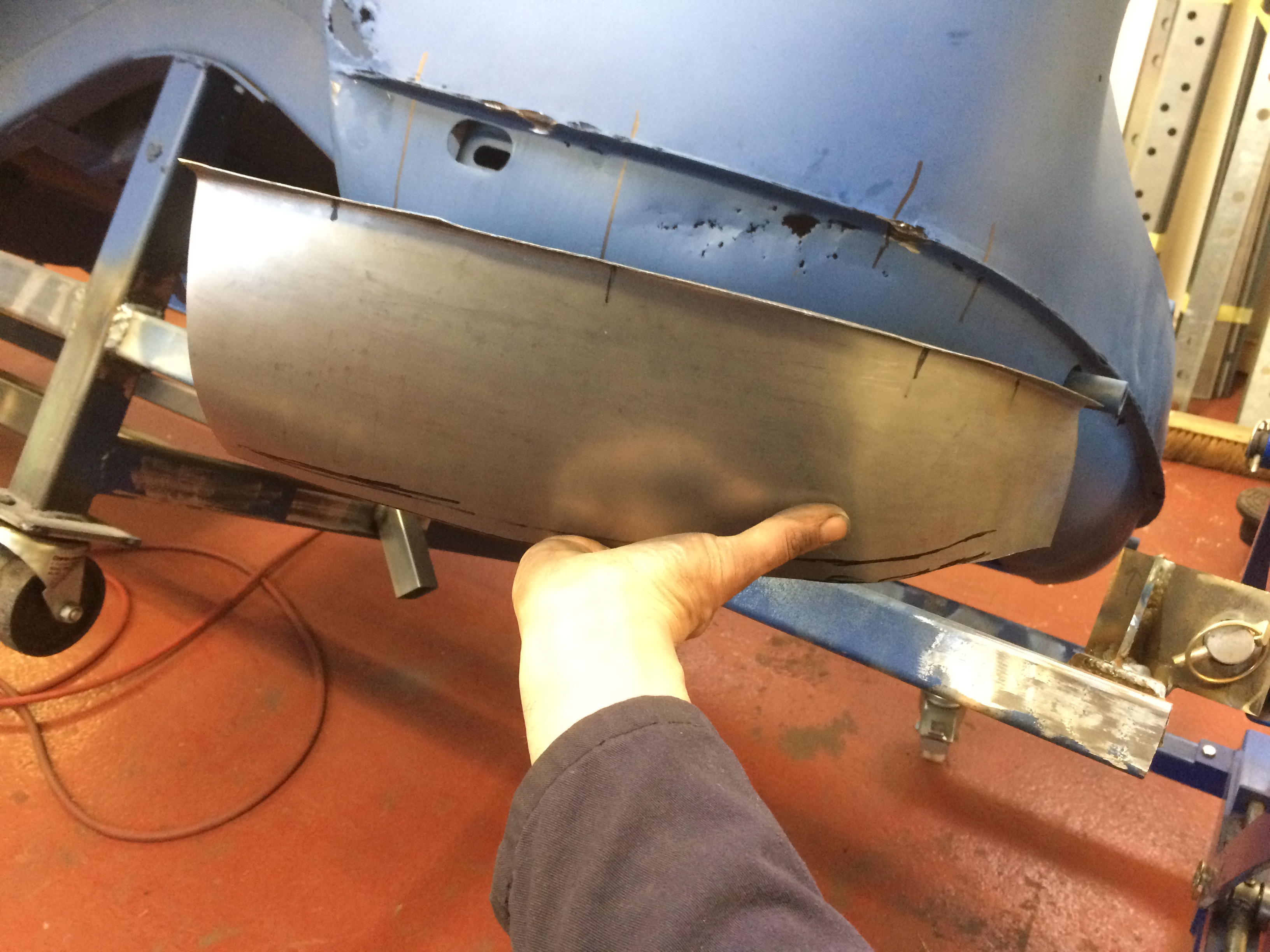

Initial shaping of new section. This is the stage you think, i will never get that
But after some persevering the shape starts to come through

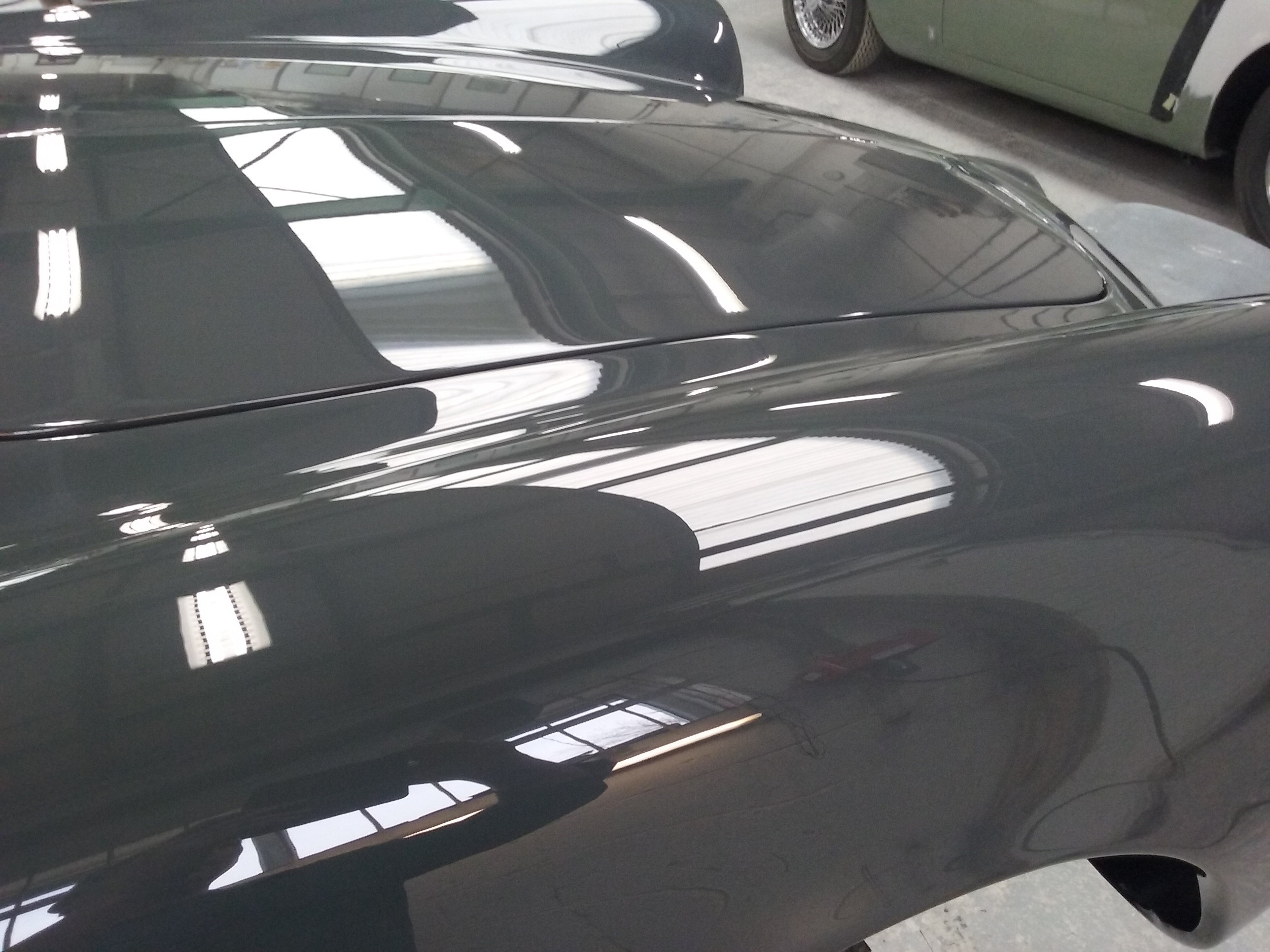

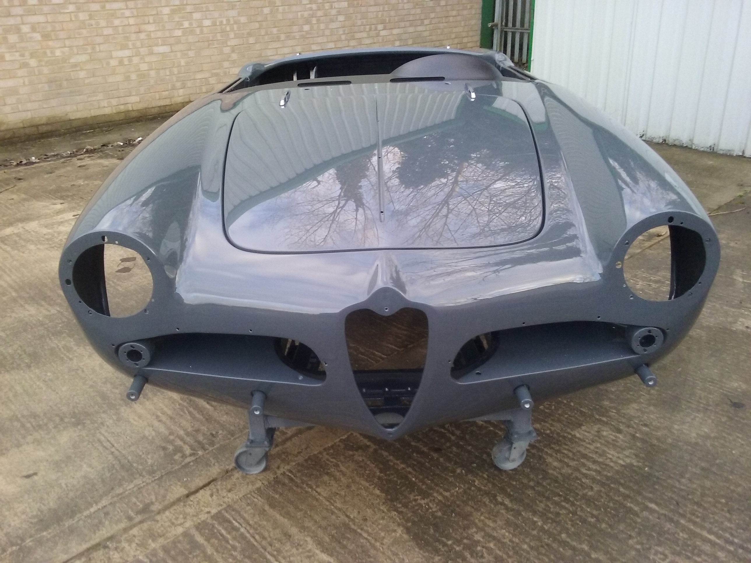

Just a little update, I have flatted and machine polished up most of the car now, and just doing a few finishing touches prior to its collection this week. It will then head up to Gad at Four Leaf Clover Classics to be reassembled and completed.

Cheers mate, the light in the workshop varies depending if the sun comes out.
Colour is Grigio Grafite.

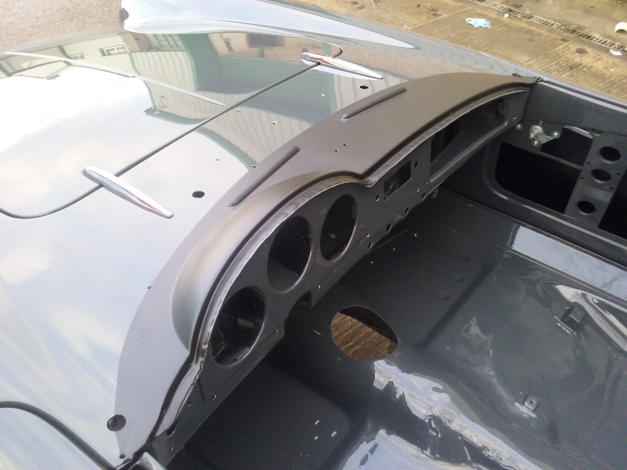

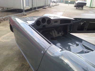

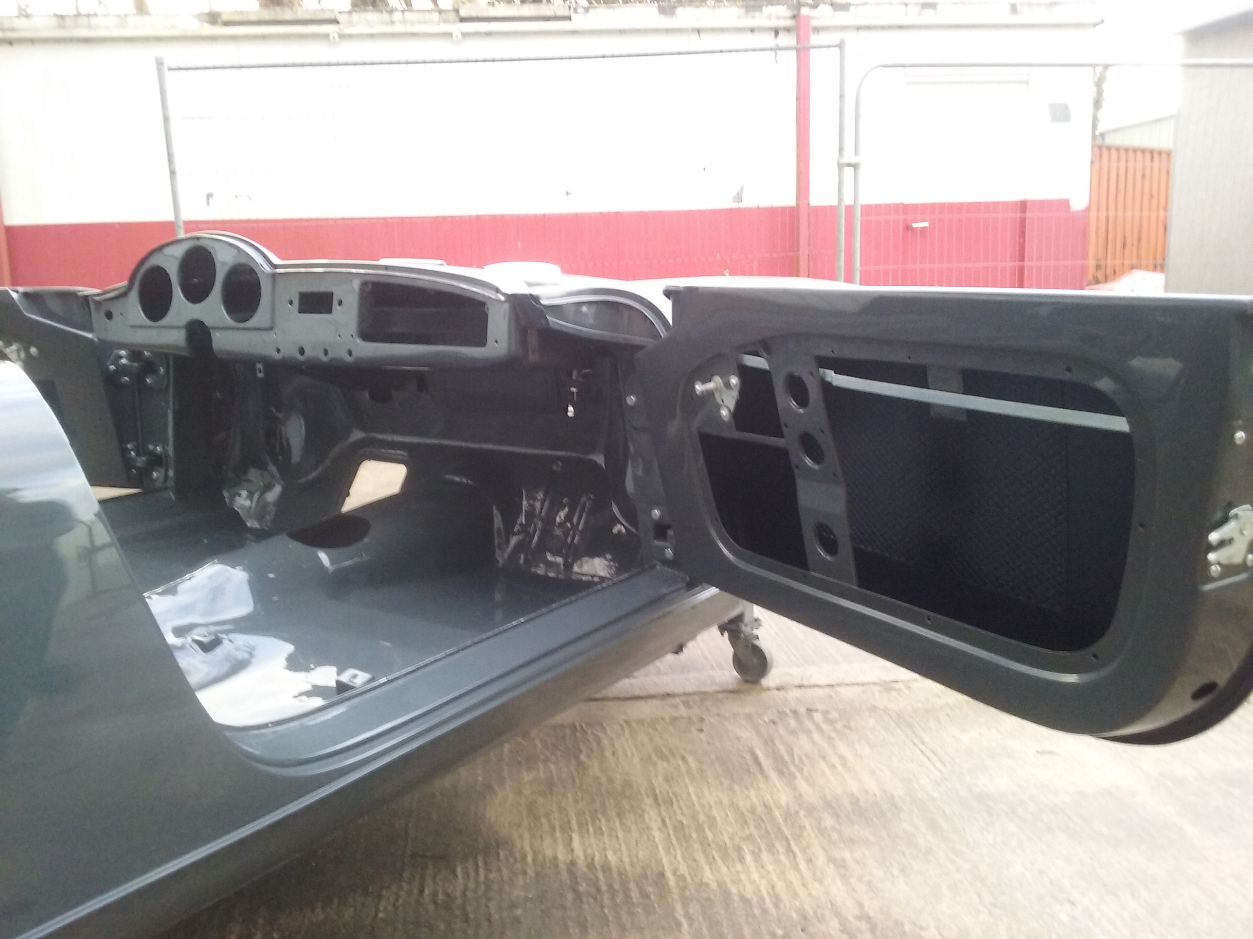

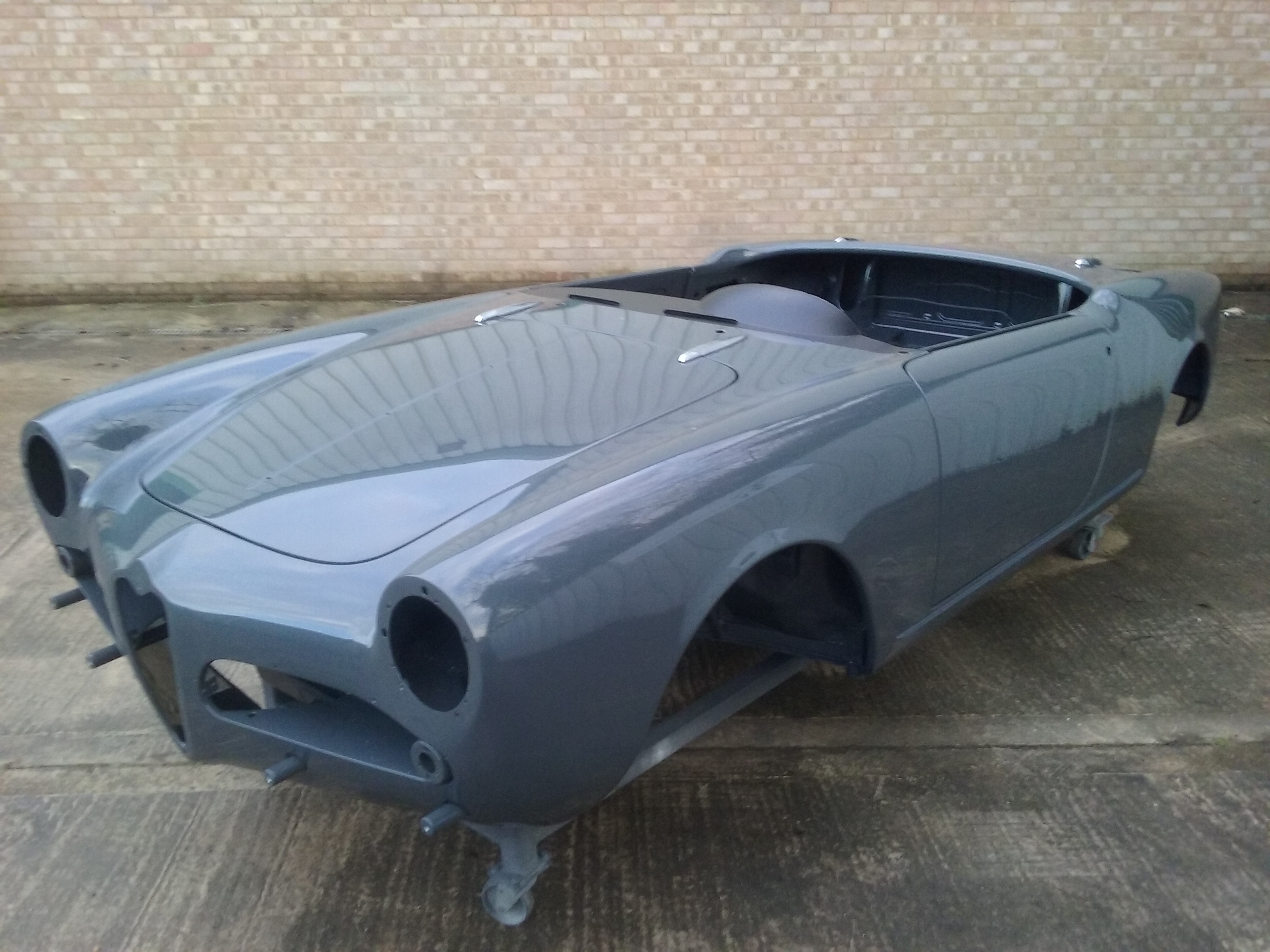

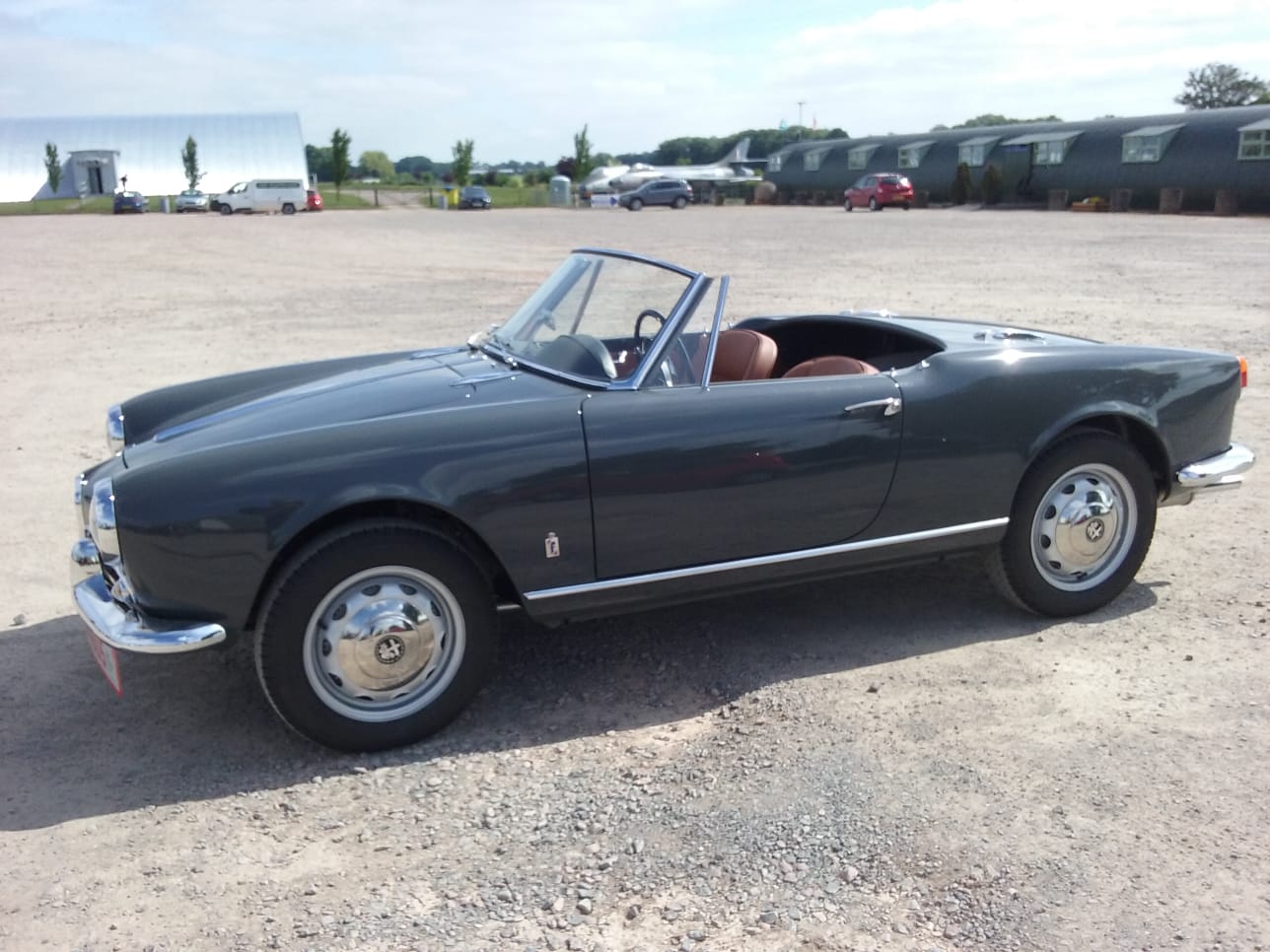

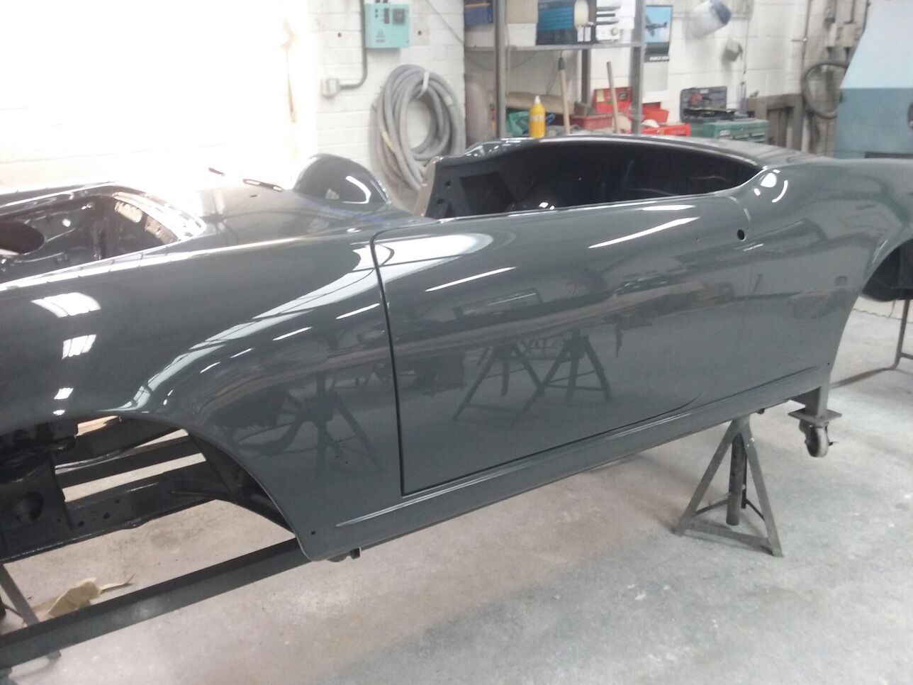

Final update from me. Here is the car all finished and ready for collection.
Not the best of shots as it was getting dark.
I'd hate to put that back together, it's too nice to risk scratching it! :D
Love to see the inside and floors done to that high standard mate, something people will most likely never see but we know ;)

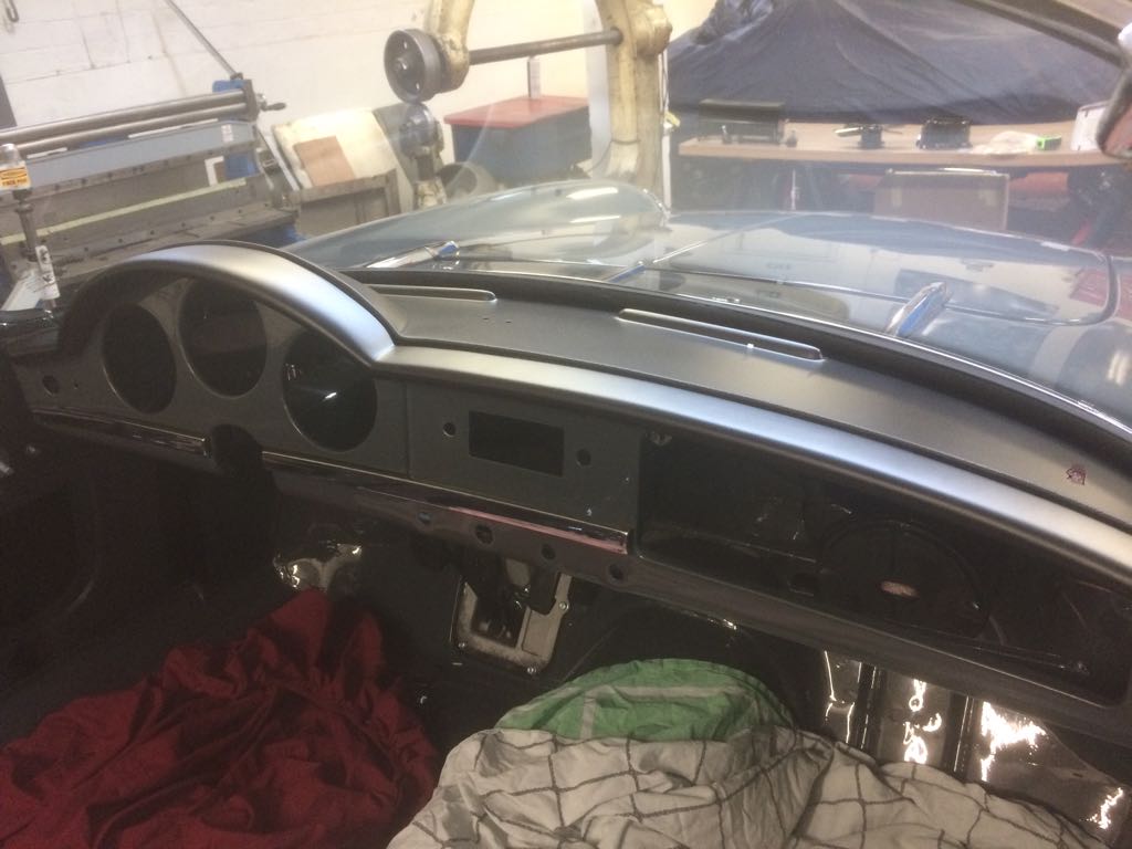

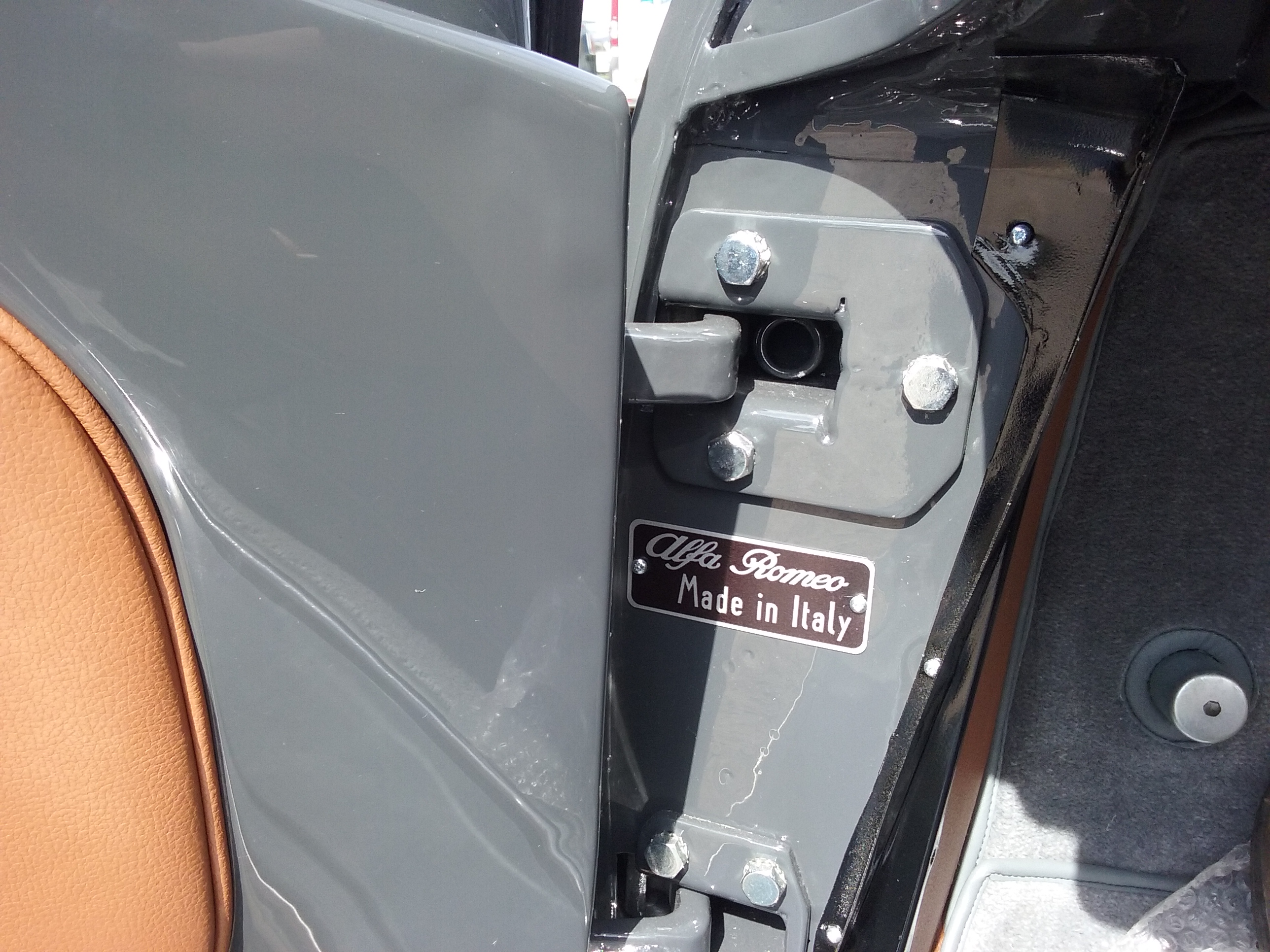

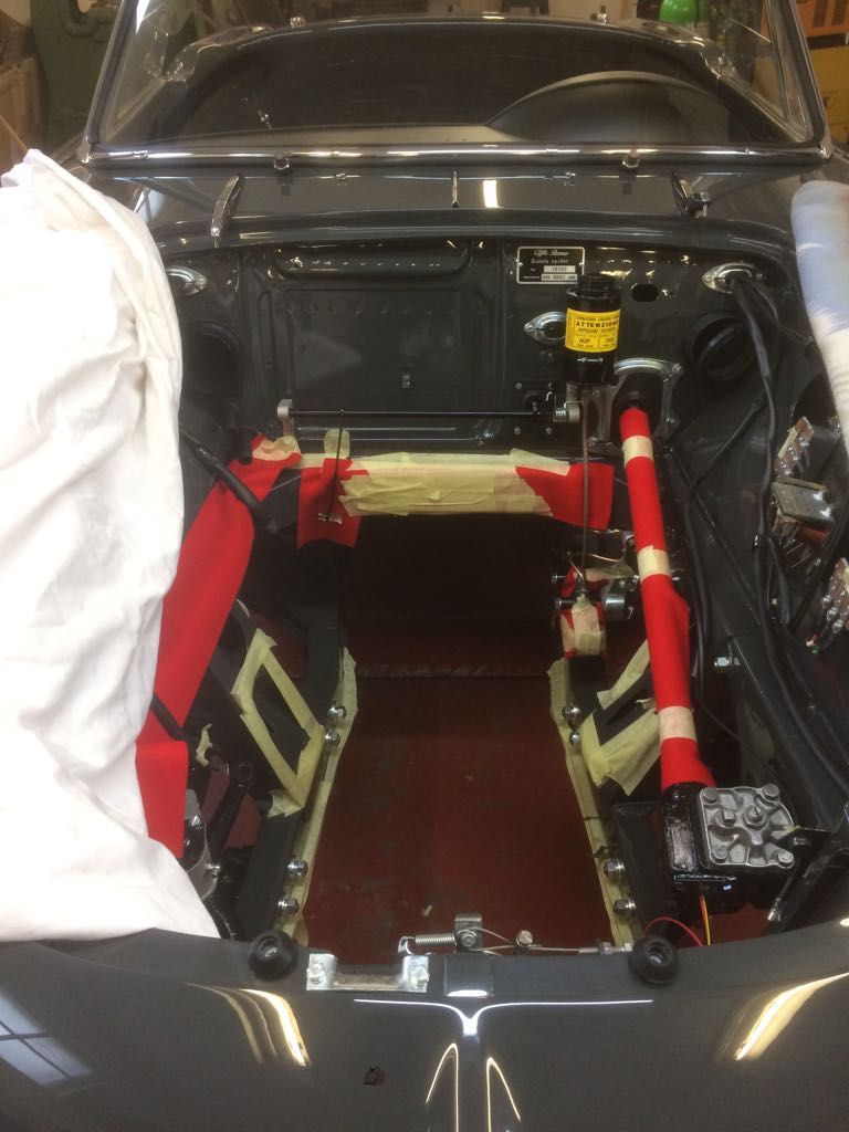

I love the dash all part of the body. Bit of a pig to work on, but a lovely effect along with the door bodies.
The interior floor picked up a bit of dirt, but underneath looks really smart.

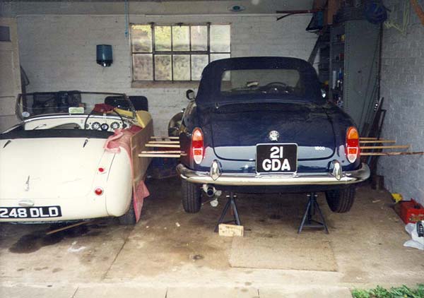

Here mine from a few years ago, what do you think's happening!
Dave
Posts: 1196
Your practicing for a magic trick, in the next shot you take the axle stands away...da dah :lol:
Something to do with fixing the chrome strips on the side?

alfatwo, lovely looking Giulietta, any chance of a full picture?

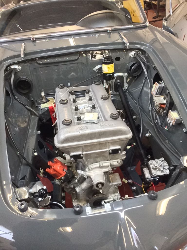

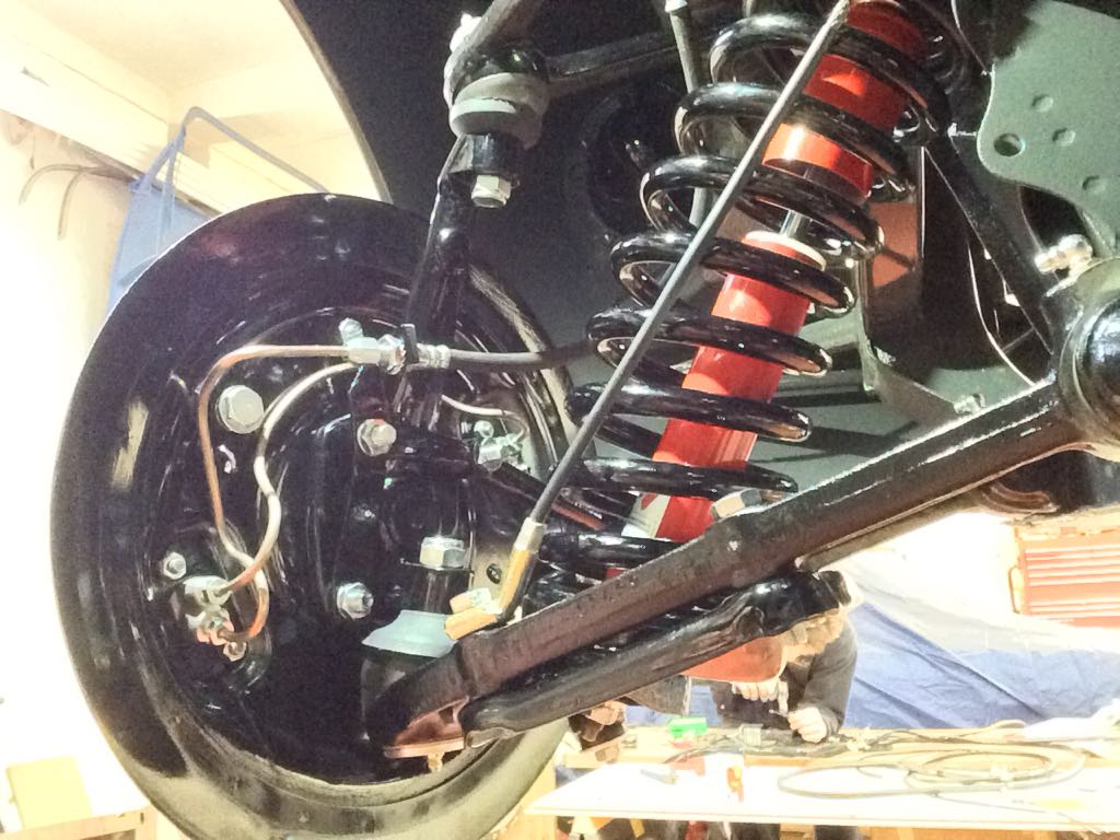

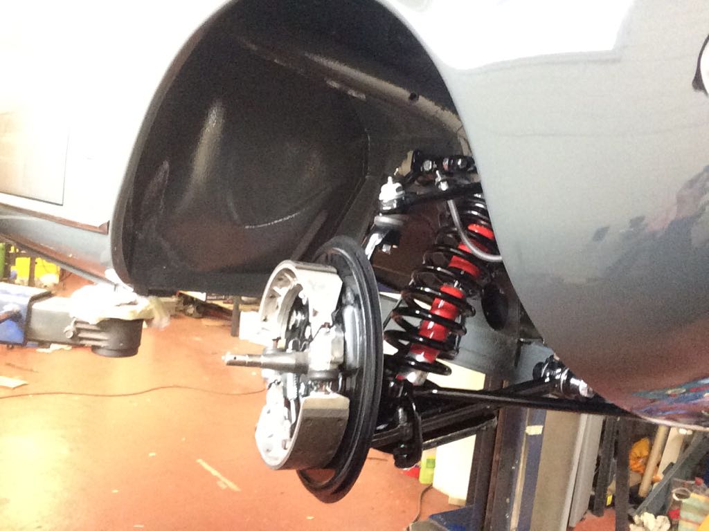

Here are a few more progress pictures.
The guys are really cracking on with the car.

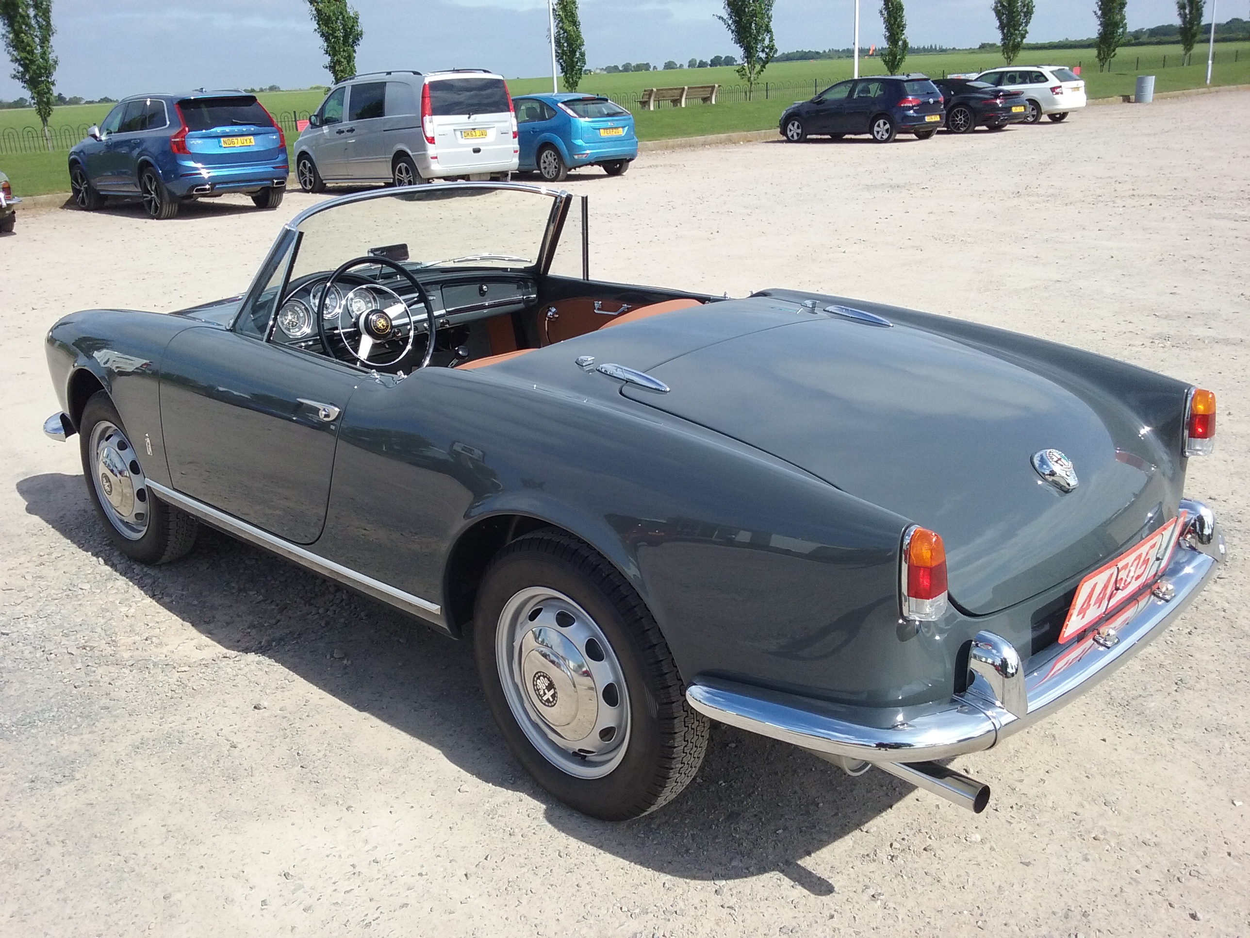

Well a final few photos to close this thread.
Gad bought the Giulietta down last Wednesday for a final polish and was also asked by the owner to give me a trip out in it.
It was a lovely day and a nice finish to the project.
Car looks fantastic, and thanks to Gad and Alex for taking so much care putting her all back together so nicely. :D
