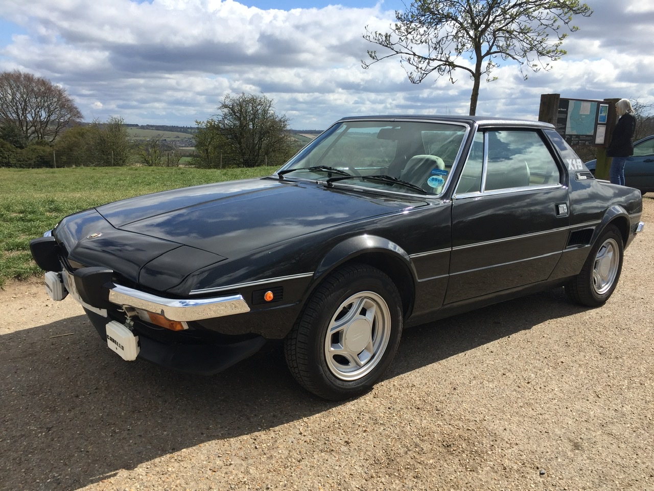

That was a great read Lauren and many thanks for sharing. I loved your bit about growing up with Space 1999 and UFO, it struck a cord with me and is probably why I loved all those exotic Italian super cars of the time. Probably why I ended up owning several x1/9s not have the skill to do what you have done or the money to buy a Miura!
